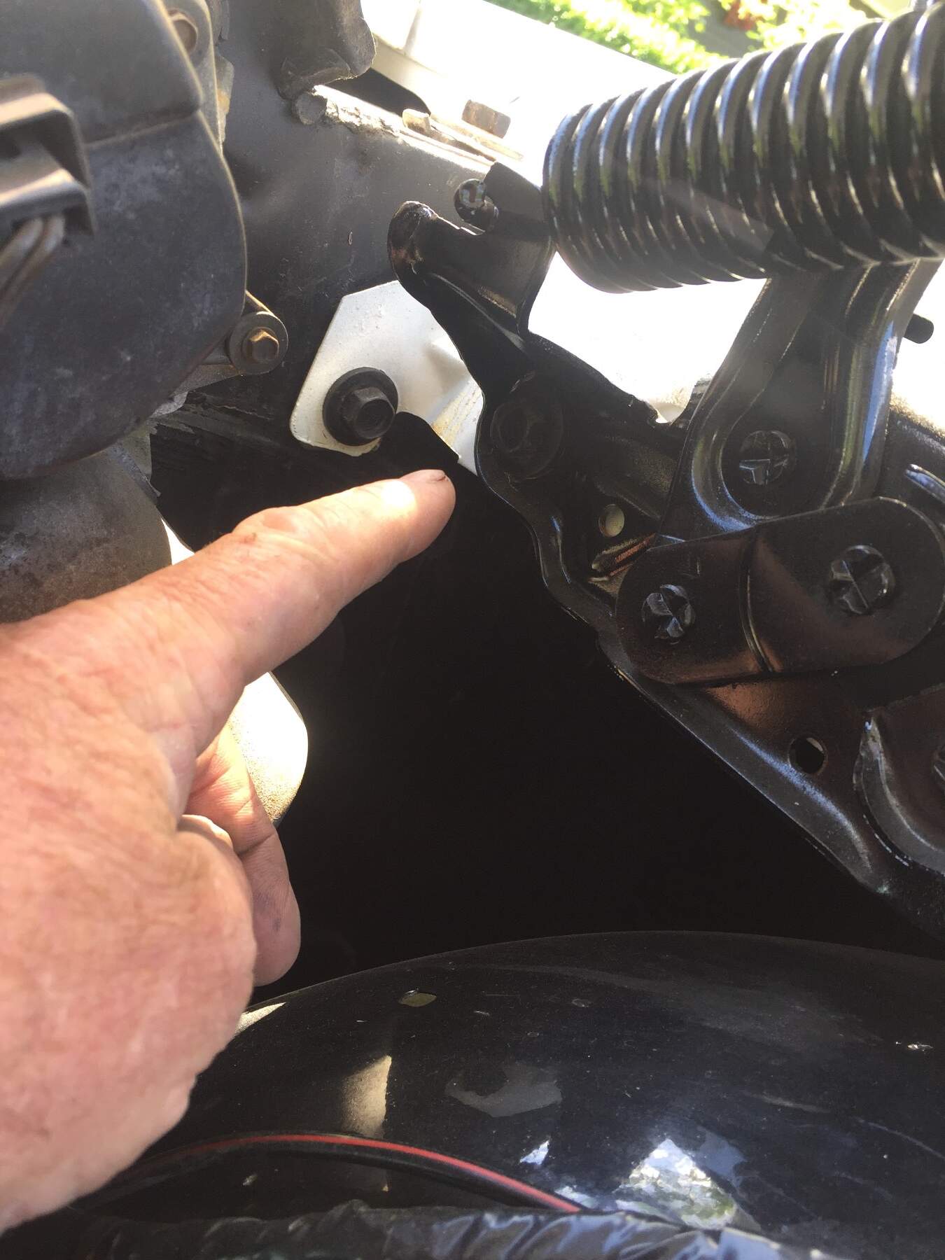

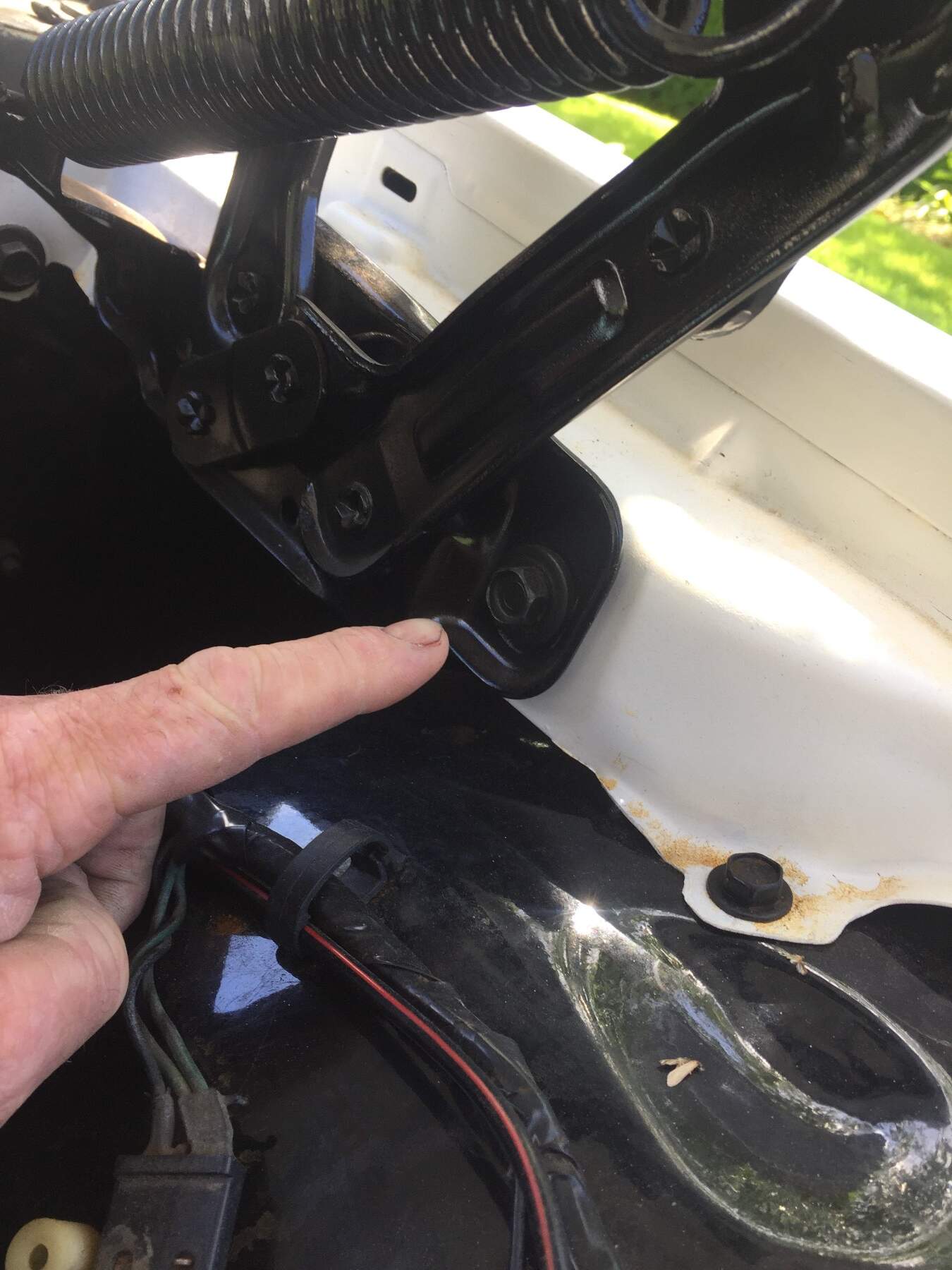

wrongway, here are the pictures i could not send you via pm !!! it works on the main platform but not on private message!!... Ringo !! help!!!!!
oh i know what it is!! i bet its because i have filled up my pm so i am over my mega bite thingy!!!:rofl: and i need to delete some old content!! and then i will get more dilithium cyrstals :rofl:
 Wrongway lets post your pictures on your thread and we can share what your trying to fix... bet we can sort it mate :cheers: and it may help another poncho owner in the future.👍
Yeah we can do that Kiwi. I'll see ya over there bro
