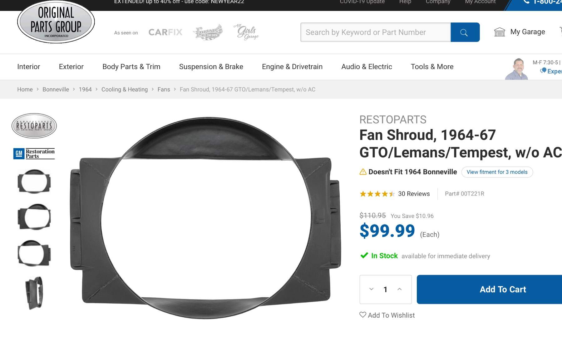

I can’t remember… do you have a shroud for your fan?
no !! i was looking at that yesterday !! i am going to make one! might even get onto that today... bloody flooring contractor rang and is now coming tomorrow, so i am heading home.
i will fold a template up out of carboard first and perfect it first, the sheet metal shop wont be open till next week i expect, and they can justA copy my template.:dancingpontiac:

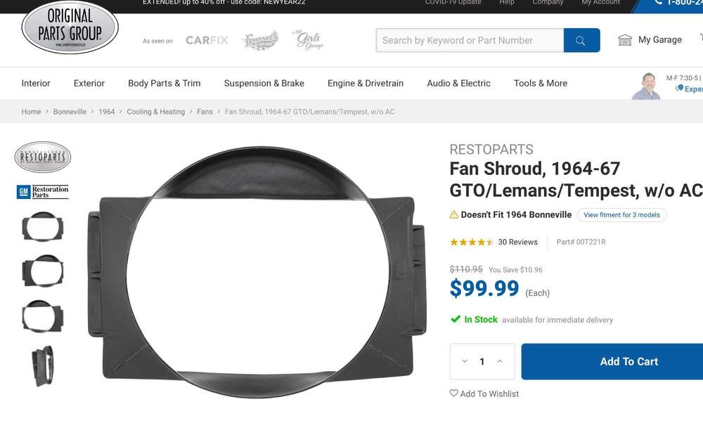

If you have him make 2 I would love to buy one. I bought one from opgi Β but it is about 4” to short. I’m not sure how much that matters but the car is running a little on the hot side.Β
Β
i certainly can mate...Β
it would pay to give me some measurements so i can comparedΒ  them to my fans diameter and distance off the radiator
yes i bet that restoparts one would be different if its for the totally different bodied car
Very Happy with my OPGIΒ  shroud.

no need to remove the fan Del, get me a diameter and distance off the radiator support member and i can compare it to mine. i couldn't use the factory fan as it was bent, so i have a thermostatic one on there off my camaroΒ Β
I bought my fan shroud as a used original that had literally been sitting against an Iowa barn for many years (off eBay). It was hugely discolored from UV fading but otherwise in good condition. Nothing a little Eastwood Underhood black paint and elbow grease didn't fix.

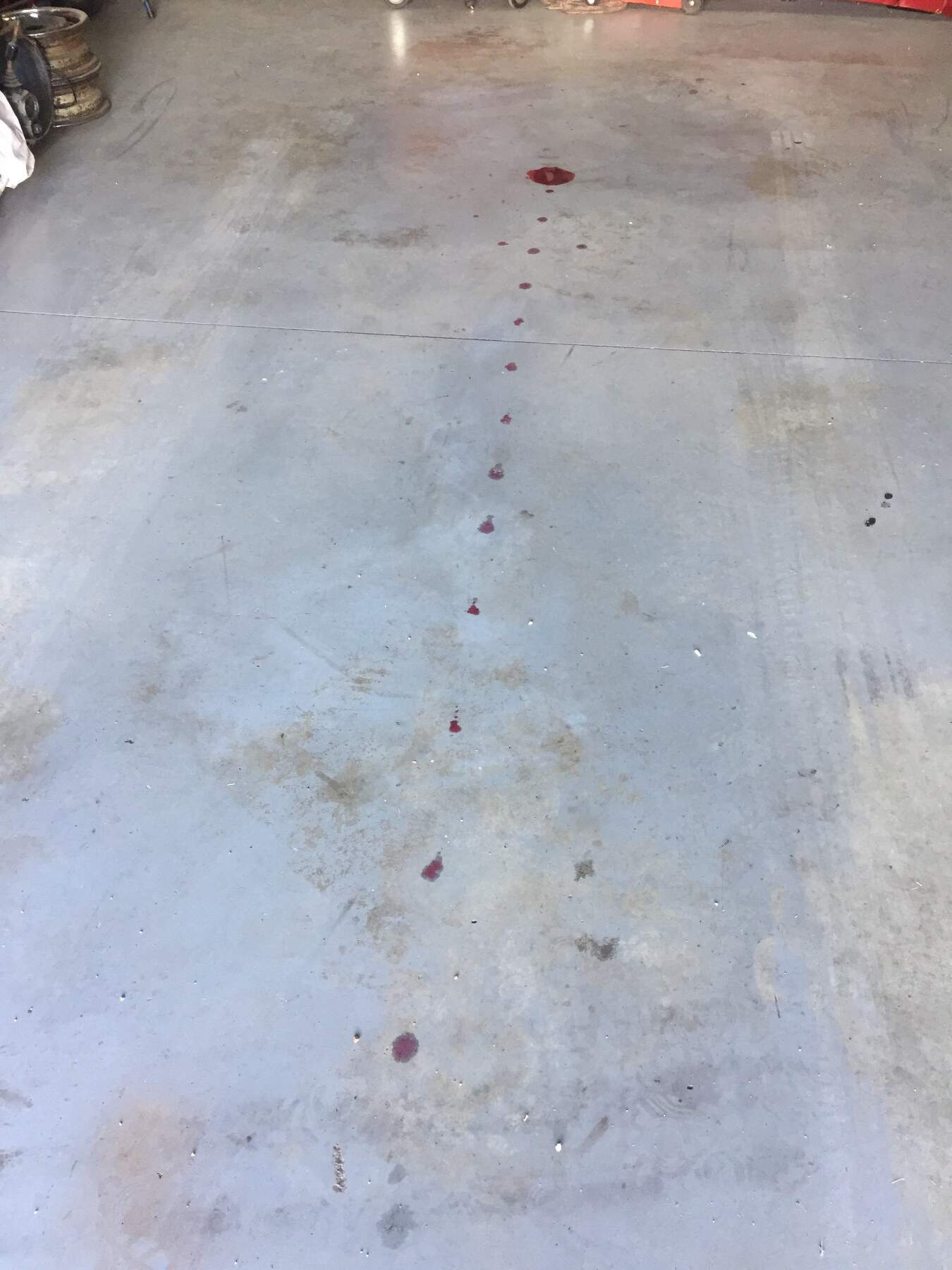

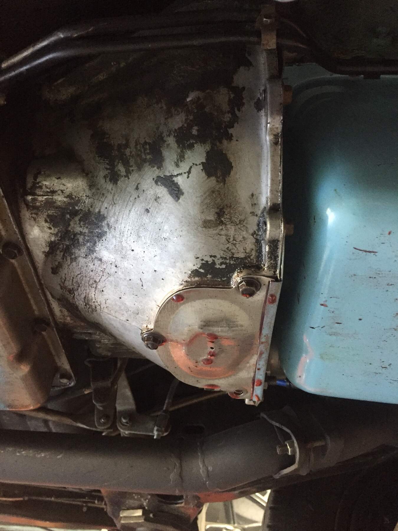

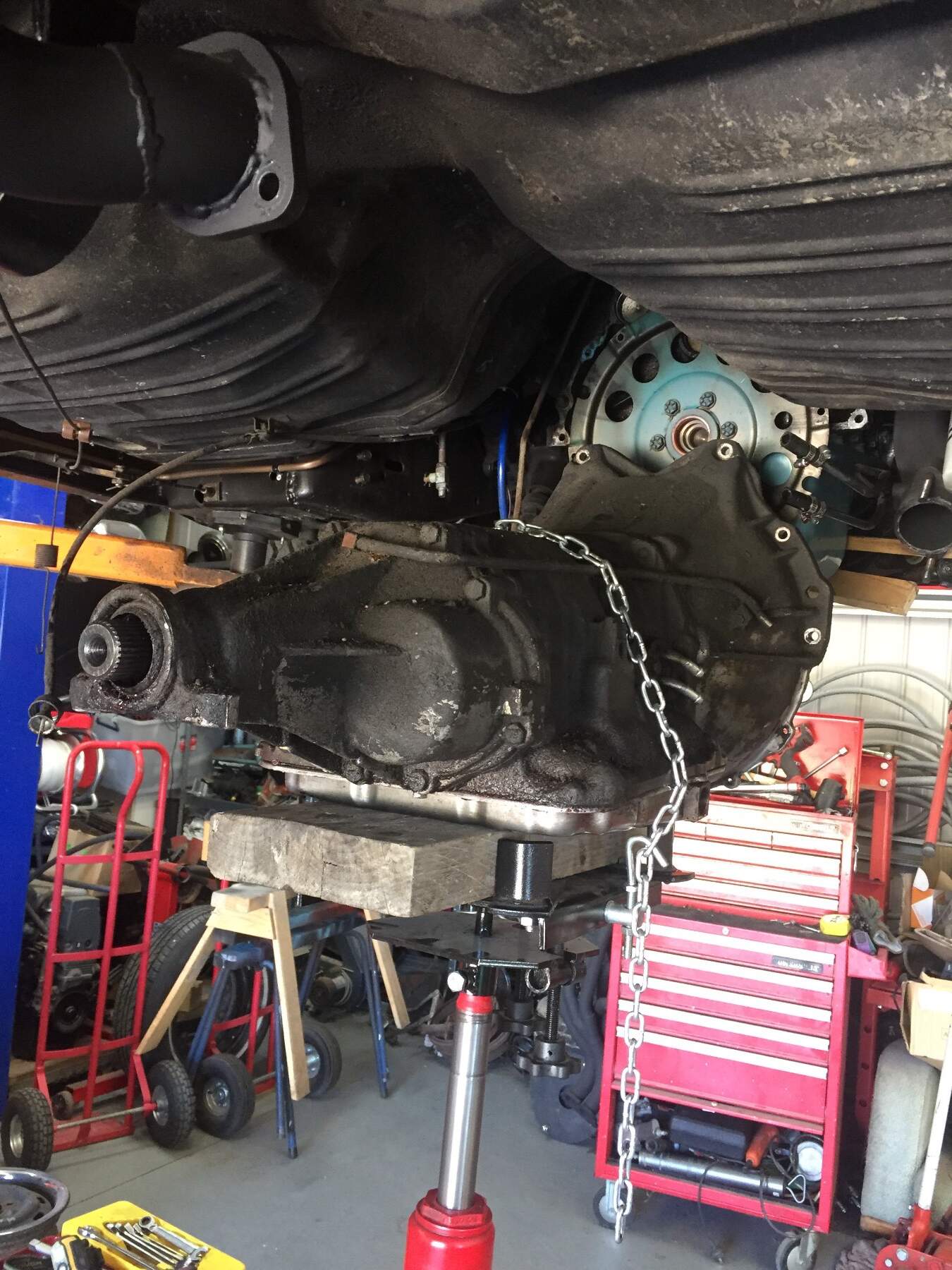

Its Trans-Mission friday !!!!! i am going to pull the jetaway !!!
Here is my leak !!!
35 minutes ago, 64 kiwi boni said:
Here is my leak !!!
Mine was even worse. The weird thing was it would stop leaking in drive. I think it would be somewhat impossible to know which seal is leaking. There are so many on and around the converter

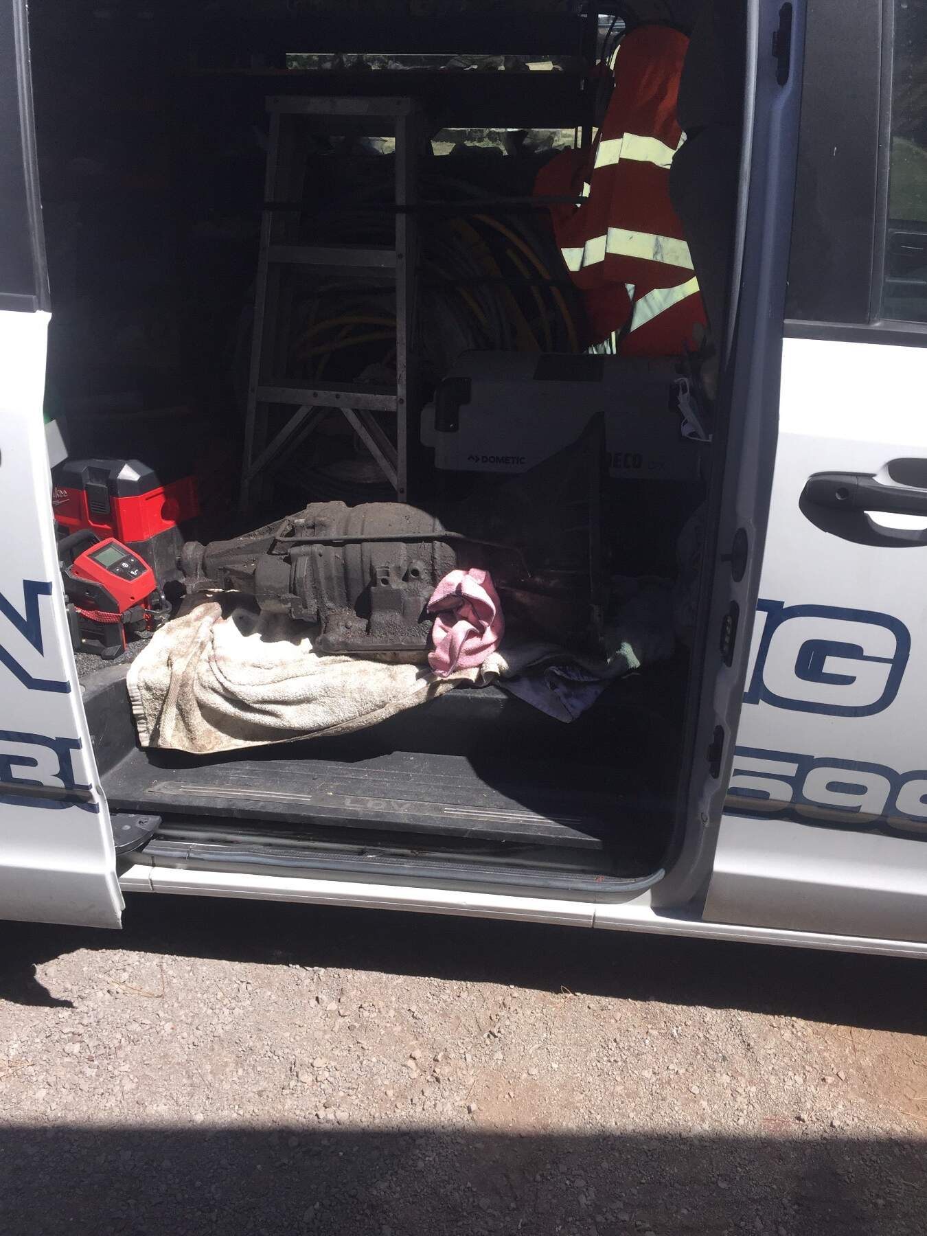

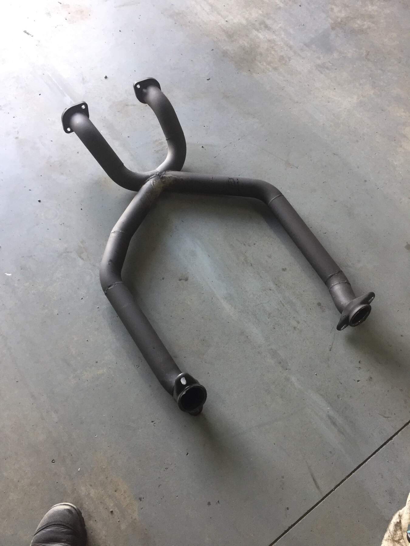

Some one must have been thinking when he built the exhaust system !!! Removeable trans section !!!Β
And out she comesΒ
Nice
Β
No wonder these cars are so heavy !!! That trans must weight 100kgs alone !!!Β
Note to selfΒ
get help to lift the blob back onto the trans jack !!
Quick road trip to RotoruaΒ
and for any kiwi jet away owners Β this is the manΒ
Treat him well. I think the transmission is the weakest link for the Bonnie longevity and performance. The motor can take some serious abuse.
according to Bill, these trans are strong!.... but my girl aint no race car, so i am not worried :)Β

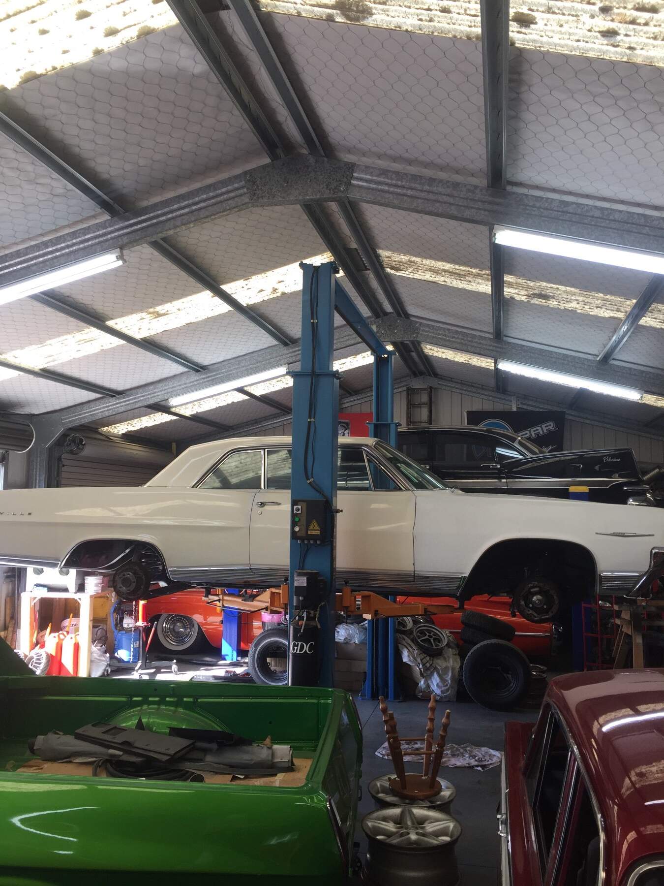

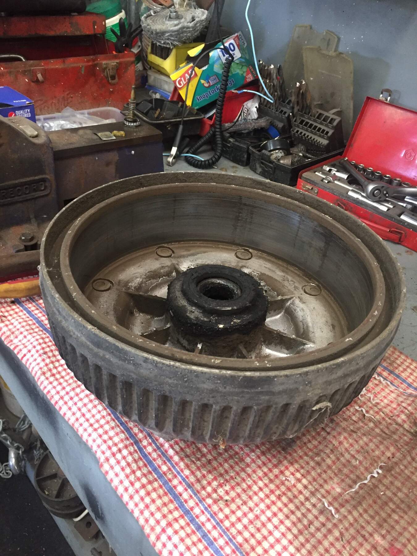

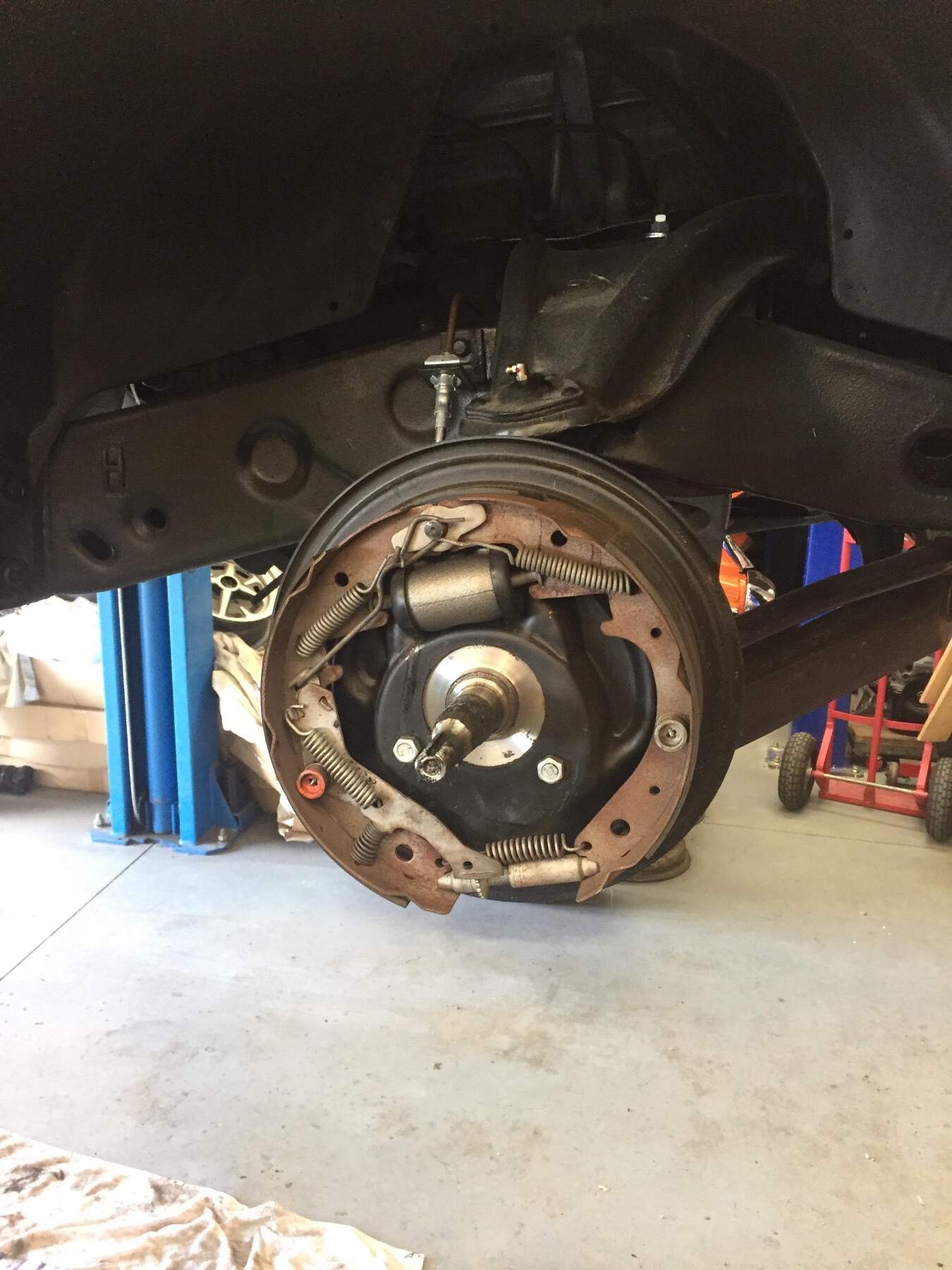

Now that the 64 can’t move and is on the hoistΒ
it’s time to refurb the brake drumsΒ
new shoes and I am going to pull the springs and have them raised justA littleΒ
I feel it’s too lowΒ
new wheel bearings and replace all the brake springsΒ

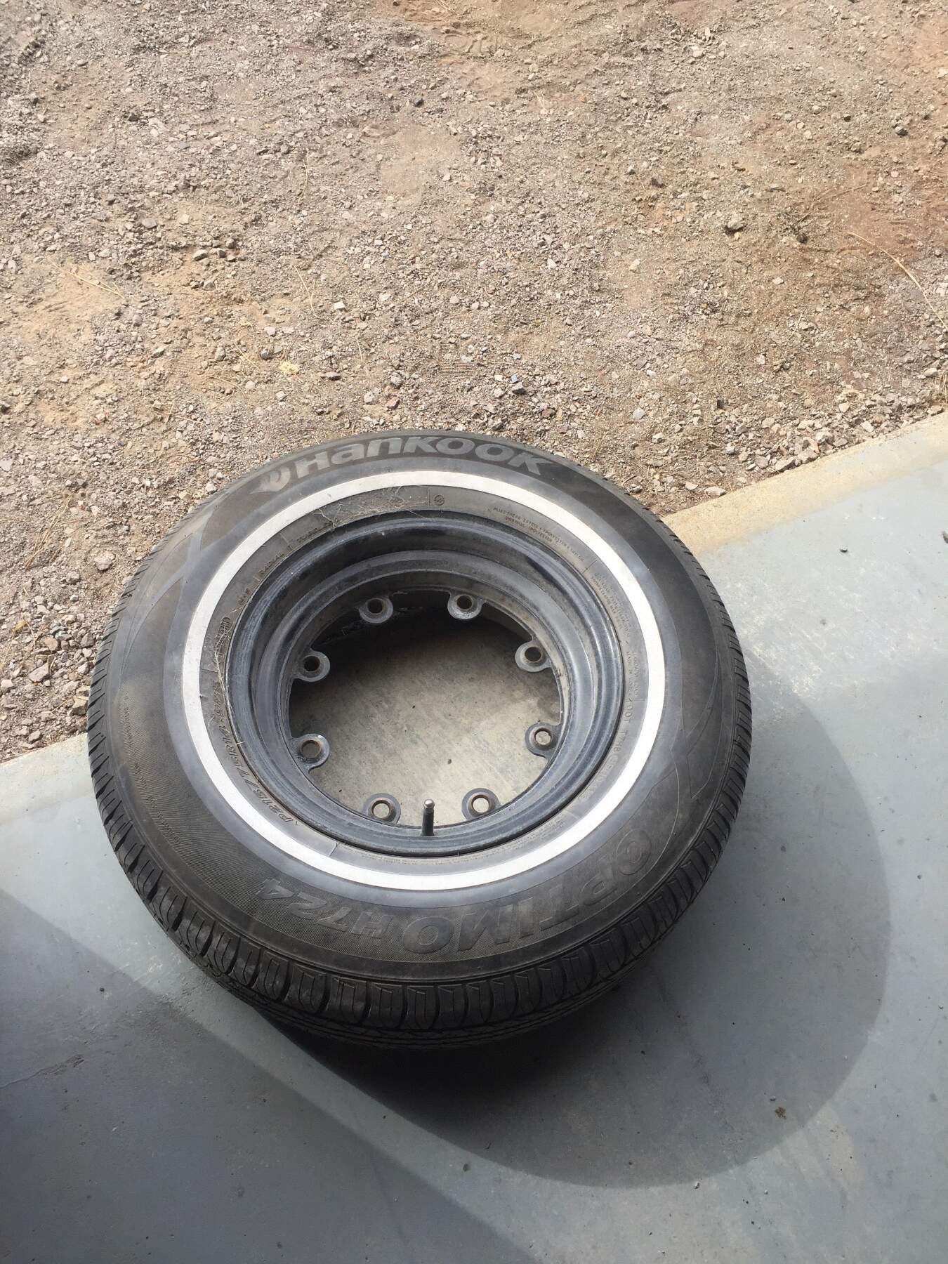

I am holding off refurbing the rims till I get my white walls in FebruaryΒ
Ah too hot again !!!Β
Beer o clock :rofl:🍻🍻🍻🍻🍻🍻

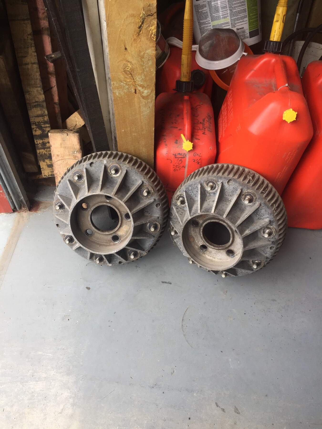

Do you have someone to line the brake drums?
