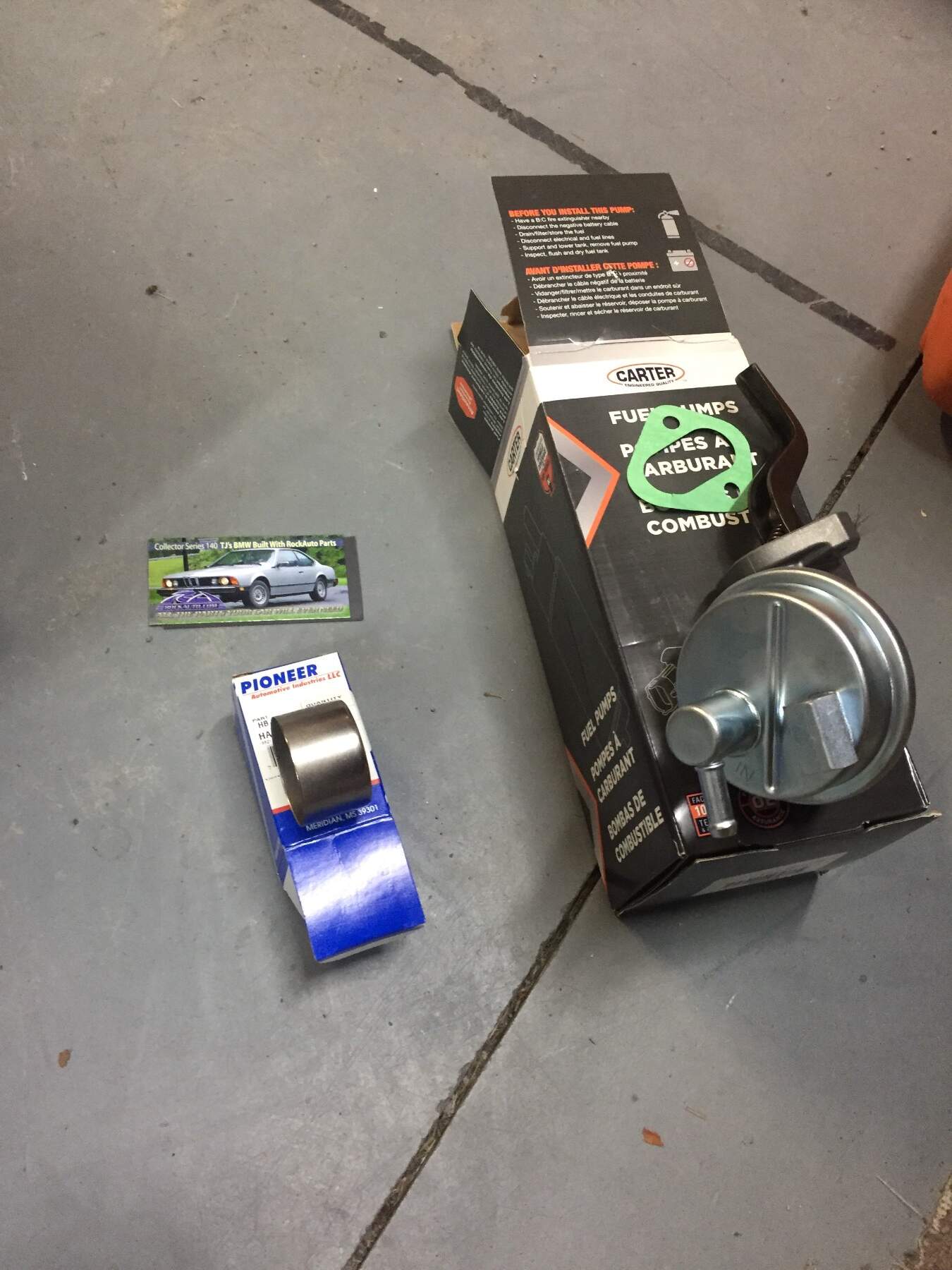

i am waiting on my rockauto balancer sleeve order!!! ( thank you to Fitzy) if that turns up i can pull the front off the engine and get the new seal in and test drive her to ensure the front seal leak is sorted before she goes on the hoist and i pull the jetaway!!

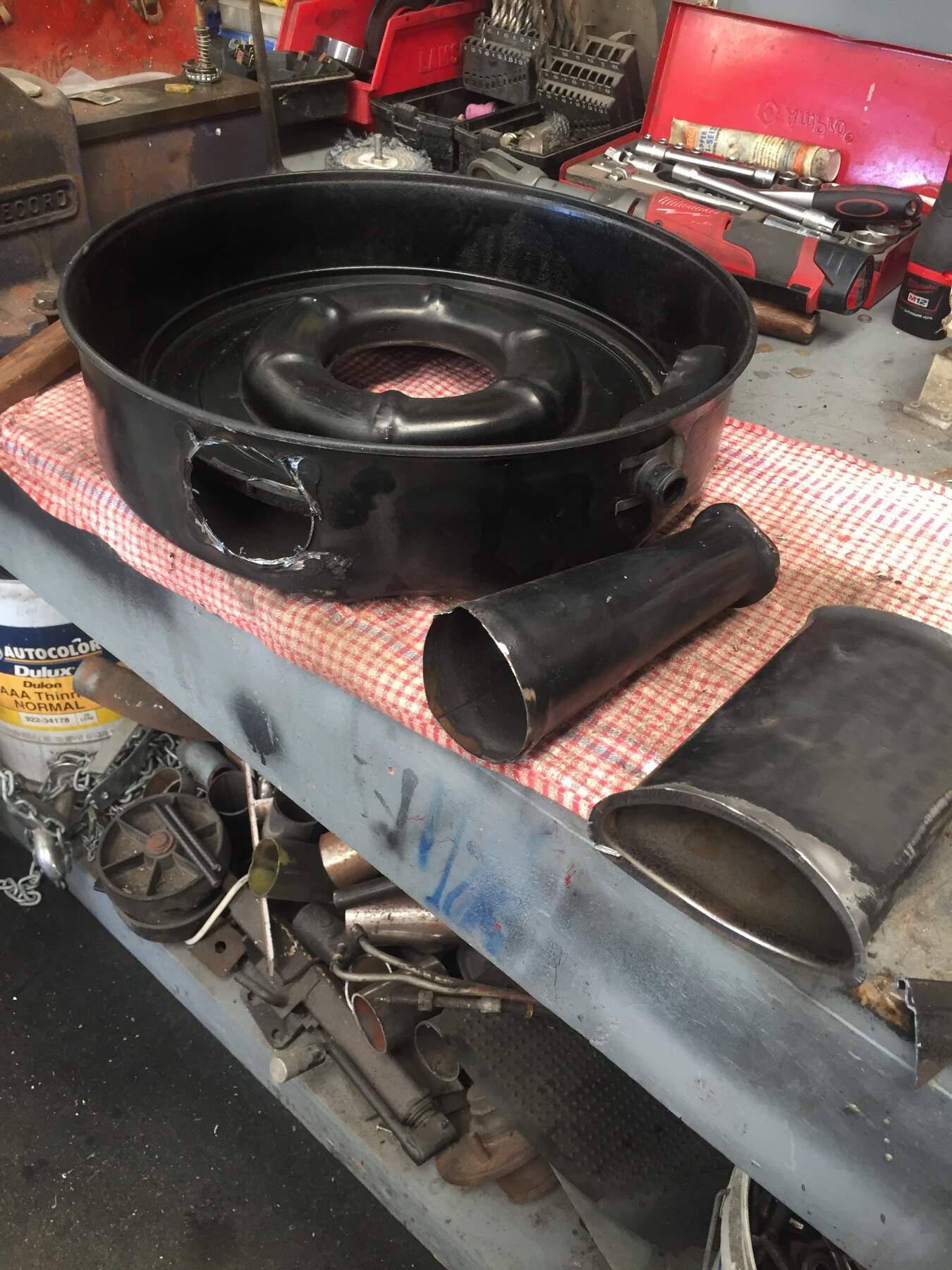

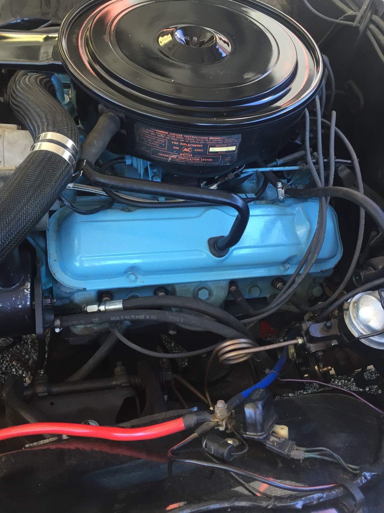

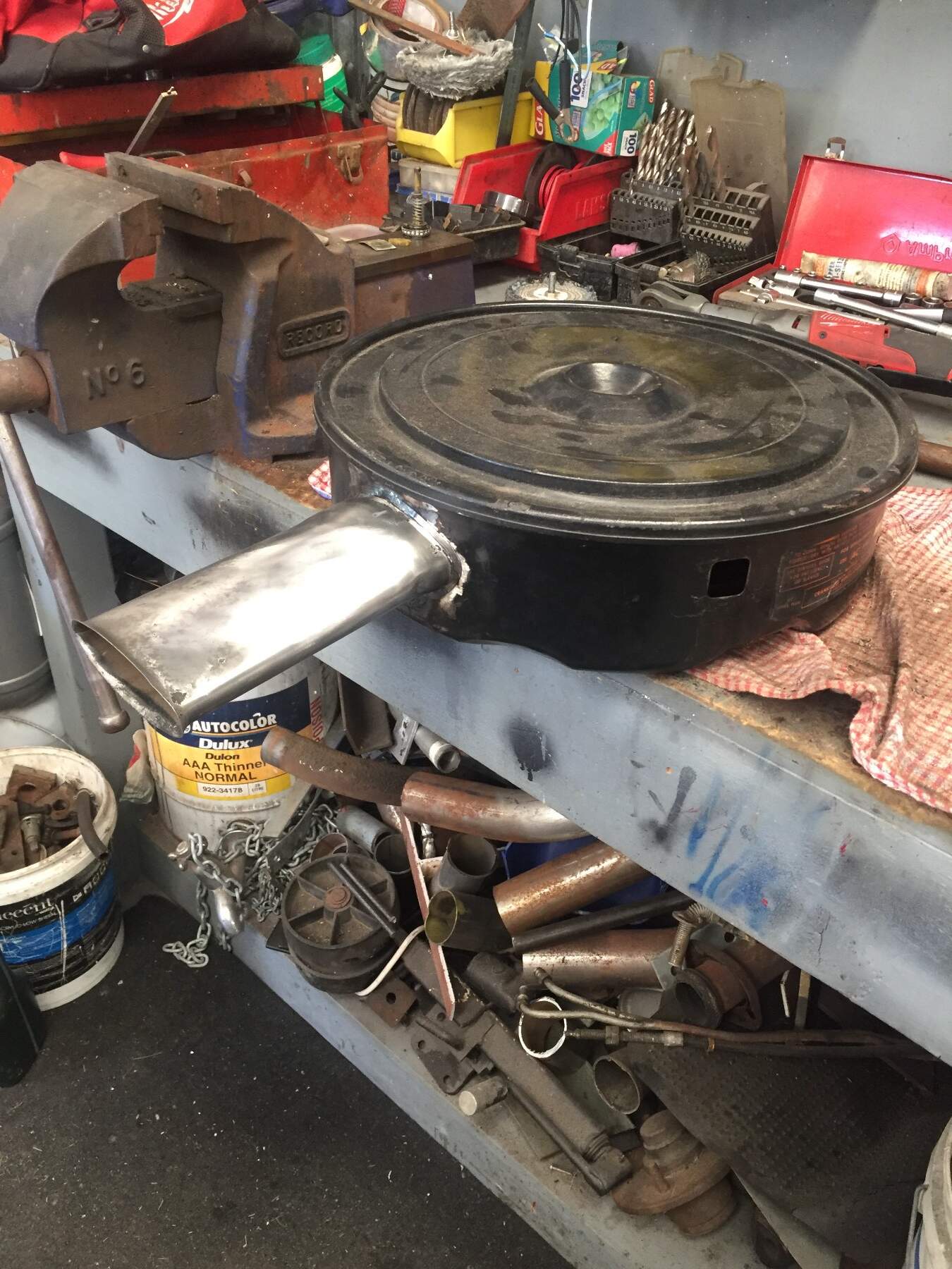

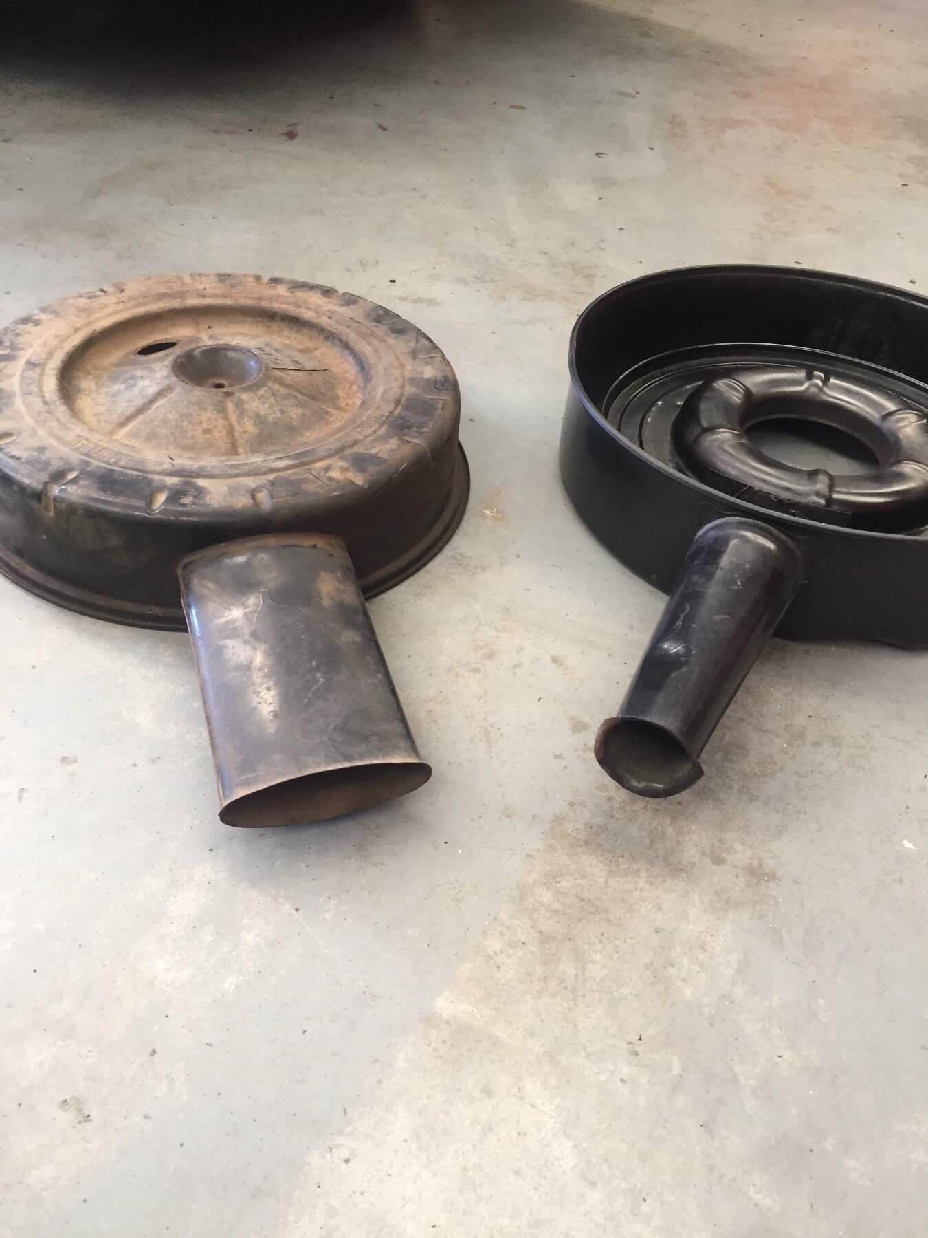

A little while back i posted a picture of a 61 ventura 2 barrel air cleaner i won for a dollar on a auction site. Today when i got home i thought it was time to show you all what i was going to do with it... the pictures pretty much explain my idea!! :rofl: and took about an hour to make the modification:cheers: which was great, its 38 c here and its got to be beer o clock!! blood heat!!!
 oh JustA6 will relate to this ! my hay contractor guy hasnt turned up yet!! i have 2 paddocks full of clover and rye, waiting to be bailed!!, i dont need any, as i have most of my hay from last year but my mate next door wants to buy the lot!
i had a 42mm diameter air intake and now i have a 100x30mm oval air intake... it must help with air flow!!... but keep it looking stock-ish :cheers:
 bit of prep and black paint tomorrow and it will be done... thought i might get a new decal for it off pontiworld for it,:dancingpontiac:

My stock air cleaner is the same as your 2$ air cleaner and is also for a 2bbl, i was hoping to find another base or modify mine for a 4 bbl. I guess i have to go to some swap meets and look around, don't even know if there is a 4bbl version of that style, may have to do what you did but cut the bottom part out and replace it instead.   It's 5C here in Socal this morning.

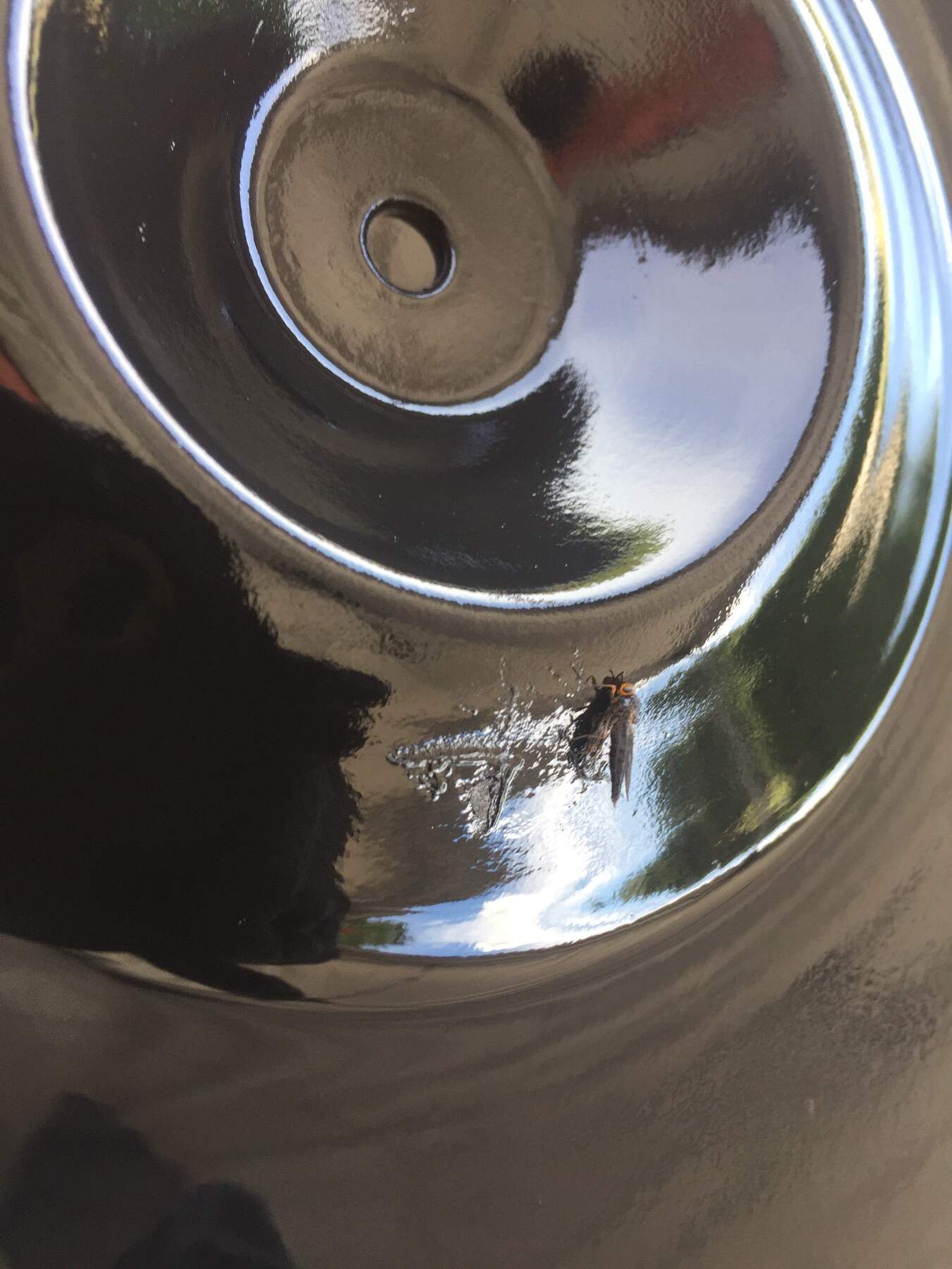

2 hours of sand blasting, sanding priming and the very first coat of top coat ..... and there always has to be a bug land on your perfect paint !!!!! 😡😡😡😡😡😡😡😡😡😡
now i have to leave it till its dry and colour sand it flat...!!!! a word comes to mind!!!!! starts with F !!

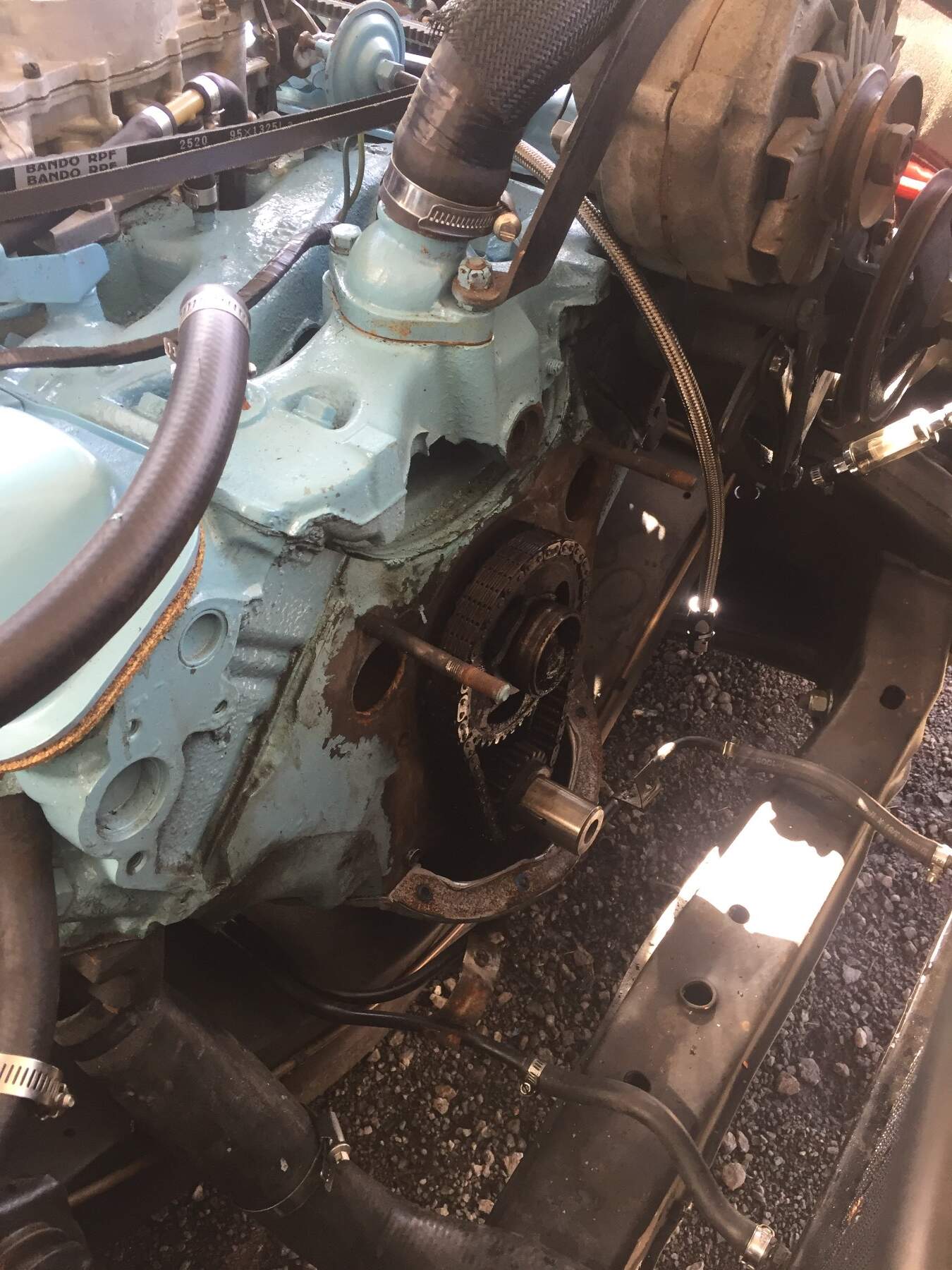

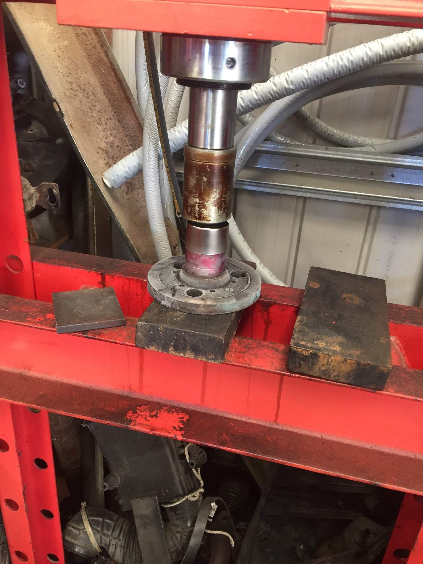

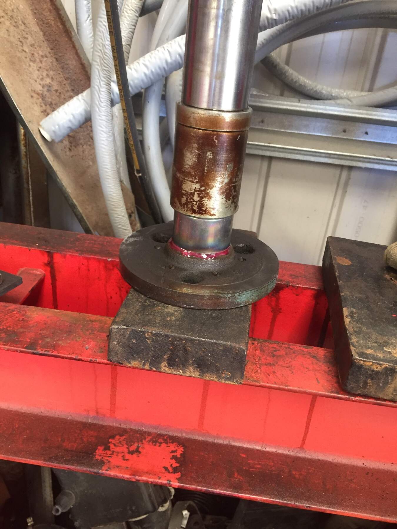

Pulled the balancer off and stuck it in the freezer for a hour
set the balancer in the press heated the sleeve up , smeared the old face with permatex red and pressed it on !
Very simple 👍👍👍👍

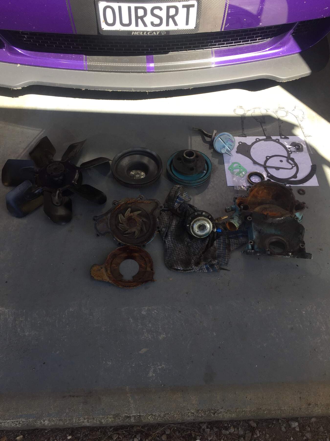

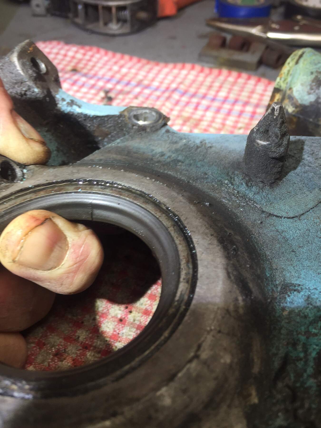

Once I did that it was all go to remove the water pump and timing cover
you can see the crack in the seal 👍👍👍

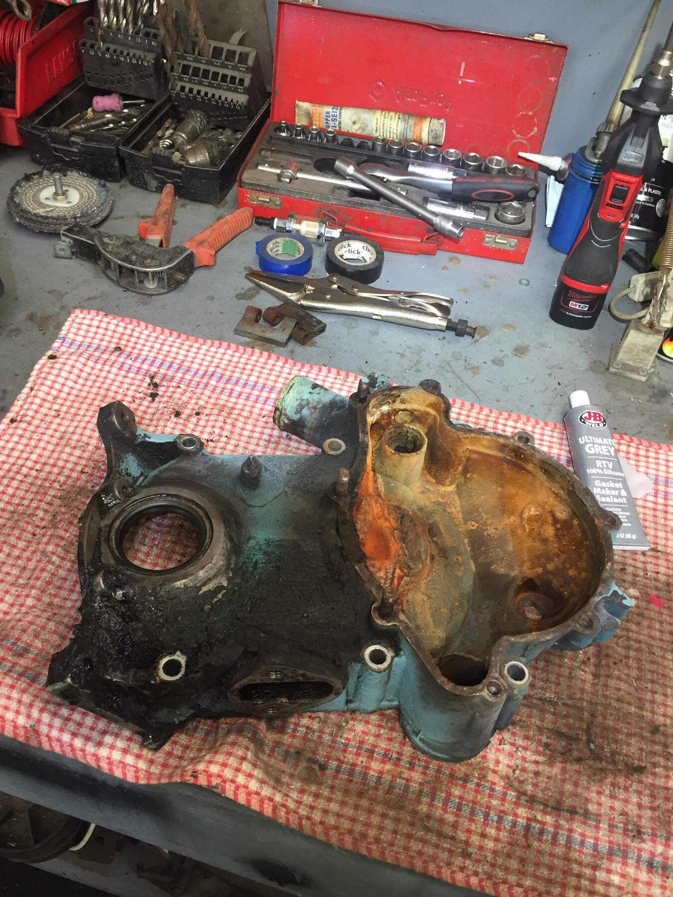

It’s getting too hot to work so I have stuck the timing cover in some degreaser  for the night and tomorrow when it’s cooler I will clean all the surfaces up and press the new seal into the cover

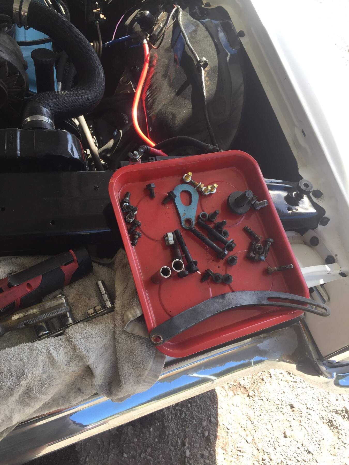

Gota love the magnetic tray 👍👍👍
Lookin good brother. Your making it look way to easy man. lol

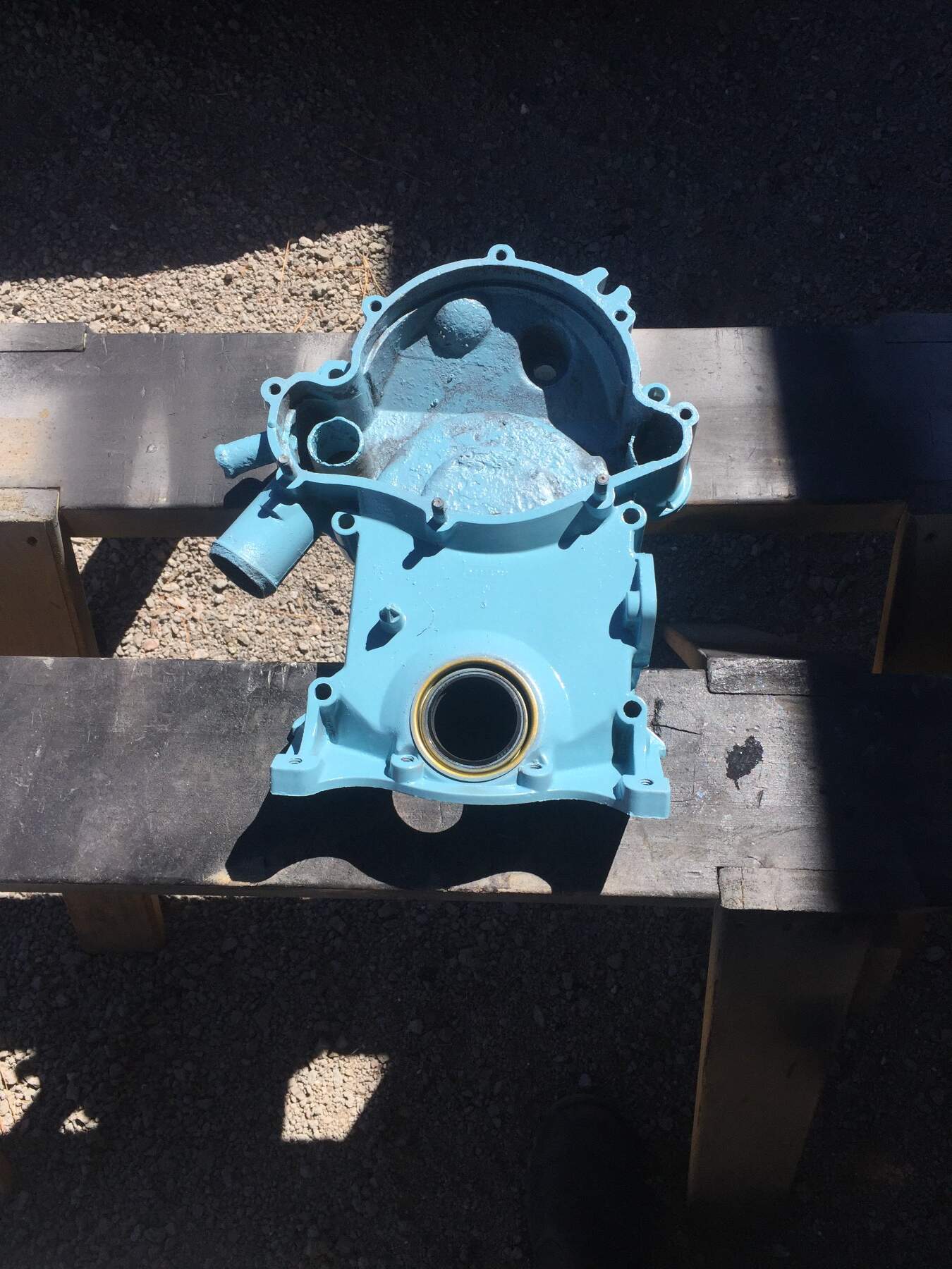

cleaned up the timing cover , painted it and pressed in the new seal
reinstalled everything with new gasket and noted the torque settings

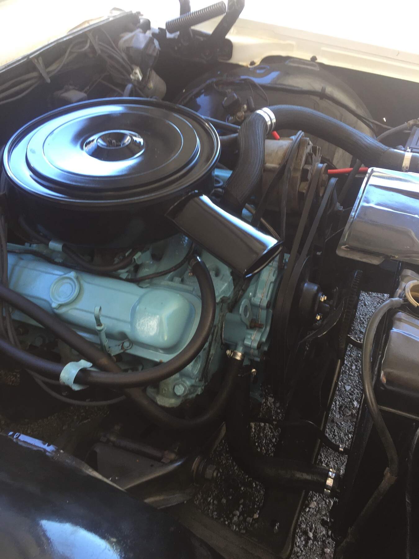

and all done along with a second go at painting the air cleaner.... not bugs embedded in my paint today!!! gees that pst me off yesterday! mind you i was tired too:stars:

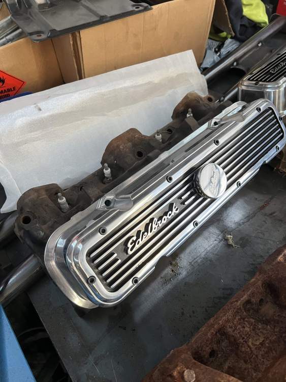

note to Fitzy and Frosty, i reversed my driver side valve cover, and the factory breather fits way better!!!:cheers:

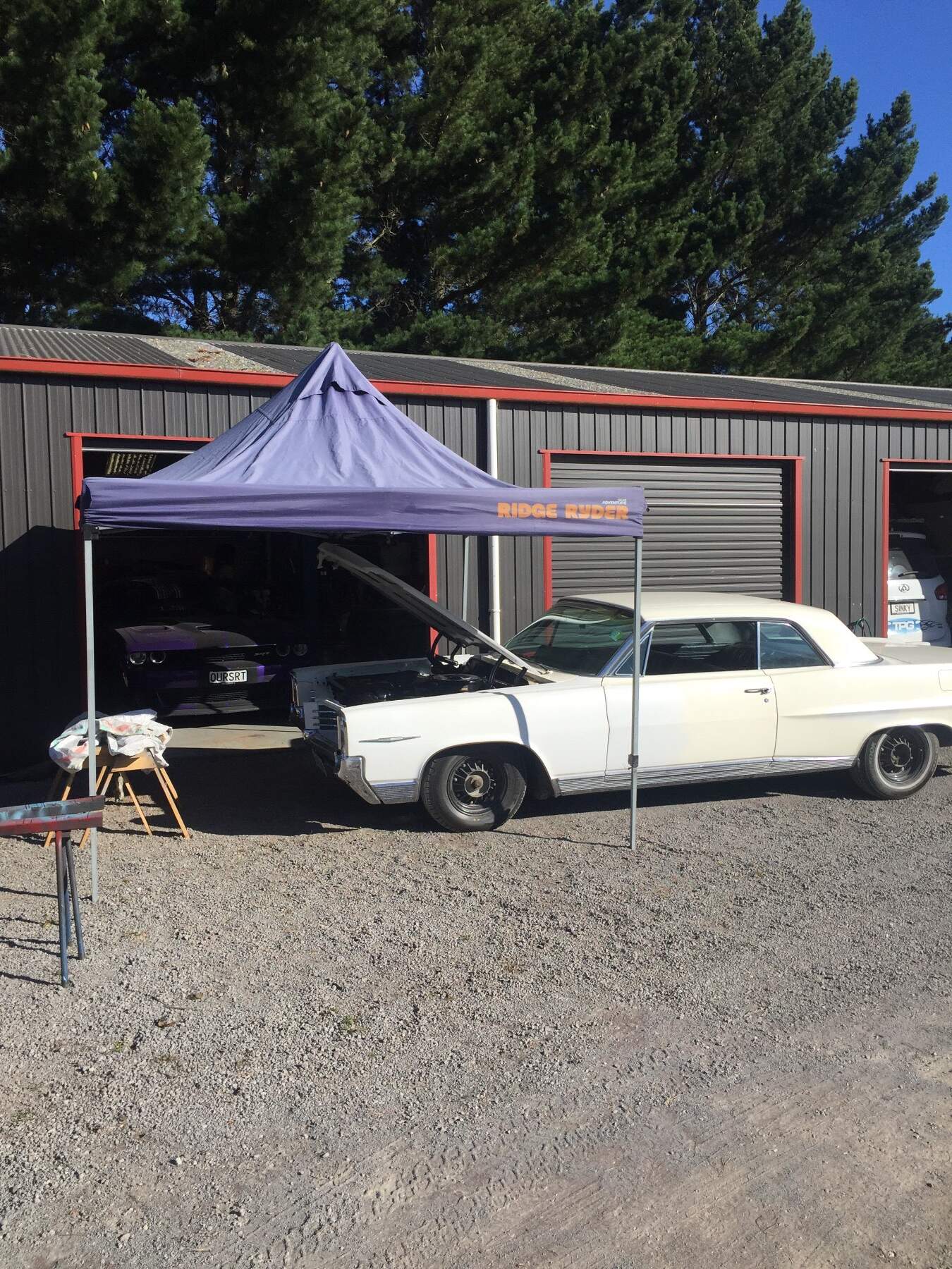

and yet another day where i have to stop working, it is 38 c here again, i have moved out of the workshop and under a pop up where i can get a bit of breeze !! but its crazy hot

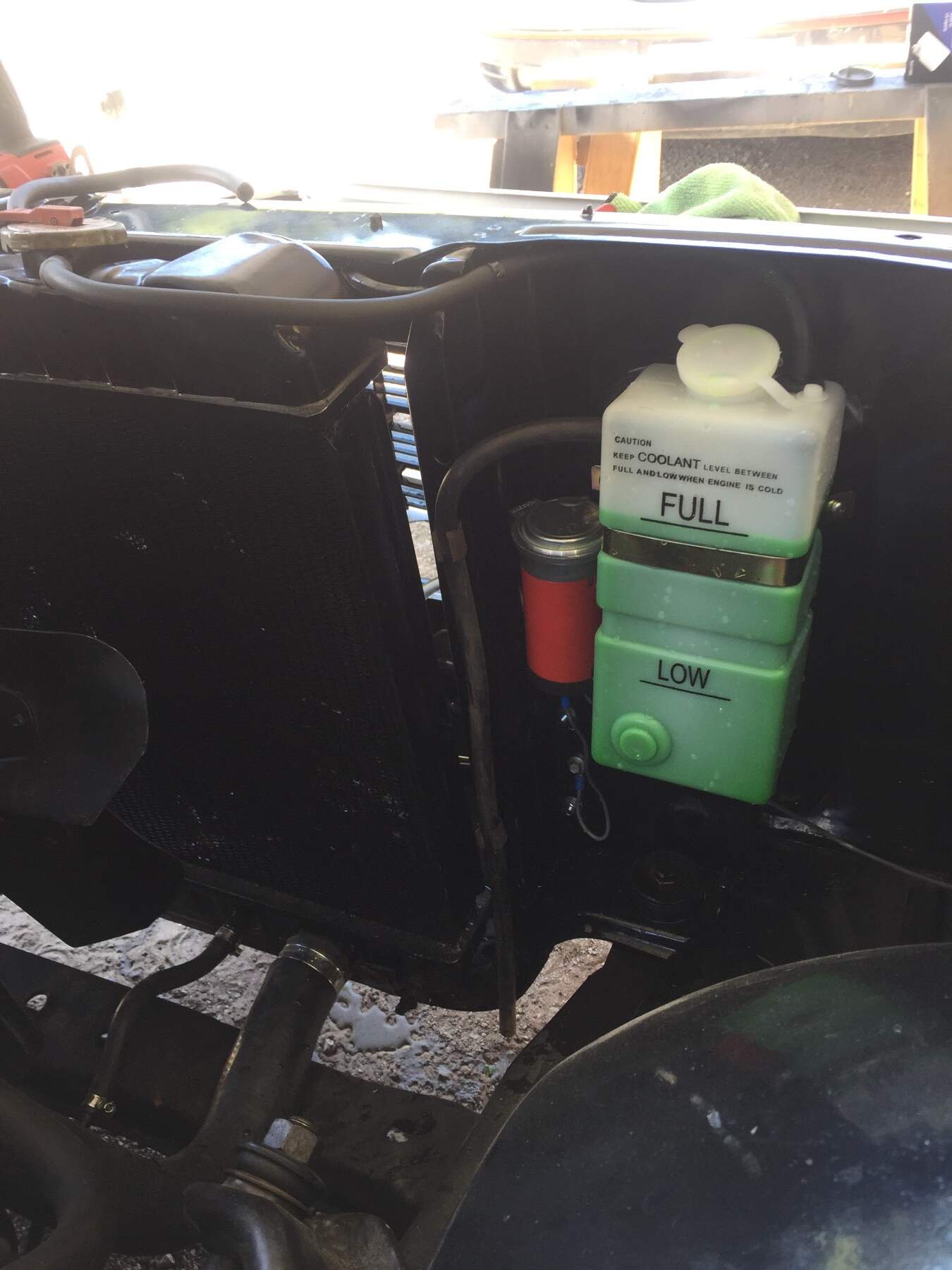

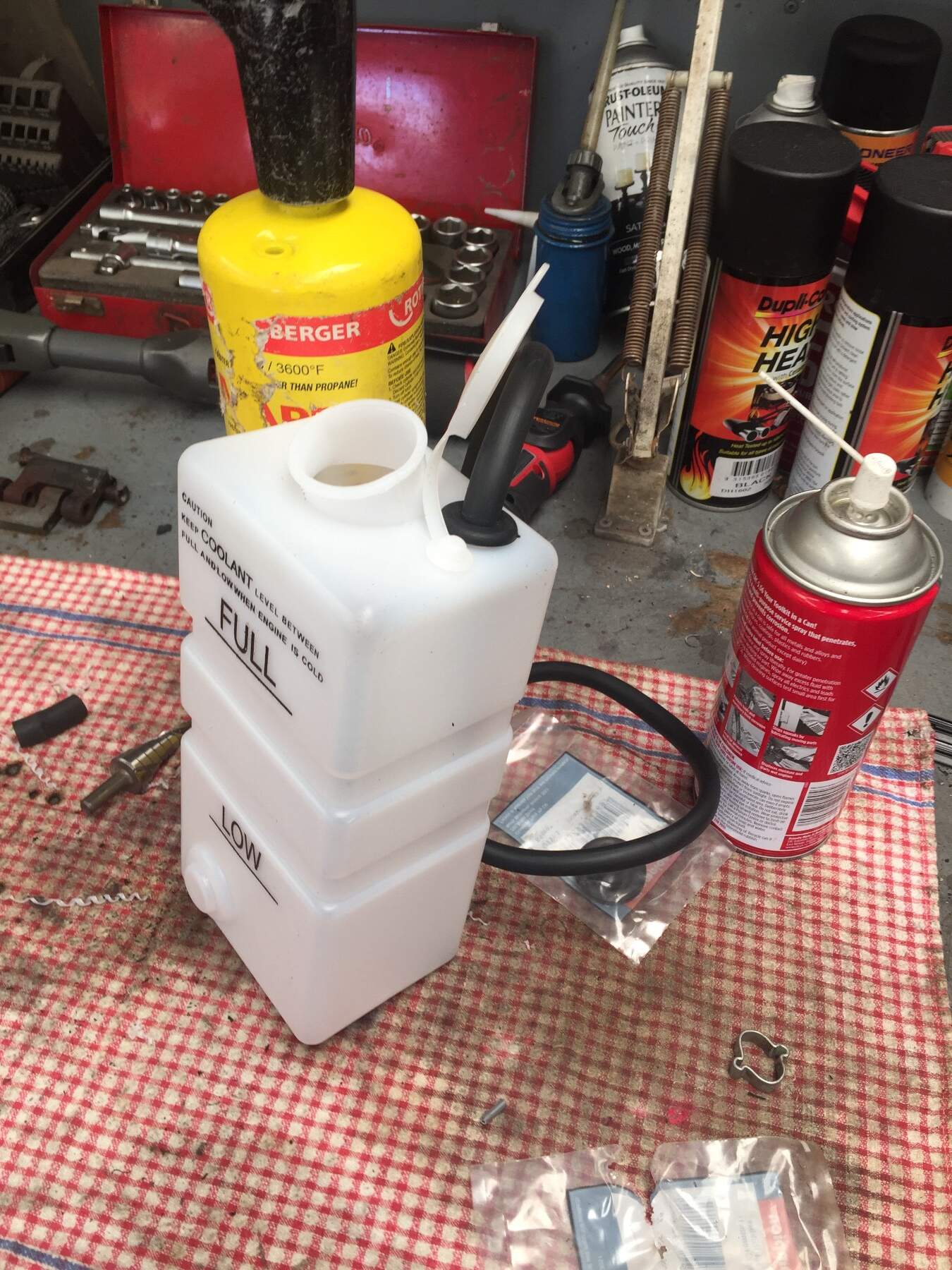

today was radiator bottle installation .... yes 64 never had a recovery system , yet I wanted to do it .....
Hey Kiwi - I'm now laying awake at 3am trying to figure my way around all the electrical stuff that will need to be done in order to make the car road legal.
I can't find any info re US style flashing brake lights as rear indicators being legal or not. With your collection of old Yankers, did you ever have an issue?

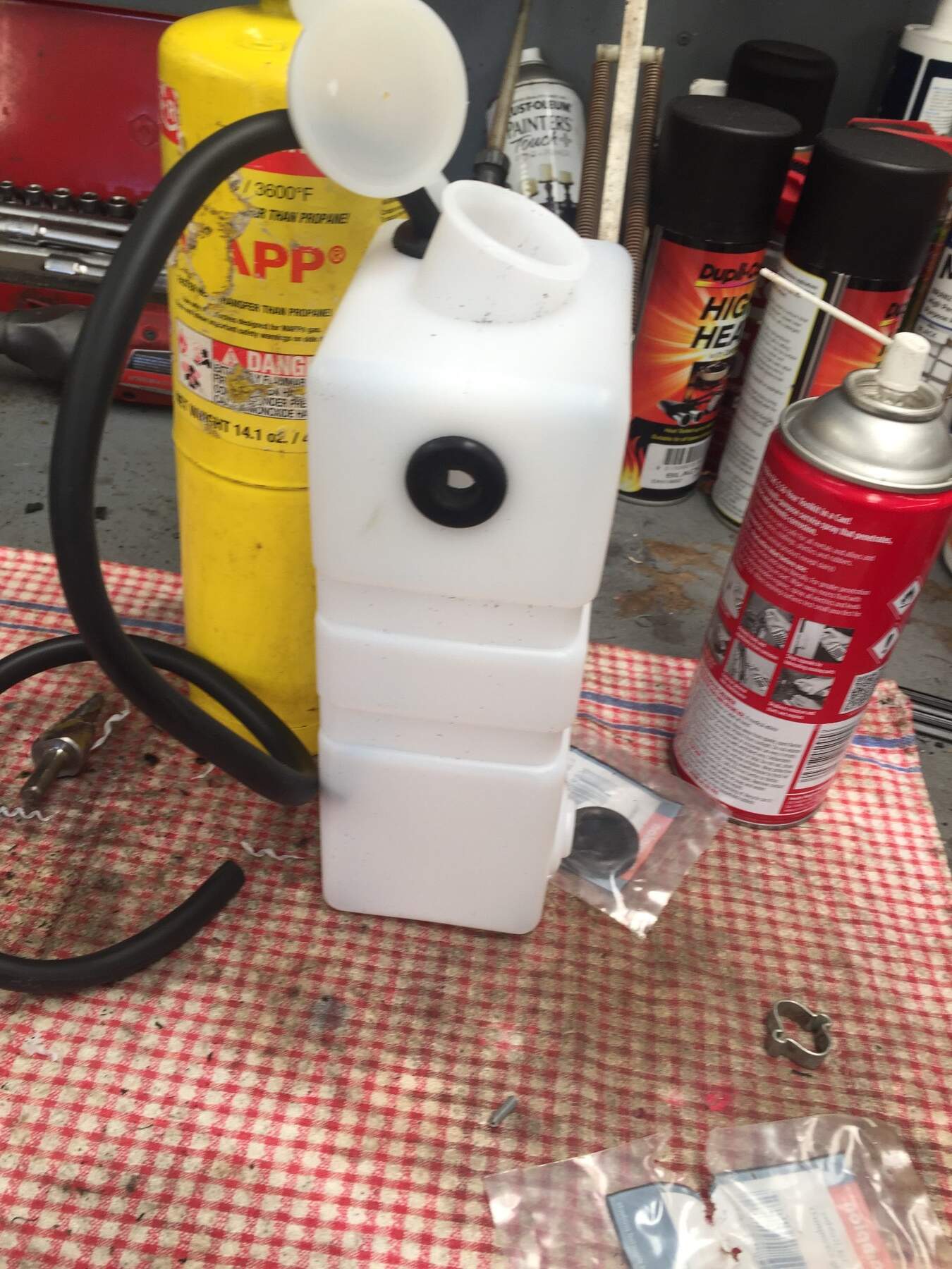

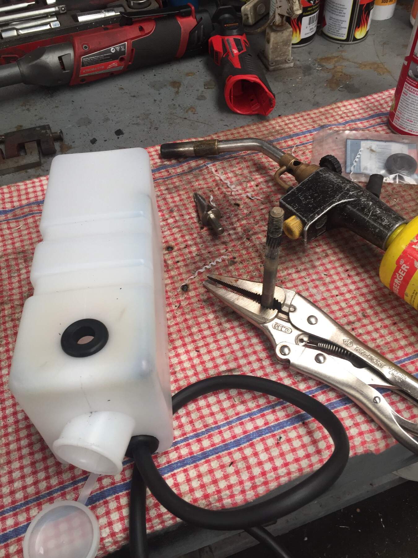

I am using a aftermarket bottle bought from super cheap . But I want it to not only have a feed pipe into the radiator as a recovery tube but I wanted a dump tube too
which. The bottle had no provision for ... I drilled a hole ,fitted a rubber grommet ... and it was too small to fit the tube in so I heated up a bolt and melted the correct size hole I need ... note to anyone trying to open up a rubber seal,,, melt the sucker ... forget trying to use a drill bit !!

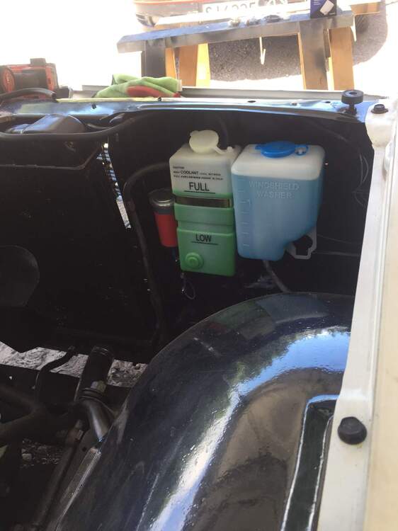

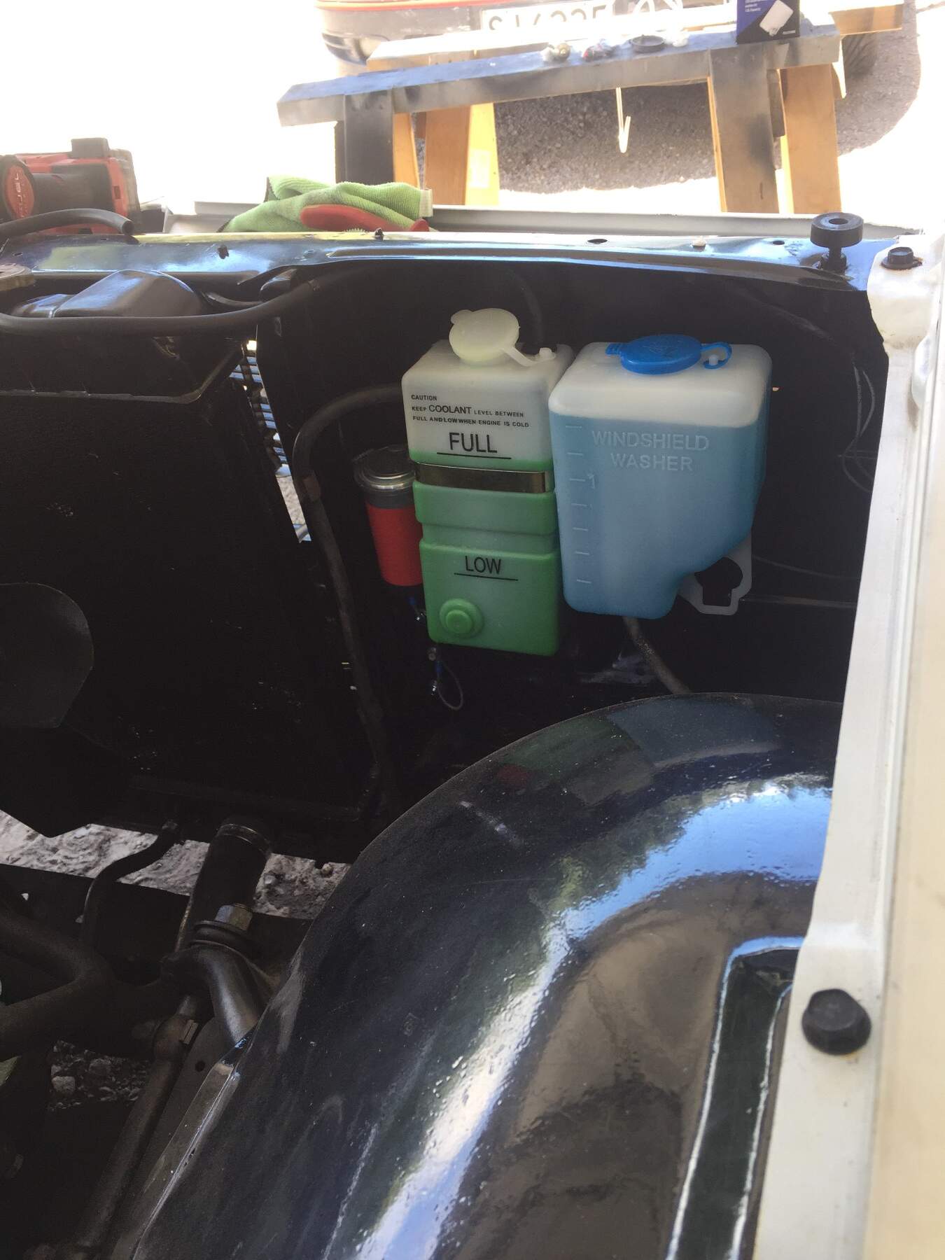

mounted the over flow bottle
Then added a window wash bottle
