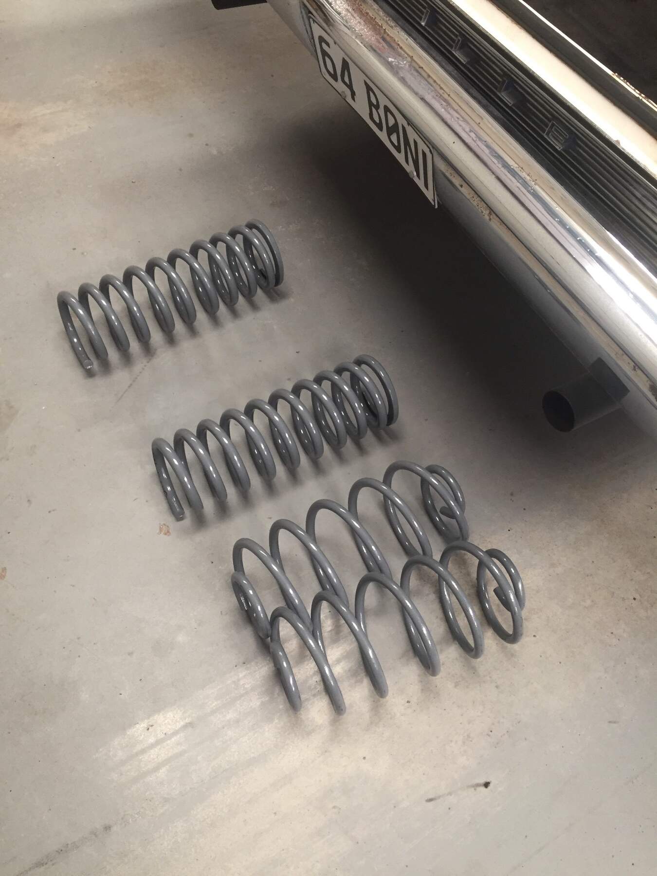

Reset springs back from the spring makersΒ

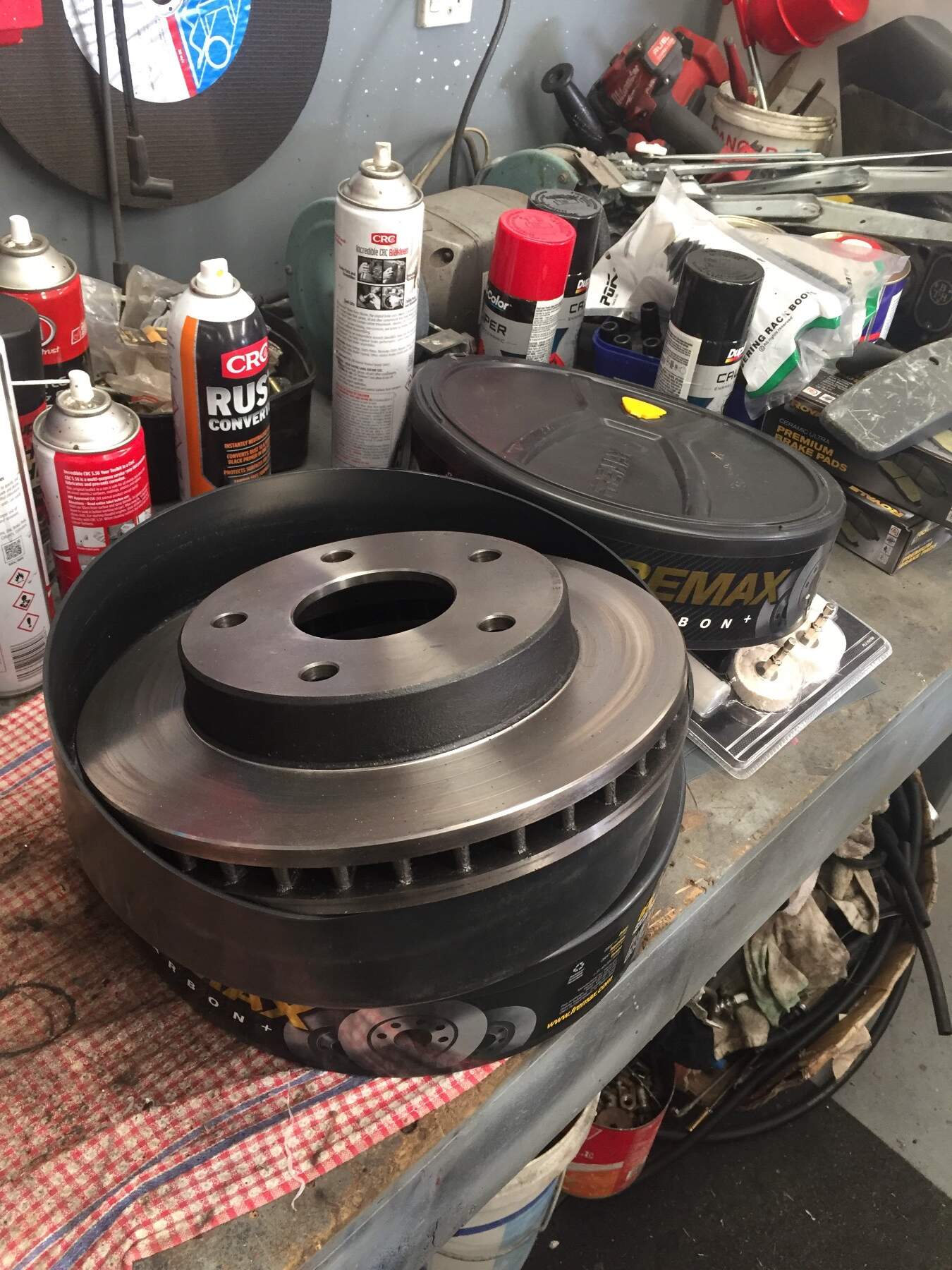

I also have new discs to throw on the ramΒ

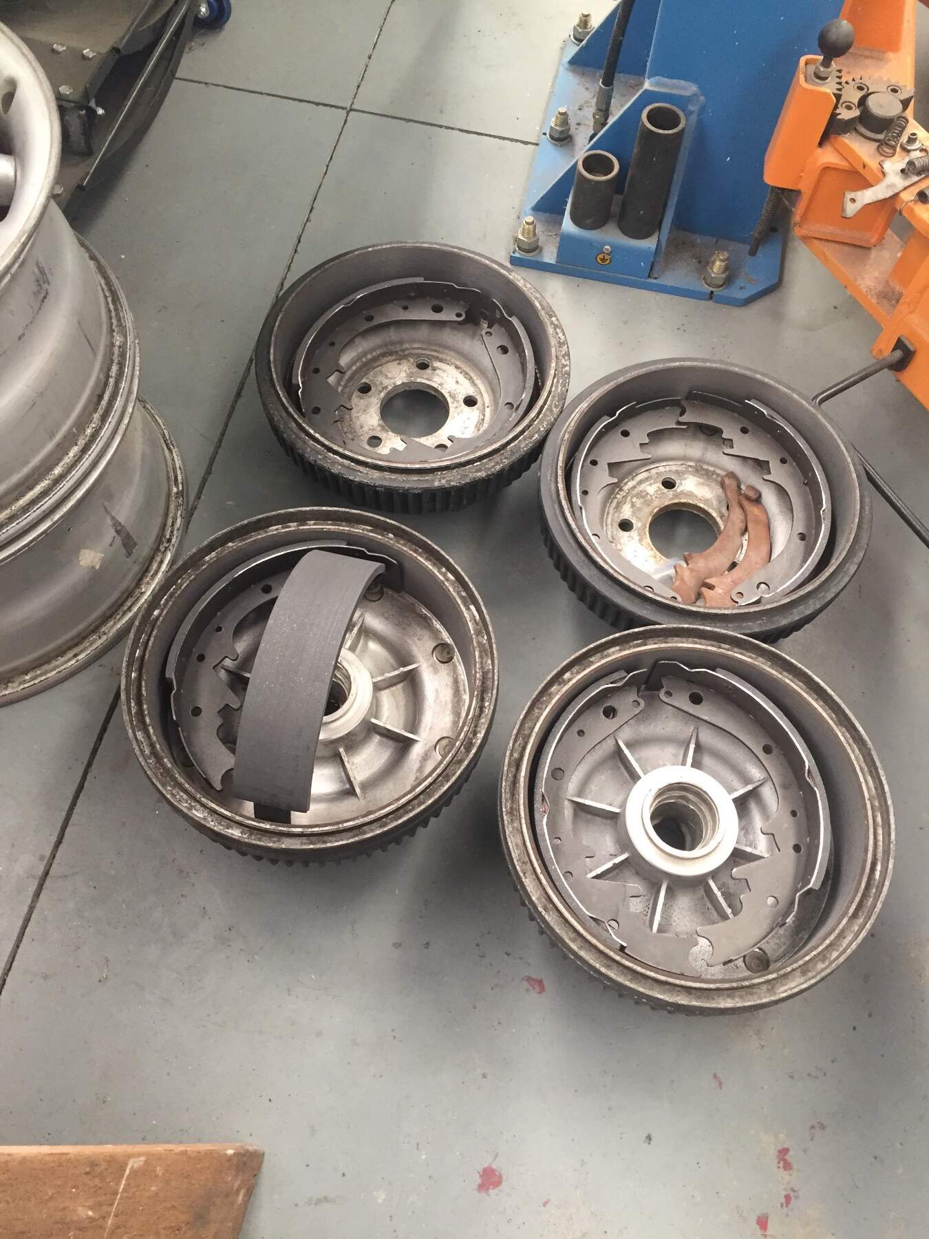

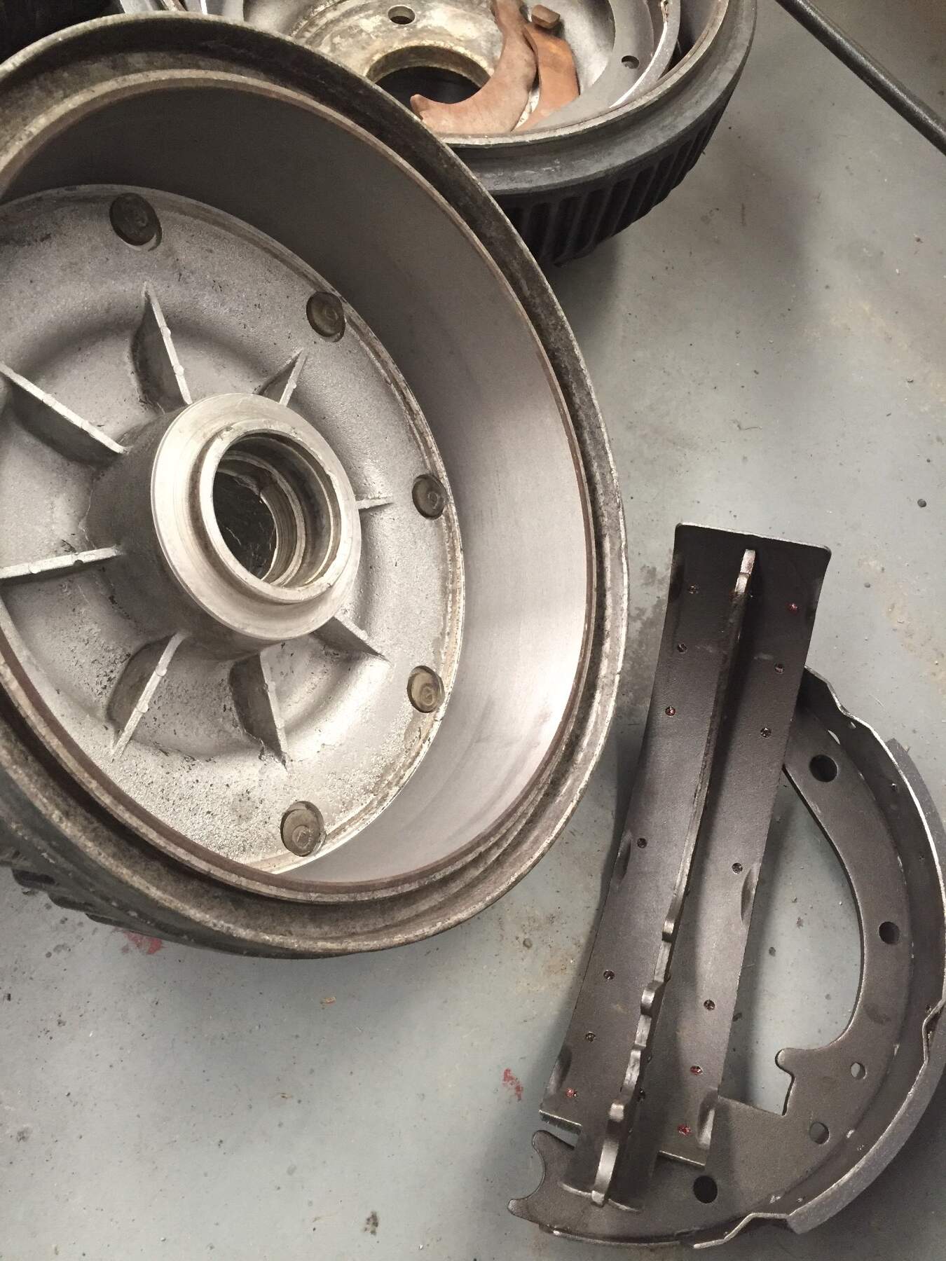

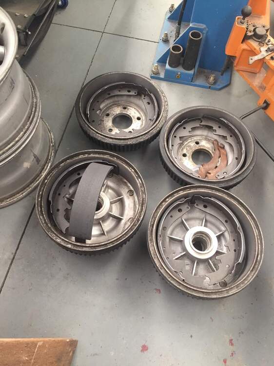

plan is to fit the springs, then assemble the brake linings and trial fit the drums... my brake guy has custom blended each shoe to each drum.... so they contact 100% ... but each shoe has to go in its respective drum.. hence why you can see the shoes sitting in each drum... then i have to check if the linings are too thick to fit the drum over... if they are they need to go back to the brake shop to be milled down a 100th or so !.
Β Then all the drums come off and the fun starts!! i have to blast each of them with the fine glass median. and i have to work out which way is going to work best... paint each drum first then polish up each blade.... ORΒ
polish up each blade THEN paint each drum...
i will test the blades first... kind of hard to explain but... if you look at each of my 8 luggers you will understand what i am banging on about "blades"
Note for Andy.... short contact shoe is called the leading shoe and goes at the front . brake 101 according to my brake guy... who is younger than me!! hahaha ..:cheers:
Nice work fella. You're doing a good methodical job. Did he chamfer the ends of the linings to prevent grabbing & chatter? My brakes are really powerful but they're a bit grabby. One day I'll pull them apart and do what you did: resurface the drums (all my shoes are brand new) but will also chamfer the lining edges. Probably a good time to clean up the rusted 'never work' adjusters to make future adjustments a little easier too.
I don't know about you but I bought a generic brake shoe adjustment tool (like a bent screwdriver) but of course, Pontiacs are a bit special and it was never going to work. I caved in and bought a Pontiac specific one from Ames and it works a treat. I recommend one if you're running out of swear words as you try and make something else fit!
no mate i am not touching the shoes as they are true to the machined drums... if anything goes wrong i can blame my mate at the brake shop!! hahaha.....

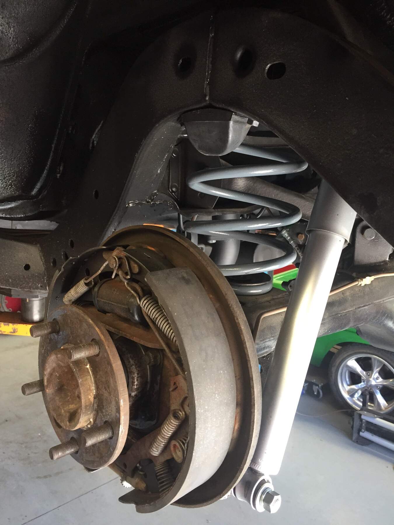

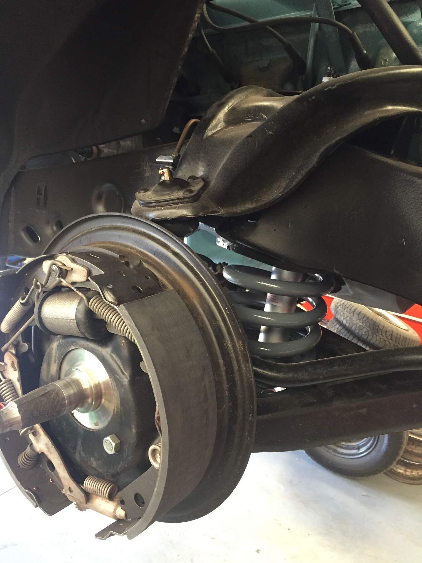

Today was all about getting chores done then hitting the installation of theΒ  springs and brakes ...Β

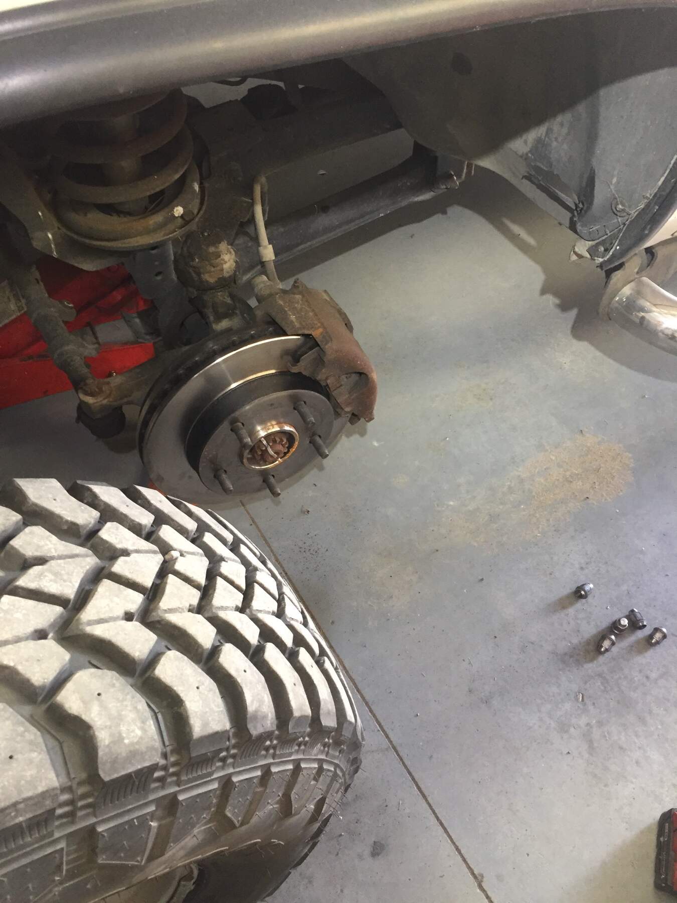

first job, stick new disc on the ram ,,,,Β
Box tickedΒ :rofl:

springs back inΒ
assemble all the brake linings in their respective locations ....

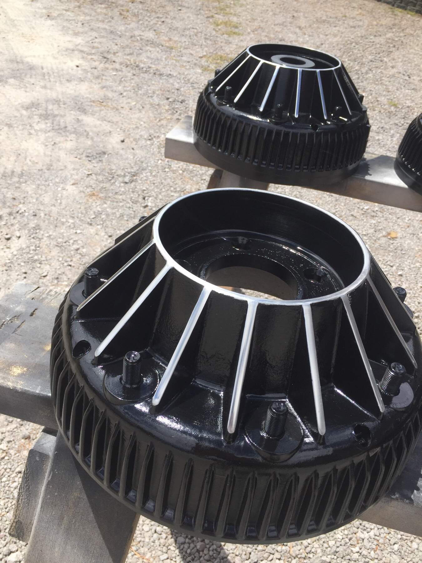

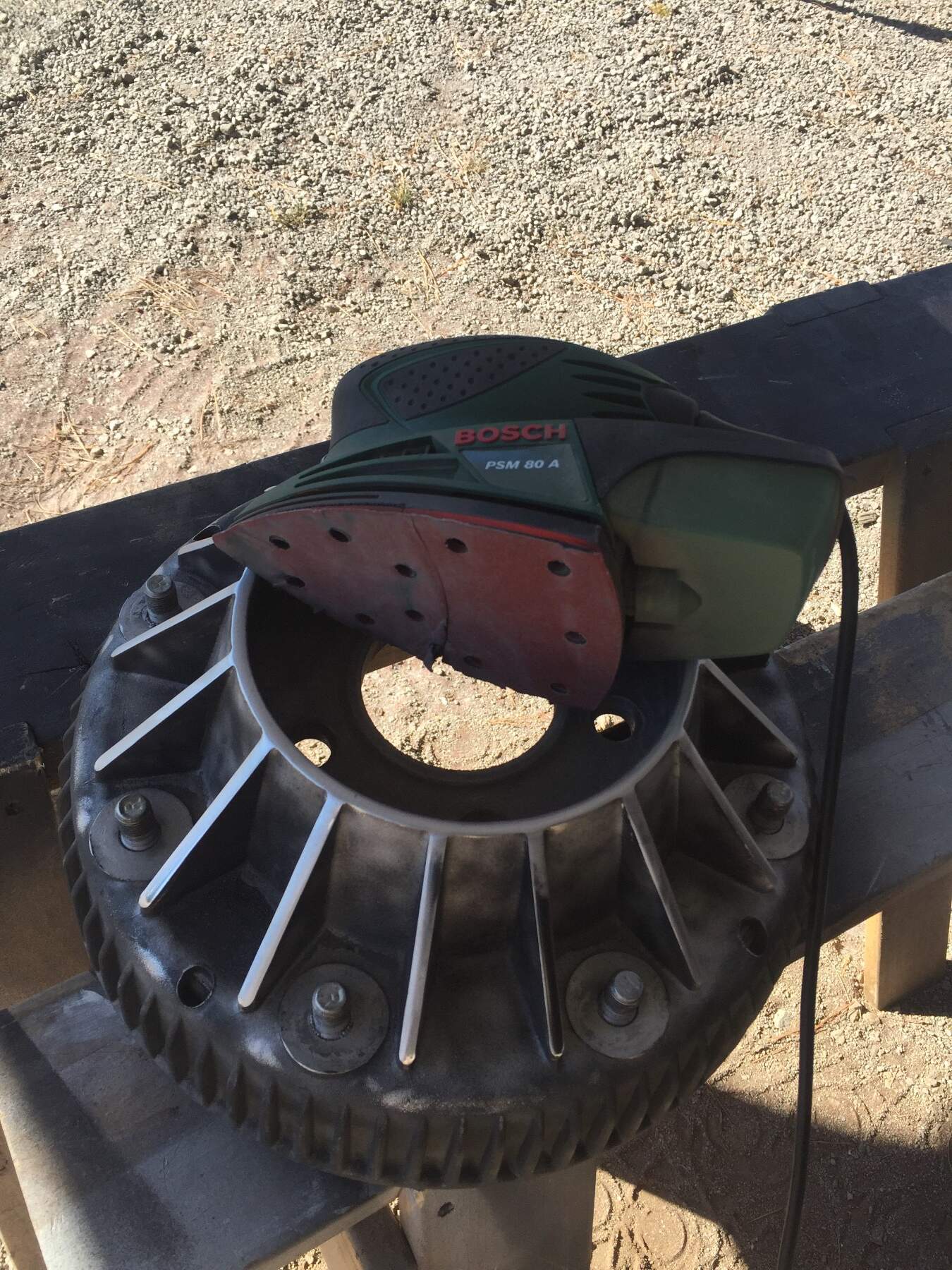

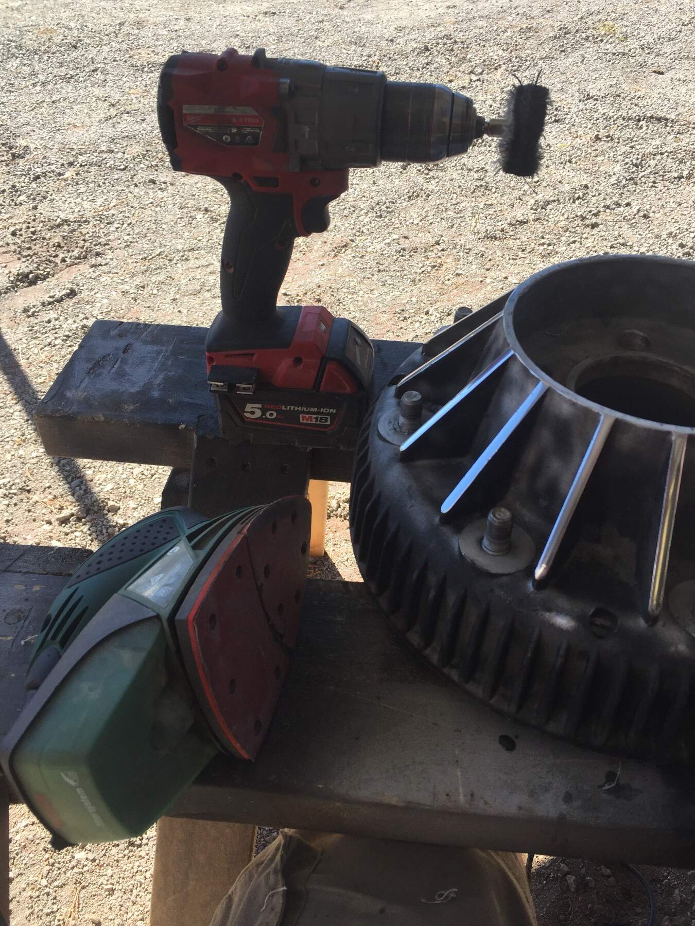

I started sand blasting the drums with this super fine glass media ... worked greatΒ
but super slow !Β
Β
I quickly worked out that I did not need to be so soft in my approach !!
and found the best results came from Β my small Bosch sander with 180 gritΒ
then 400 wet then 1500 wetΒ
followed by a buffing wheel !!!Β
... tomorrow I can show some resultsΒ

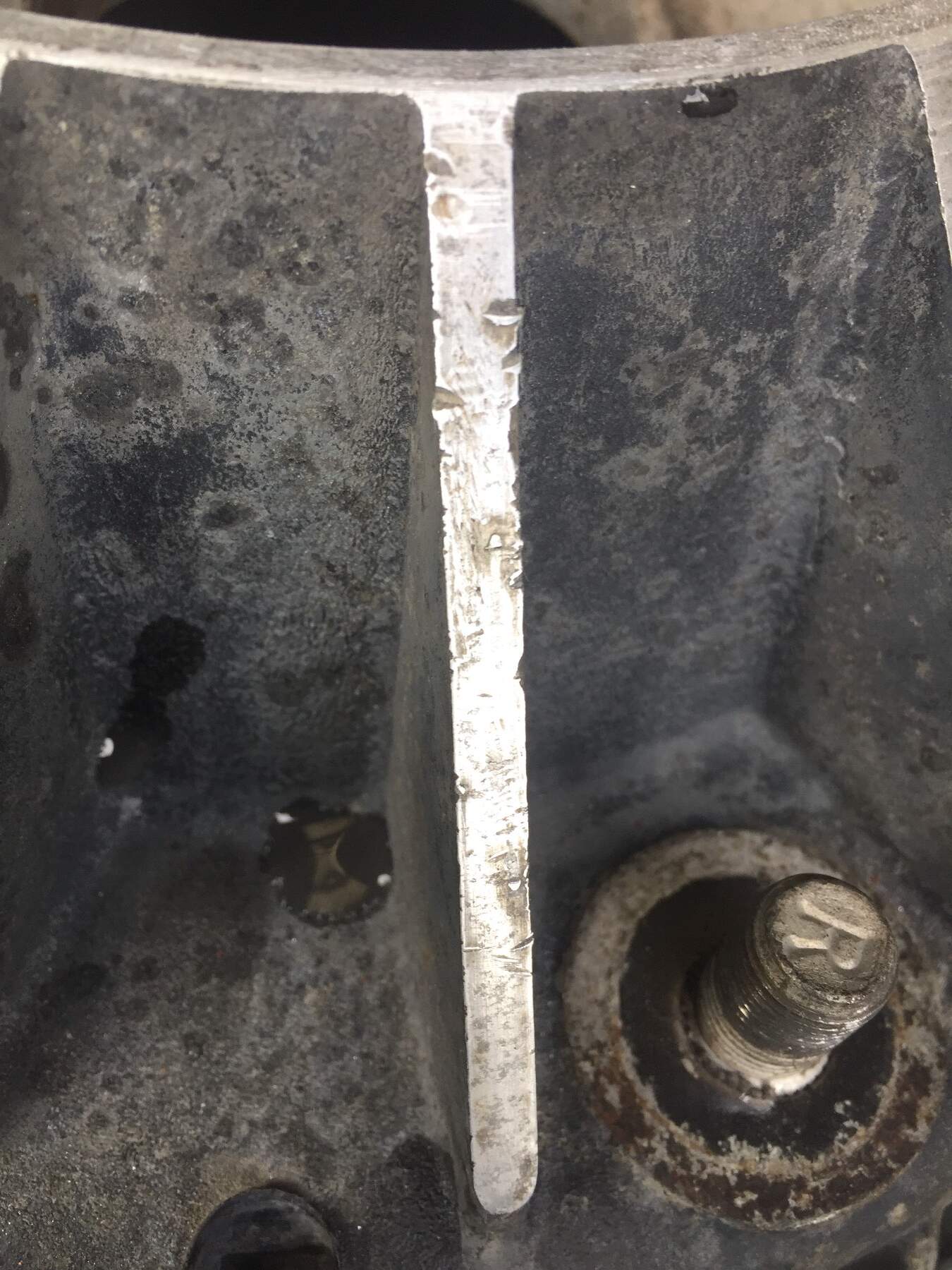

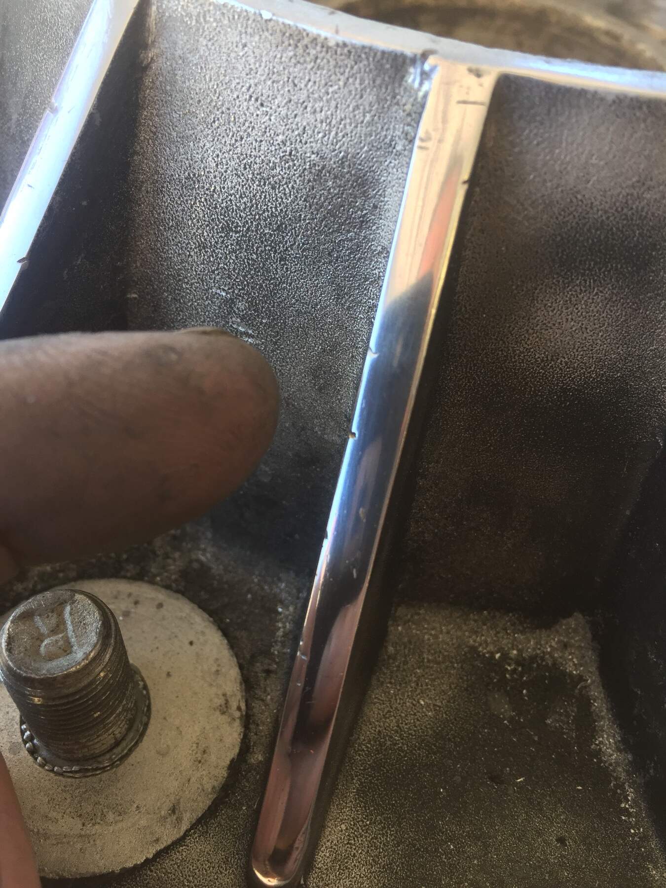

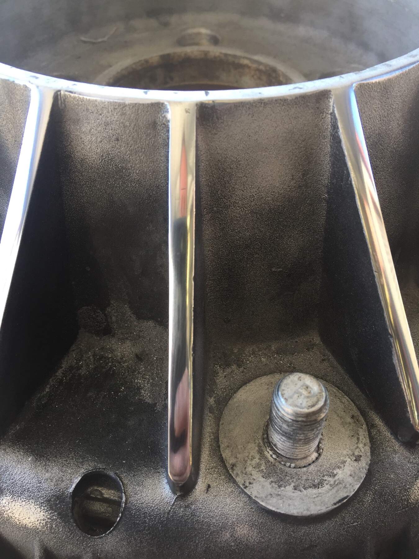

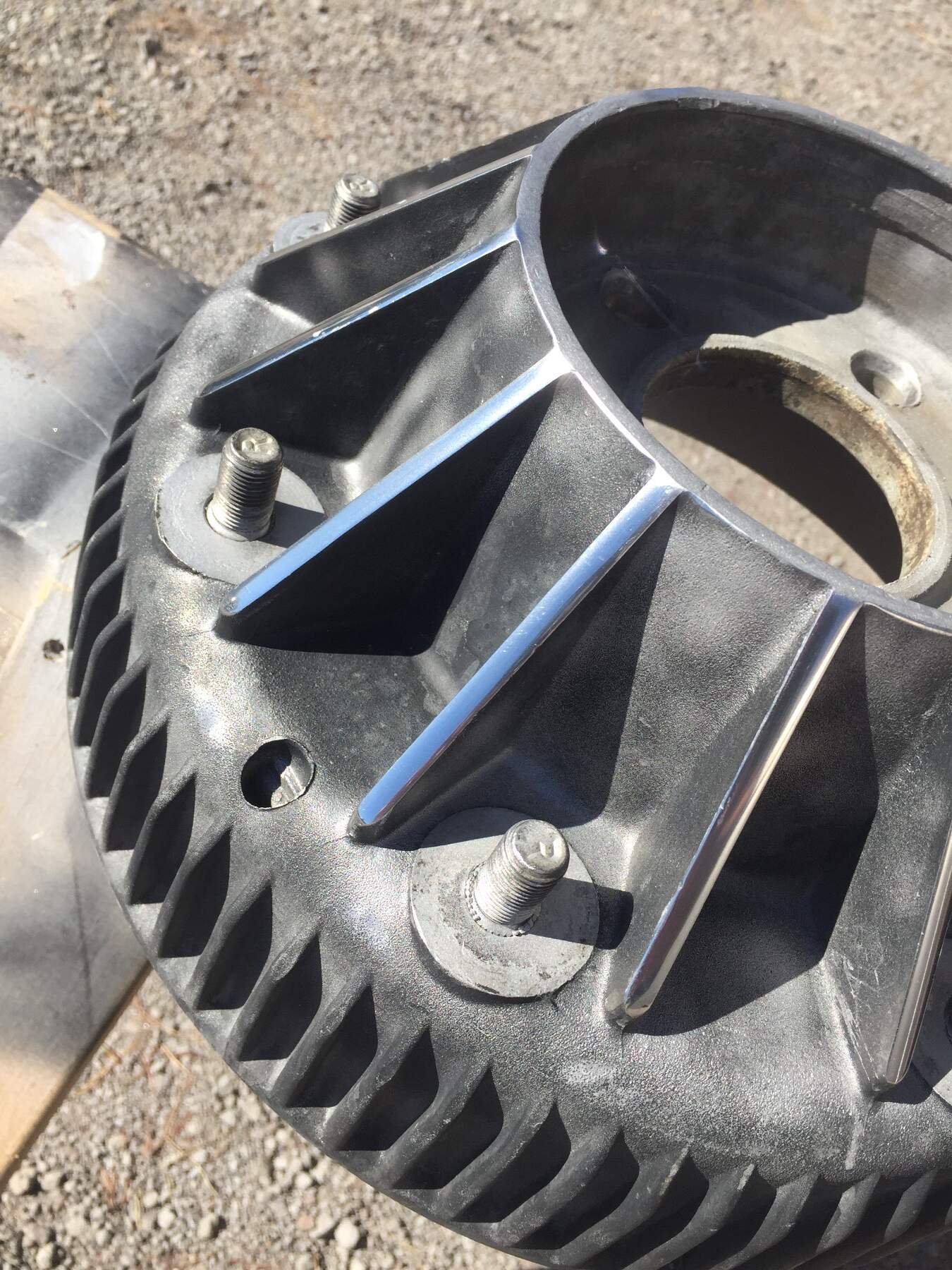

here you can see all the nicks and marks showing.... not happy with this....
so here i started using the 180 grit on the sander.... and blended all those marks out..
my first attempt left all the years of small marks in each blade as i cleaned them up....you can see them in the first picture above...
i was not happy with the result.......
but with the sander i was able to blend all the nicks and blemishes... picture number 2 above:cheers:
then the wet sand smoothed everything!!

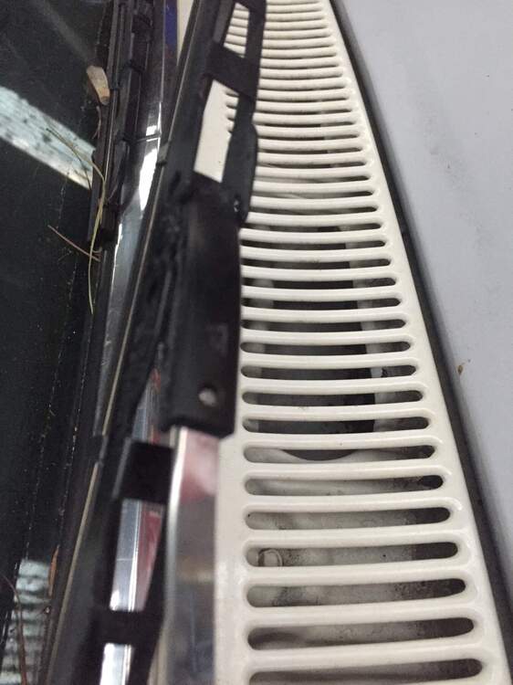

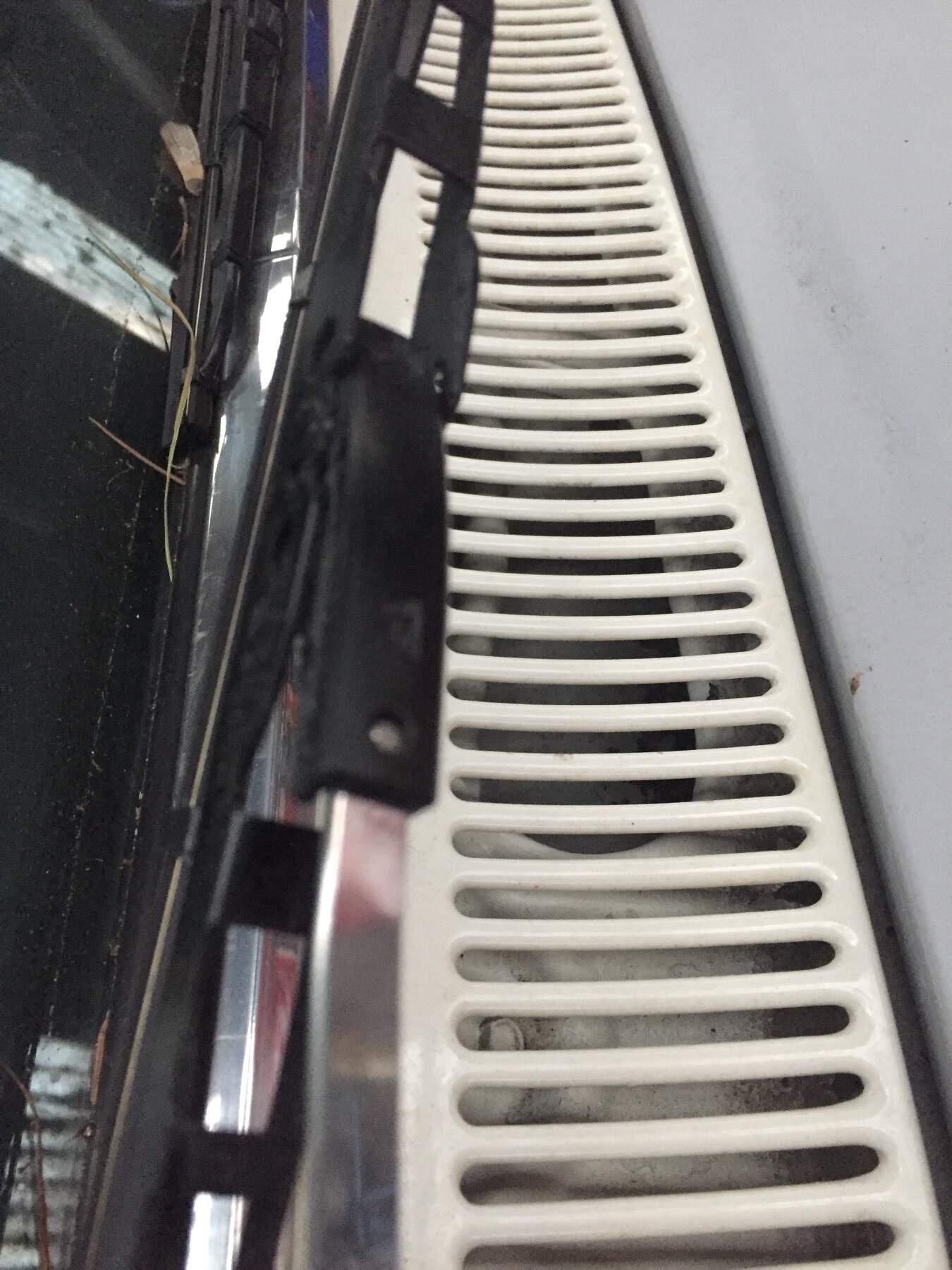

Didn't you paint something before and then used acetone or something to take the paint of the shiny part on the piece? Is that how you are doing this?
16 minutes ago, Andy H said:
You are making a lot of us look bad and lazy πŸ˜† you are getting so much done, nice job.
Yes Andy !!!Β
I repainted the grill sections then wiped each polished bar with acetone .... worked really well. And I think I will try that with these today πŸ‘πŸ‘πŸ‘

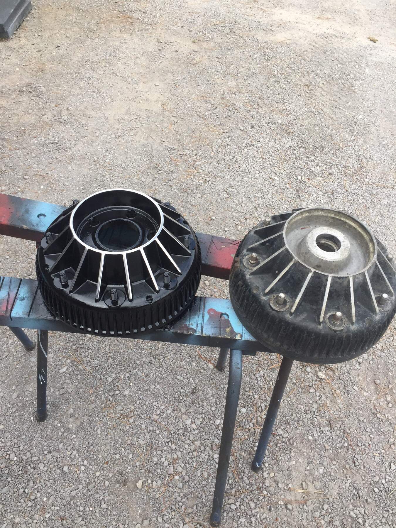

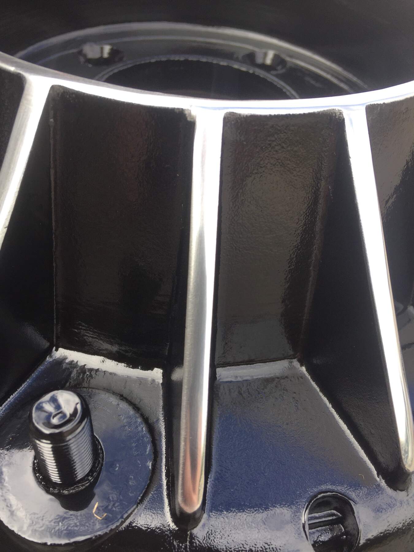

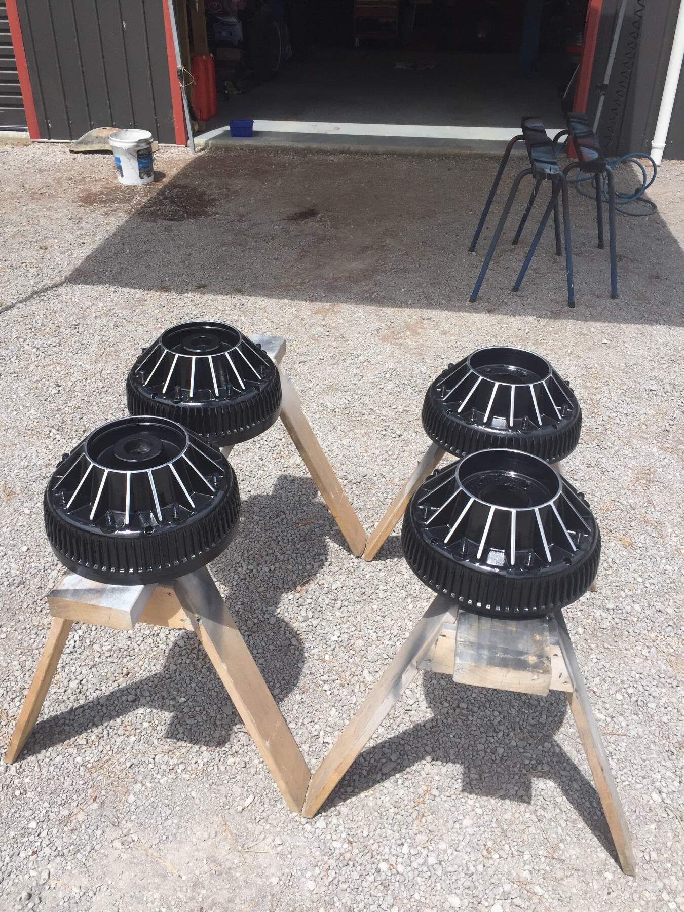

I decided to completely finish one drum to ensure my plan works !!!Β
Here is number one finishedΒ
I will leave the paint to really cure and just do a light polish in a few days timeΒ
but here it is ,, a before and after !!
All the work is getting rid of the nicks and marks in each of the bladesΒ
So they come up like this .... with added time and effort. i was wayyyy more happy that each blade was mark free!!
its up there with sanding steering wheels!!!!Β :stars::rofl:

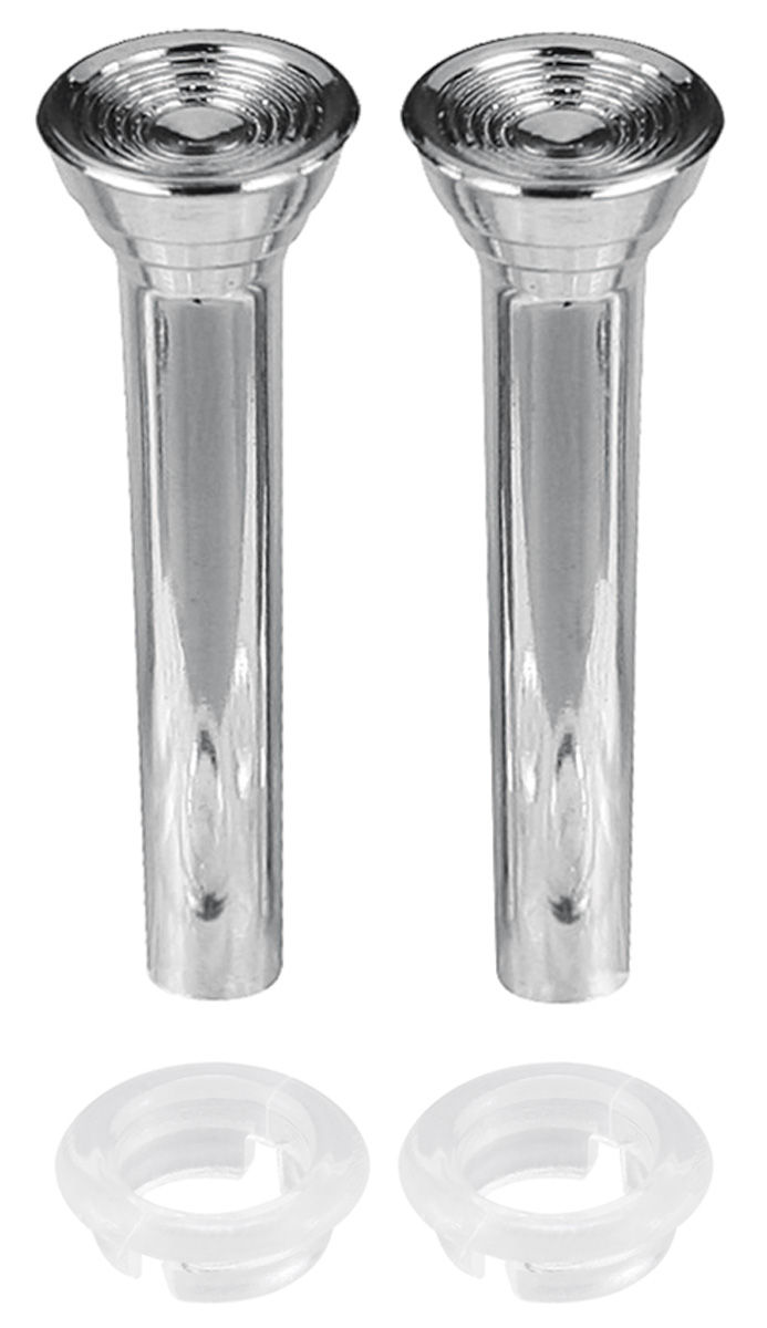

Alright boys - shopping list time. Ol' Frosty plans to hit the winter swap meet trail this weekend. On Sunday is a small indoor swap meet, but a gent I know that carries Pontiac parts is usually there. He often has bits and pieces. He may know where some '64 and '65 parts are. So let me know what your short list of hard to find parts are. I will see what I can find or see what he knows / has.
Frosty, i have bugger all left to get, but one little thing is the interior door lock buttons!! my car is missing both of them !
Β the other is a pair of stainless wiper blades they are 18 inches long and have the push in blade connectionΒ
Β
Kiwi - to be clear - are we talking manual door lock buttons correct ? This thing does not have power door locks?
