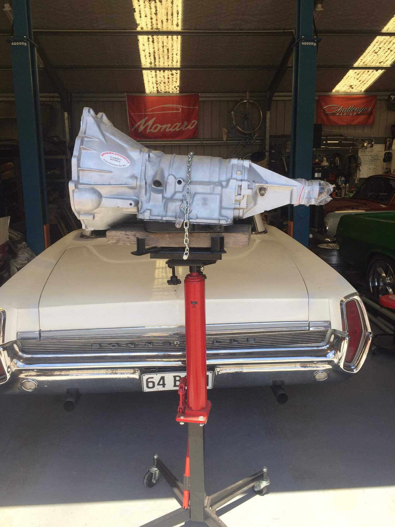

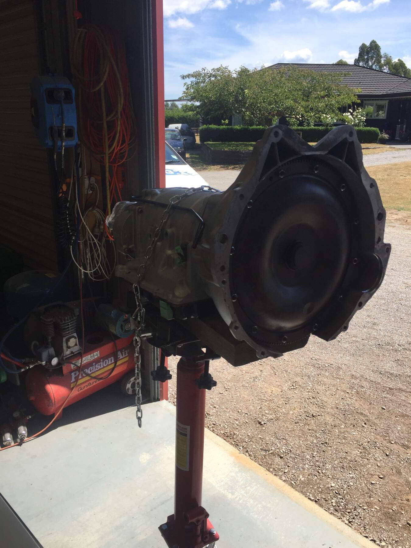

Well here we go guys
had the son in law help me lift the trans out of the van and onto the trans jack...
i had lifted it off this jack and into the van ,by myself,, and I really shouldn’t have !!!
it was justA as I was lifting it I rembered my stay in hospital last year for the herna repair !! Hahaha
Good luck, fella. One of the many advantages of having a hoist. If mine needs doing, the car will have to go to the shop - I can't even get under it to even look at the trans!

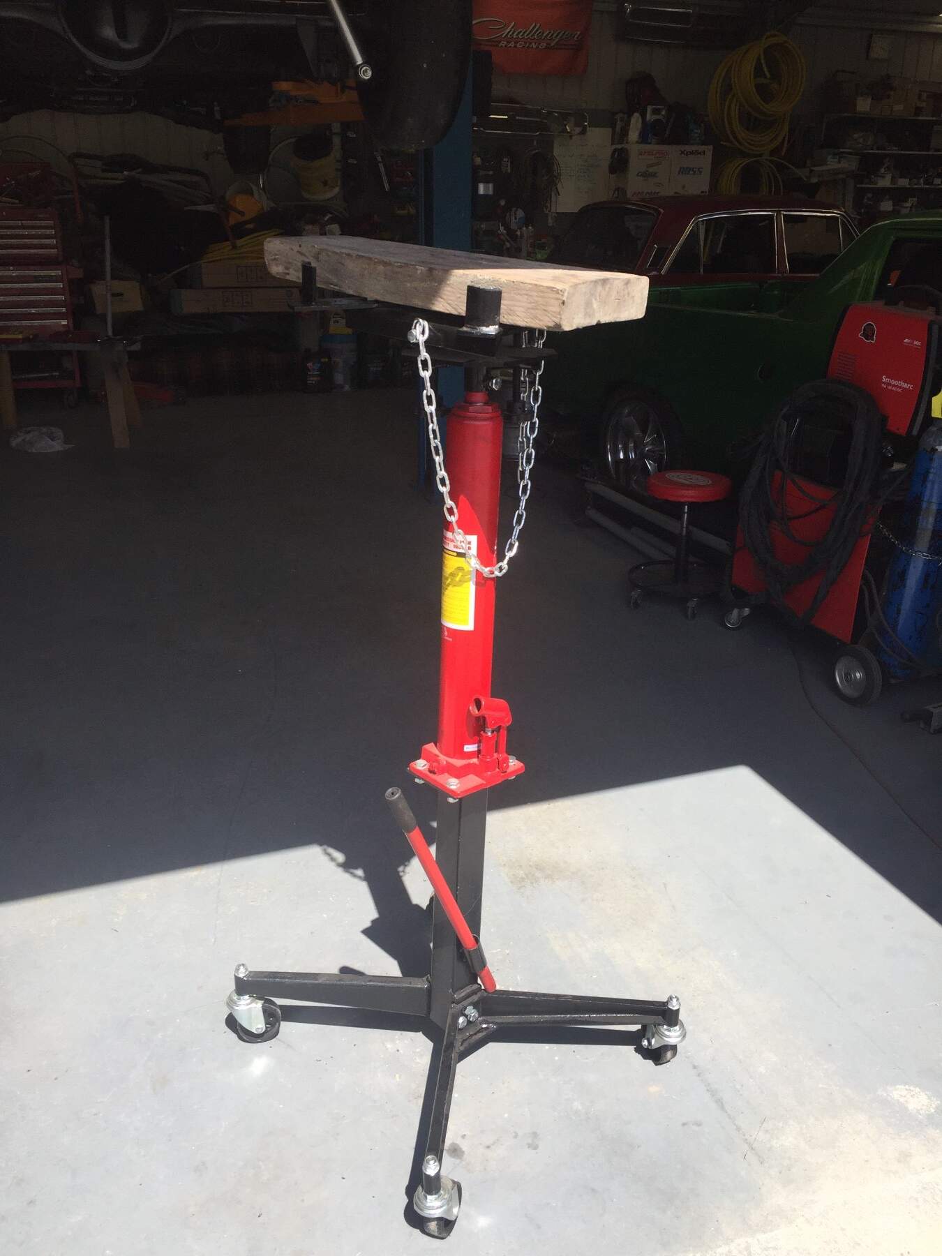

hay.... my new best friend !!!
the trans jack !!!
wish I owned one years ago !!!

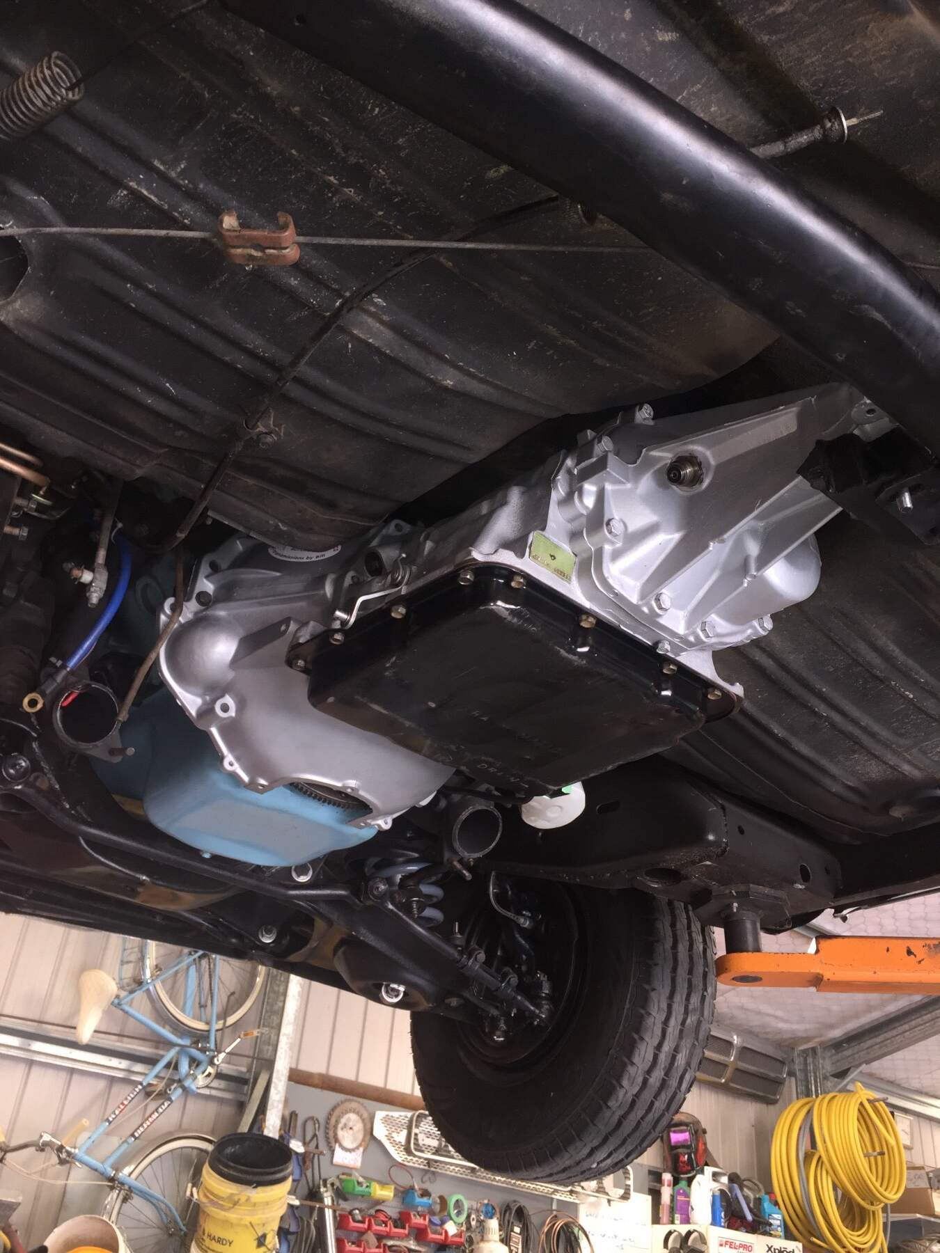

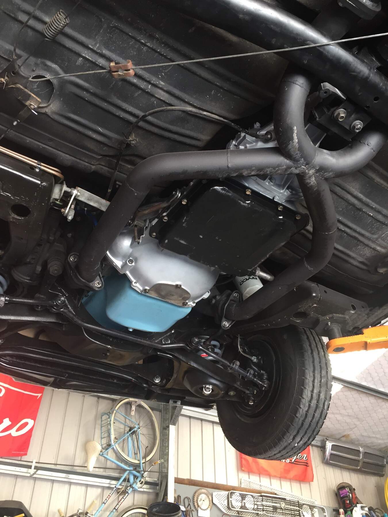

All button up and ready for fluid ...
but it’s also knock off time... it’s way beyond hot here today ... I am going to read my shop manual and find what amount of dextron 3 I need to fill the jet away with ... oh and have a beer 🍻🍻🍻🍻🍻🍻🍻

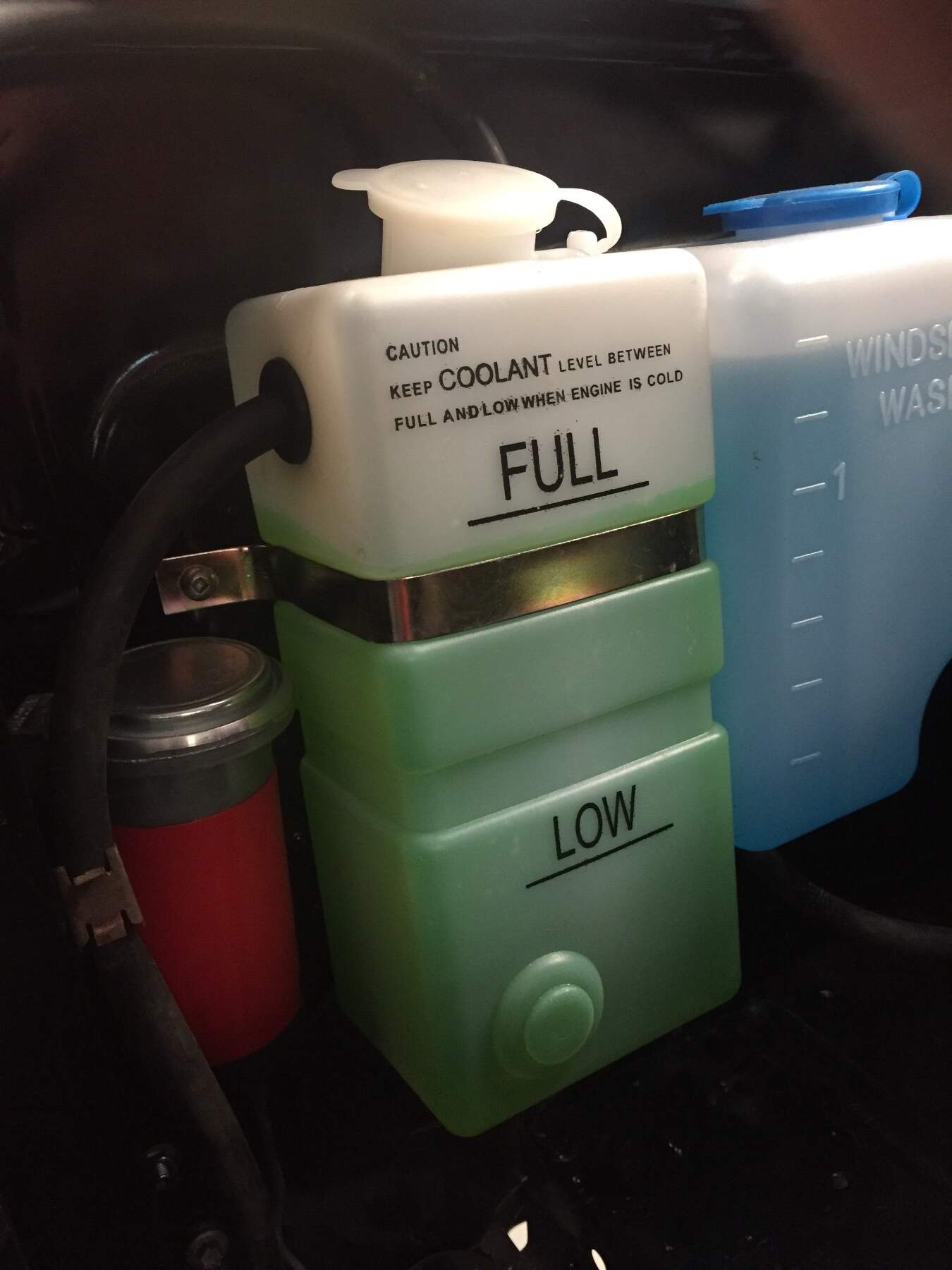

Fitzy I noticed you don’t have a over flow pipe from your rad bottle
I fitted one so if the overflow bottle does spit . It doesn't oooz out the hole in the lid
i blocked the hole in the plastic lid with a small bit of silicon ( plumbers best friend too ):rofl:
its justA rubber grommet and a bit of 3/8 tube, down the side of the radiator

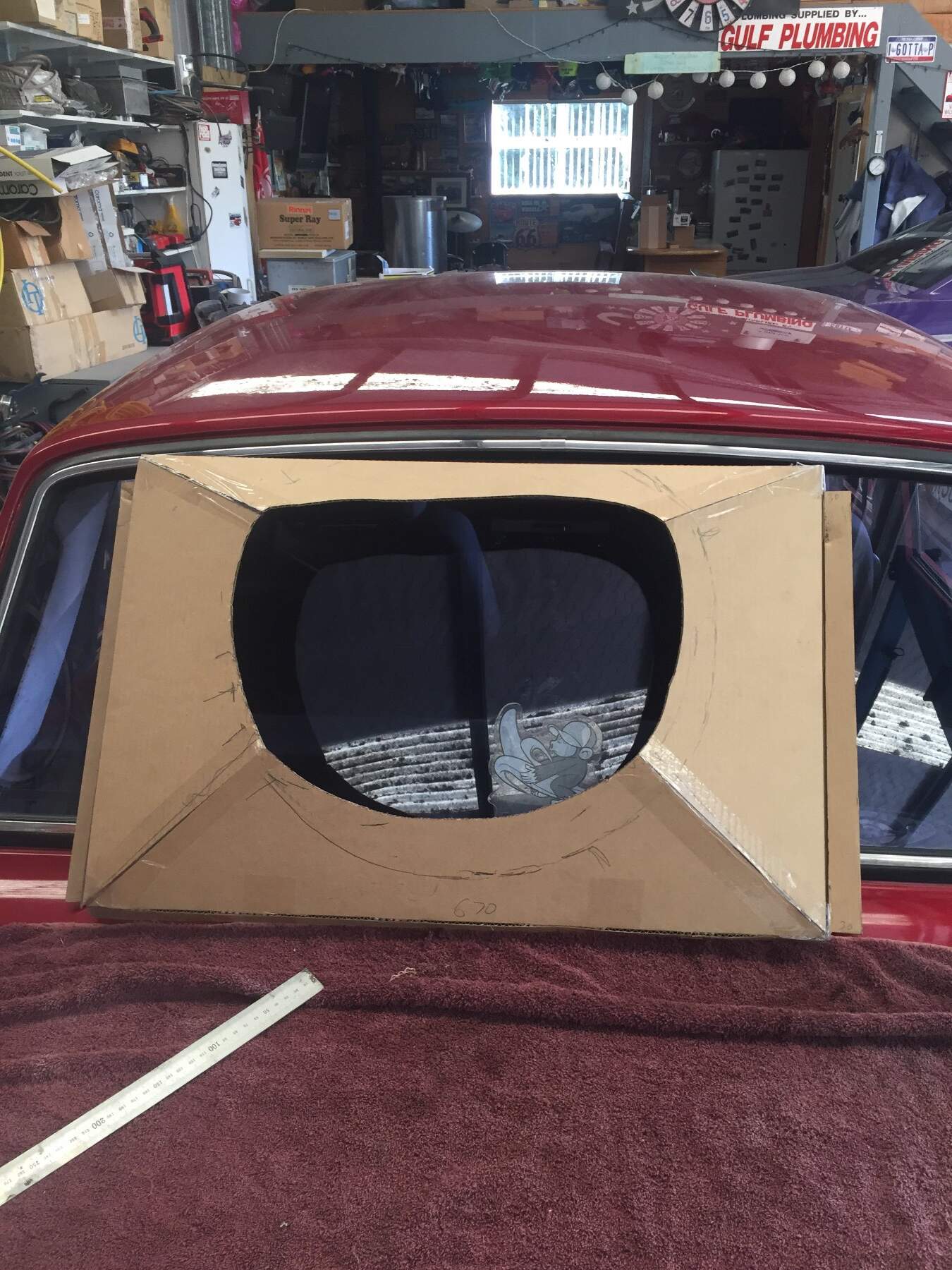

Still haven’t completed the radiator shroud ... but another day another mission
you can see were i have scribed the edge of the fan blade with a pencil to the cardboard for my next cut
to find the circle for the cylindrical section to be added
this is the important part... the fan pulls air and the cylindrical sheet metal stops the air falling of the out- side edge of the fan, and MAKES the air head in the direction the fans wants it to flow. i bet there is a special name for it... i call it flow.
The bible is very explicit about how to fill a jetaway 315
fitzy..... it works :rofl:

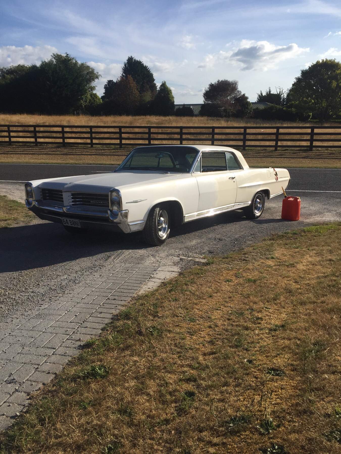

Ok.. I could not help my self !!!
i had to do a test drive !!
ran out of fuel in the gate way, on the way home and flat battery ( hasn't been running long enough to charge)
no leaks, trans shifts way sharper than before...... job done ... box ticked . next job:cheers:
once i did walk back to the garage , got fuel and a jump pack.. drove home, told the boss how happy i was that all went well. she goes... oh, why didnt i get a ride??... my reply... sweet if it packed a sad while you where in the car, you would call it a pos.. thats why i do the test runs :) :rofl::dancingpontiac:

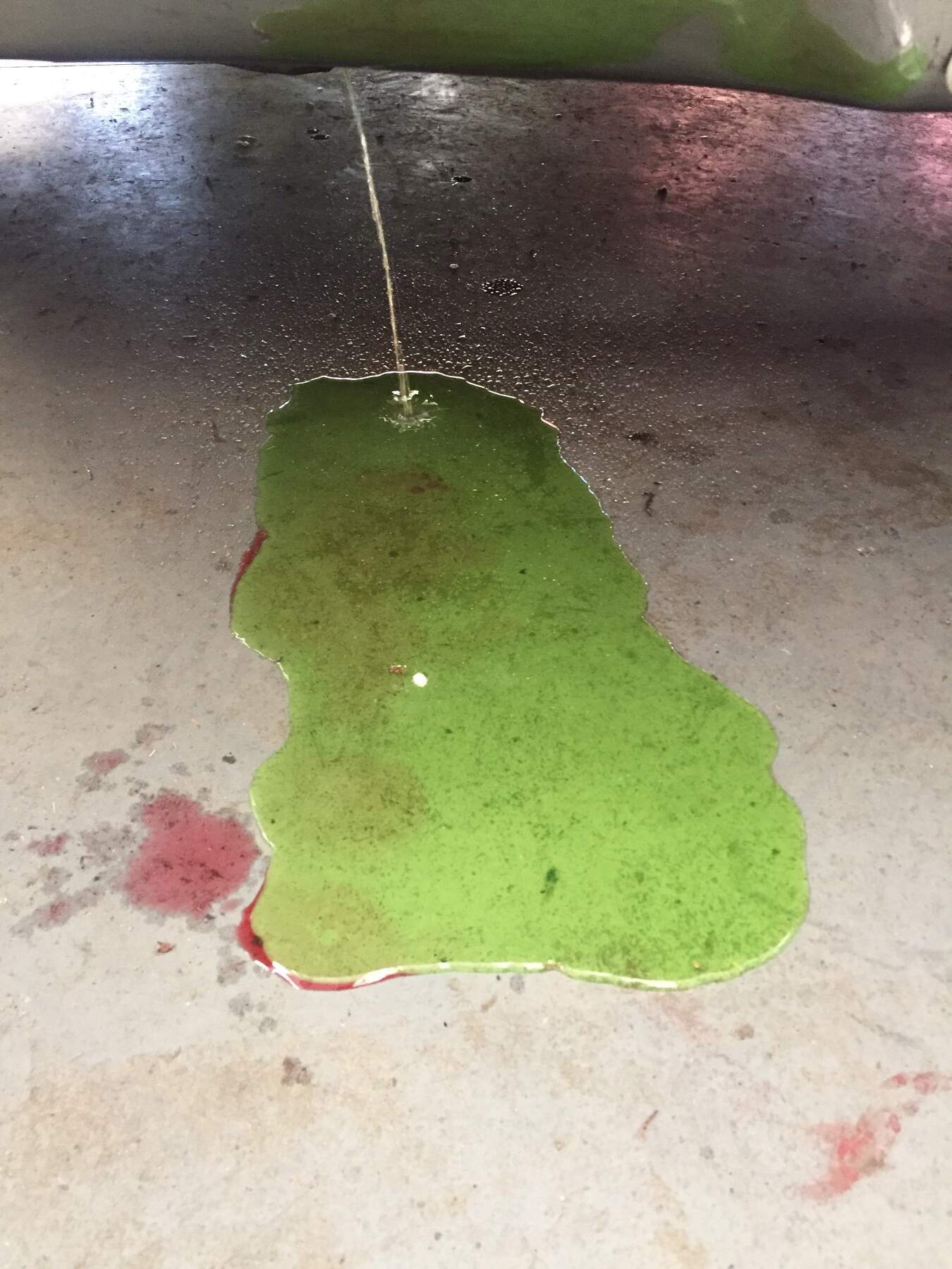

Okay - what am I looking at here: is that coolant and why is it all over the ground?
Well done on the trans & brakes - car is looking sharp from underneath, and not too shabby on the surface. Sounds like all your hard work and dedication to solid engineering has paid off. I can only hope I attain the same sort of result coz upon my return from work next week, I'm gonna replace that leaking wheel cylinder and take it for a drive to the nearest servo (about a kilometre away) chuck some fuel in and see how the auto shifts. If the car drives okay, I'll get a 2 day permit and will drive it around listening for fatal noises and monitoring everything.
i topped up the reserve bottle once again justA in case i had any more air bubbles in the system.... more than happy for it to over flow rather than be lacking fluid, knowing full well it can do justA what it did :cheers:
