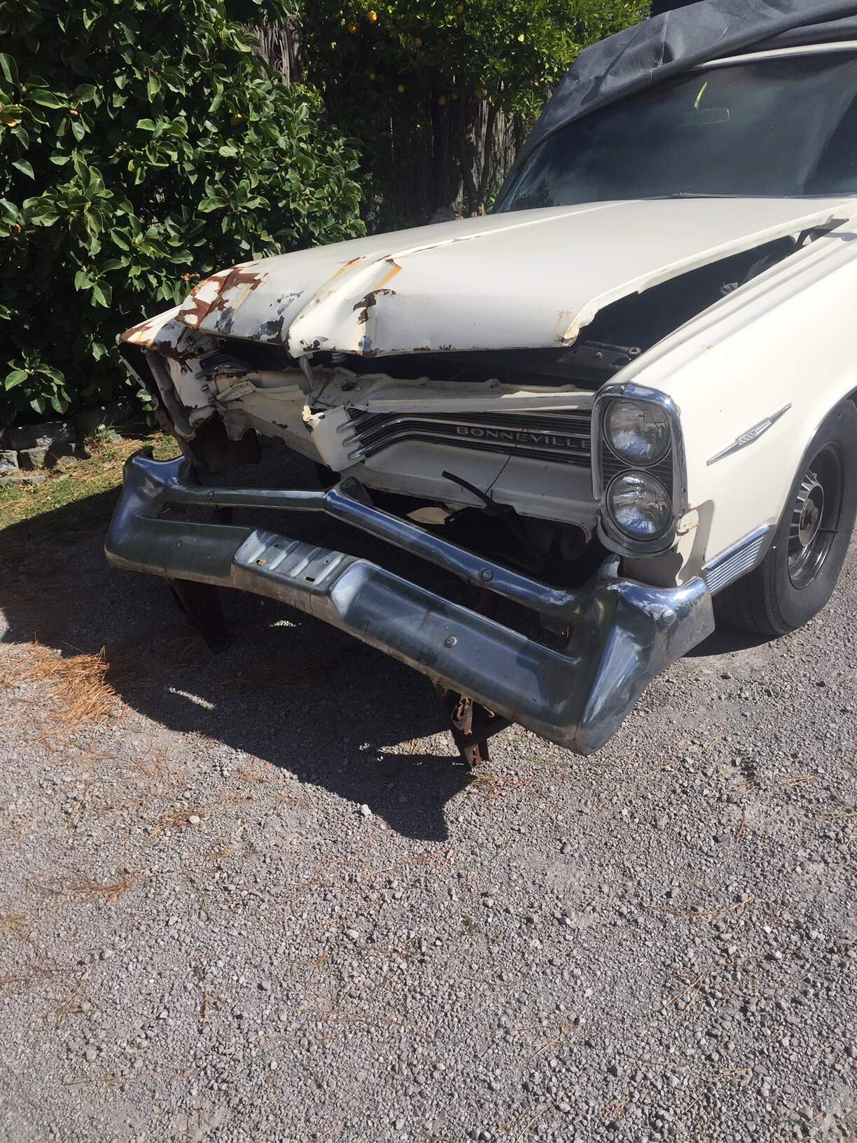

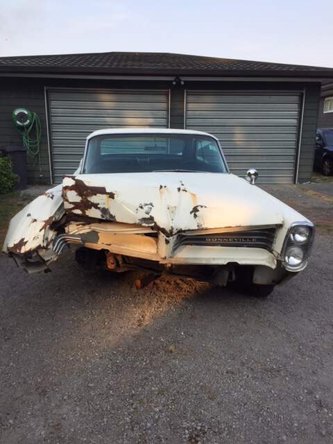

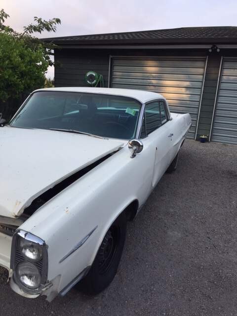

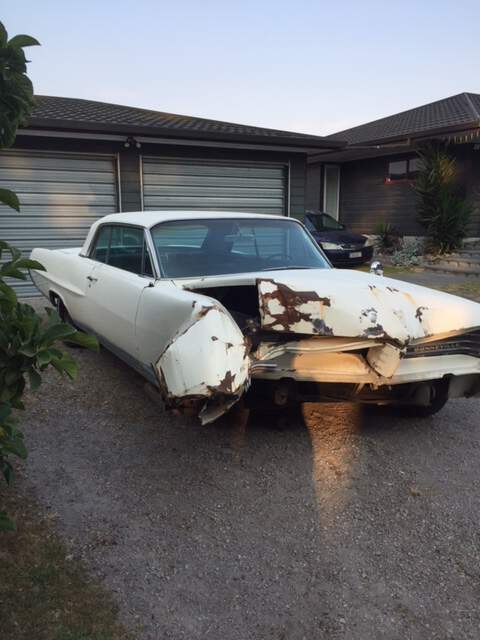

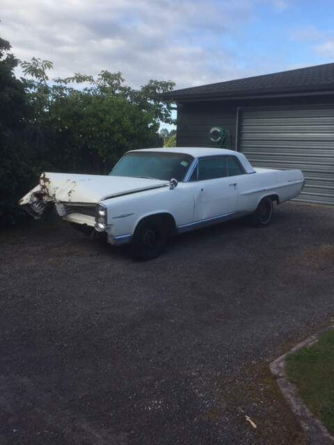

hi all, i bought this 64 Bonneville that has had a head on.
the guy i bought it off had collected all the front sheet metal to put it on the road again.
i had booked in with my panel shop guy to put the car on his chassis machine in mid February.
how ever he called out last night and inspected the frame.
he advises me to forget straightening it, just find a replacement.
which i think will be a much better long term option.

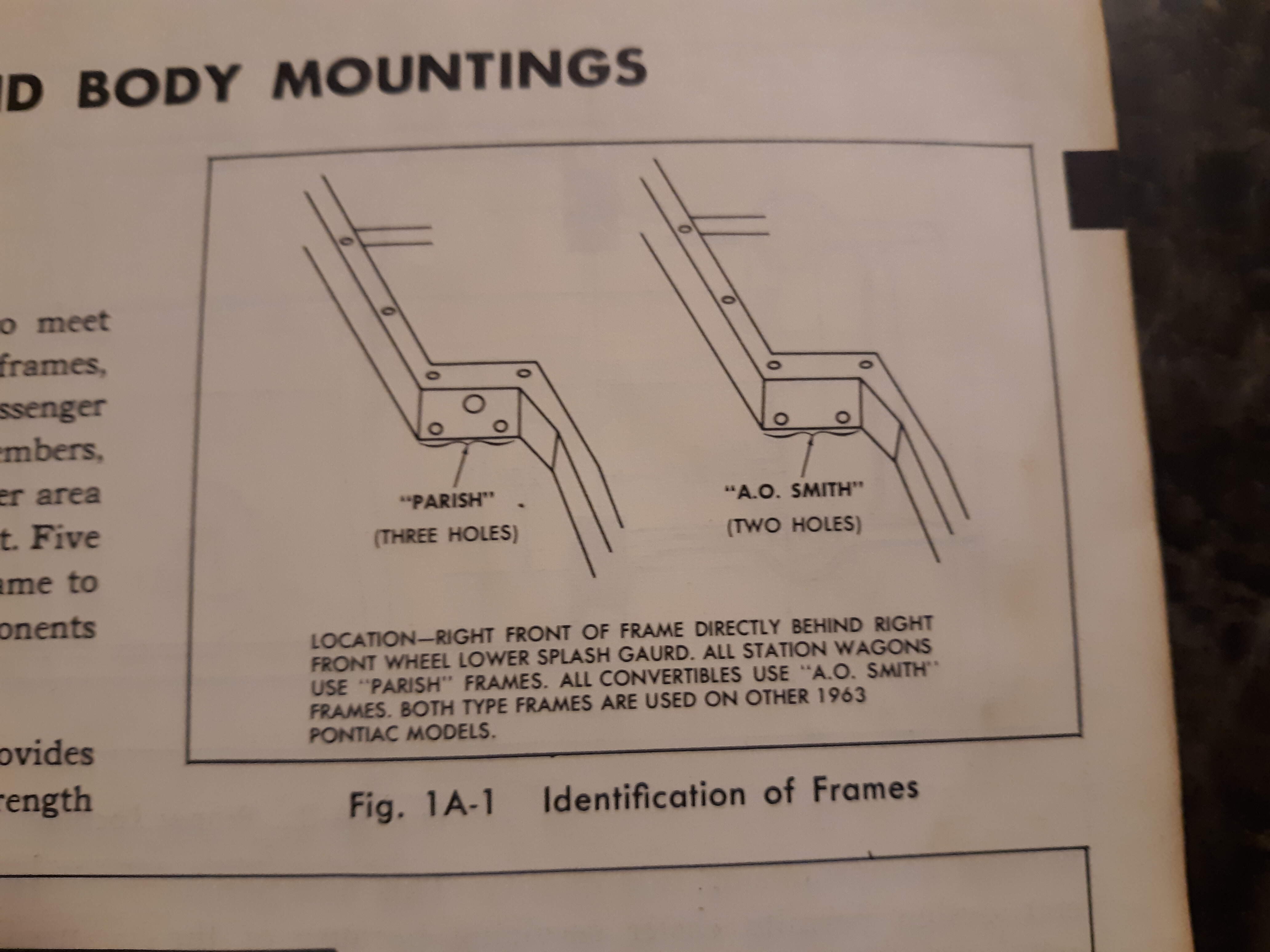

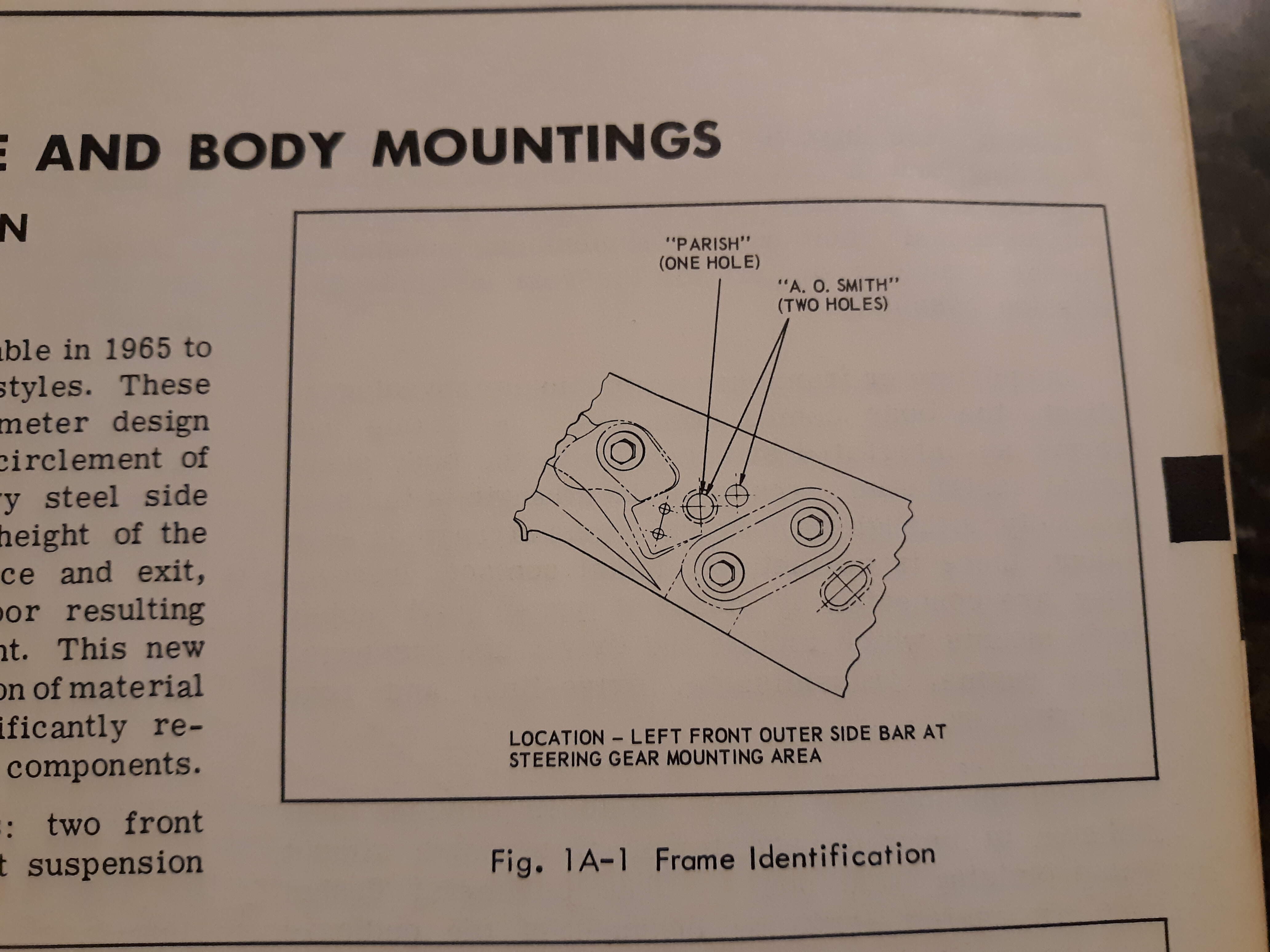

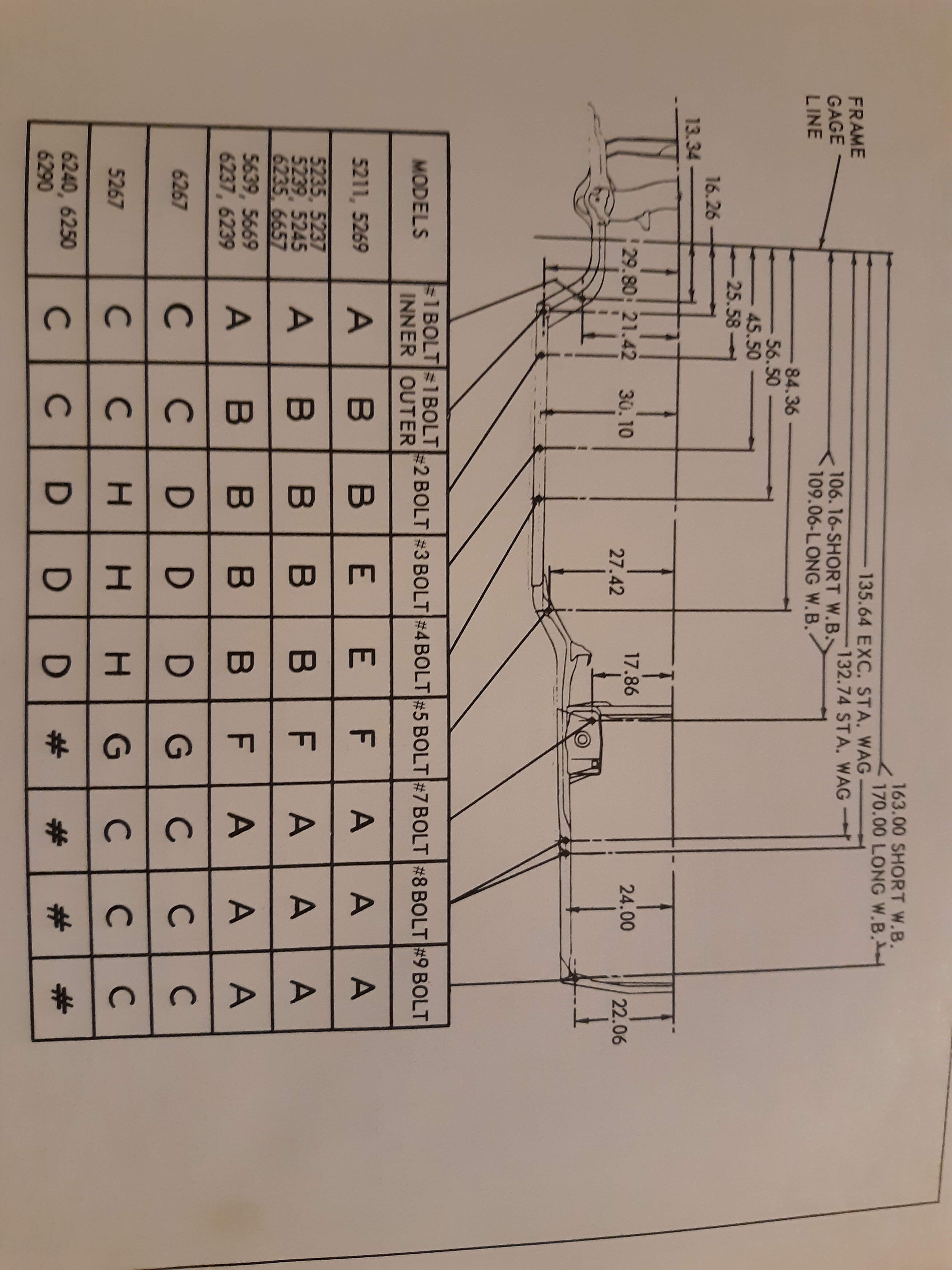

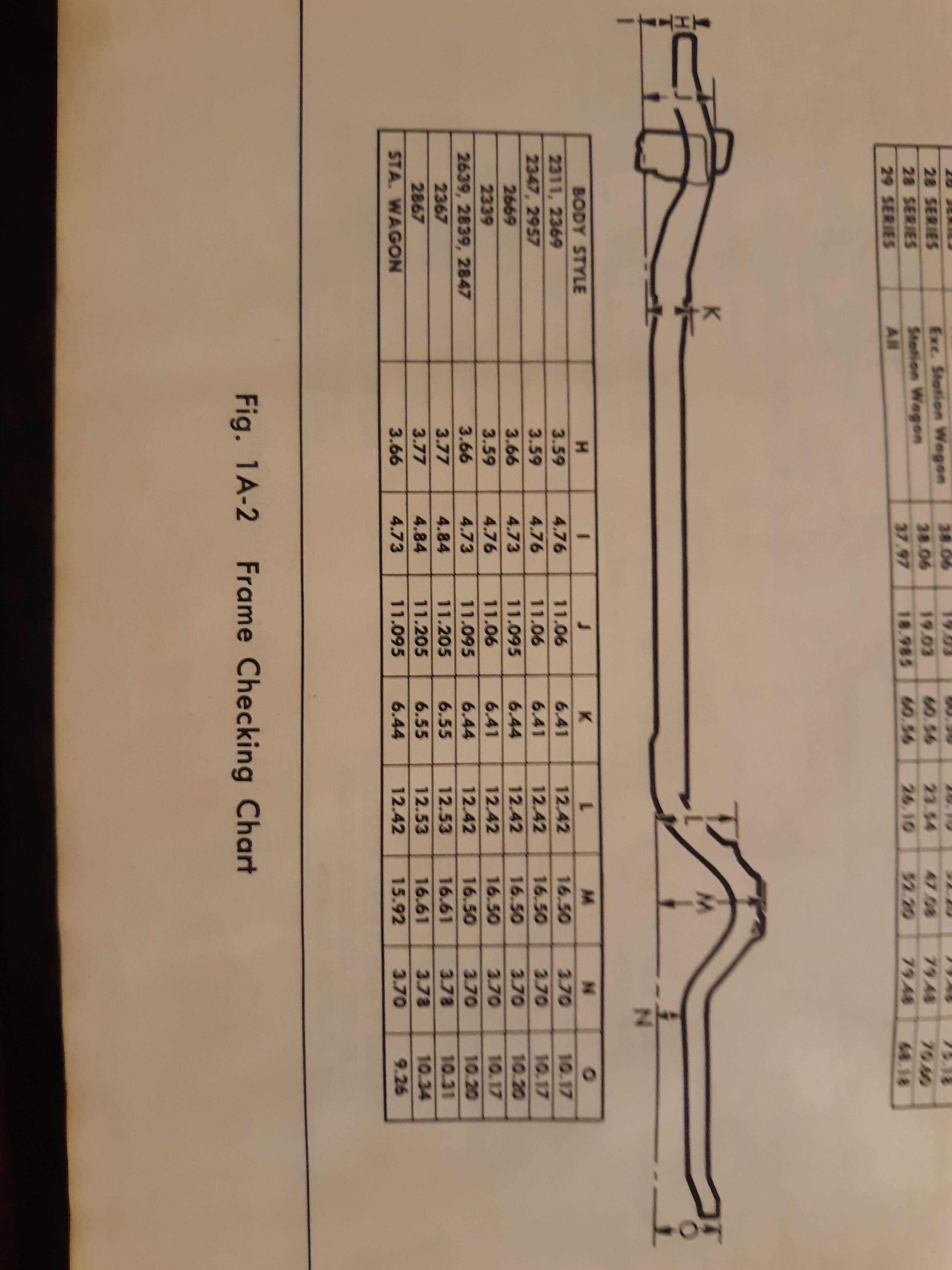

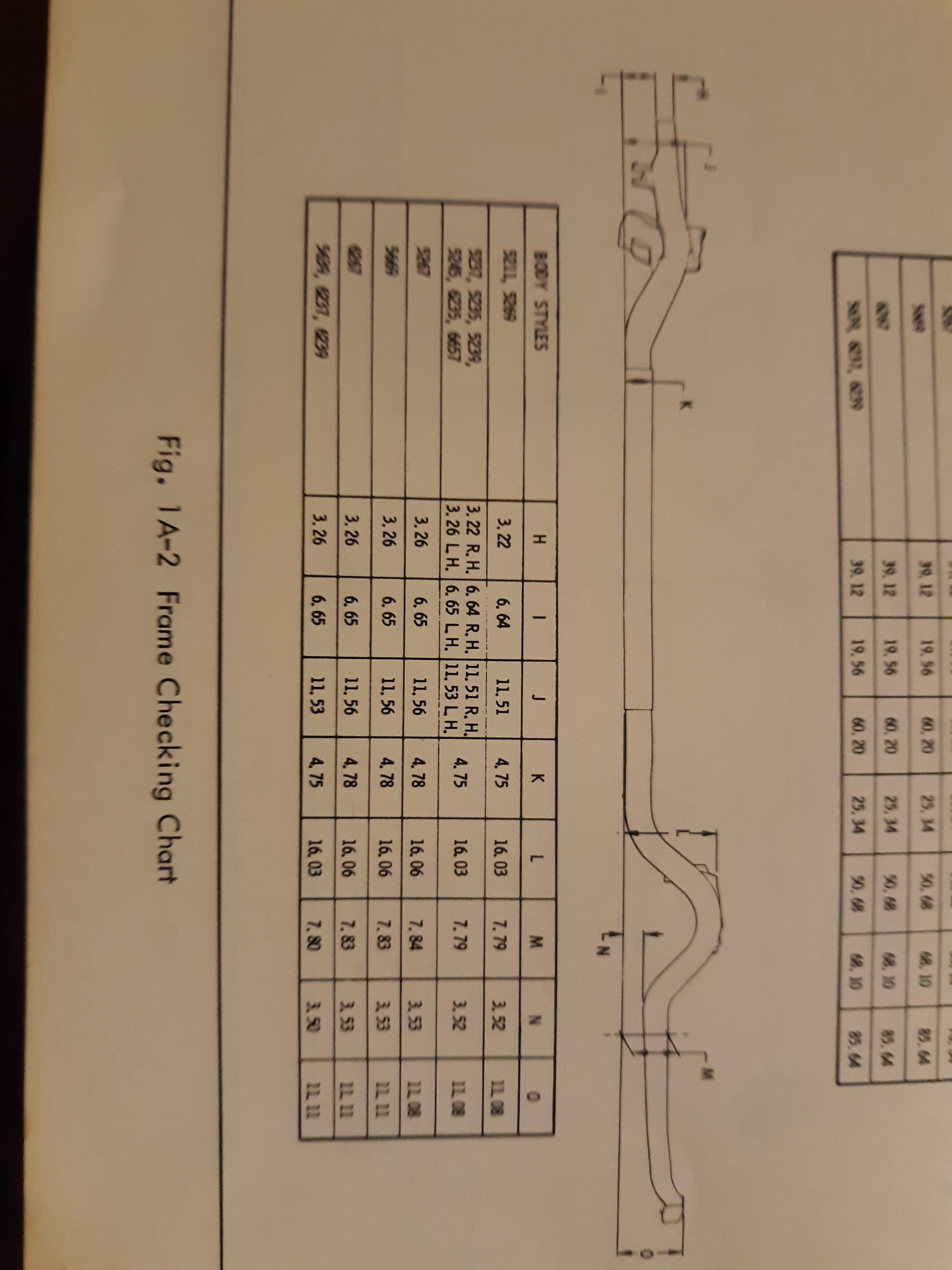

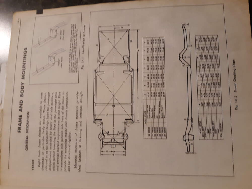

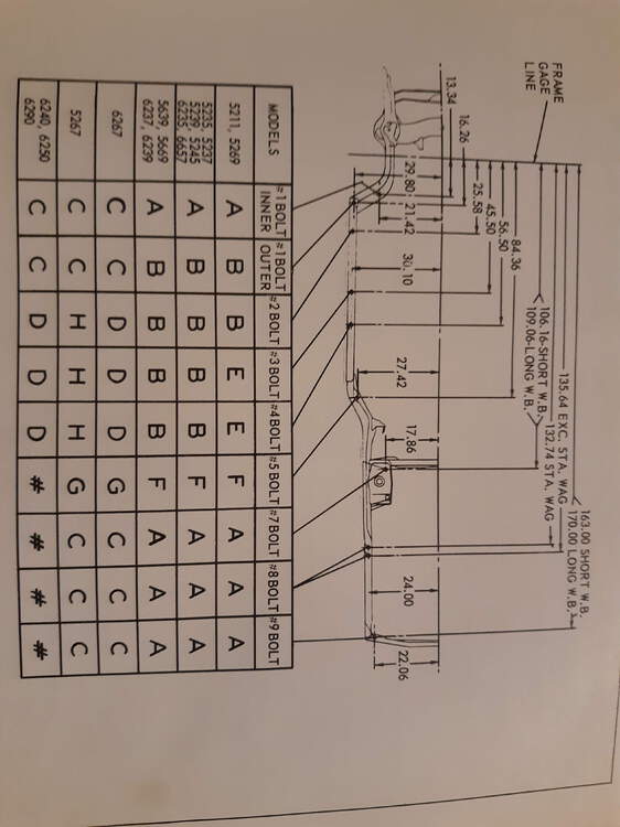

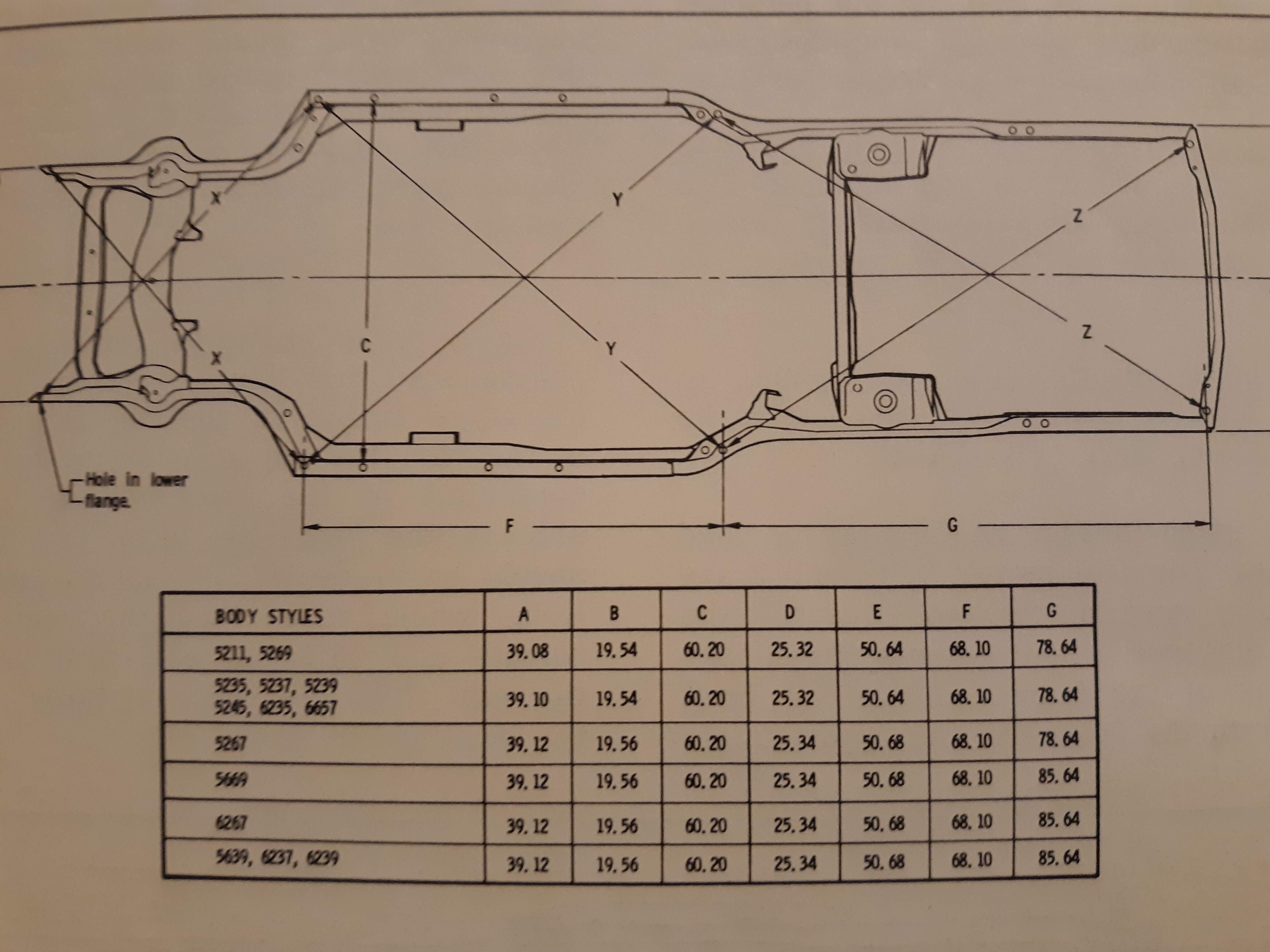

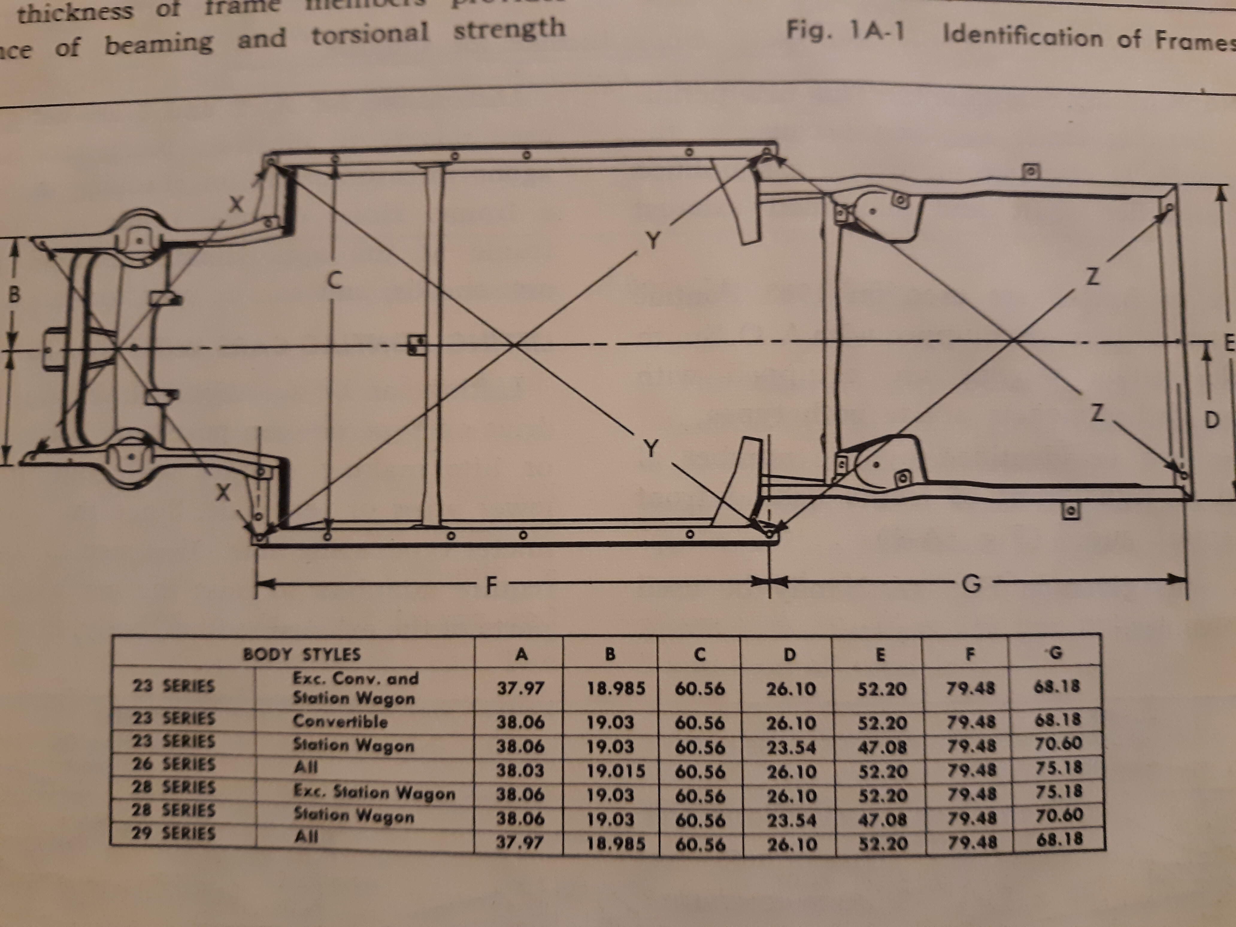

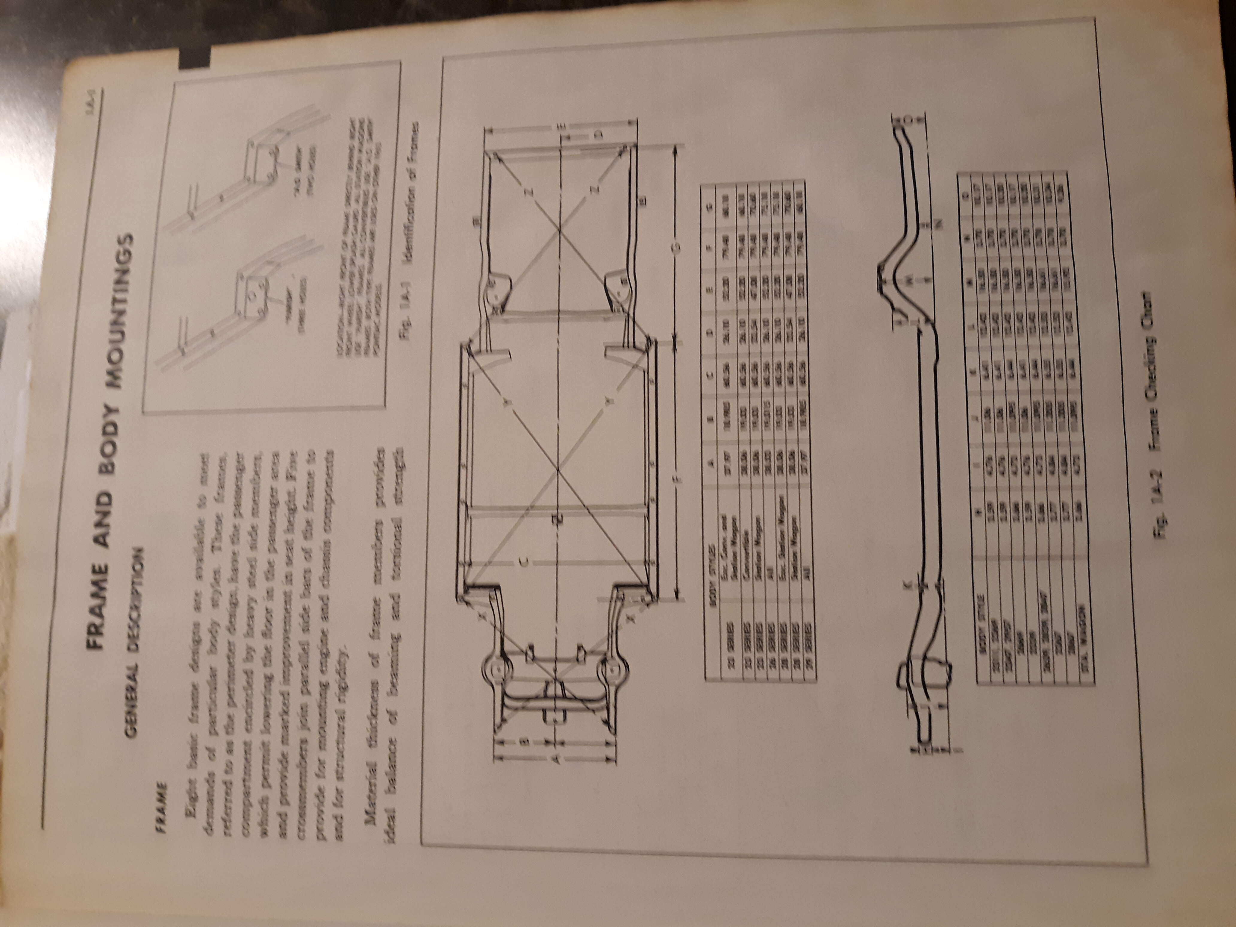

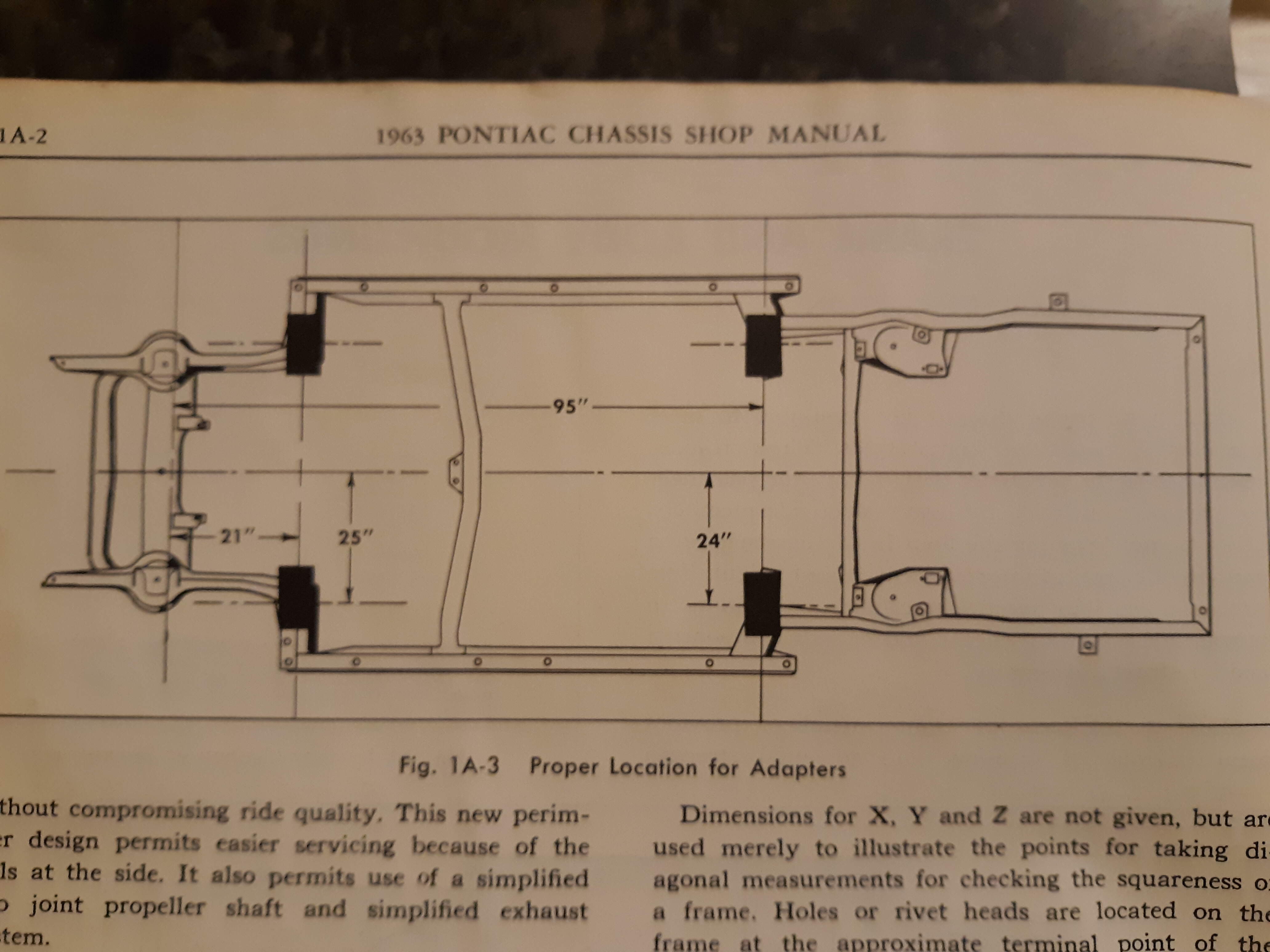

I'm pretty sure that the 1963 and the 1964 Bonneville use the same frames...But NOT 100% sure....I don't have the 1964 Frame specs that you are looking for but I do have them for 1963 and 1965....I'm 95 % sure that 63 and 64 are the same...I will include the 1965 frame specs also....Pretty sure that the 65 is different from the 64 model...This may or may not be correct for 1964
Hope maybe these photos will help.....Hope they are legible....Welcome to the site
that is exactly what i am after two lane !!!
thanks heaps, my chassis is certainly like the 63 model and not the 65.
when i get the new frame i will compare the measurements.👍

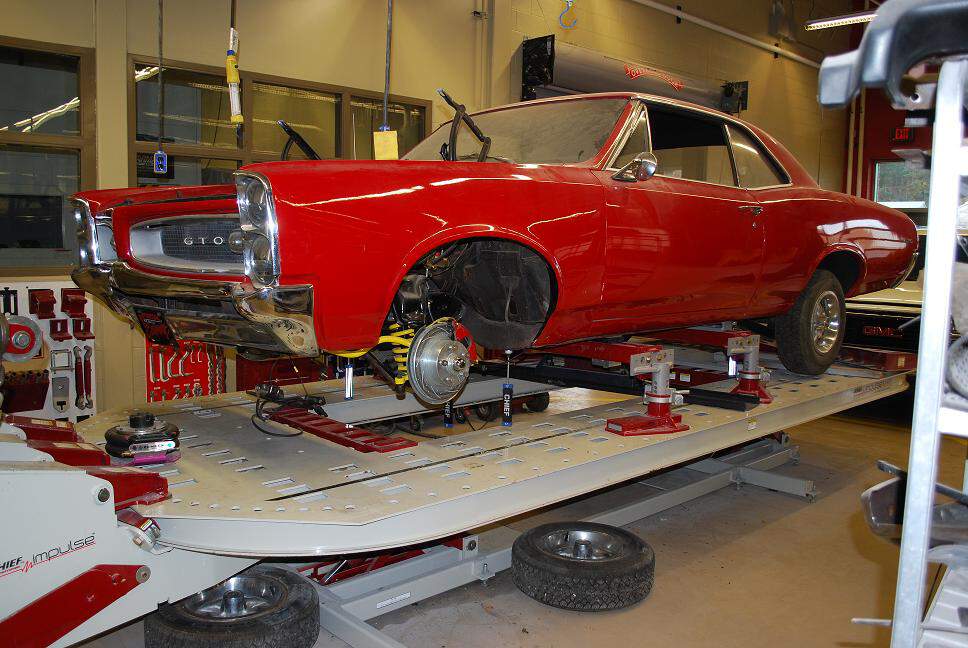

Mate I can't wait to see what you have to go through. My buddy, JUSTA6, had to do a frame swap on his '66 GTO. I've heard his horror story. It will be interest to see what you discover along the way.
Kudos to Two Lane and his specs. Way to go buddy!

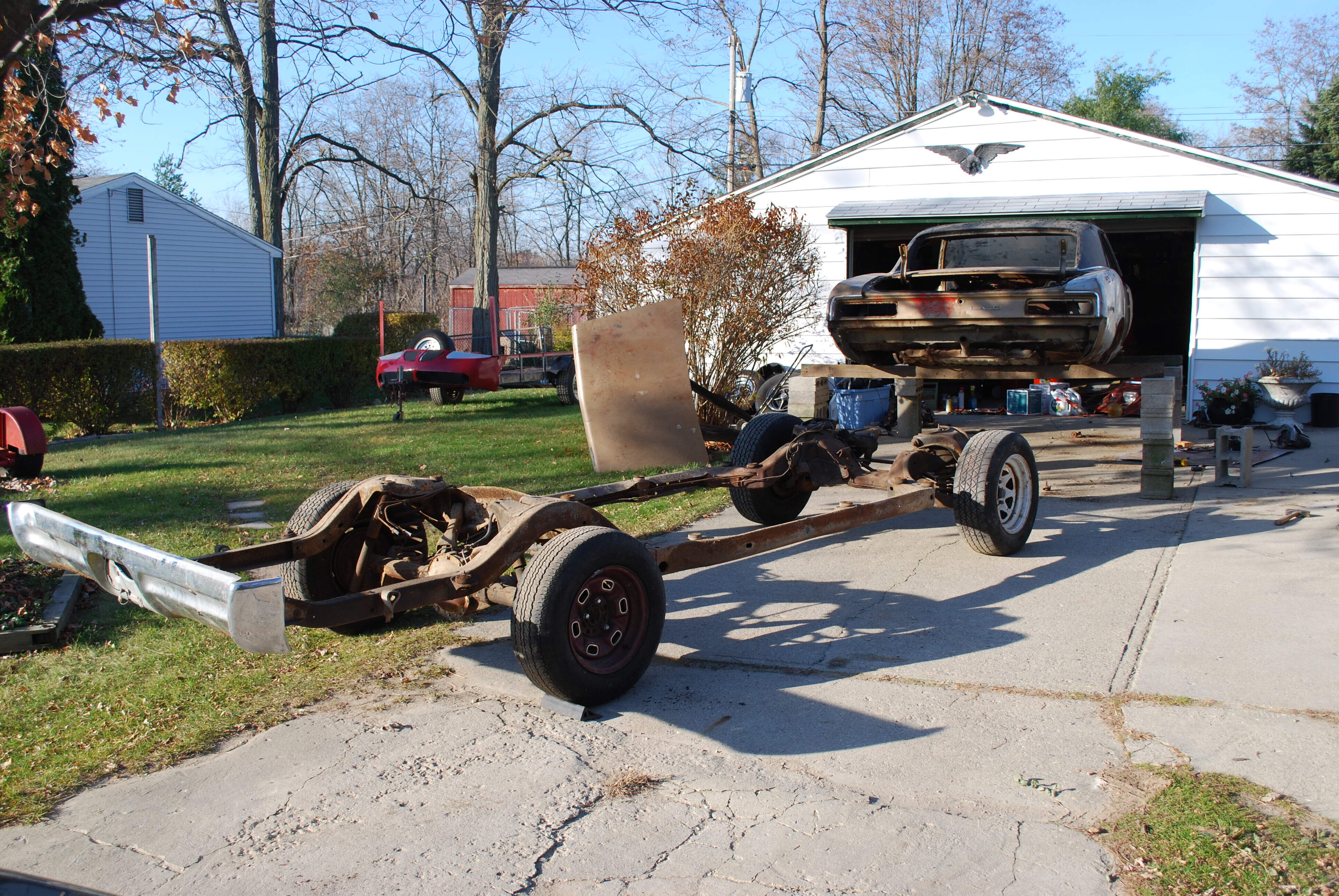

I can laugh about it now........ Shortly after claiming my prize frame.  A cement block exploded and the whole body crashed down, JUSTA missing me!!!!

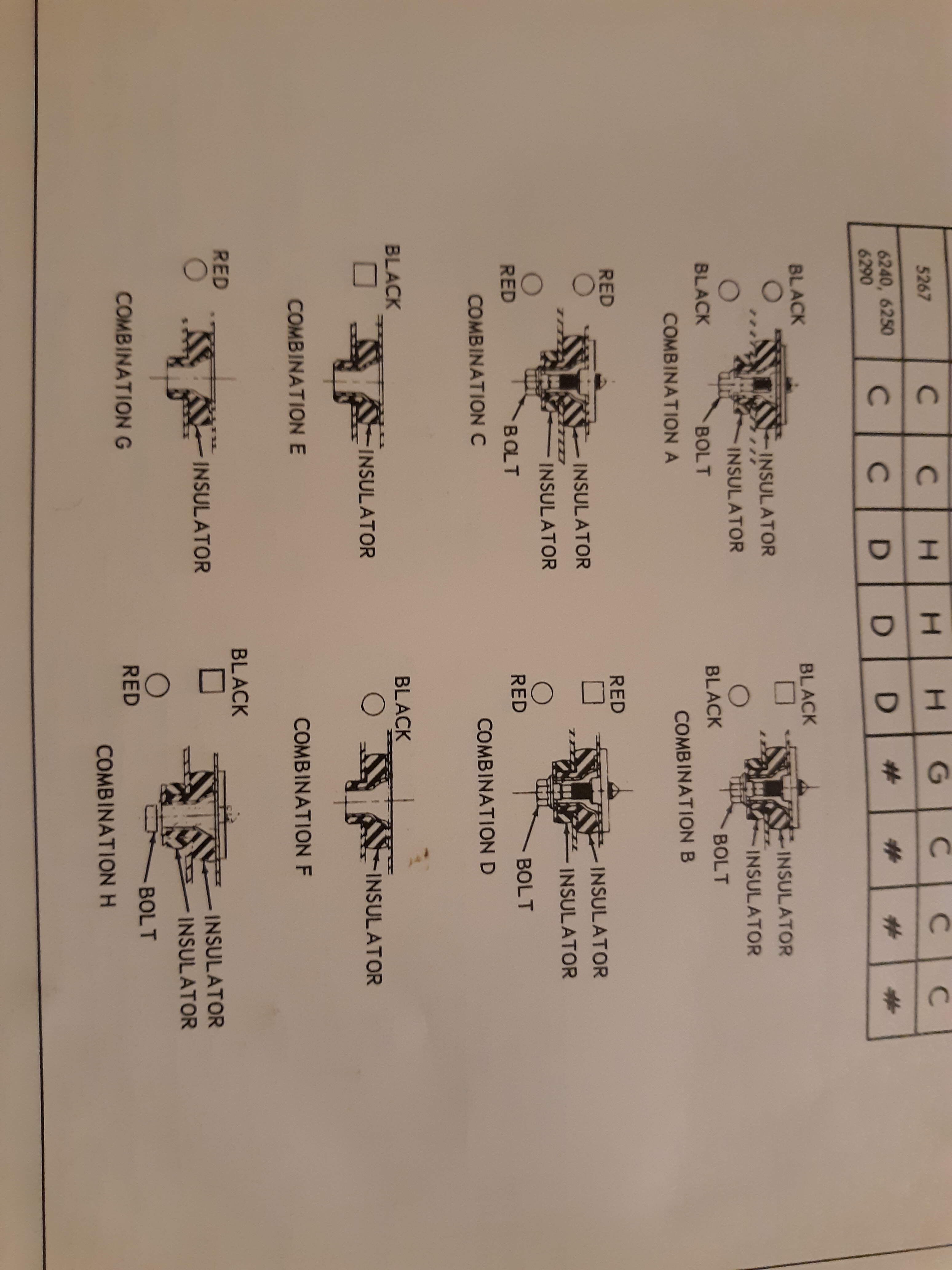

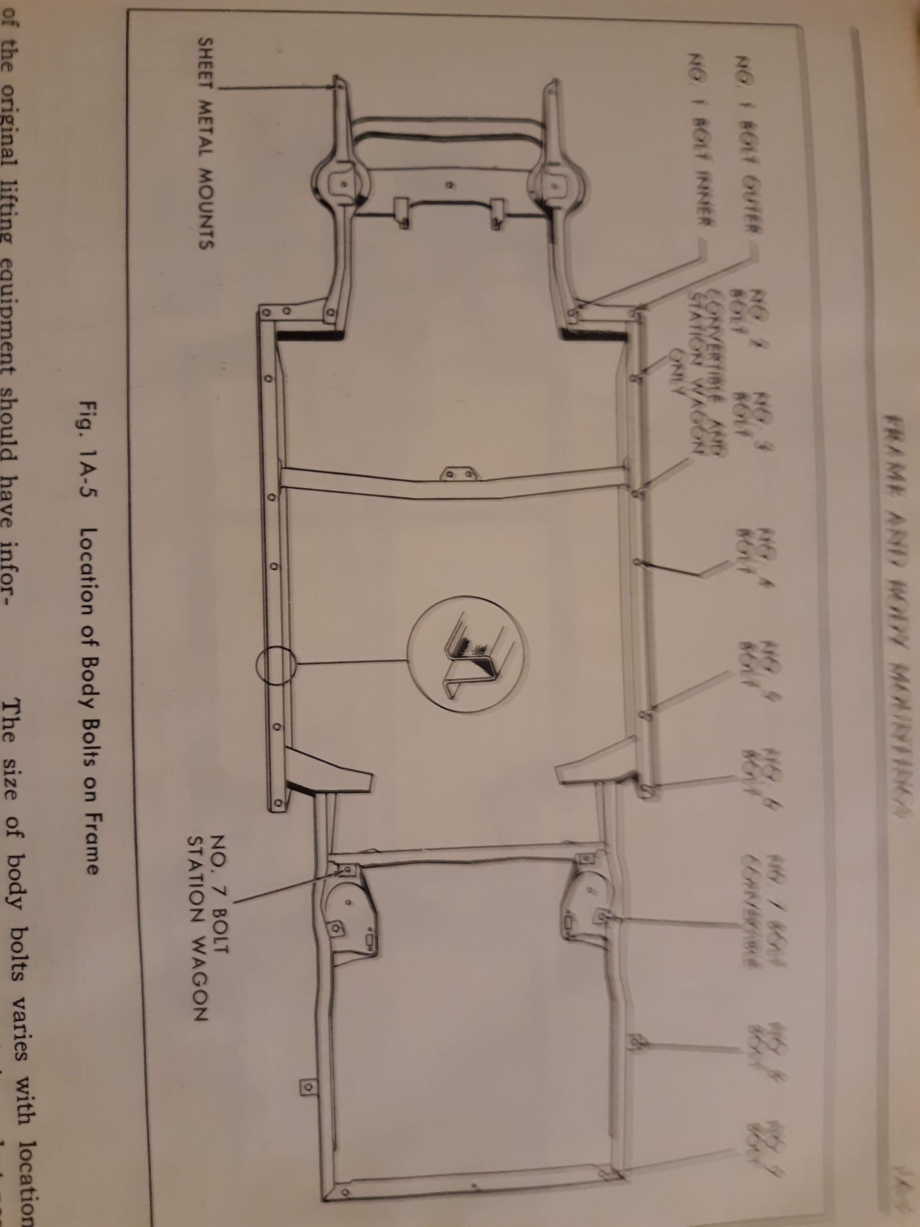

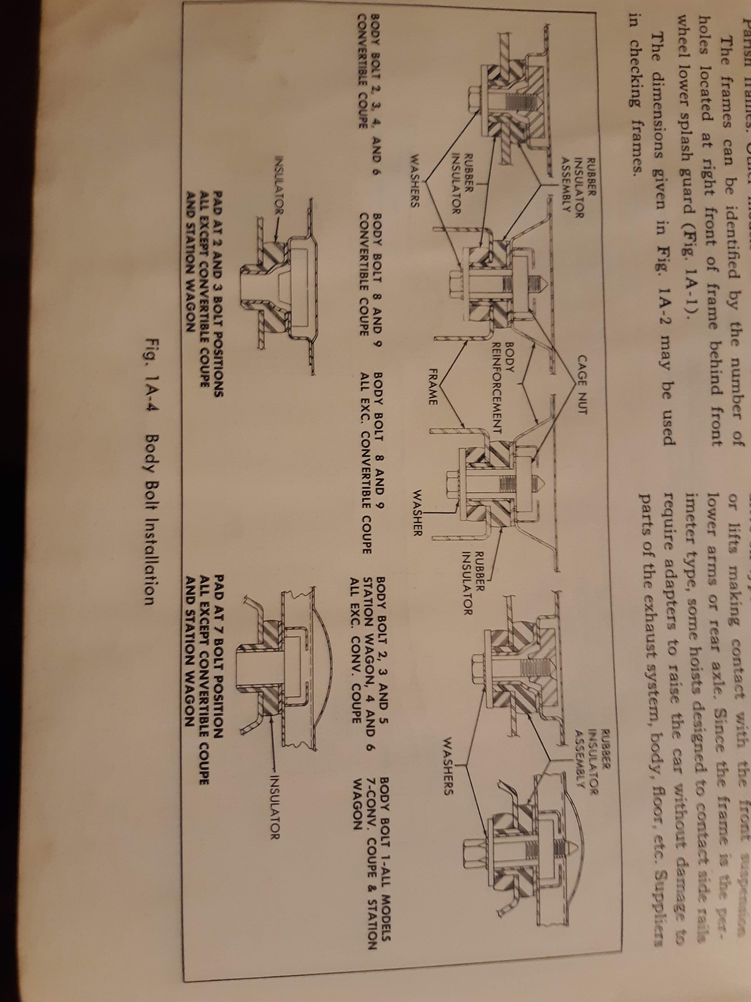

Thanks to two lane,
i bought a copy of the 63 chassis manual from rockauto so  i can read up on what and were the mount points etc are to get too and all the measurements.👍

None of it was easy.  Thursday night, the owner of the frame shop kicked the car out of his shop after a month of tinkering with the frame. I had completely replaced the entire suspension and couldn't come close to aligning the front tires, so it's off to the shop.   If it was not out of his place by Monday...a wrecker was haulin it to the junkyard.  He agreed to transfer my body to the new frame, (if I could get one AND have it to his shop Monday AM) Couple calls and the owner of the car agreed to help me out and sell the frame, IF I would help him strip the car of what he wanted.   Met the owner of the running/ driving Lemans @ 7am.  The two of us had the car completely stripped, engine/trans, front clip,  complete interior,  wiring, doors, side glass and  loaded on my car dolly by 1pm and heading home. Went to work bustin loose rusted body mounts. Of course the 1st one, with my feet on the frame and a 4 foot length of pipe.  Broke the bolt and the pipe of course opened a nice gash under my right eye.   Quick fix with duct tape and back at it.  After claiming my prize rolling frame, kept hearing this ping noise.   Down on one knee trying to pinpoint the noise when the block exploded. No time to move, launched myself backward's, landing on my back staring at the sky, with this body less than 3 ft from my legs.  The crash noise brought my wife/family and neighbors running to find me laying in the grass (sayin a quick thank you prayer)  Not thinking about the entire side of my face covered in blood from the gash under my eye.  Sending the entire situation to the next level.  Quickly jumping up to prove to everyone I was fine, then back to work.  Had to get the Lemans body back in the air, to get it on the trailer and out of my way.  Spent the next 2 days straight sanding preping, repairing rusted out body mounts, priming and painting.  Yes I was there @ 7:30am Monday waiting for the frame shop to open.  To this day he doesn't believe I pulled that one off.  The frame jig lets the body be separated and dropped on the new frame.   Smartass did not drop a couple bolts back in the body mounts and I almost lost the whole project getting it home, with the last mile+ being rough dirt roads!!!!!!   Stopped soooo many times moving the body around and finally got it home.   Now to rebuild the body front to trunk......WAIT thats a whole nother story.

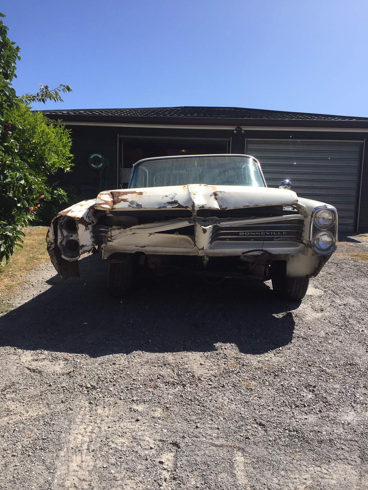

This afternoon  i  only got a few hours to make a start on my plan...
which is to get the bonnie steering with 4 wheels on the ground, and see if she will run...
remembering i bought the car as is were is, no warrenty ... zip...
Once that part of the plan is sorted i will start striping off what i need to for the frame swap.
soo , here is what i got up to..

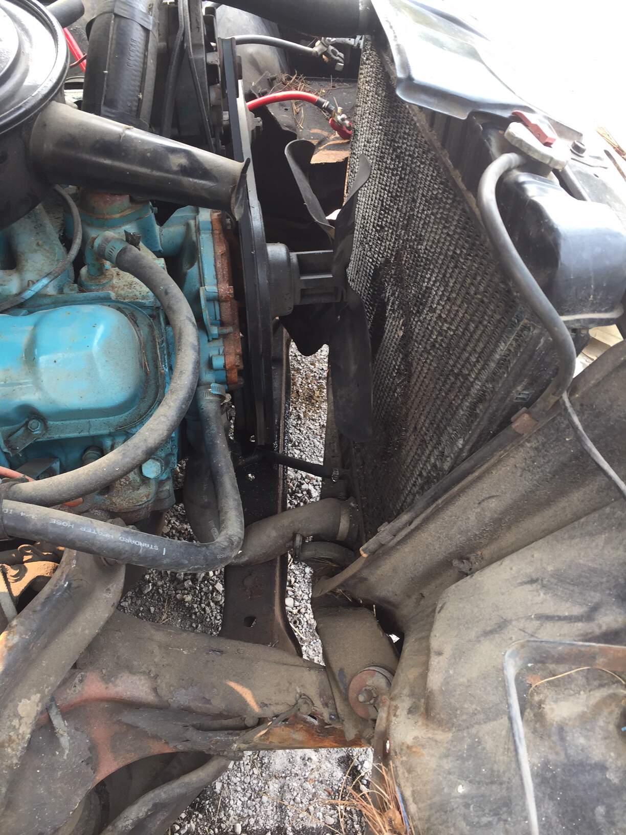

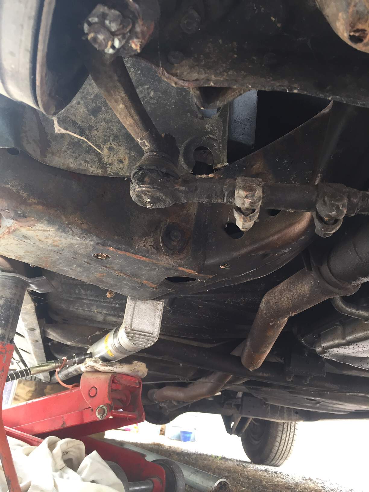

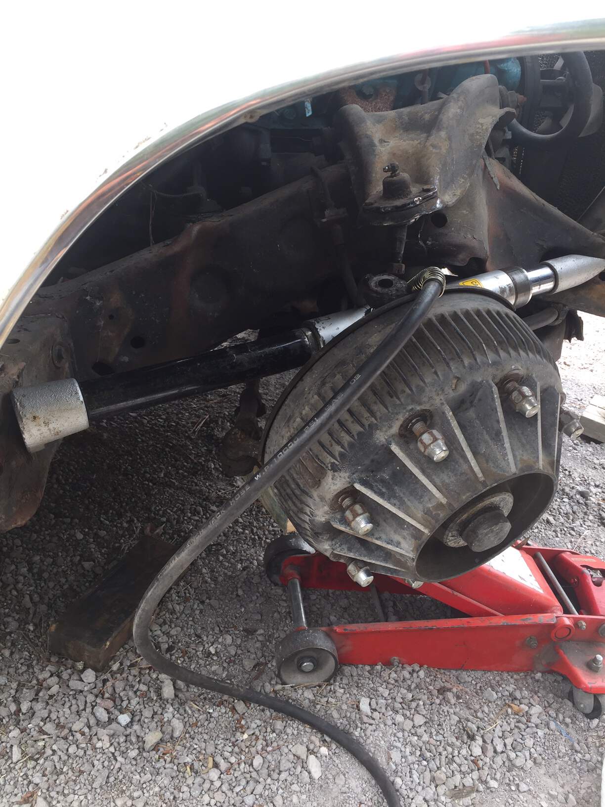

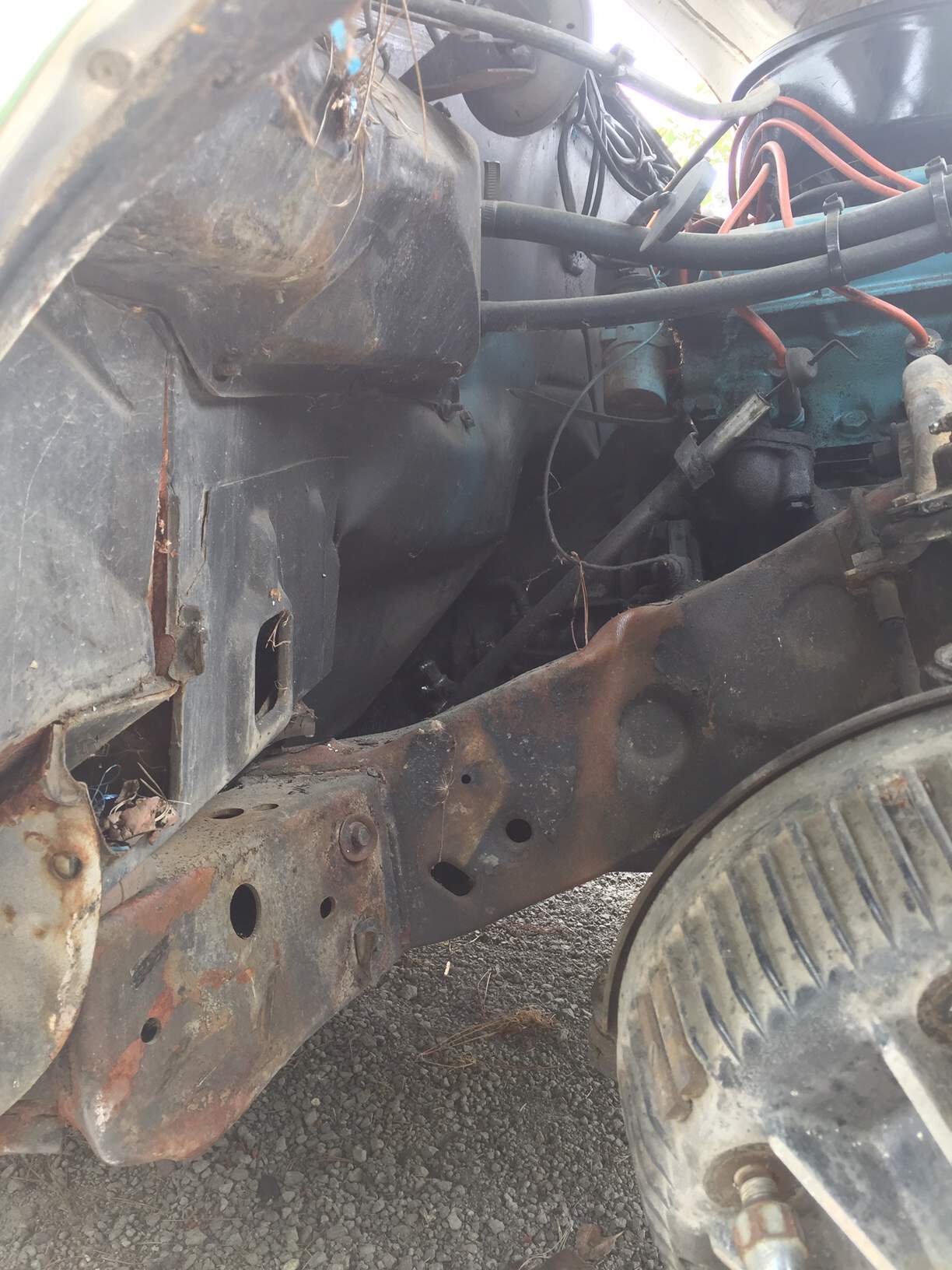

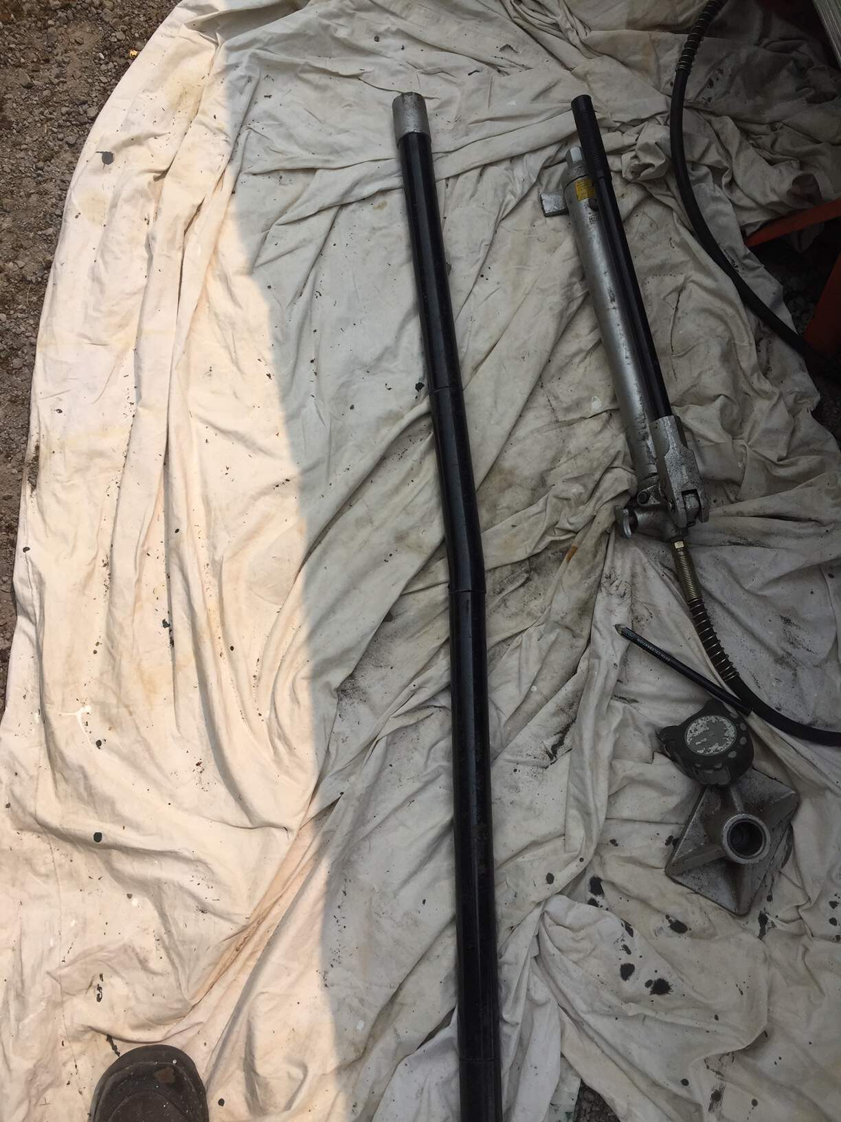

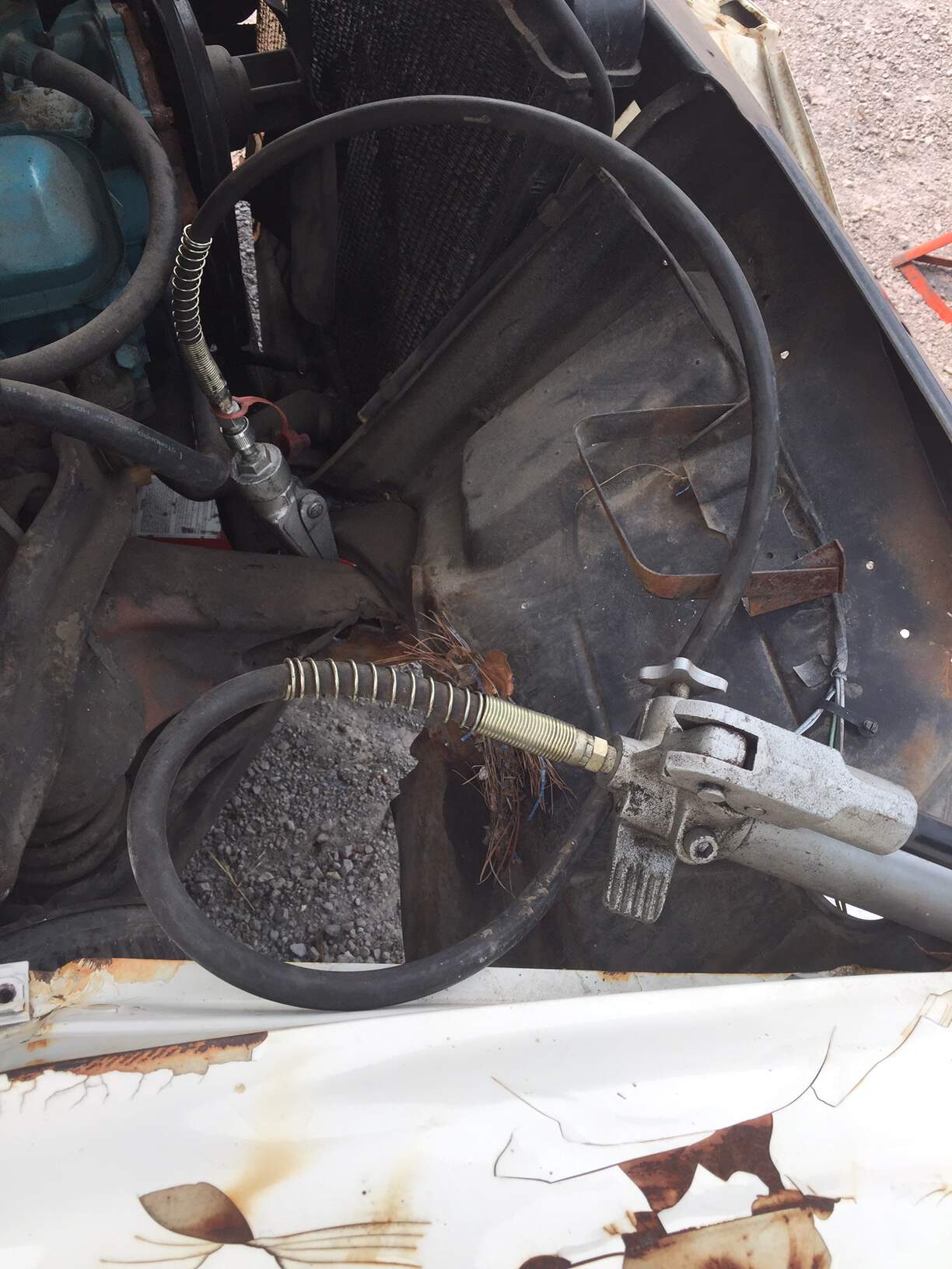

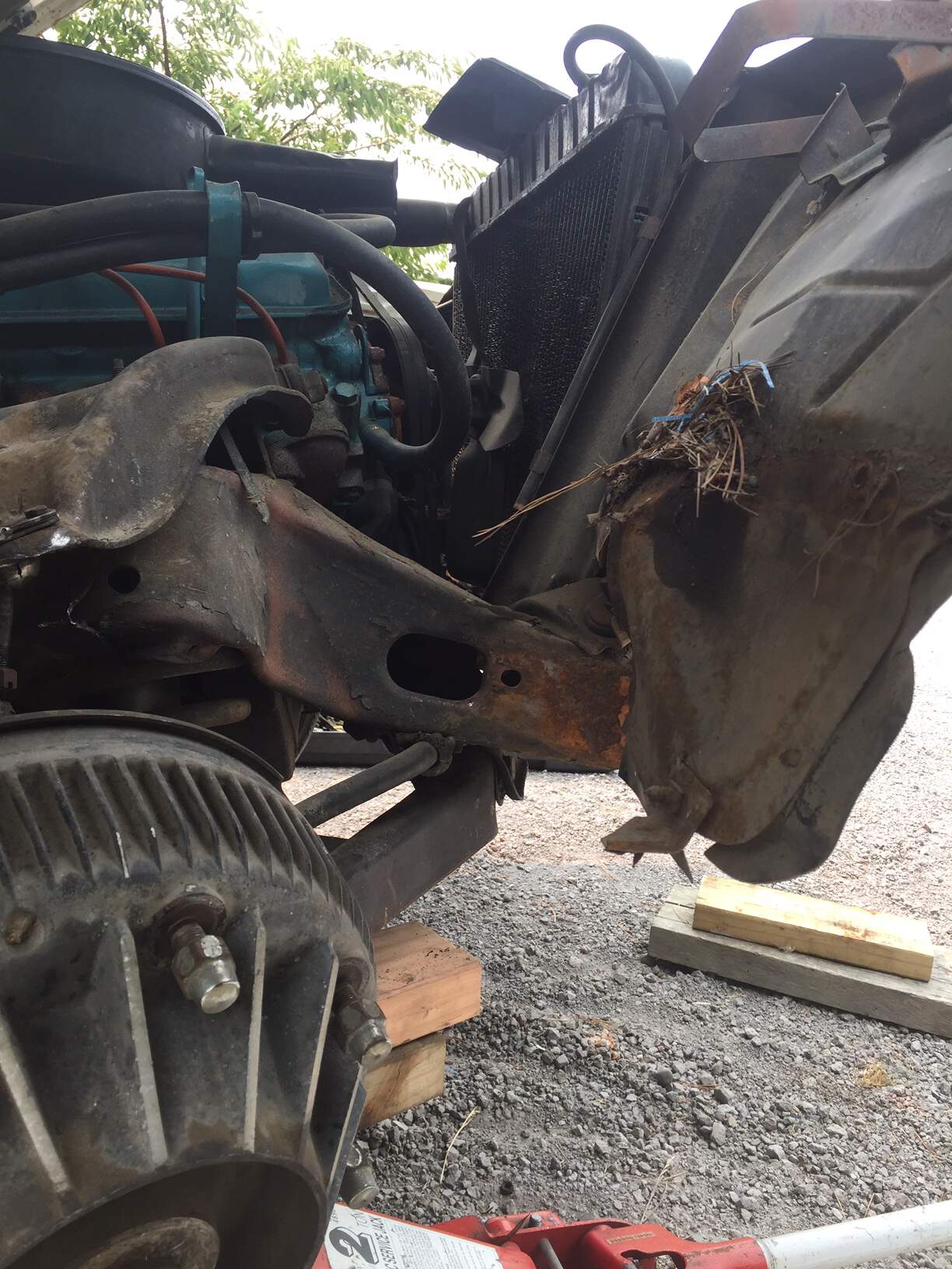

first i borrowed my good mates porta power, and it worked a treat..check the pictures
first push was parallel to the sill and it moved the frame about 4 inches forward, but i also bent one of the extensions doing it, so i will need to drop it off to my mate who can machine it straight again( hate breaking freinds tools)
Once i had moved the 90 degree section forward enough i then set to try and push from that point out through the from A arm to the bumper mount, i dropped the front hub to give me clearance
Then once i had that pushed forward, i moved the radiator support cross member forward off the fan
And by now it was 5pm and i was pretty much done for the day..... but not quiet.

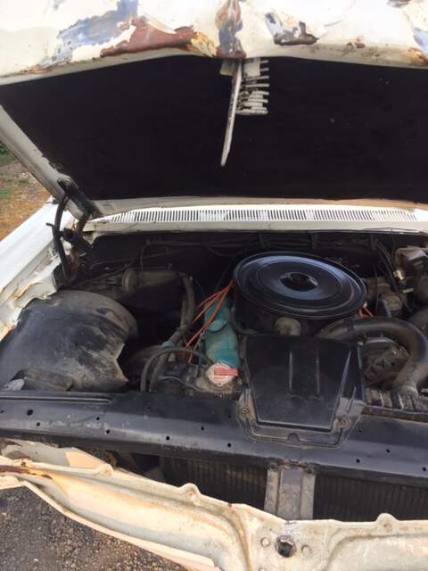

 now that i had moved everything off this motor i just had to give it a try and see if it would live !!😯
i hooked up a battery, and nothing!😖
so i pulled the ignition switch and found the contacts to the plug where corroded,,,, sand paper..
bang! she would light up the dash, and would turn over....👍
filled up the float bowl, and cranked.... nothing ...zip...
pulled the cap off, lots of spark at the points... sand papered the rotor....
bang!!! she started🍻😁

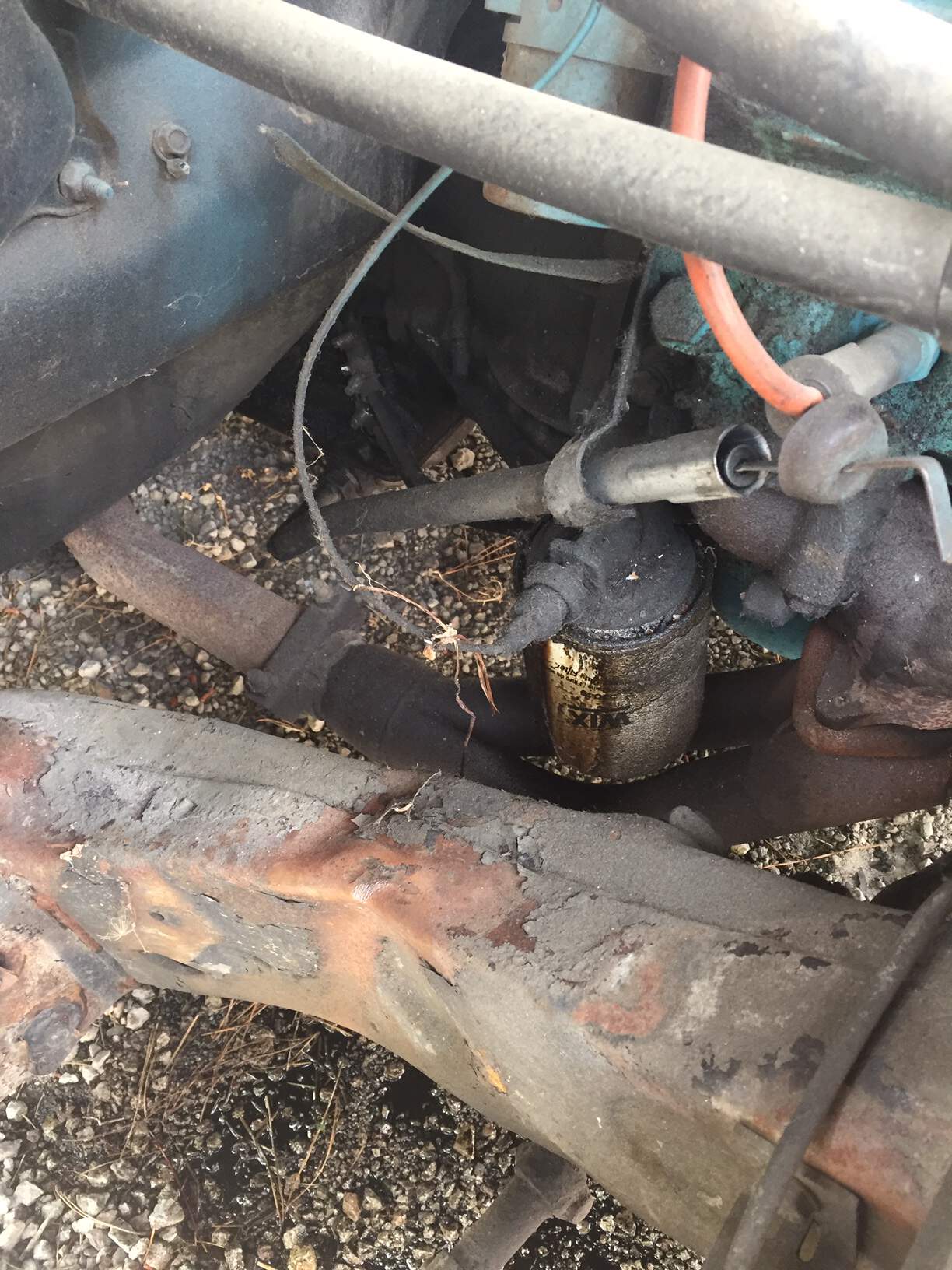

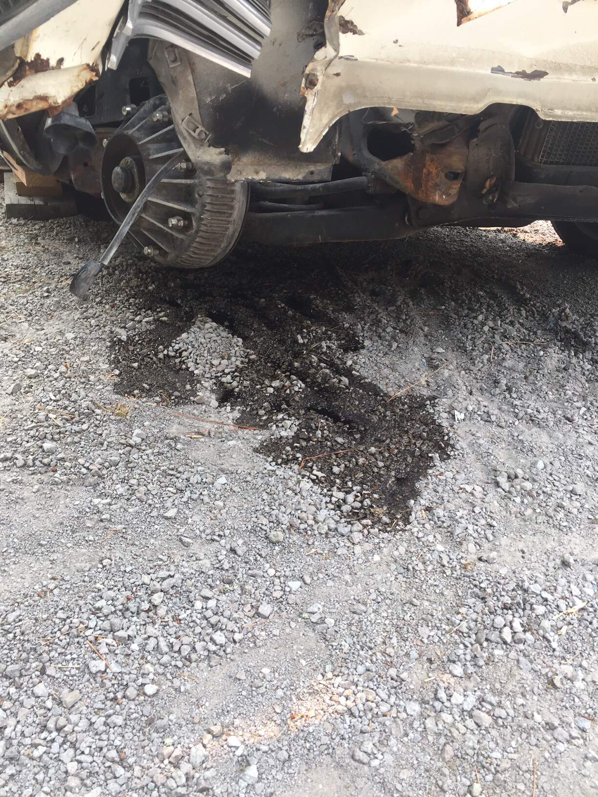

then i saw the oil!!!!
the filter had a puncher hole.
 so i shut her down....
clean up and call it a day.
i was so pleased that she ran and now i can move forward to getting her mobile and can get her into the shed onto the hoist for the next stage.👍😊

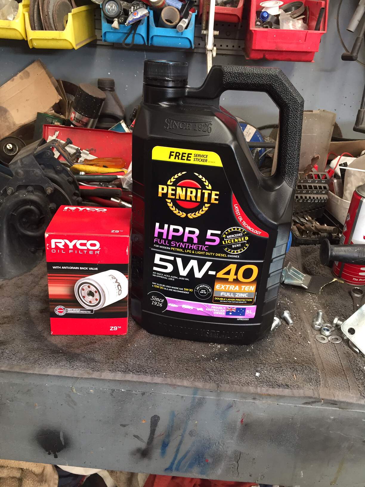

hi Guys, i would like your input here.
i want to run the engine again, but i will change the oil and buggered oil filter..see attached what i have bought... thoughts????🙄
i think it will be ok, and i need to know what trans fluid to get, shes empty!!

Hi kiwi boni,
The automatic transmission fluid (ATF) you want needs to be a DEXRON II or DEXRON III compatible ATF. You start getting into the more modern ATFs, and some shift quality problems are reported with older transmissions (e.g. unrestored/unrebuilt). You can also use a synthetic ATF or mix conventional and synthetic. However, my preference would be to use one or another.
Pontiac engines were designed with work best with 10W-30 or 10W-40 motor oil (according the late Pontiac historian John Sawruk). To get the engine running and moving under her own power and get through all the rebuild work you have in front of you, the 5W-40 is fine for now. I just would not continue to use it for the next 10,000 Km. Once you are ready to seriously drive the vehicle, I'd do another oil change.
I have no experience with the Ryco filters. I assume it is a Kiwi brand and it is the equivalent of the AC Delco PF-24 (OEM filter). Others North American brands are the Fram PH-25, WIX 51049, or Hastings LF212.
Good luck getting her started and moving. Keeps us posted!
Thanks Frosty for the great info, i will get a drum of dexron👍

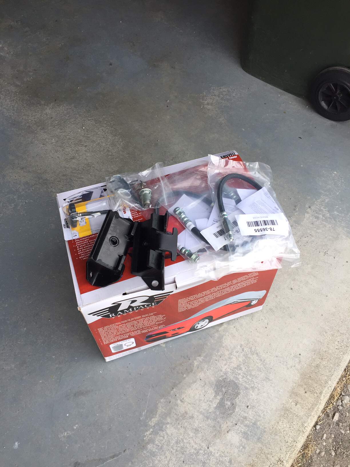

While waiting for the new frame ,i have been starting the shopping, and today my rock auto order arrived( first one)😋... its always xmas when these arrive! and always a fridge magnet too 👍
I got a cover for the period of time she will have to be outside and as you can see engine mounts, brake hoses and the boot lock assembly, and power steer pump cap, that was missingrockauto.thumb.JPG.4d316bffe72e865a945263b11952ec50.JPG
Rock auto have most of what i need, but i am still looking for the body mount kit, if anyone know were to look

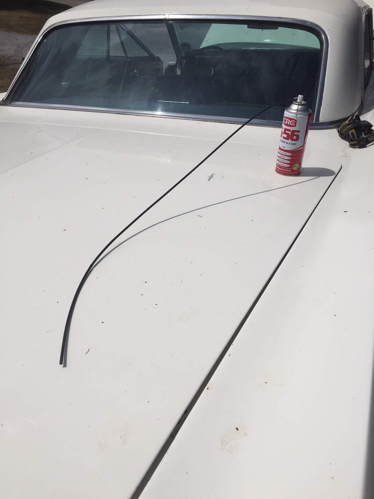

i have made a extension pipe out of heat shrink about 1/8 and attached to my penetrating oil.
on the end i have plugged it and pin holed 4 holes so the fluid sparys 90 degrees to the hose

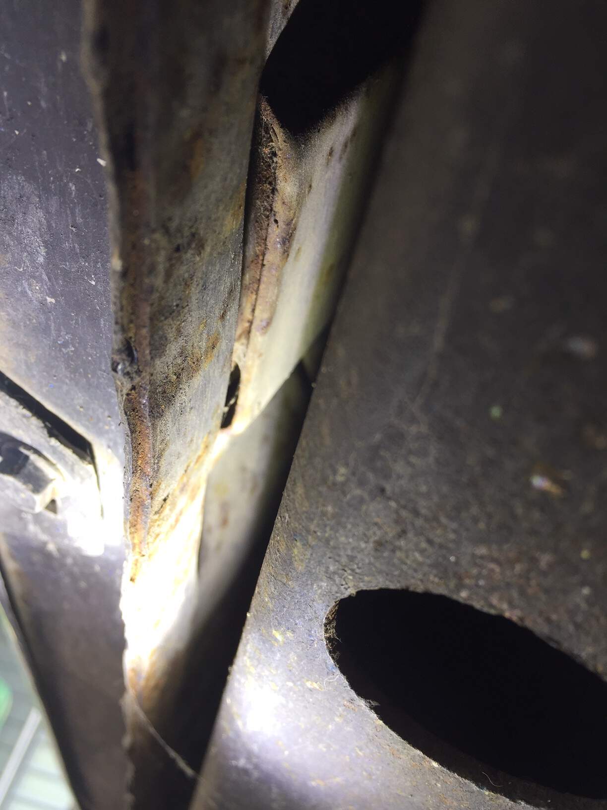

i found that each of the chassis bolts is attached to a sub chassis section with small opening that i can get this small tube up into so i can spray the heck out of the caged nuts along each side of the car, in preparation for the removal job.

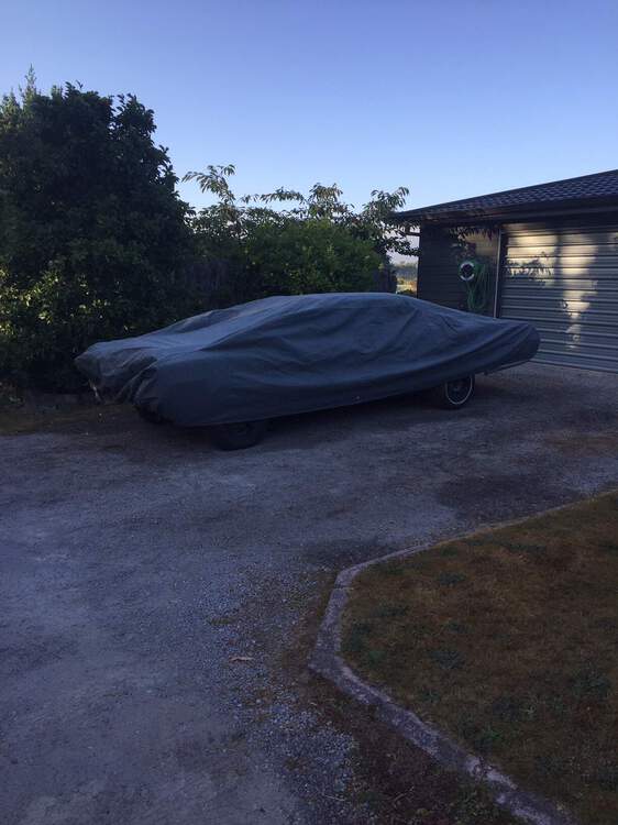

so i bought a good cover off rock auto and it fits really well 😋
