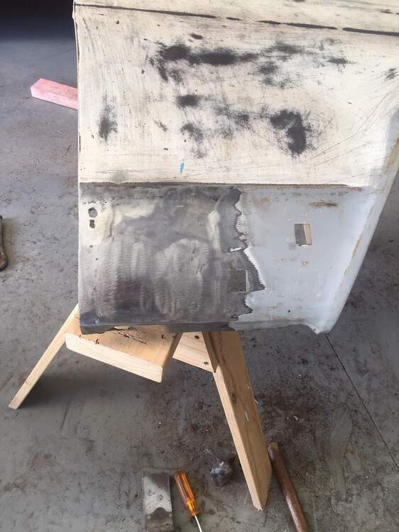

I really enjoyed tig welding in this patch, i had bugger all heat distortion and i could move the panel unlike when i used to mig my patches, which meant i can get it so flat that i am using less than a mil of filler.... and this patch is going to be under a big Chrome trim panel.... thing is... i know its there!!, so i am a little fussy just for my own thing.πŸ˜‹
i enjoy building them just as much as driving themΒ :cheers:
Tomorrow i am going to level out the imperfections with filler and i found 3 rattle cans of primer, so i will sand the whole fender and prime it.
Tungsten inert gas welding (TIG) is definitely better when using the foot pedal for heat control...Although it can be very tedious especially when welding out of position like in tight awkward areas or overhead and you have to operate the pedal with your knee or elbow/toes..butt..ETC..and have to be able to do it both right and left handed (Been there Done all of that more than once)..The main thing is to have the tungsten needle sharp when welding stainless whereas you want a little ball on the end when doing aluminum...Also the cleaner the base metal is... The better and easier it is to weld especially when doing paper thin or cast aluminum...Personally... By farΒ the hardest material to work with is cast iron...Just because of the prep work involved...Properly preheating and stress relieving is very very important and if not properly done the results will substandard and you will more than likely do more damage than good...
An expertΒ fitter can make a mediocre welder look good..The better it all fits together before welding...TheΒ less filler metal you have to use (tig)Β theΒ better the overall results will be and that's true for all welding processes MIG..TIG..and Stick...
The car is looking good and I respect the ingenuity and attention to detail...That is what makes for a truly top notch restoration....
Your dead right Two lane ! i made the patch panel as close as possible to butt fit and i dame near didnt need filler rod... and Yes, when i can i am going to buy myself a foot pedalπŸ‘

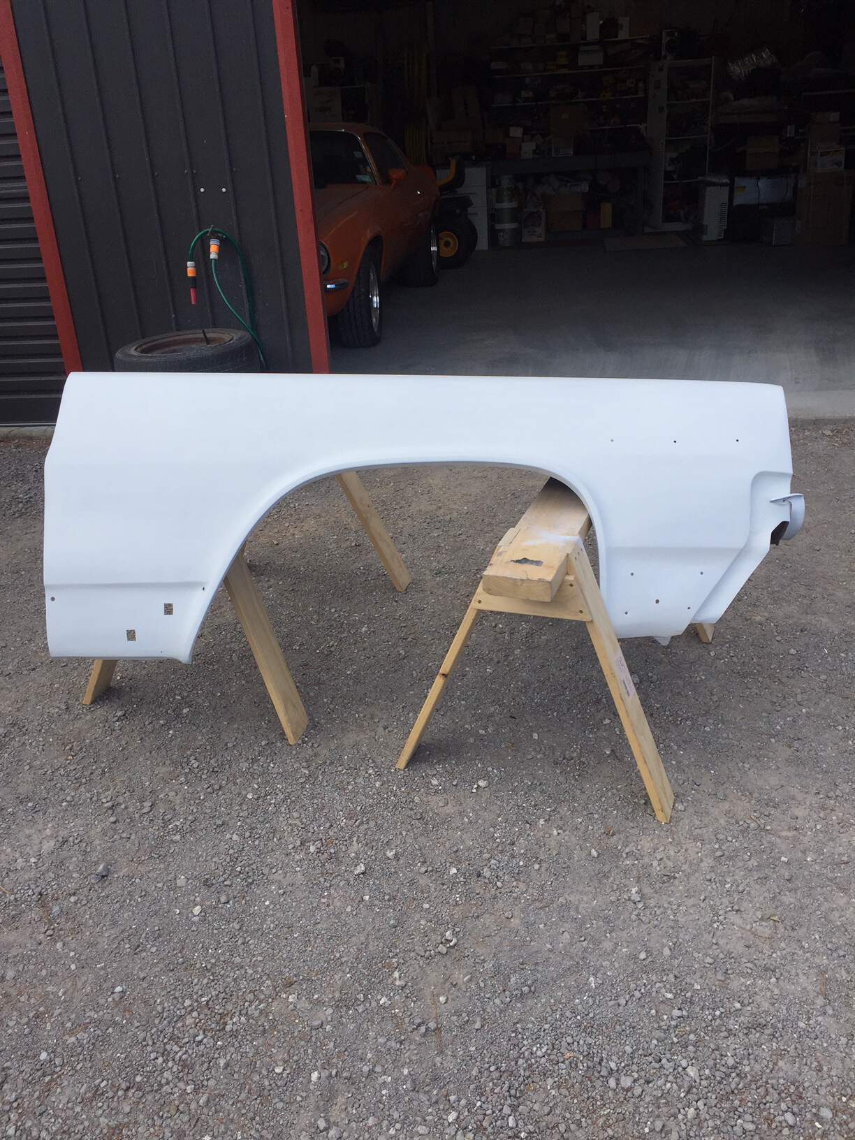

Spent the day sanding and priming and i still think its rough, it will need spray putty to get all the sand marks out, rattle cans just dont cut it for coverage.
Β i need a couple of litres of Real primer!!
i did fishoilene the inner fender just to make sure it doesn't rustΒ πŸ‘

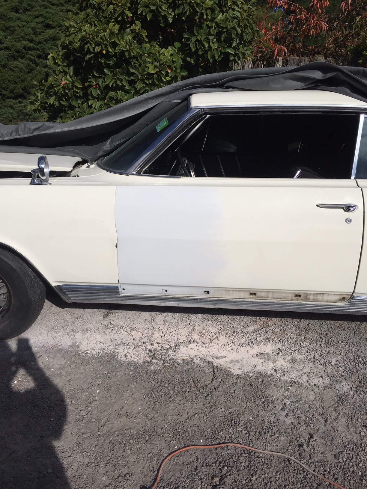

And got the drivers door smoothed out too, same thing, i need filler primer to get all the scratches out.
Nice job,Β I can't see any sandΒ scratches.
Great job! We love to see Pontiac’s being loved!
Haha, phone cameras tells soooo many lies mate !!Β
Β a nice coat of high build primer and a wet sand will get rid of them... even the wife says it looks fantastic!!.... when are you fixing the front sheΒ goes.... i reply.... when i get my CHASSIS !!

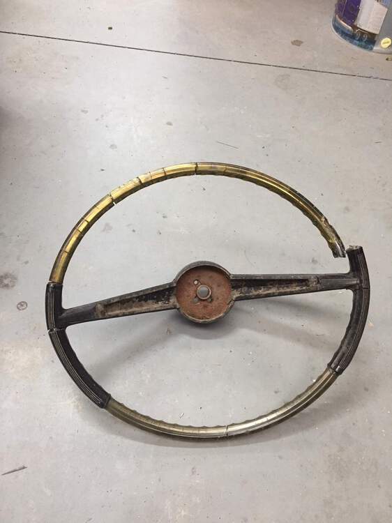

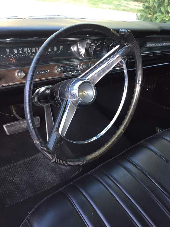

I need some input from you guys about what to do with my steering wheel..... i could just buy an after market wheel and stick it on... that would be the easy wayΒ Β out.πŸ˜‹
But i want to try and save this steering wheel, any one had and experience with rebuilding a wheel like this with clear sections ????
Β any advise would be great .
Β and i am not scared of trying to weld it up and making a mold etc... never done it but keen to learn:dancingpontiac:
or... does some one have one for sale ????

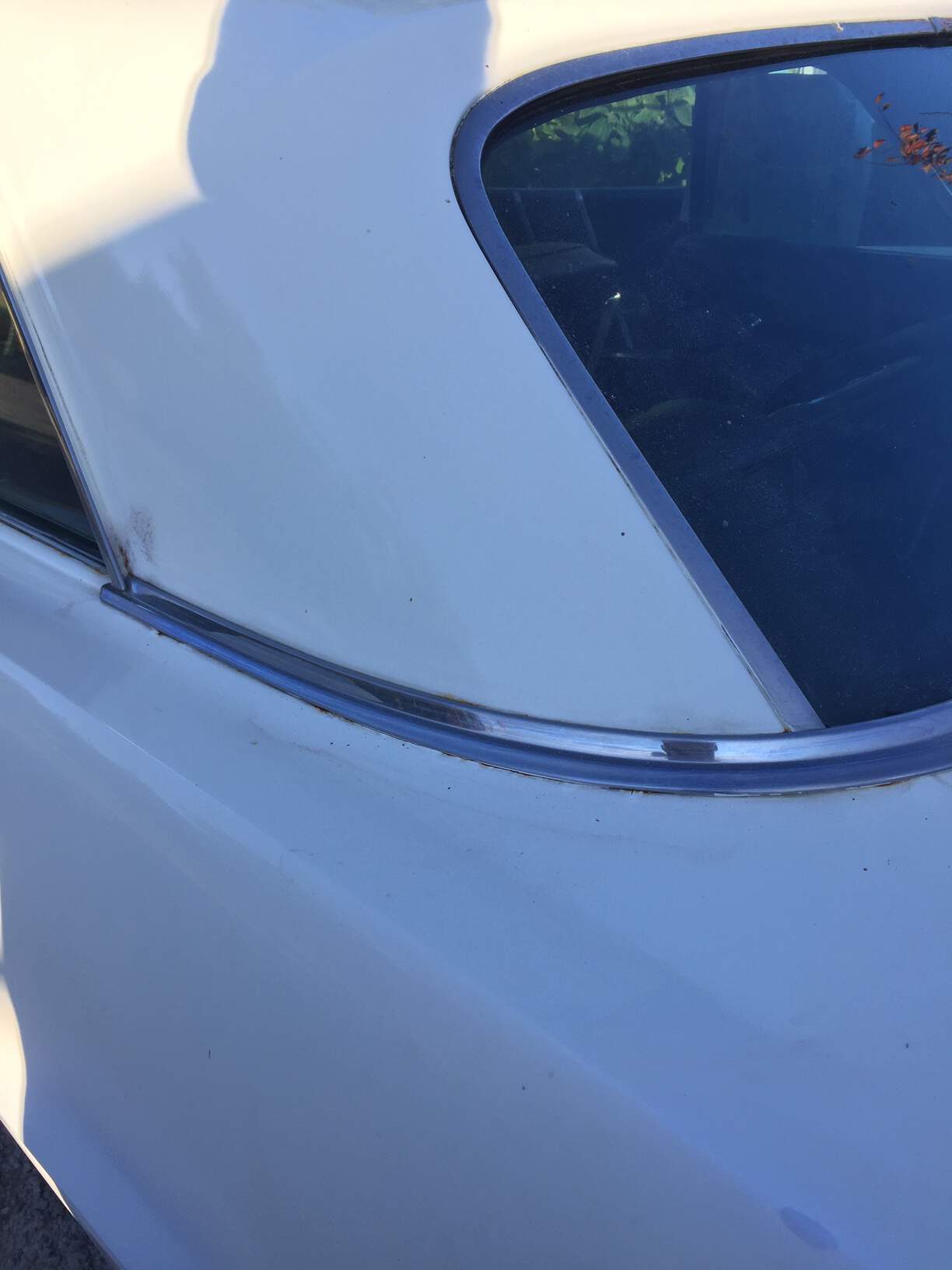

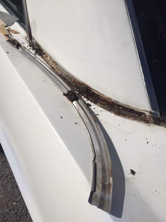

The other issue i had today is i have a spot of rust under the rear window trim and i want to remove this trim.... i would really!!! like some input as to how to remove this trim with out stuffing it up!!
 hope one of you has been there done that, and can give me some advise....😦😦

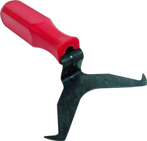

Most OEM stainless window trim can be removed with what I call a J-hook tool. You can probably fab on yourself out of flat sheet metal or perhaps a mate of yours has one.
Here is what a commercial one looks like. Basically you slide it along to release the clips underneath the trim carefully.
As for the steering wheel. I might be inclined to weld it up straight, use epoxy to repair all the gapsΒ and then sand, primer,Β paint it a solid complimentary interior color and skip saving the clear acrylic for now. Try to get a replacement wheel from the states when the madness calms down and you have the cash. Like you, I preferΒ the OEM look versus an aftermarket wheel.
Check the backside of that heavy trim.Β  May be screwed on there with nuts, most of the rest would be removed with the hook tool.Β
Ok! Bit of a long winded answer, sorry! Both Frosty & JustA are correct with a caveat! The window trim would use Frosty’ tool! Not his tool, but the one he showed.:rofl:Β The upper trim that wraps around the window? It depends on what kind of clips are used? That I’m not sure of. So you might be able to use the window trim tool, but Β my guess is it could be what I think JustA I suggesting. You have to remove the inside panels and remove a nut.Β
I actually think it’s another type of clip though. This type of clip has two upset lips on each end that snap into the inside groove of the trim on each side. Possibly with a nutted clip at each finished end. I would take a couple plastic body filler spreaders at the rear glass area and insert them, one on top of the other, under the trim. This should raise the trim up. If it doesn’t raise it enough to see under the trim useΒ a broad blade putty knife between the two spreaders to raise it more to see if you can tell what type of clip. Once that is known removal will be much easier.
The steering wheel! Well obviously you have to pull it. I think Frosty’s on the right track! Β Clearly you have to get rid of all the plastic on the ring. If you can pull the broken section back in place where the ring looks round & you can weld it that’s the simplest. But you more than likely will have to cut the plastic on the two arms backΒ as well. Than getting a material that will adhere to the old existing plastic and fill the rim without cracking may be a challenge. I have a few thoughts as to how you might restore it as best you can without sending it to a restorer, but see what you find when you take it apart first.
Thanks Frosty... i will make one of these!!!
thnaks Last Indian, i do exactly what you have suggested, and tonge in cheek it dont stuff it !!!😦

i am going to pull the wheel and break it down, and i like the idea of the stone top epoxy, i have a mate who owns a bench top factory, he will have this stuff, and like frosty said, for get the cleary and just go solid colour:cheers:

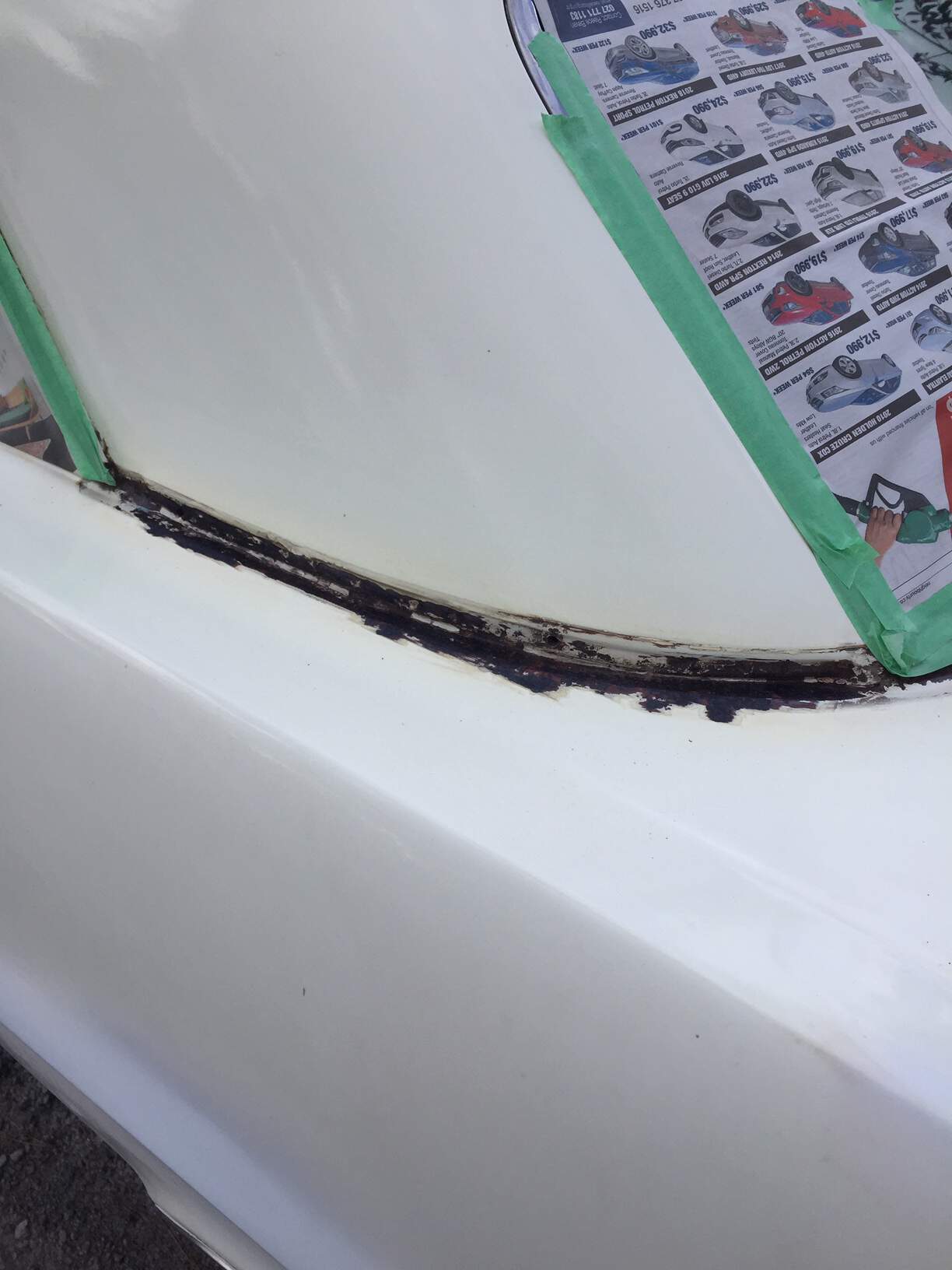

Pulled the belt line reveal off, after i had removed the interior trim and found 2 nuts and another in the bootπŸ‘Β thanks guys,, i was thinking they where just clips pushed in.
i was lucky as its just surface rustΒ only, so i have treated it and primed.
But the retaining clips are buggered, and i cant find anyone who is selling them, which brings me to this question.Β
Being a 2 door hard top identical to a 64 impala, could the trim be the same... if so i found these guys sell the clips
Β Β https://www.thepartsplaceinc.com/product/1964/1964-chevrolet-impala-caprice-bel-air-rear-window-belt-reveal-molding-clip-kit-lower-c9082/81172

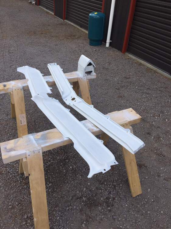

Front grill support panels primed and just like the fender, they will need a bit more attention when i can get my hands in some hi build primer surfacer.Β
Pulled the broken steering wheel off and you can see where its not broken, it has been cut !!, there is cut marks like a jaws of life have chopped it:o
So i have straightened it, mig welded itΒ and Last Indian has given me the idea i can fill it and file it. So i have tonight filled it with a 2 pot epoxy polymer and lets see tomorrow what its like and hopefully i can get too and start filing it.
i am guessing that the wheel is covered in an acrylicΒ  plastic ??? its certainly not Bakelite.
Β My plan is to sand it flat and paint it Black, but what paint to use on this material... and as always at the moment, do i have anything in the shelf that will do it... i am running out of supplies real quickΒ Β and we still have 2 more weeks of complete lock down, prime minister today is talking 23 April moving out of full lock down to a level 3... which means i can get back to work!!Β
weee hee !! before my company goes completely bust 😑
