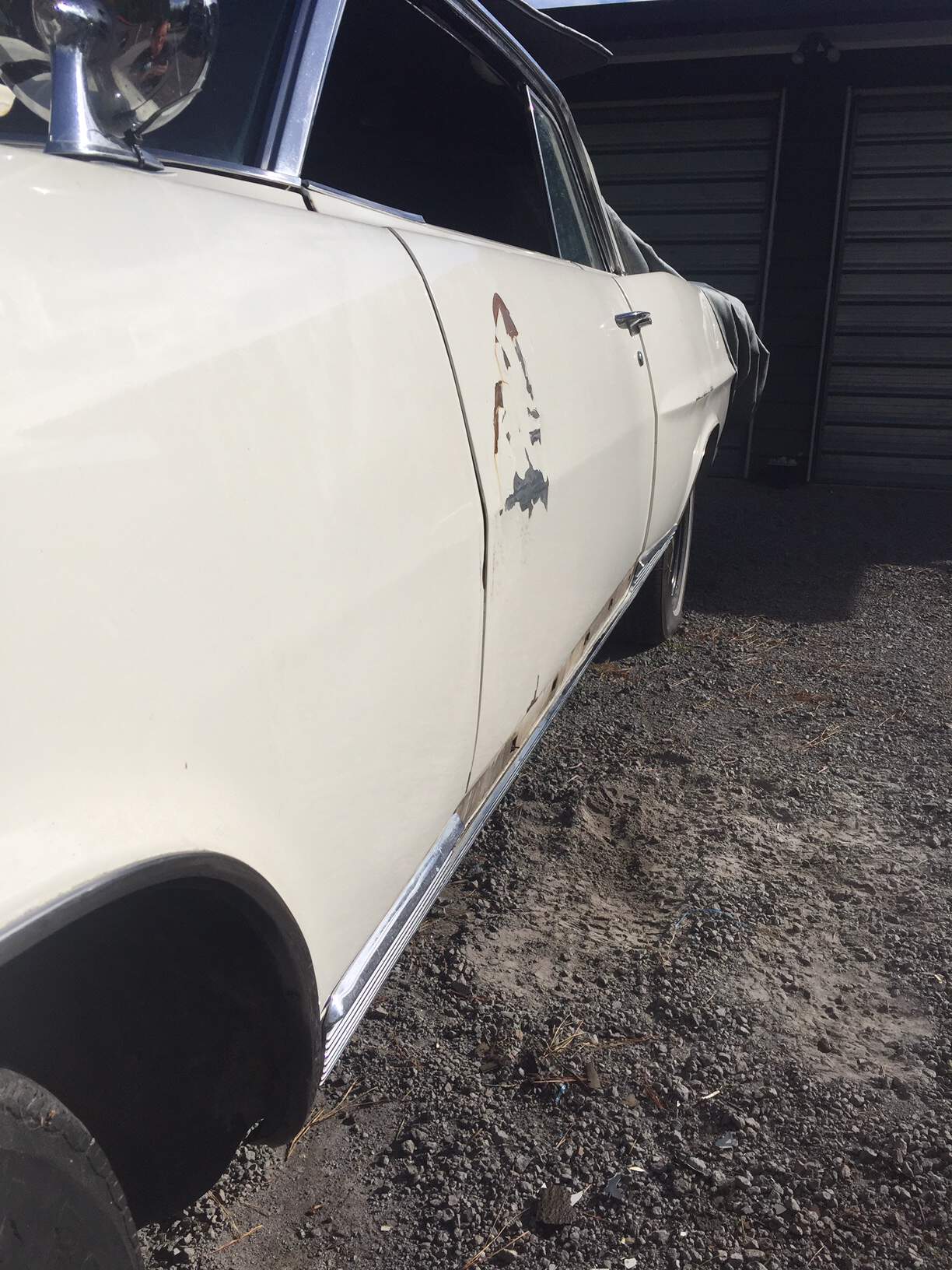

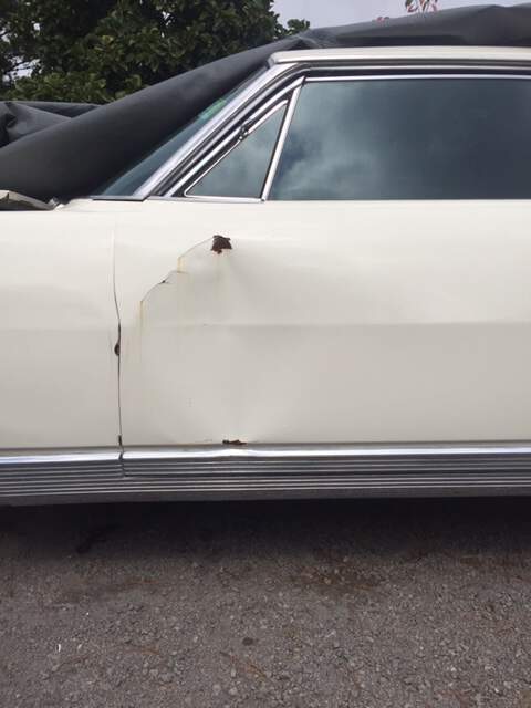

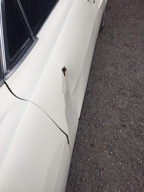

first project is the drivers door dent

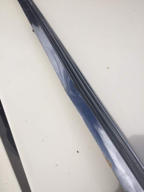

The muck metal trim along the bottom had a small dent and i managed to press it out with a bit of timber and the vise
So then i hit the door with my pro tools,,, hammer wood dollys , pretty much got it all out and it will need a small tickle after i take the paint off.( this is not my trade, i am a plumber/gas fitter)
 i did have to strip all the window out of the door too and found a window mount broken, will get that sorted tomorrow 🤨
 but i have made a start, its going be hard with out materials but lets see how we go, i do have quiet a bit of gear that may help.
i just cant get her into the shed just yet, so i will try and leave as much paint on as i can since its autumn here.

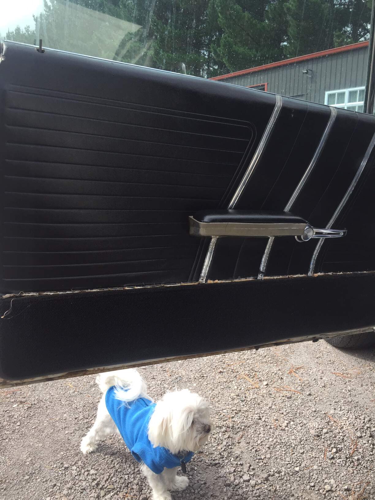

On the door trim the chrome trim along the bottom was missing( i have a replacement) and when i removed the door card i could see why it was missing... the card was buggered.
 i will need to make a new one and transfer all the upholstery over to the new door card

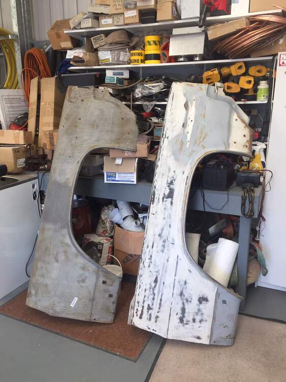

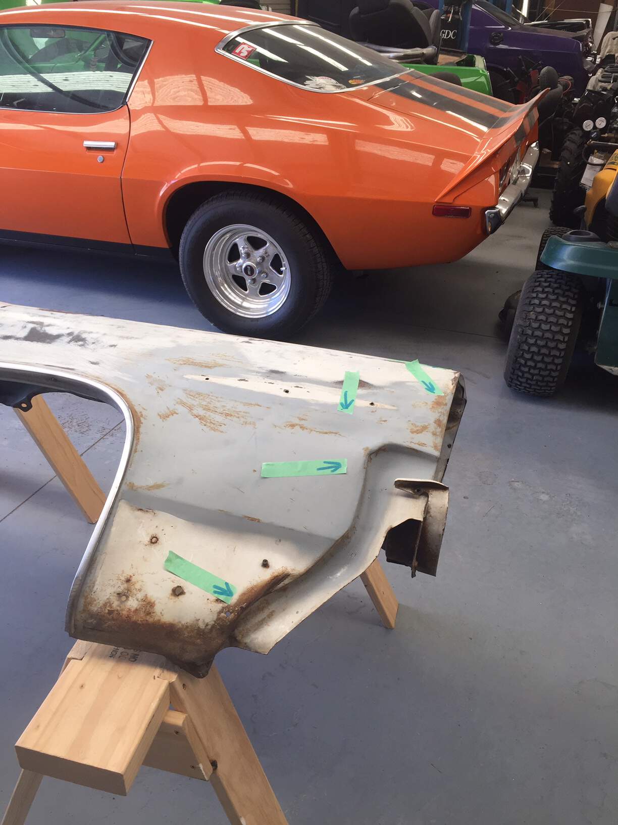

My next job is to sort a new fender for the passenger side, i have 2 and both need work... question is which one, so i made the decision and i am going to fix the white one
 i have made a bit of a plan and here are the areas that need attention
i took the old fender off the car, as i thought i could use the rear lower section for a patch panel, the bottom bolt under the rear of the fender spin the caged nut!!!!! so i had a few choice words... then hit the mother f__ _ker with the grinder
this just reminded me what justa6 was saying about the fun of removing the chassis!...looks like i will have more fun to come !
then once i had the fender off, the same area was rusty, so it was usless to me. time for plan "B"... make a patch panel form scratch.
best part about this is tomorrow is another day and as long as i do the jobs the boss wants done first, i get the best part of all afternoon to do my stuff  :dancingpontiac:
 We are in day 6 of a 30 day complete lock down, told to stay at home. this whole thing is like being in a movie:o

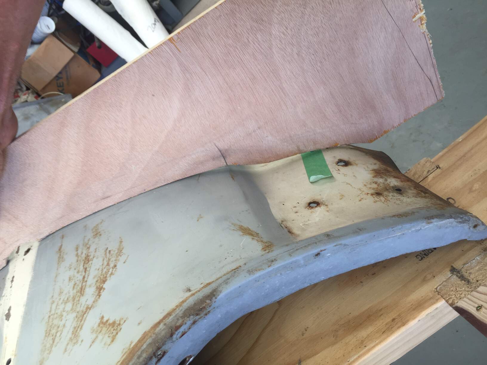

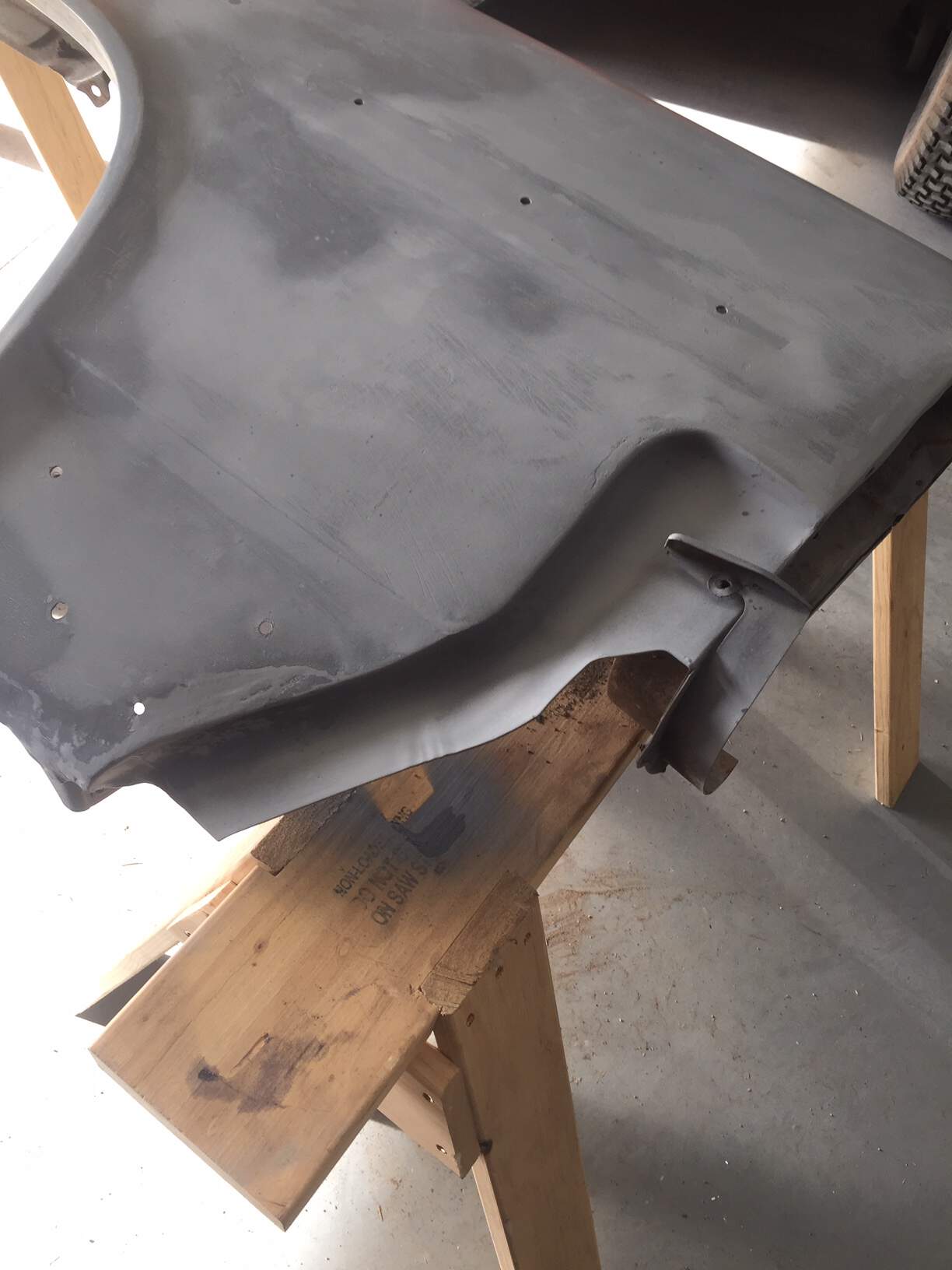

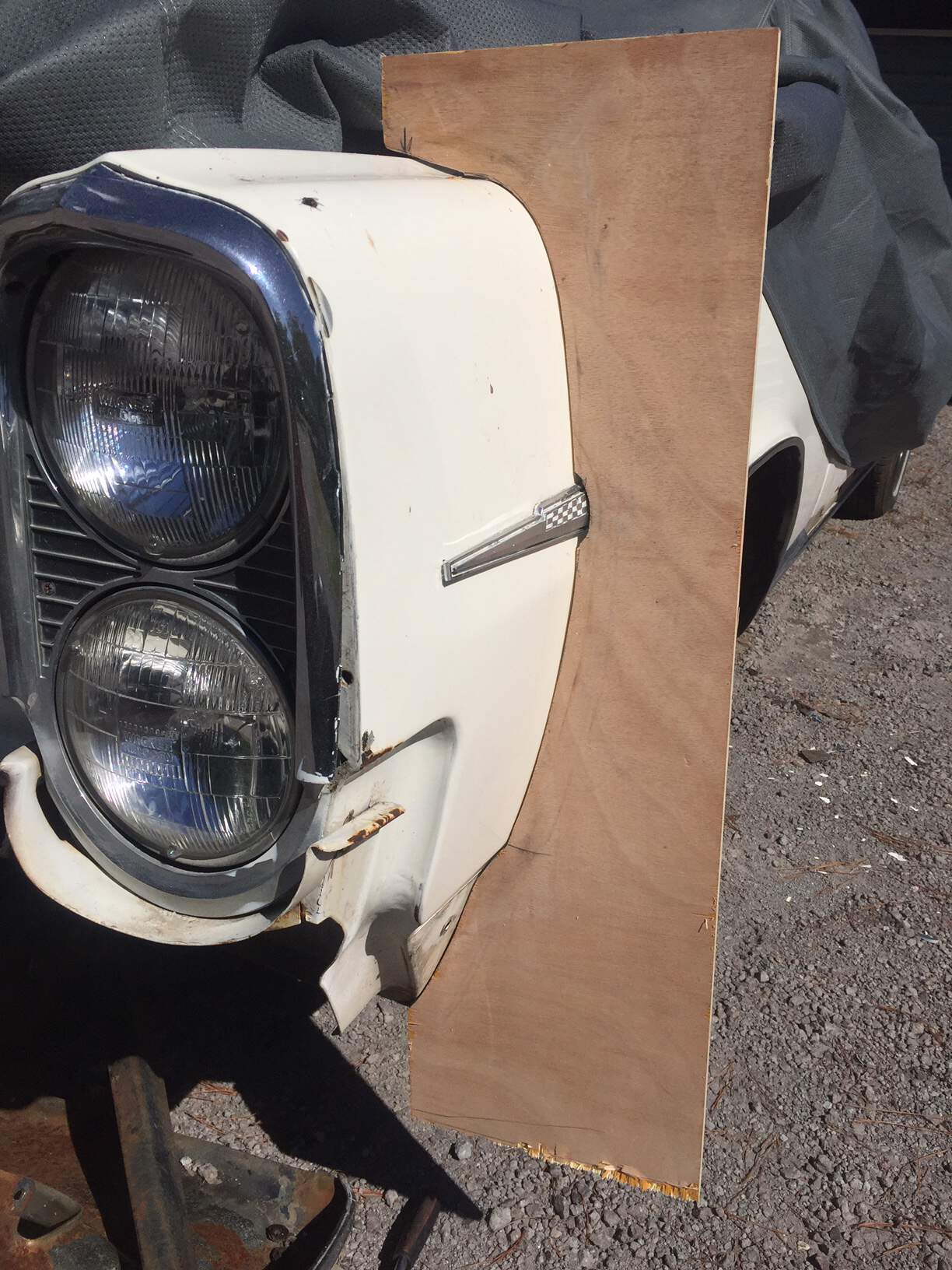

Then... i get to do my stuff... smoothed out the dents in the front of the fender...by making a profile from my good fender, then made the new left hand one look the same.
 its the best i can do with out mounting anything,,,in a real world i would be fitting the fender to the body and then twigging it, but with my frame still bent, it justa nota gona worka 😋

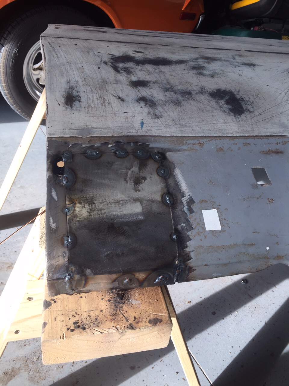

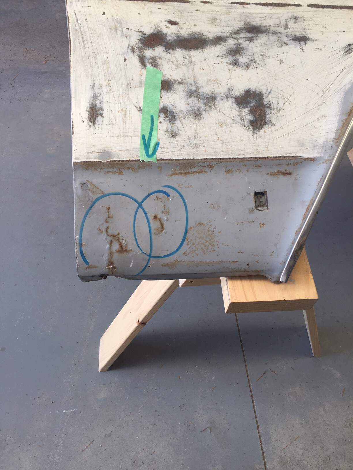

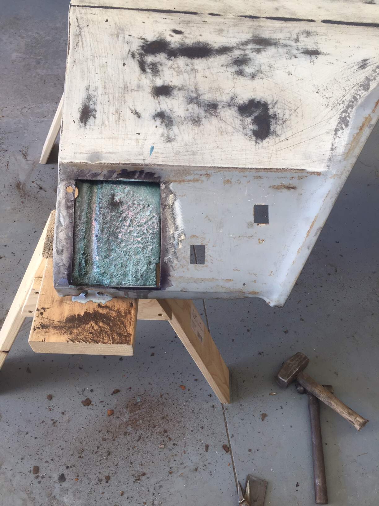

Next was to remove the rust and fit a patch panel... i am using my new tig welder and still learning how to use it, way less heat than fusion welding and way easier to panel beat than what i used to do with my mig welder..
oh and had to cut in the trim holes as this fender was not off a bonny so it didnt have the correct mounts for the chrome along the bottom
 you never stop learning in this world !!😜
Dude, you are being very resourceful and imaginative in your repairs of that fender without a full chassis and body to mount it to. Kudos to you bro. Time for Speight’s, don't you think?

Haha, yes i have had lots of time to think about how to attack it Frosty, its the tig welding that is challenging me, years of fusion welding have helped but i really think i need to buy a foot controller so i can modulate that heat.
