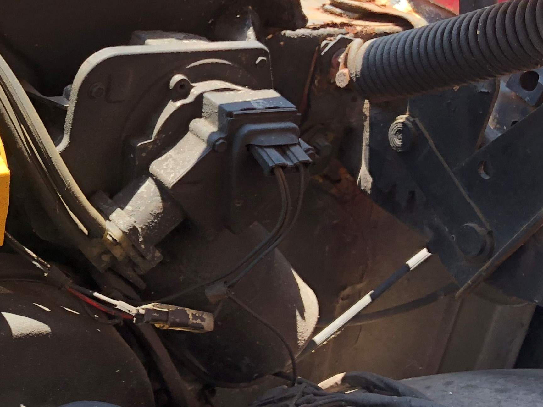

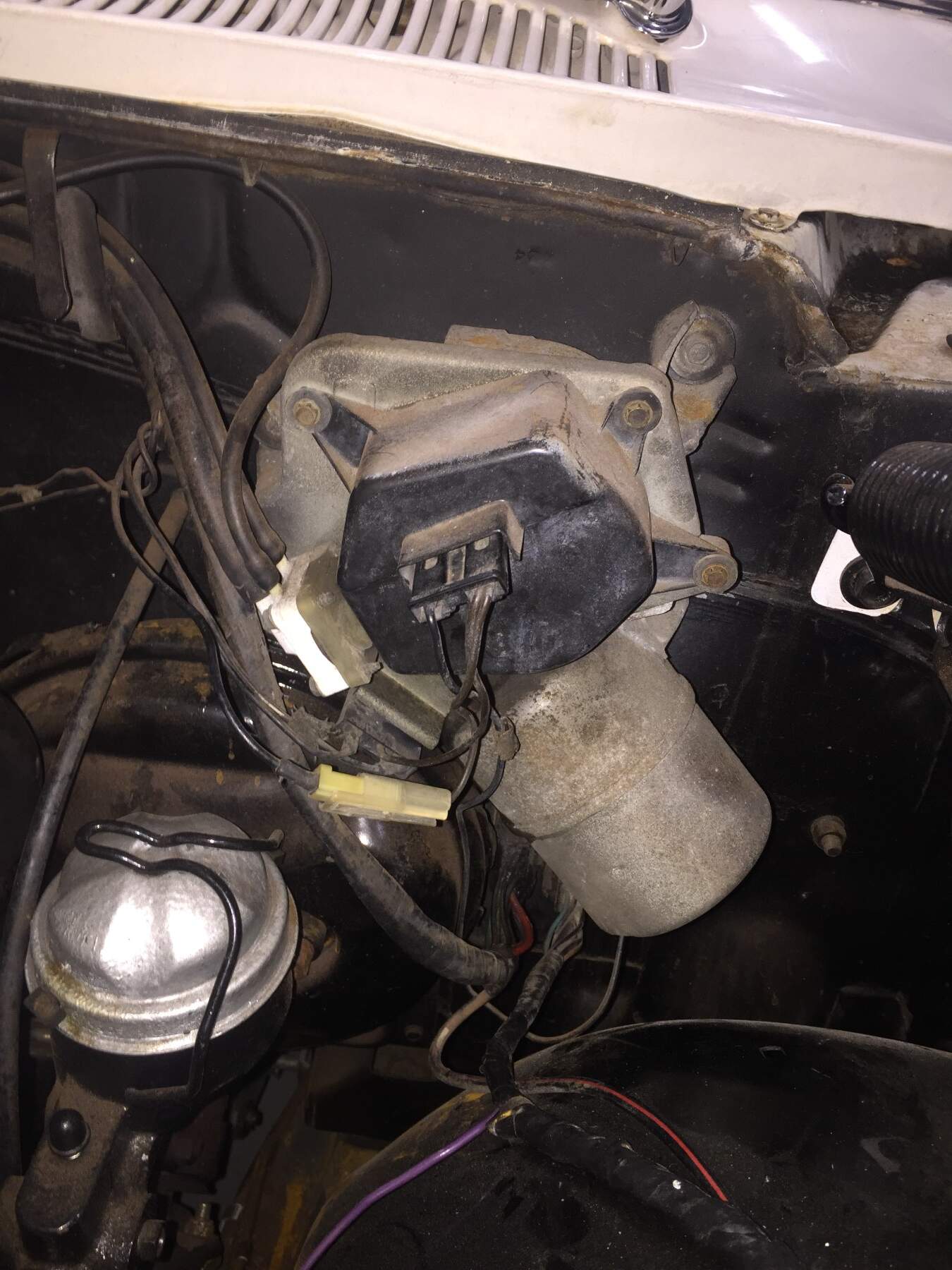

like fitzy my window washers didnt work ... I looked at the wiring diagram but it doesn’t show the wiring to the washer pump !
I was expecting the pump to have its own motor ... no such thing ! It’s a diaphragm with a push rod ..
and this is where I justA had to laugh !!
When you push the button on the wiper control knob I could hear a click ...

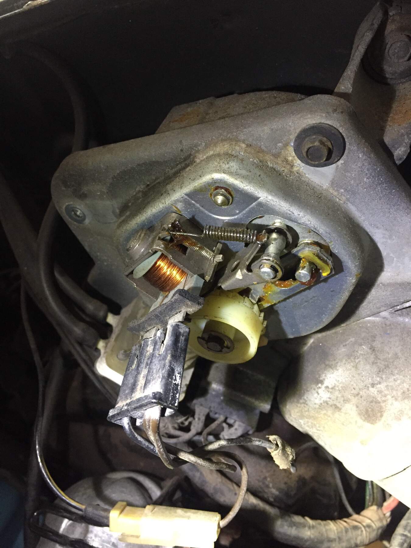

I take the cover off the wiper motor to find a solenoid operating  gate .... this gate locks and unlocks a wheel , with teeth on it !!! What a crack up ! I have never seen anything like this before !!!
When you press the wash button you actuate one full turn of this wheel with teeth on it , the plunger moves back and forth pumping the diaphragm / pumping water
all that was wrong with the system was it was lacking lube... a quick squirt of crc and it all worked perfectly !!!
One very easy fix 👍👍👍

Does you wiper motor look the same mate ?

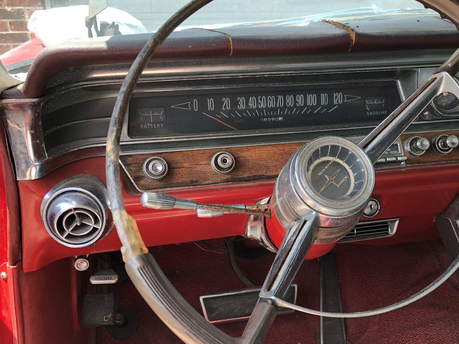

This is an old picture bro, before I pulled the engine. But I believe it looks the same. I haven't messed with it yet. I need to find another wiper switch first. Mine is missing the little button in the middle.

yip that looks very much like mine mate, i can see the double brown power supply going into it , which loops off and feeds constant power down to the wiper motor, and the push button you are missing is a earth switch to that black wire that trips the coil to make the washer pump operate.... its really kinda cool how it works.... the guy who designed it must of had a meccano set when he was a kid!!!:rofl:

It's defo primitive engineering. A simple modern electric pump is so much more efficient and simpler. I don't know what the GM boys were smoking back then but it must have been good shit.
maybe a steam locomotive went past their window mate when the guy was designing it... because it looks justA like a piston pumping !! :rofl:
