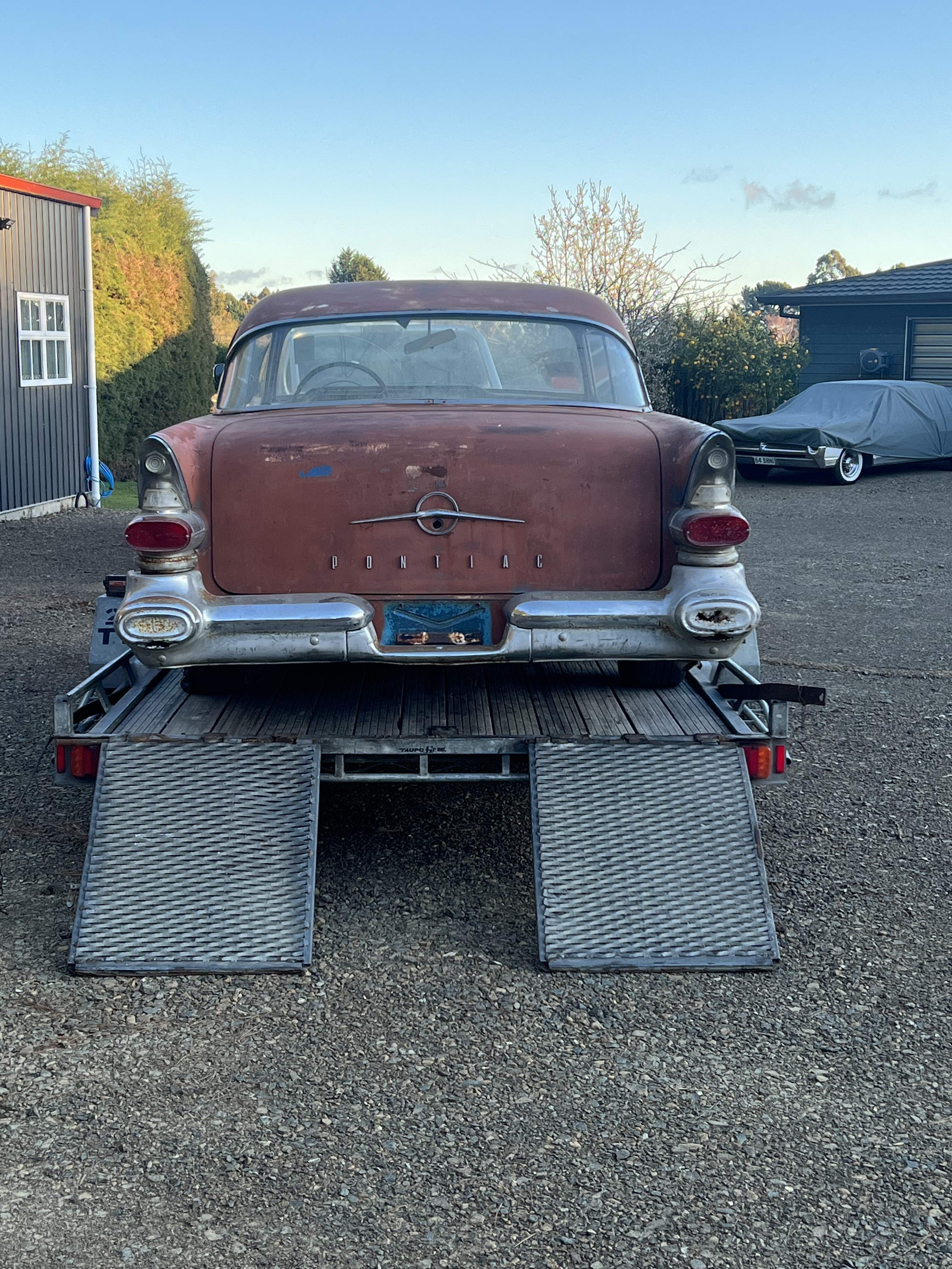

See if can get Louie to stand by the trailer tomorrow and I will take a picture …. If I ask him ( the cow ) nicely !!:rofl:
Β
Thing is he’s such a lazy cow I will need to. Con him with hay just to get him to get near the trailer ! … I will try …. Watch this space !Β

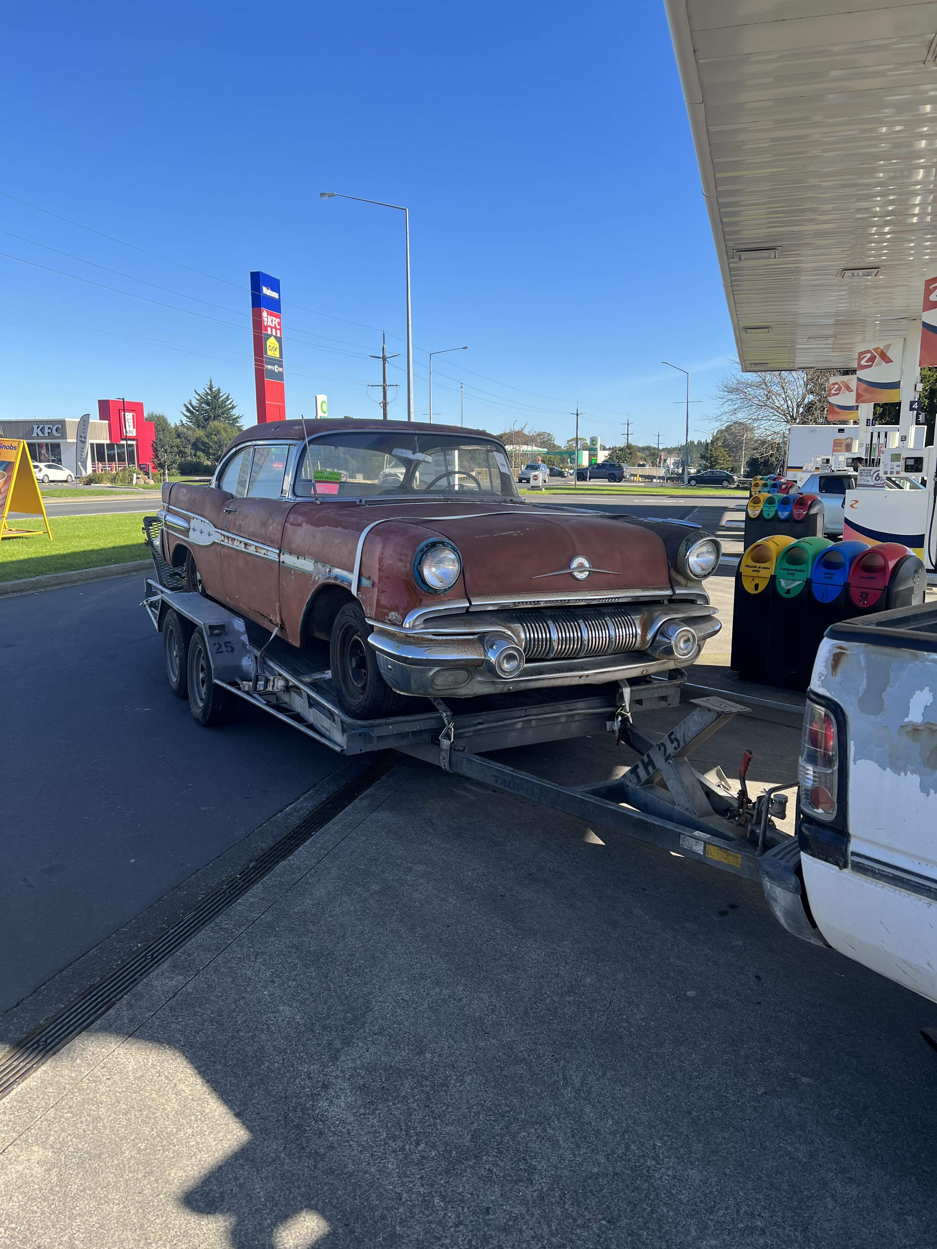

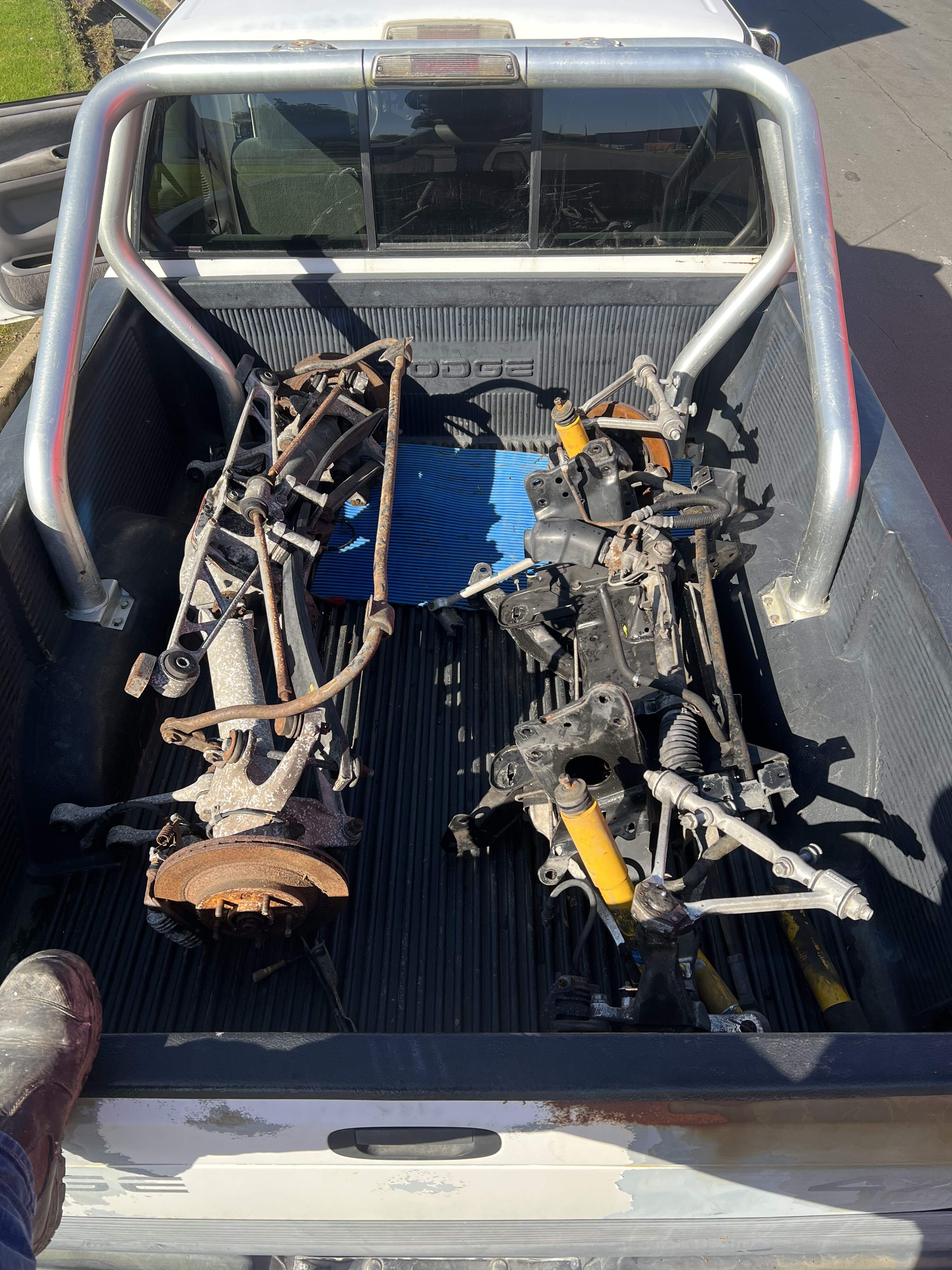

First stop is to pick up my c4 suspensionΒ

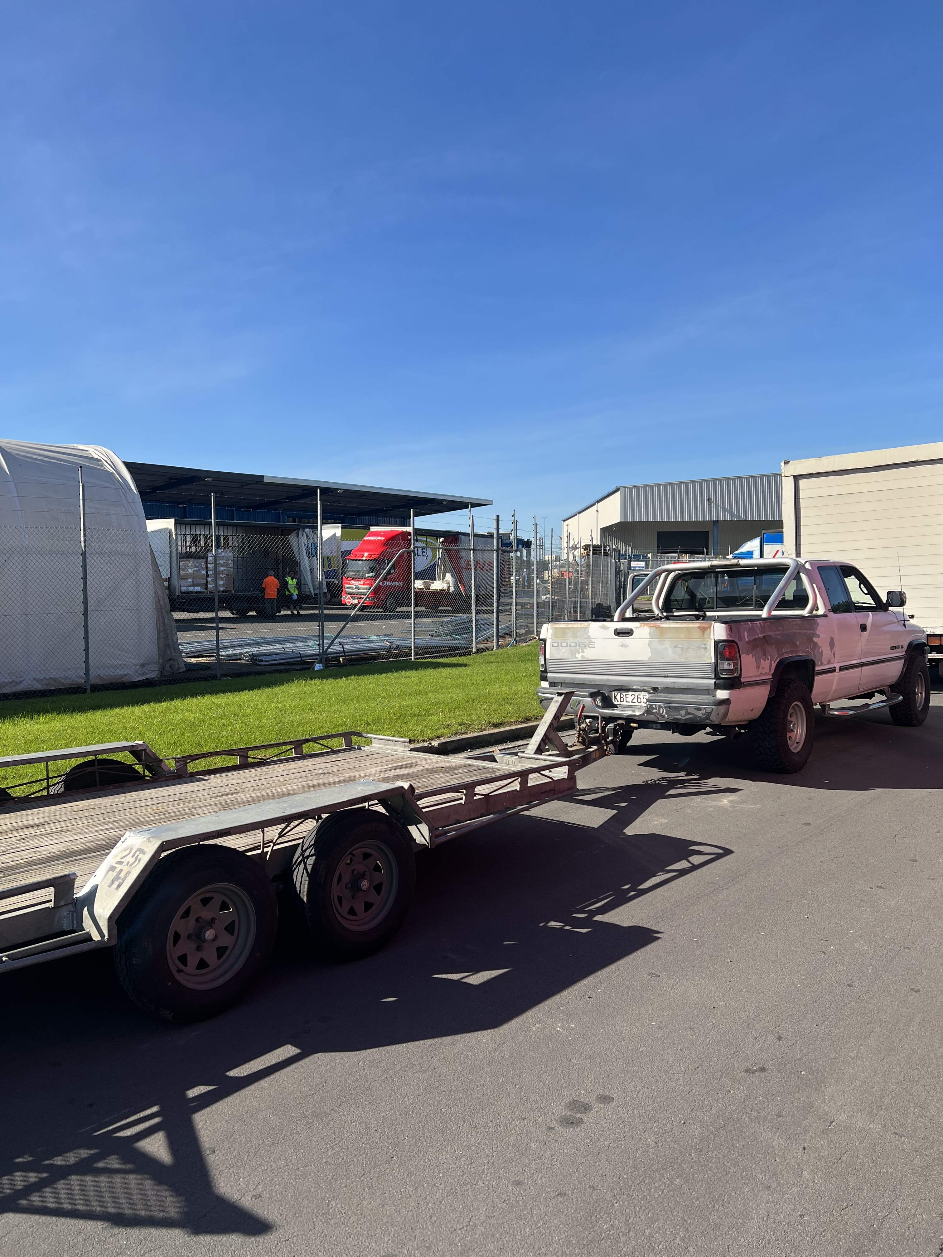

And now in a que at the shippersΒ
waiting waiting waitingΒ
:willy_nilly::willy_nilly::willy_nilly::dancingpontiac::badGT:

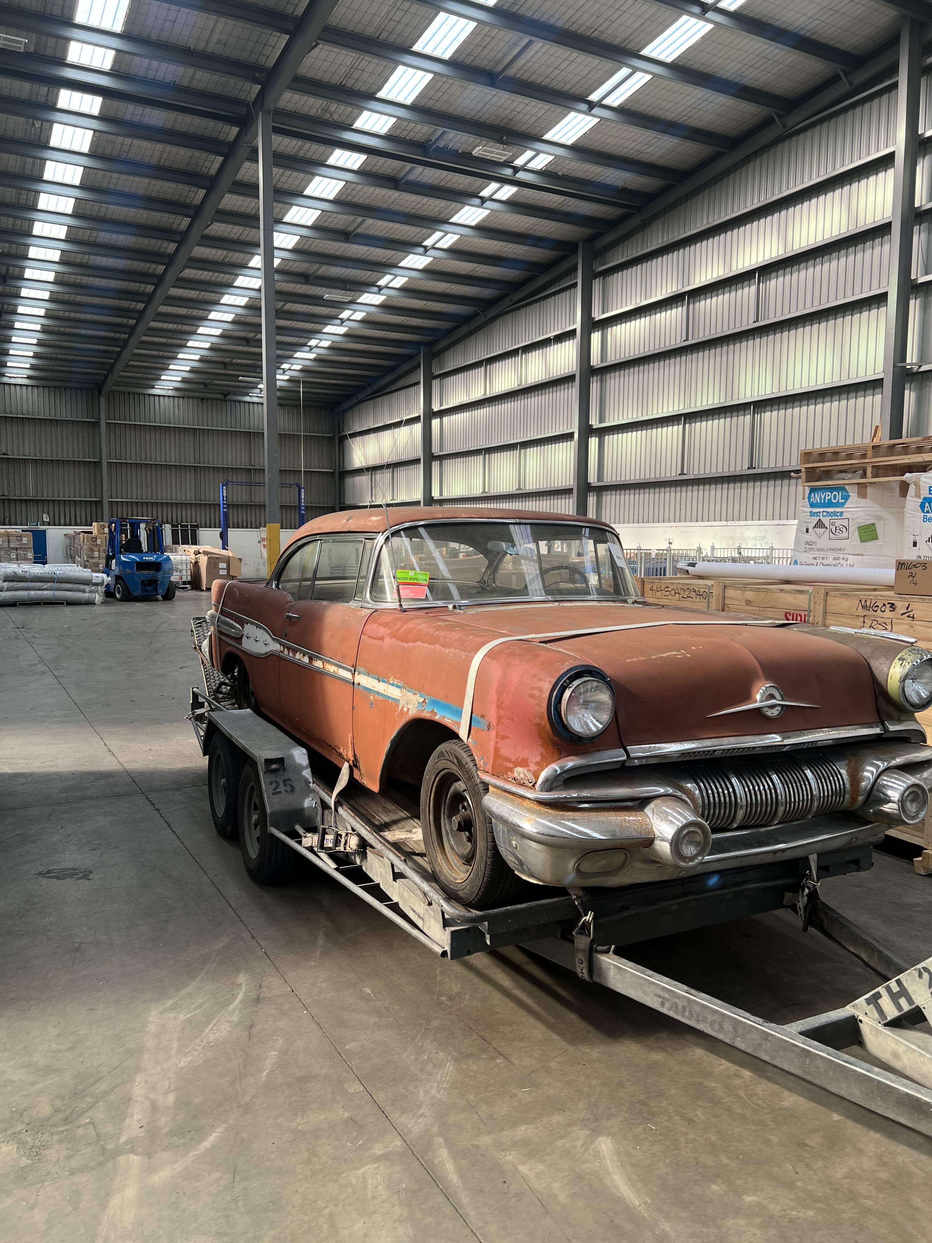

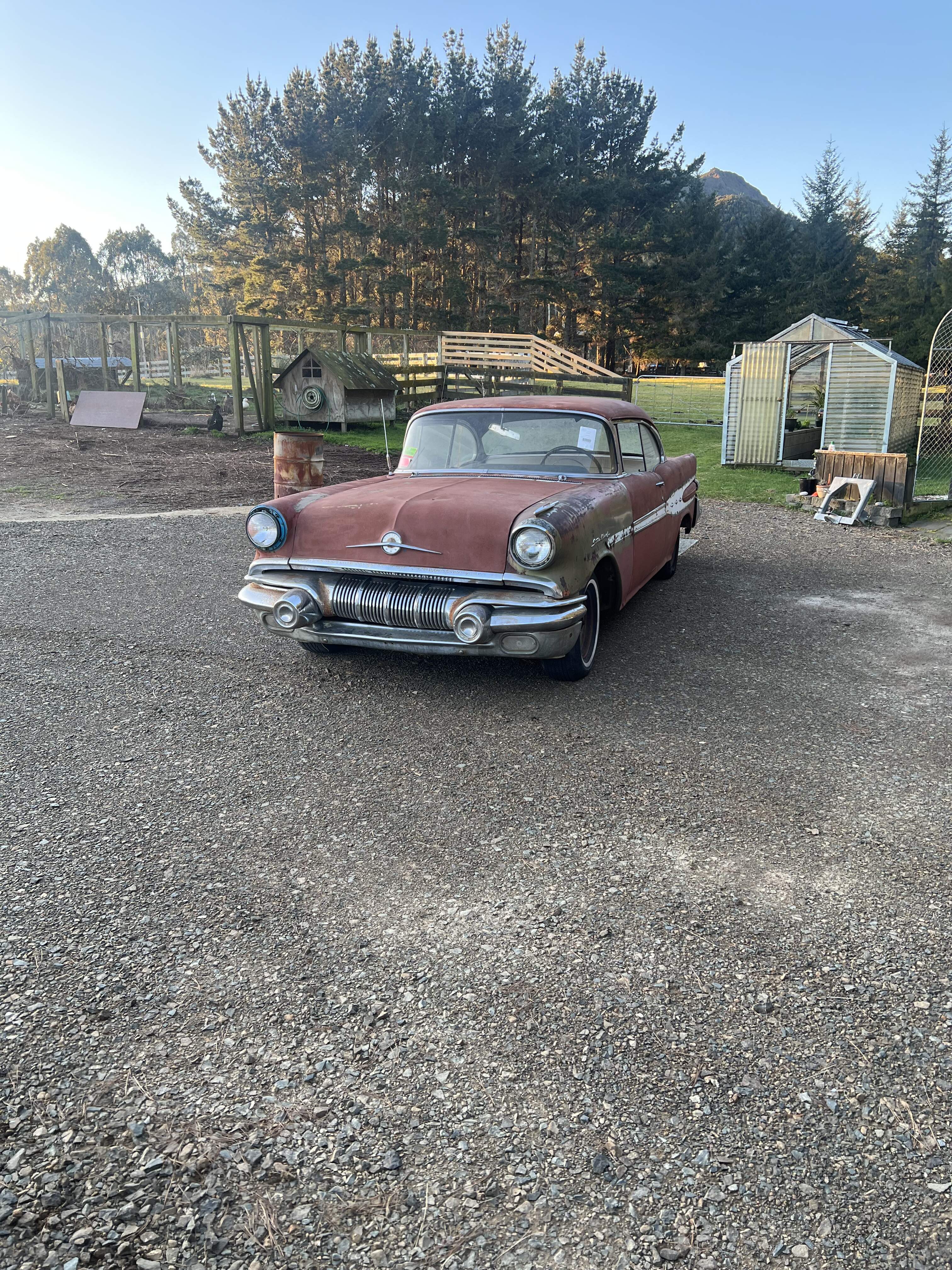

First pics of the new toy !Β
Β
And home after a long day !Β

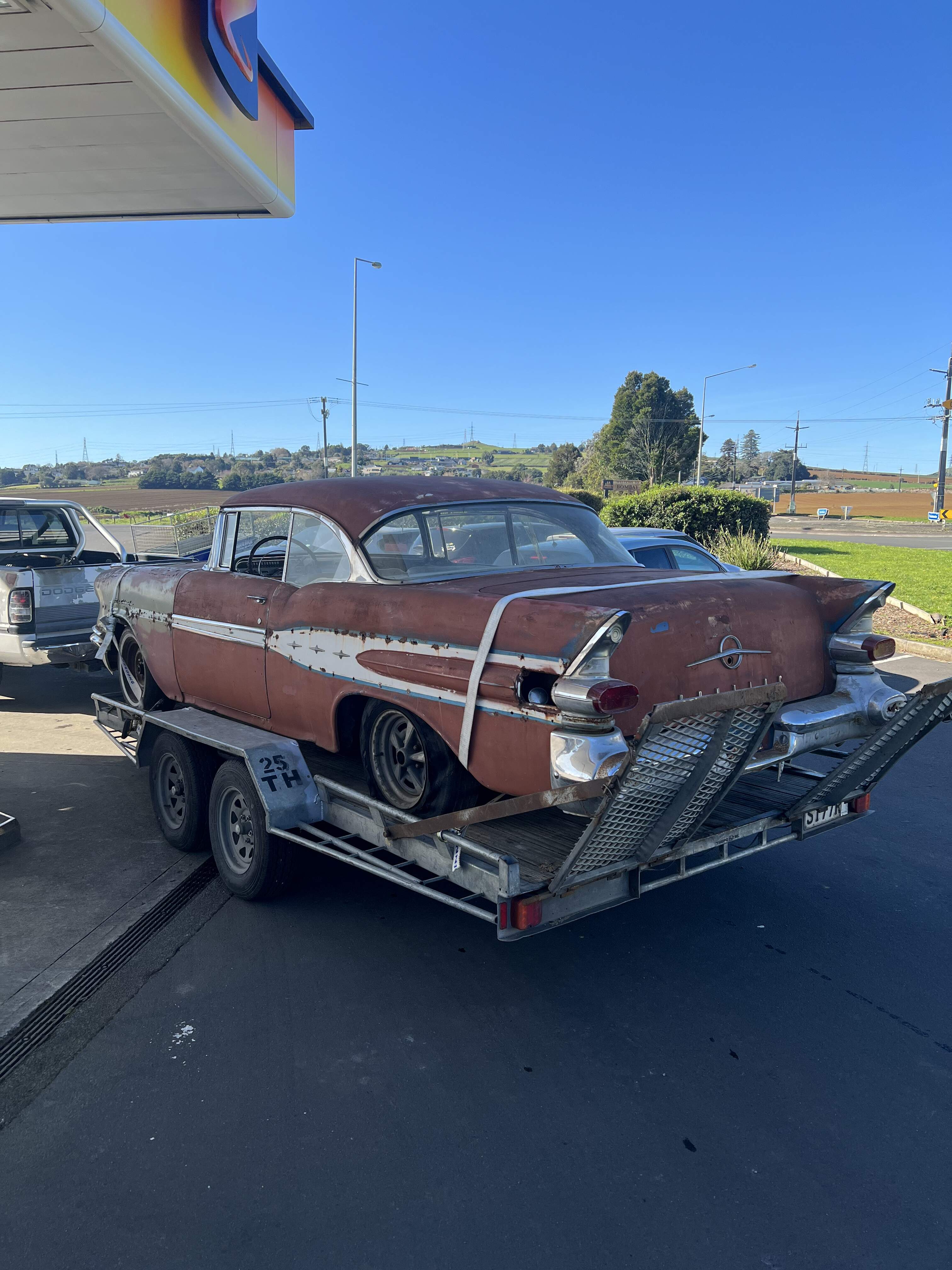

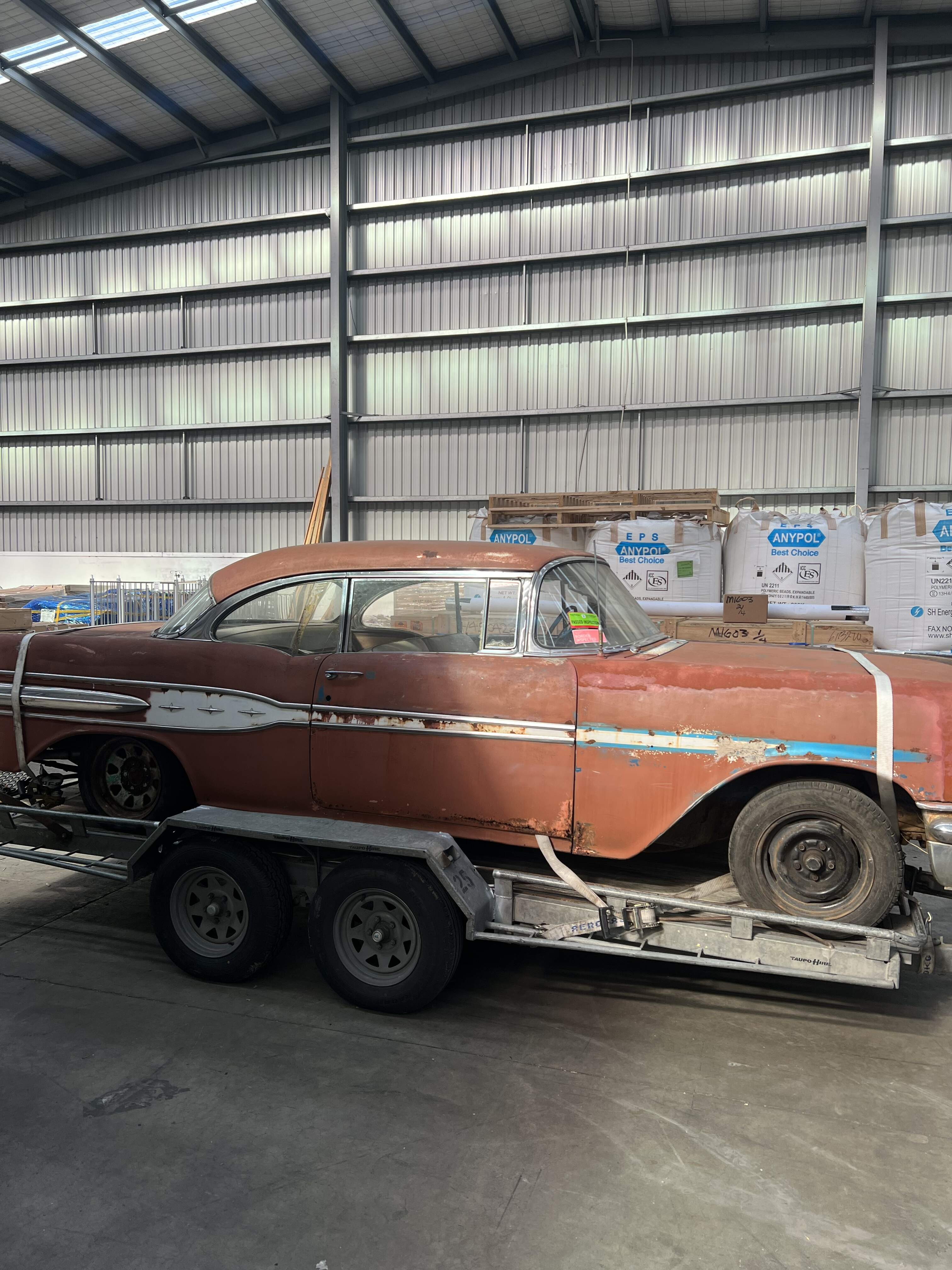

Thank you JustA, this as been a long long journey ! the car left Still water Minnesota way back on the 22nd of March ! then went to newark ny depot , then shipped down the west coast through the panama channel, across the pacific ocean to Brisbane Australia, then down to Tauranga nz then railed to Auckland for maf inspection. then yesterday onto my trailer and down to Taupo !!!:stars:Β
Β And yes i need to check on what is there and what is missing!!! one big thing that has gone is the passenger side head light surround !Β Β

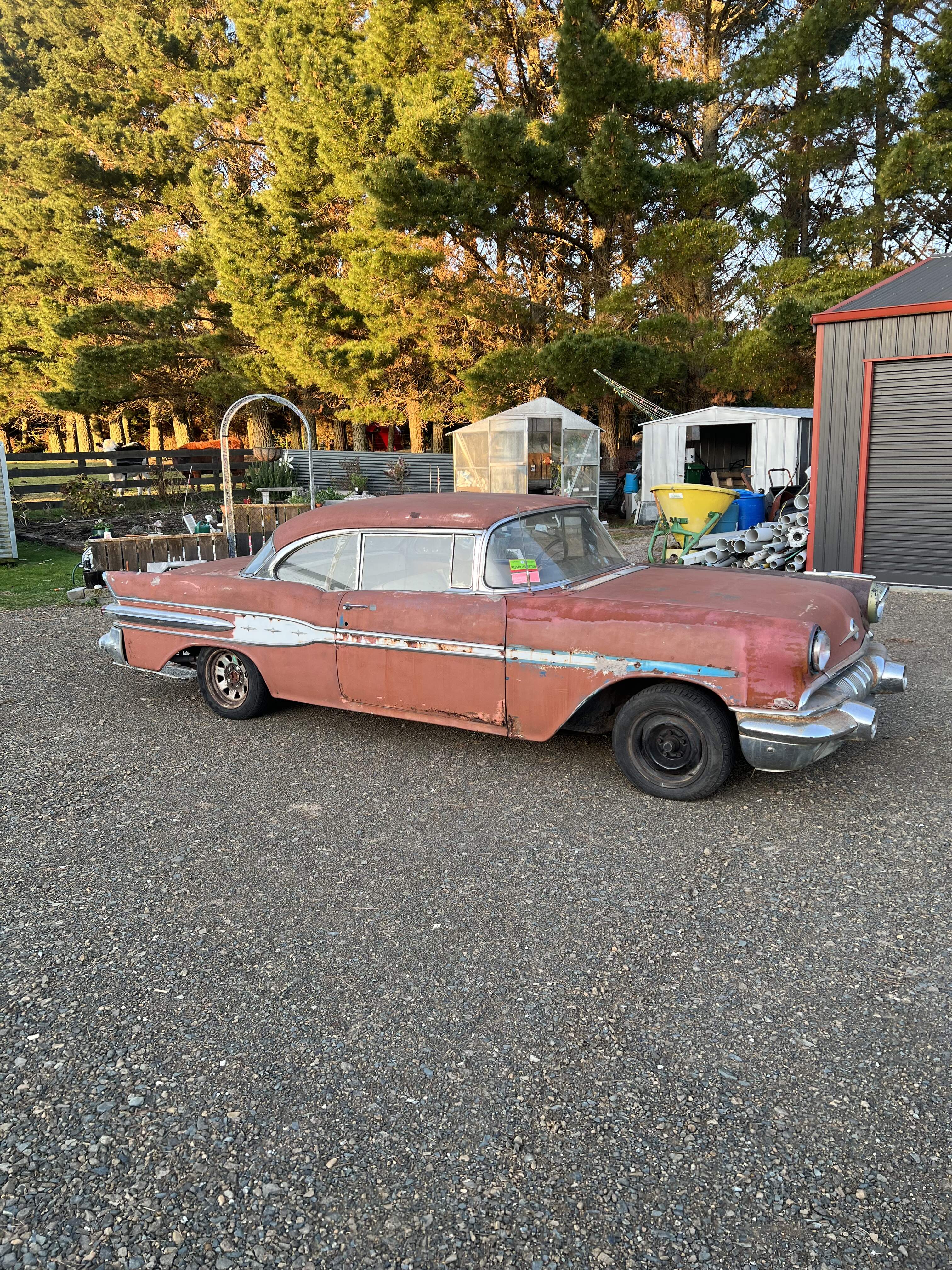

i am going to get some painting done on the additions done first thing today then latter i am going to pull everything out of the 57 and see what i have and take lots of pictures !
i had a quick look last night, and i think i can get it to run!!! everything looks intacted and the motor is free,Β Β
watch this space !!!!:dancingpontiac:

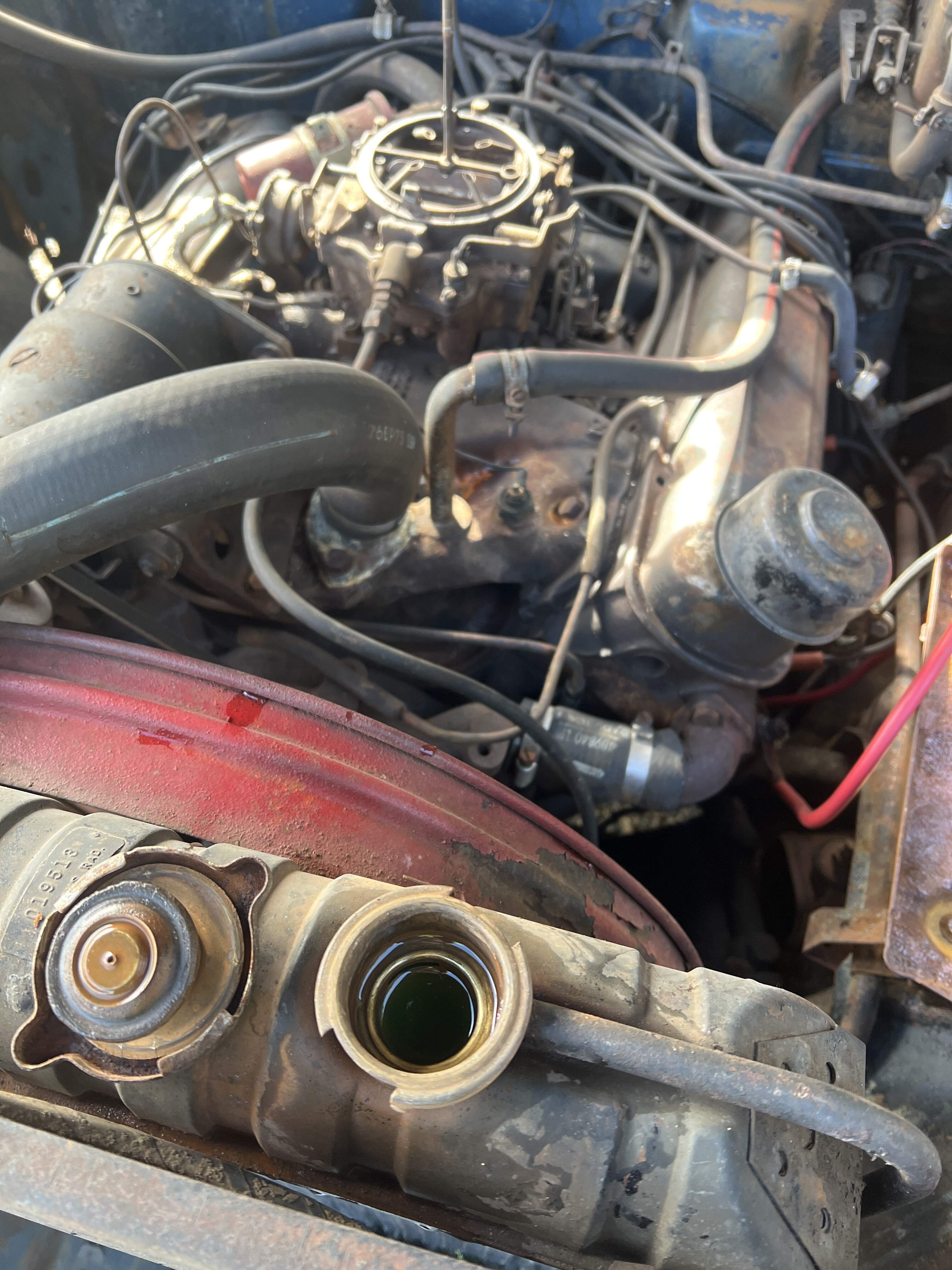

so after first top coat I have topped up the water to see if she leaksΒ
I must agree with JUSTA. Clyde would make an interesting name for the Chief. So you have Bonnie and Clyde! Well done JUSTA! It would make fun discussions at car shows, especially if you had both cars parked next to each other.
Dont forget that that stock 331/347 is a reverse flow cooling system too. Water goes to the heads first, then the block. It is opposite of your 389 in your Bonnie in that respect.Β
Took all of 20 minutes to get it running and driving ! Which is a bonusΒ
it was sold to me as non runnerΒ :cheers:
It looked really complete in the engine bay and the plugs looked really new, i had no information on when it was last running, so i bought this car based on no- go!
i stuck a tank of gas in the front with a hose to the fuel pump, cleaned the battery terminals, would turn over, didn't fire.....
checked for 12v at the coil...yes.....
popped the cap, filed the points, cleaned the rotor.
put cap back on, turned key bang!
idles great, big leak from the passenger side manifold, looks like the gasket is blown out..
jumped in, shifted into "D", it moved !!! stomped the breaks.... it stopped !:cheers:Β its beer o clock ! i am now impressed !!!:dancingpontiac:
took it for a drive around the house... it was slipping....
stopped, pulled the trans stick, no fluid to be seen, pumped near 4 litres into the transmission .
took it for another drive ! wayyyyy better , trans shifted 1-2-3-4 .stopped stuck "Clyde" in reverse, and off we went backwards!!
AND i looked underside and this super hydro isnt leaking..... YET !:rofl:

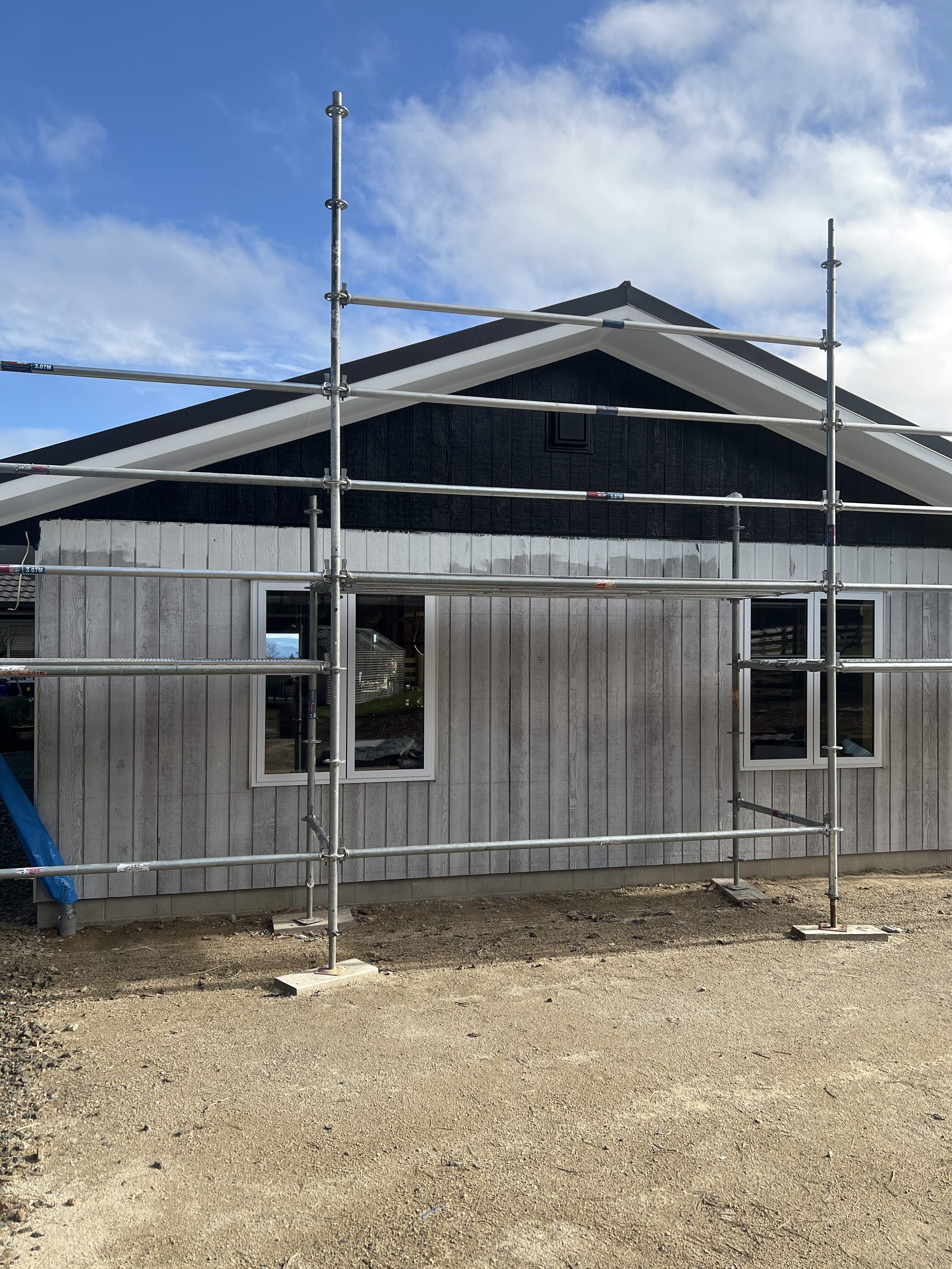

i must post some pictures of the reno when it stops raining!!! ... or i should say... IF it stops raining! this has being going on for weeks now! rain water tanks are full to over flowing !

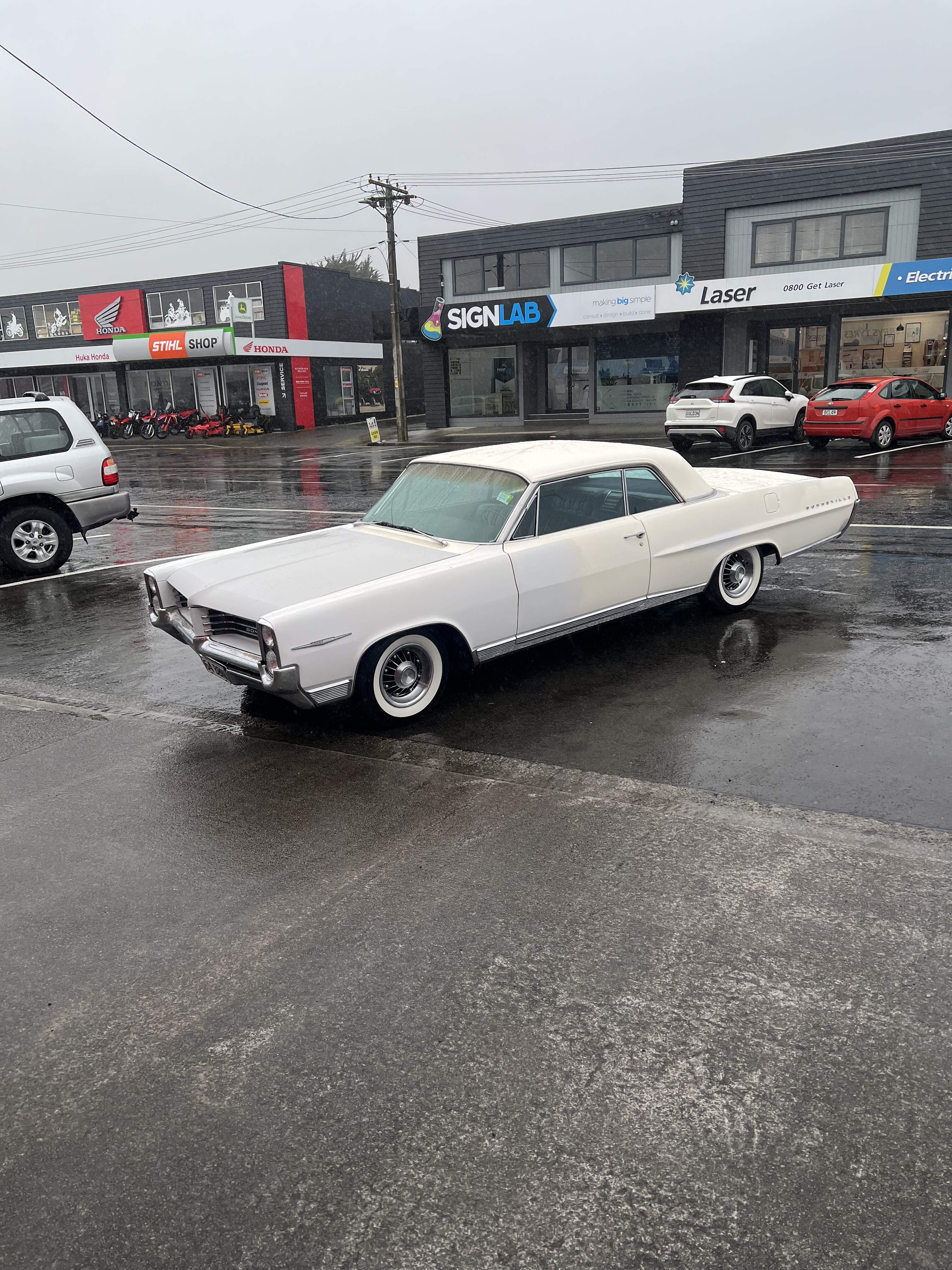

As I want to take the 64 for a drive on her new tires !
the day I had them fittedΒ
I justA drove her home and haven’t cruised since ! funny thing is.... the bloody rain hasn't stopped either!!!
