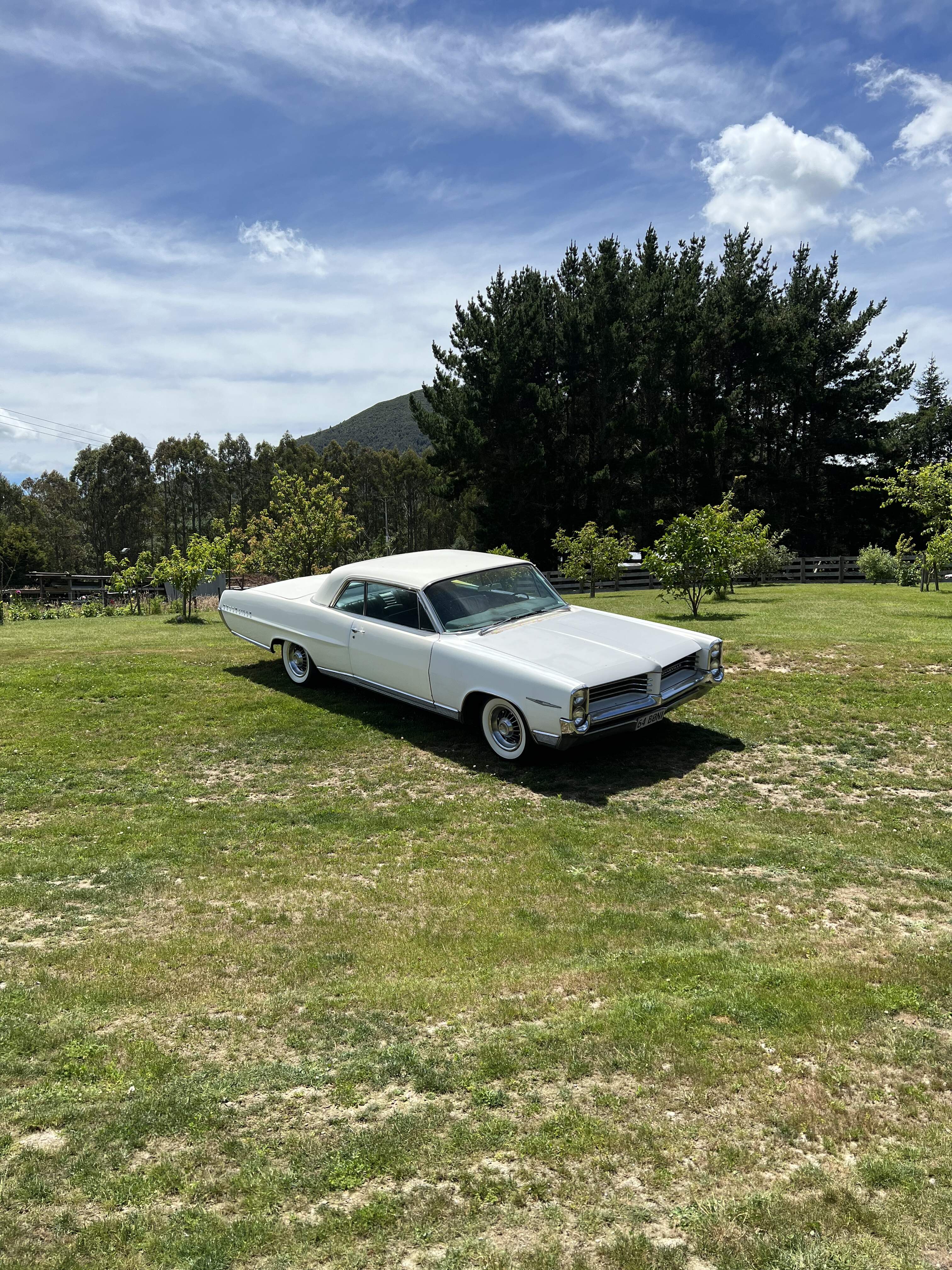

Super hot day here today in Taupo nz
I took the 64 for a spin and thought she is looking pretty good :dancingpontiac:
and thought ! Why not put her in for potm ! :cheers:

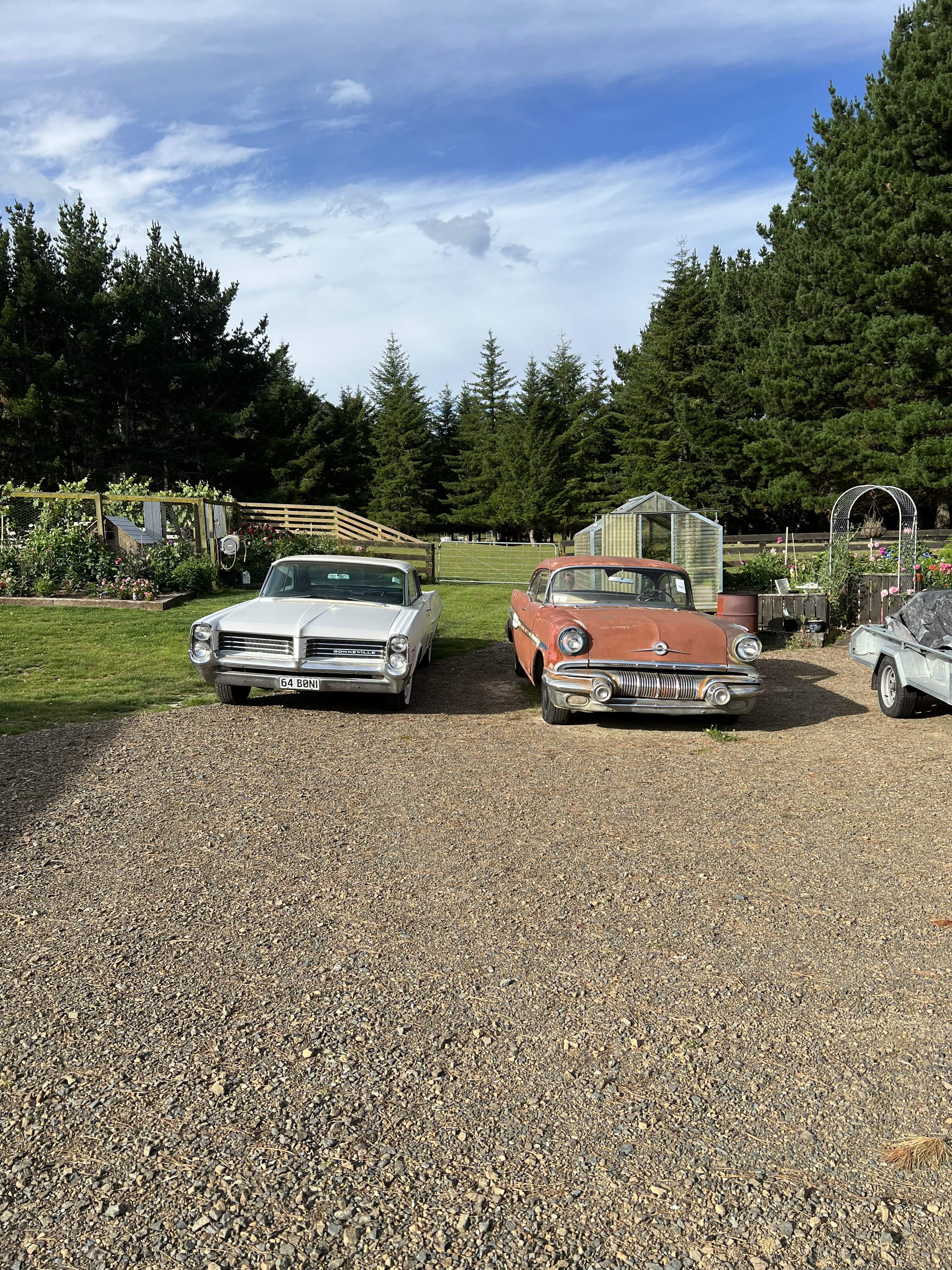

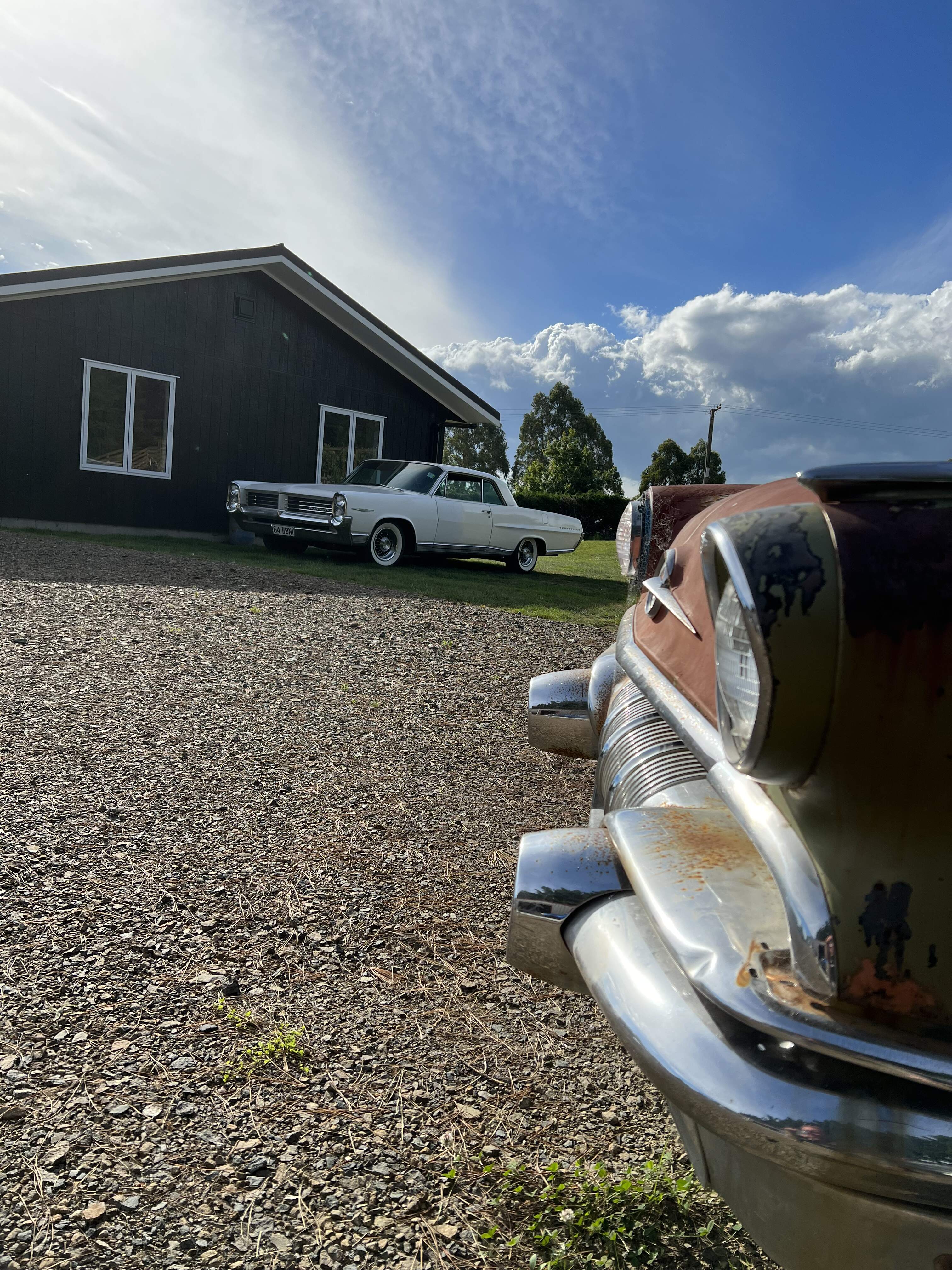

The 64 sitting in the shade
with the 57 near by on this stinking hot day
64  with the 57...
who doesnt love dagmars :dancingpontiac:
Once upon a time in a galaxy far, far away, there was a show on telly called I Love Lucy. In one memorable episode, there was a car dealer who's yard was called "Honest Charlie's Cheerful Chariots," or something. When I see your collection of clapped out machinery in that pic, it was the first thing that came into my head...apart from the CO2 bubbles from my current beer. That 57 is such a stylish old beast. Reminds me of the old metal monsters that prowl the streets of Havana. I was always careful to doublecheck the traffic before attempting to cross the road in Cuba - just in case the ancient drum brakes on those old cars weren't quite up to scratch.
