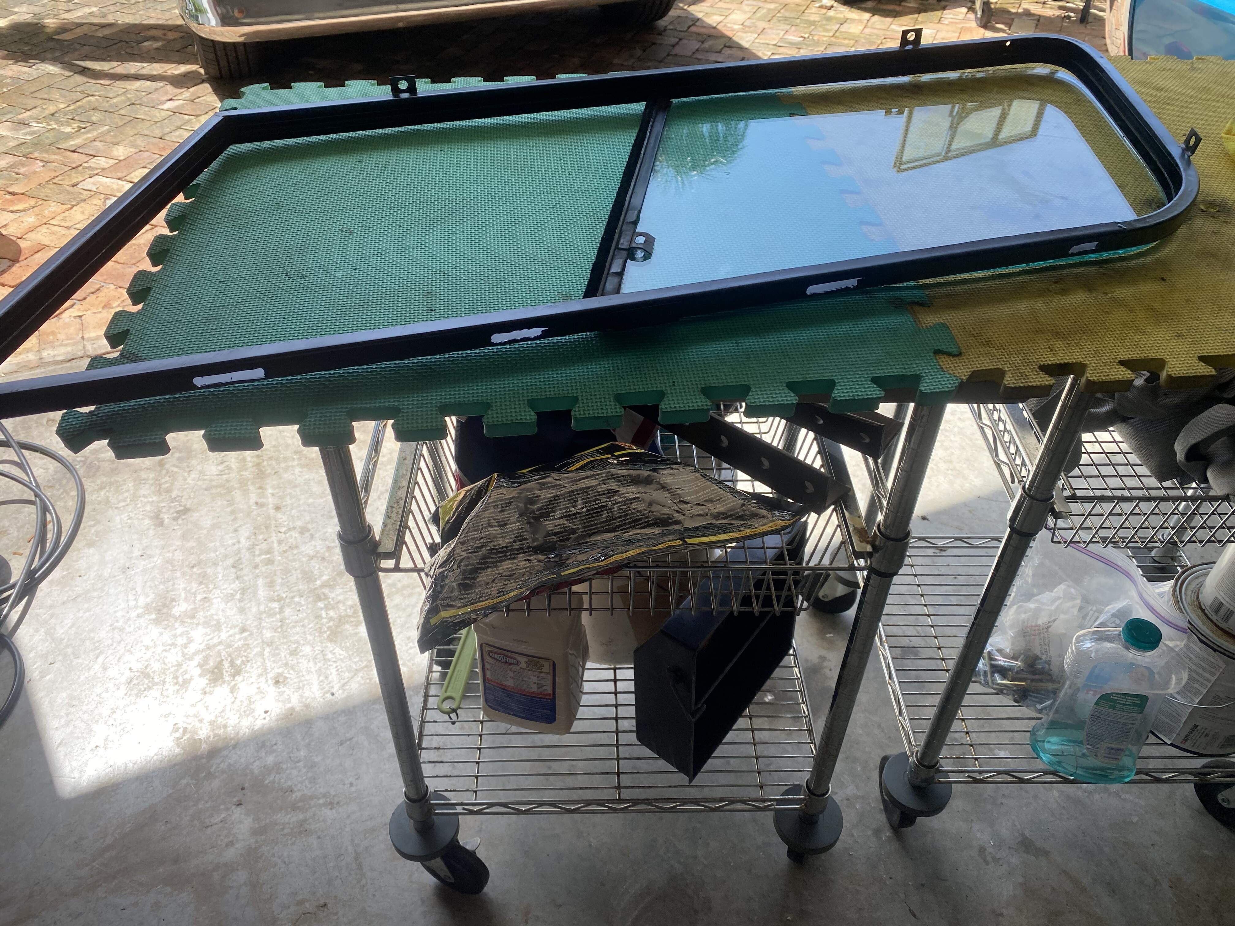

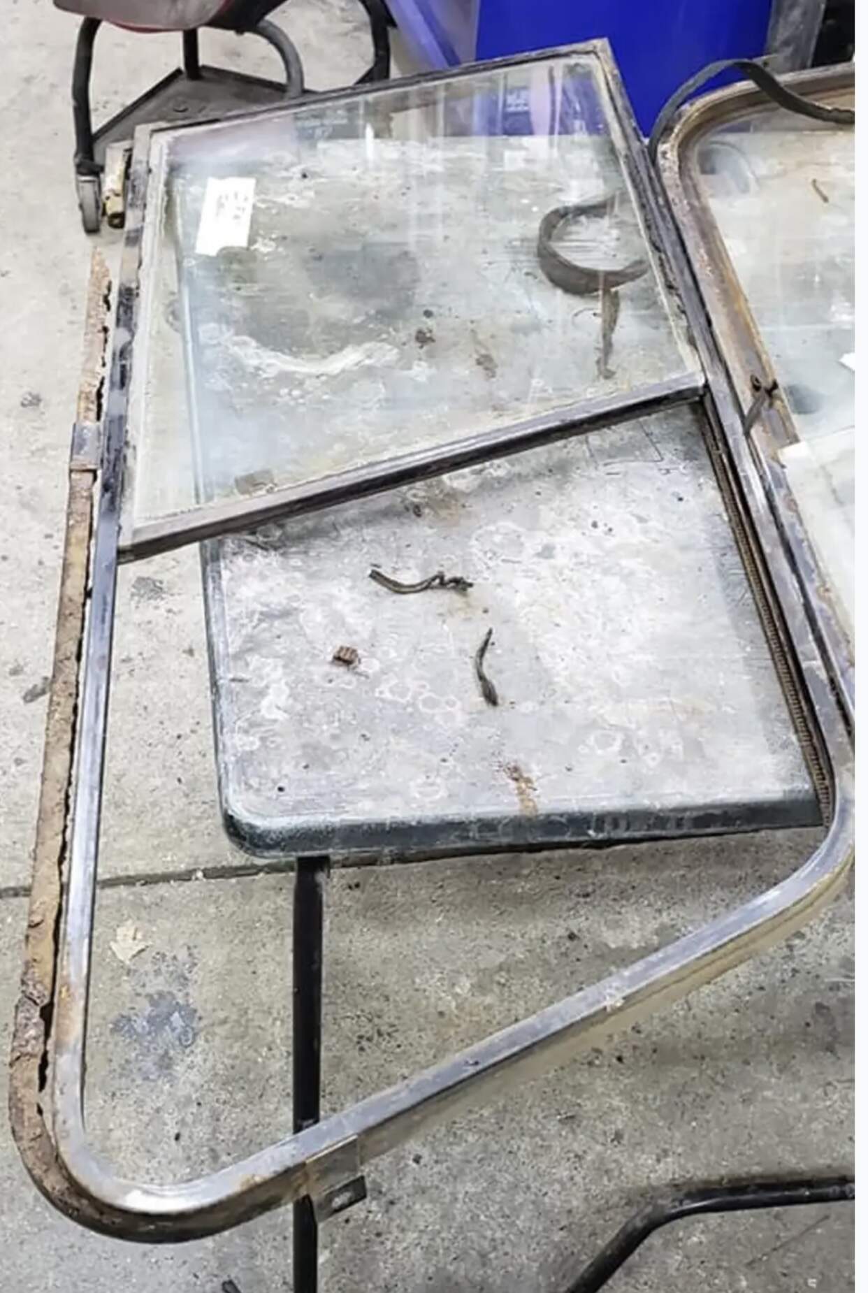

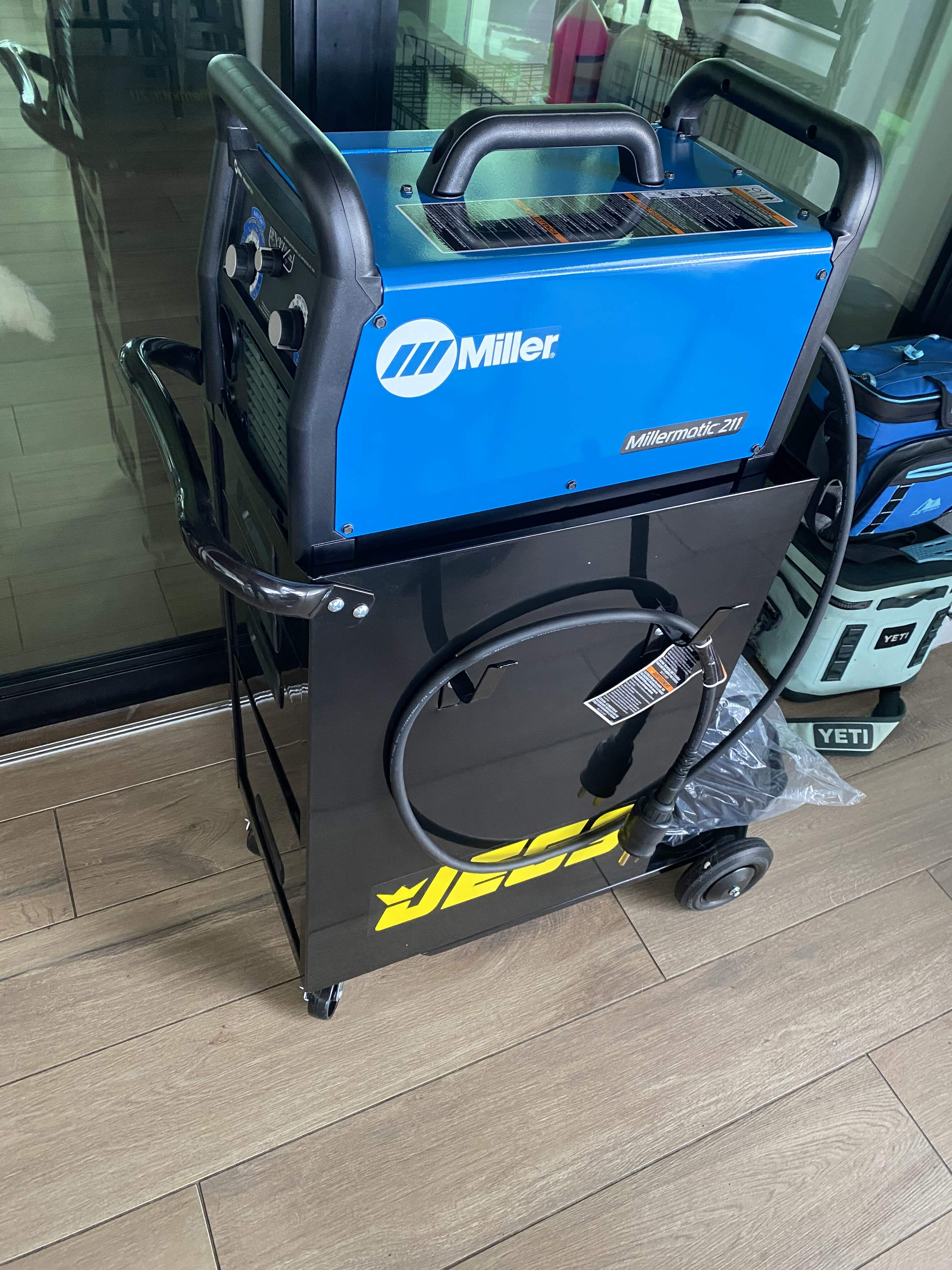

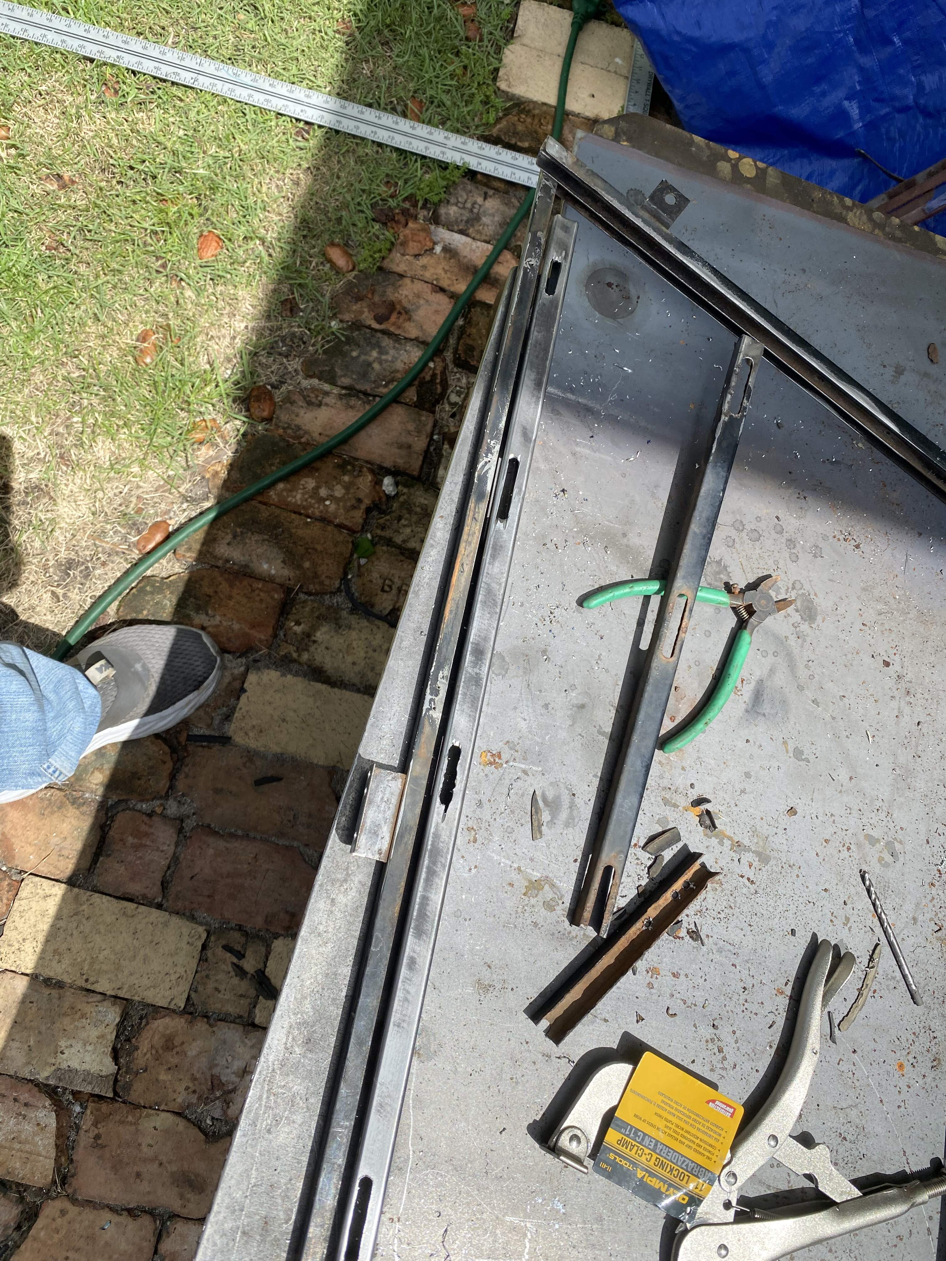

Speaking of new tools, look at what the wife bought me for my bday. Looks like i will be taking it up a notch with car restoration. The 66 suburban is doing great. I just finished with front disk brake conversion. I want to make the rear solid glass sliders so it my be my first welding project. You can see a picture of an old window frame. It is double channel. One is 1/2”wide and the other is 3/4. The trick is the corner curves. I guess I need to cut notches to allow it to curve then weld it back. Also I imagine i will need to bend up my channel vs finding the correct u-channel size. Oh, one more thing, i have never welded other than cheap harbor freight 110v stick welder. Should be a learning experience.
Happy to say I managed to figure out the welder enough to replace the rotten bottom channel. The hard part was to get the right side channel. It seems the ID of the U it too small for the bending machines. I ended up cutting to top off of some square tube which worked great!

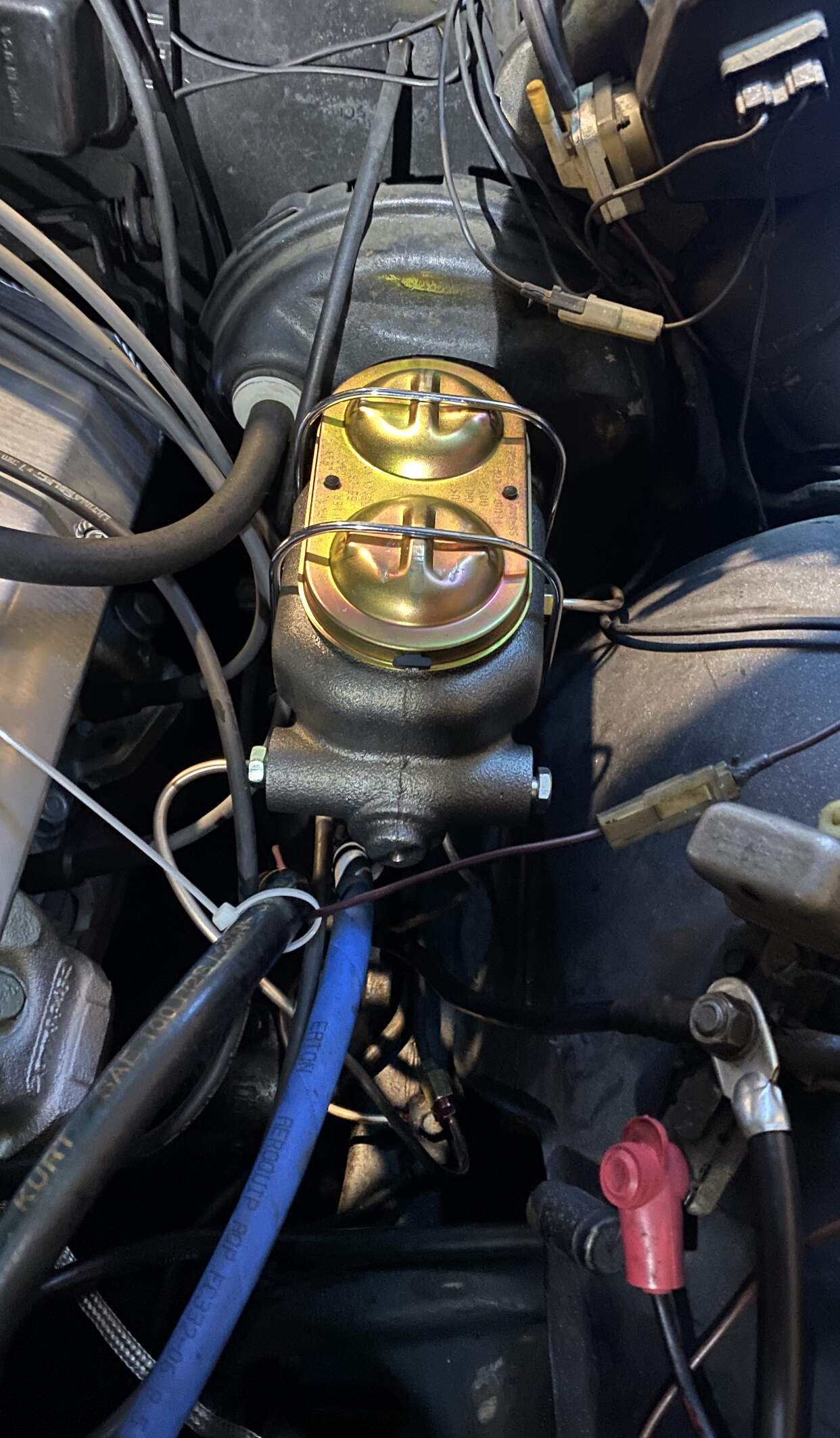

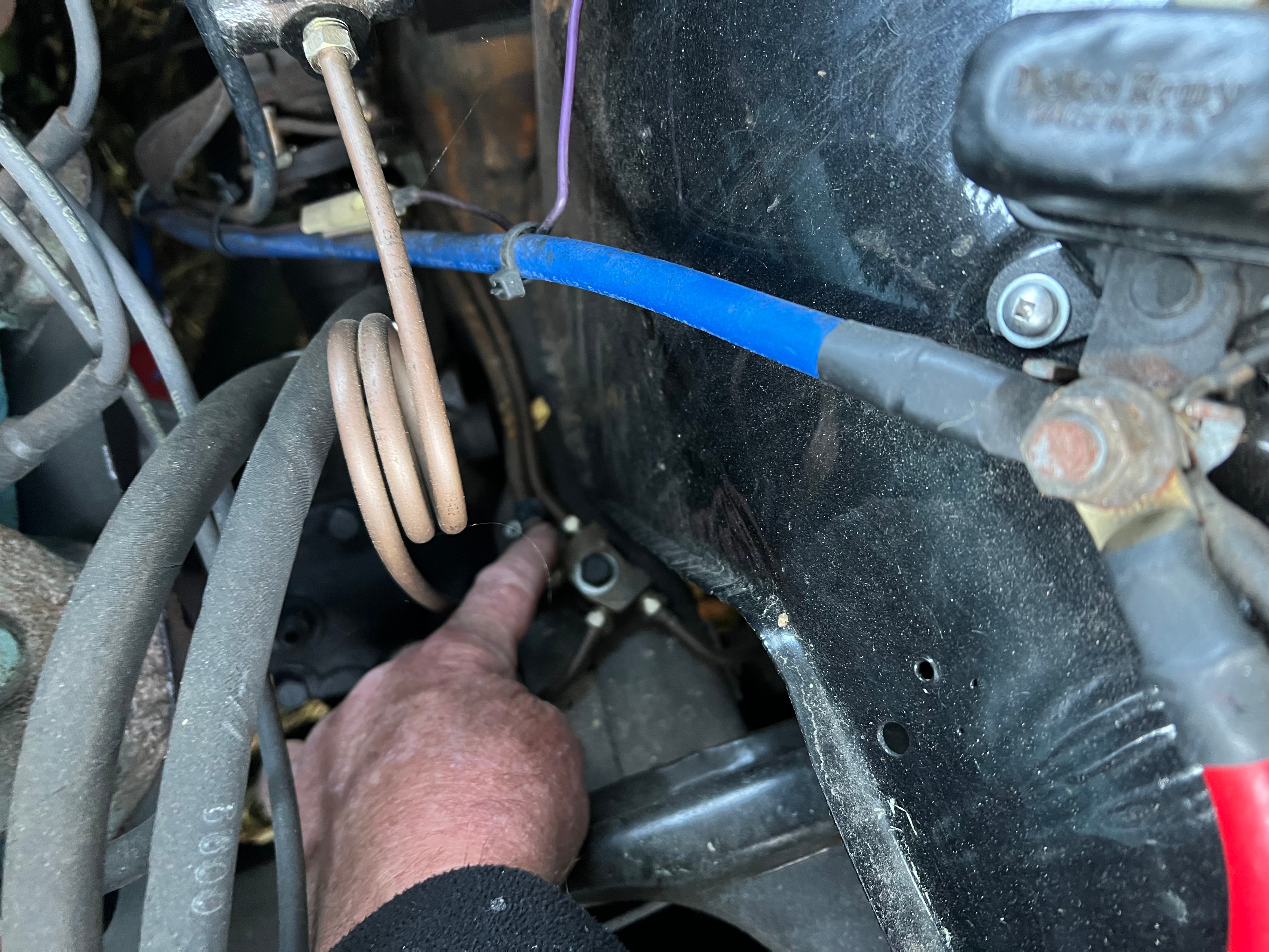

Hi Chris, finally doing dual Master cylinder swap. Do you add any kind of proportional valve? I know I did for the 66 suburban but it had disk in front and drum in back which then needed proportional valve.

hi Del, no i havent done the swap yet, but Fitzy is on his 65, i dont think a proposioning valve is required as its drum- drum.

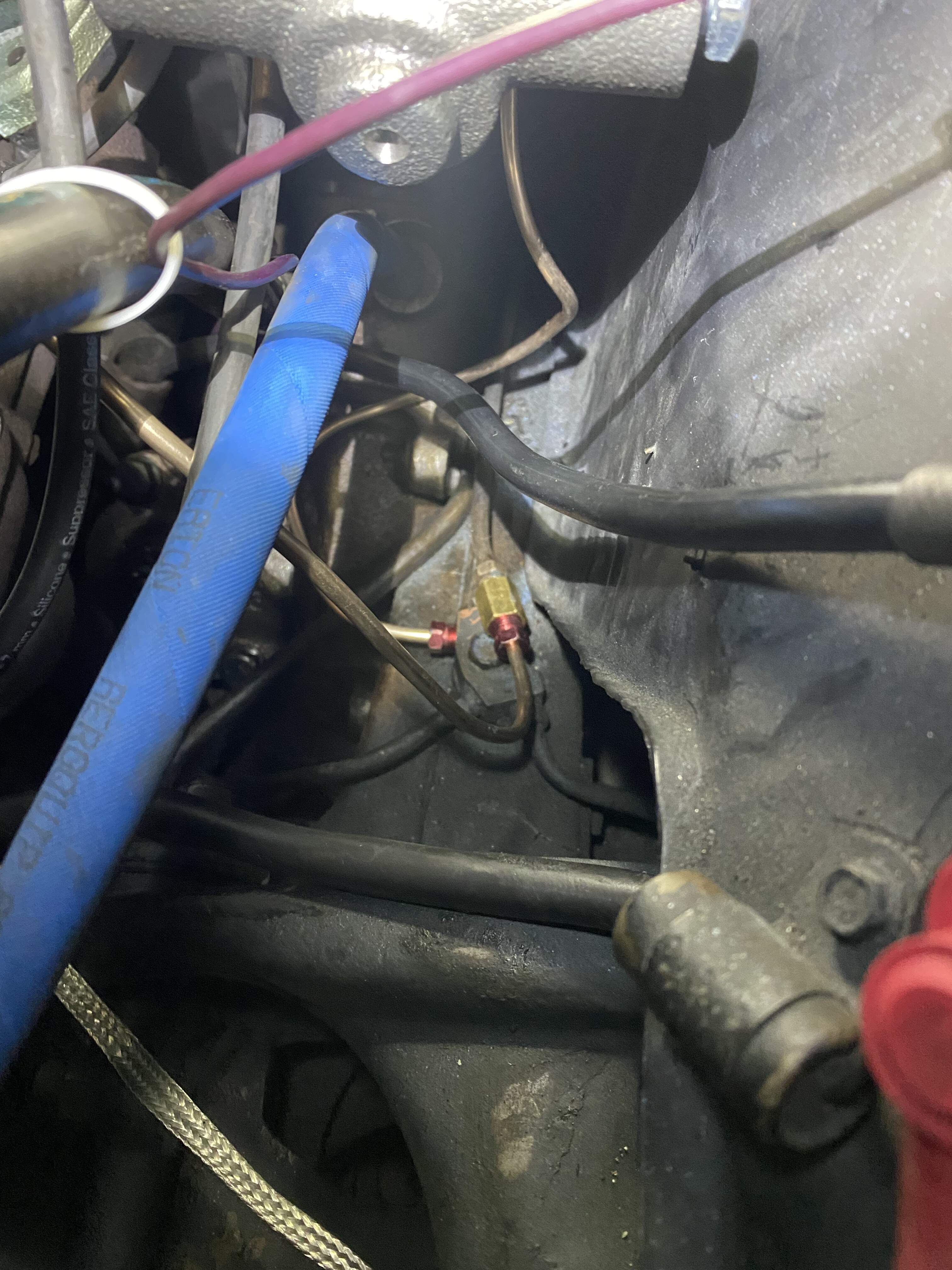

Β  I had to put a rush on doing the dual master cylinder upgrade because the original would lose all its fluid in 4 days. The job would be easier if it included the fittings and coupler needed. Β I’m sure it’s different for various applications. In my case I only had room for one brake line on one side due to the wheel well. I ran the other line off the other side as you see in the picture. Not pretty but it works.
Thanks for your help.Β
nice work del !!!!:cheers:Β you could be a plumberΒ :)

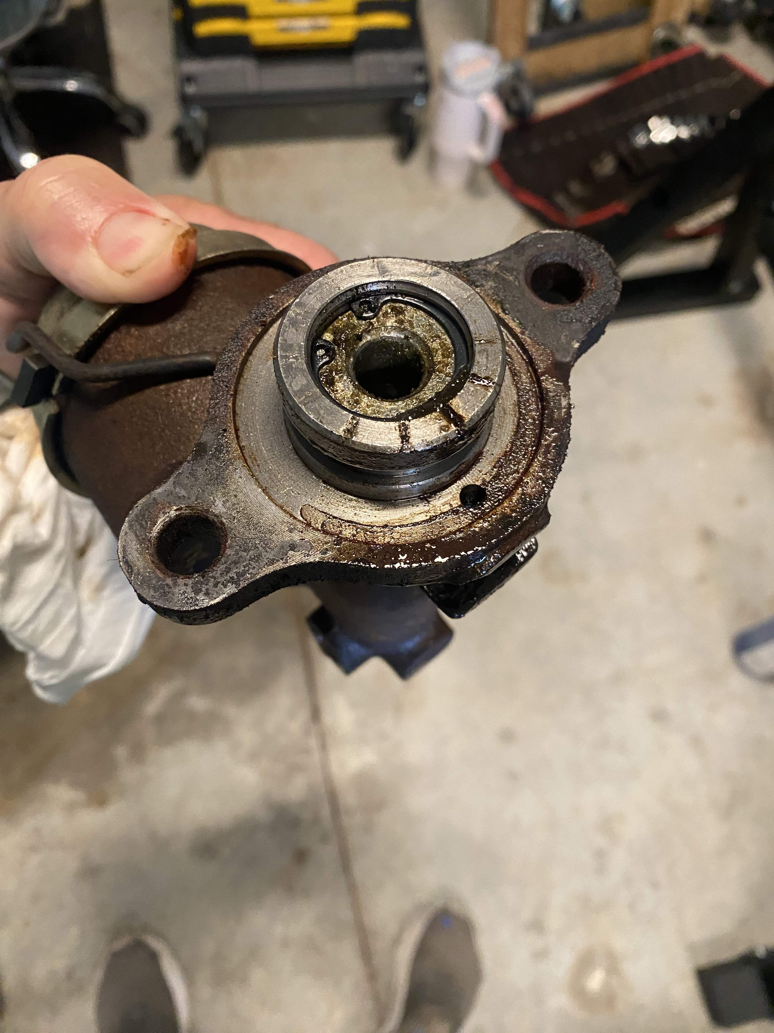

Β i note that your old single outlet master cylinder had the c clip that my booster rebuild man warned me about !!!!
those eyelets in the c clip dig into the front seal on the booster, hopefully it hasnt damaged your booster !!!

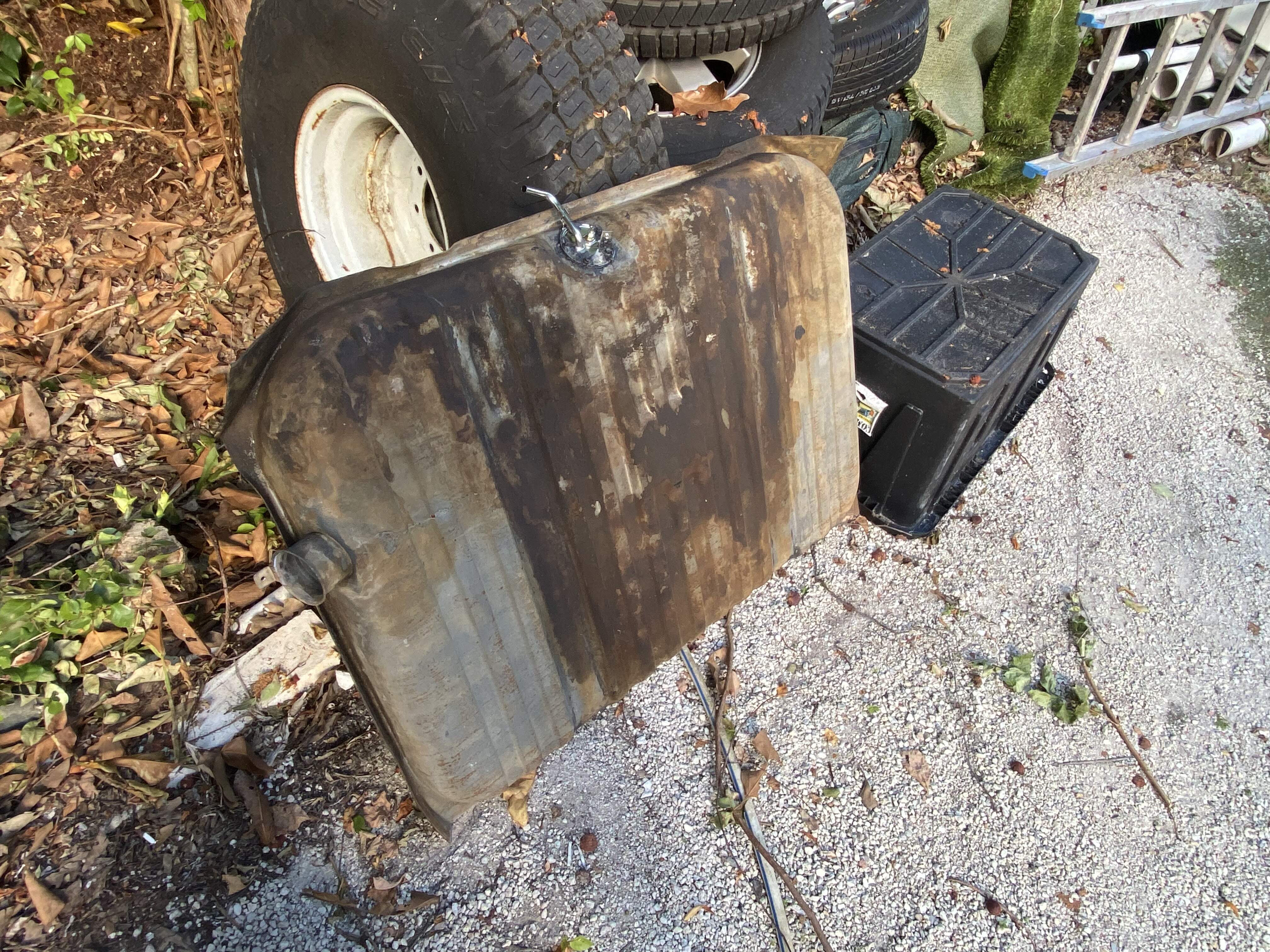

My daughter helped me IMG_1620.thumb.jpeg.465d727ab235033473cc2d8c65ffe06b.jpegbleed the brakes. Man, the front brare nipples tight location is super hard to get a wrench on. Anyone figure out a trick to this? Also dropped the tank to put in new sending unit. The love of Bonnie repair!

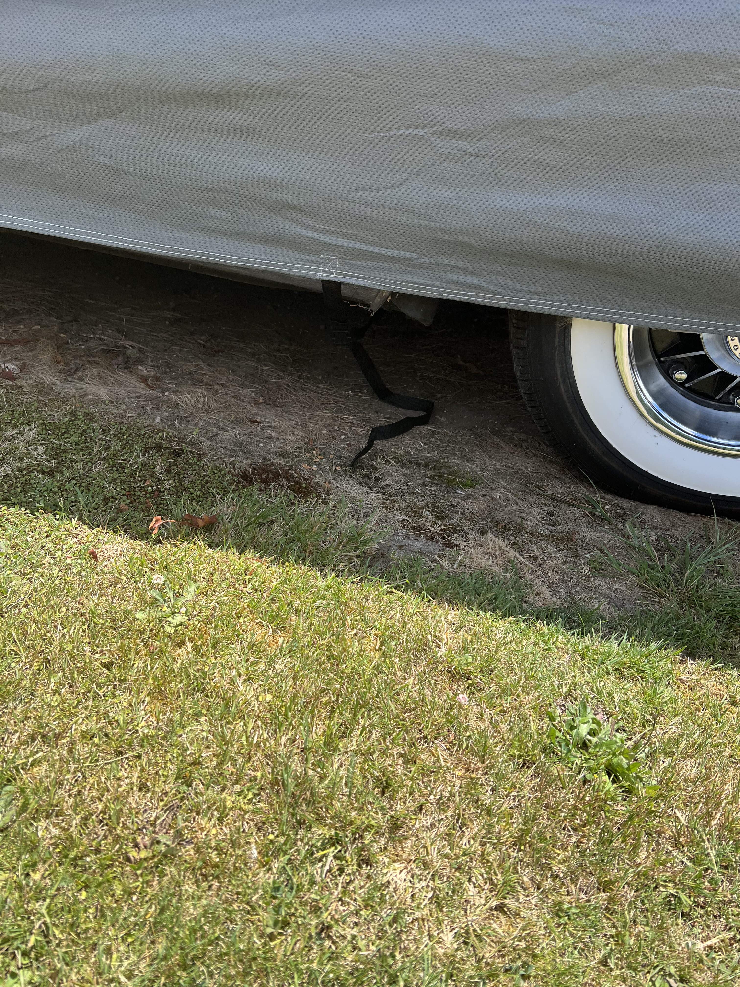

Great value for $175 and good fit too ( no one sells anything this big in parts stores here in NZ ! )
I bought one of these 5 years ago and I note that my new one has more tie down points ..
unlike my old oneΒ
Β
There is extra straps front and rearΒ
But they do Break down over time !! The material gets thin and ripsΒ
And nice to see some accessories too !Β

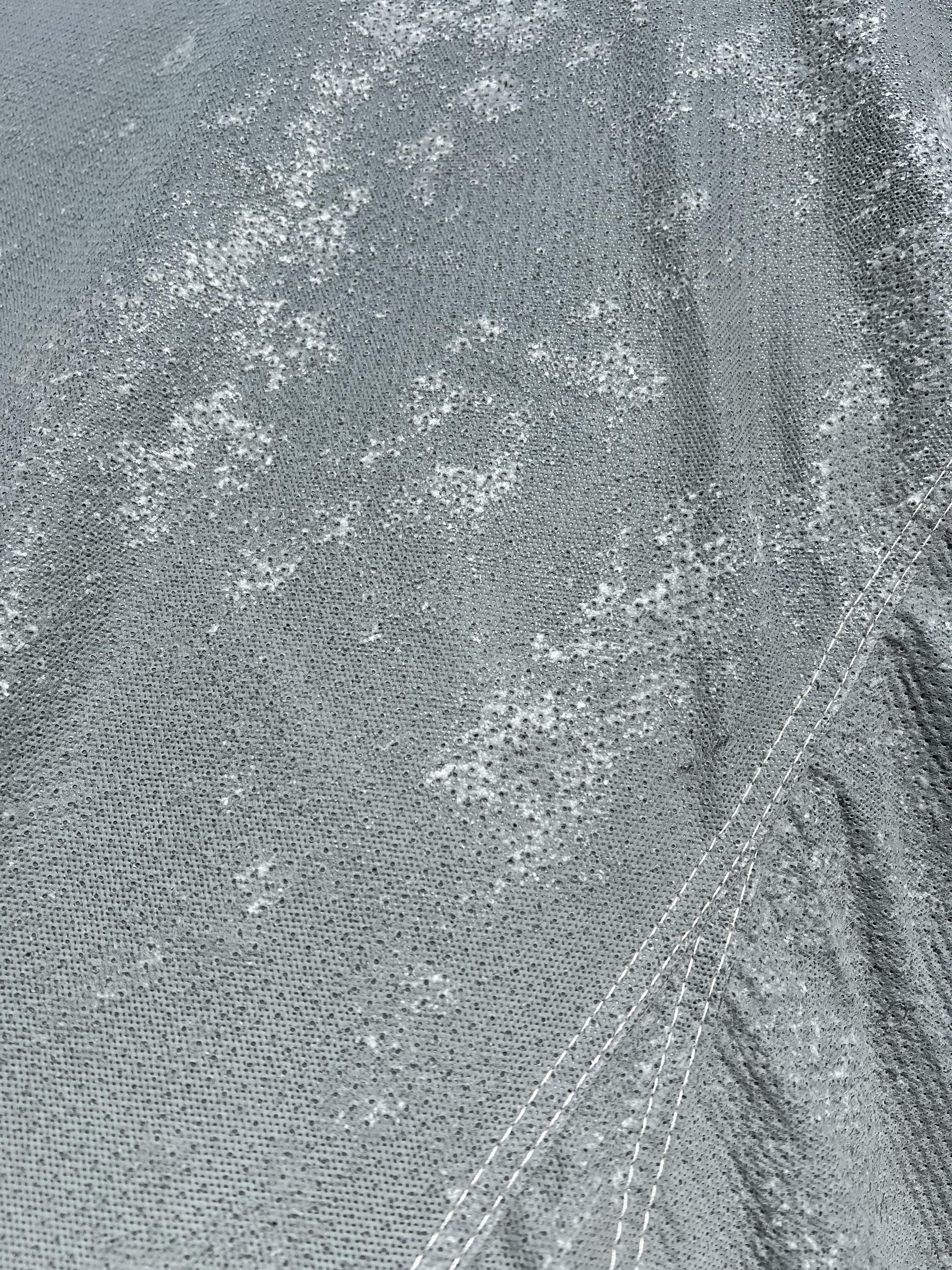

Mine sits outside under a cover and they only last about a year, have not tried one of the more expensive ones but they are several times the cost of the cheaper ones on Amazon so for now I just keep buying new ones. The sun in the warmer climates seems to be the biggest problem.
