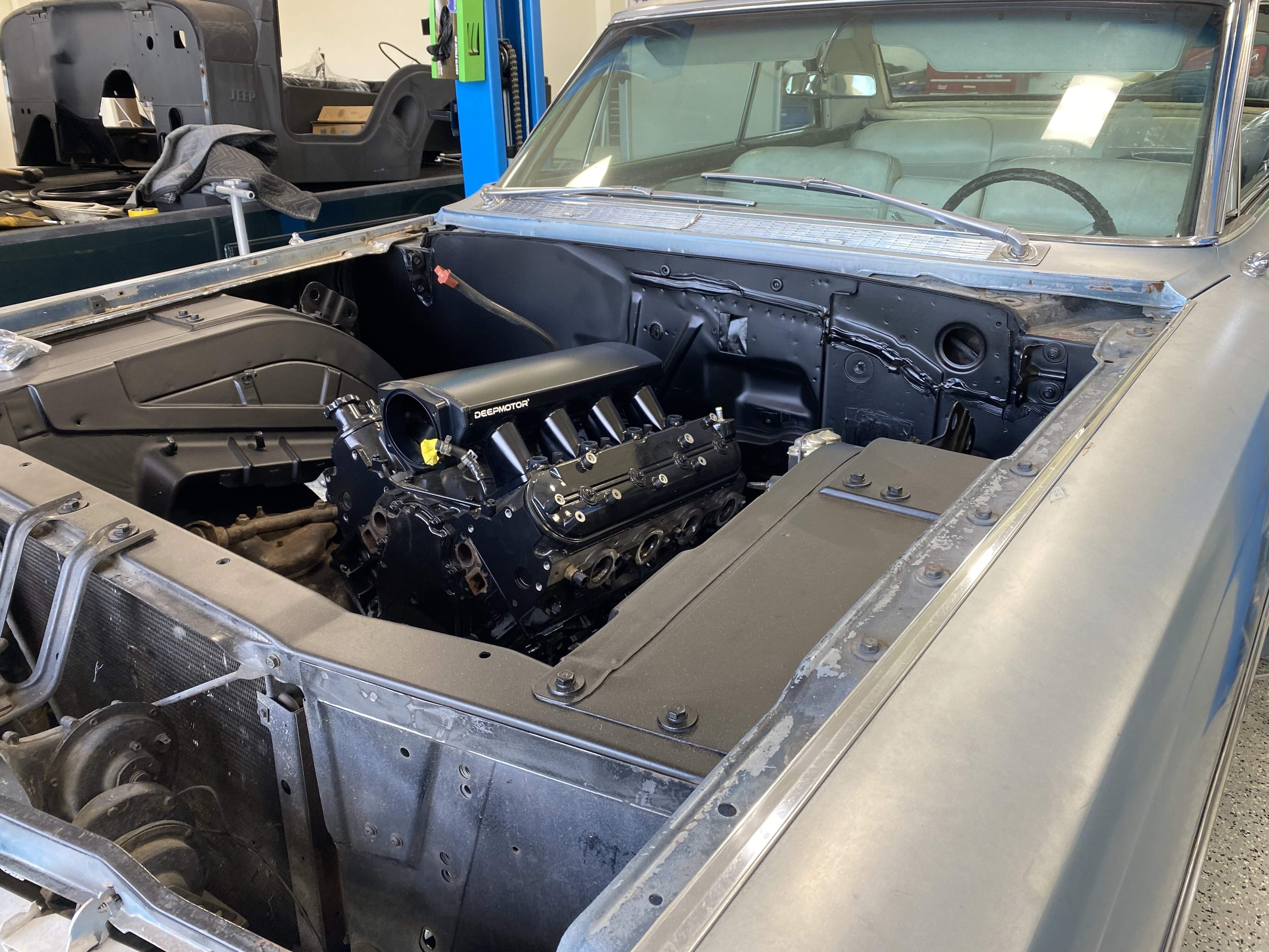

Question !
that little seat in the front โ€ฆ does that flip forward to gain access to the rear seats ?

Question !
Yes it does. Itโ€™s crazy they have three rows of seats for a 2 door. Front seat totally flips forward for rear access as you can see. Iโ€™m demonstrating the head room for my son. This was the other burb I didnโ€™t buy.

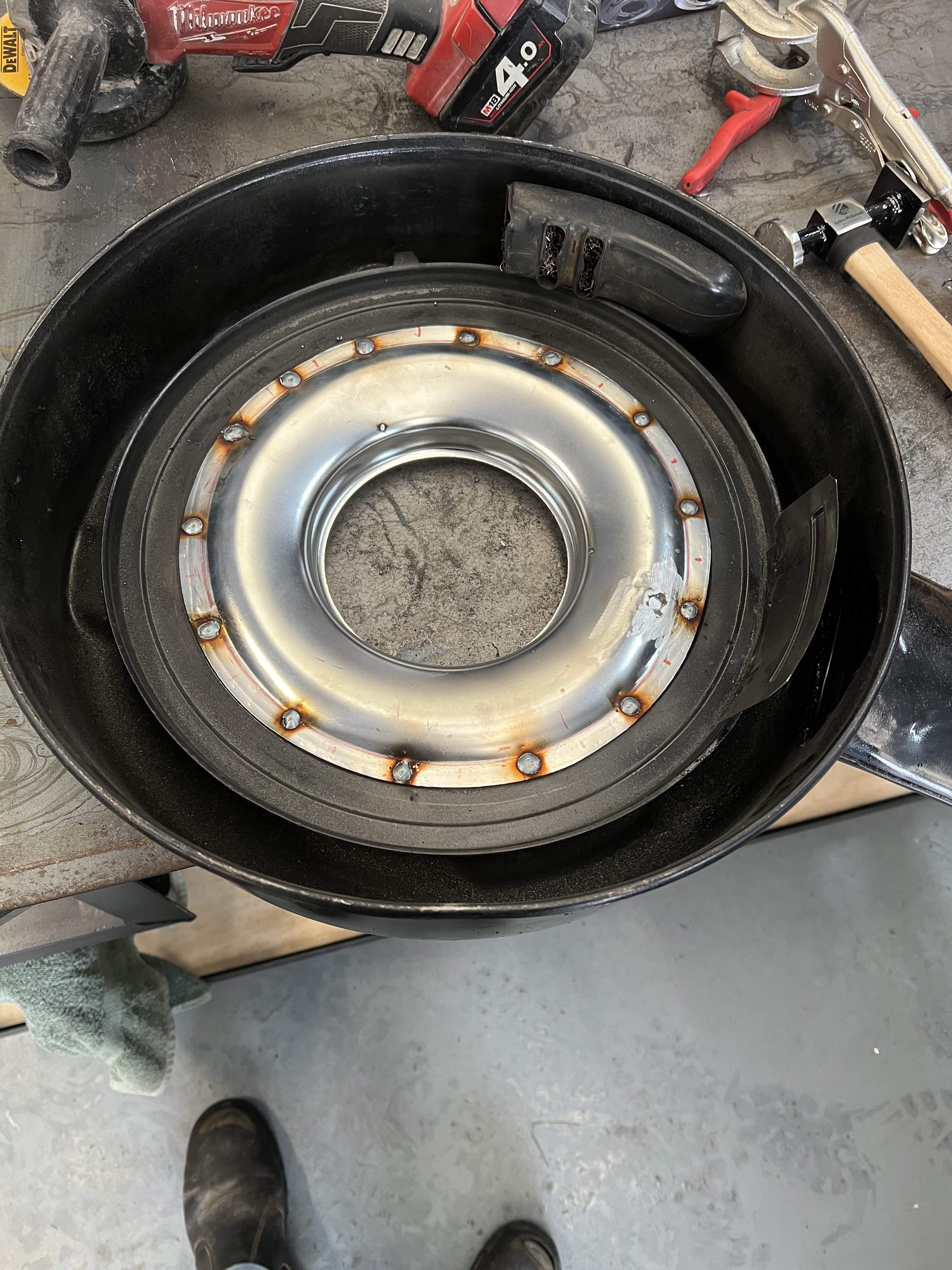

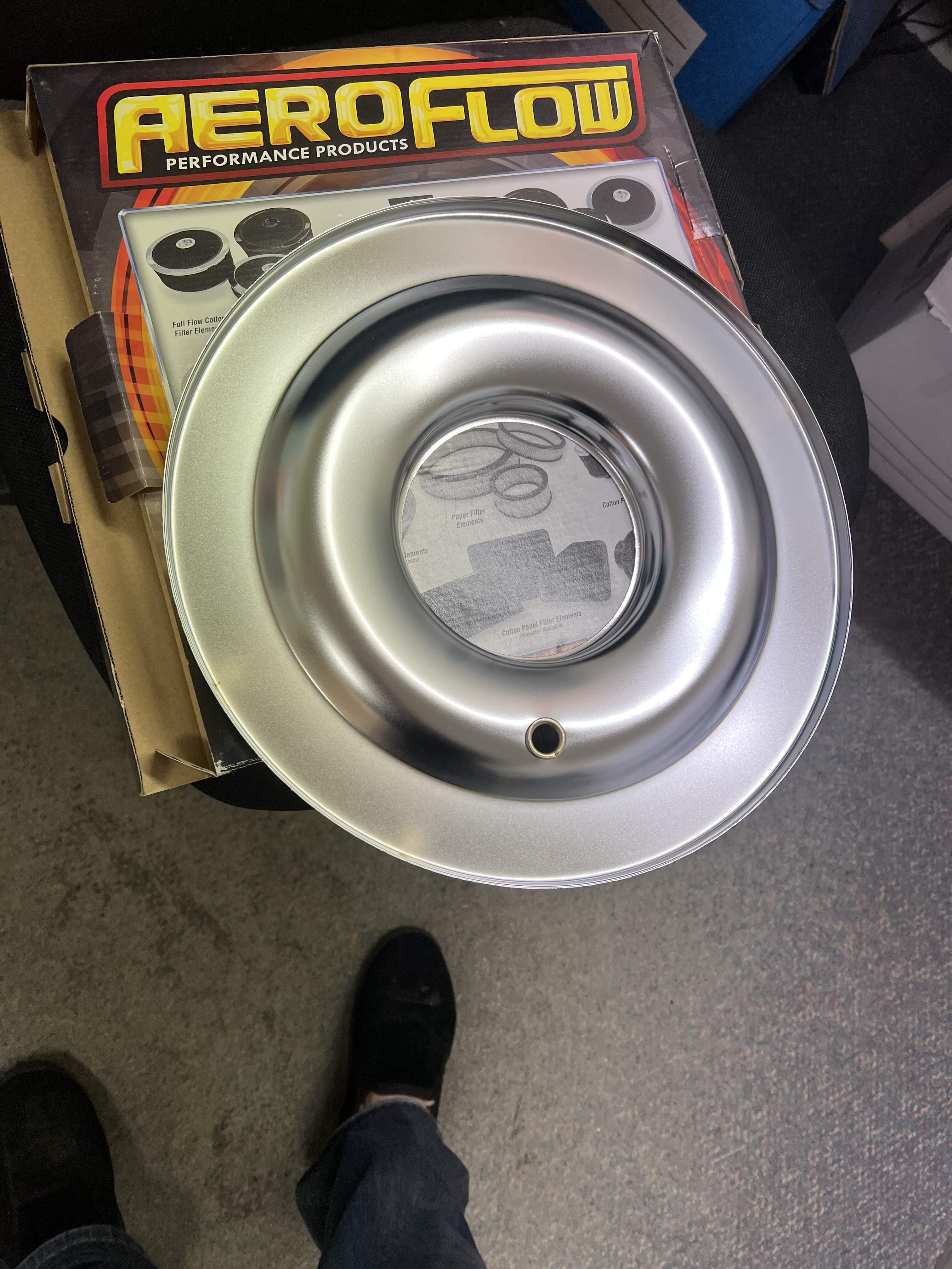

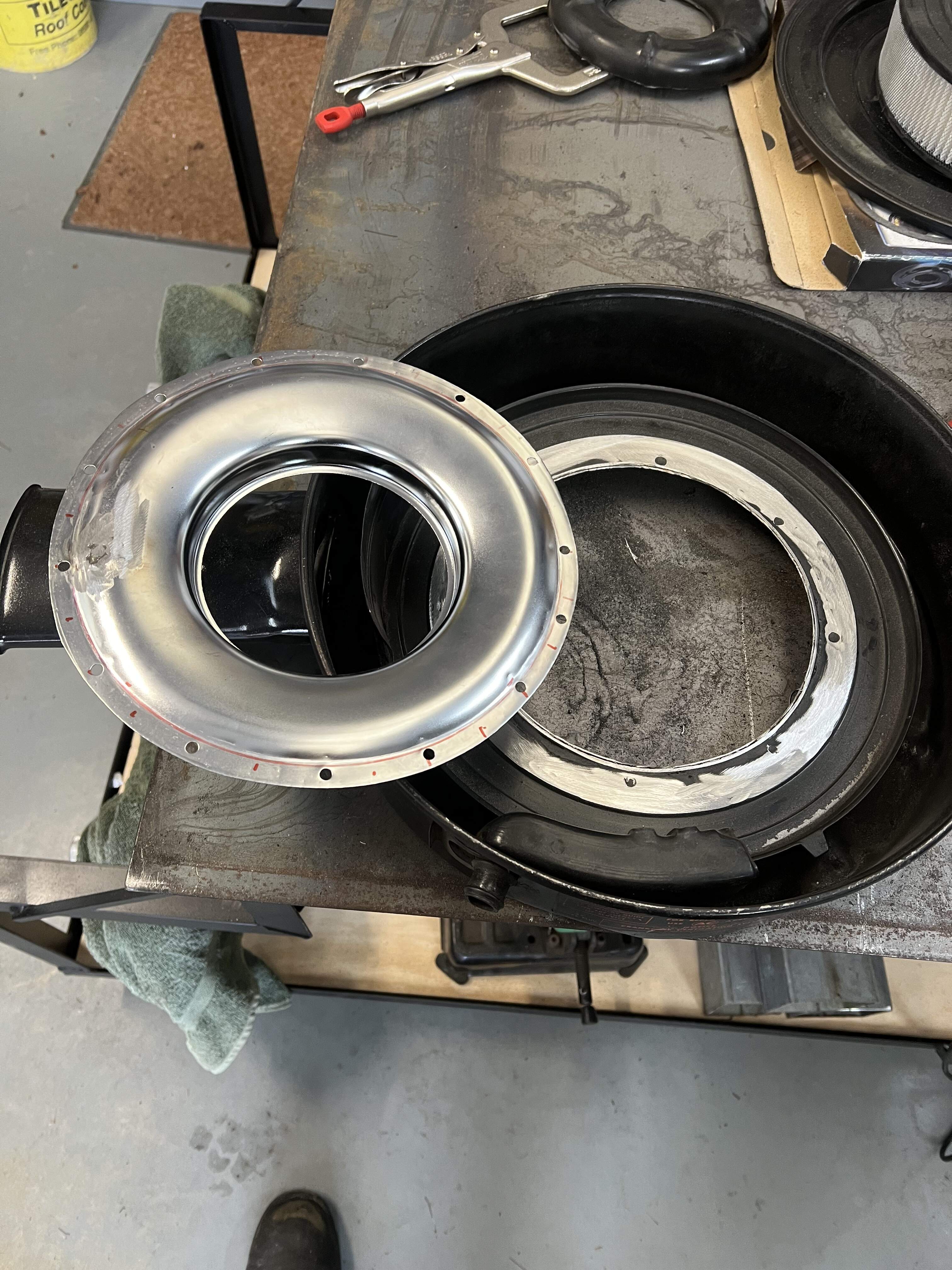

You will recall i have upgraded the 64 with her 389 to a brand new edlebrock 1906 carb... and then i found that my stock air cleaner wont fit !! the bloody new carb is 5 and a bit inches and the old carter was 4inch and 3 what evers !!
sooo, i was thinking out side the square and thought i would find a latter model air cleaner and chop it up to make my stock one fit...ย  then i found this ...
https://www.trademe.co.nz/a/motors/car-parts-accessories/performance/fuel-systems/listing/4123689044
ย as base, i can weld into my stock air cleaner !!!:dancingpontiac:
ย What i like about this base is it has that sexy curve !! so the air flows down the throat ... most after market stuff is flat base, no thinking about air flow... the bulge makes for a nice curve for the air to flow down into the carb.... see!! sexy as aye !
So what does a kiwi do ? hit buy now !:dancingpontiac:
ย i will up date when i get the base and show you all what my plan is... super simple yet cool, because i really want to keep my stock 1964 air cleaner on my stock 1964 bonniville..:dancingpontiac:

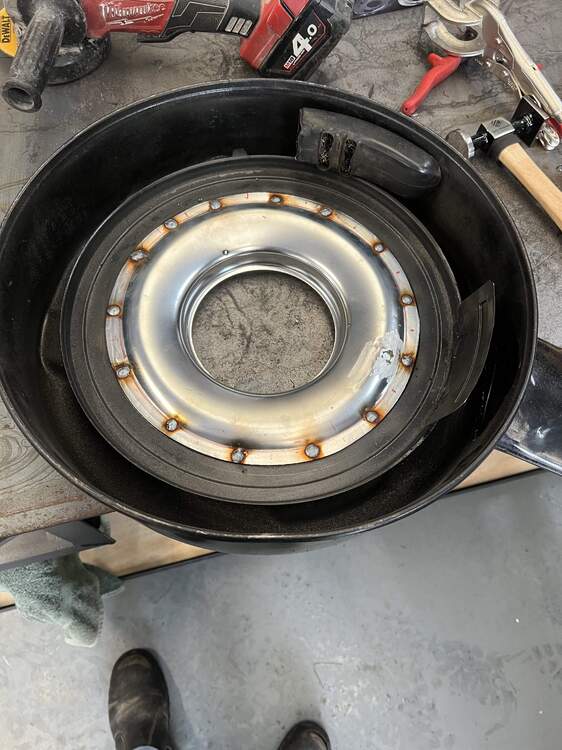

That is a nice piece, basically same thing i did but you don't have to go out and hunt down a donor air cleaner, didn't see a price?
i hit buy now and its $38 nzd with shipping ... lets see what i get Andy !

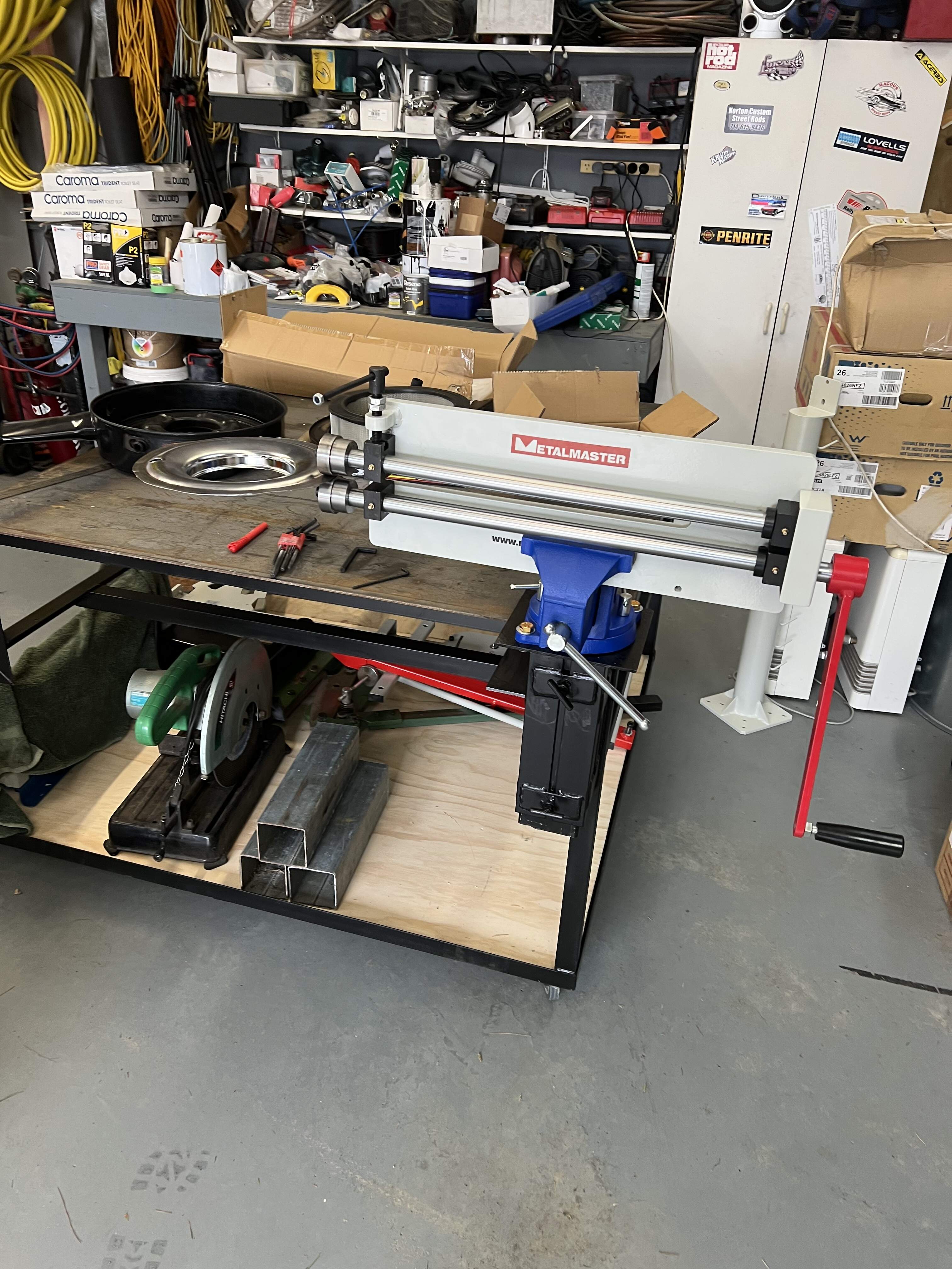

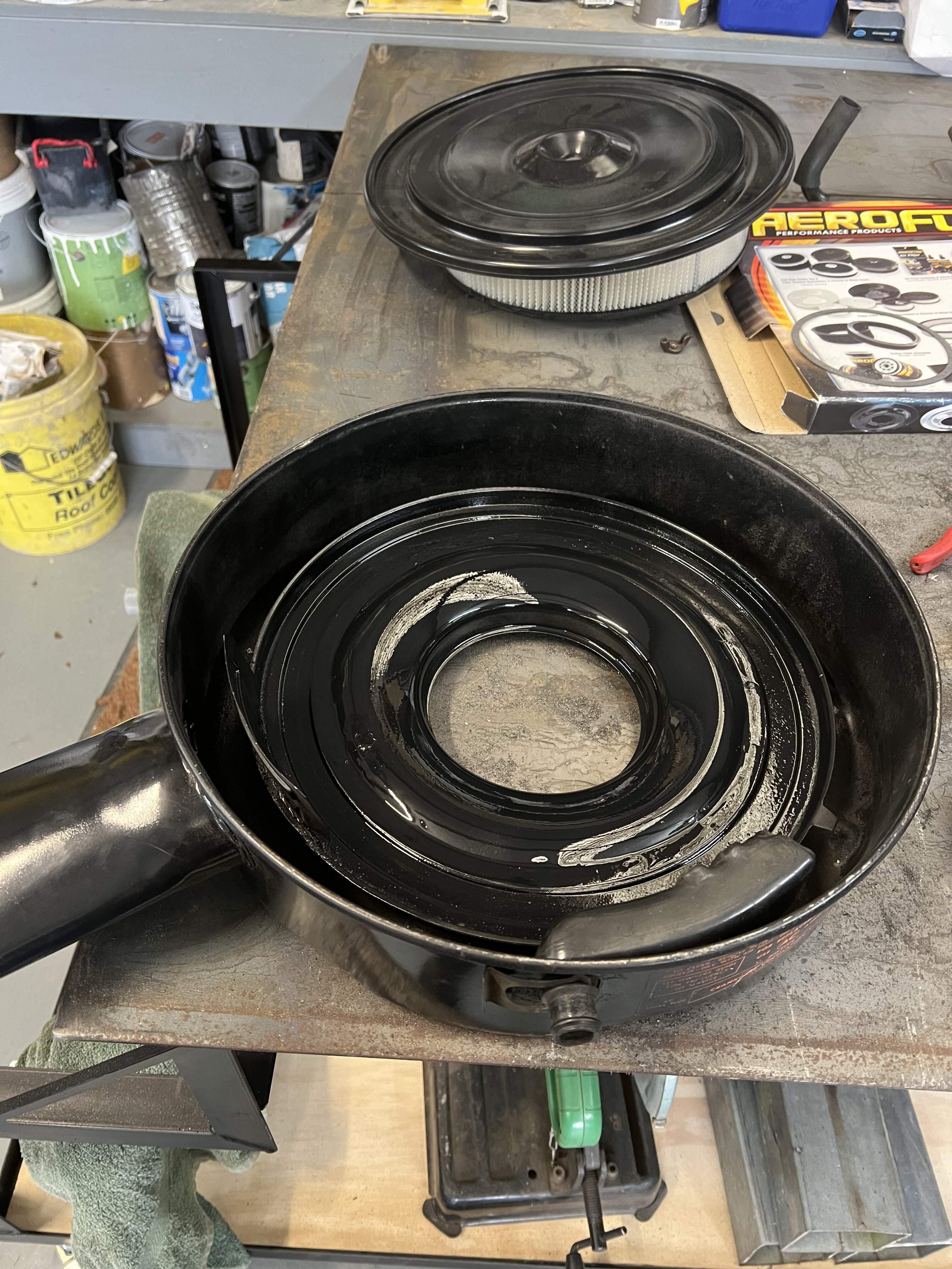

The air cleaner base arrived and I am happy with the nice swept entry to the throatย
So I got to test out my new bead roller that came with a pair of shear wheels and chopped it downย
Punched some 5mm holes in itย
And itโ€™s ready to plug weldย

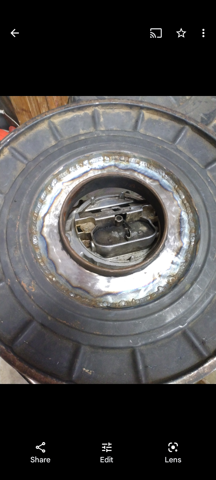

I cut the old carter sized center out of my factory air cleaner and in with the new 5 1/4 throat to suit the edelbrock.
And coat of rattle can blackย
And the rain has stopped !!! So while that dries I can get the Safari ย in onto the hoistย :dancingpontiac:
