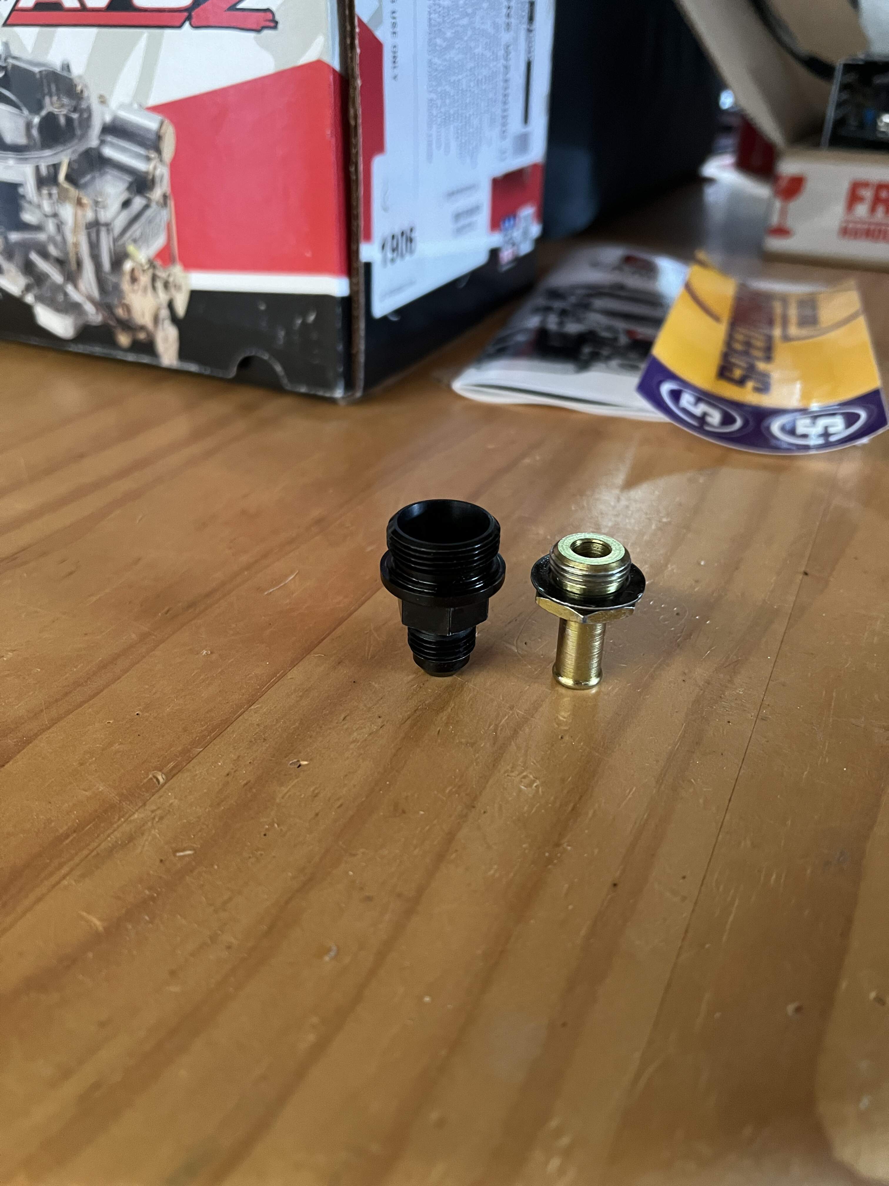

popped off the linkage
undid the an fitting into the old carb … best I check it will fit the new Avs2……
/cdn-cgi/mirage/d0d7b897c25fd0e39d513e1f86efac0d067aaea4978f01975f03818c57b48a29/1280/https://foreverpontiac.com/uploads/monthly_2023_01/0BD2C537-6951-496B-B90E-DB5ABC8DF9CB.thumb.jpeg.0c1d57106cc58b7312ce35e31ae4c740.jpeg
Fail !
the old carter has a way bigger thread ( i think the old/bigger thread is the same as holly)
so I put it all back together and parked her back outside !! It’s Sunday here and there will be no one open that has the right a fitting to hook to my fuel line .
One step forward …. One step back !

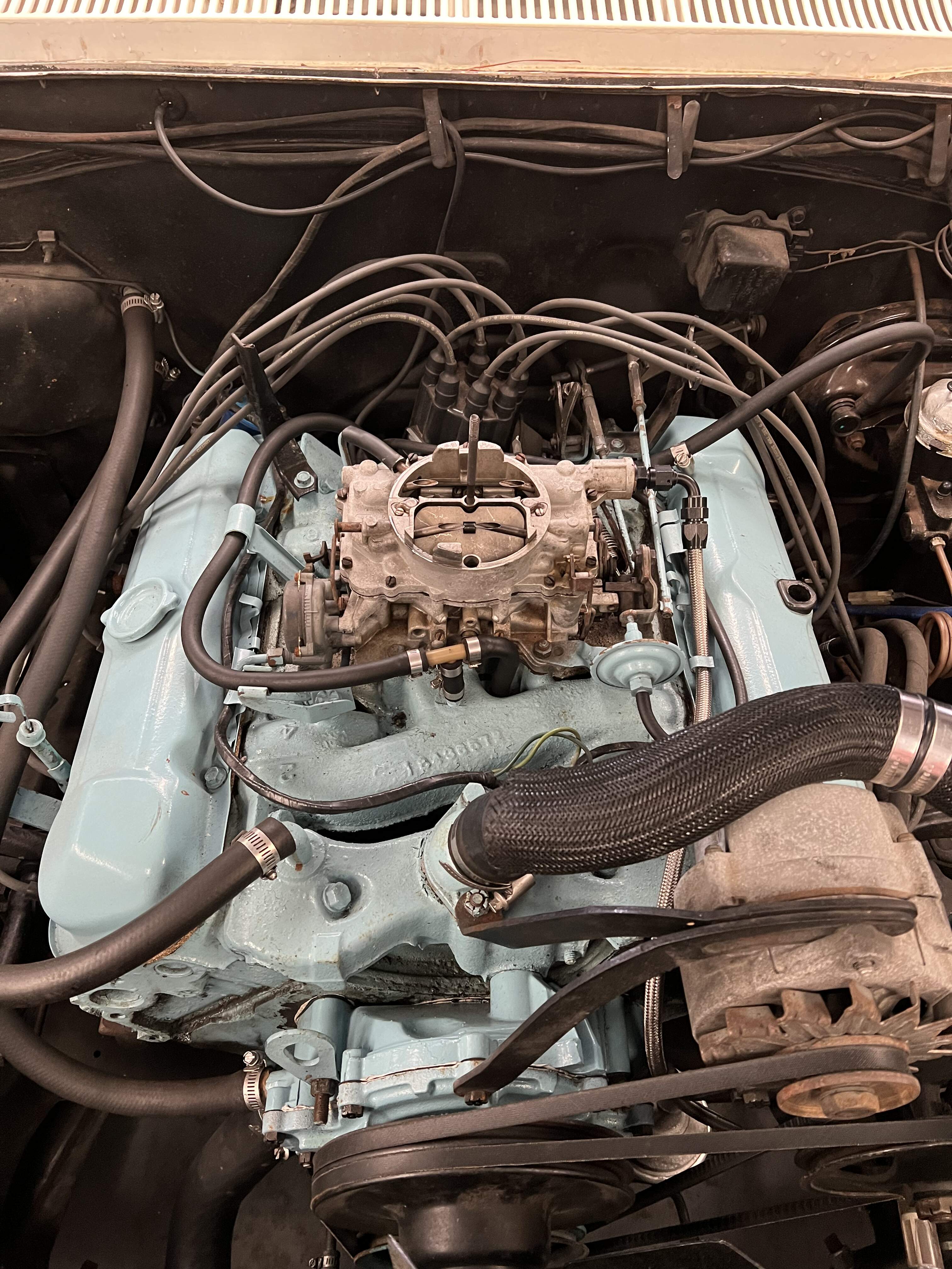

while under hood looking at the diffance of the linkages i noted i am going to have to make custom bracket for both the accelerator shaft and the trans shaft, the avs2 has nothing even close to the original carter ! /cdn-cgi/mirage/d0d7b897c25fd0e39d513e1f86efac0d067aaea4978f01975f03818c57b48a29/1280/https://content.foreverpontiac.com/emoticons/default_dancingpontiac.gifgota love aftermarket !!!
/cdn-cgi/mirage/d0d7b897c25fd0e39d513e1f86efac0d067aaea4978f01975f03818c57b48a29/1280/https://foreverpontiac.com/uploads/monthly_2023_01/378FCDB9-DF75-4E9D-8FBA-80D2B8FC122D.thumb.jpeg.64298d648c6f9812d42bf5c39020ed69.jpeg
Sounds about right,i had to do something similar on the Edelbrock carb and i had the aftermarket intake manifold also so o had to Frankenstein the bracket for the cables also.
Does yours have rods for trans and throttle?
Yes it does
and they have to be bang on to work correctly

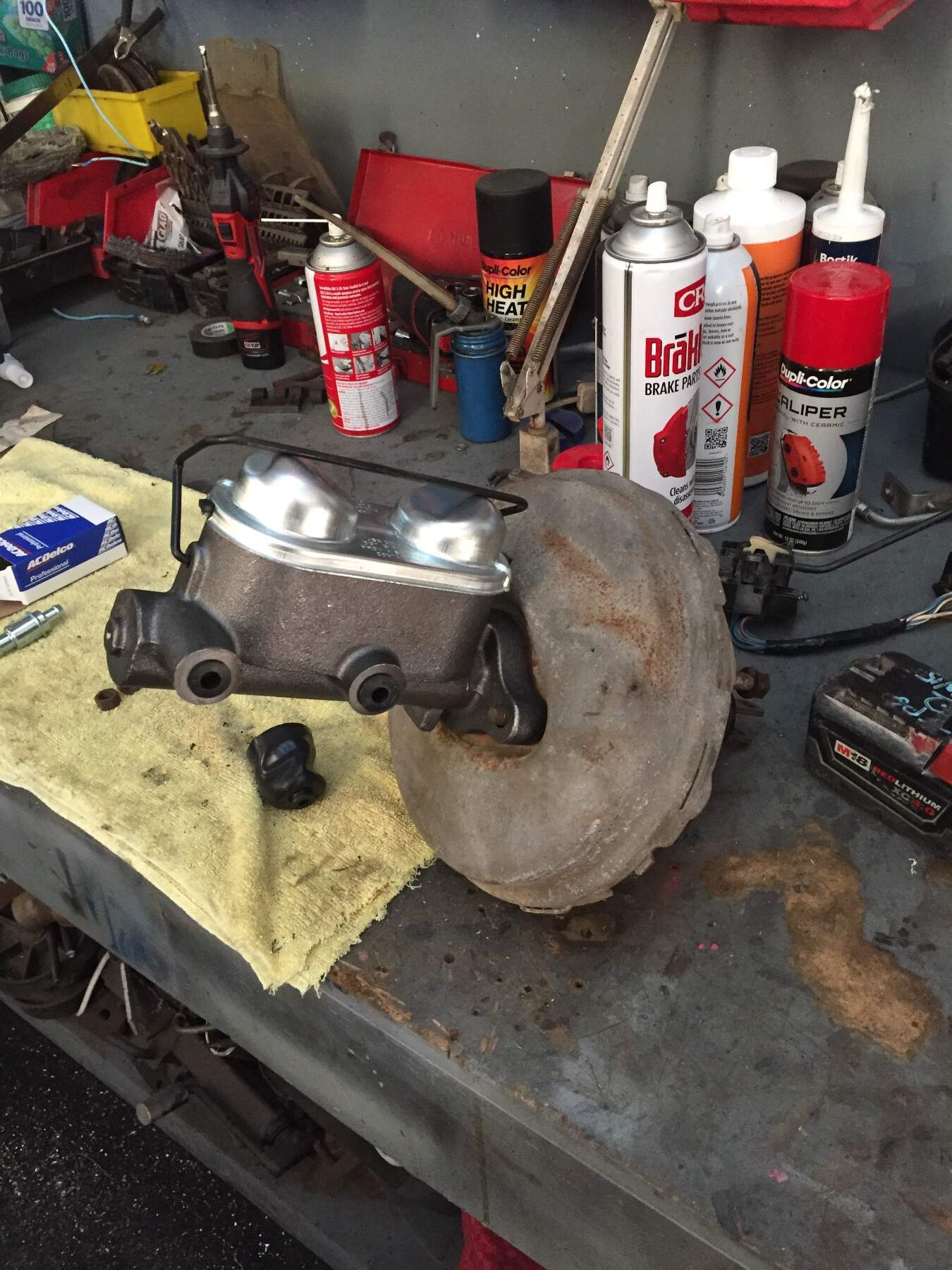

Just arrived is the 69 Belair master cylinder,👍
Fitzy the part number on rock auto is ce 130.62016
and I tried it on the spare booster I have and it’s a perfect fit .... remember , my 64 is drum/ drum , so this is the correct one for my factory set up but wayyyyyy safer with its dual circuits
Its about now that i love gm using generic parts!!!
So anyone reading this, and if you have a 61-68 with the single outlet master cylinder for your brakes, here is your best buy !! a factory configuration, dual circuit brake master cylinder. ( i am guessing that Pontiac used the single outlet master cylinder all the way up to 68 on the wide body cars)
This one part could be the difference between life and death if your single outlet master cylinder had a fail in any one of the four brake corners of your Pontiac .:dancingpontiac:
i will, when i get time post the swap over from the old master cylinder too this dual port unit...
It will be easy as its justA plumbing :rofl:
I was wondering if you did this install yet? I’m going to attempt it myself. If so, any process pictures?
No Del I haven’t yet
I was going to hold off until the car was inspected then swap them over . It will be super easy as bolt holes are correct … plunger is identical .. that justA leaves splitting front from rear pipe work and remove the tee section on the chassis
