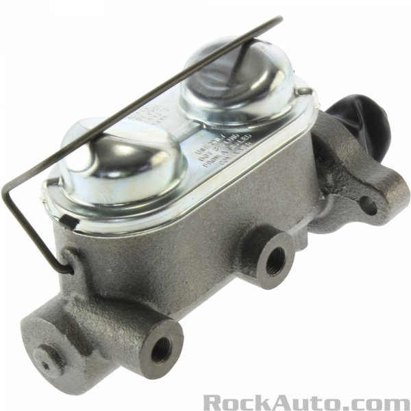

So i have found a 1969 chevelle has a drum/drum master cylinder and i can get one off rockauto !
so i have bought a master cylinder thats for a 1969 belair drum /drum car.ย
i will put it on the shelf till after i get the car legalย ๐Ÿ‘
ย
That looks perfect. Well done. Can you post the rockauto part # for me please?
Just arrived is the 69 Belair master cylinder,๐Ÿ‘
Fitzy the part number on rock auto is ce 130.62016
and I tried it on the spare booster I have and itโ€™s a perfect fit .... remember , my 64 is drum/ drum , so this is the correct one for my factory set up but wayyyyyy safer with its dual circuitsย
Its about now that i love gm using generic parts!!!
So anyone reading this, and if you have a 61-68 with the single outlet master cylinder for your brakes, here is your best buy !! a factory configuration, dual circuit brake master cylinder. ( i am guessing that Pontiac used the single outlet master cylinder all the way up to 68 on the wide body cars)
This one part could be the difference between life and death if your single outlet master cylinder had a fail in any one of the four brake corners of your Pontiac .:dancingpontiac:ย
i will, when i get time post the swap over from the old master cylinder too this dual port unit...
It will be easy as its justA plumbingย :rofl:

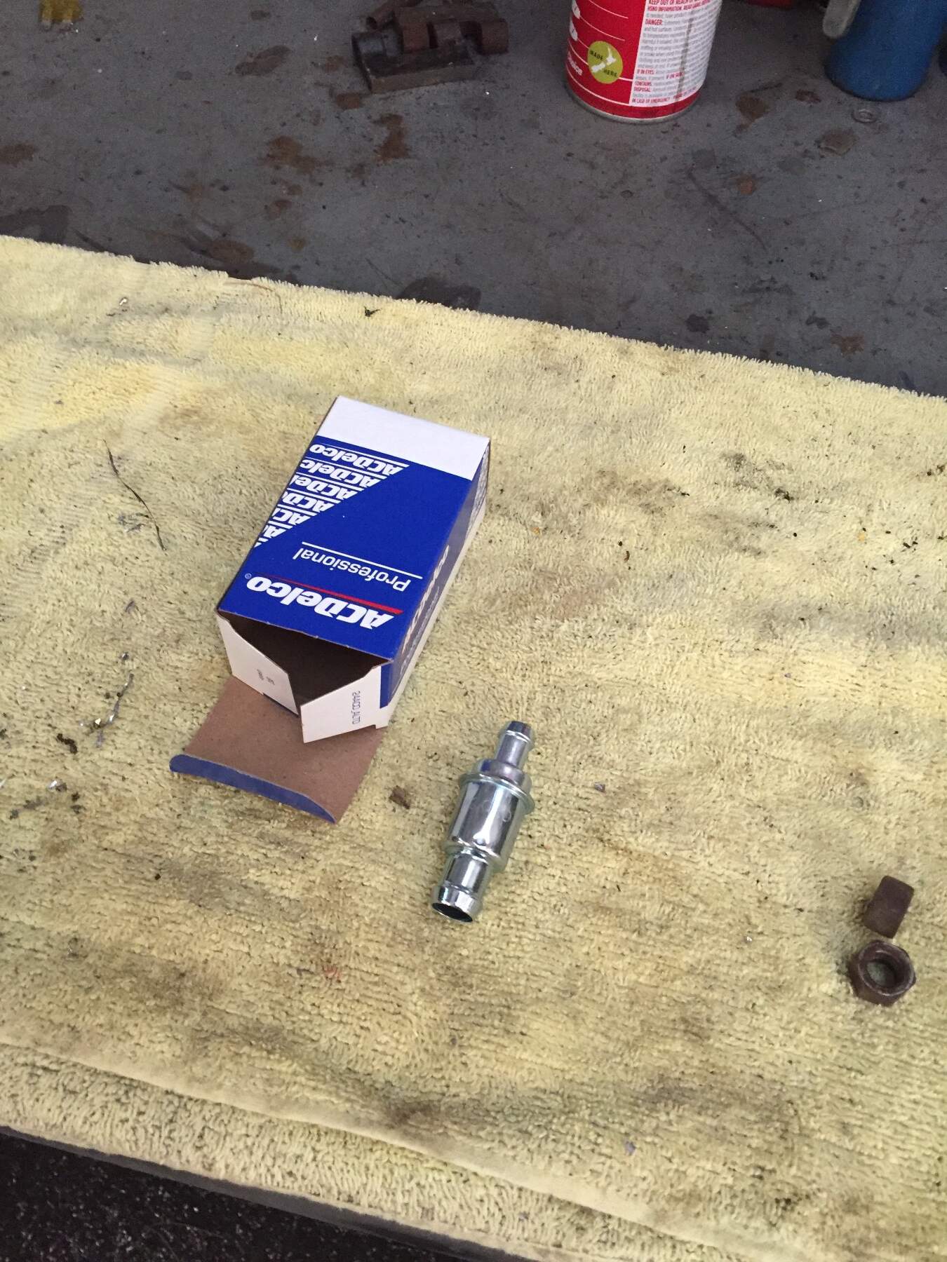

Along with the new master cylinder was my new pcv valve, easy install too, but i may just check my idle mixer setting after i have installed the new valve.... it may change things , not sureย

So, I've always wondered about this: how are you going to configure the outlet connections? Are you going to dedicate one reservoir to say, the front brakes and the other to the rears? I believe the factory setup is for each reservoir to activate a triangle of both fronts and one rear, so that you will always have effective braking no matter what.

What is the diameter on this one vs your stock one?

its 1 inch Andy, same as the stock one but with 2 chambers

So front chamber feeds the front slave cylinders and the rear chamber to the back slave cylinders mate, and if the back brakes lock up before the front i will add a adjustable propositioning valve to the rear brake line and adjust so the front gets more fluid than the back, but i should not have to do this as its a drum/ drum master cylinder with equal amounts of fluid going to both front and rear. and remember, my front drum brakes are bigger and that should make them work better than the rears. :cheers:well thats what i expect to happen !!! hahahaha
This wont be done yet as i think i will get it legal and then change the system.( i dont want the powers to be, pointing at my master cylinder and saying "oh thats not stock" !!! "you will have to get that certified" )
once the car is road legal they will never look at it again, but i know the upgrade will make the car safer !!
What i will do is i have to go through the exercise on the mk1 cortina, so i will post else where on how it works on that car, it has a singe outlet master cylinder and i have a datsun 120y - 180b dual master cylinder coming from ozzy for it that is configured disc/drum for that car:cheers:ย
