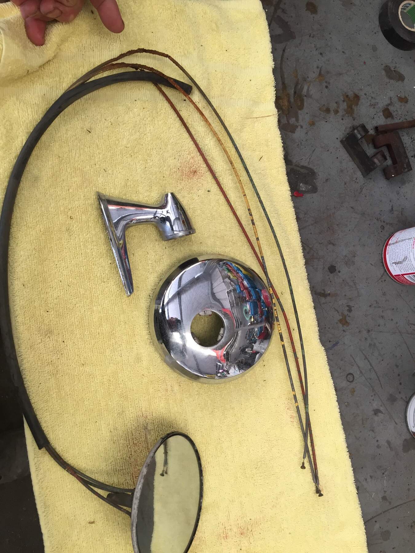

The drive side remote mirrow is stuffed
you can see the cables are rusted out
but I did see Ames do a replacement
so I am not even going to bother with this old one

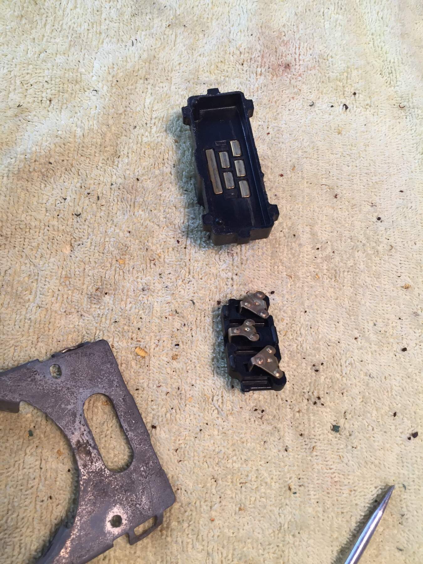

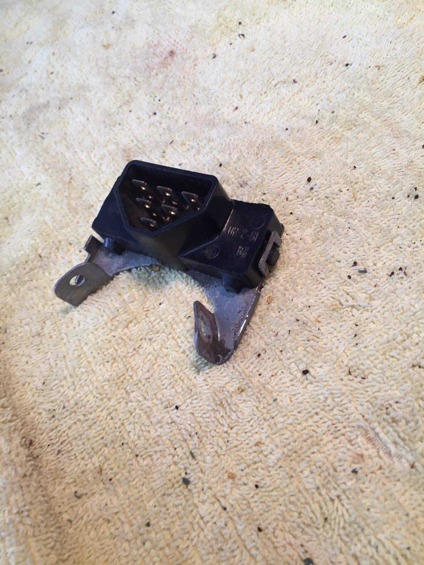

The indicator switch has been stying on after switching left so I pulled the switch opened it up and justA checked the contacts
which where clean
what I did notice is you can move the switch around where it’s screwed to the steering colum
Don't forget I am bringing my old remote control mirror with me, although it's been fiddled with and as far as I was concerned, was not worth the effort to try and repair it. I am sure you will be far happier with a nice new reproduction. I replaced mine with a standard 'lean out the window and adjust' mirror because, really - how often will you need to adjust it?
As far as the indicator mech goes, are you saying the stalk won't self centre after you straighten the wheel, or does the indicator itself continue to work even though the stalk has returned to centre?
yes mate, the whole switch mounted on the colum can be moved to set the centre so to speak
yes mate i will wait, it was justA one of those little things i had left over i wanted to see what was wrong with it.... and i had a slow day today, not feeling flash again. so i was really just potting around.
I'll bring it over (along with the standard passenger mirror) later this year. I don't know how the 64 indicator mech works, but I've only ever known for the switch to remain static, whilst a nylon cancelling cam does it's thing. I am so fortunate that my own mech works faultlessly - I've never even looked at it. If it ain't broke - don't fix it.

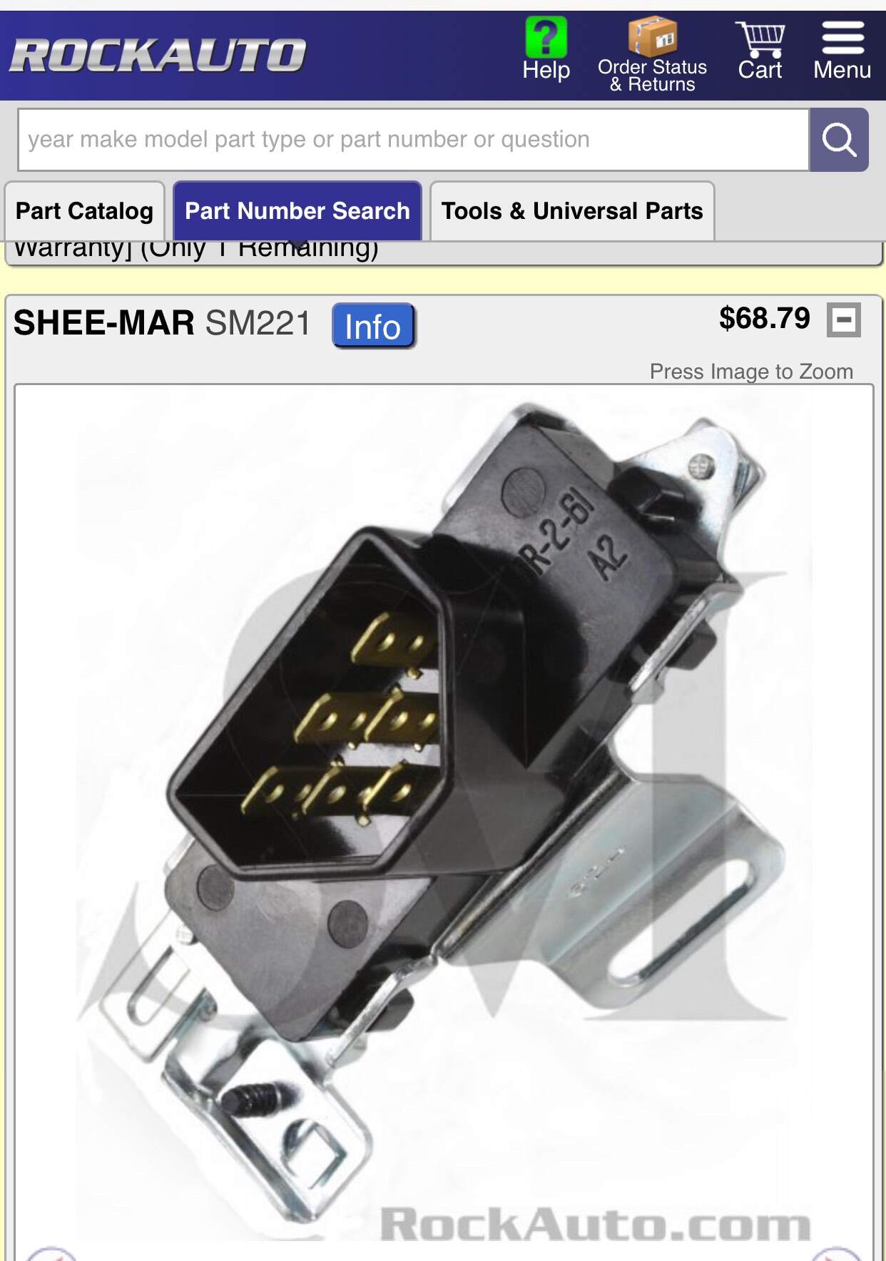

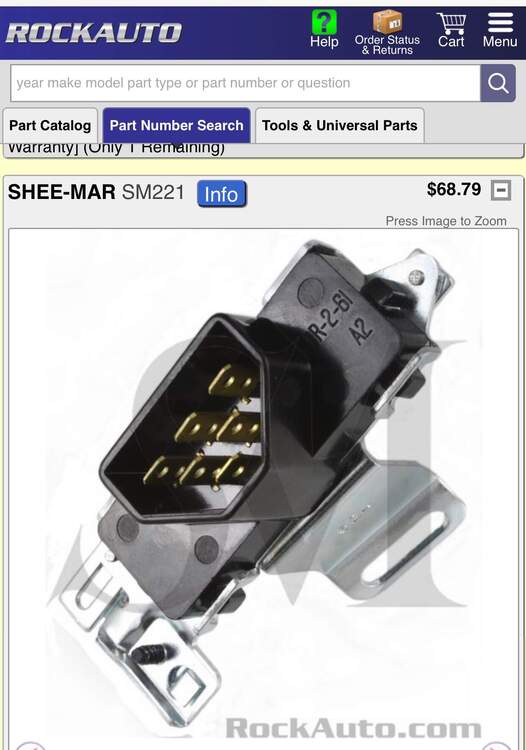

Here it is at rockauto. Same switch but you need to transfer it to your original bracket. I did one Bonneville but still need to do the other. I also need to find the switch in the column connected to the arm. It is tight compared to a new one.
cheers Del, i did pull my one apart and its nice and clean, and i did get it to worker correctly by moving its mounting screws 👍
your 65 may be different Mate, on the 64 the indicator stalk, operates a shaft down the column to a slide switch operated by a wire loop, and this switch is mounted on top of the outer column sleeve above the gear shift inhibitor switch
