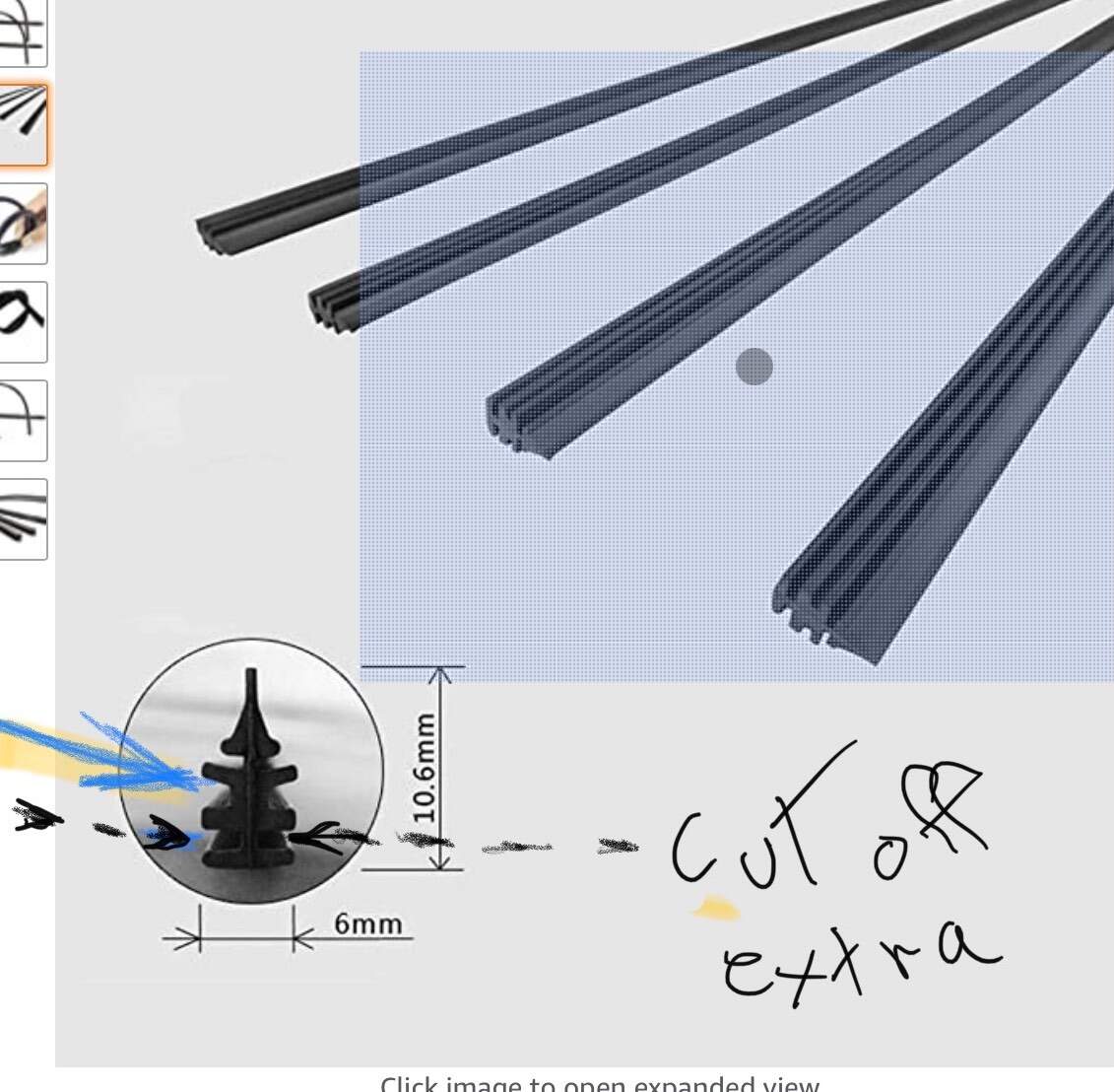

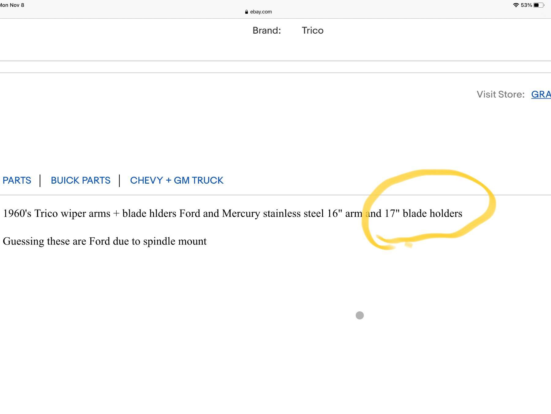

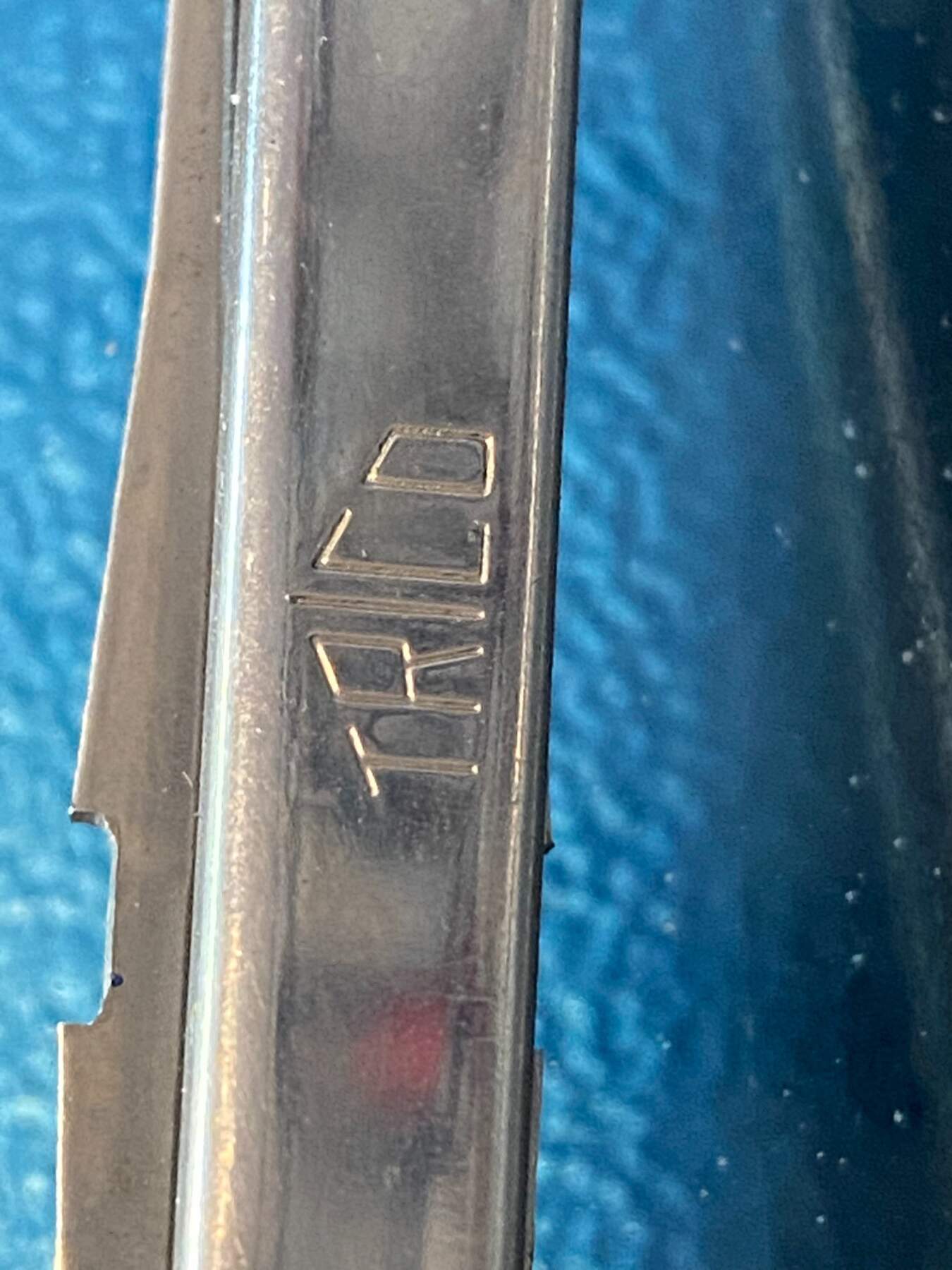

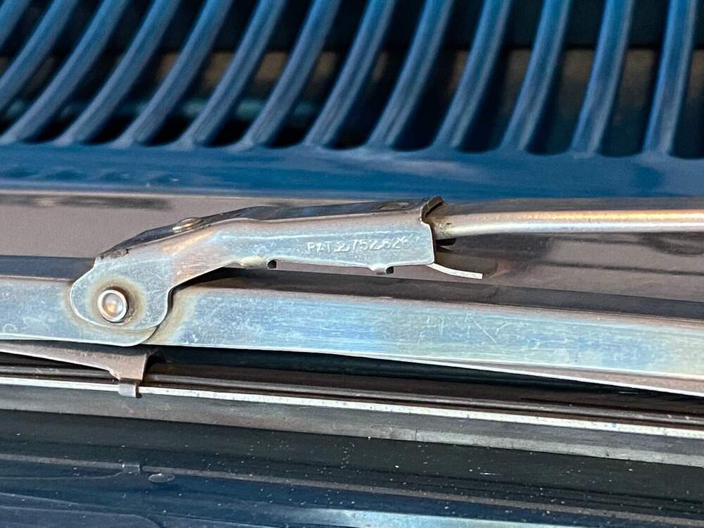

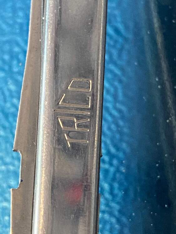

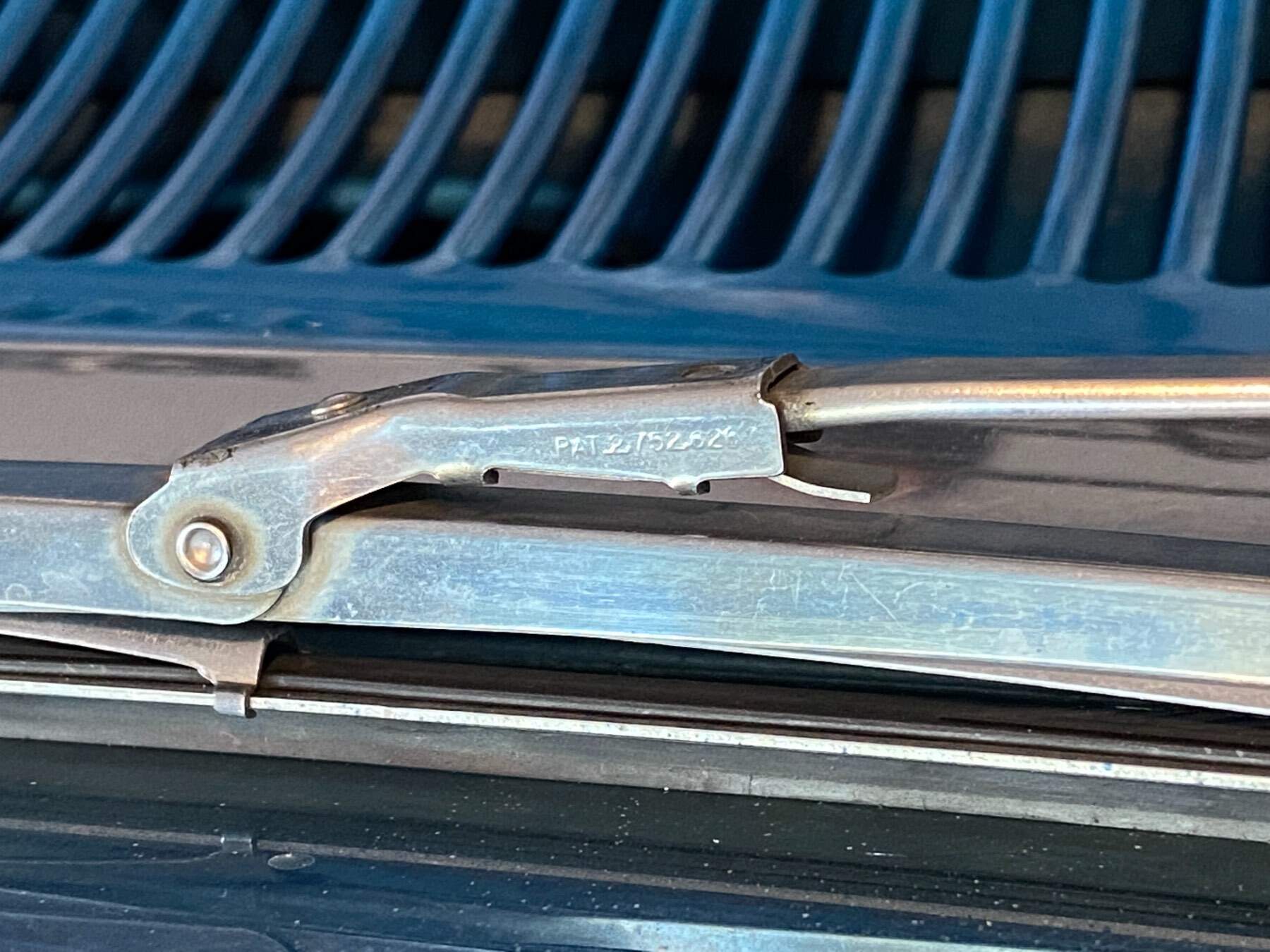

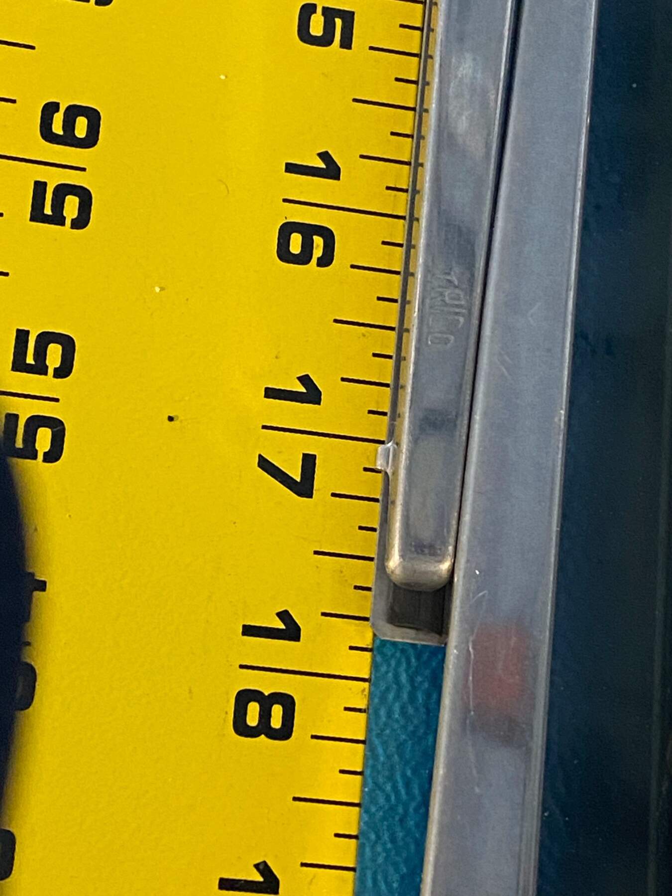

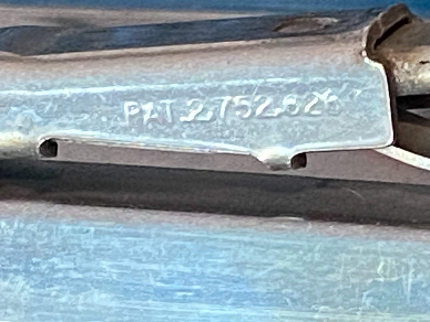

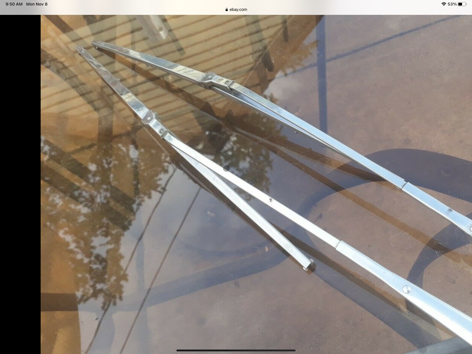

I have what looks like original stainless wipers on one Bonnie but not the other. It looks like mine are 17”. I don’t see them on Ames. I did a search on ebay and found a used pair of 17”. I know I can install new rubber myself. I would suggest searching 17” trico stainless wipers. First 4 pics are of mine and last two are what I just ordered on ebay.

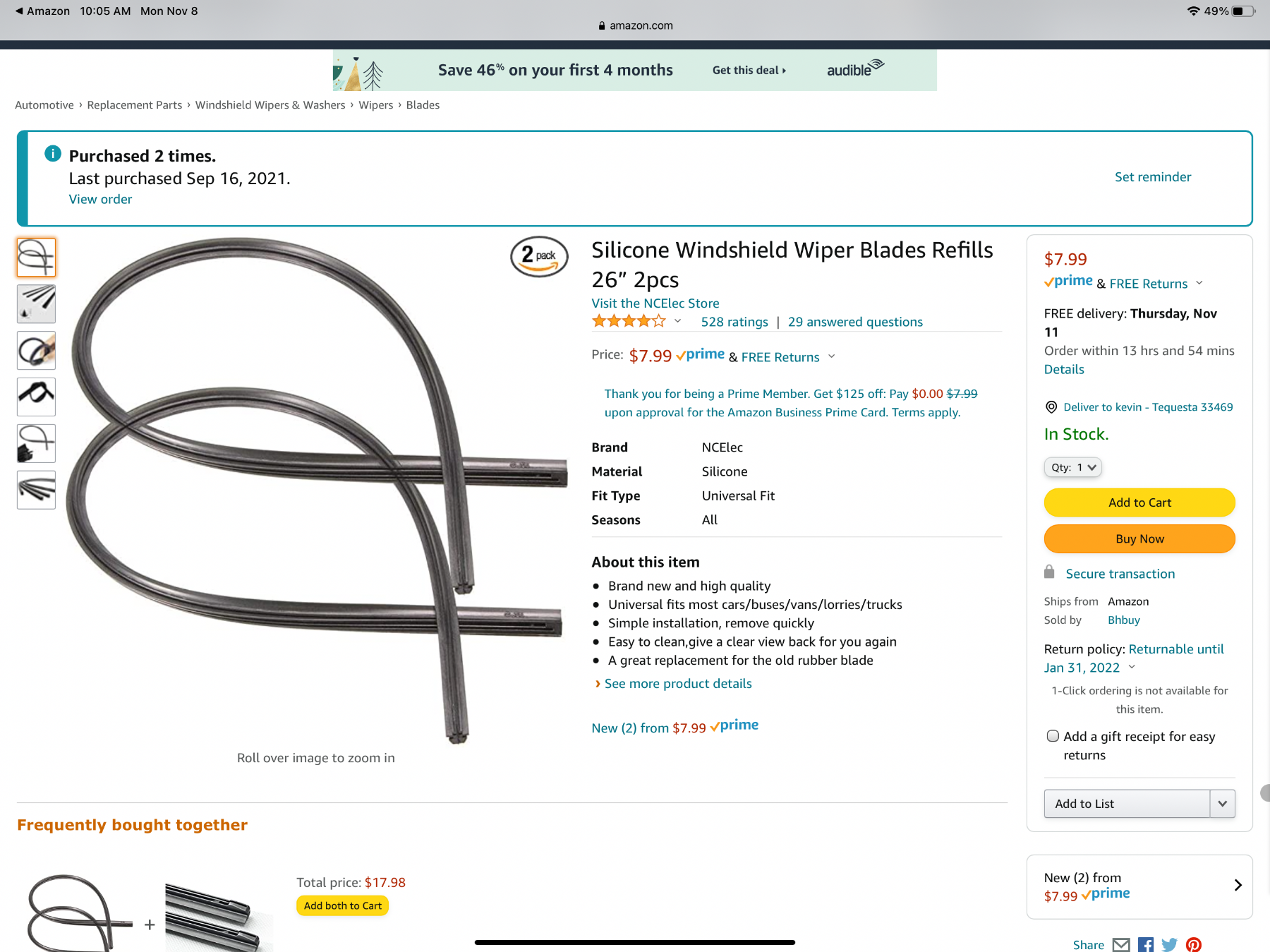

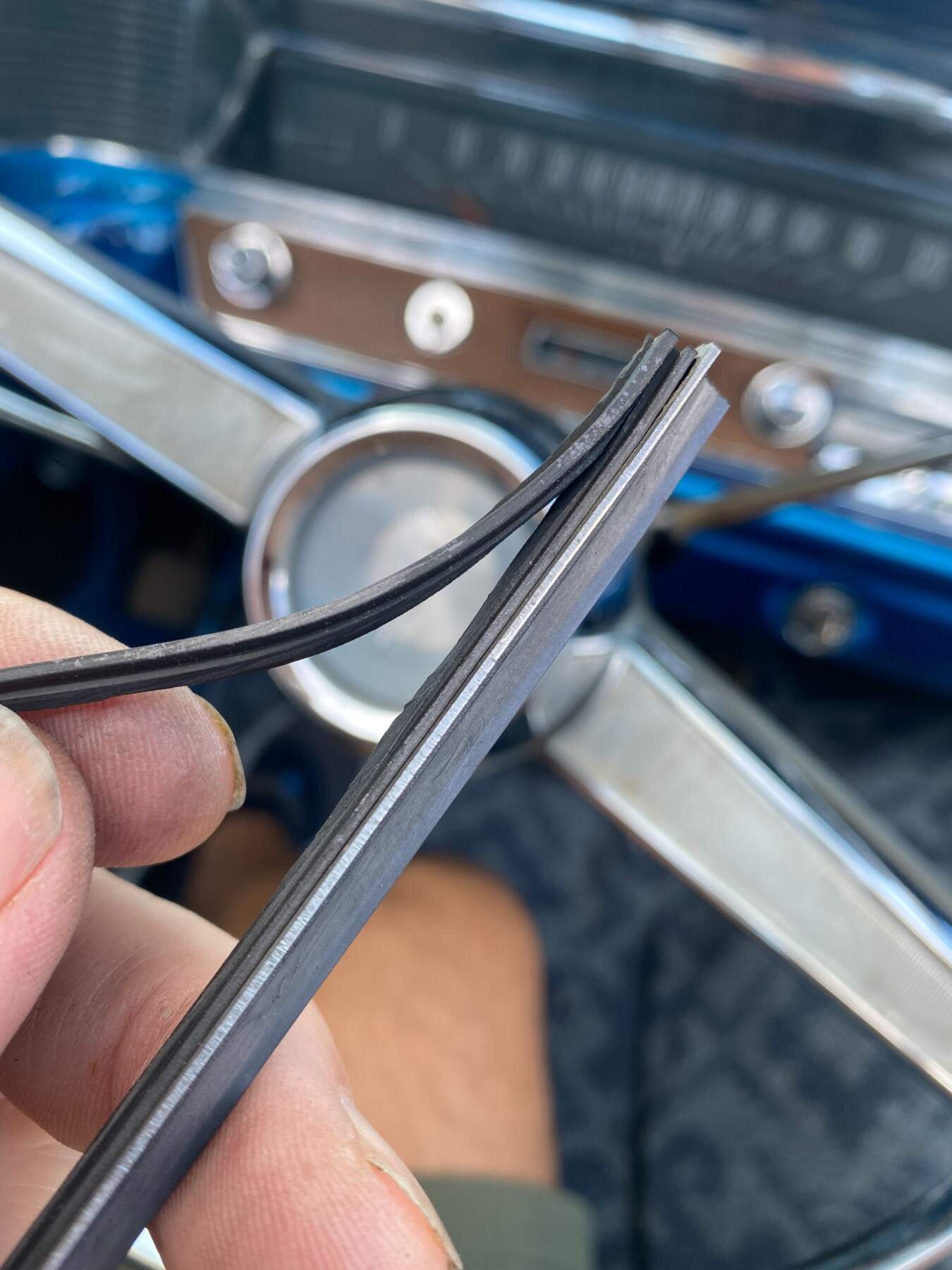

I bought this rubber on Amazon. You can see I slipped it in place on second groove and cut off the extra behind it.

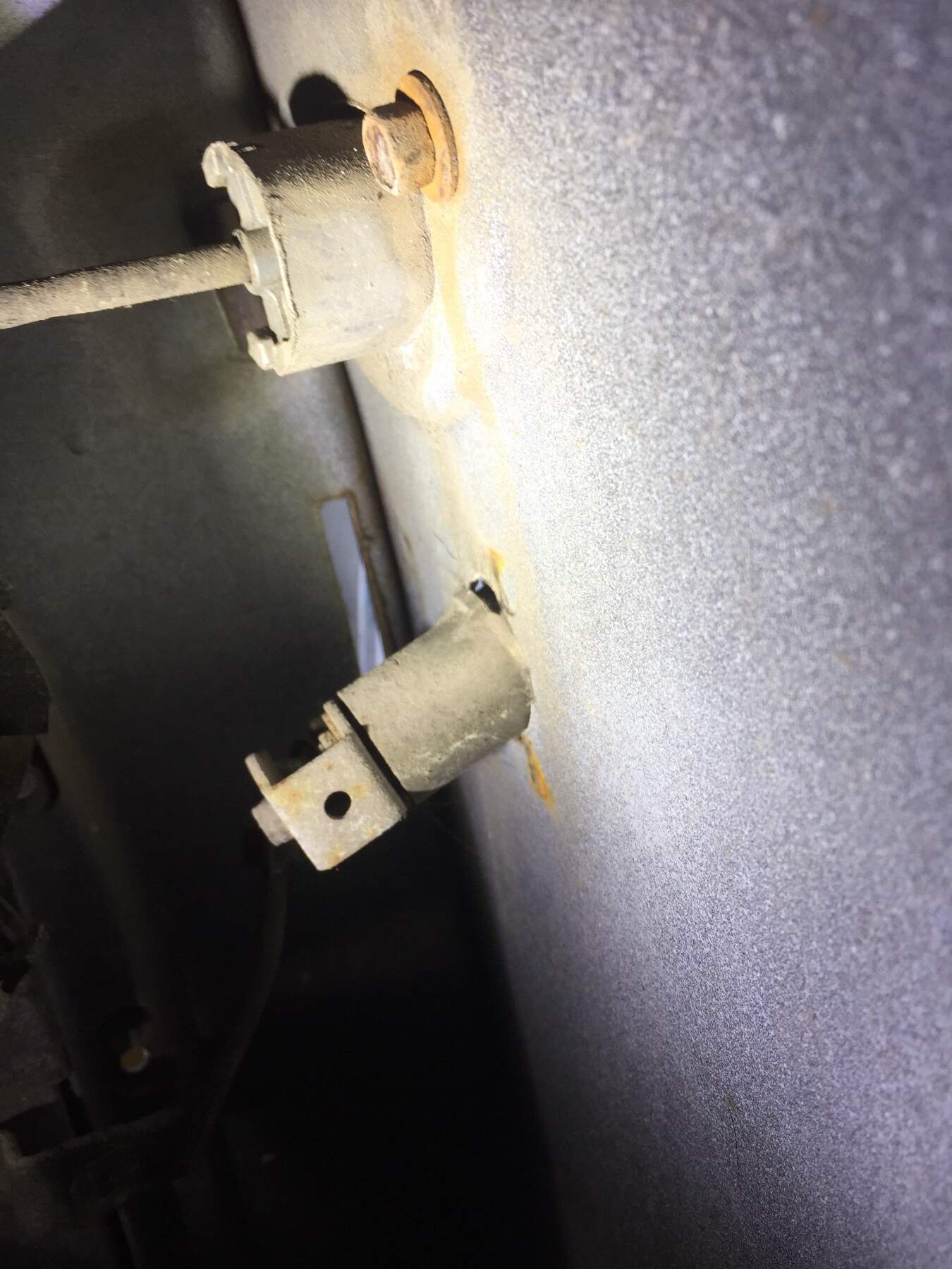

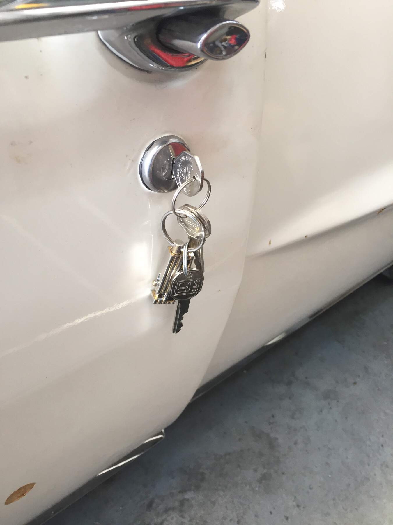

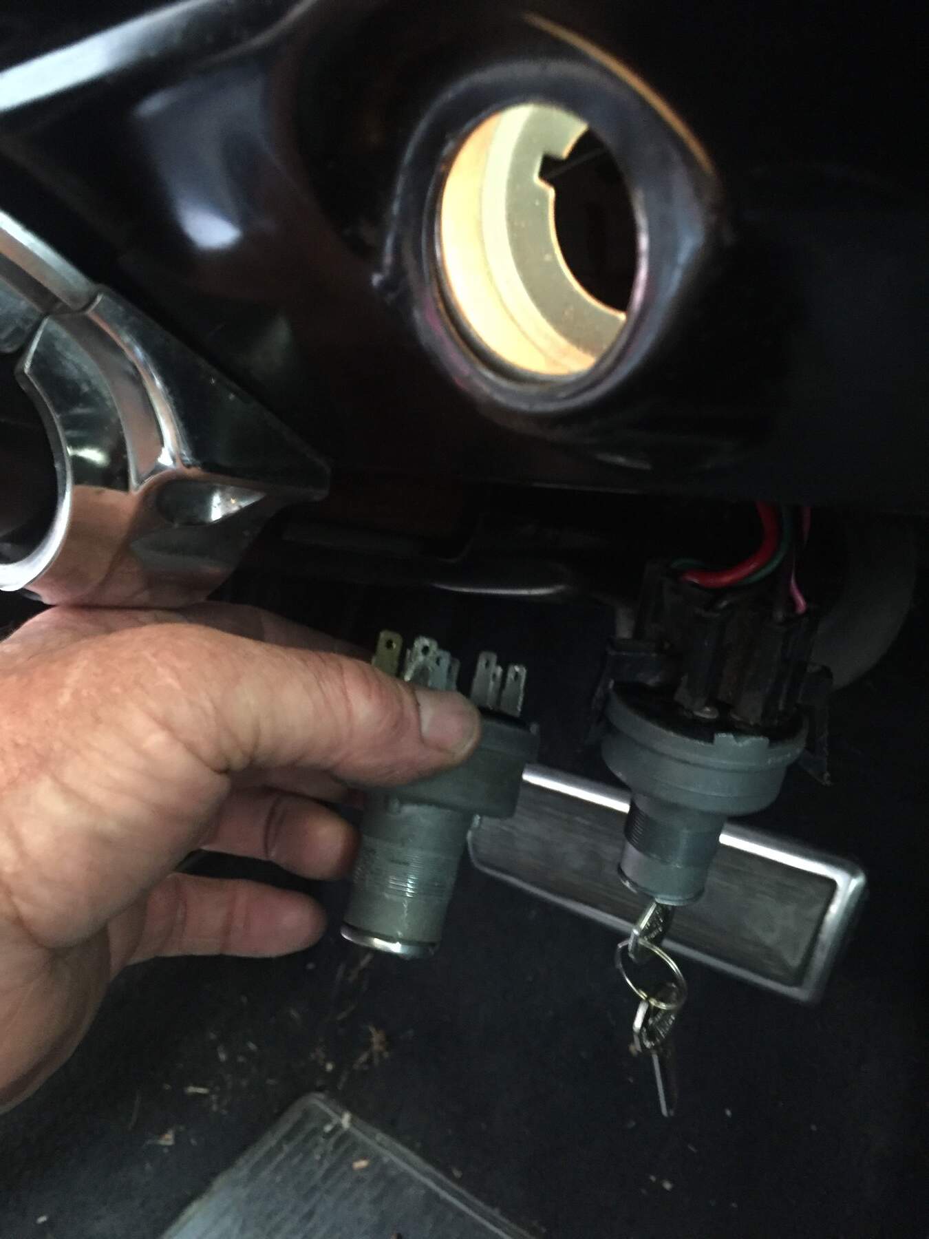

so Installed the new ignition switch

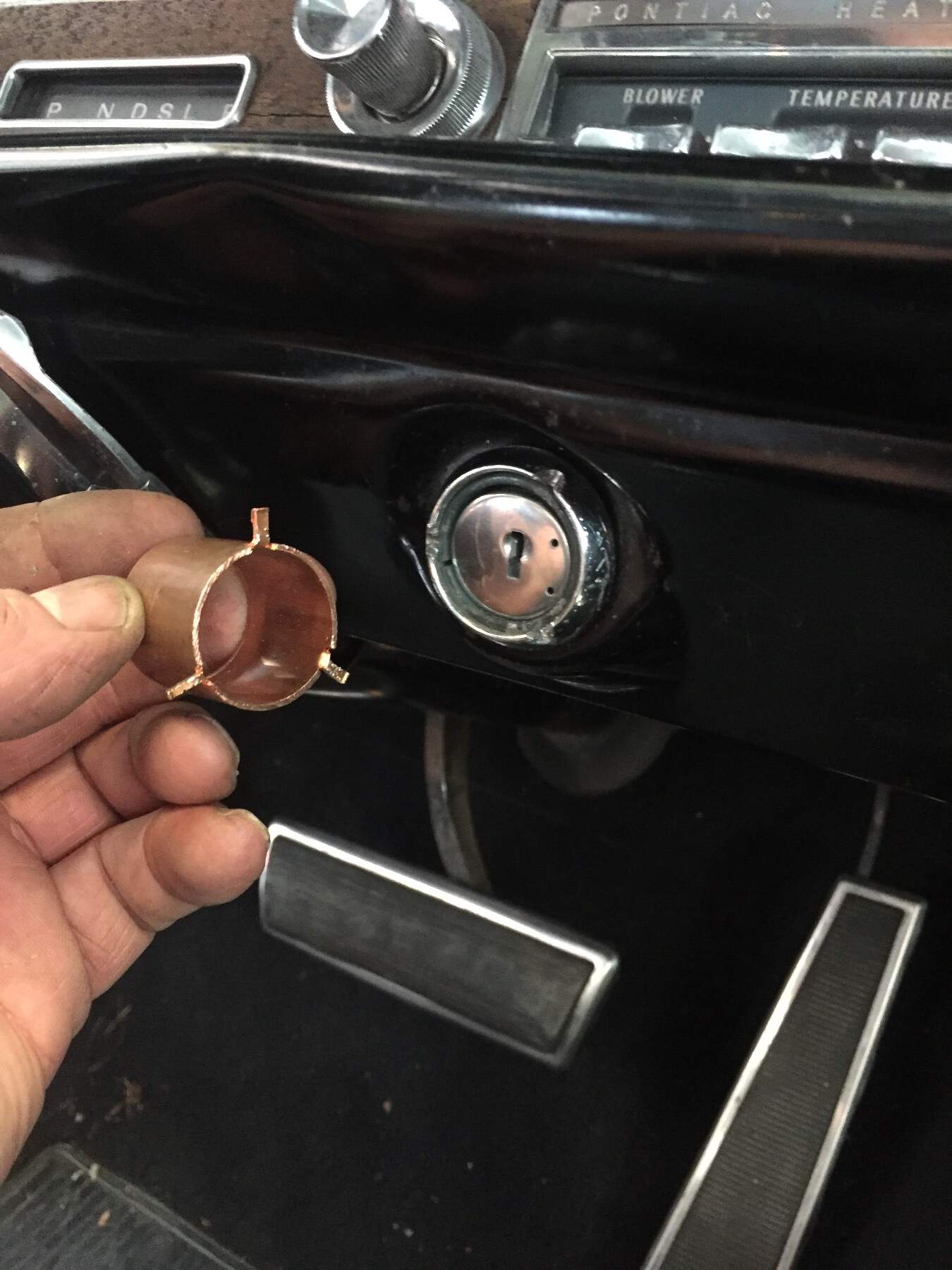

I made my own bezel key out of a bit of inch copper tube to lock into the 3 keyways which took longer to make than installing the new switch :rofl:

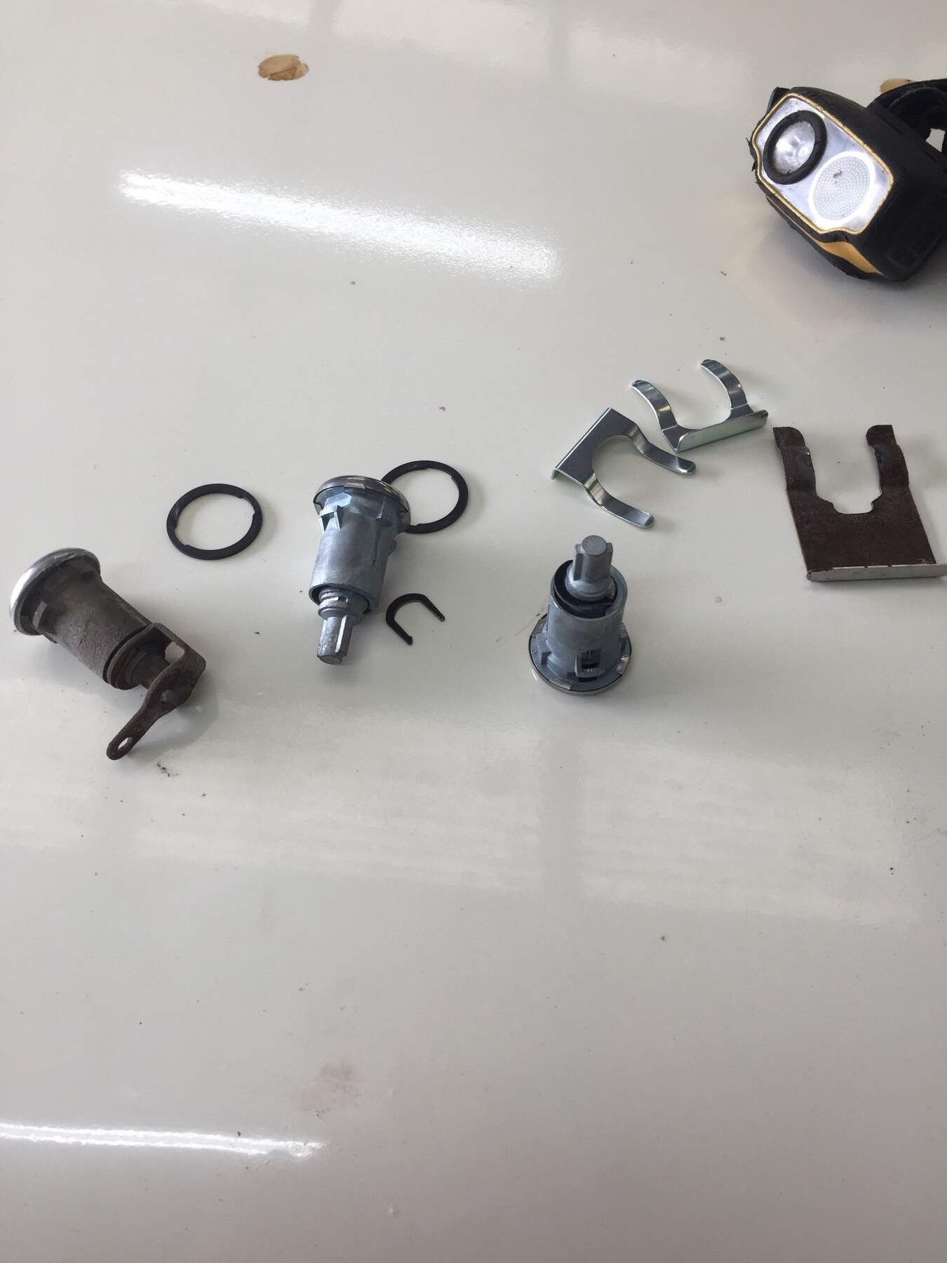

Then with the matching Ames door locks in hand I popped the door trim off and installed the new lock barrels along with gaskets
The retaining clips are wrong for a 64 bonneville so I reused the factory ones that slide in from the door jab
and now I have one key that unlocks the car and starts it and one for the trunk 👍👍👍🍻

Oh, by the way Kiwi - I am super impressed with your homemade 'bezel removal tool.' What a cool solution. I've always attacked mine 'butcher style,' a pair of needle nose pliers and a hammer, or a little screwdriver tapped around.
