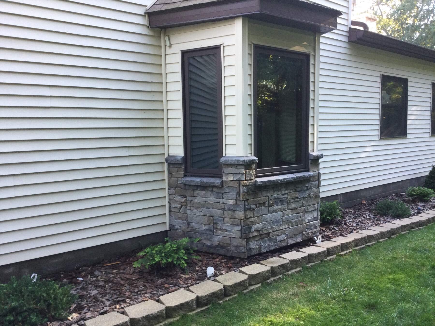

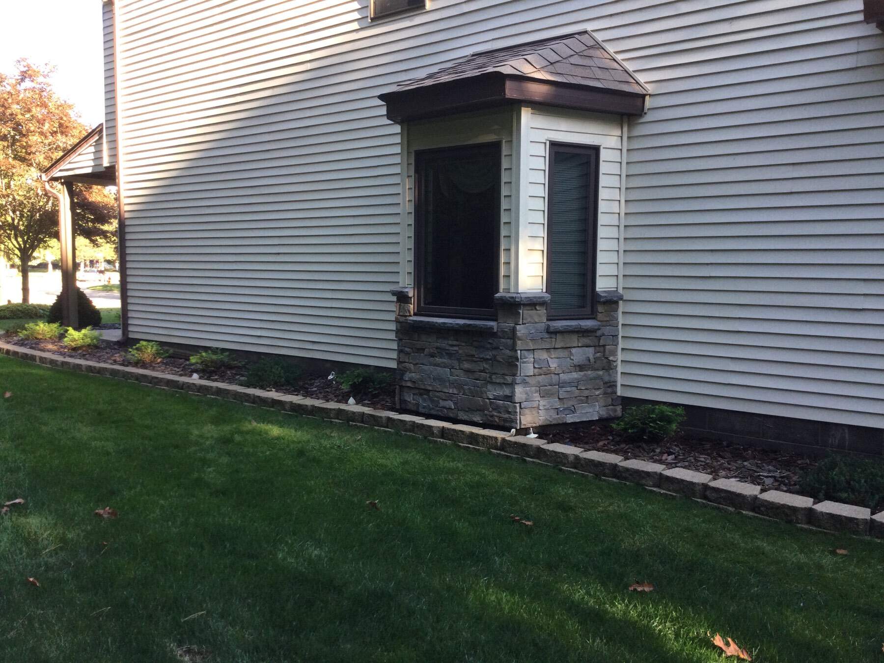

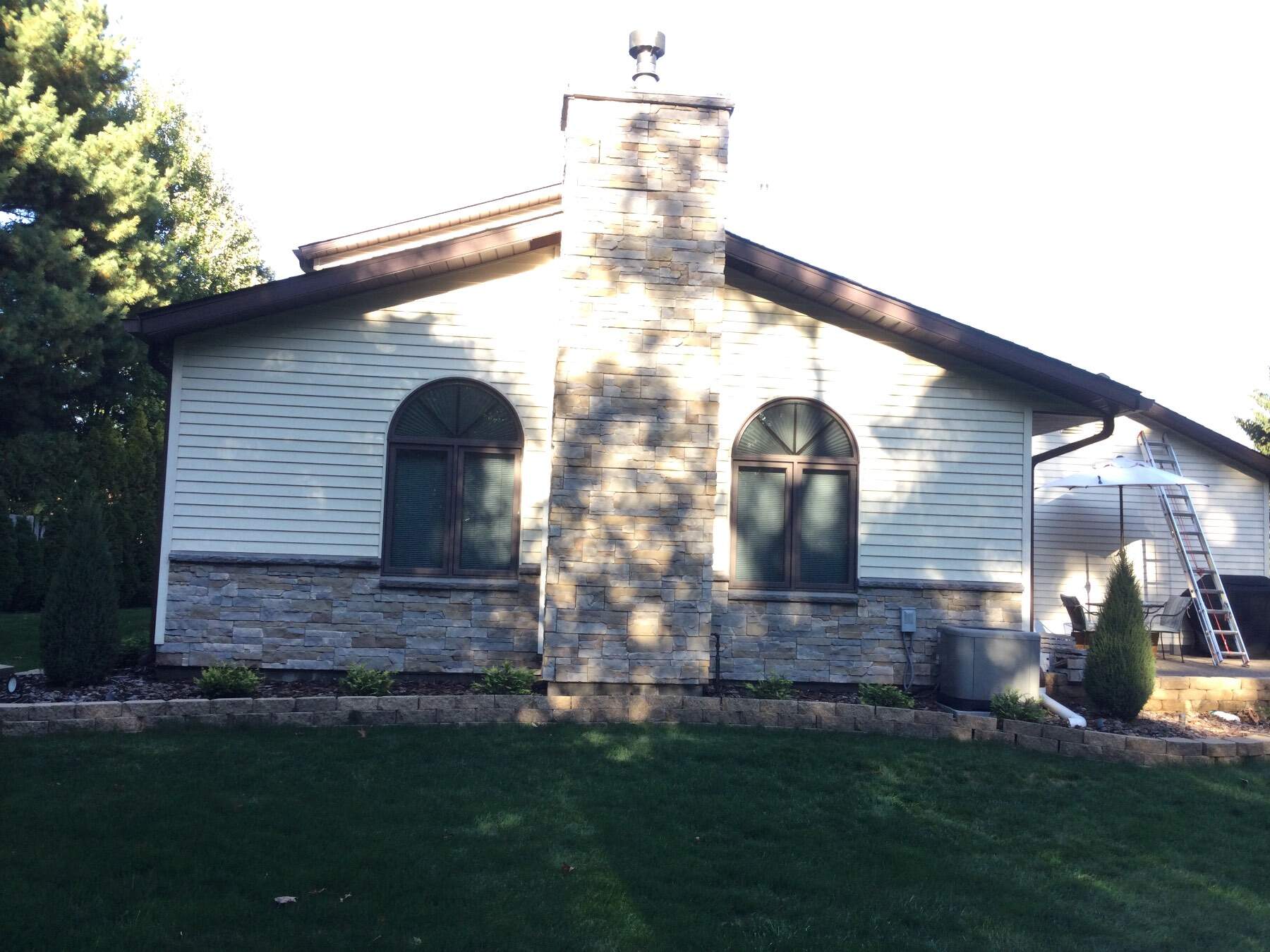

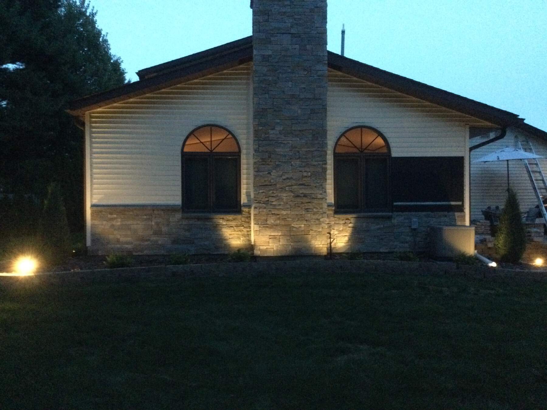

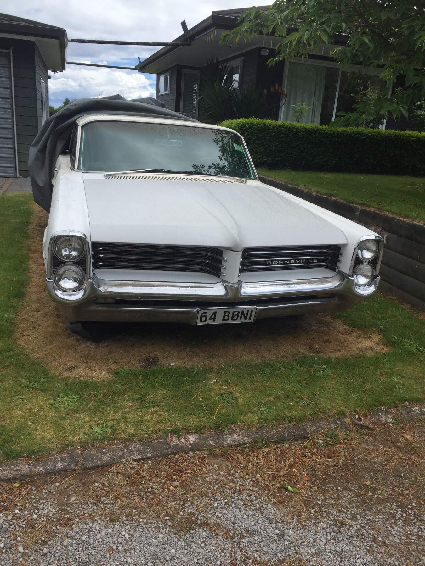

These pictures are about a month old, can’t get a sunny day to save my life anymore now let alone rain free!
Whole summers worth of Blood Swerat N Tears.   Amazing job, simply beautiful.
& a little help my Milwaukee buddies! 18V fuel & his pal M4!
NICE very NICE 👍

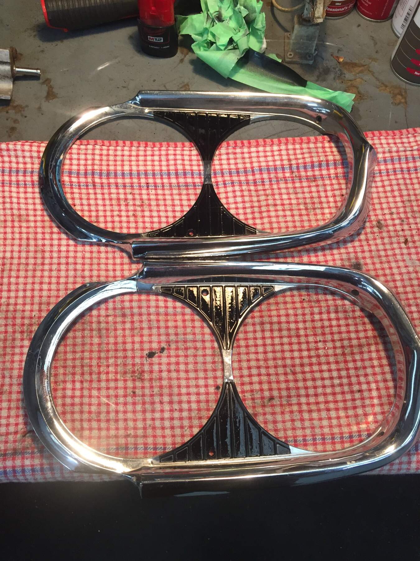

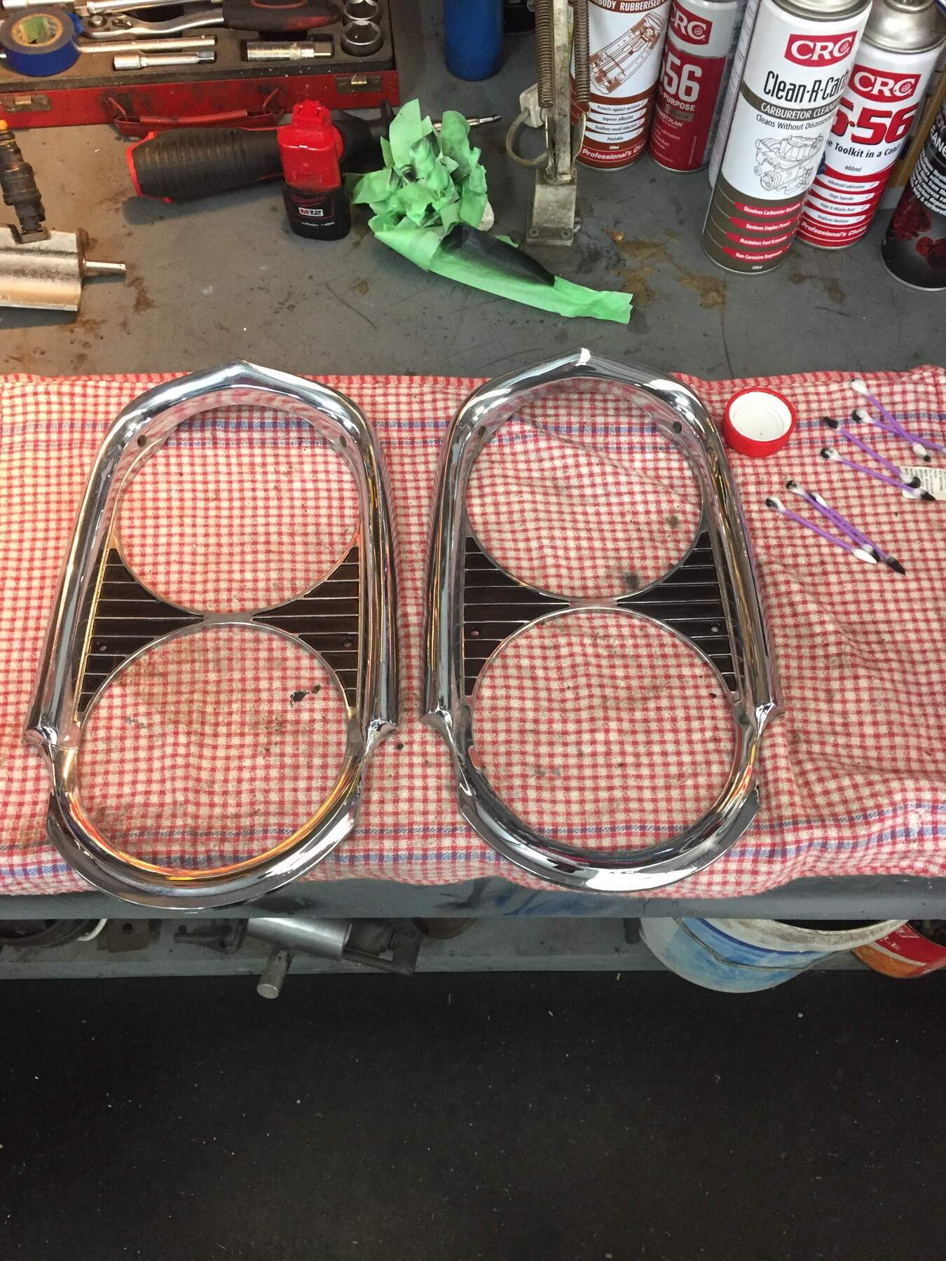

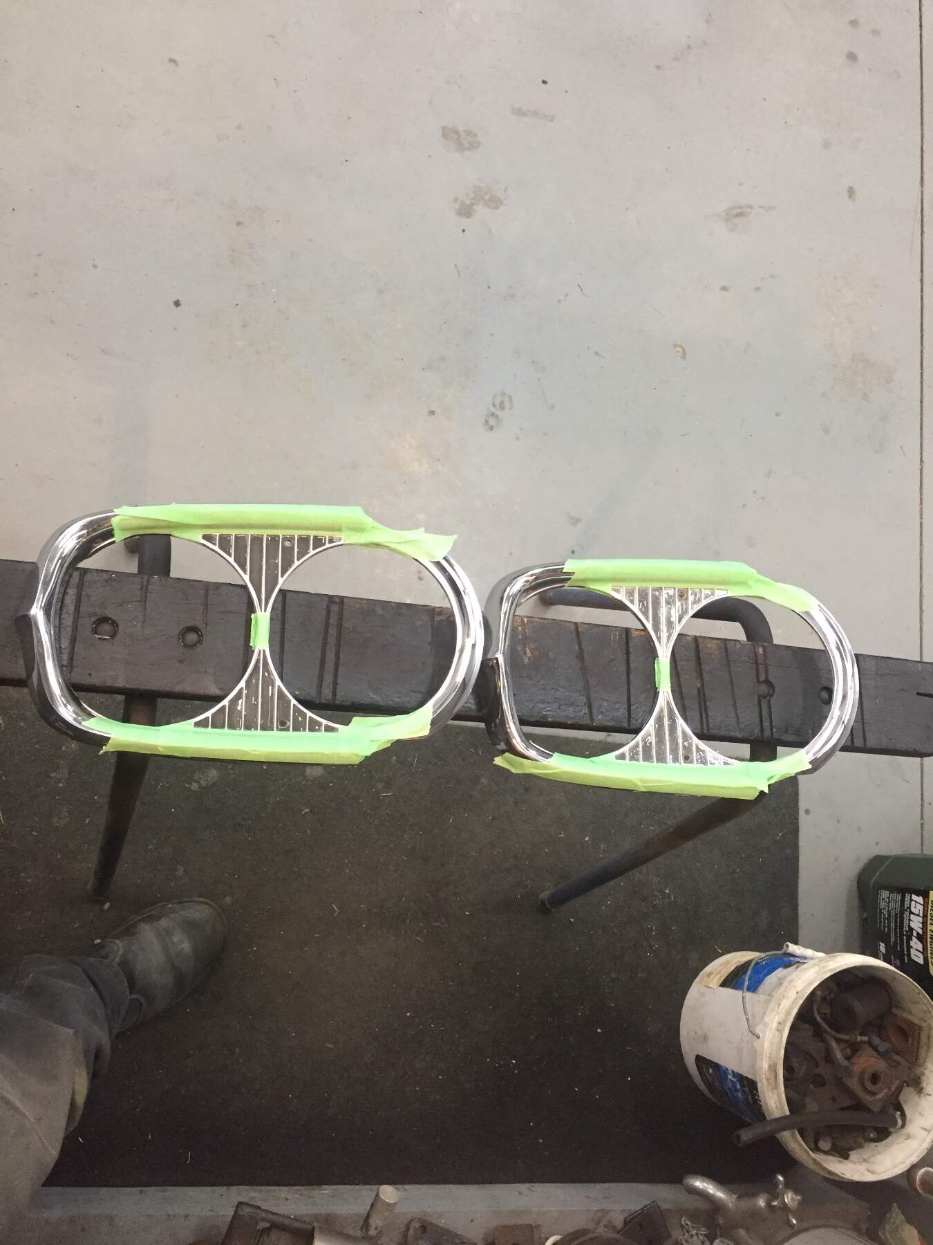

I managed to get a hour on the head light trims today
gave them a good polishing
then masked them off,
repainted the black in fills
 then using a cotton bud and some acetone I wiped the paint off the chrome high lights .... very happy with the way they came out
GREAT technique. Look better than mine for sure
A really easy detail to do Del !
took me less than a hour
and it’s justA tattle can satin black

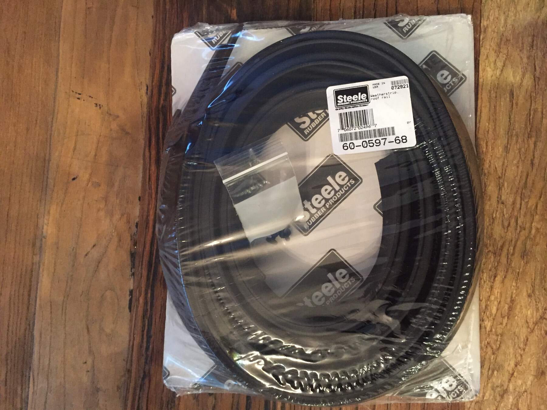

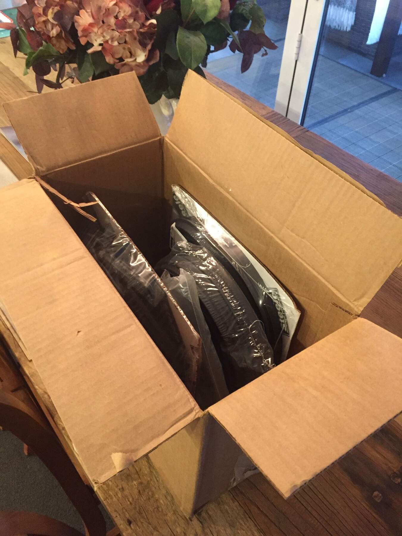

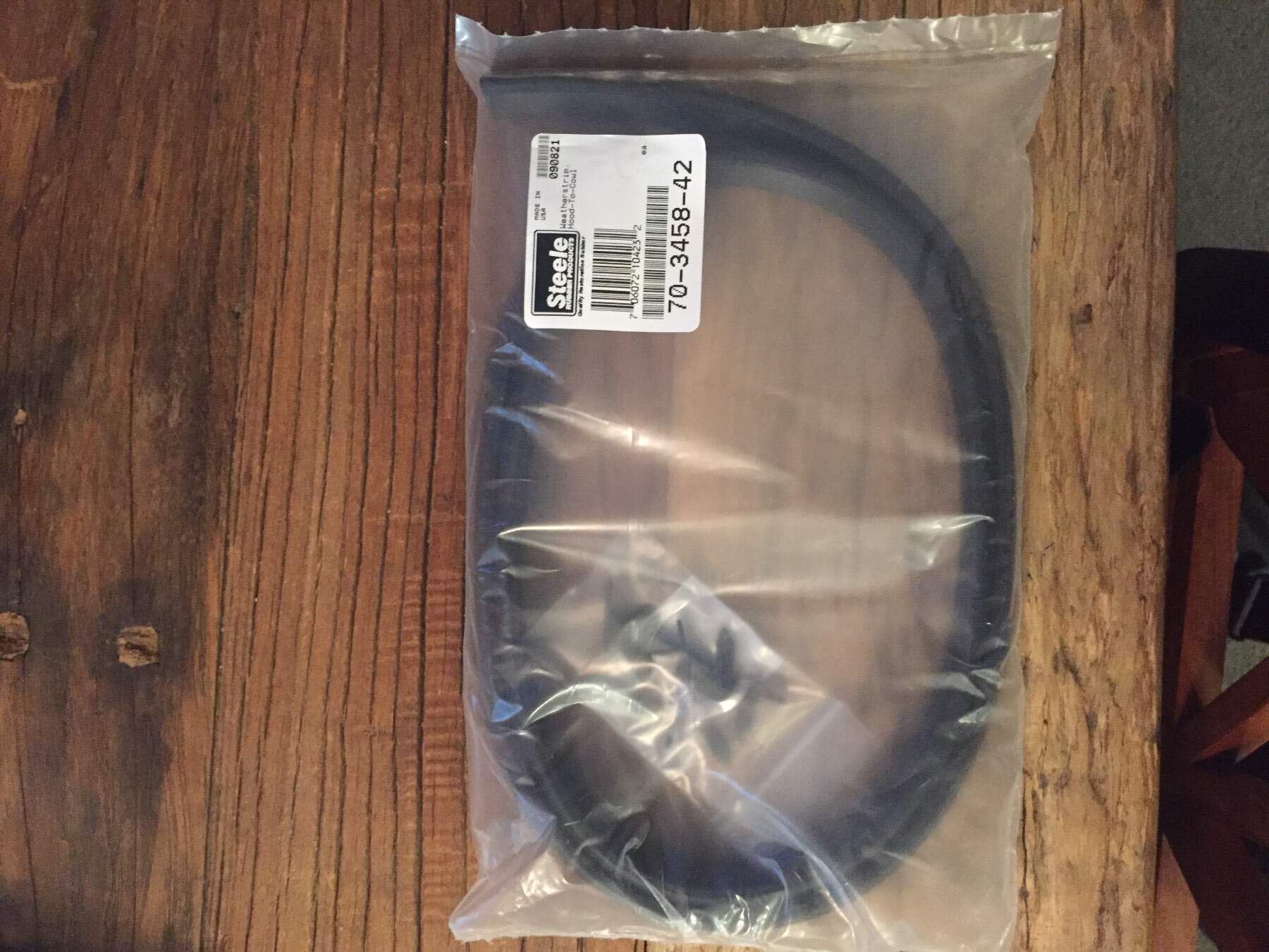

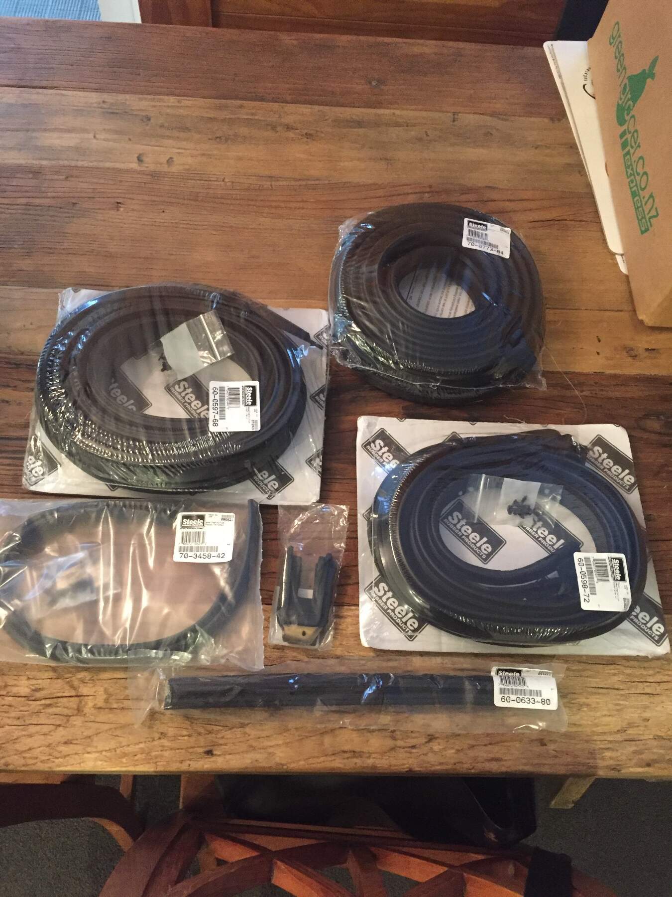

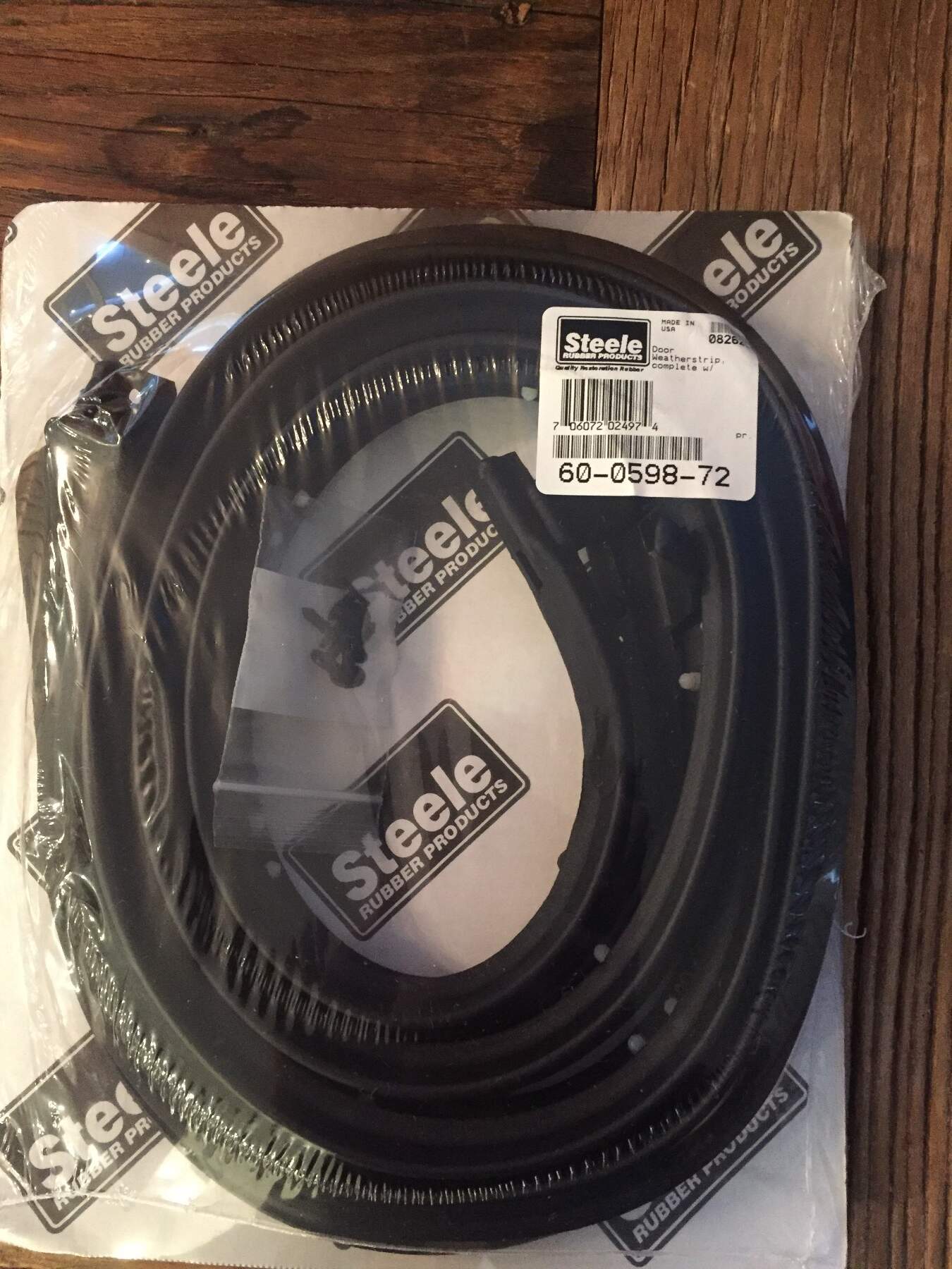

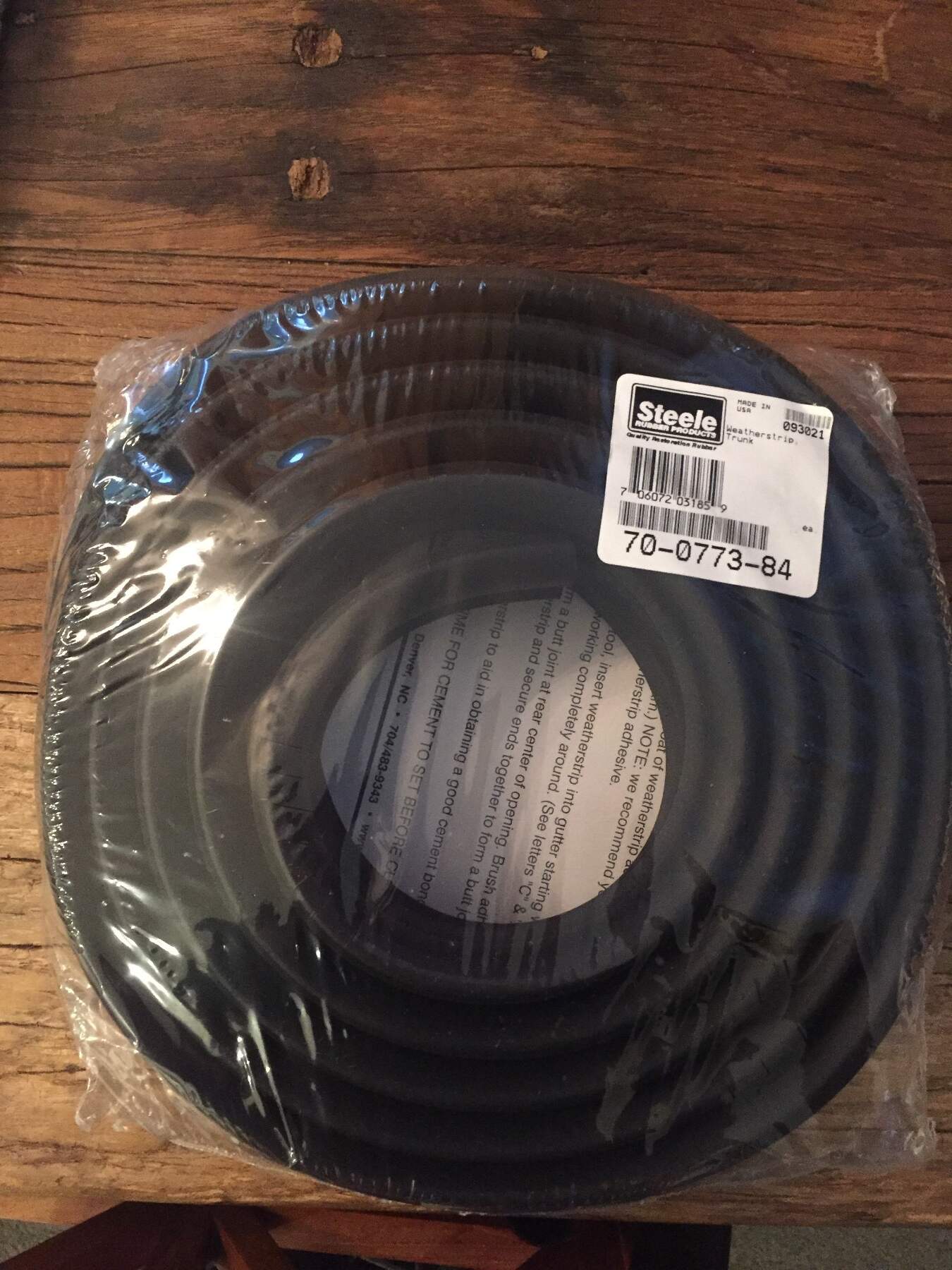

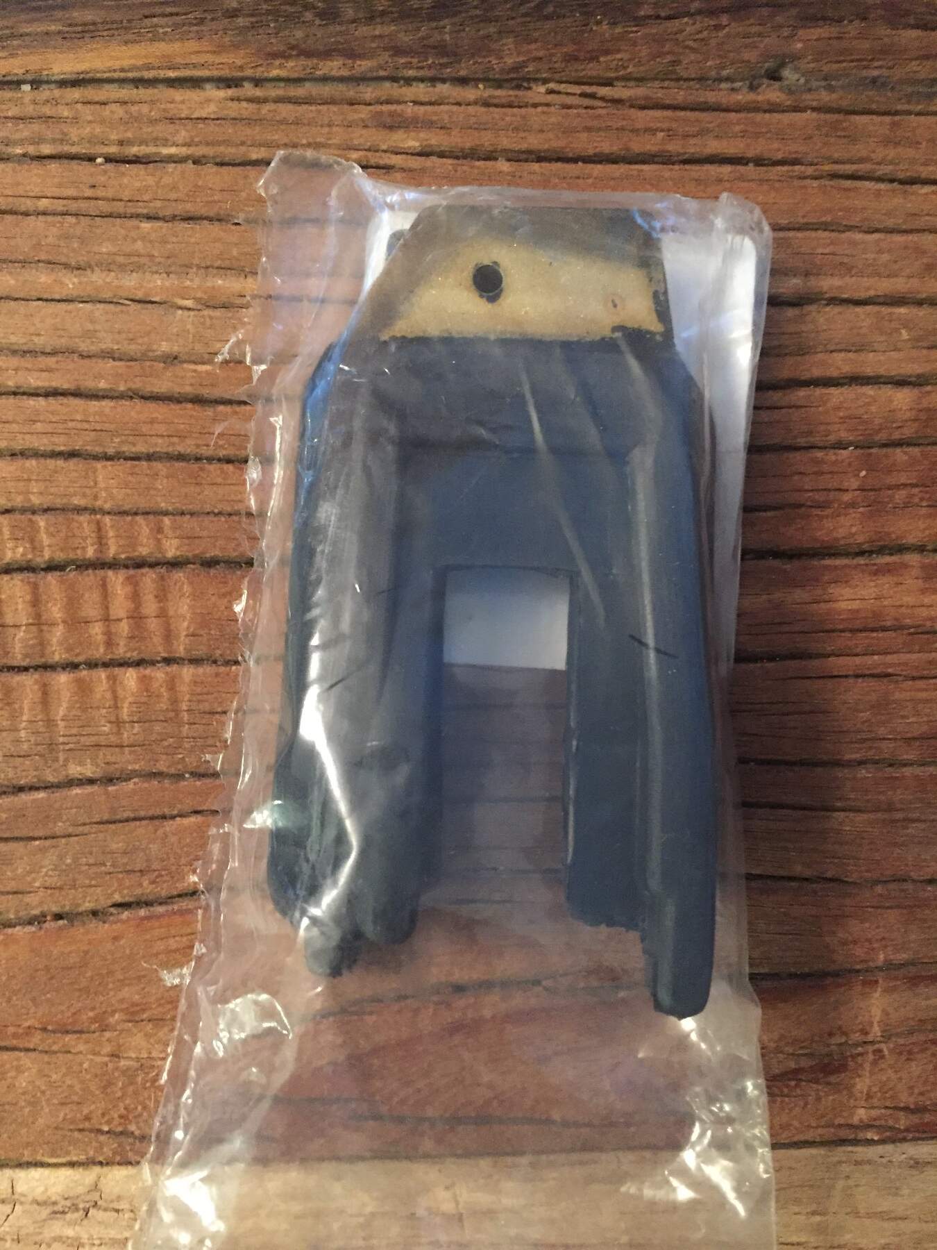

Super excited my Steele rubber order arrived today !!!
Down side is I made a deal with the boss , this purchase was my Xmas present ... so I can look at it but I can’t fit it !!! And won’t till Xmas .... none the less
check it out 👍👍
I have
door, hood and trunk seals
j seal to the b pillars
vertical seal between the front door and rear glass seals  quart glass to door glass seals and the most important one the roof line seal too the door glass :dancingpontiac:
Then it all goes back in the box for another 52 sleeps !!!
Christmas sucks !!! Haha :rofl:

I thought I had the wrong rubber installing mine because it’s so puffy the door didn’t want to close. I guess that’s normal until they flatten
what brand did you use Del ?
i have the same issue with the brand new door seals on my hq holden ute, and they have been on for over a year now !!! and the doors are still hard to close!!! ( they where rare spares brand, and supposed to be the best for holdens  😡!!!)
yet the soft seal brand ones i stuck on my last 57 chev, worked perfect... guess its just luck.🙄
Have heard from my buddy that works for a car collector that they are having problems with seals also and they have tried several brand's
yeah ... thats why i said luck !! you would think all seals are made to a set profile, and measurement... NOT :rofl:
It seems about right. After being on a while it is easy to close

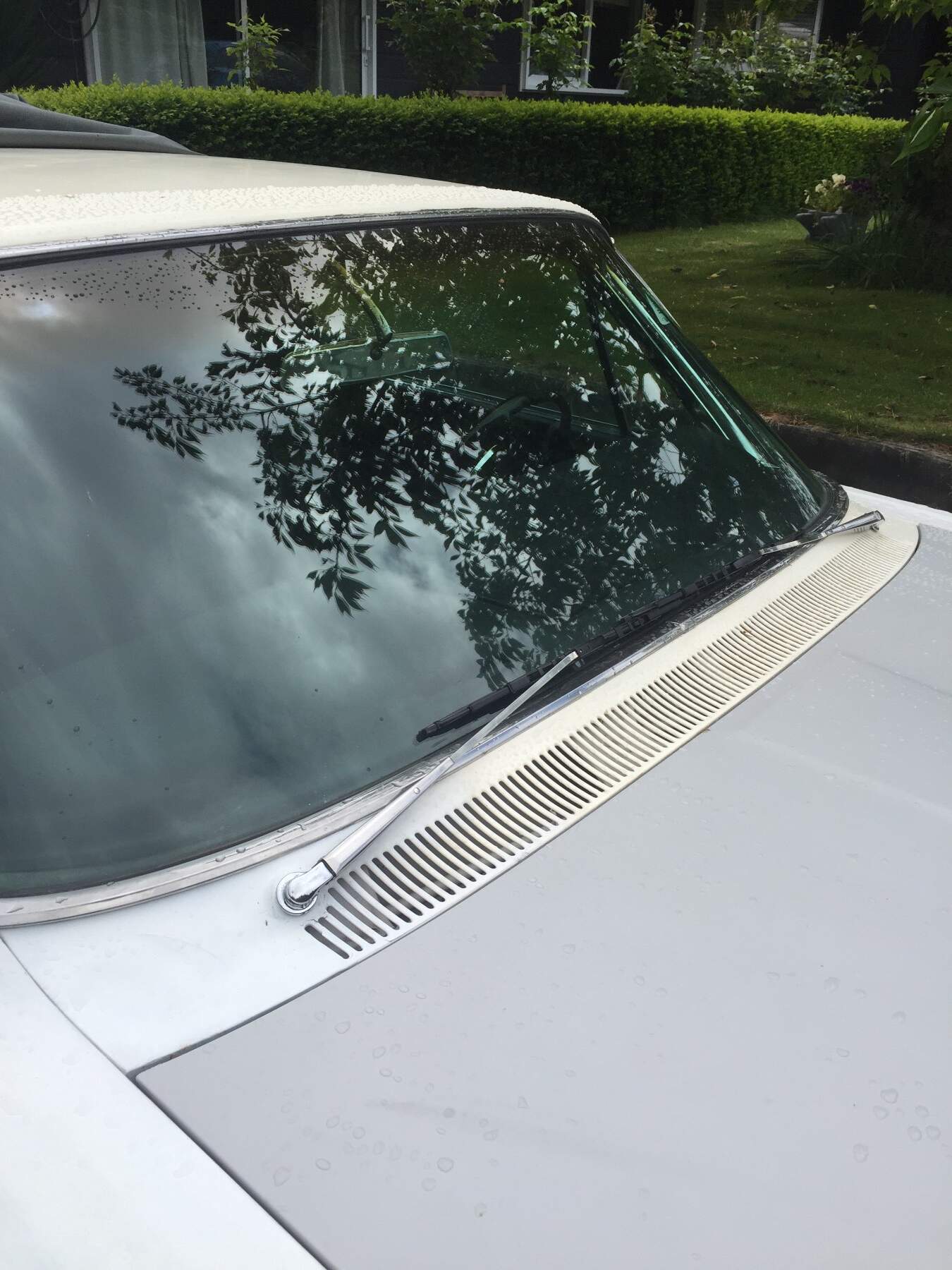

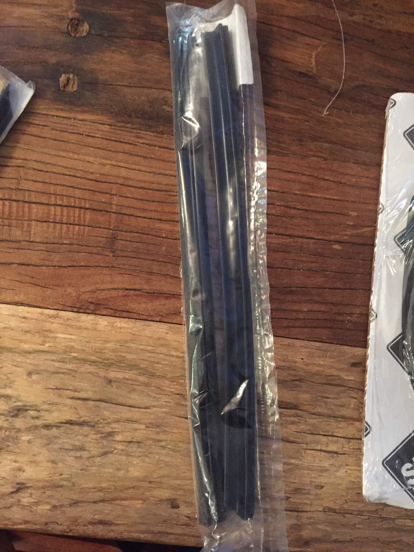

Polished up the wiper arms and fitted new blades , can’t get chrome ones any where so I had to settle with black !!
Been waitin to see those.:pop_corn:
one had a crack so i used your favorite weld !! jb 👍 on the back side to strengthen it, you would never see the crack.:)
its all these little details that make for the finish... and yes its ALL got to come off again for paint but i want to ensure it all fits nicely... and the head light trims was the only part i was missing !!!

looking good,the way you are doing it is a good idea, more work but nicer end result, how about finding some used stainless wiper blades and just get some rubber refills?
