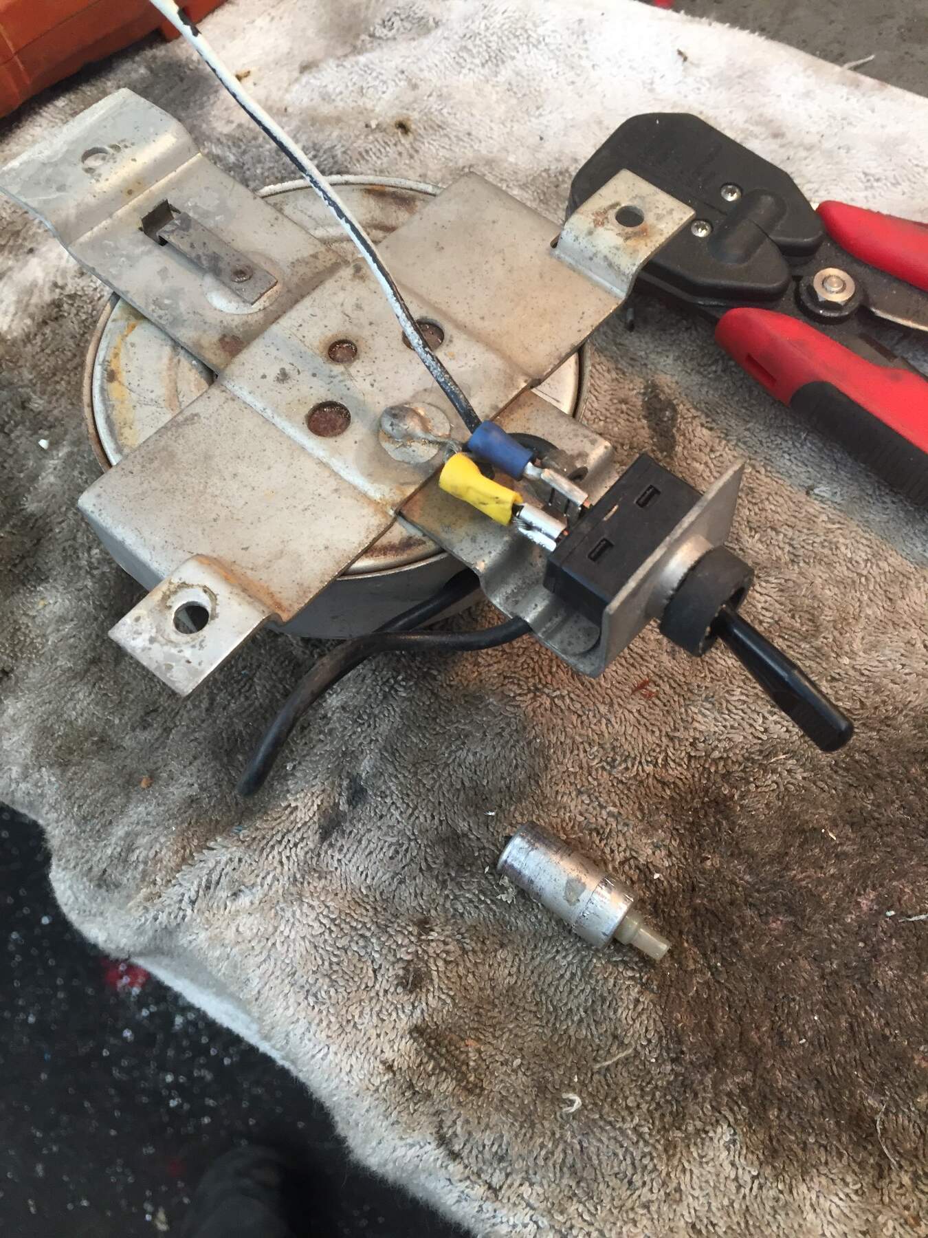

I had to use a bit of hose as a nut to hold the second hand switch in place !!!
i am still in lock down till Wednesday ... so I am using anything I have around ....

No real clue as to what switches it justA this small cylindrical thing that used to have wires going in to it at some stage of its life
so for now it’s getting a switch
Bet it's a pendelum like a clock.  When the hot touches the side, it lights the light.  That's how seat belts lock in too.

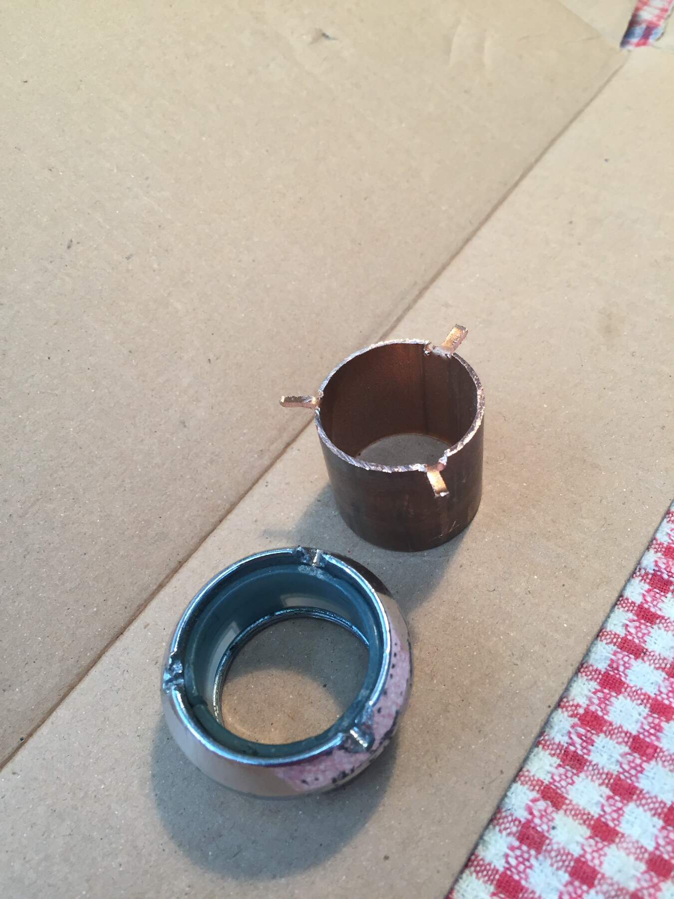

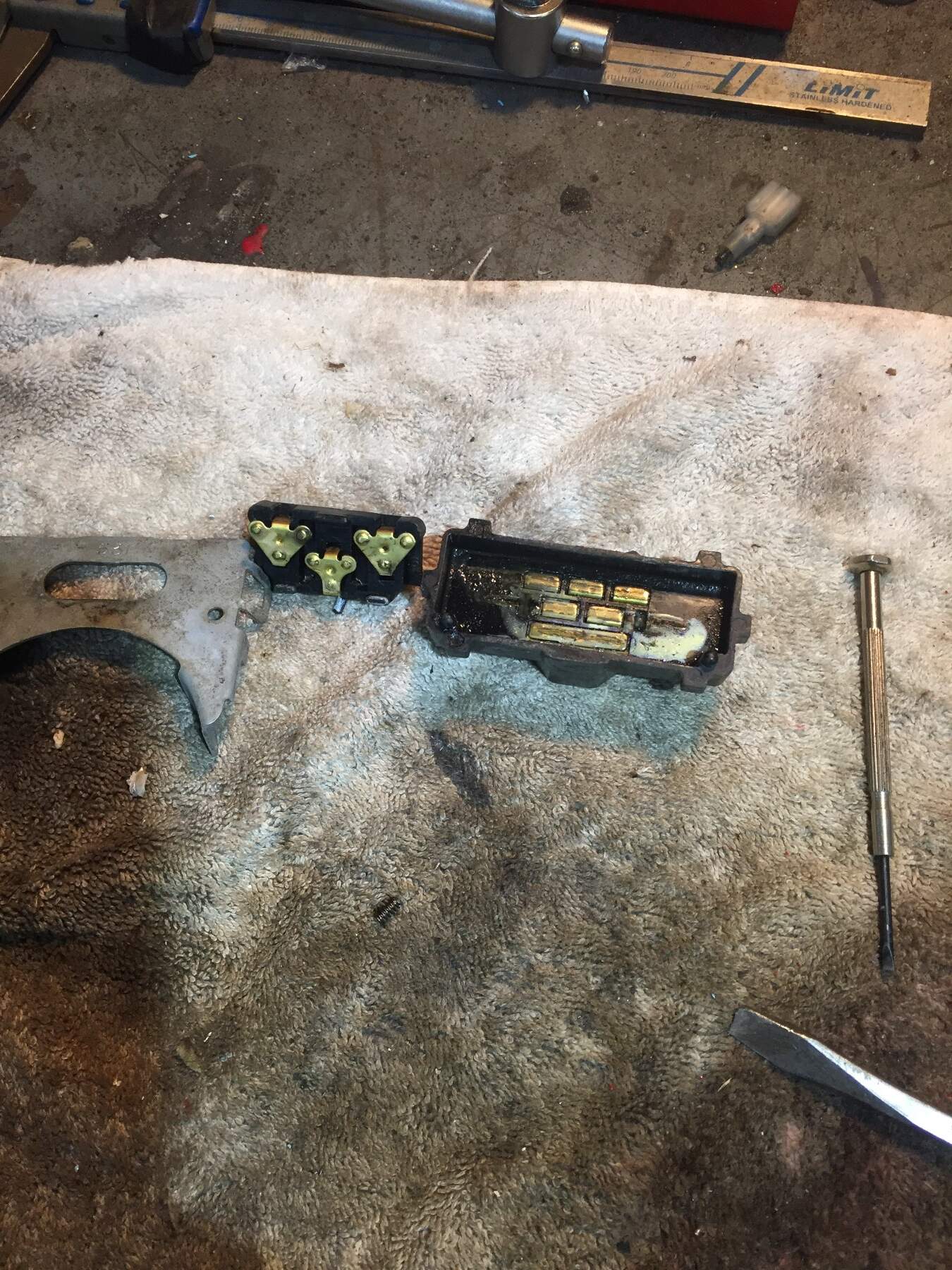

to finish the day I made a start on the indicators

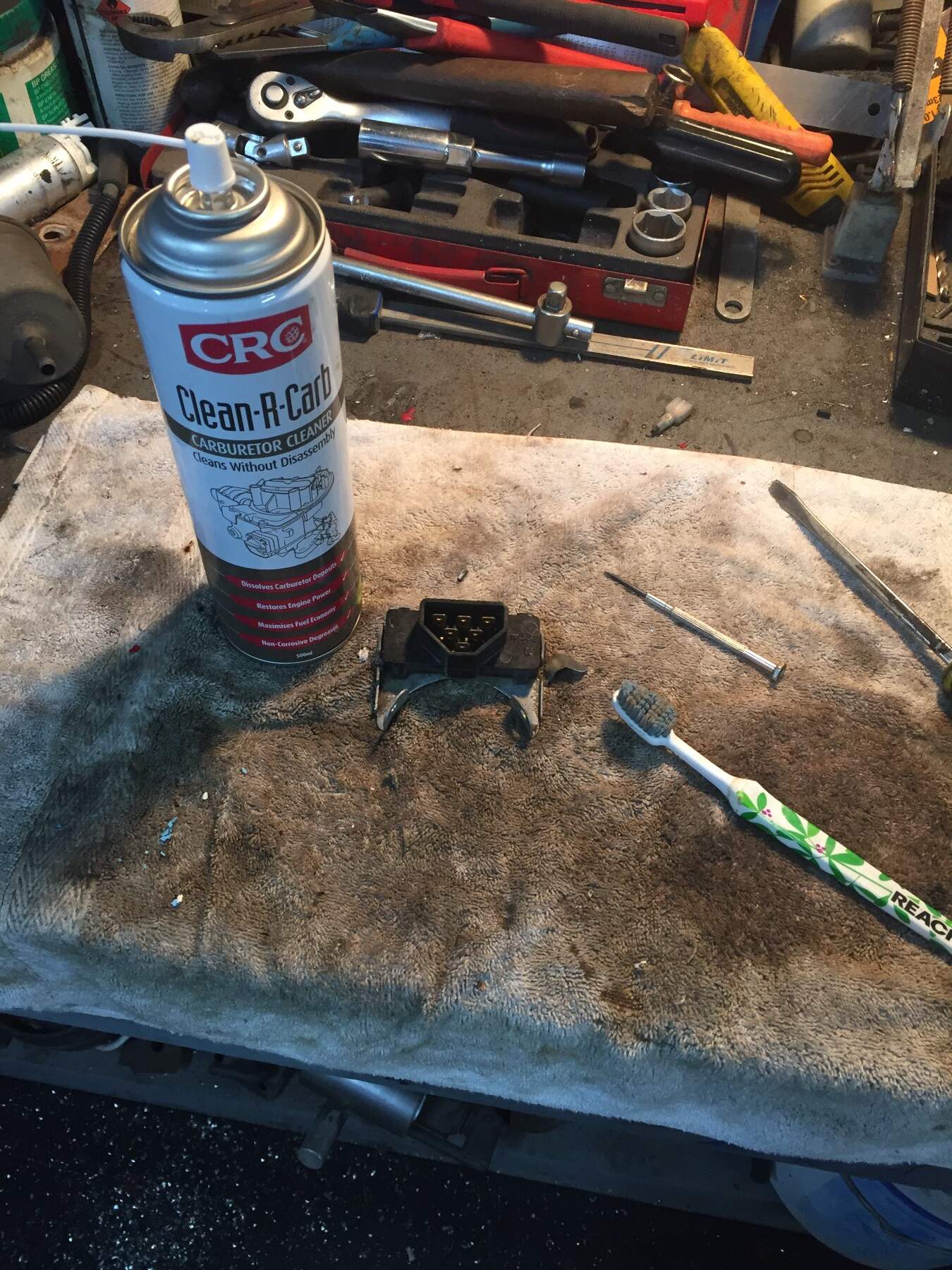

3 are working and I pulled the switch off the steering and pulled it apart , cleaned the contacts with a tooth brush and some carb cleaner and back together !!!
gotta love 1960’s cars with parts you CAN  fix

thanks Del.. yeah i though it mustA had a gravity switch at some stage of its life and like other wiring i have foud they have justA changed it... the crack up is that it would have been going 24/7. so they must of had lots of flat batteries!!! hahaha..

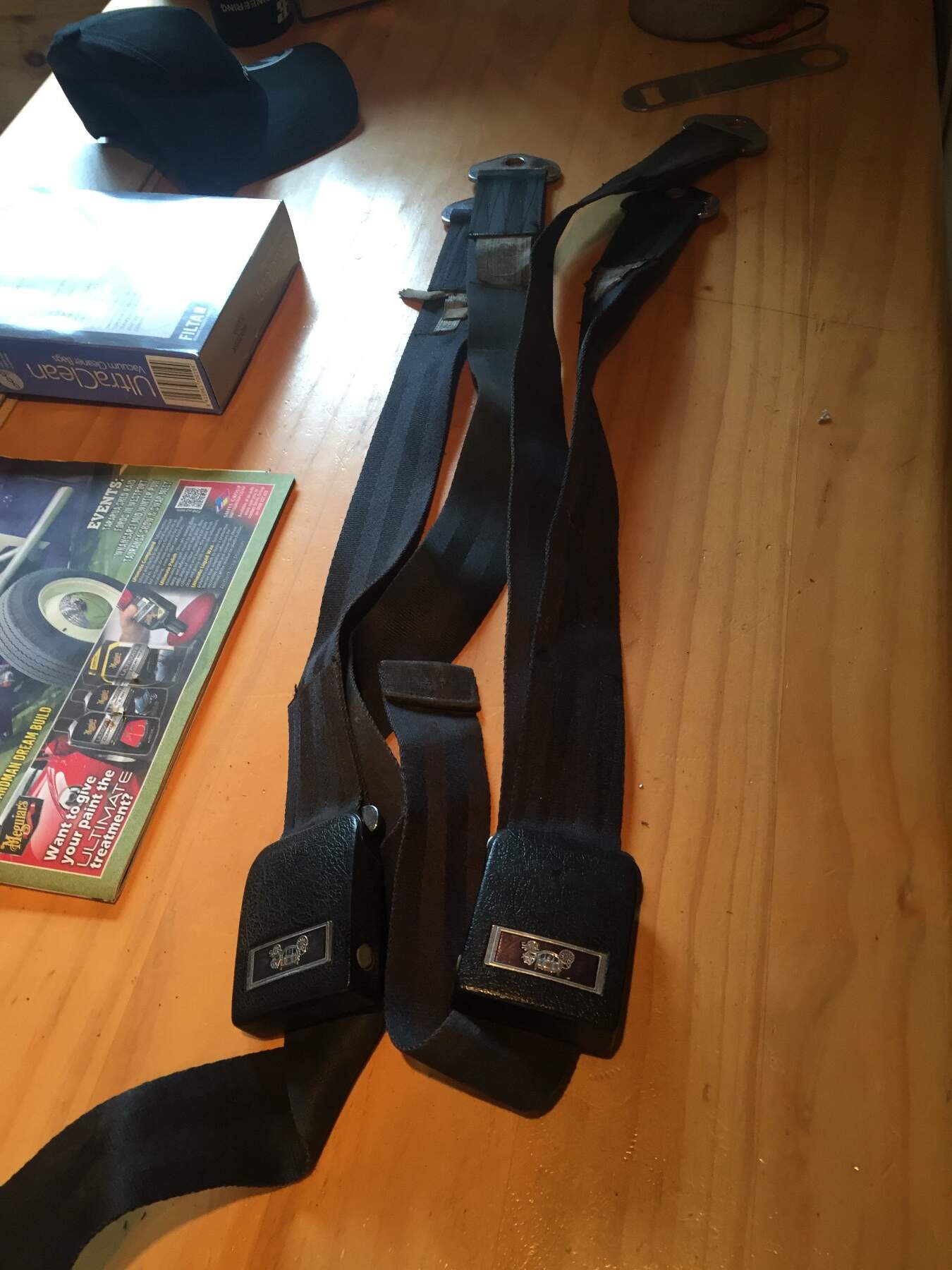

i pulled out the factory seat belts today, that will need to be replaced to comply for nz rules, but i have found out that i can have them bewebbed and thats legal. i would like to keep the fisher body latches so a re web job would be so cool

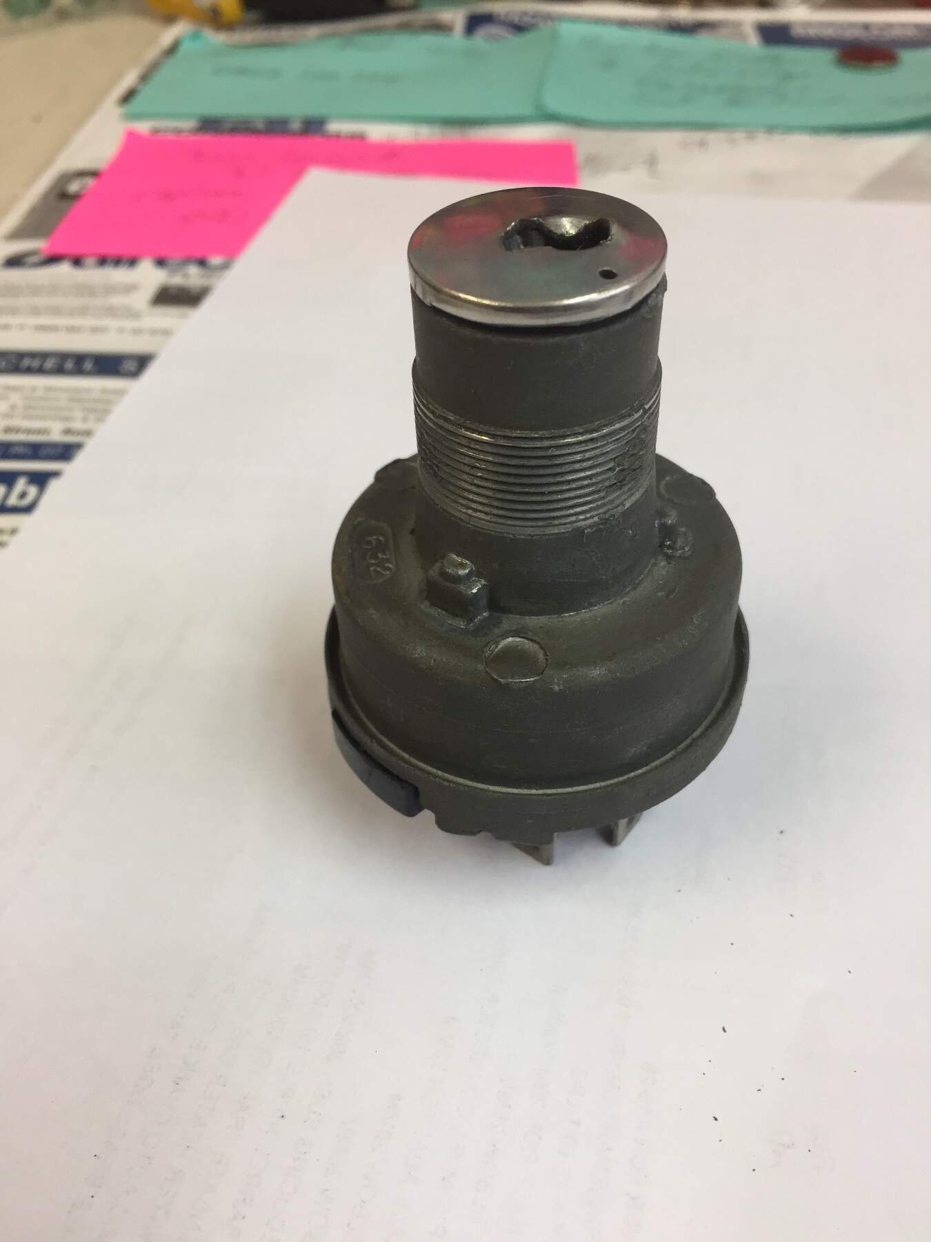

I pulled the ignition switch as it’s got a flat spot when you go to start and I thought about pulling  it apart like I did with the indicator switch and stopped !
if I can’t get it back together I am in trouble !!
So I emailed Ames to see if they sell them ...
and I made a key to screw the bezel back on , and re fitted it till I hear back

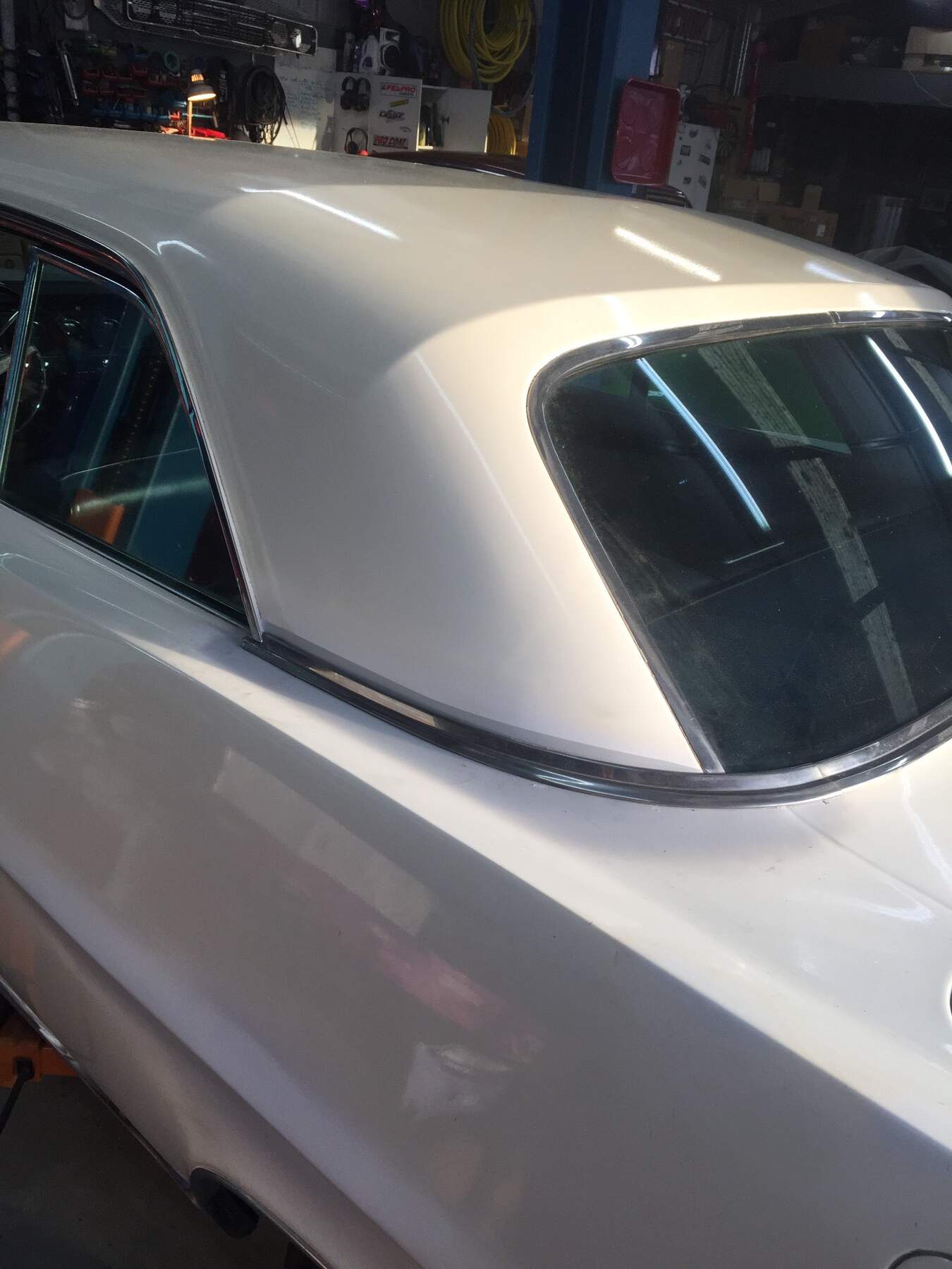

Months ago I pulled the belt line trim on the driver side c pillar  to fix a small spot of rust and found the 3 clips that hold the trim on where shot ... note to any one doing this replacement
they are the same clips as a 64 impala 👍👍👍
so I have fitted new clips and another box ticked off .. I did fix another small dent at the same time and got the touch  up gun out and layed down some 2 pack primer

yeah JustA Ames got back to me, they dont have any... and i have looked on ebay, cant find a single 8 pin unit, and even looking at other brands like chev, they are different housing shapes.
i did find this company, but they are not replying to my emails
http://www.2040-parts.com/pontiac-nos-nors-1963-1964-ignition-switch-catalina-bonneville-grand-prix-star-c-i1517464/

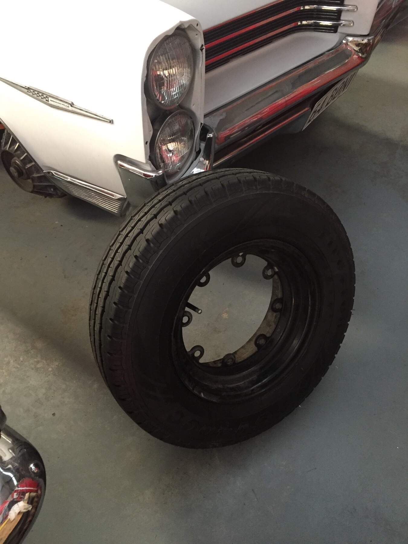

How does a tyre shop balance an 8 lug wheel? There must be an adapter that you will have to provide when the occasion arises.
Wow,  good question.  Did you think of that at 3am again???😎
Deeps thoughts from sleep depravation or insomnia?
Bring the whole drum?😁
yes you dead right mate, my 64 had its adapter in the trunk, i have left it with the tire shop, as they are sticking another tire on the spare rim, i will post a picture of it when i get it back later today
