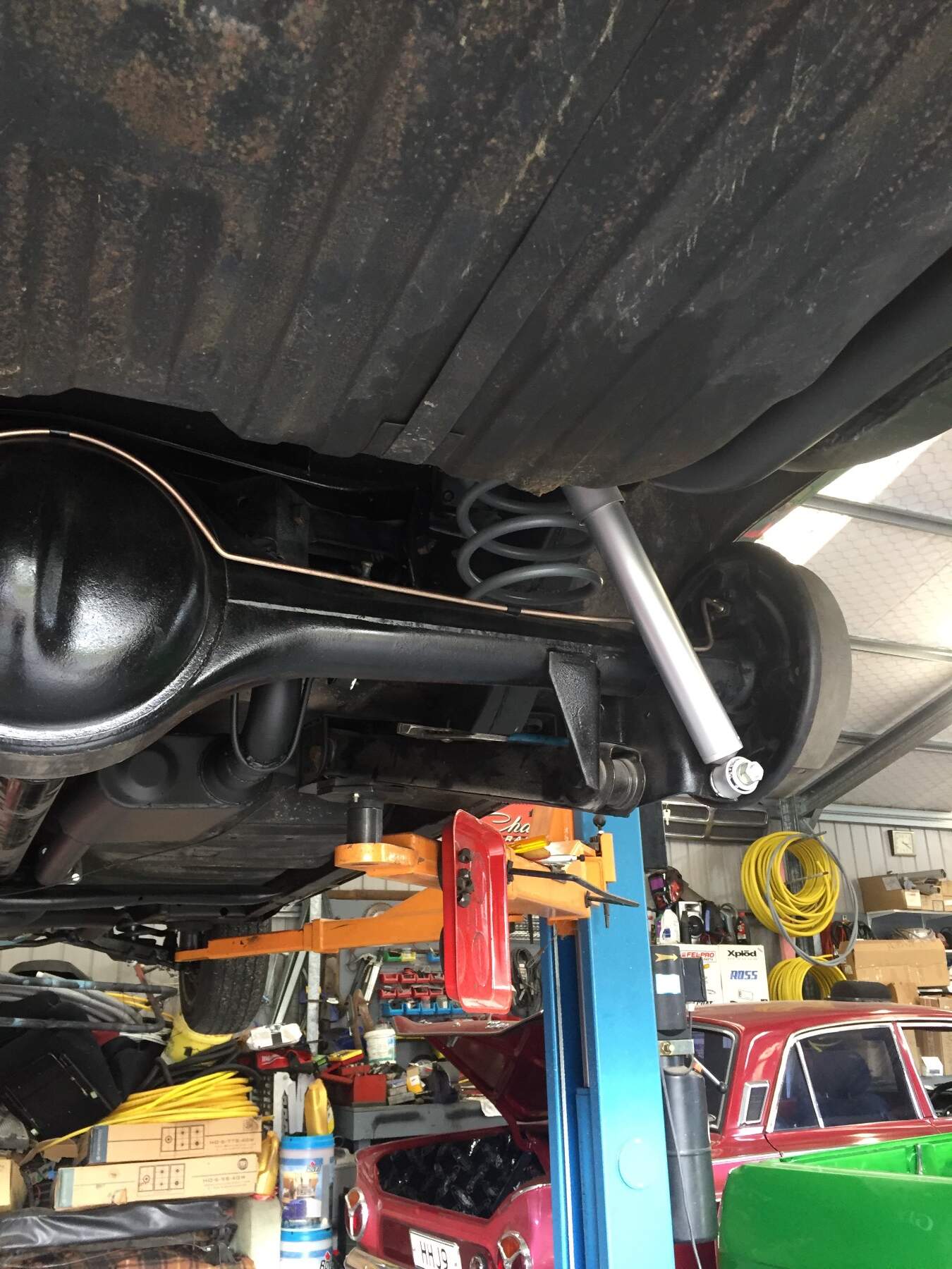

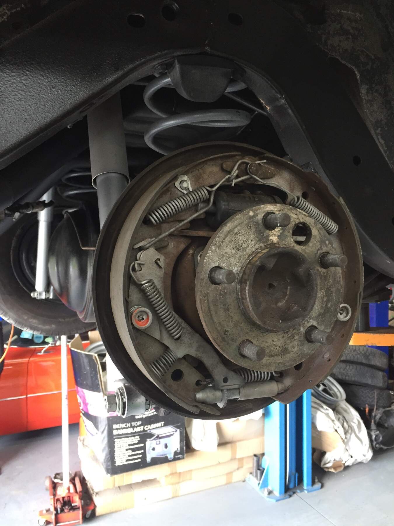

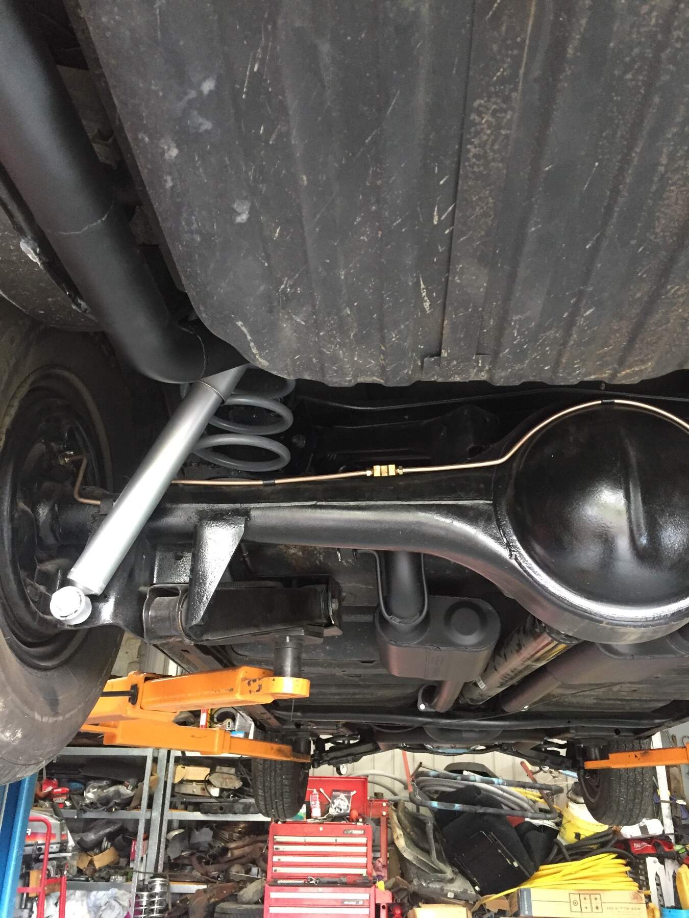

Today I have made the new lines over the diff, fitted the rear slave cylinders
clean all the parts
I have no new brake shoes, so justA for now the old ones go back in

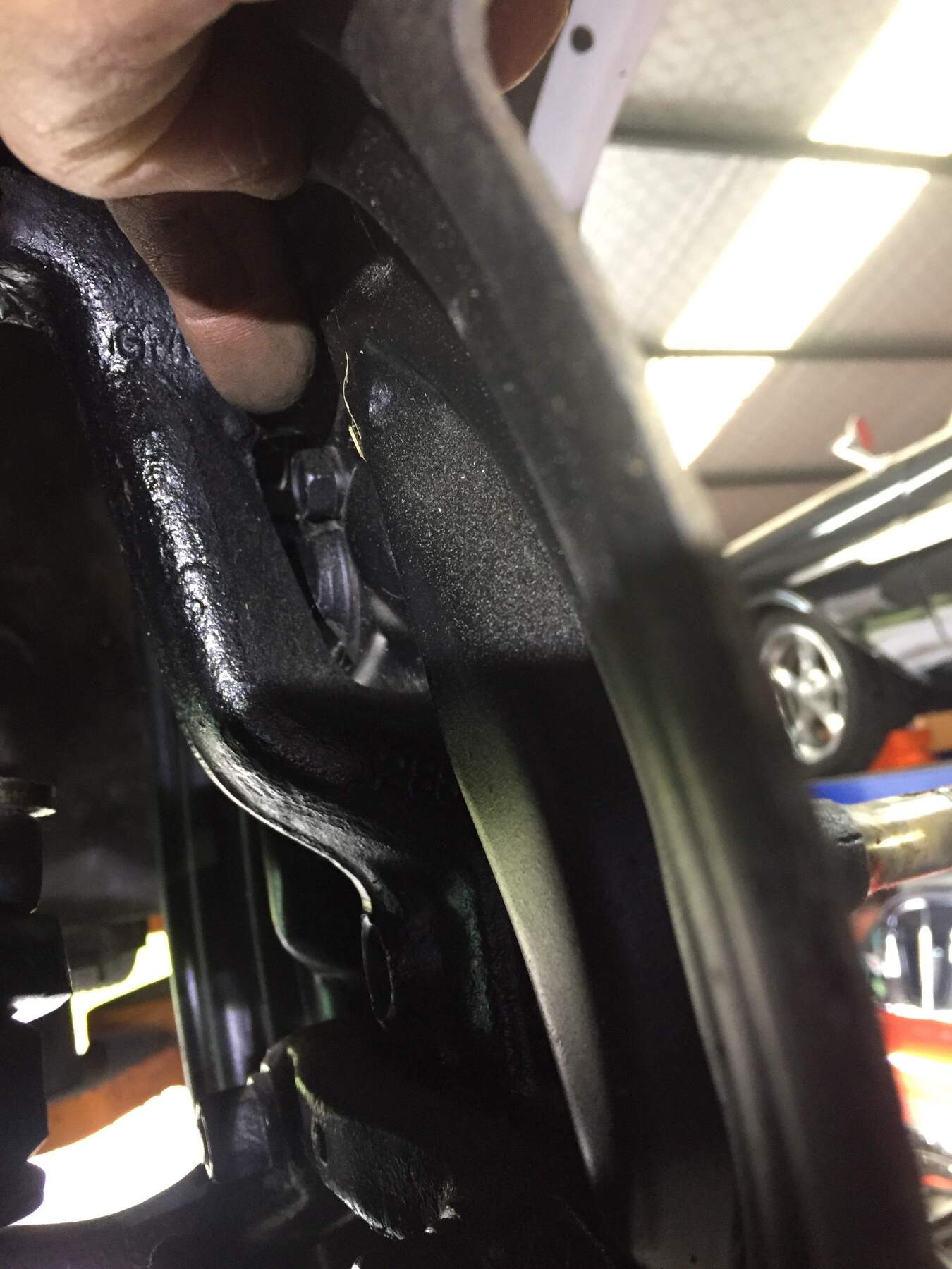

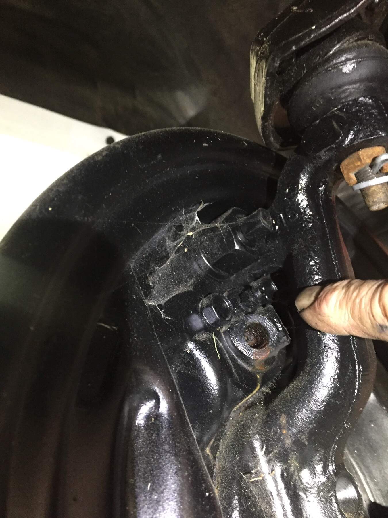

For anyone reading this and doing a slave cylinder swap . You need to remove the front backing plates to get at the 2 bolts holding the cylinder to the backing plate !!

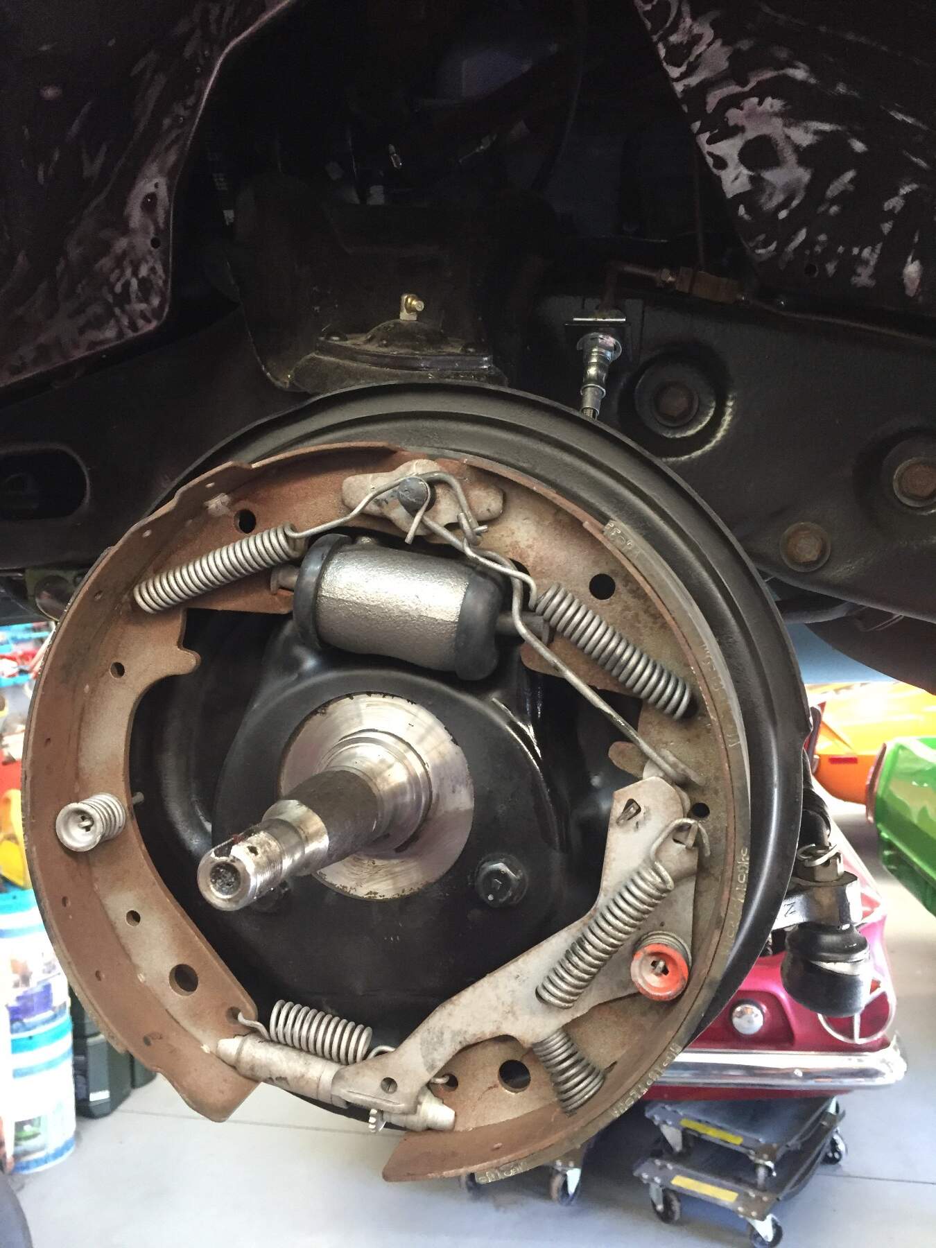

And this is where

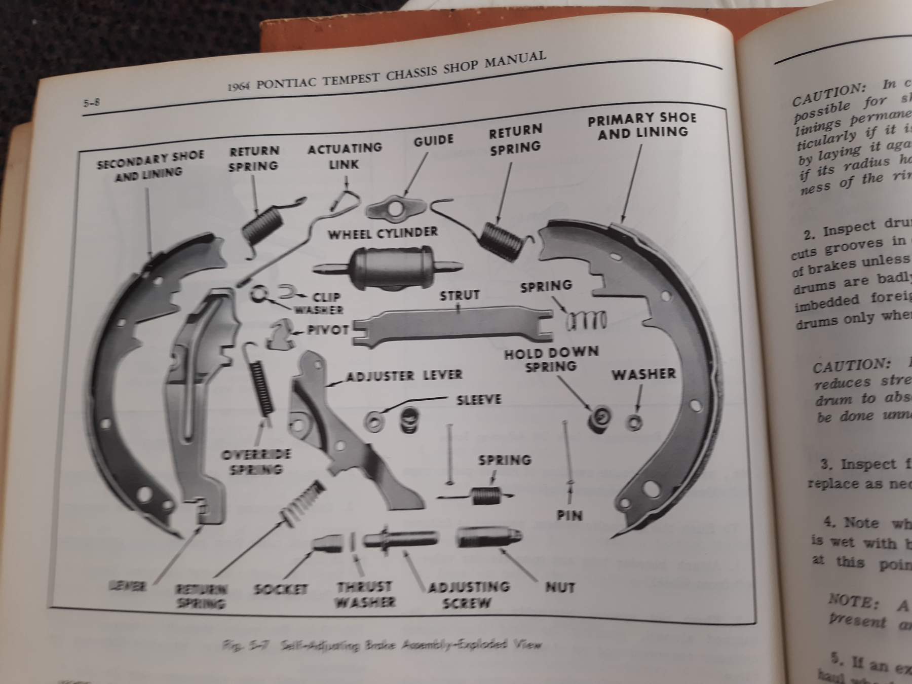

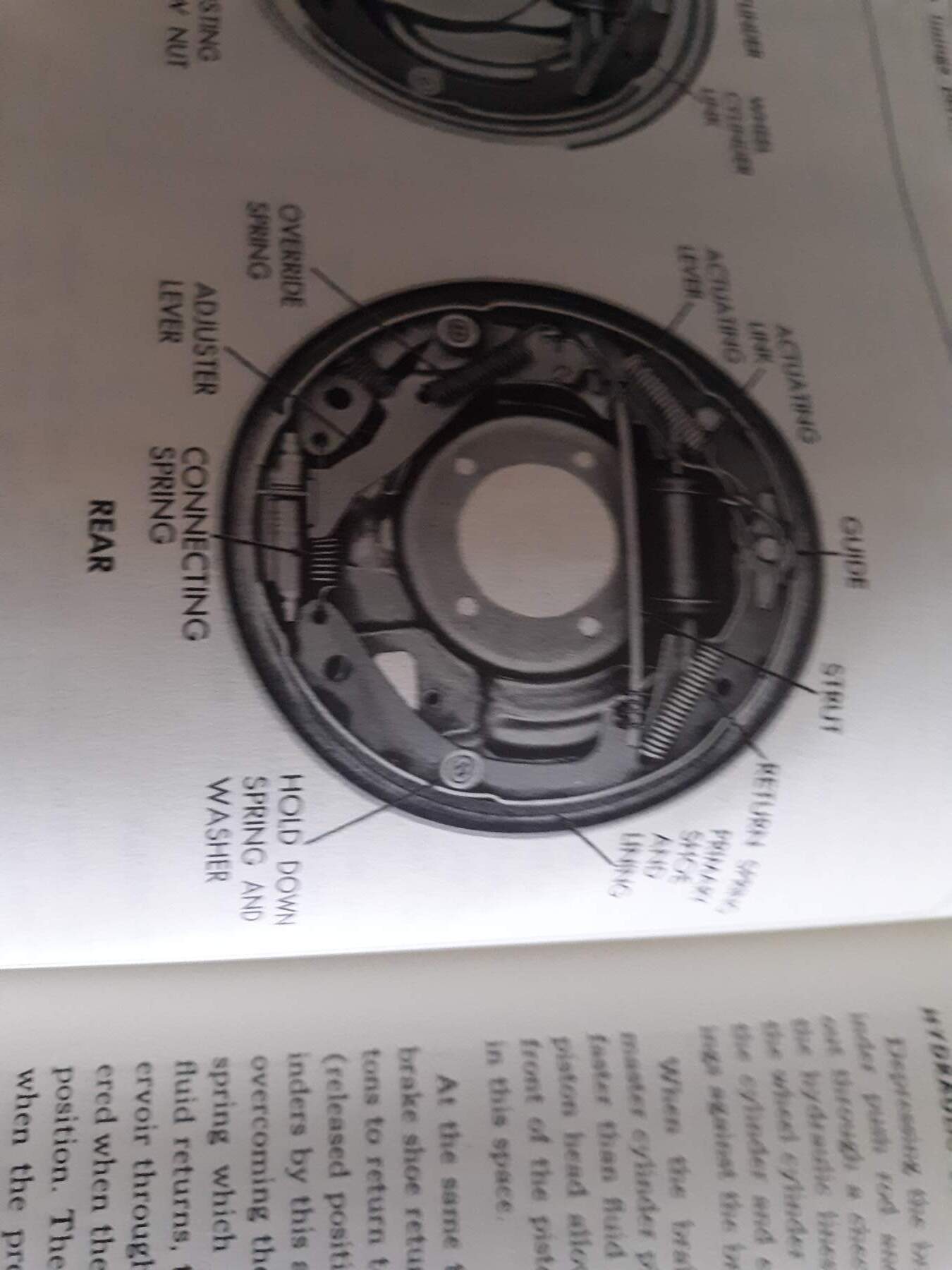

I need some help !
the front brake shoes are different
one has more pad material on it to the other ... the book says front is primary and back is secondary
yet the pictures contradict this
and my front ones I have one side with small front pad surface and on the other side large front surface !!
does anyone know which way they are supposed to be !!!👍

The brake shoe with the longer pad surface area is the primary shoe and is installed toward the front of the vehicle...The primary brake shoe lining should be a lighter color than the secondary brake shoe lining....

You may want to do some more research on this, I believe we used to install the shoe with the shorter lining in the front on most cars but i think there is some exceptions
Have been looking through some of my old Pontiac service manuals again...and have ran into conflicting illustrations...and text..the one I'm 95% sure is correct is from the 1963 chassis manual...The 1964 chassis shop manual is a supplement for the 1963 manual...which shows the shorter shoes toward the front of the car opposite of the adjusting stars which are always to the rear of the car...Also the right front and the right rear adjusting screws are left handed threads and they are identified by having 4 grooves in the adjusting screw nut whereas the drivers side nut is standard RH thread...The backing plates themselves are also right and left handed...
Sorry for any confusion or inconvenience I may have caused...As I strive to post only accurate information..The photos show the right hand side
TLBT...
Thank you two lane
yesterday when I pulled the front drums off I took a double take when I saw one side was different to the other
and raced  to my copy of the 63 chassis manual you recommended to me last year and it says small shoes to the front yet the picture shows the opposite !
JustA for now I will fit the small ones to the front
they are coming off again to be relinned when we get out of lock down , all I want. To get done is complete the hydraulic system and bleed the brakes 👍👍

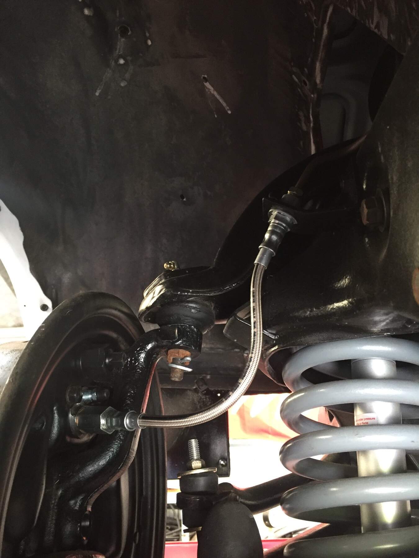

Yet another productive day finished up the front brakes and fitted the new Teflon front brake hoses, bleed the brakes and fires her up for the first time with the new x pipe exhaust system and I am super happy with how the 389 sounds 👍👍👍👍

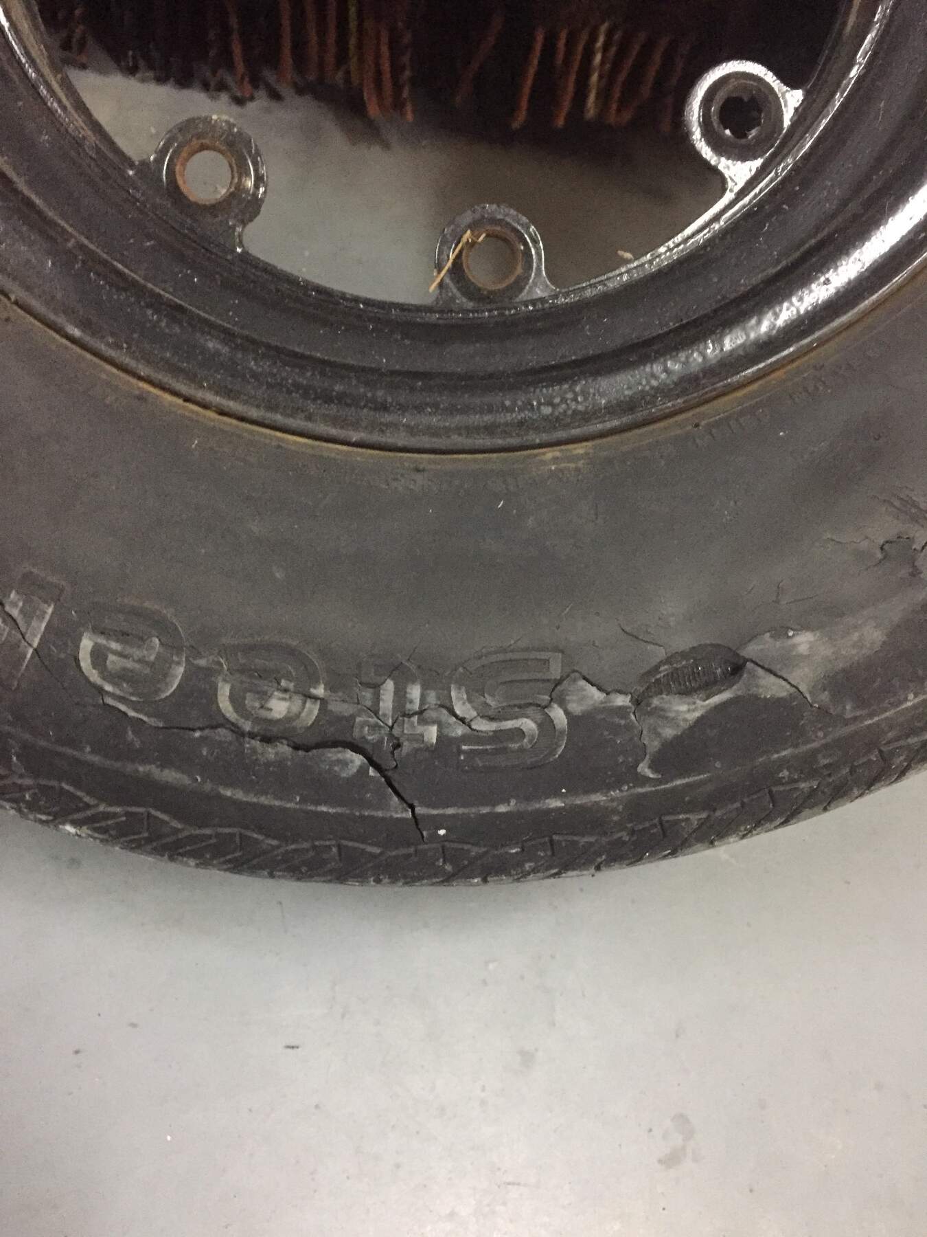

It was getting late in the day but I justA had to take her for a drive to test out the brakes ... I got 20 meters down the drive and could hear this big hissing sound !! The one dodgy tire I had in the front let go !!
So I crawled back to the garage and pulled the sucker off ...
note to self ... don’t trust old tires that have visable cracks in the side wall !! Hahaha :rofl:
and its sunday beer o clock, time to go bbq some scotch fillet and spend some time with the boss..:cheers:
So much accomplished, you gotta be happy.  Congrats.  I wouldn't have trusted that tire down the driveway.:nuts:

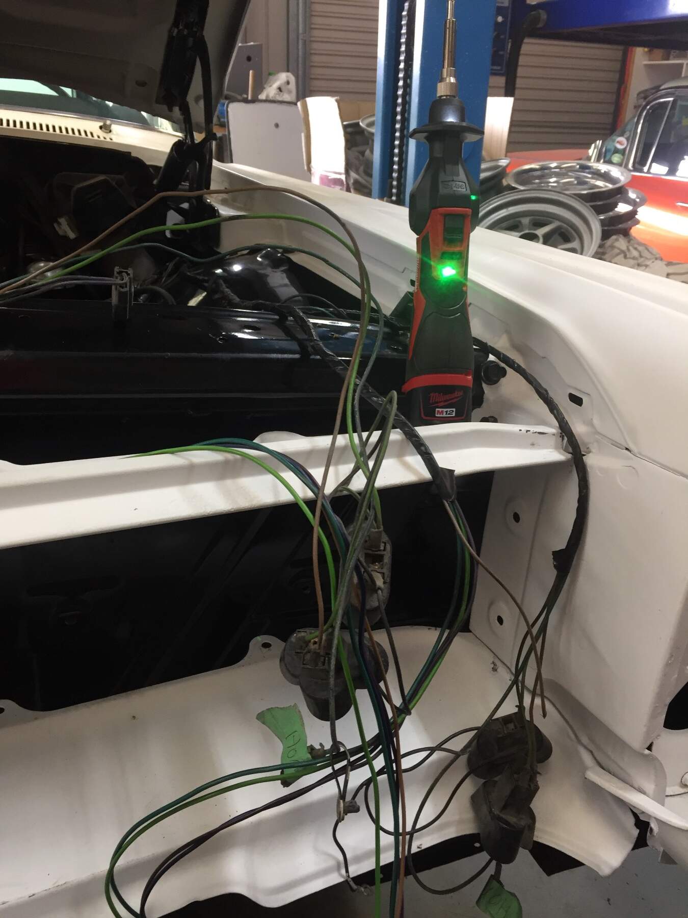

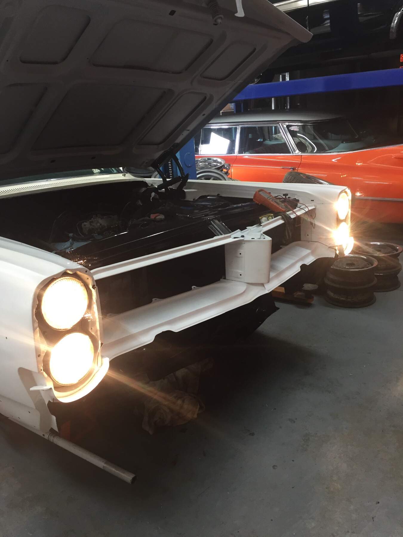

so I got stuck in and got all the front sheet metal adjusted to where I wanted it including the Pontiac nose piece
then thanks to my mate wrongway 👍👍👍 i rewired the damaged front head light loom and installed it in the factory location :cheers: cheers mate.
and it even works 🙄
also got to use my new m12 soldering iron .... big thank you to last Indian for the recommendation , mate it works fantastic 👍👍👍😀
next is a big job!! detailing the grills and installation !!

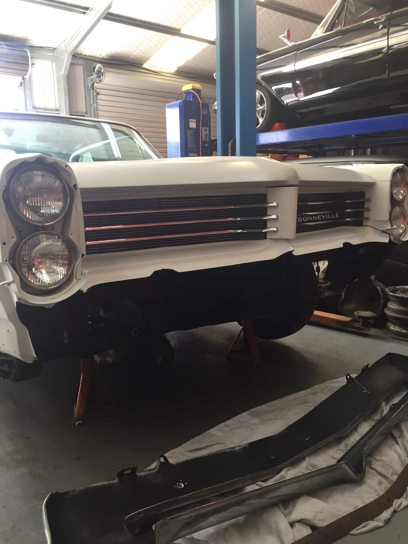

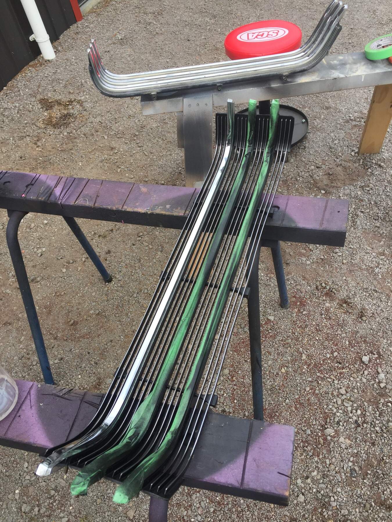

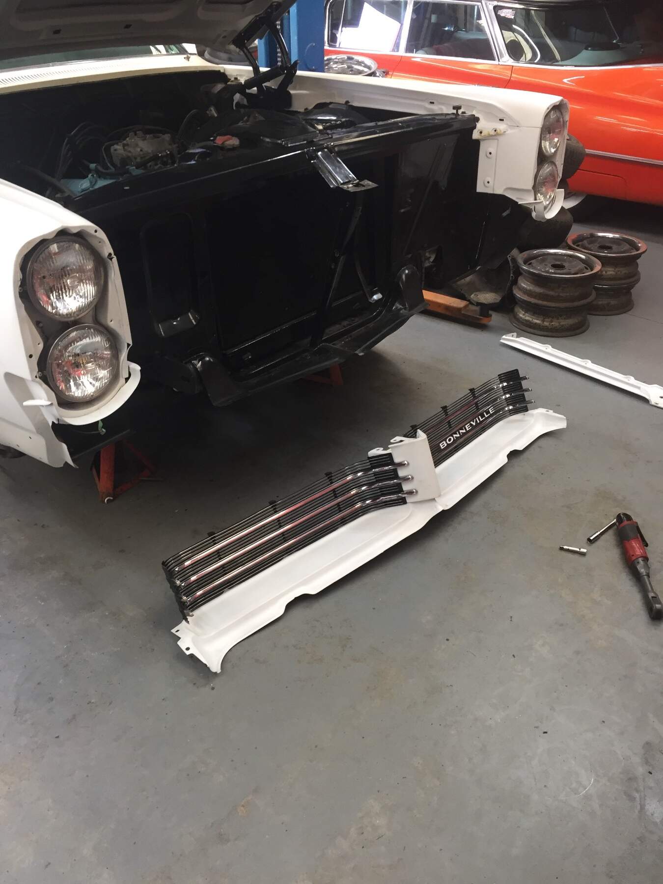

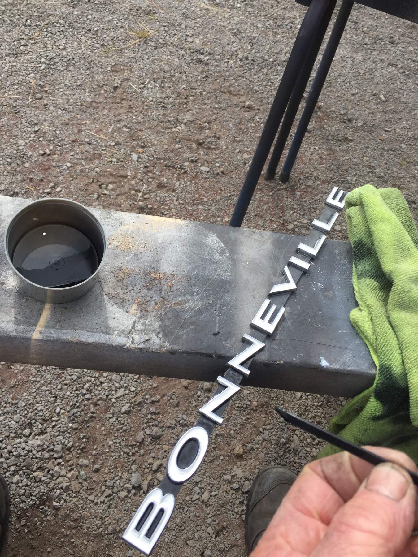

i had a very productive day, washed, cleaned, polished and painted the grills, hand painted the "Bonneville" badge in the grill,
for some reason i cant upload pics... most likely as everyone in new zealand is on the internet and the number 8 wire that feeds all our www, too the rest of the world is at max capacity !!!  :rofl:.
i will try and post some pics later tonight when most kiwis are asleep !!.... 10 pm ! :rofl:
Crappy Internet? I swear to you this is absolutely true: one of the girls at work lives with her husband about 100km south of Darwin out in the sticks. There's a Telstra tower out there, but it was built 'in a ditch' and the reception is hopeless. She showed me a video of her neighbour tying his phone to fishing line, then with a pulley system, they hoist it up into the tallest tree they can find so as to get a decent signal. Why would you live in any other country? I've been to so called 'developing nations' where the Internet is delivered at what appears to be the speed of light.
because the letters are so fine I ended up using a cable tie as a paint brush ...
it worked great !

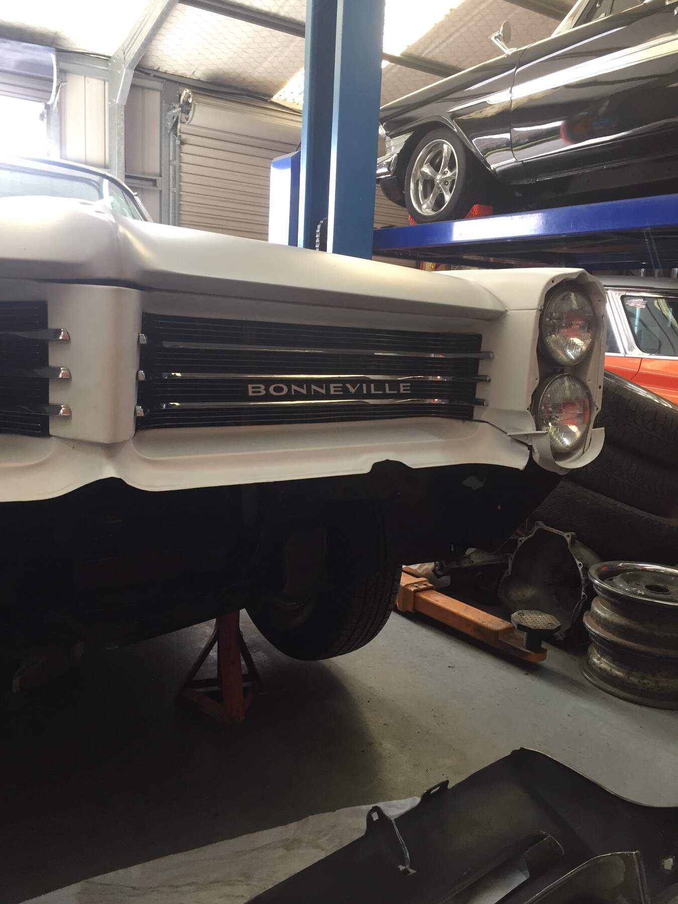

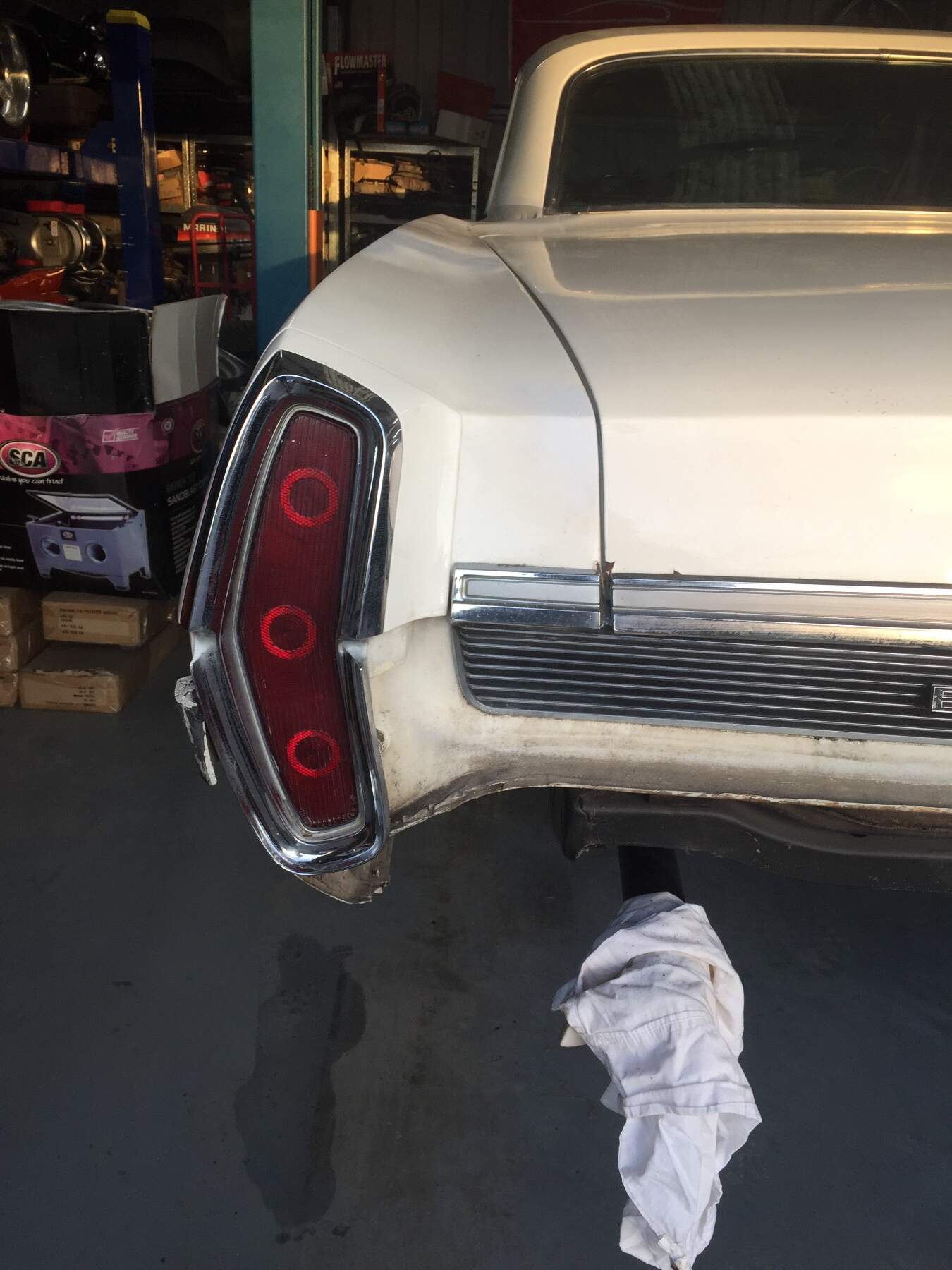

Note to anyone installing a 64 Bonneville grill
you have to remove all the front metal , assemble it as one piece and then bolt it between the fenders !

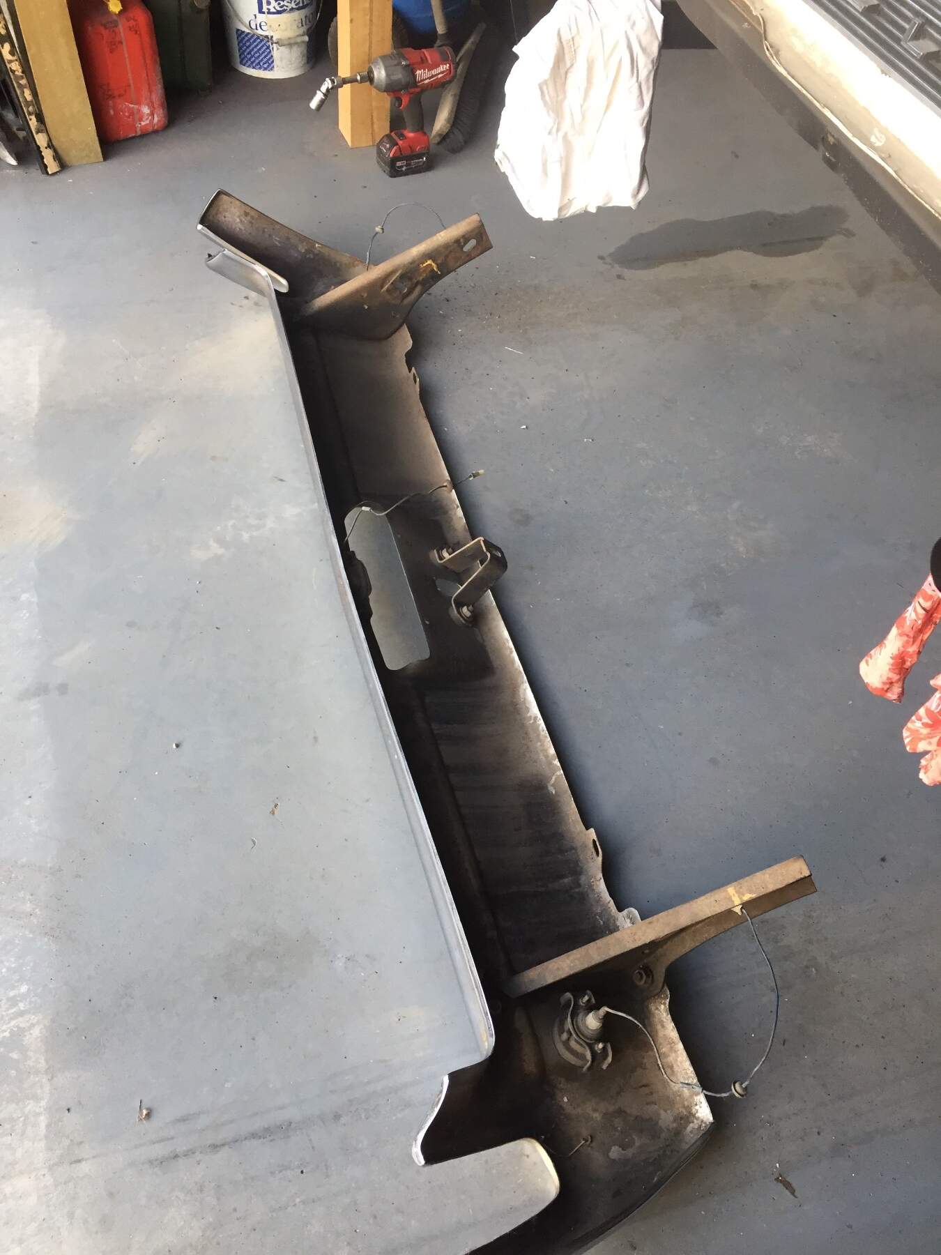

And when you want to replace a tail light lenses, you have to remove the bumper first !!!! :cheers: gota love pontiacs !! they certainly do things different :rofl:
