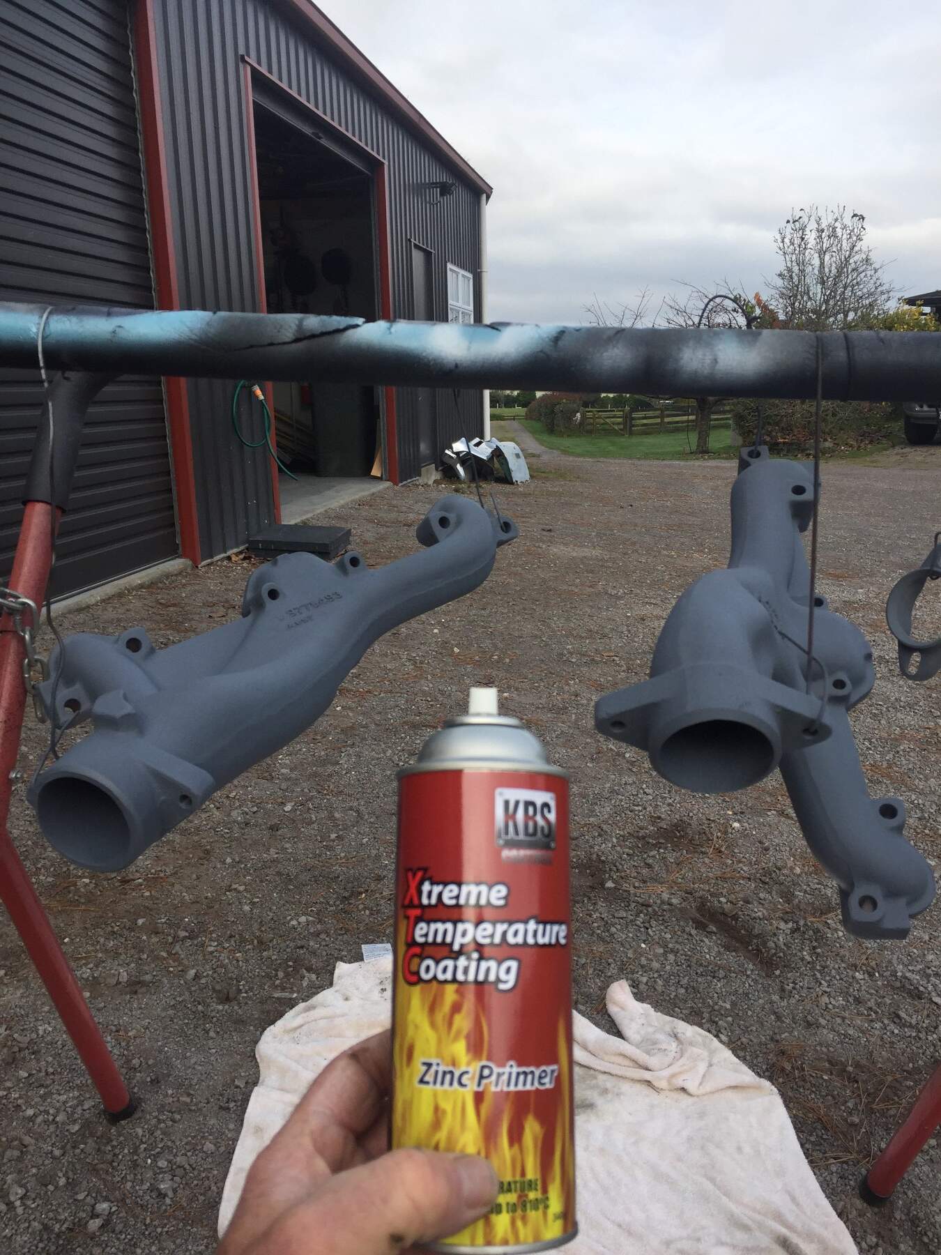

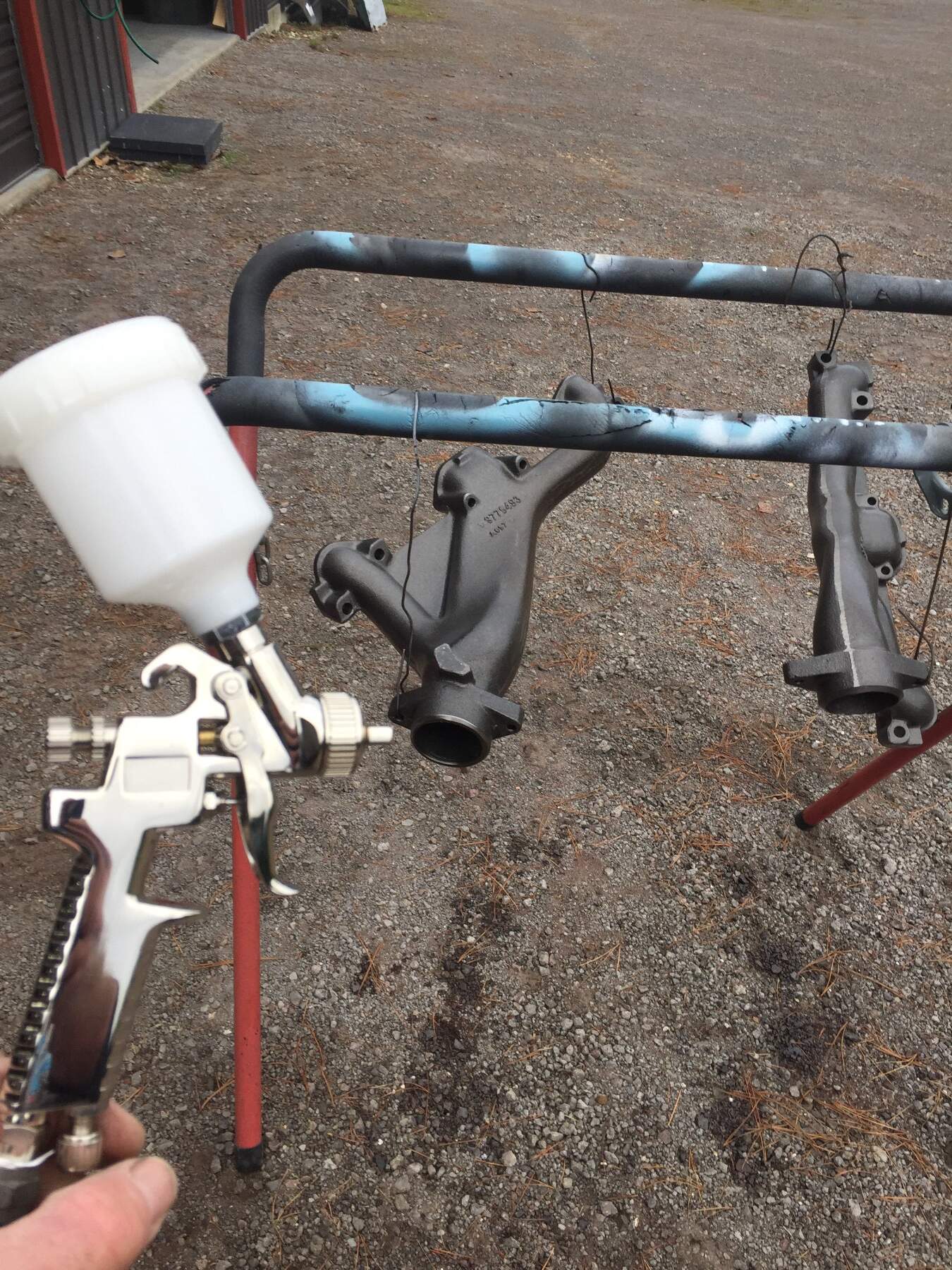

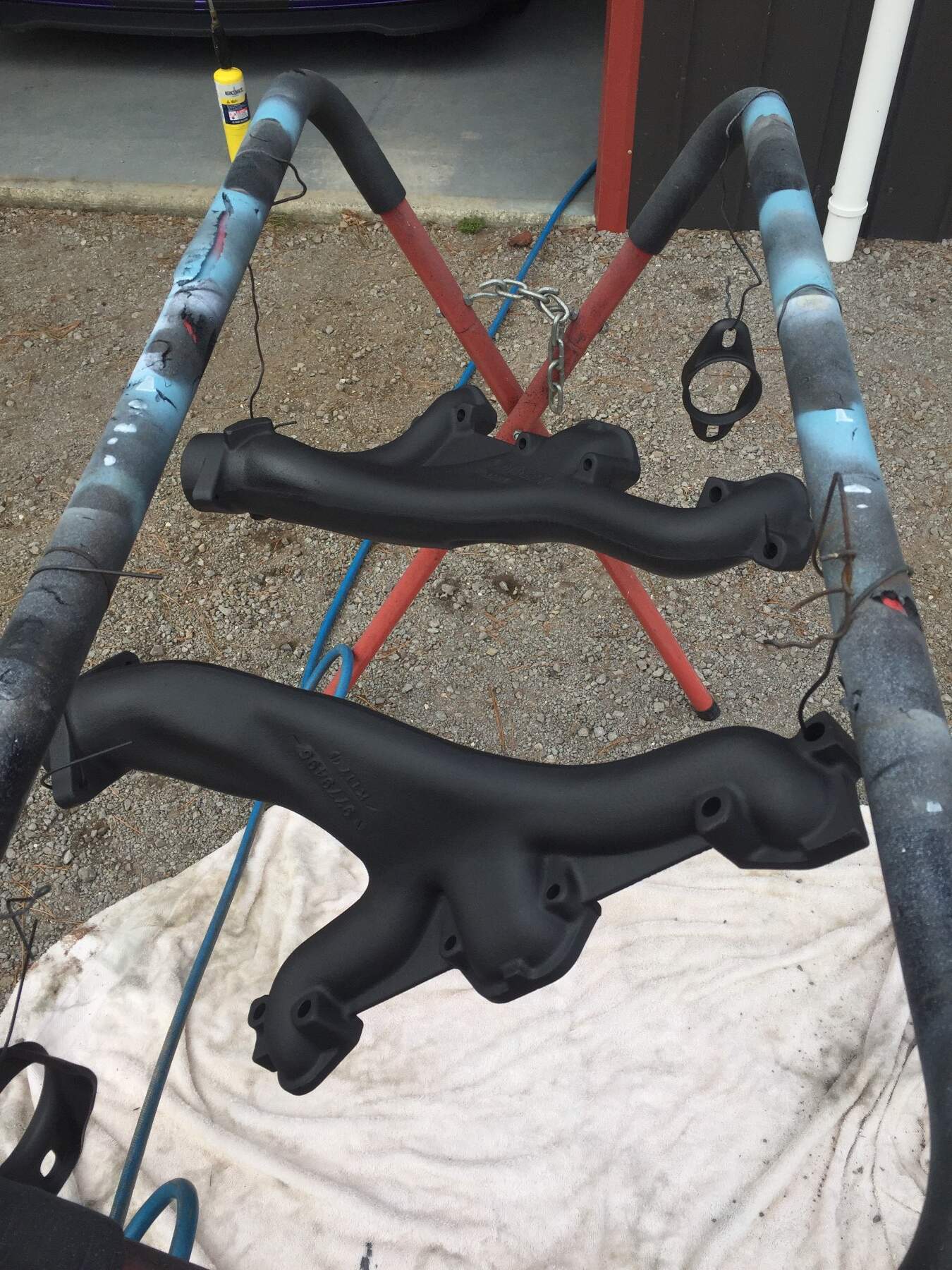

I got to paint my long branch headers with the ksb heat proof paint
Zinc coat first and then I got to try out my brand new touch up gun
with the satin black

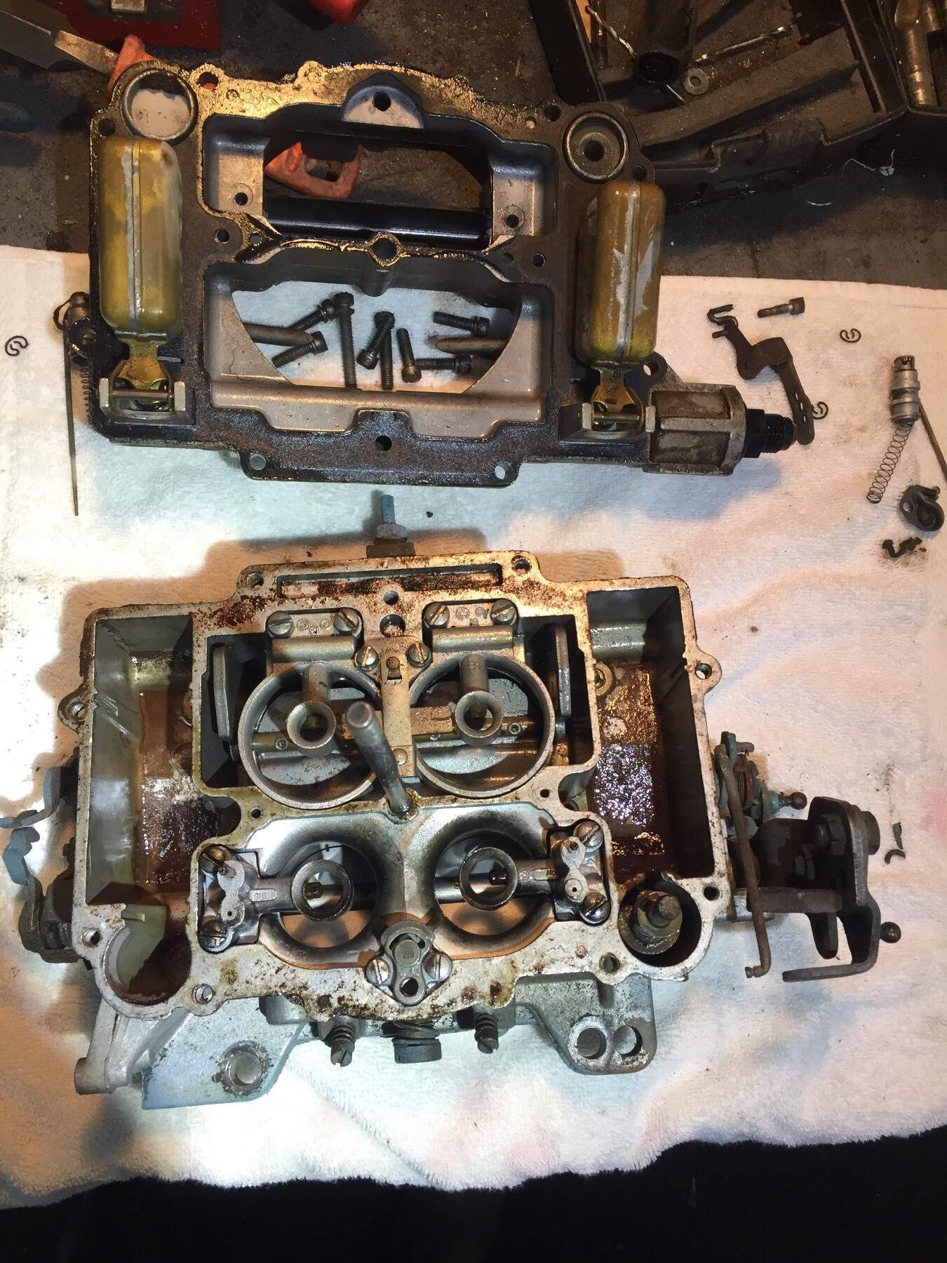

Then I had enough time to pull the carter  carb and start the rebuild
JustA small rebuild instruction manual !!!! NOT

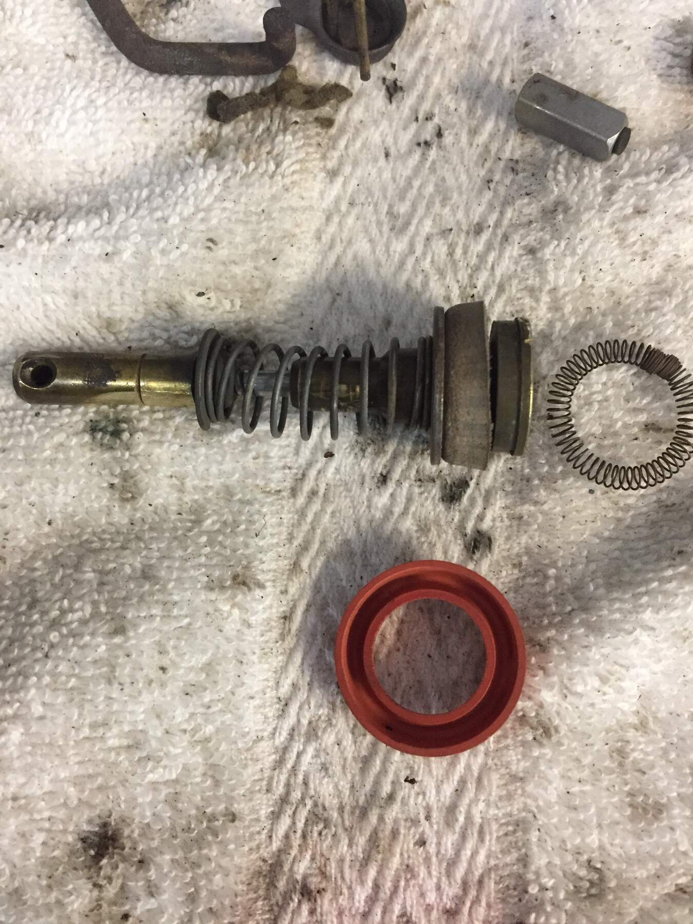

Here is a little catch for anyone rebuilding their carter carb, the edelbrock kit has a plunger seal that works for latter model units not a 1964 unit, my seal  is leather and a different shape , so the new seal doesn’t work
I have had to order a whole accelerator plunger assembly

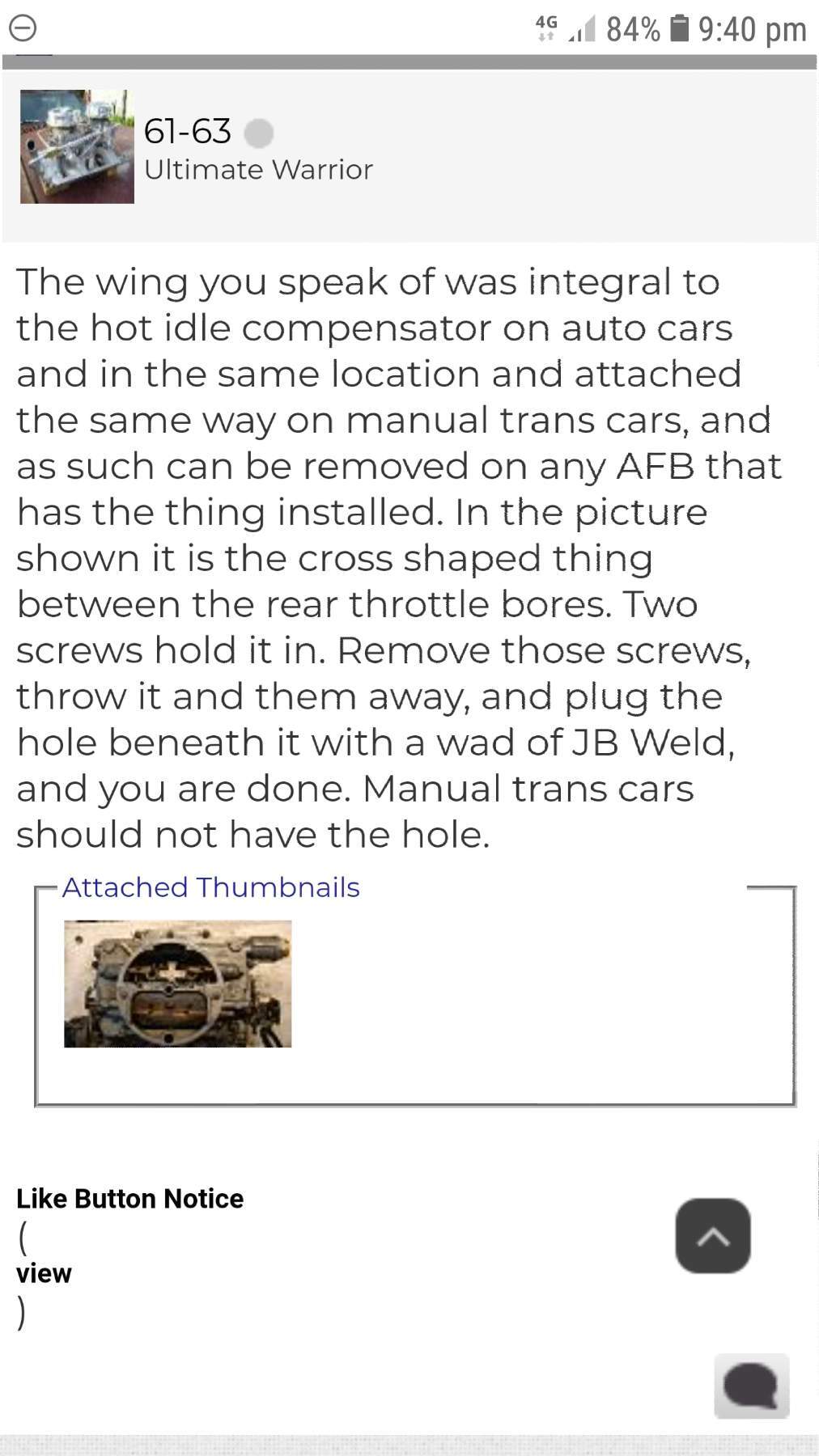

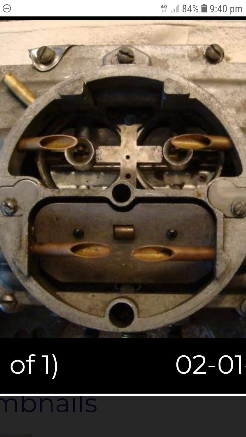

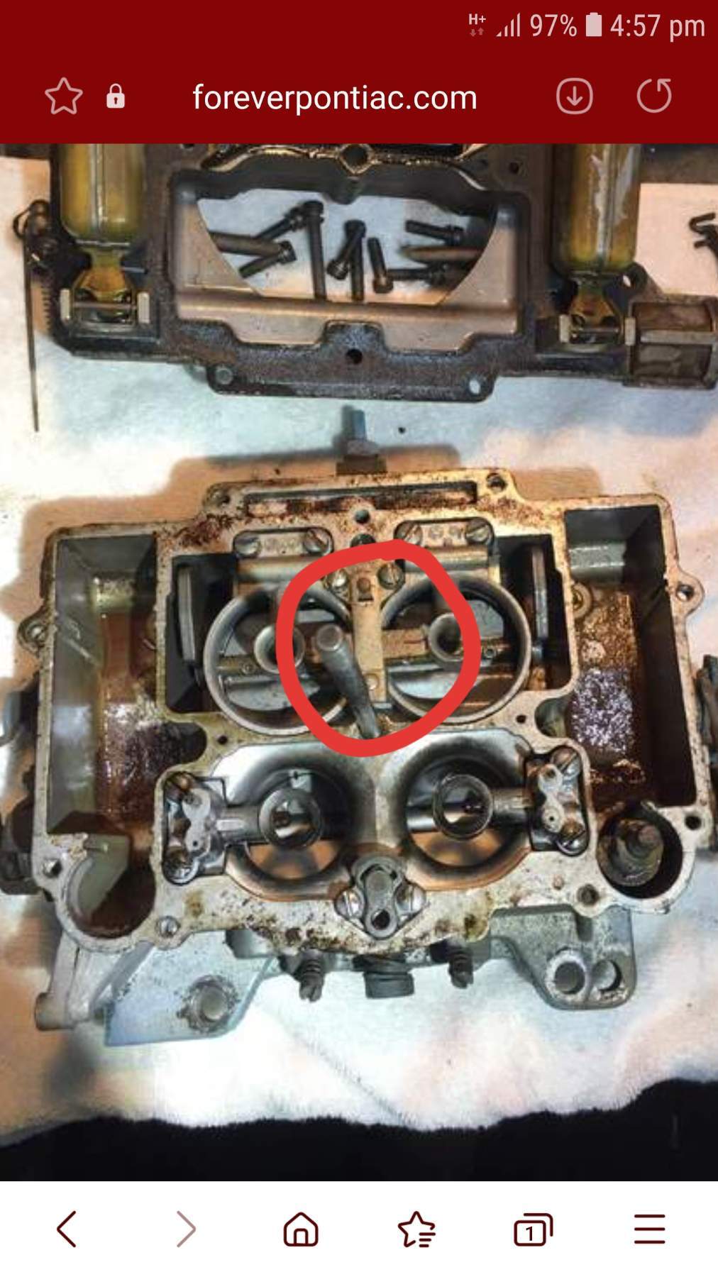

Kiwi - have a look at this:
Legend has it that some Carters had a restrictor installed at the behest of Pontiac to ensure that their tri power setup gave more horsepower at high revs. The first pic is of your carb.
I also have a similar Carter and already have the rebuild kit - all I need is for the car to come back!20210614_165735.thumb.jpg.9d62b11dd32fc75ac996779d657a2a99.jpg1555054182_Screenshot_20210606-214049_SamsungInternet.thumb.jpg.ba434043f5dfbece5b677edbb800ccaa.jpg482907627_Screenshot_20210606-214041_SamsungInternet.thumb.jpg.327ef9bfe10b56eb229f56d538ca3cf5.jpg
bugger me your right mate !!! i was wondering what that plate did !!!
where did you find this info ?????
the interesting part was i noted that there was not a replacement gasket in the edelbrock kit for it !!
fitzy, you will find you have the same leather plunger seal too mate and will need to get yourself a Edelbrock #1470 plunger complete
so you got me wondering, so mr google says it a hot idle compensator, that when the engine gets hot allows extra air into the motor and helps to cool the carb down again, and then shuts ...
from what i have read you need it for ac cars and hotter climates!!
It could be an urban myth. I forget how I found it - I've spent a lot of time at work lately, and I spend a lot of THAT time sitting still in a coach and idling, so Google got a workout.
I'll check my kit when I get home. If I have one of those doovers in my carb, I'll probably remove it. That way, when it runs like a bucket of crap, I can then put it back in.
I'd love to hear any thoughts that the guys might have on this topic.  Is it a myth, or is it really a restrictor, or is it actually what it's supposed to do?

ok further to the carb rebuild DONT buy the edelbrock kit if your rebuilding a carter afb!!!
 why...
there is a number of parts that are missing. they are....
 accelerator plunger ! the edelbrock kit only has a seal compatable with the later model plunger assembly, and wont fit the brass carter plunger assembly.
 the gaskets for the secondary air horns are not correct for the carter.
there is no replacement seal for the coke assembly to the fuel bowl assembly
the base gasket is a open 4 barrel gasket when the carter needs a 4 hole gasket...
 i found all this out by looking at the kit on rockauto... i had ordered a accelerator plunger from out new local speed shop, he came back to me and said there was none in the country and do i want him to order one from usa!!! i sad NO !
 came home jumped on rockauto and found that i should have bought a COMPLETE kit from them
https://www.rockauto.com/en/moreinfo.php?pk=987394&cc=1350425&pt=5964&jsn=849
 i paid $100 for the edelbrock kit and as you can see they are $47 plus $20 for freight to me here in nz!! boy some times i am such a dumb arse !!!
 i have now ordered the rockauto one... so i can get all the parts i need to correctly rebuild my carter! 😡
