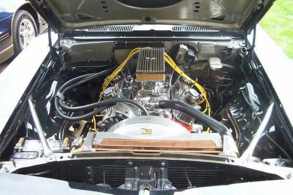

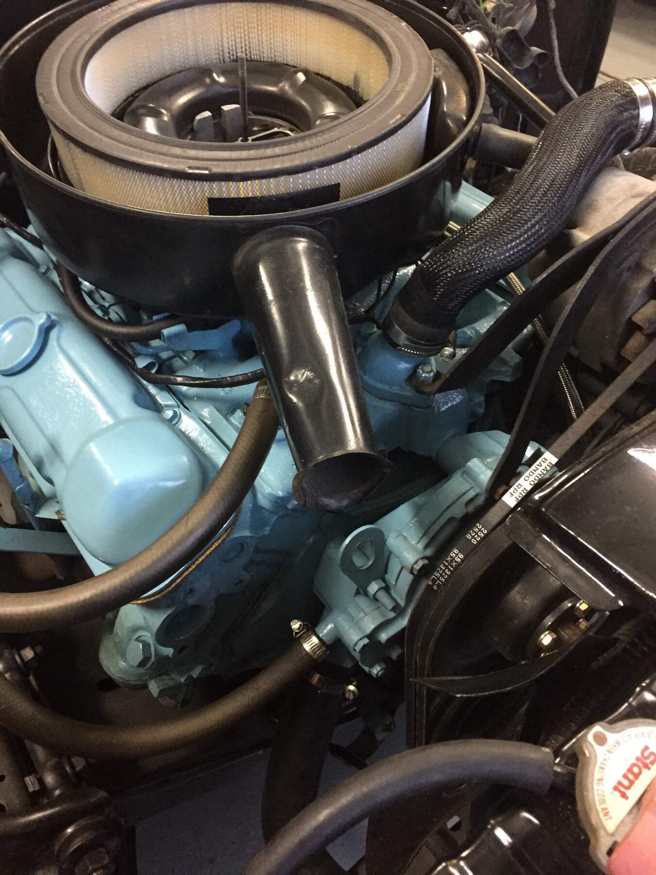

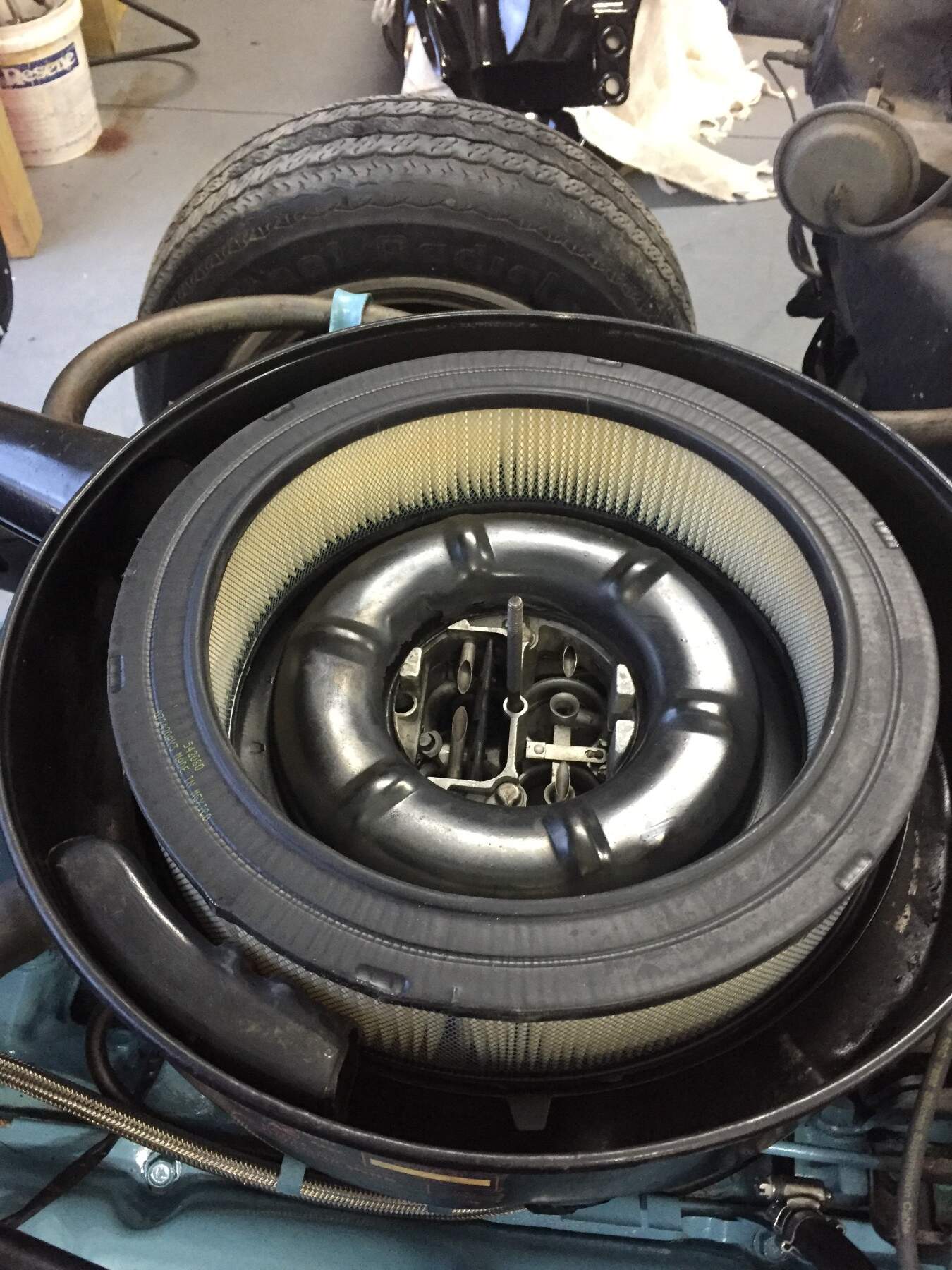

One thing I am going to change is the way too small air cleaner inlet !! It’s only 1 1/2 and that has to be restricting the air flow to the four barrel !!!
What do you think of this? I can't think of a cooler looking air cleaner. Apparently, it's an old Cadillac design.
Oh, by the way, your engine sounds great! Everything is looking really good, too.
Atta boy... Lookin sweet.
Purrrrrin like a Cat...alina.
My personal favorite for a V8 was always a pyramid design! To me it gives a structural stability design to the engine. It also has a tendency, if designed right, to aiding in volumetric efficiency?

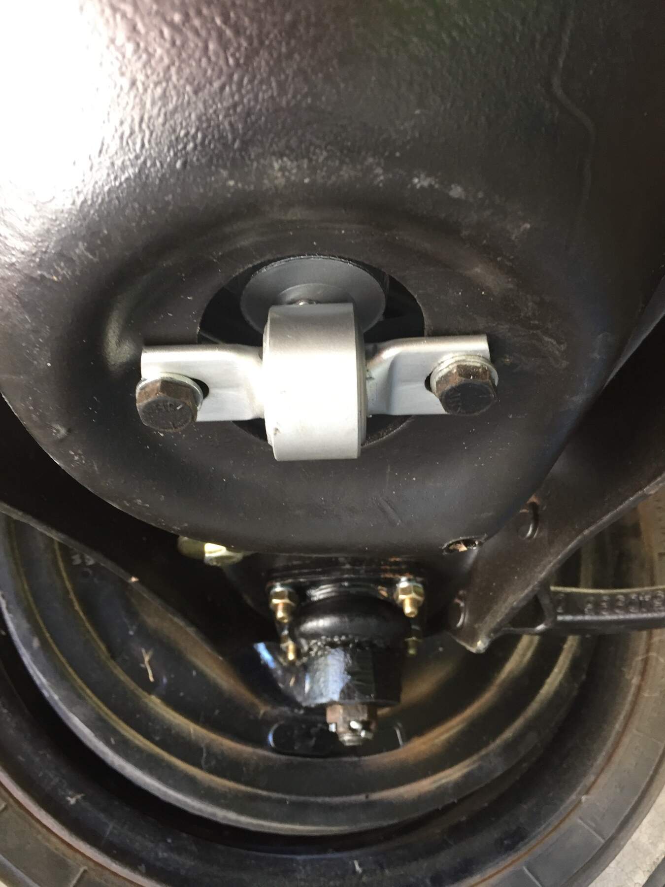

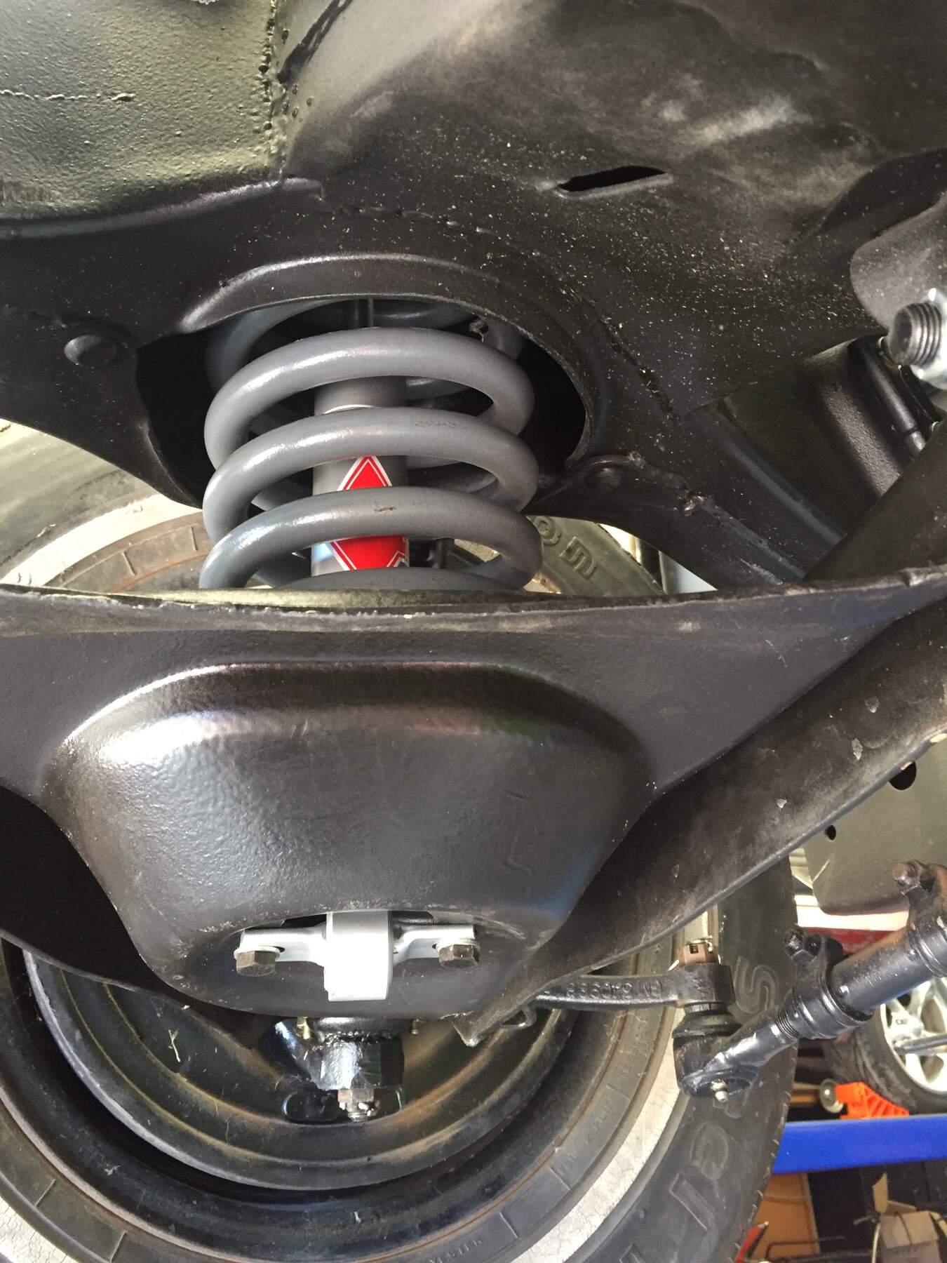

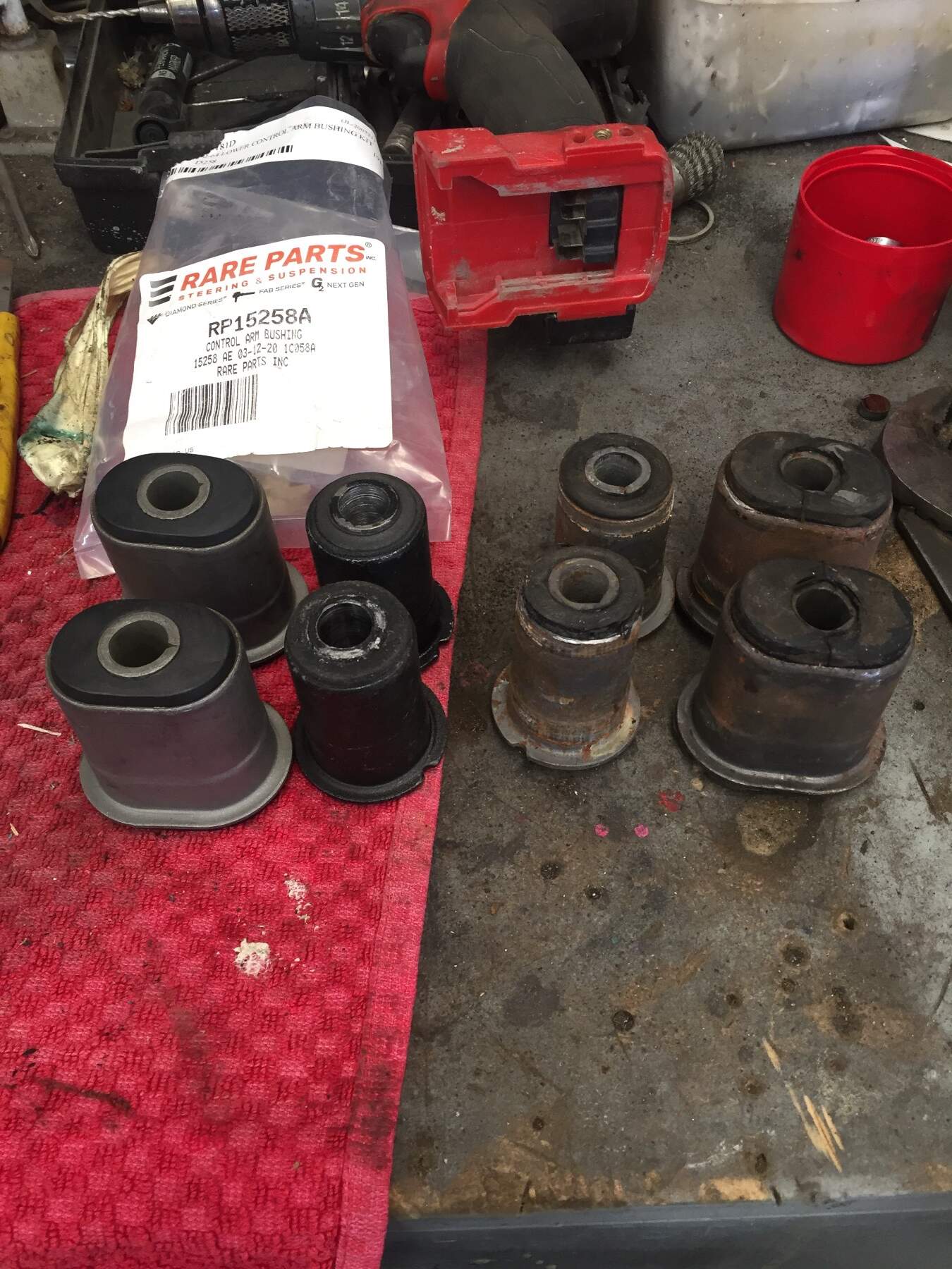

Now to the front end , earlier on in my thread you will see I pressed in the lower front A arm bushes only to find that they are 1/2 inch and my 64 is set up for 9/16 bolts !!! Simply not going to work .
bit of home work found the correct ones at Ames .... well I thought so !! Andy you will laugh ! Pressed out the wrong ones
went to press in the Ames ones , and stopped !!! I justA thought I would check them to ensure the 9/16 bolts fitted !
oval bushes bang on👍
Round ones didn’t fit !!! I ended up using a dremal to open them up to fit the bolts

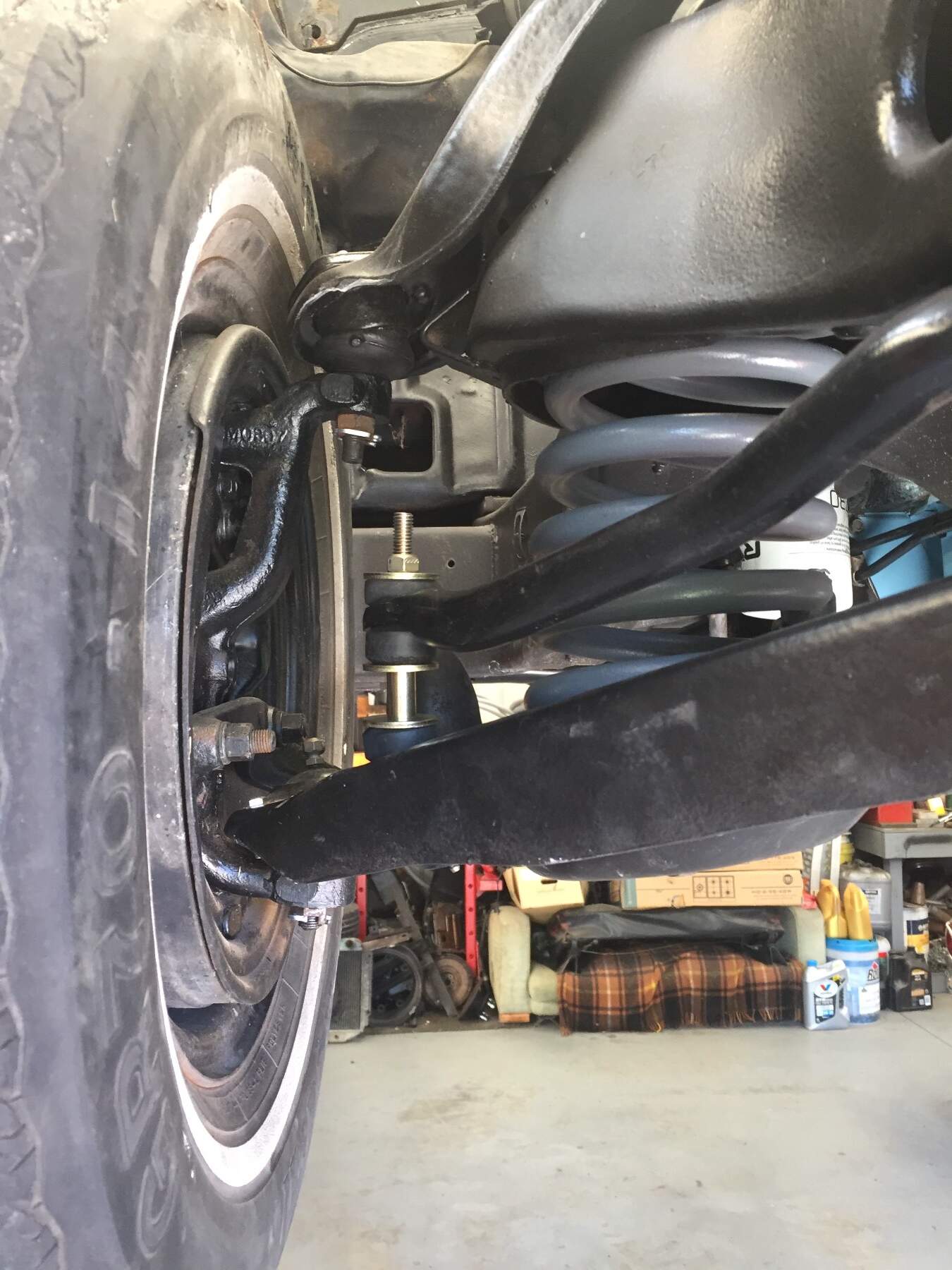

Next was to install them , along with the 3 inch lowering springs and sort the shocks
both front shocks needed the bolt holes opened up and once again I hit them with the dremal 👍👍👍
Looking good, almost time for a test drive?
Typical parts,always got to check everything, trust nobody.
Are those sway bar links stock? they look short, maybe that's what i need to do to make some more room for my front brake hoses,
Yes Andy, test drive possibly today !!
the links came from rock auto and fit nicely with my custom sized sway bar
the factory one was 3/4 I had my spring shop make a 1 inch one and I made my  own bushes to fit the factory saddles
So how much shorter are those spacer sleeves then the stock ones for the sway bar links?
Nice with a stiffer sway bar these older cars need help in that department, would like to add one in the rear of mine eventually but first things first

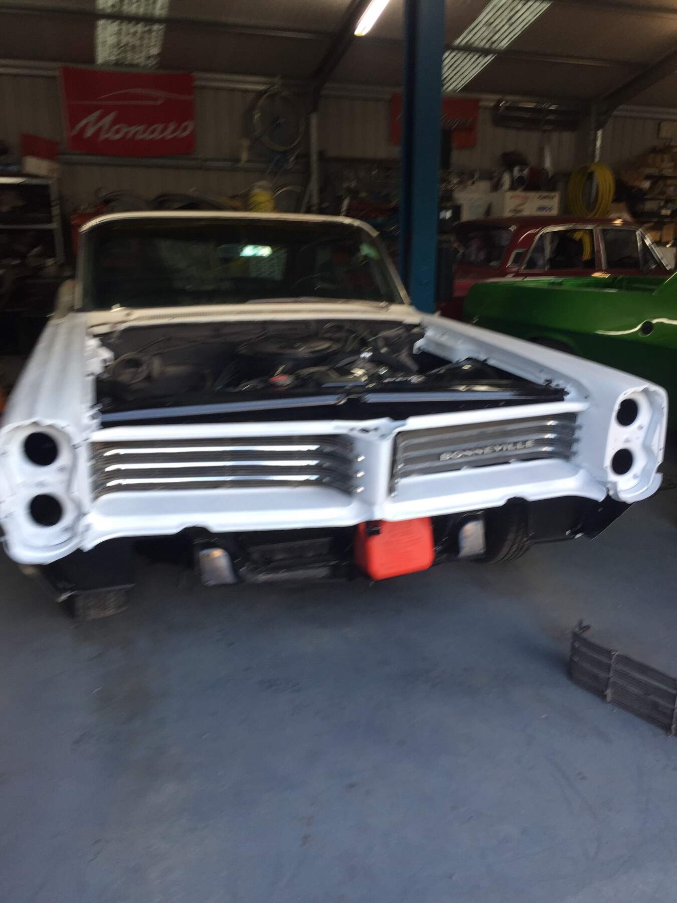

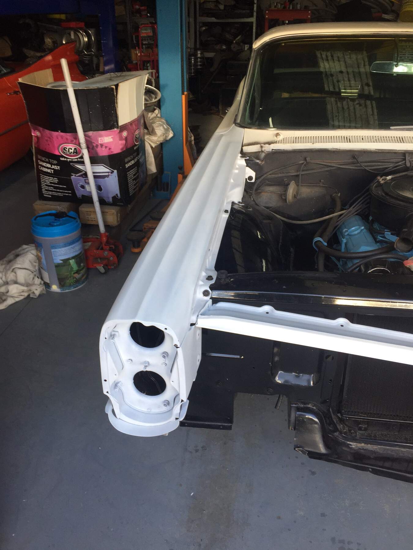

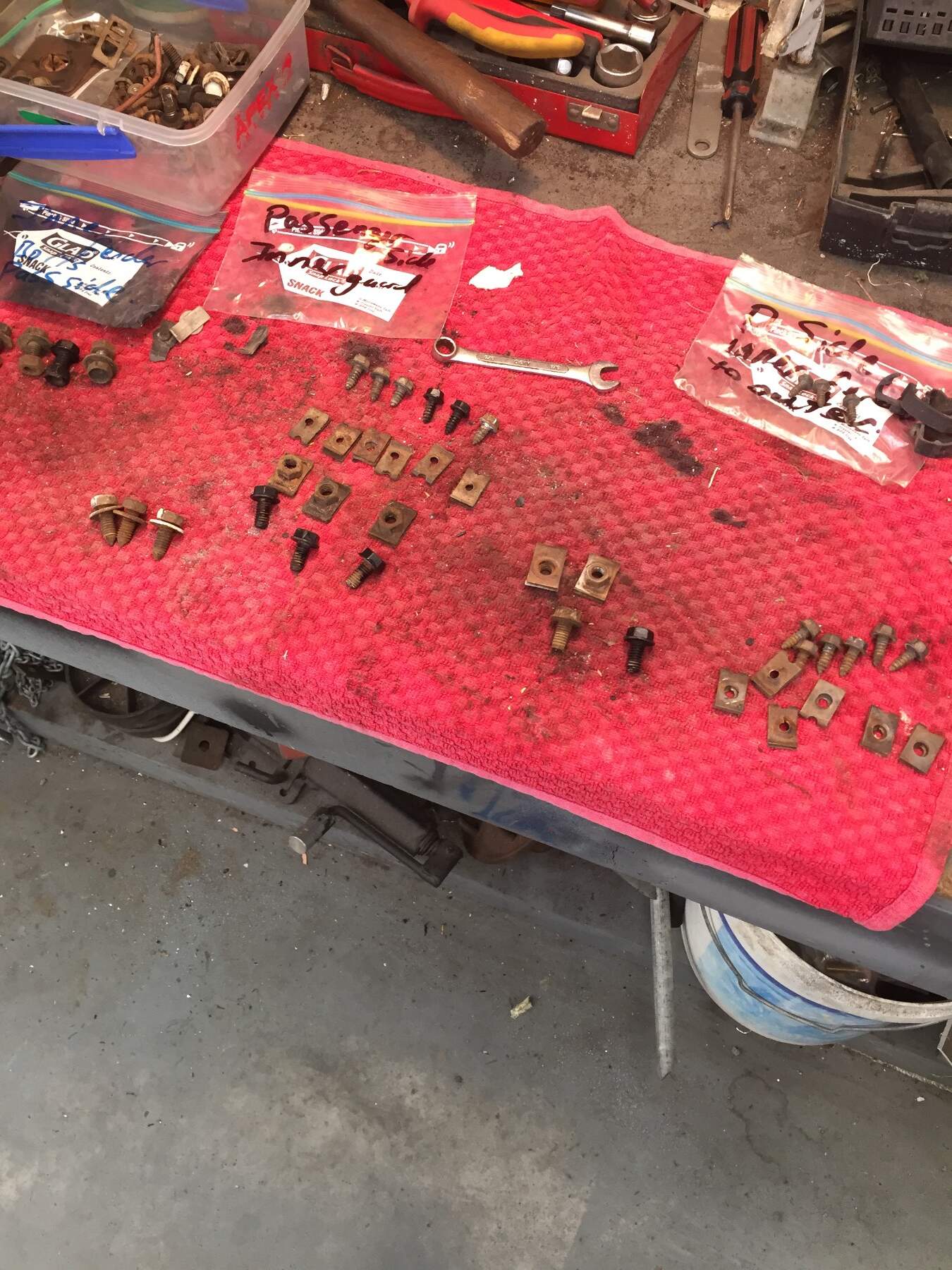

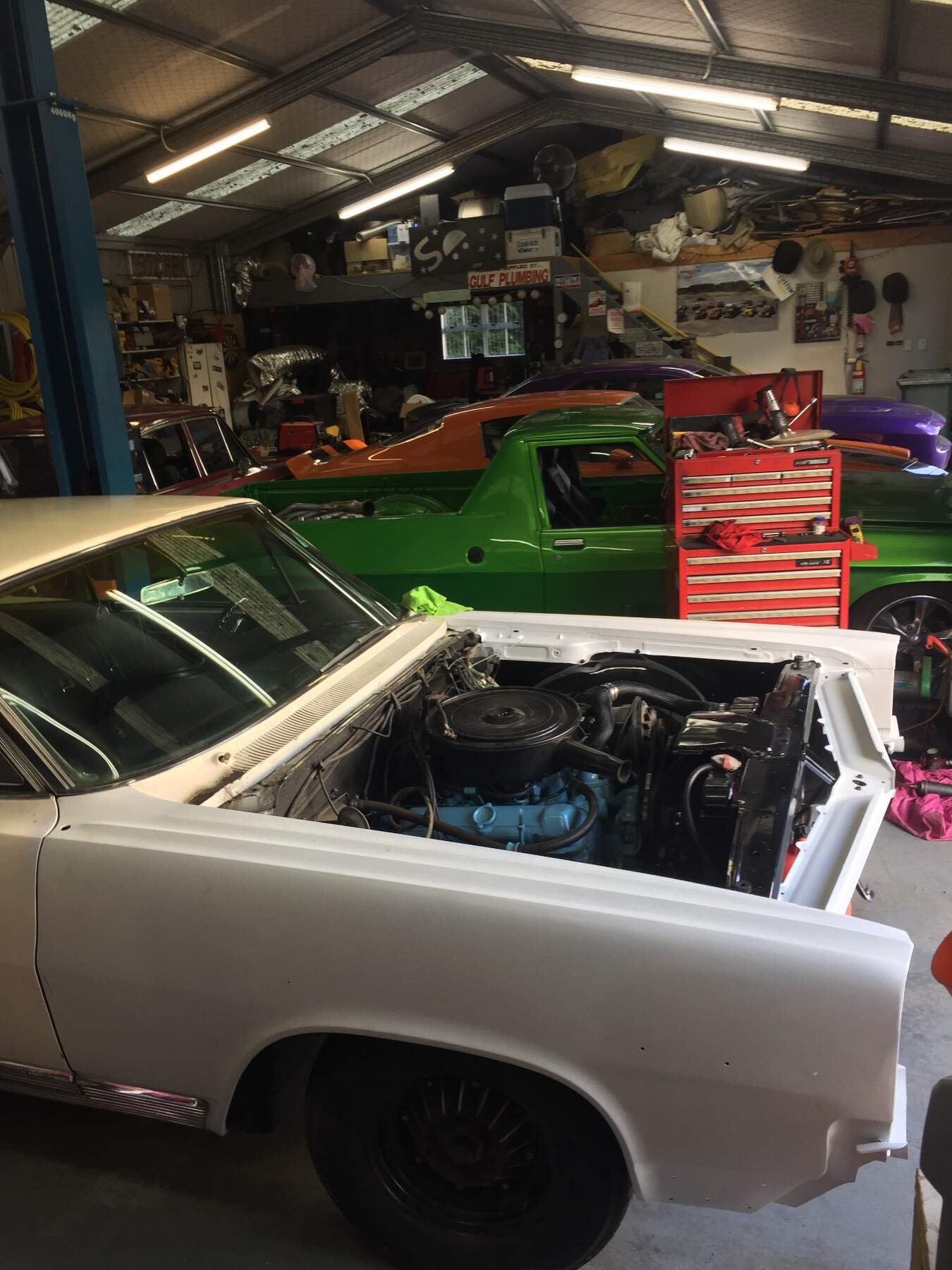

Heaps more progress today , I have spent most of the day buffing and painting bolts and the rest of the time assembling the front clip.
Justa seem to take forever !
And remembering where all the bolts go !!!

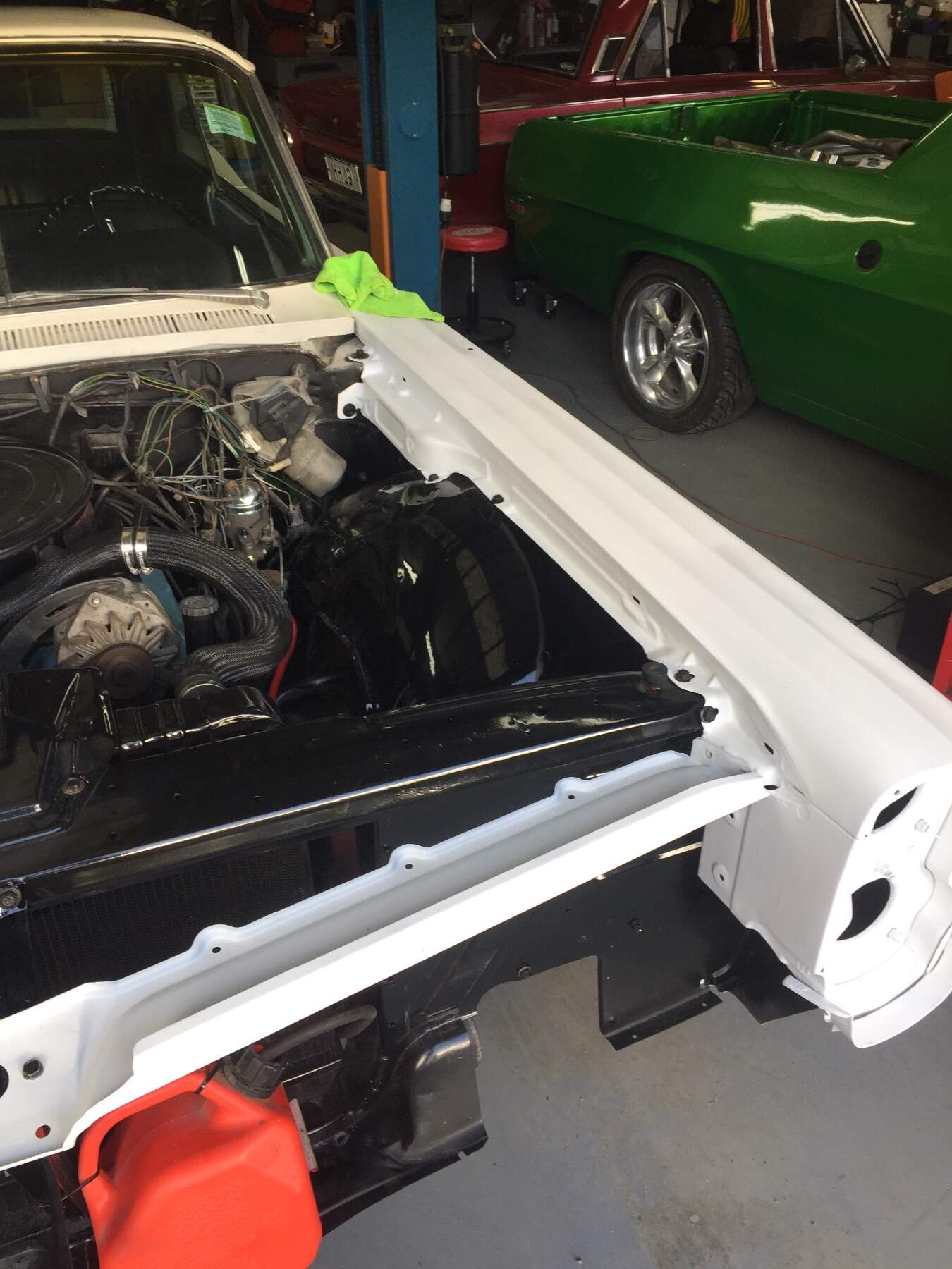

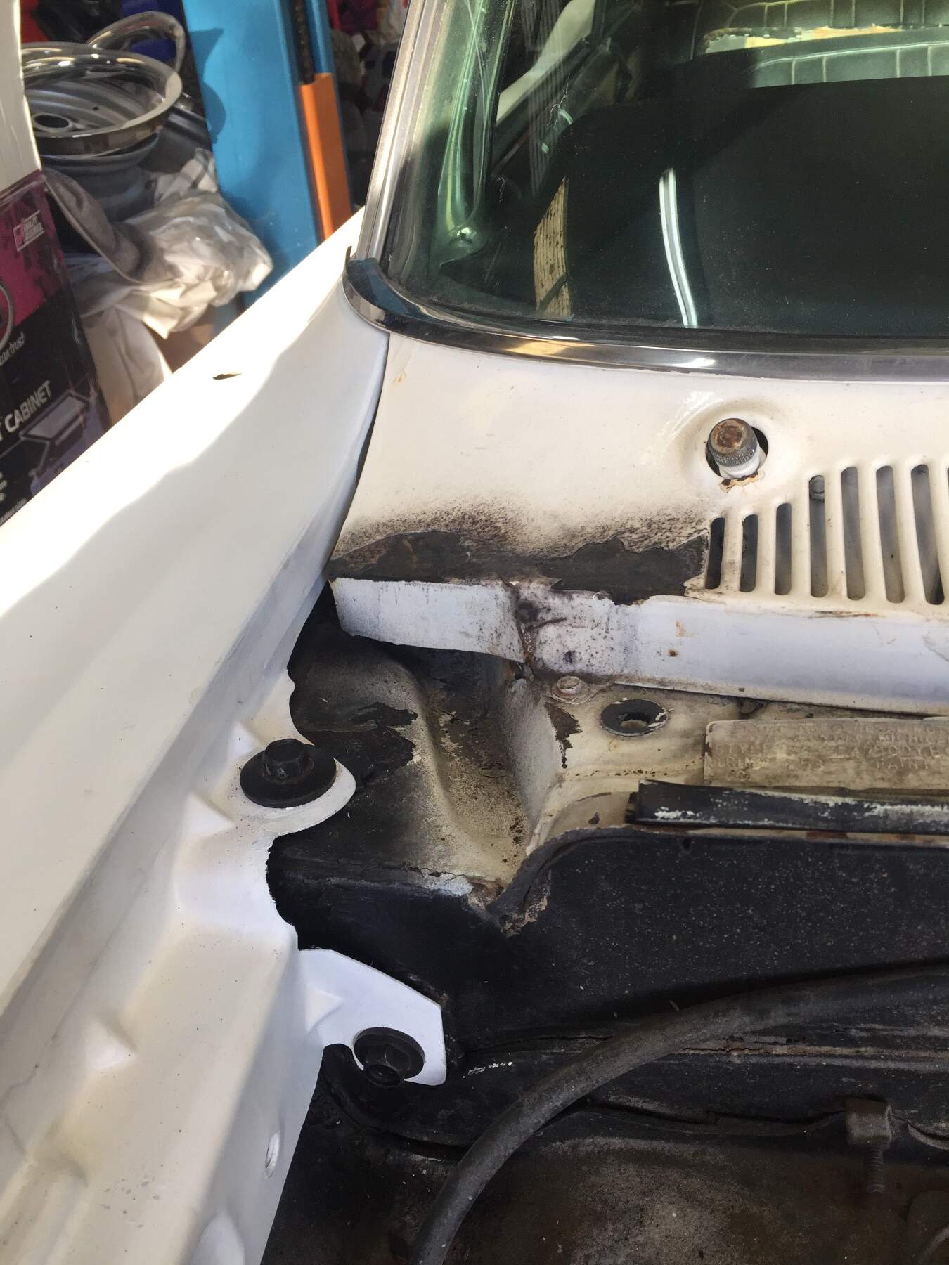

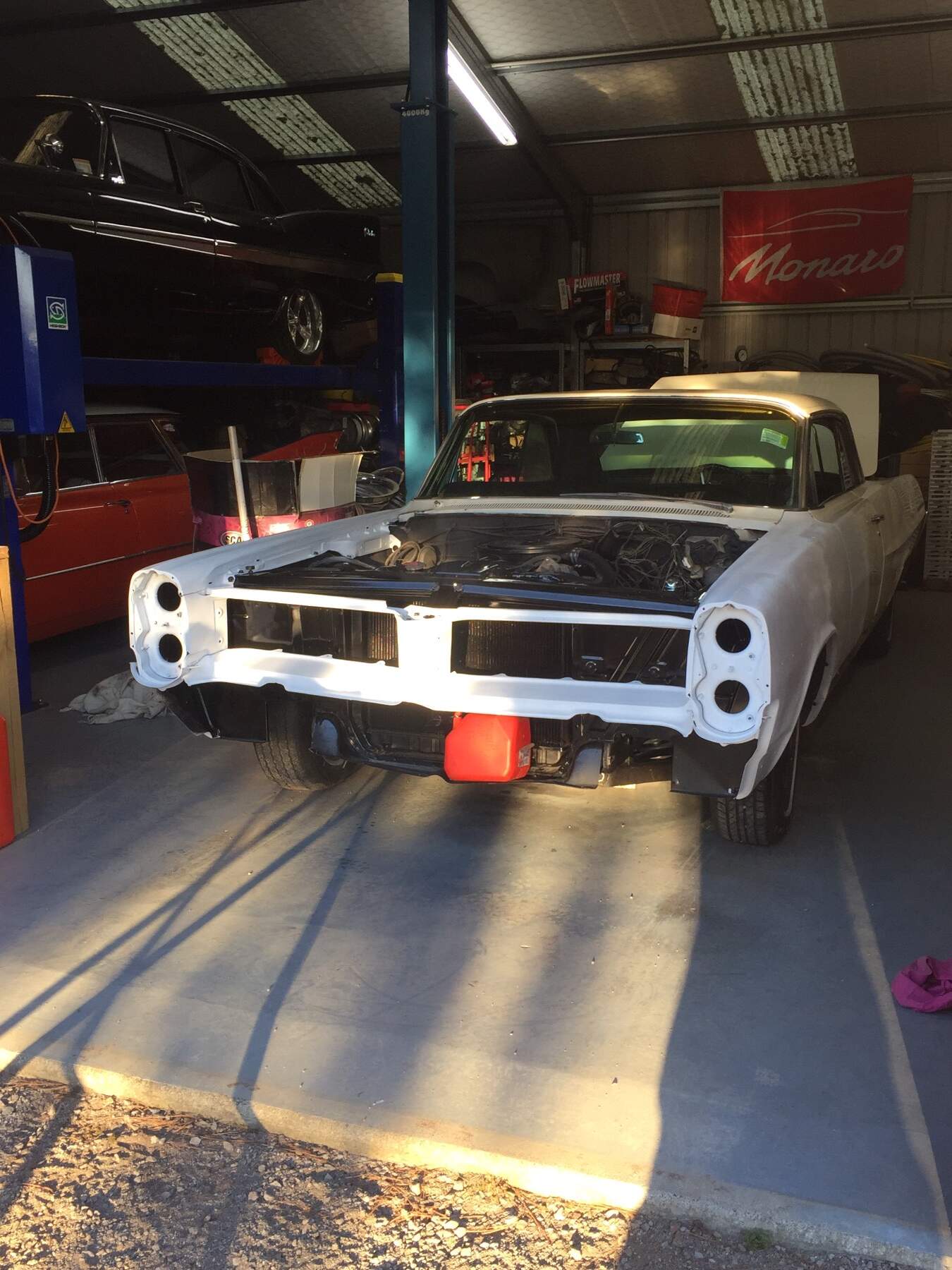

The inner and outer fenders where prepped last year and had been sitting waiting for me to complete the engine / chassis swap
what i did find to be an issue, is the passenger side fender, i assembled the inner and outer and went to fit it too the car, would not fit !!! ($### IT ) the heater fan was in the way, so i removed it,,, easy! fitted the whole assembly then looked and not a hope in hell of reinstalling the fan motor!! .....
So i had to spilt the inner from the outer fender, lay the inner over the wheel, then install the outer then bolt the inner too the outer !!! what a muck around !!
in hind site, i should have assembled the whole front clip, then fitted it to the body. but to do that would have taken two guys and i do all this by myself.:picard:
I spent a whole lot of time adjusting the panel gaps and i am so pleased i am not dealing with finished paint as i marked the heck out of things justA moving panel around and doing bolts up and undoing them again.
i found that the cowl panel need some love, so i will remove it and make it nice and straight again
And after day 2 the girls looking way more like a car again , and not a bent wreak :cheers:

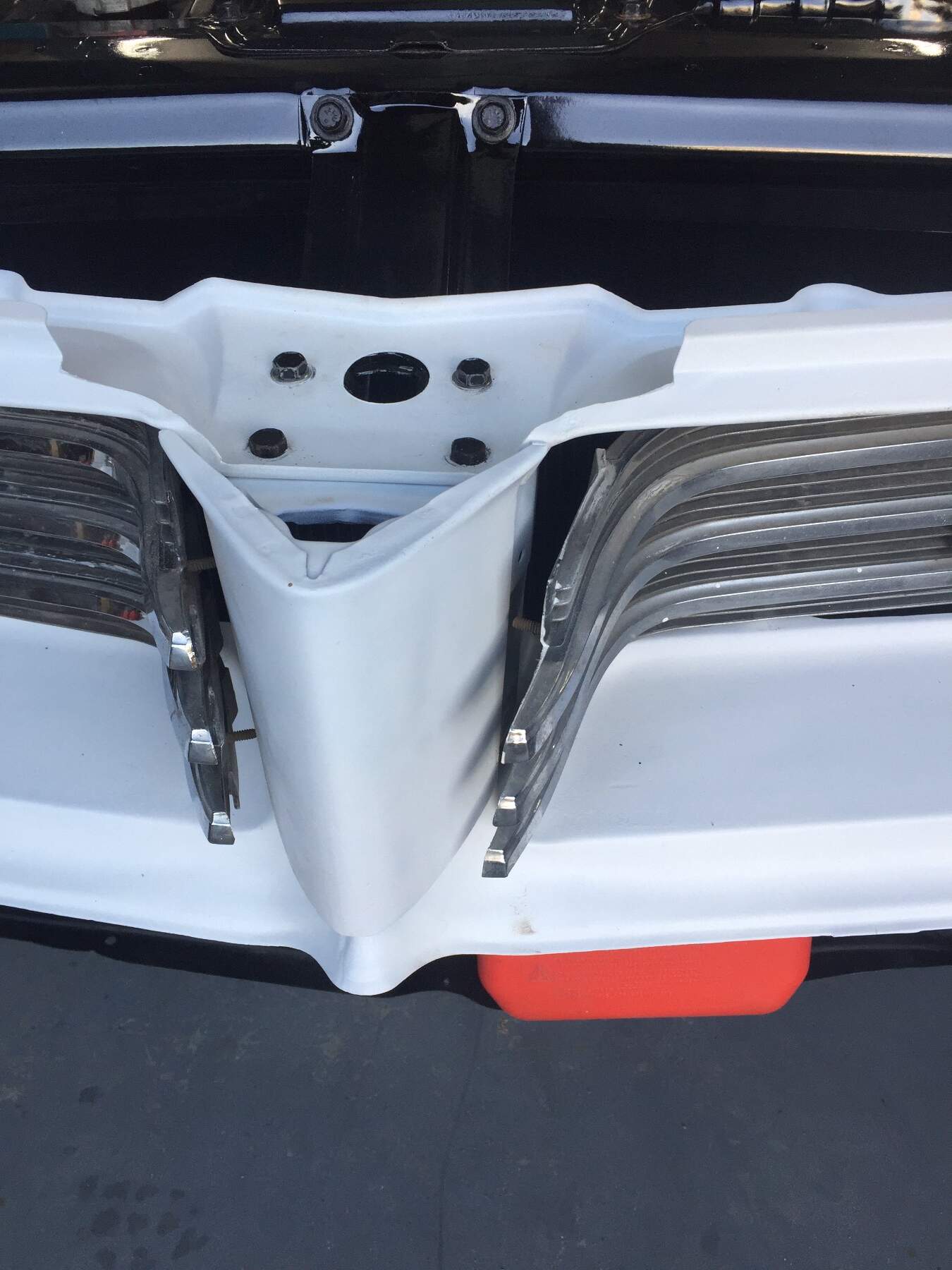

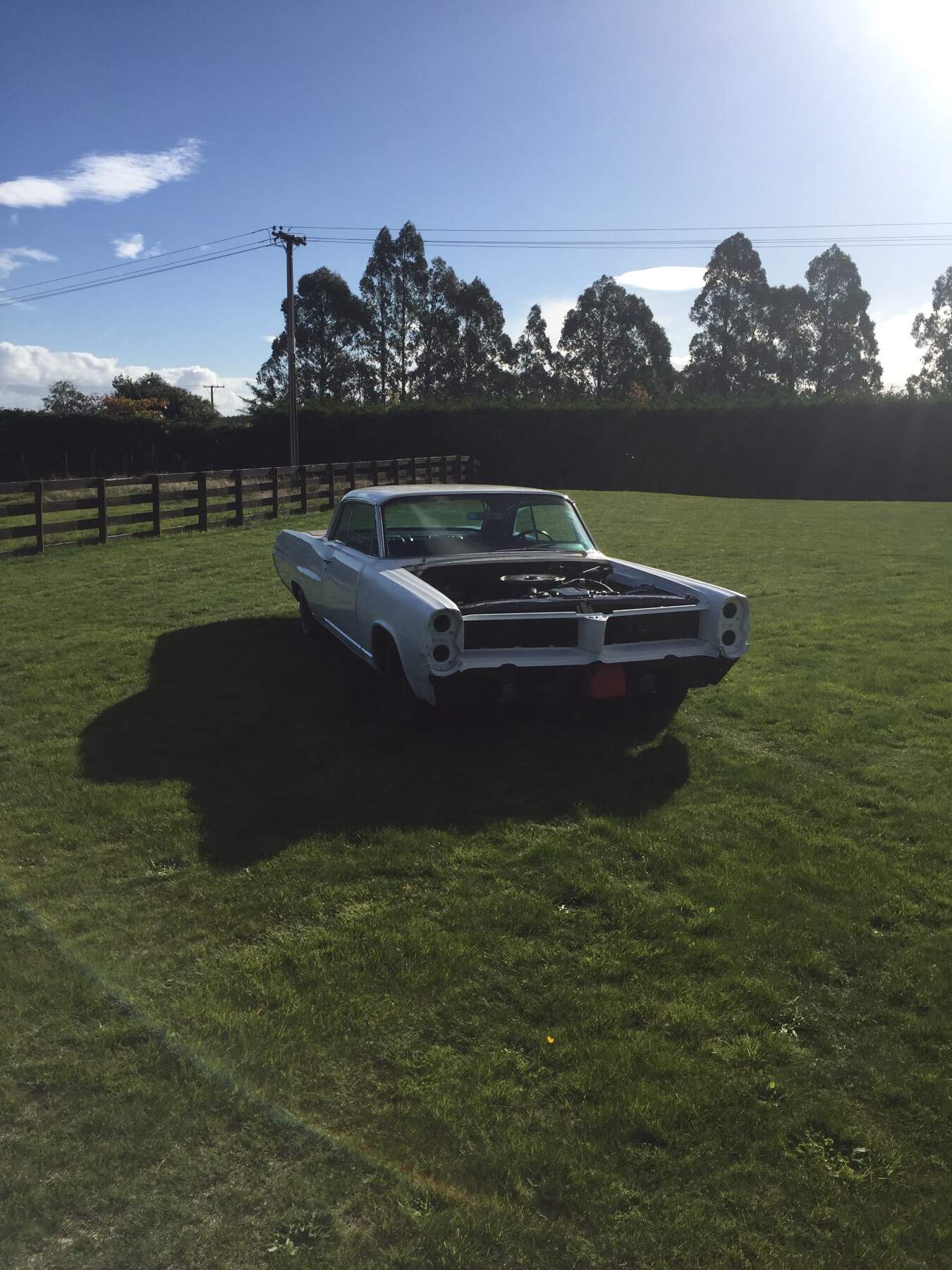

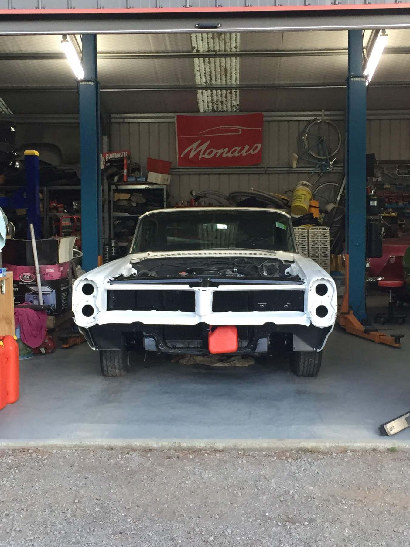

While standing back having a beer and admiring my days work I thought I would see how the grills fitted !!!
They don't !! I will need to unbolt each fender and push the fenders apart to get the grills into place !!!
Another wtf moment !!😡😡😡😡
so pleased its all in primer stage! or it would be a nightmare !
i am going to have to come up with a cunning plan on how to paint these parts and assemble them without all the possibility of scratches.
hmm, good food for thought there mate :cheers:, justA dont see how a 1 1/2 hole can feed enough air into a 300 hp engine !
Wow - look at all that work. Car is looking really good. You must have loved the moment you sat the grilles in place only to discover that they didn't quite fit nicely. How many damn cars have you got in that garage??? AND a hoist! No wonder you can do just about anything. I was always reluctant about laying under my car supported by stands and having the possibility of 2 tonnes of Detroit coming down on me. Anyway, well done.
You are the magician,,,,  Looks so good, you have every right to be proud of all you have accomplished.:bowdown:
Wow bro! Looks great. I'm gonna have some questions for you in the not to distant future :lol:
Wow ,what a progress, nicely done, nice garage to, looks like you are a busy guy, you sure you have time for that work thing?
How are you going about paint? are you going to paint inside of the fenders and door/ trunk openings and then reassemble before painting the outside or are you going to paint everything in pieces?

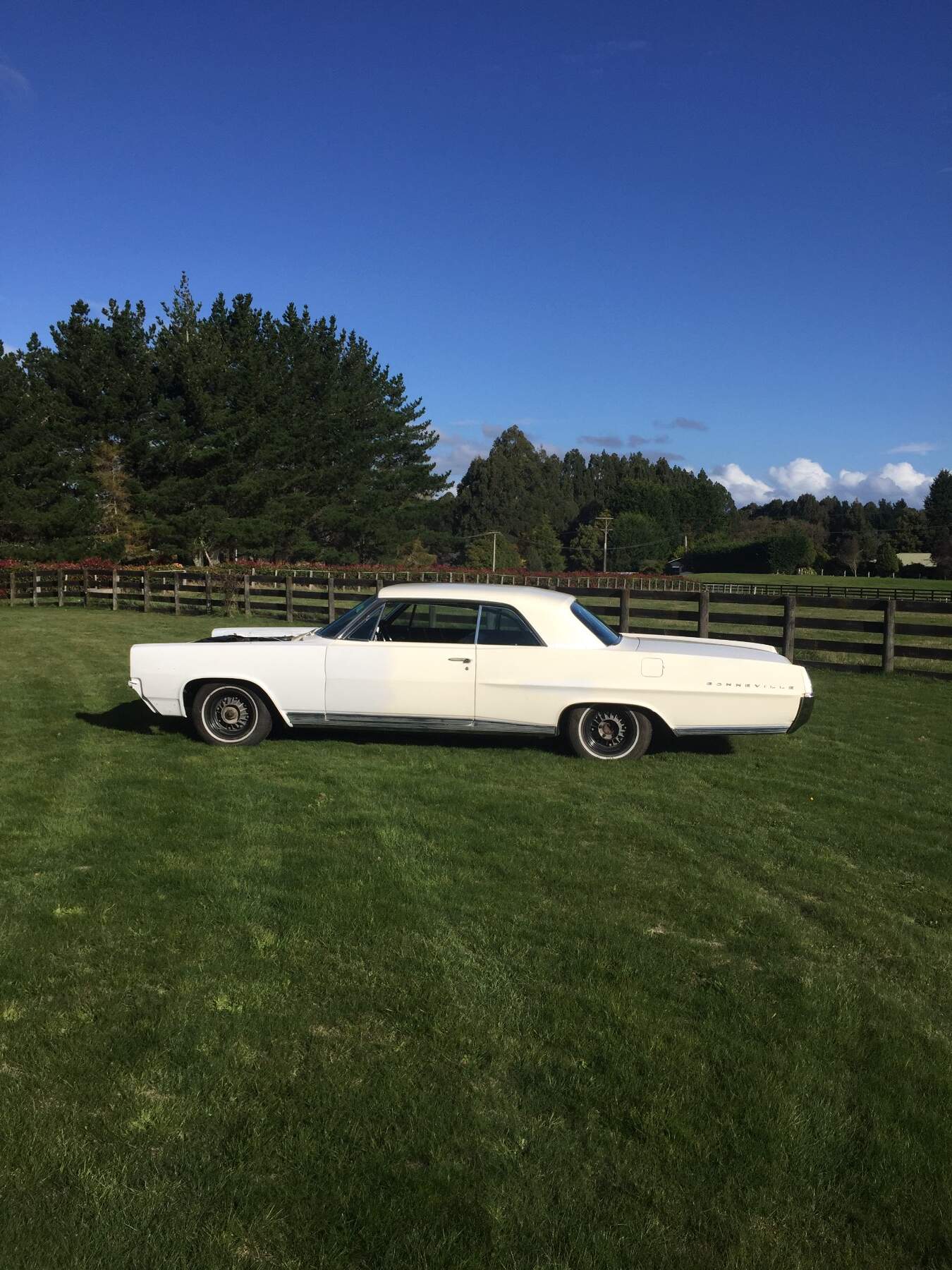

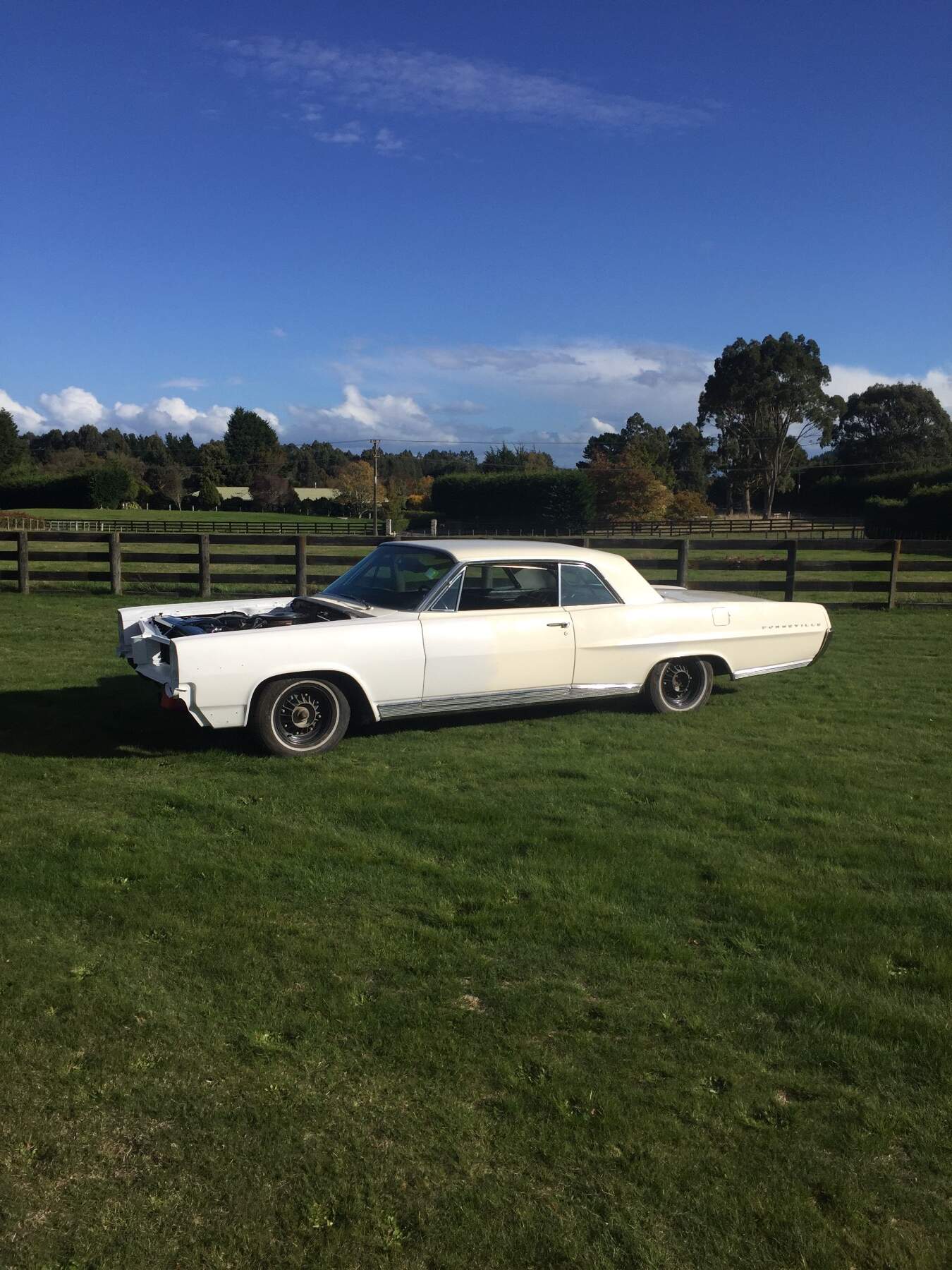

FIRST DRIVE  :cheers: VIDEO
DA6141F0-1C3C-421B-8FC6-BF39EBB6A826.MOV

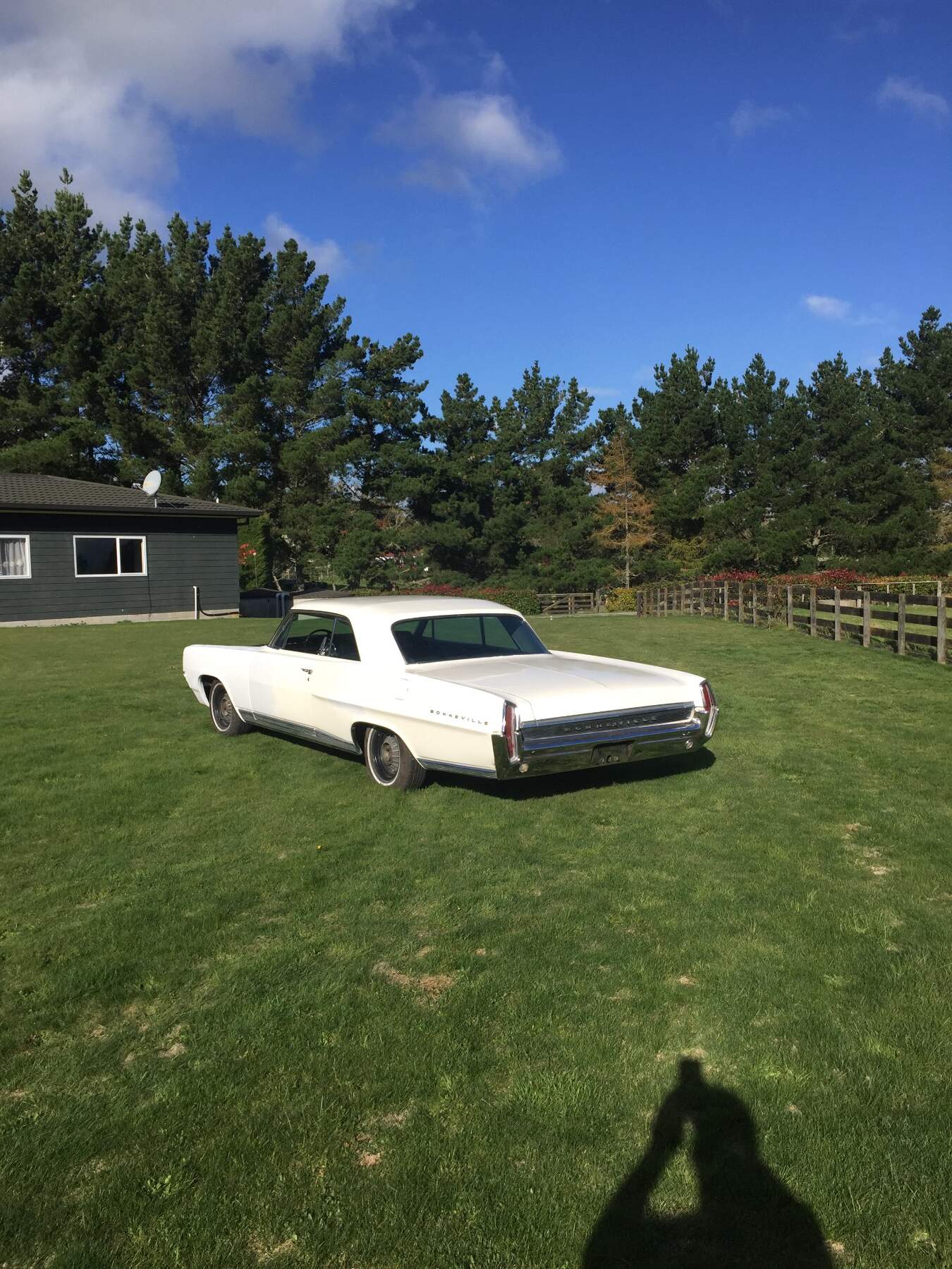

And some shots of her on the lawn :cheers:!!! Its bloody beer o’clock I feel :cheers:
Kiwi! That's flippin awesome bro! Congrats man!!! :dancingpontiac::cheers:
Did you decide on a paint color yet?
How in the heck do you have time to build cars with all that grass to cut??? :rofl:
Shit hot. A vast improvement and it's sitting nice, too.

yes mate, my plan is high opacity white, with a pearl in the clear coat, for below the belt line and then go the same white on top but with a heavier pearl in the clear coat .
am yet to get some paint and try it on something.:cheers:
I love my big lawn, i can drive around the house, some times i give it some gas and do some skids, and i have a ride on that does the job in about 2 1/2 hours.
best part about living in the country i aint hurting  nobody and i can make as much noise as i like!!! haahaha
sure is Fitzy  justA not to sure on that ride height in the rear yet,, kinda bit low, front looks good to me at 3 inches down, but not all the sheet metal is on yet.
Still have that hood to prep and fit and the 2 ton front bumper!! haaha:rofl:
