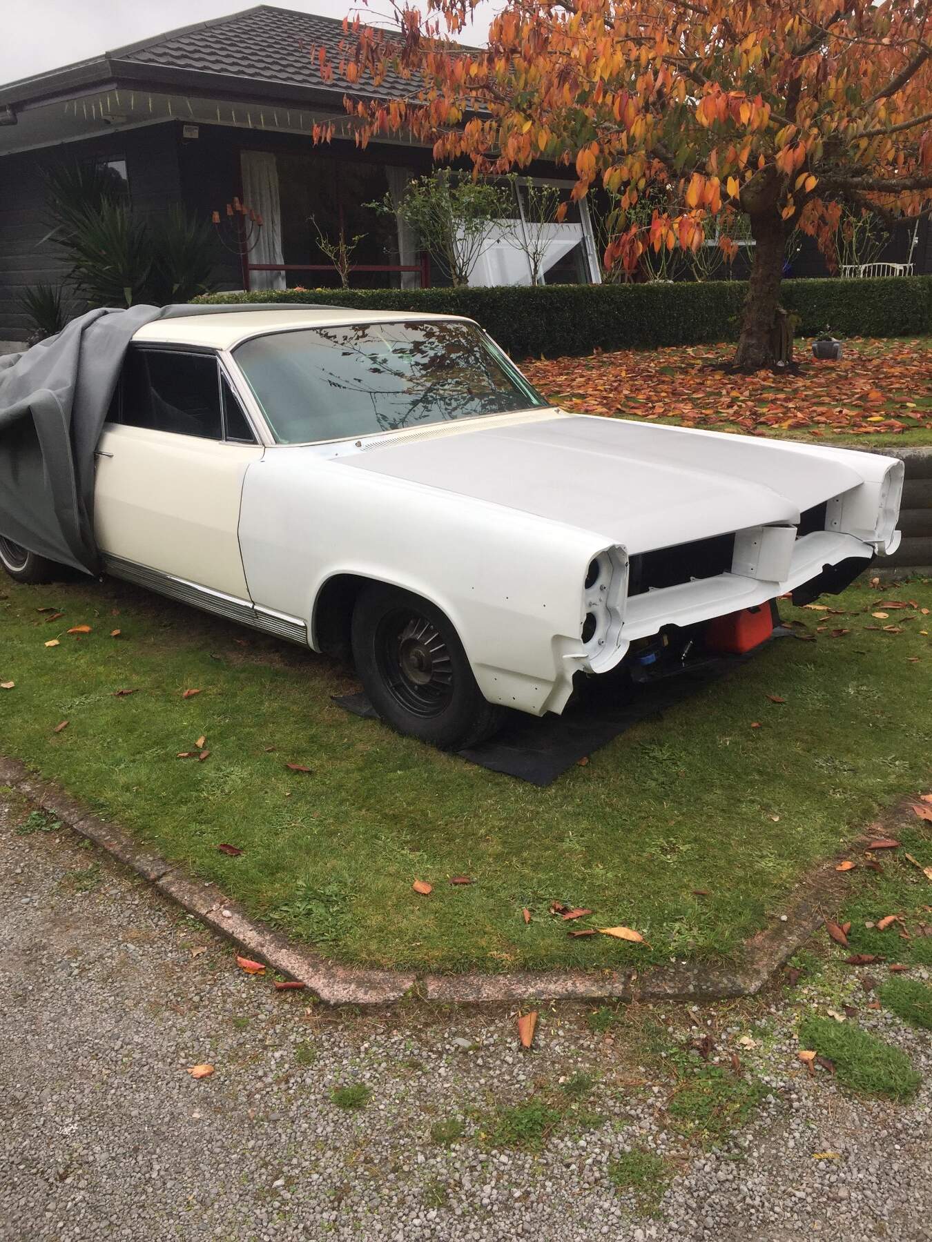

yip, its certainly autumn here in nz, you can see the cherry tree in the back ground telling me its time to dump my leaves !! 😡

9 hours ago, 64 kiwi boni said:
So on a 64 there is only 2 bolts holding the whole front clip onto the chassis, i undid these and move the whole front clip over till i had the diagonal measurements right.... now if your doing this .. i measured from the bolt on the fire wall that holds the fender on    ( top one) across to the bump stop bolt/ rubber on the radiator cross member on the opposite side.
 i had already paralleled my hood with the cowl panel, so i knew that my hood was square to the body.... give or take a little that you can adjust the cowl panel... and they do move a bit !!
Gota remember, i am dealing with a car that clearly had a major frontal impact, AND it was built in 1964, so panel alignment  was never flash back then, mind you new cars are not any flasher !!! :rofl:
Once i am  happy with were it all is ......., ( and i am not there  yet) i ran out time today, i will drill a 1/8 hole in the hinges to mark were they need to stay so that i can refit it back in exactly the same location after i pull it off to paint. ( if you are dealing with a finished painted car, justA use a marker pen and scribe around your hinge  mounts... trust me, it will save you so much hair pulling !
i have also moved the 2 mounts over on the chassis to radiator cross member  and they will need to be re-calibrated ( flash kiwi  word for grind out the hole to make fit) :cheers::rofl:
And looking more like a super cool wide tracker very day i work on her... so pleased with how she looks:dancingpontiac:
Best time of the year for picture shoot N build a large portfolio of your cars.  Sooo many beautiful/colorful backgrounds for your cars.  This is where calendar shots are born!

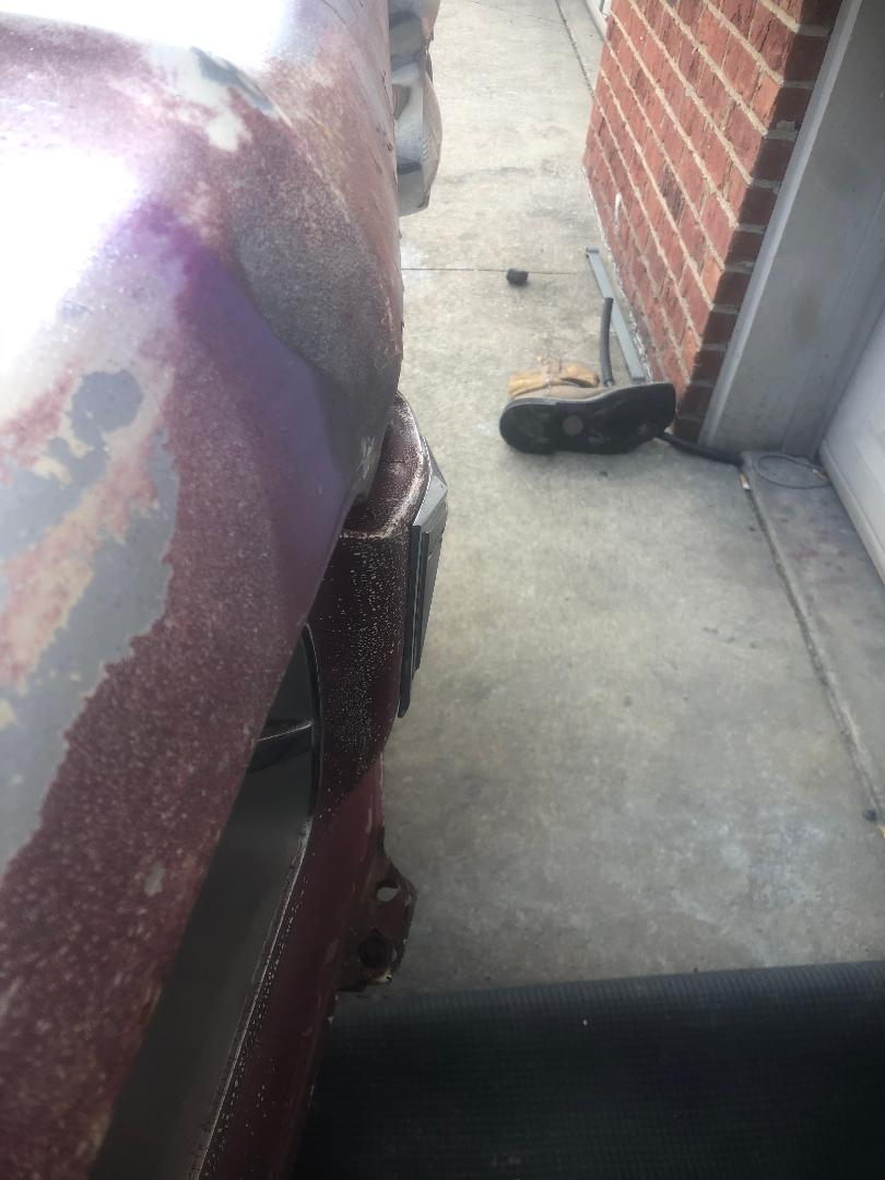

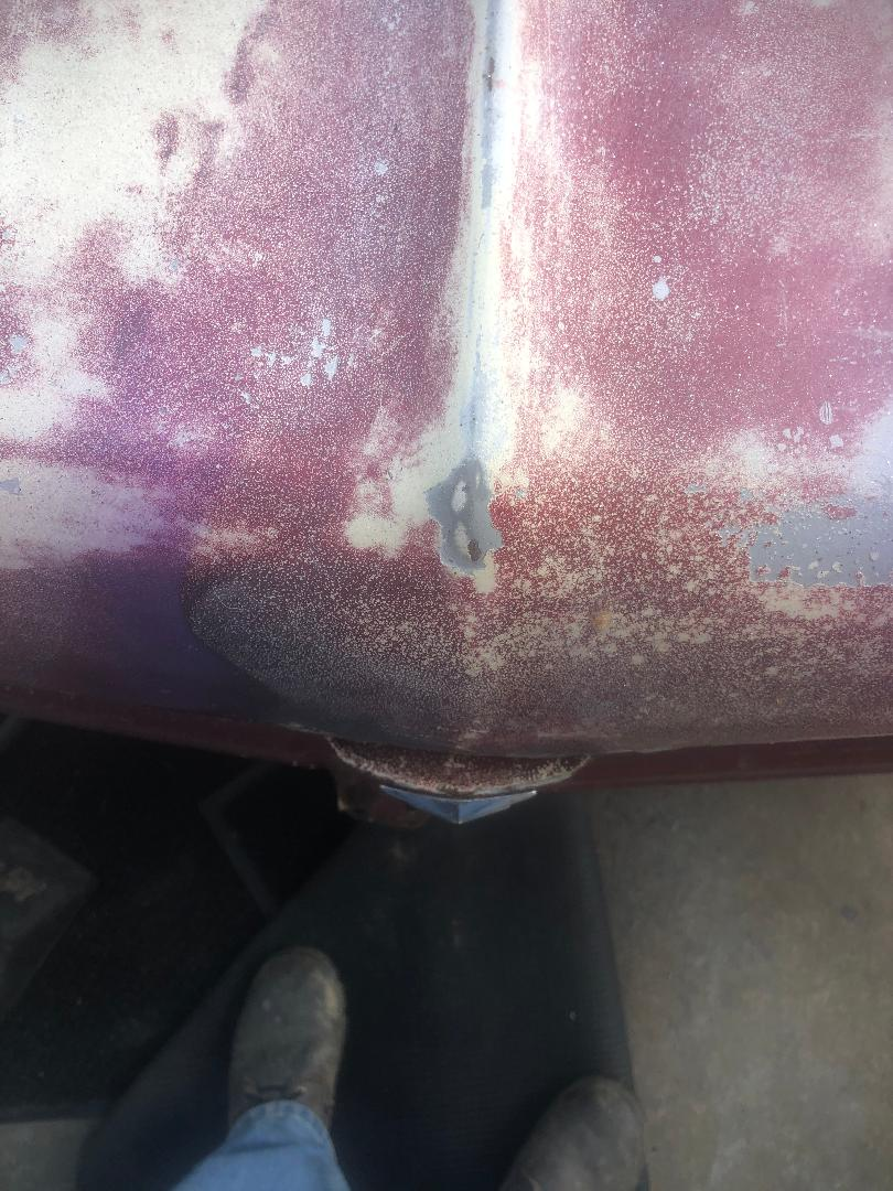

Yeah Kiwi, here's mine bro!
Wow that seems to be waaay off.
ok! and has it got a gap between it and the hood ?... my thought with my one is that its dropped down on the bracket thats holds the hood release hook.... i will take some pictures of what i am thinking is causing it mate and it may be the same with yours
