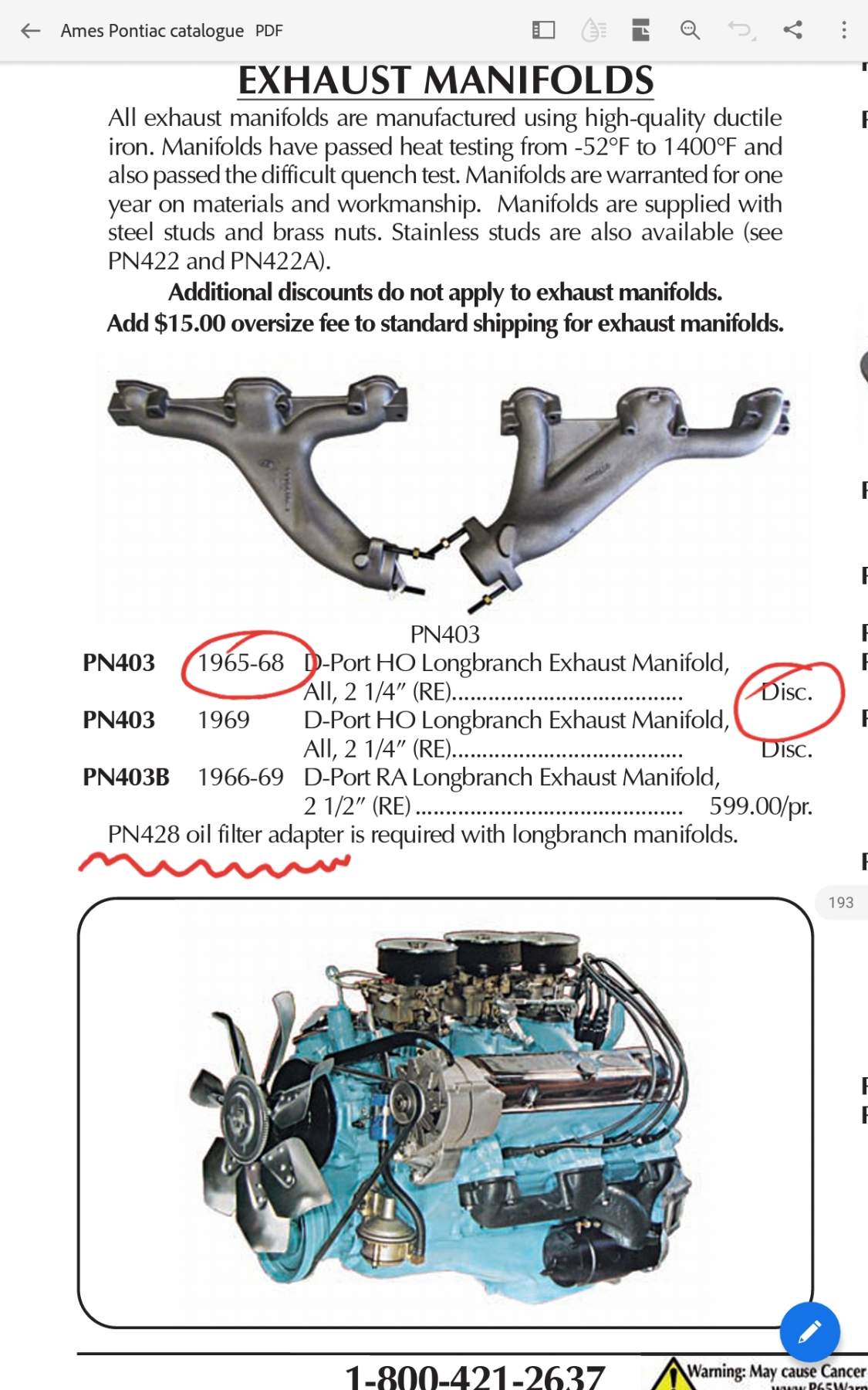

You know, Ames sometimes act as the manufacturer's agent so I can only assume that those headers you are chasing will be made by RAR but distributed by Ames. I got my Doug's headers through Ames because it was actually cheaper than any other method of purchase. I know I sound like a recurring advertisement for them, but I research all prices before committing and I've yet to find a cheaper alternative, plus they will ensure that what you order will actually fit. How's this: I needed tail light bulb holders. There are companies that specialise in nothing else but Ames were still better priced and the parts were exact. I have since installed them and now have tail lights, those cool looking US style flashing brake light indicators and brake lights. Yippee!
not sure they are made by the same co mate, see this comment...
https://www.ramairrestoration.com/catalog/product/gallery/id/173/image/353/
ok... so now i am getting a justA tad pist off. i have emailed, called (got an answer phone) and again tonight email ram air restorations ...
 all i want is a set of their cast iron headers and they are not communicating.. i will try and call again again tomorrow morning and if i get the answer Phone again. i am going to buy the ames headers.😡

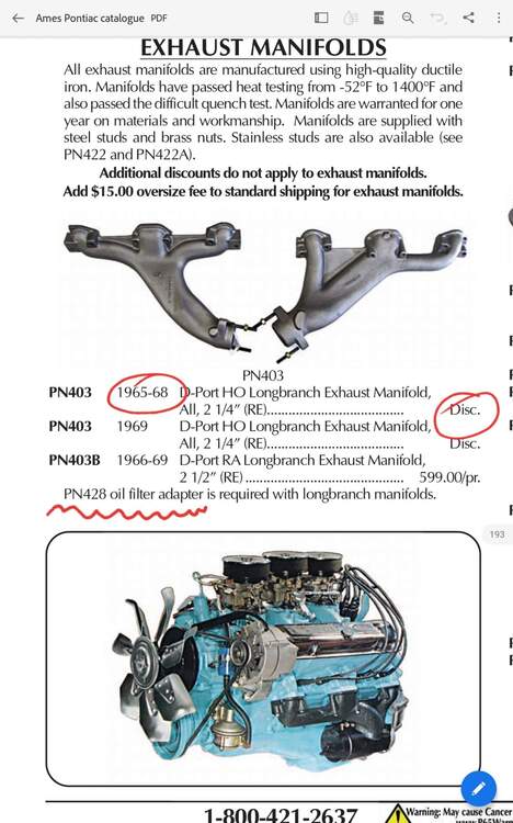

Hmm...good luck. See attached from Ames catalogue. I also checked the Doug's site but no mention of your car or mine! I went to your posted comment and that's fair enough - they make a good point, but I suppose you could always whip out the air grinder and talcum powder and port match them yourself. Come on, what else are you going to do with your life???
I must add that I got the same ignored treatment from every salvage yard that specialise in old cars - every single one across the US. Whatever, I'll go somewhere else.
yes mate and i got the same reaction looking for a chassis at the beginning of last year, not one got back to me, as if it was too hard. !
what i have is 2 very crappy log manifolds that i certainly cant use, one has 2 broken bolts and the other one broken bolt.
i will give it one last crack tomorrow and then i will be ringing ames...
what concerns me is they dont list a header for 64 , and i bet its because of the steering box clearance issues.

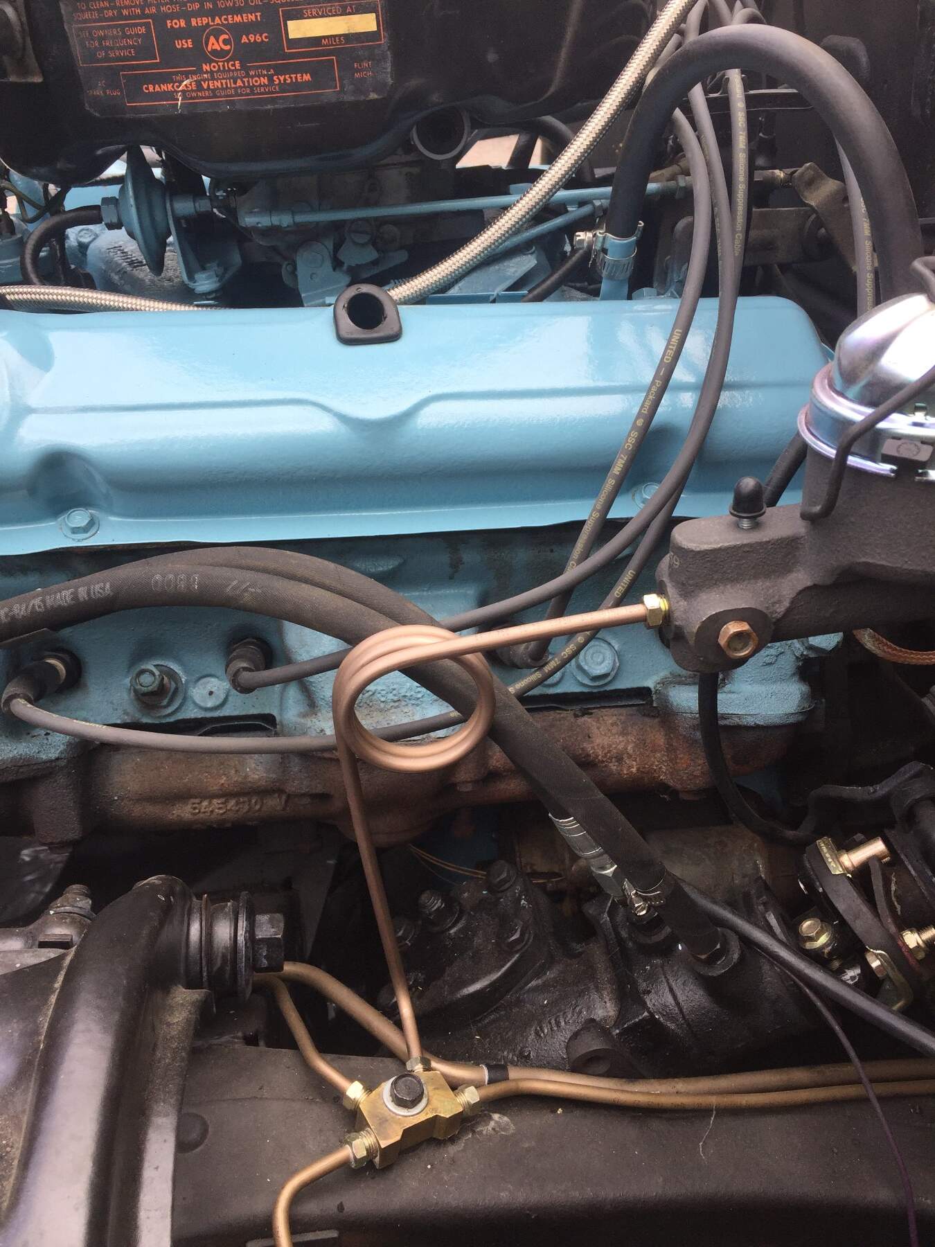

Finished work Sunday afternoon and had the best part of a whole hour free, so managed to make up the brake line from the master cylinder to the block junction
To be noted, that i haven't bent the brake tube as per the factory one as
with brake line rules here in nz there has to be a loop between the master cylinder and the chassis fixing point, which when you think about it is a good idea considering that the body and chassis are bolted together with rubber bushing so that they can move and this brake line will need to flex, which the factory item had no allowance for😀
i did plan to make up the Teflon fuel line from the pump to the carb, and found that i am short of a dash 6 a n  elbow for the top connection at the carb, you can see the braided hose justA under the air cleaner.
Nice loop ,did you just bend it by hand around a pipe or something? Don't need to have one here in CA nobody check's anything but like the look
you Will laff Andy, i hand bent it around a 24mm socket😜
Whatever it takes, looks good, think i will do something similar but i need two for my dual master.
Yes Andy, yeah do what you have to to make it work... thats the cool part about being a petrolhead ... we can think out side the square and make it work, this brake tube is really nice to work with, which helps no end :cheers:.
Pipes are my job, so automotive isnt to hard for me as a gas fitter... the difference is when i install copper tubes into a customers home or a business/ shop, they dont see what i do with my pipe art !... and they dont really care as long as the fire/ heater, works ! hahaha ... gas fitting..... the un- loved trade !! :rofl: oh i know!
