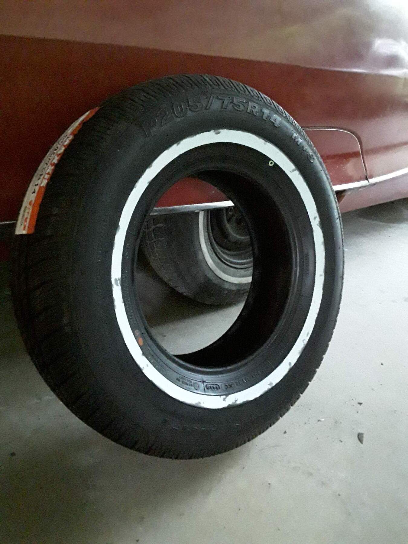

Oh...better stay on topic...New whitewall tyres: nothing flash, but will look nice once mounted on the Torqs. I was sure to buy tyres with the correct whitewall height. You know how whitewall height differed thru the years? Well, about an inch high is considered appropriate for the mid 60s. I took a pic of THIS tyre, because of the obvious scuff marks on the white portion. I scrubbed it with Autosol chrome polish and finished it with extra cut & polish. You're looking at it pre treatment - looks much better now.20210301_115540.thumb.jpg.fa9ca61b405137e0f971bf97b29fbf4c.jpg

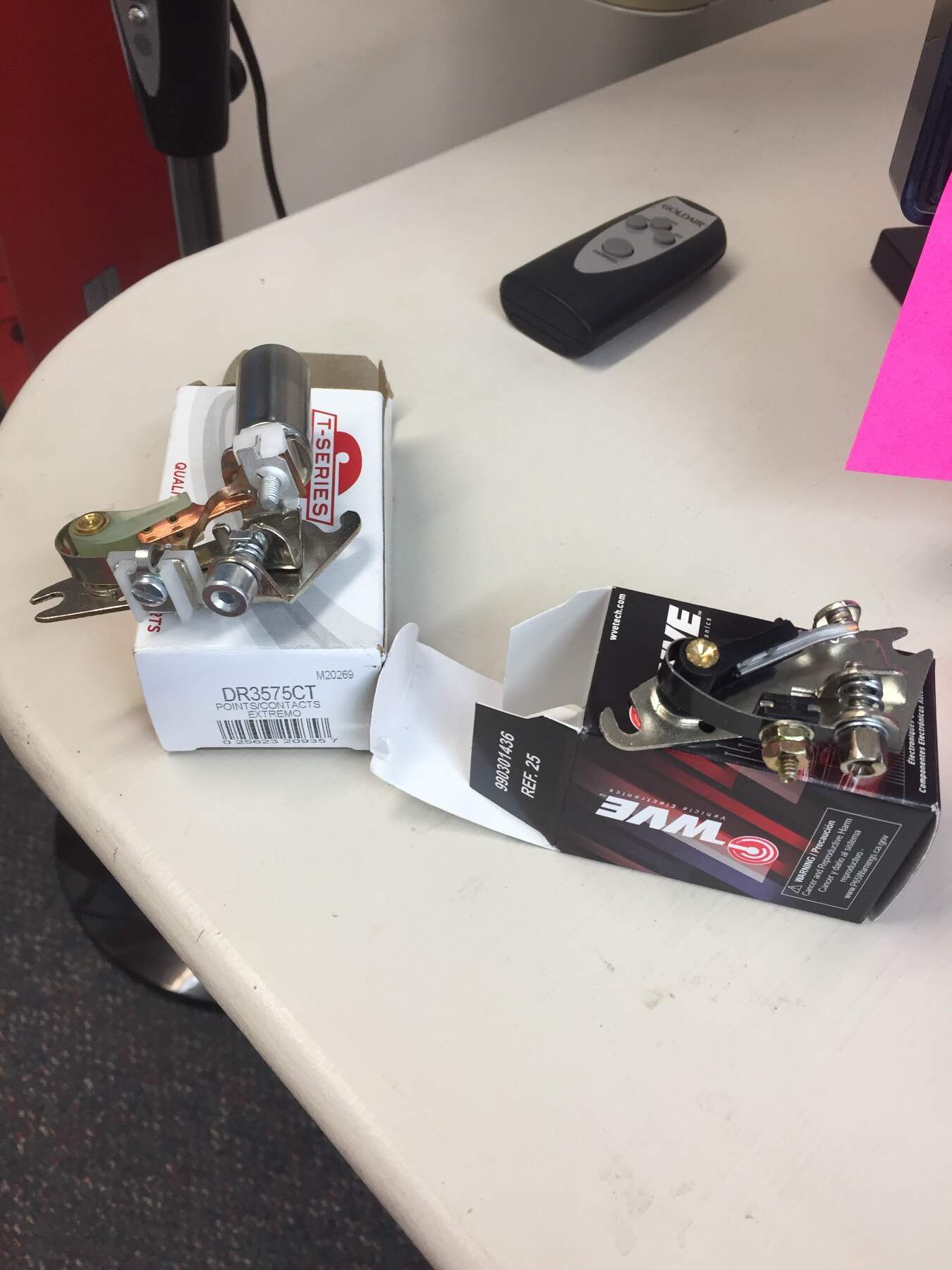

Dumb arse guide to buying points off rock auto, check what you have BEFORE you order them ! ahhaha:rofl:
Ā so i had jumped on rock auto and ordered points for my stock 64 bonni dizzy, and didnt even look at what i had.. i assumed !!Ā
Bad move, attached is pictures.... the points i needed have the condenser attached!Ā wtf, i am a Pontiac virginĀ šŸ™„... i am learning as i go along... ( and enjoying it too šŸ‘)Ā
Back in the day, the points and condenser were separate items and not physically attached to each other. You had to mount them and attach the lead from the condenser to the points.

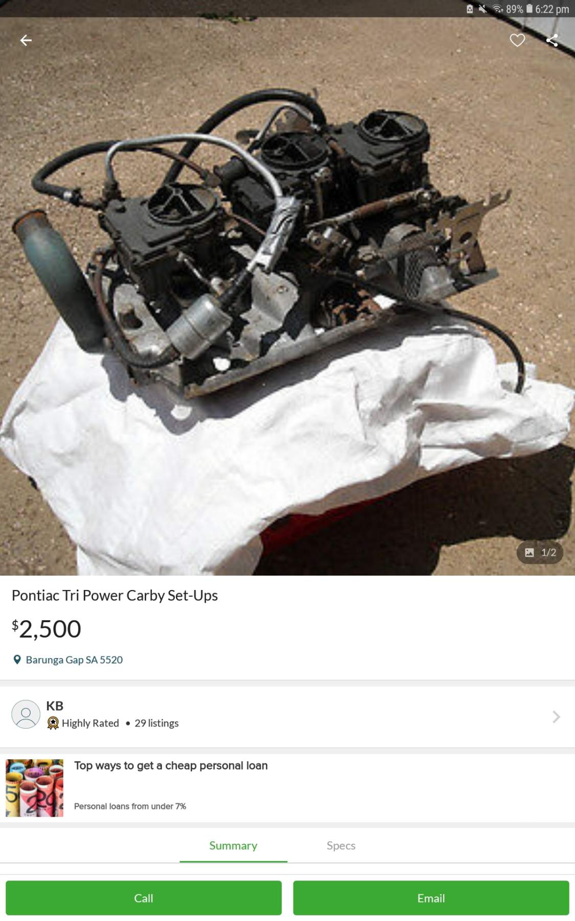

what do you guys think of this triple carb set up, is it worth thinking about for the 389 ?
https://www.trademe.co.nz/a/motors/car-parts-accessories/performance/carburation-induction/listing/3004279378?bof=gT3vCrOV
It's definitely an awesome piece. A set-up like that can runĀ close to $2k USD. So it's definitely Pontiac eye candy pure and simply. If you got the wallet for it, I'd say go for it. Just be prepared to justify your actions to the missus.
The biggest trick is keeping all three carbs properly tuned. Justa as tri-power set-up on his 421.

It's a complete tri-power set-up for $950. Only thing that appears to be missing is it isn't painted Pontiac blue.

Yep. All there.Ā  Vac lines for brake booster on linkage side.Ā  PCV and distributor vac lines, and the choke tubes look ok on the other side.Ā  Fuel lines are all intactĀ too.Ā  Whats missing is the trans bracket that allows you to hook up the trans kick down and throttle linkage.Ā  I had a very hard time finding one.Ā  Ended up using a throttle bracket and welding up what I needed for the trans.Ā  Frosty is right, that set up would be around the $2000 mark here.Ā  But as always, it's only worth what someone's willing to pay for it. Looks like only 1 bidder so the price war has not begun.Ā  I would watch it and maybe bid at the end.Ā  Ā All that said....Been driving the GTO for may years and still can't work out the BOG when the outside carbs kick in.Ā  Have tried everything.Ā  Ā I can feather it past the bog, but can't JUSTA stomp it to the floor.

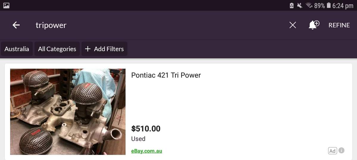

Kiwi, have a look at the Ames catalogue - downloadable if you don't already have it.Ā There's an entire section devoted to tri power setups. Personally, I can't be arsed fiddling with multiple carbs - one is plenty. AND I think it was 1968 or thereabouts when GM made the decision to no longer offer them, having made more power with a Rochester albeit on a larger motor, but for sheer presence and as eye candy, they look shit hot.

I just found these, if it helps...

OMG.. This is great.:lol2:Ā  Ā Check out what he is using for the throttle cable bracket.Ā  A plug wire loom.Ā :slap:
That fuel line plumbing is NOT factory and completely F'd up.Ā  Good way to burn down your pride N joy.Ā  The themostate housing appears wrong as well, facing the wrong direction.Ā  Most Pontiac have upper hose to the right side of the radiator.Ā Ā RUN, don't walk away from this one esp at that price.

This is NOT rocket science and should NOT be intimidating.Ā  It's 3 Rochester 2 barrels.Ā  As basic as it gets.Ā  The entire system runs off the middle carb.Ā  This has the normal adjusting screws.Ā  Be it right or wrong, I was always taught working with my Dad N Grandpa the best way to tune a carb is to hook up a vacume gauge and adjust the carb to the highest vacume you can make.Ā  Start with the left side adjusting screw. All the way in.Ā  Back it out 1 1/2 turns.Ā  Now go out until the engine revs higher and vac raises.Ā  Might have to go in to raise RPMs N vacume.Ā  Now follow same instructions on the right adjusting screw. Finish with idle RPM screw to usually 800 RPM.Ā  Some adjust idle with an automatic trans in gear.Ā  I always adjust in park/neutral.Ā  When in gear RPM will then drop to 6-700RPM at idle.Ā Ā Ā Your now adjusted to run the car on the middle 2 barrel from idle to full throttle.
Now, wanna give er a kick?Ā  Ā Let add 2 more carbs.Ā  These are non adjustable. They don't have adjustment screws.Ā  I'm sure you could re-jet, but why? Bigger cam, higher compression might be the only reason. It's set up to run like a 4 bbl, past 1/2 throttle they kick in depending on where adjusted. Just like changing the spring rate in a 4bbl.Ā Ā Ā Look at the pic's from the setup your lookin to buy Kiwi.Ā  Throttle linkage for outside carbs is on the choke side with a solid connecting rod.Ā  You open the butterflies wide open and bend the rod up or down til both carbs open exactly the same.Ā  Never need to mess with this again.Ā  Now open full throttle and make sure your getting gas from both outside carbs as you would with a normal 4 bbl.Ā  They both have normal floats, experience normal carb probs with floats sticking open or closed.Ā  If your smoking out the exhaust, check to see if one or both outside carbs are leaking/dumping gas before they are suppose to kick in.Ā  The tri power set up is top of the line cool and you paid extra for it back in the day.Ā  Alot of flash and intimidation for those that are unfamiliar with multiple carbs.Ā  There is no constant adjusting to keep them in sinc like alot of multiple carb setups.Ā  At what RPM do you want them to kick in is the biggest decision you have to make.Ā  EYE CANDY like the rest ofĀ hard to find option makes your car that much cooler.Ā  Up to you.Ā  I added the console and HIS/HERS shifter to my 66 because I've always thought it was sooo damn cool.Ā  It didn't come out in the GTO til 67 for the purest.Ā  These are the same people that can read your Vin plate and know what everything means.Ā  They walk away shakin their heads that the car didn't come with Tri Power. Much respect to these guys, but Cmon.

Still need to hook up your throttle cable, but you could use the one off your intake.Ā  Appears to be factory air cleaners.Ā  These are very expensive.Ā  I have cheap ones that came with my motor.Ā  I would check these out further.Ā  Looks like you have a good setup there to bid on buddy!
