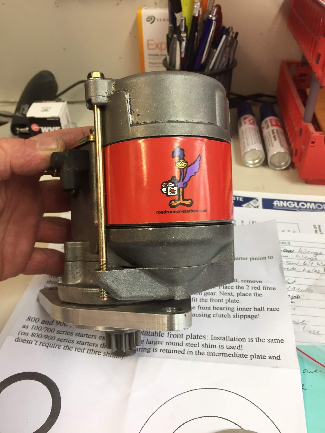

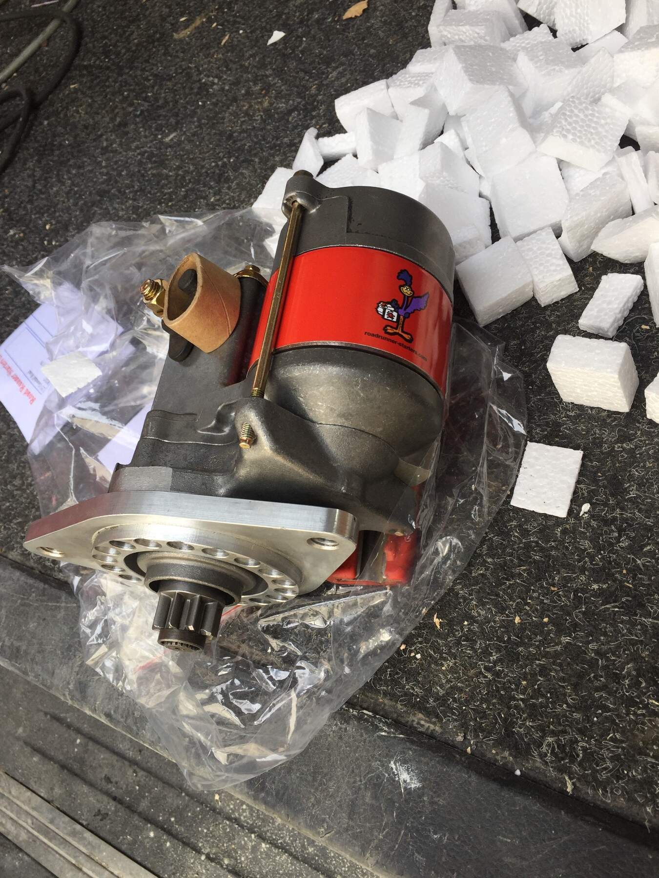

my little present too myself arrived today !!!!
Fitzy, this is a road runner starter made here in nz
the motor is a USA made denso unit and the front mounting plate is a USA patterned item
and it is wayyyy smaller than the stock unit
so I expect that once I get my headers there will be no clearance issues and I should have many happy years of starting :dancingpontiac:
I'll keep that in mind, too. I'm hoping my own Doug's headers will fit around the stock starter. If not, I'll get some details from you.

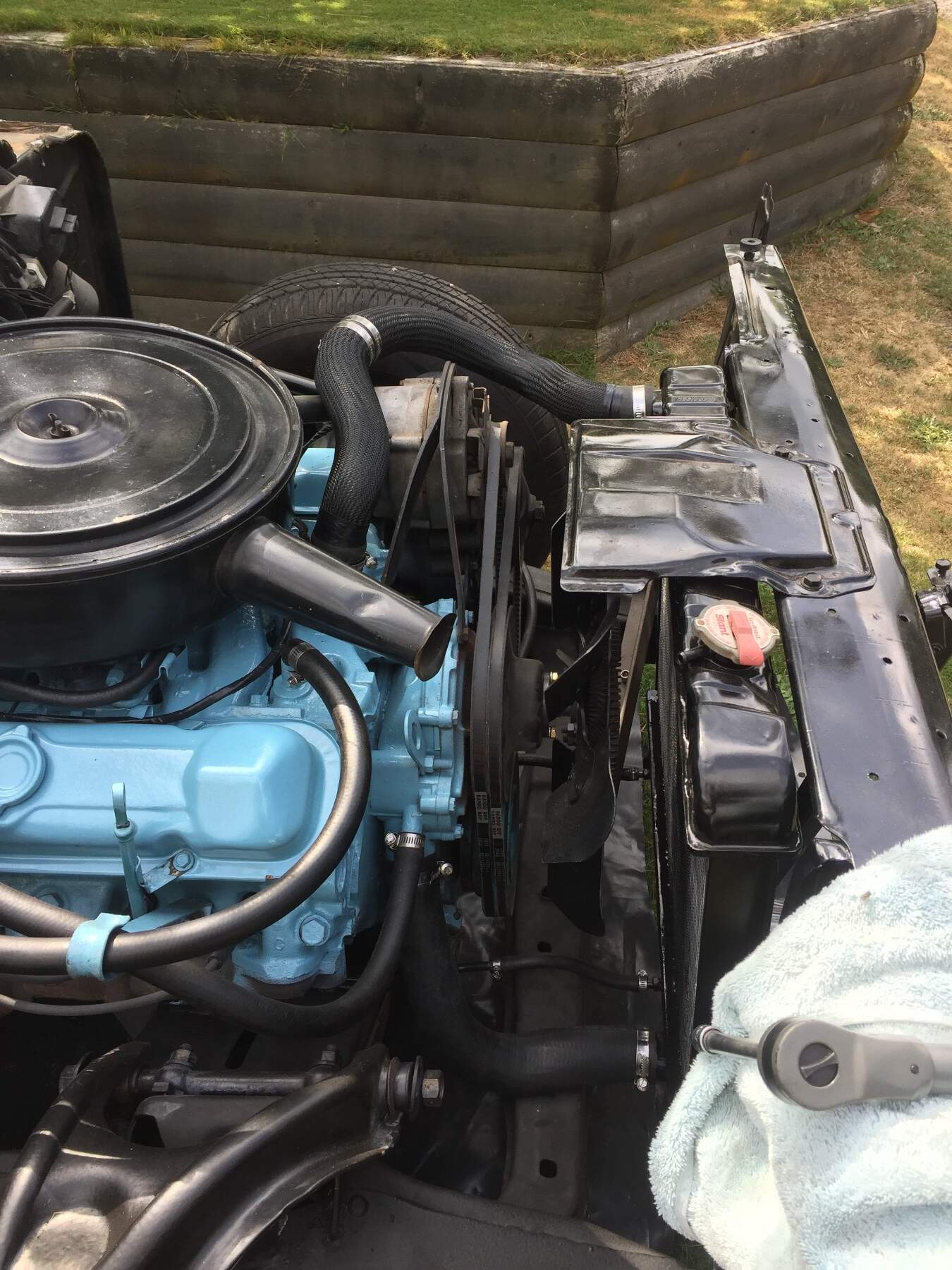

Didn’t get much done this weekend
was away with the club on a run
but did get rad hoses fitted I wasn’t happy with the top hose passing over the top of the power steering pump, you couldn’t get to the cap easily
So I have made a custom hose that goes around it:dancingpontiac:
And a new set of fan belts, wacked in the new air cleaner.... all nice easy stuff considering i aint feeling that flash this sunday, some of the boys in my club are pita. :stars:

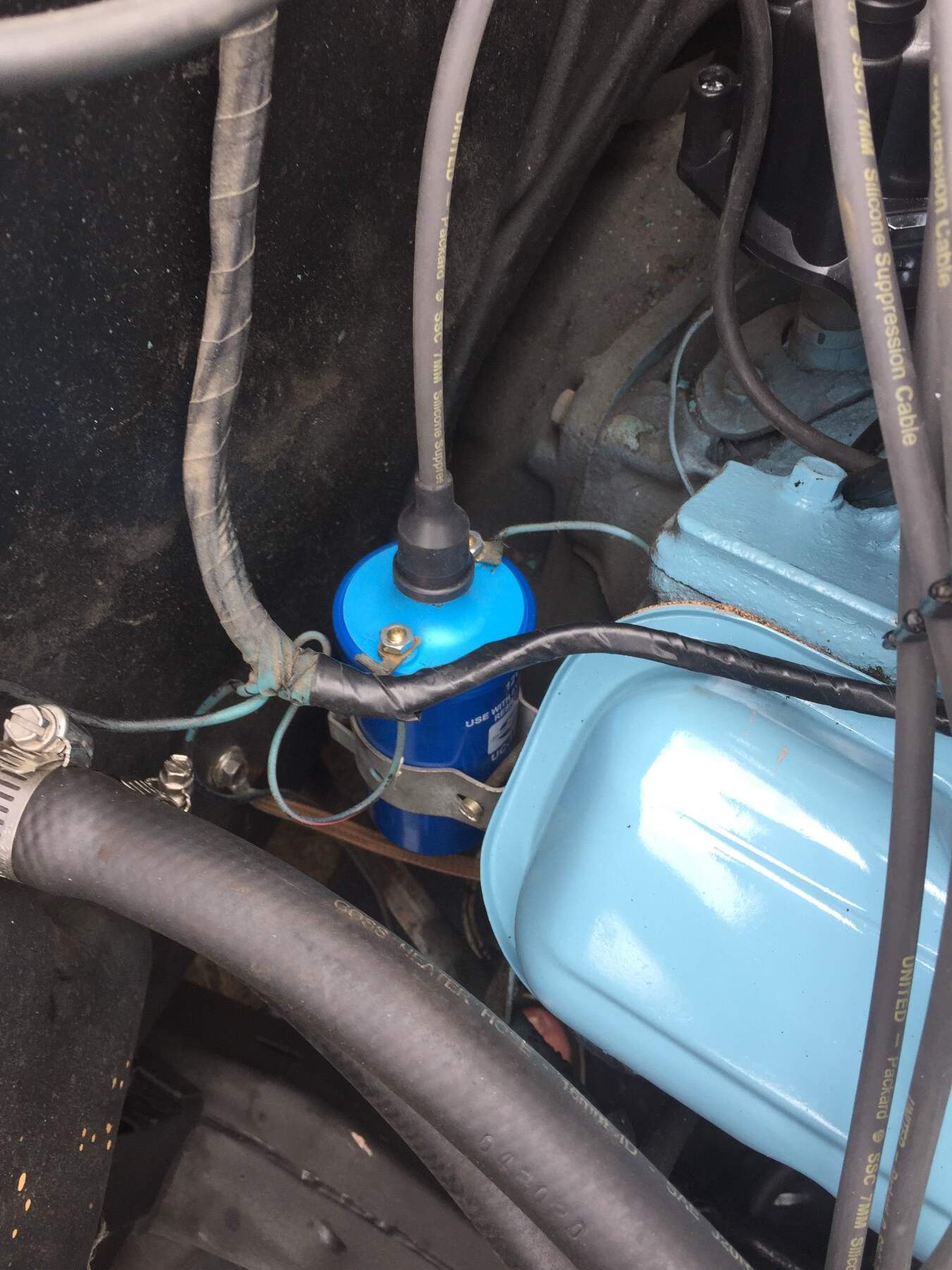

New blue coil installed
and I can now fill the cooling system

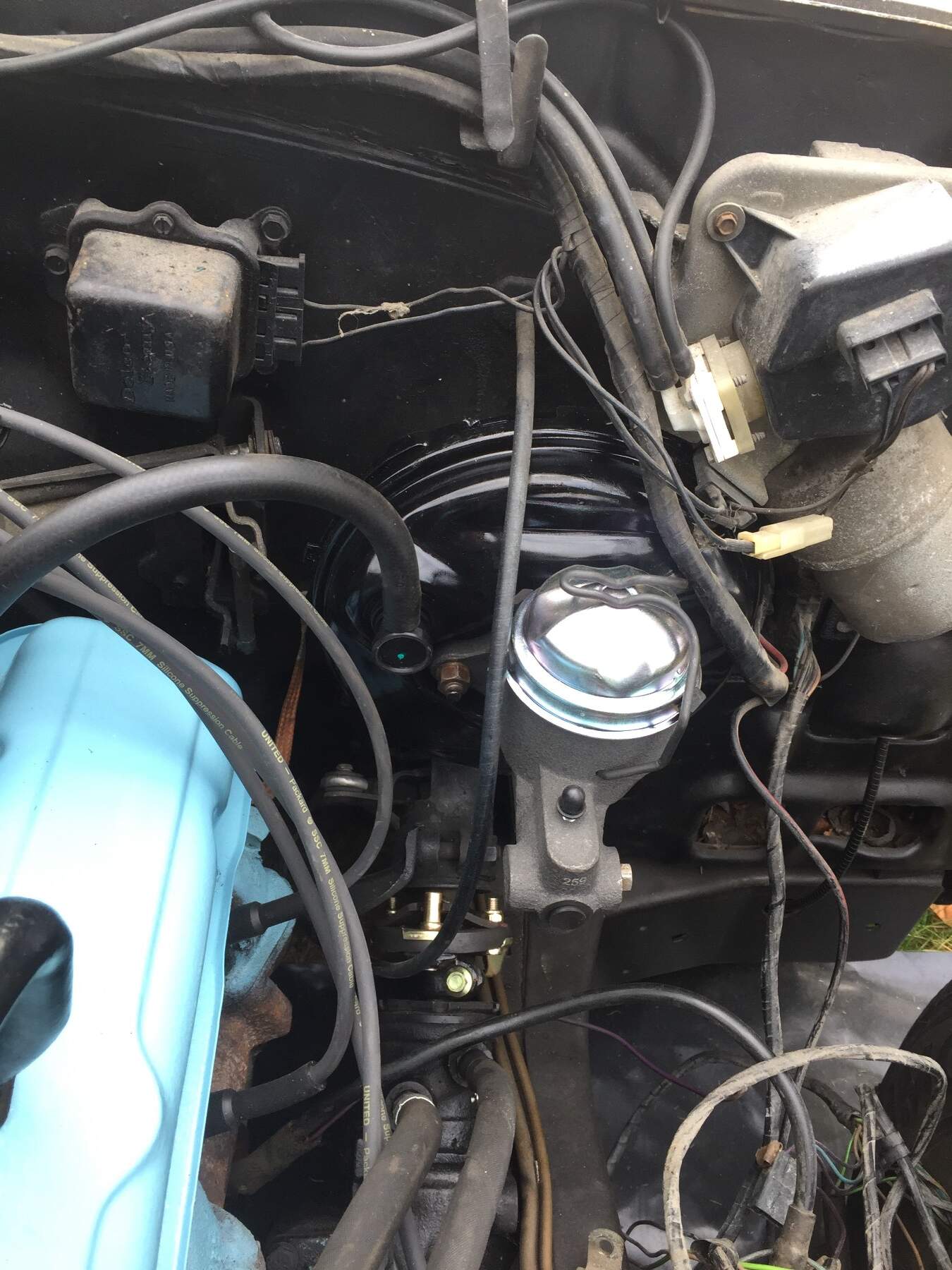

The rebuild power brake unit went on
and the master cylinder !

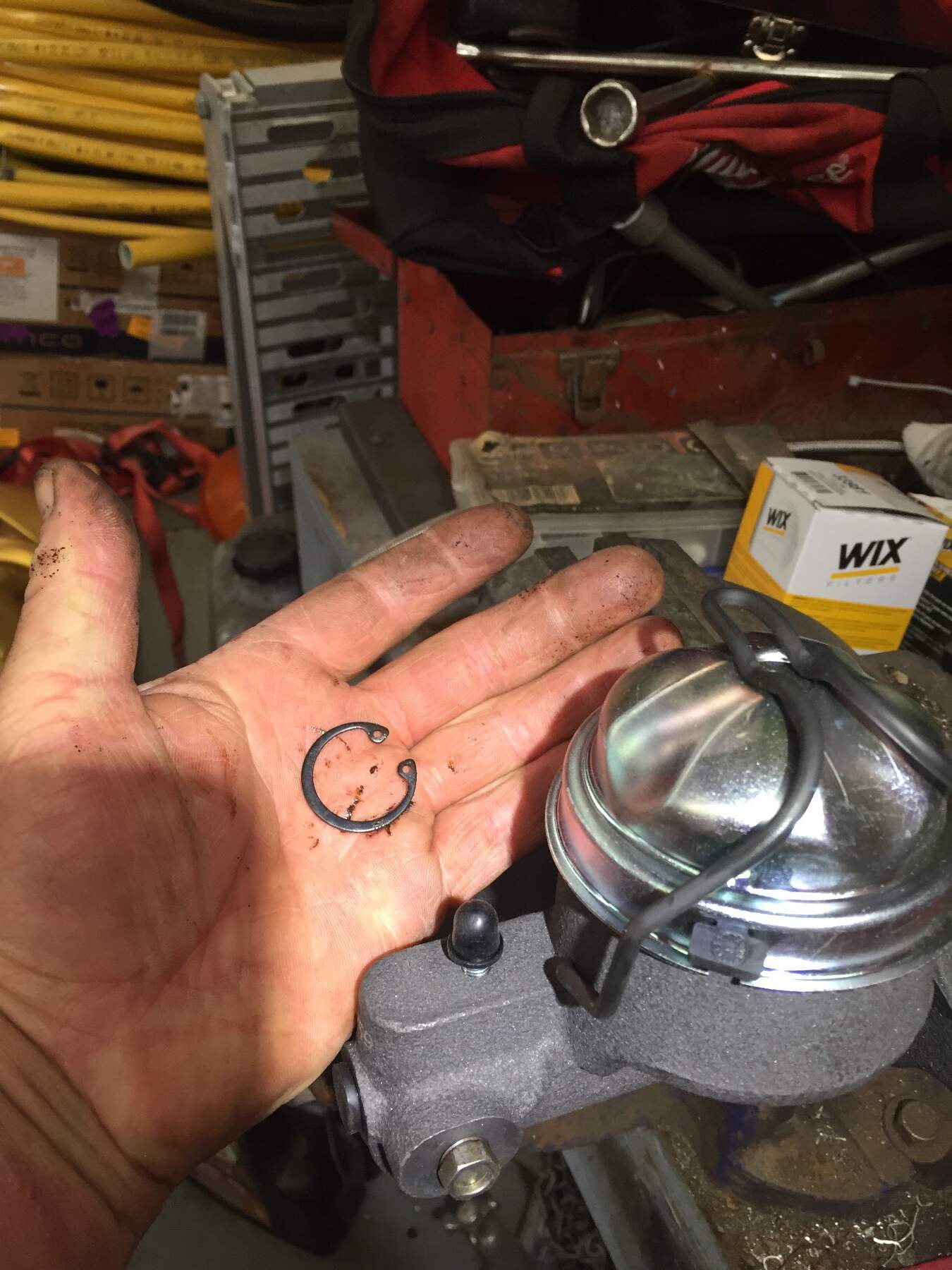

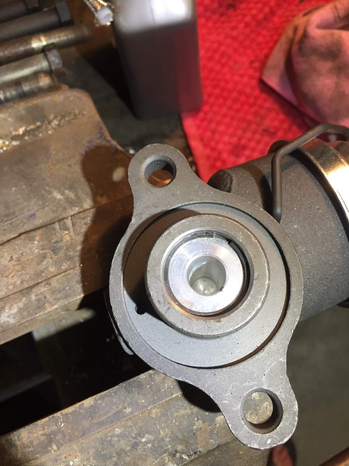

But watch for the aftermarket master cylinders with the eyelet circlip, I was warned it needs to be replaced with the plain end circlip, as you can see here in the pictures , as  the eyelet one will cut the front seal on the booster !!

Kiwi, I gotta ask: did you have the master cylinder rebuilt simply for peace of mind or was it in poor shape? My own car came from the States with brand new shoes (asbestos requirement-old shoes had to be disposed of and asbestos free ones fitted before arrival in Oz) and after I adjusted & flushed & bled the system, they are really good. Of course, it bothers me that 2 tonnes of iron & steel is dependant on drum brakes through a single system, in other words if they go to lunch, I'm supposed to rely on the parking brake to pull me up! I'm thinking that the very least I should do is sort the master cylinder and flex hoses.
You could probably retrofit a dual braking system (not just the dual master cylinder) but it sounds like a complex solution. Maybe I'll just keep a little extra distance between me and the crushable modern car in front of me and keep a St Christopher (patron saint of travellers) figurine on the dash.
Fitzy , it’s for my own peace of mind, to go through the whole brake system really isn’t expensive , so I justA went “what the hell” do it !
The master cylinder was cheap , the 3 brake hoses in Teflon where expensive , but for drum brakes that will get hot , the Teflon hoses will not expand with heat .
And I did all the steel lines as I had the body off and it was really easy , and the tube was cheap too, once I fit the new slave cylinders and mill the drums, have the shoes rebuilt , I know my system is 100% and it will pass compliance when I go to road register her too 🍻
