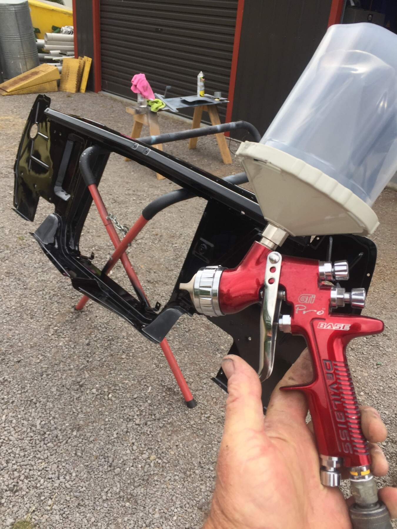

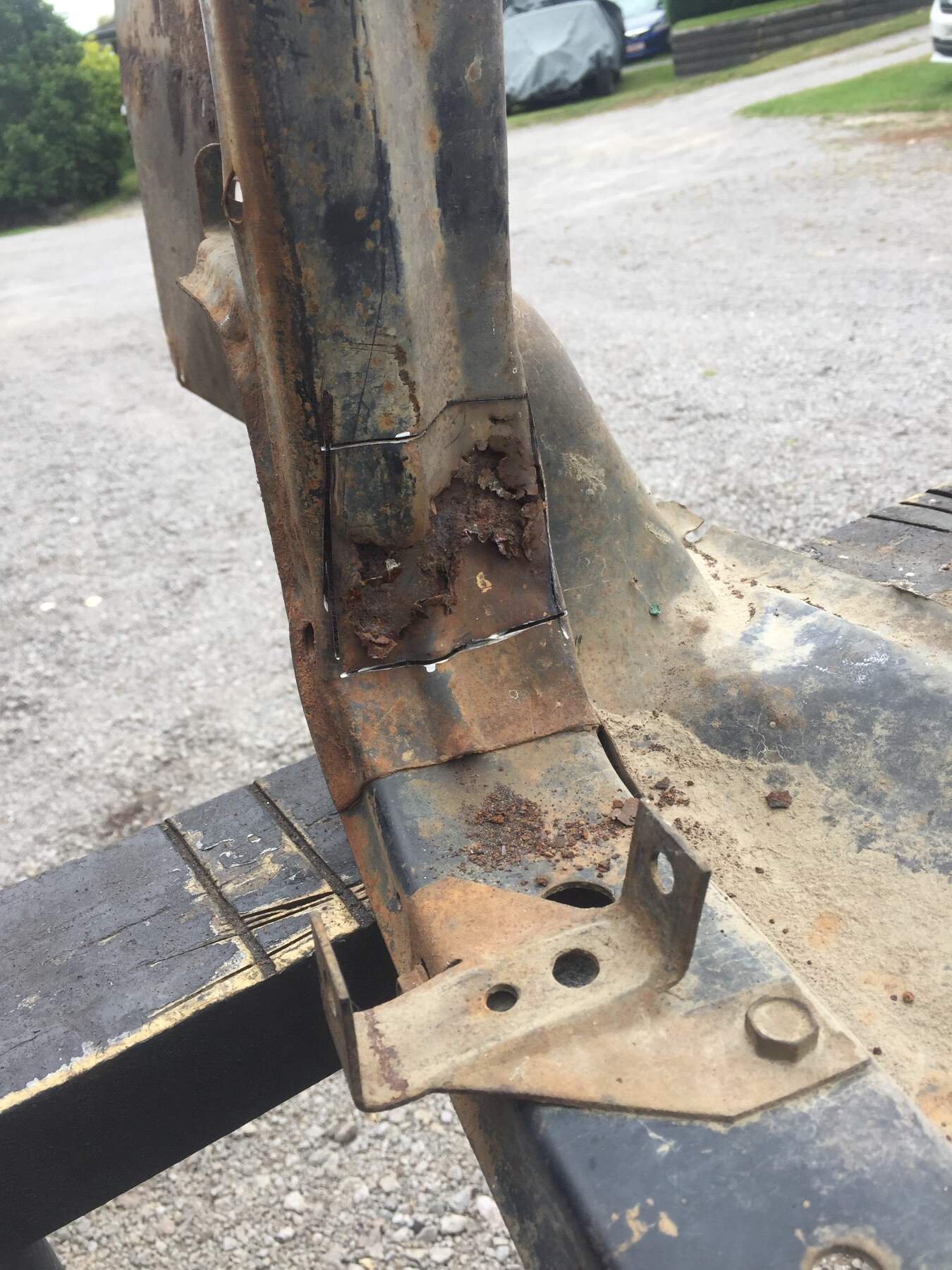

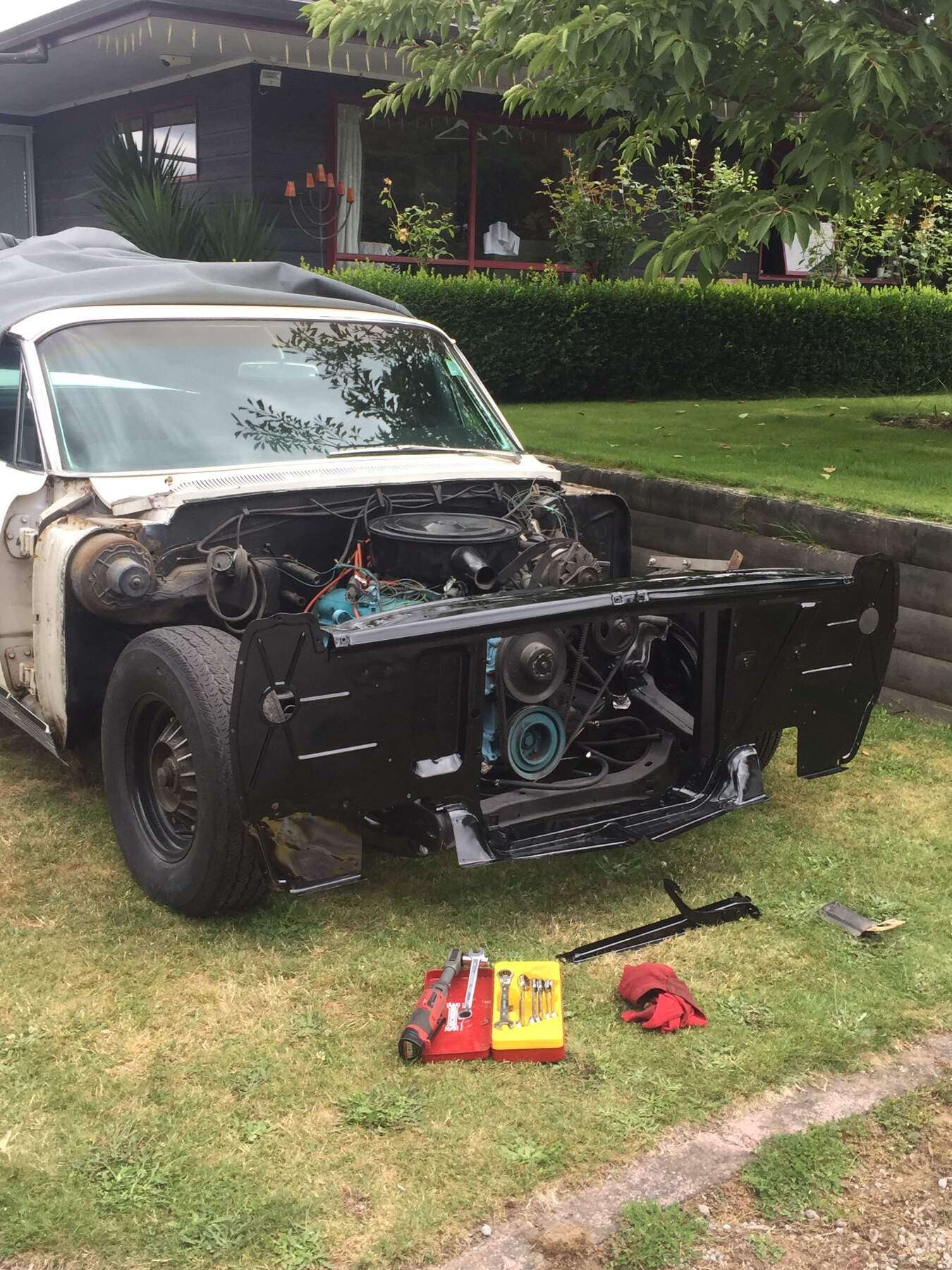

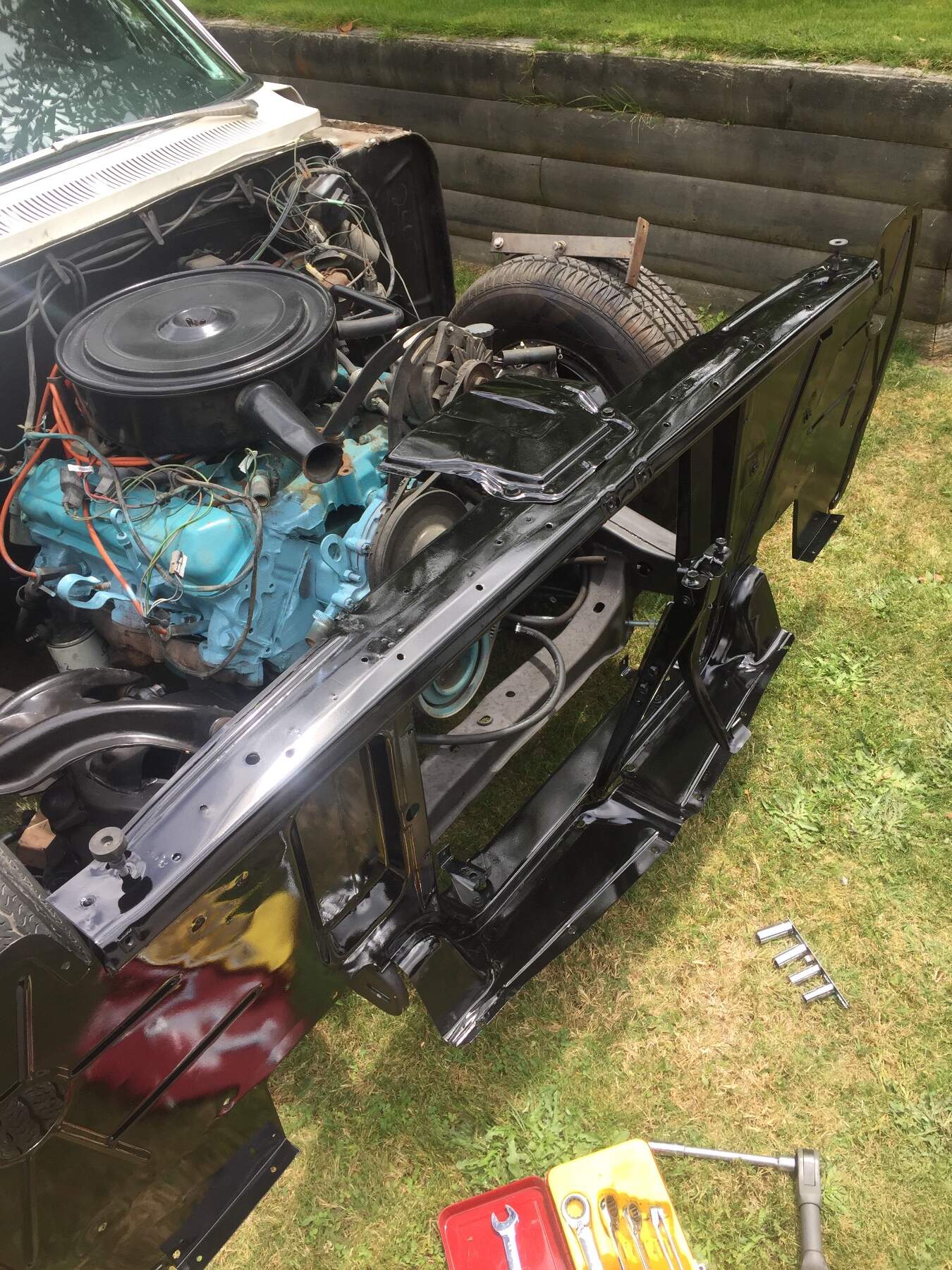

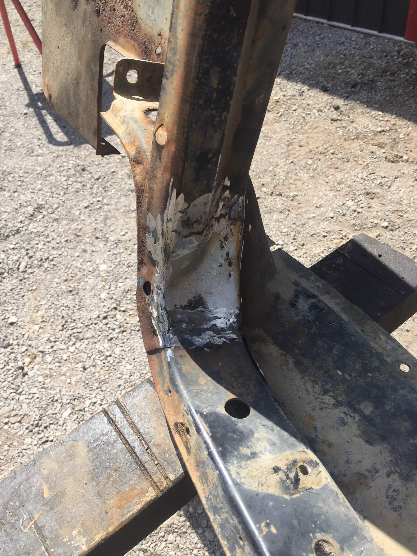

The radiator support cross member that i have as a replacement had one spot of rust to cut out, so in with a patch, and i sand blasted the whole thing and painted it with my new devilbiss gun that i bought like 4 years ago and have never used!!πŸ™„Β what i dream to use compared to my cheap one i have been using for the last 30 years !!...hind site tells me i should have bought one long ago!:)7E307732-95F9-460F-B5B4-15014F1B459D.jpeg
I painted it in enamel and stain black, very happy with the results, justA lots of sandingΒ cleaning and prep, but worth it as you can see, and as i go along i am justA wire buffing all my bolts and painting them black with a quick drying enamel also in satin black. she is never going to be a show car, but will be nice and clean.:cheers:Β 7B0E58F6-AFEB-4B95-BBAC-8C57DA4475C4.jpeg

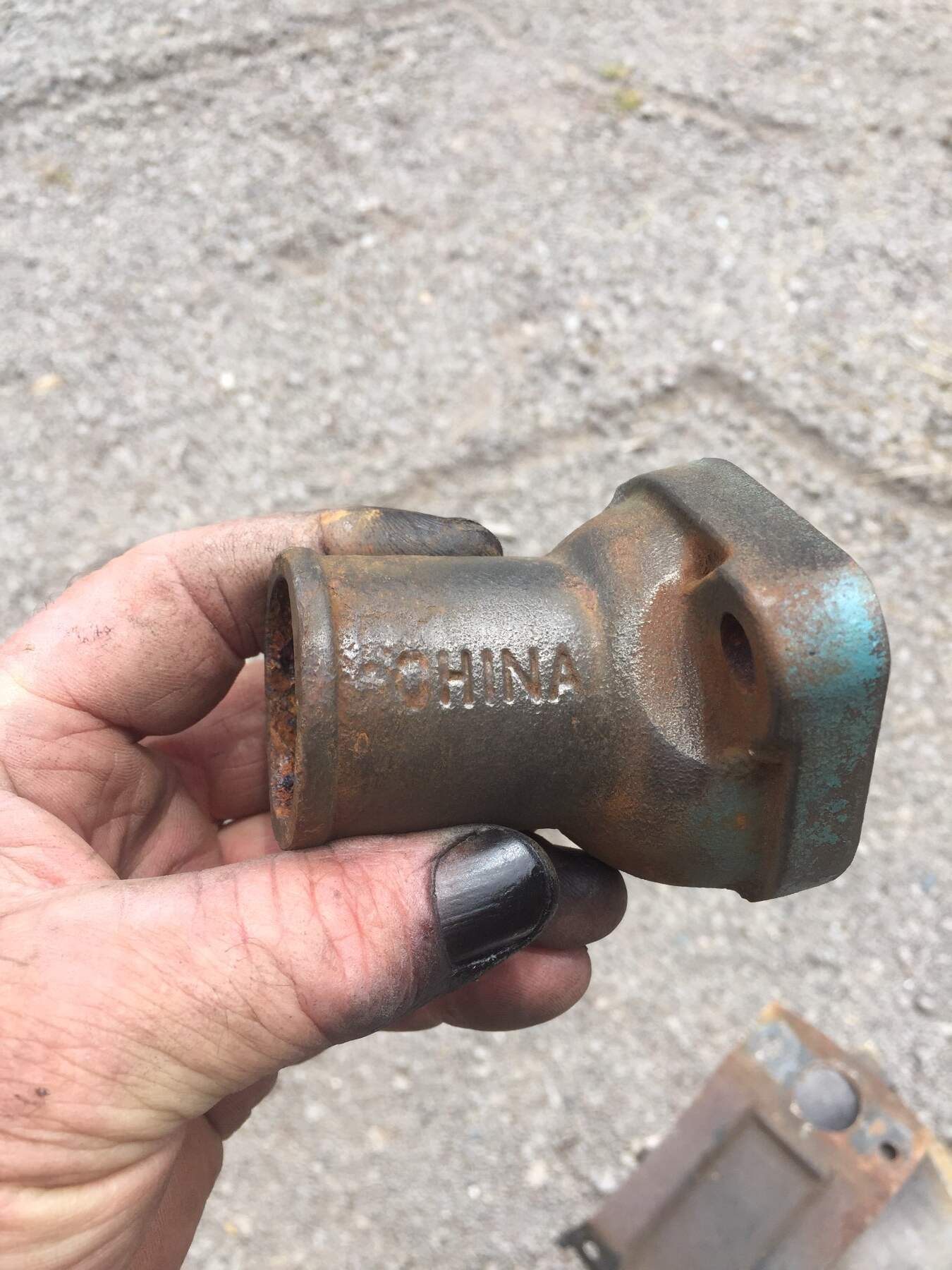

The thermostat housing was staring at me and i knew i was always going to pull the thermostat and replace it, so off it came and i hit it with the wire buff to find a wtf moment !...surely in 1964 the housing was not made in china???.
Any way it got buffed, sand blasted and painted ready for a new thermostatΒ πŸ‘CDE4DB99-8401-4F9E-B4CC-37DC7C6DFB23.jpeg

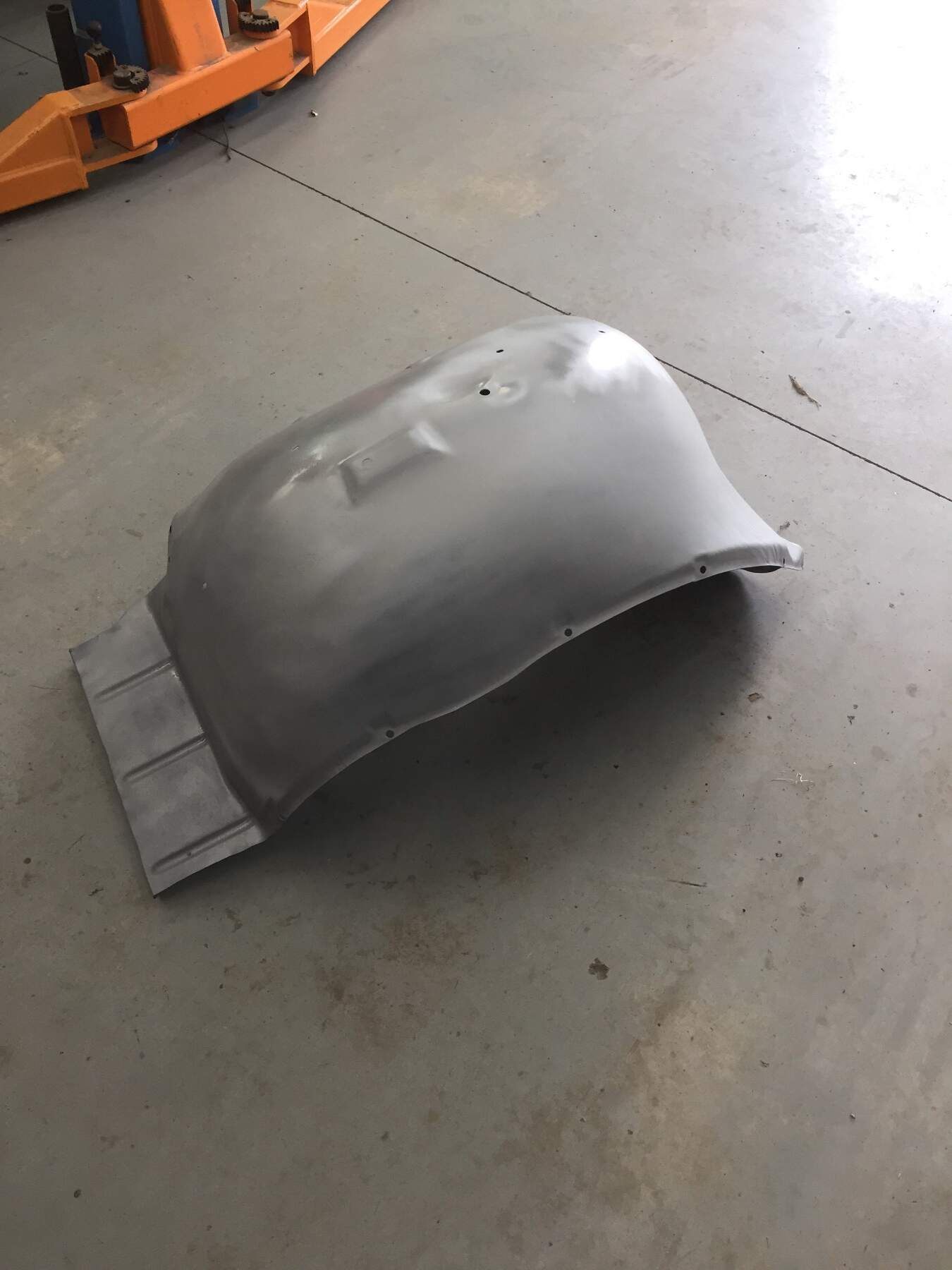

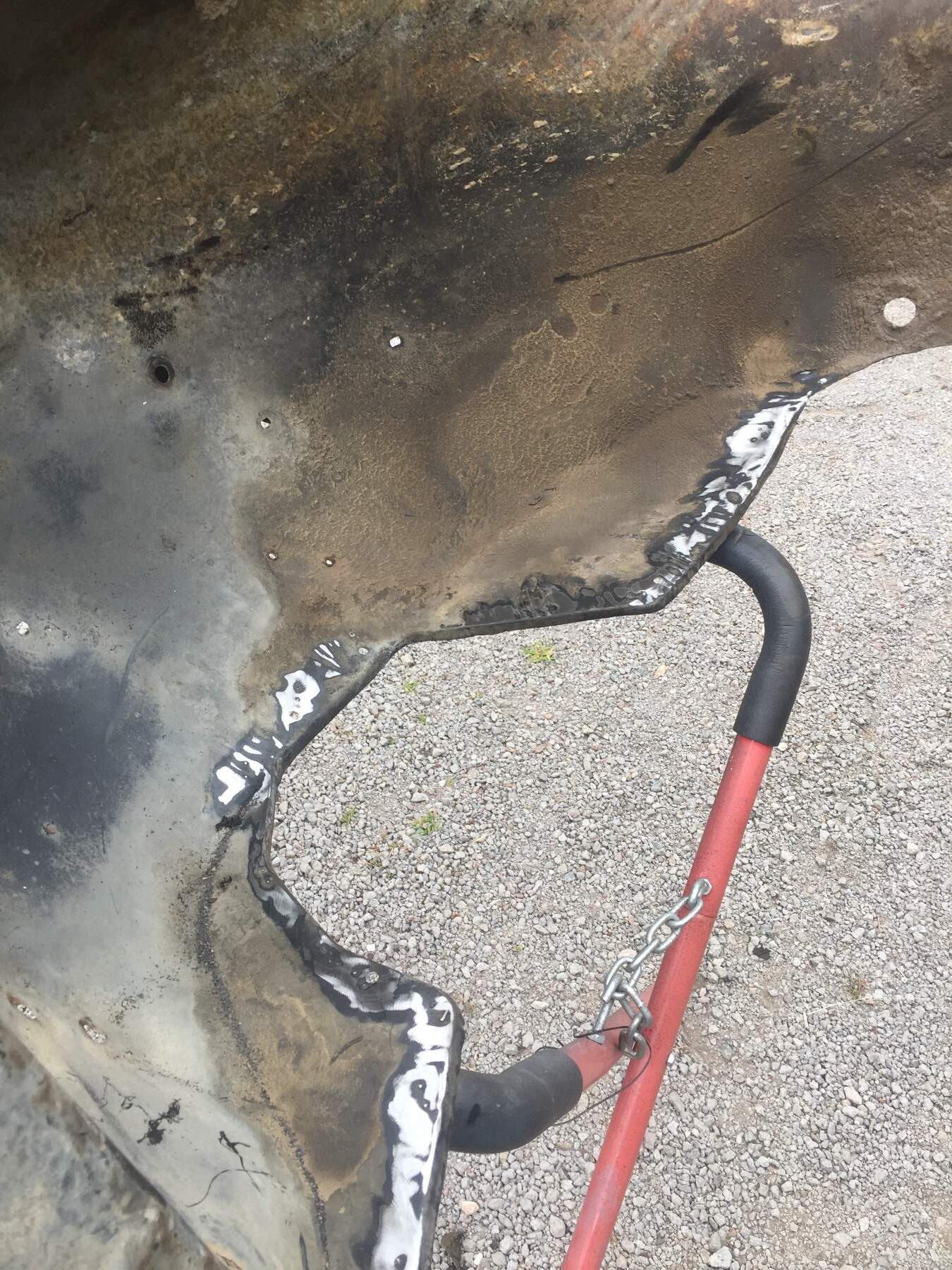

Next mission was to pull the inner guard off the driver side fender and sand off the staples holding what is left of the dust flaps, not sure what to do about replacing them, has anyone done this or do i justA leave them off ?????πŸ™„
Got this one buffed and sand blasted out side before it started to rain !!😑.......oh look C26B4807-5F8A-40CA-8908-BC41D864BCE3.jpeg

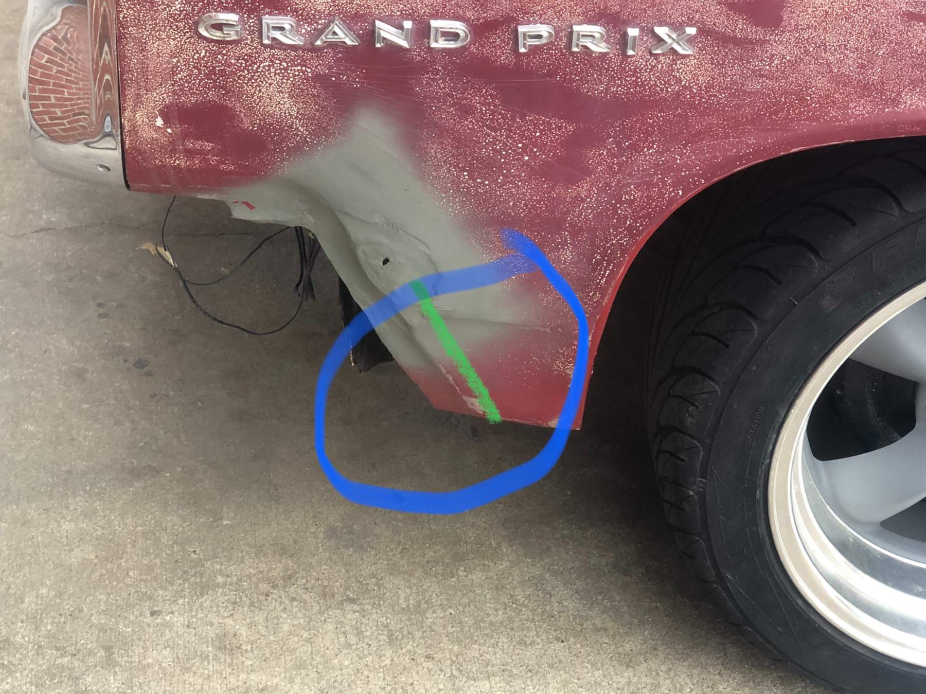

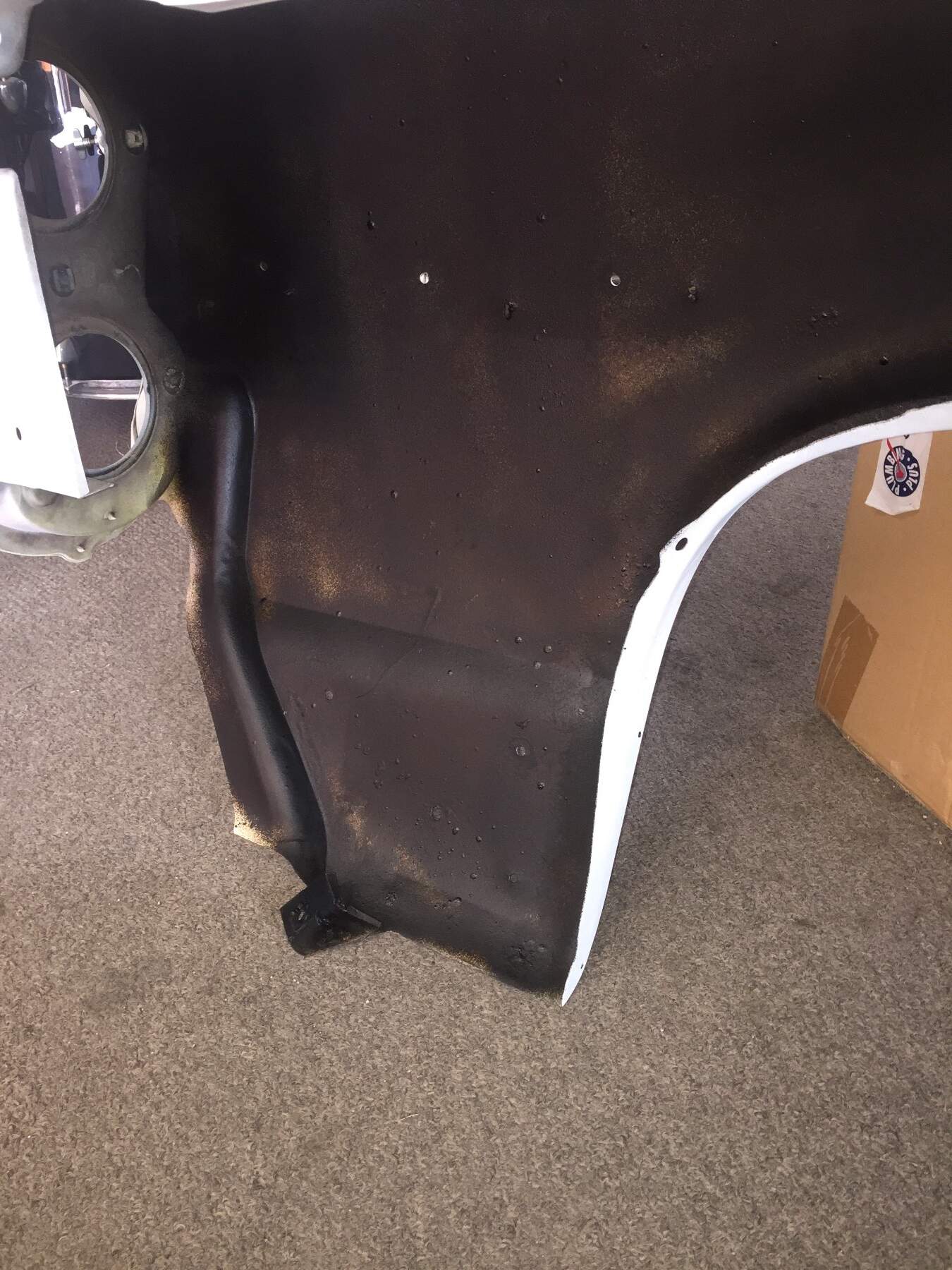

Oh, by the way bud, when you start putting your panels on or just have them out messing with them would you mind posting a picture of both fenders. In particular the front, lower portion between the wheel opening andΒ the bumper section. No rush Justa whenever. Thanks bro
32 minutes ago, Wrongway said:
My brake cable runs under my cross member bro. But I'm honestly not sure if that's how the factory did it. So much was changed on this car by the time I got her. For example, when they put the 428/400 in. It looks like it had a slim Jim trans from the factory. The trans tunnel wasn't wide enough so the 400 turbo was actually touching the floor, like pushed up tight. The drive shaft was pushed all of the way up into the trans with no wiggle room, again pushed in tight like it was wedged in between the trans and rear end yoke. The trans had a 4x6 (guessing on the exact size) piece of thick steel bolted to it and that was welded to the trans mount, no rubber. Once I got engine and trans out I spent over an hour beating the trans mount out with a BFH, it to was wedged into place. But yes, the brake cable was under the trans cross memberΒ and still is bro.Β
Thanks Wrong way, thats the path i was thinking they ran but justA wasn't 100% sure,πŸ‘
Will do Mate, both are justA sitting here, i will get some picturesΒ of the inside of each and post themΒ πŸ‘

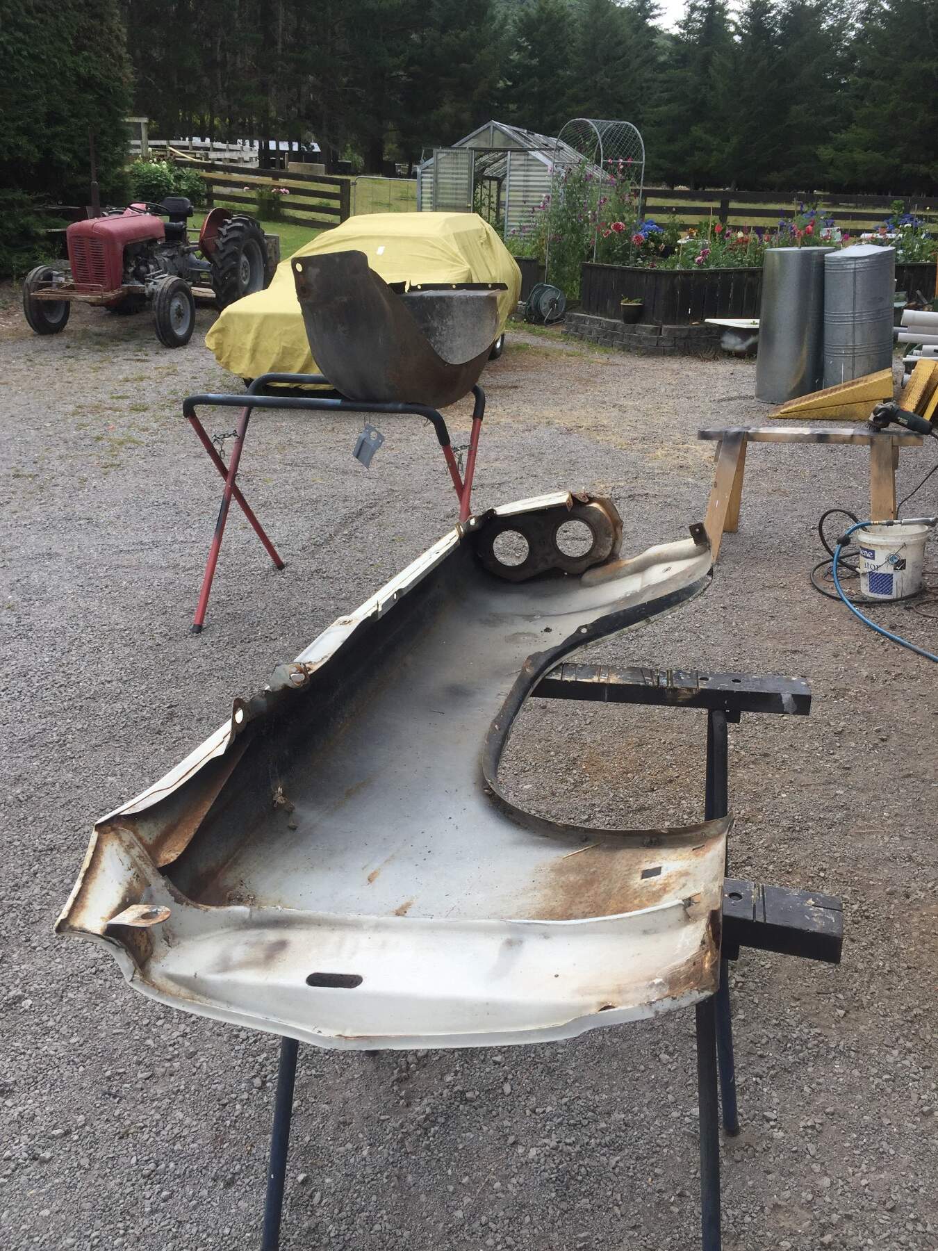

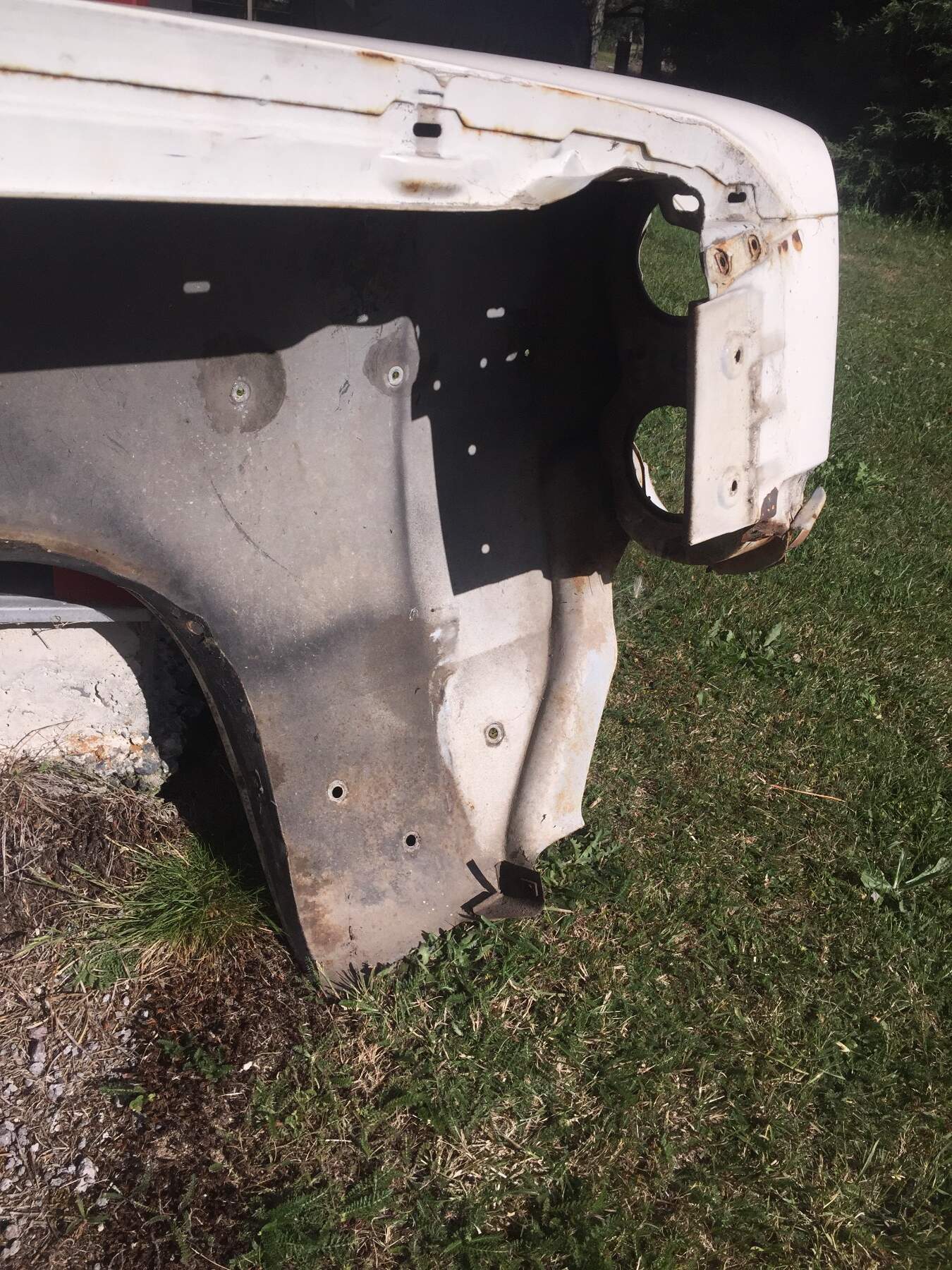

Here ya go wrongway this is a shot of my original drivers side fender I have yet to take a little dent out of and the passenger side fender I cut the rust out of back in March 2020 during lock downΒ

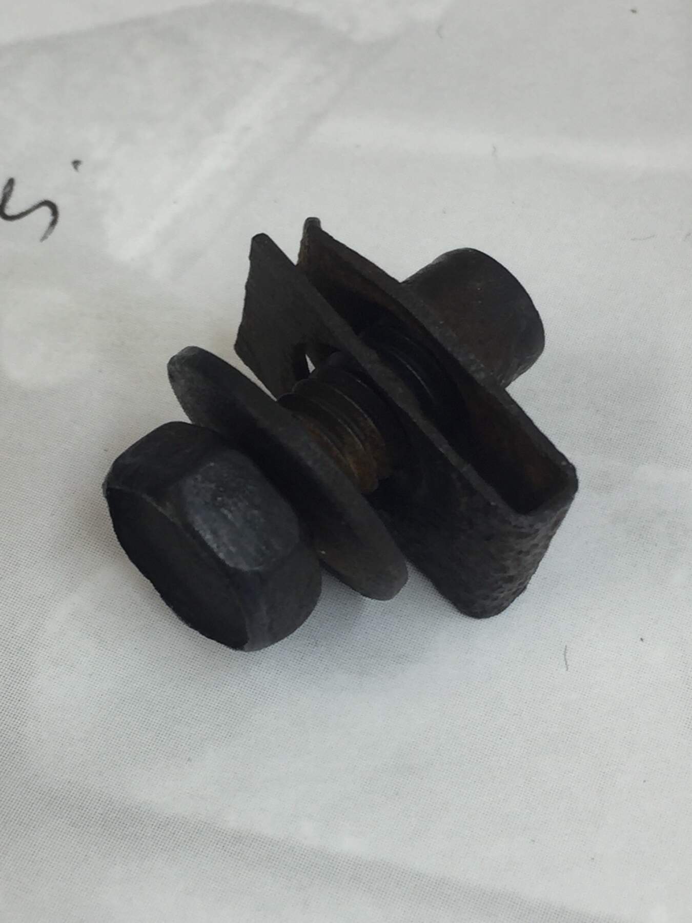

Can some one tell me the correct name for these clips ?:unsure:
is it a body clip ?
i have a whole bunch on the fenders I need to replaceΒ
Iv heard them called body clips but when I was replacing some of them they called them "U nut clips" bro. You can google that and all sizes pop up.

Thanks for the pics bro. Those did help confirm that one of my fenders is from a 64 lol.

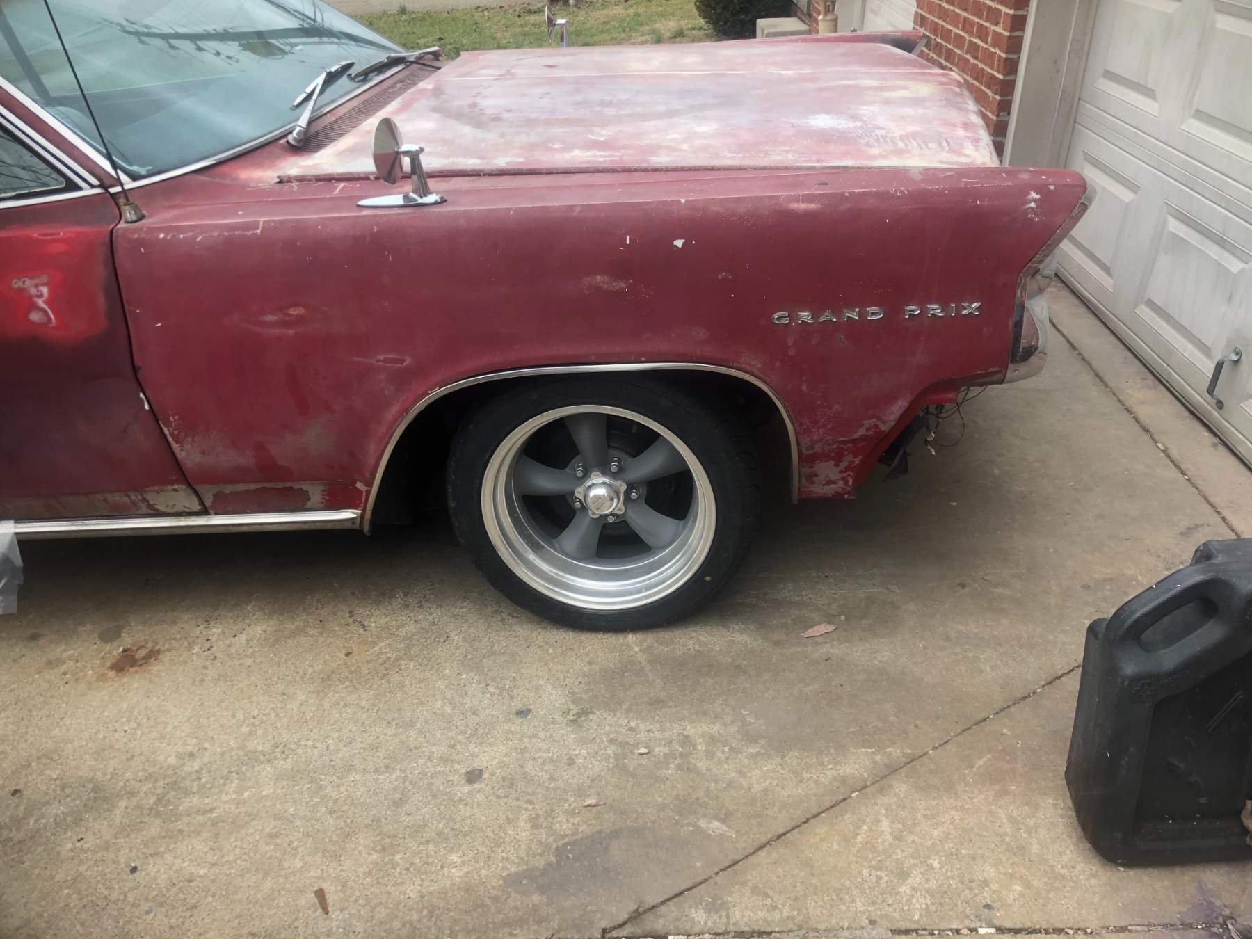

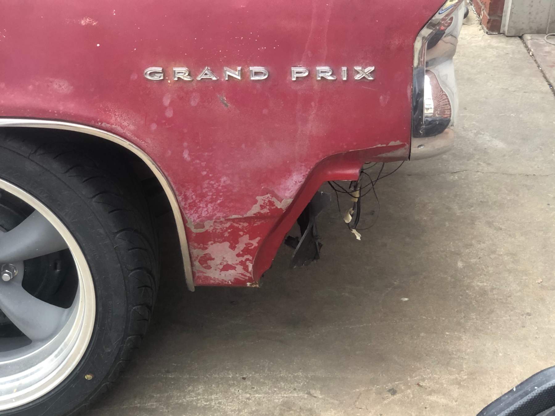

IF I'm remembering right the one you sent curves back just a bit more the my passenger side fender does. My drivers side looks just like yours. I'll snap a couple pics in the day light and let you see. But its such a small difference that its hard to tell. I honestly didn't notice it for about 6 months.
Ok I misspoke bro. I think its my passengers side fender that may be from a 64. Take a look, do you see it bro?

One curves at the very end and one is straight.
