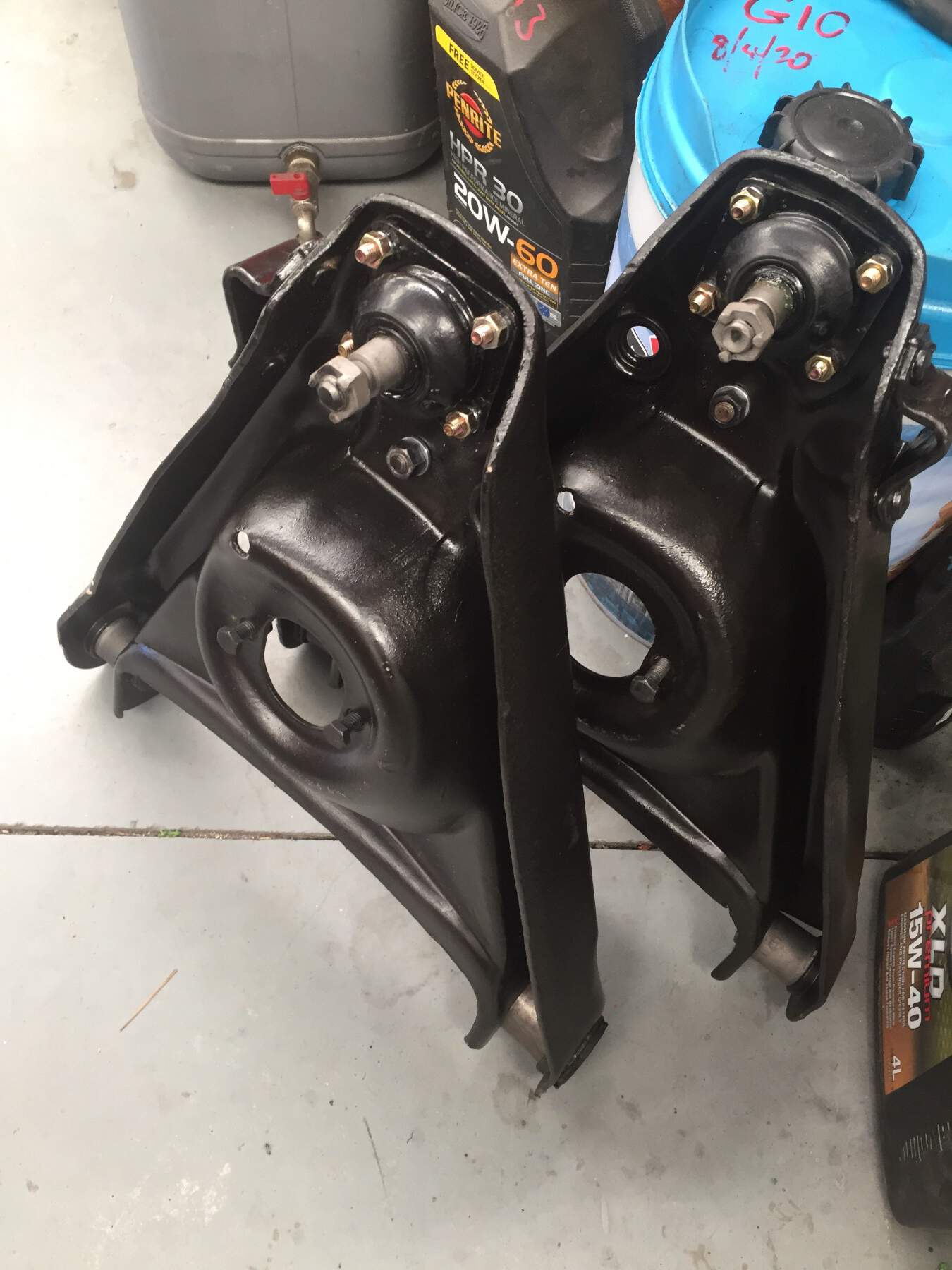

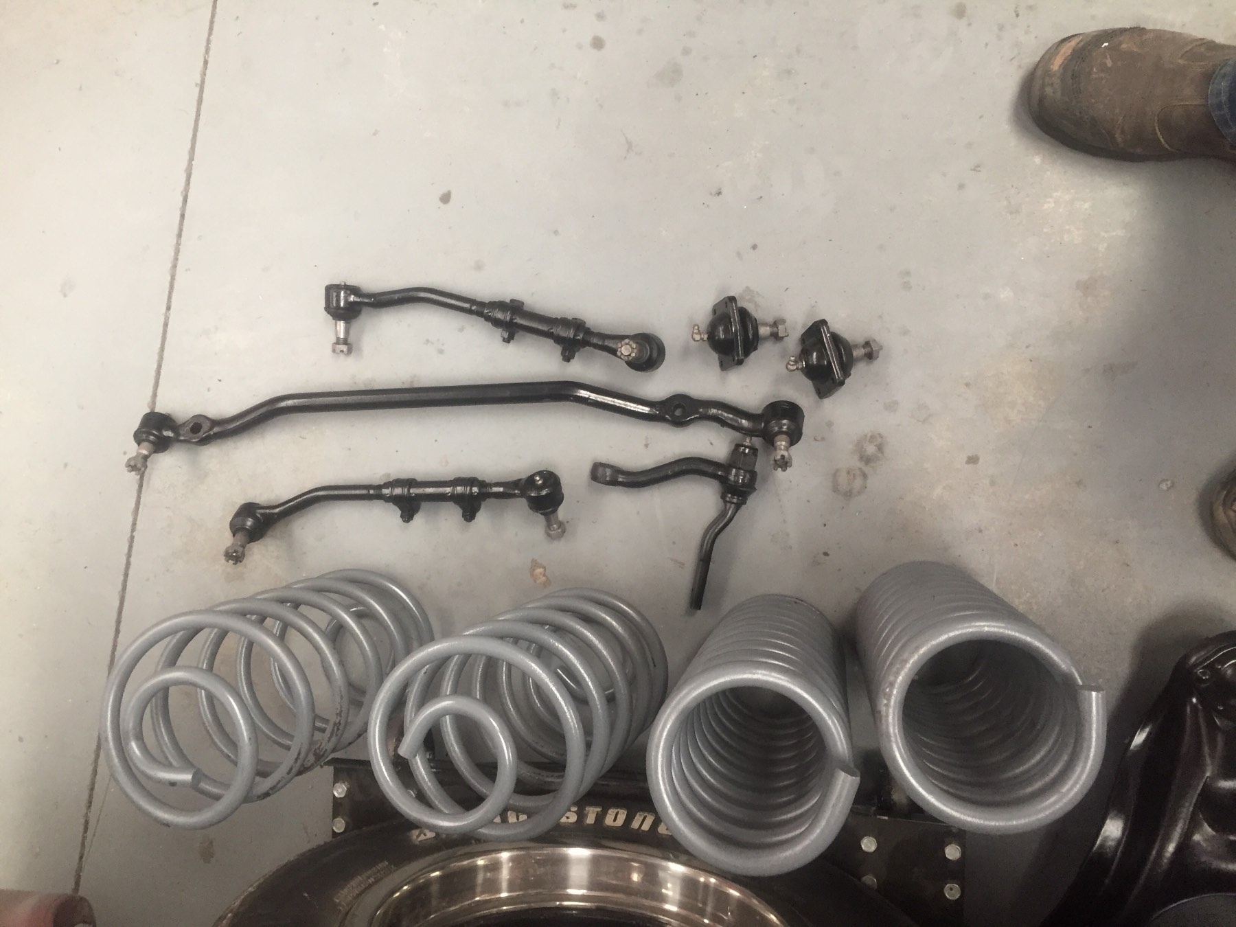

I now have all my steering parts rebuilt , rebuilt ball joints and I called into the spring makers in Rotorua and my reset springs where ready 🍻🍻🍻🍻🍻

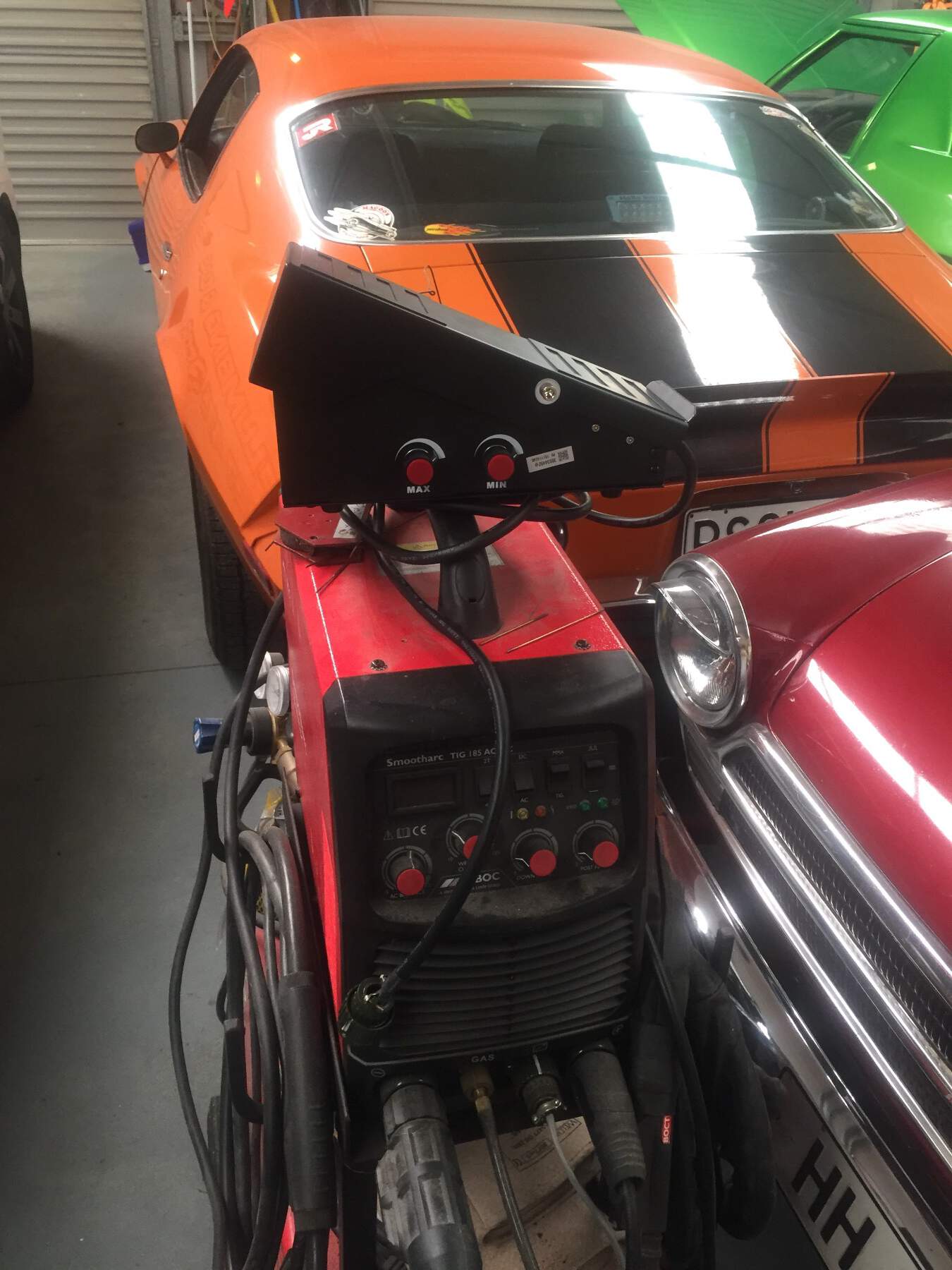

and my Xmas present too myself arrived Β for my tigΒ welder
a foot control πŸ‘πŸ»πŸ»πŸ»πŸ»:dancingpontiac:

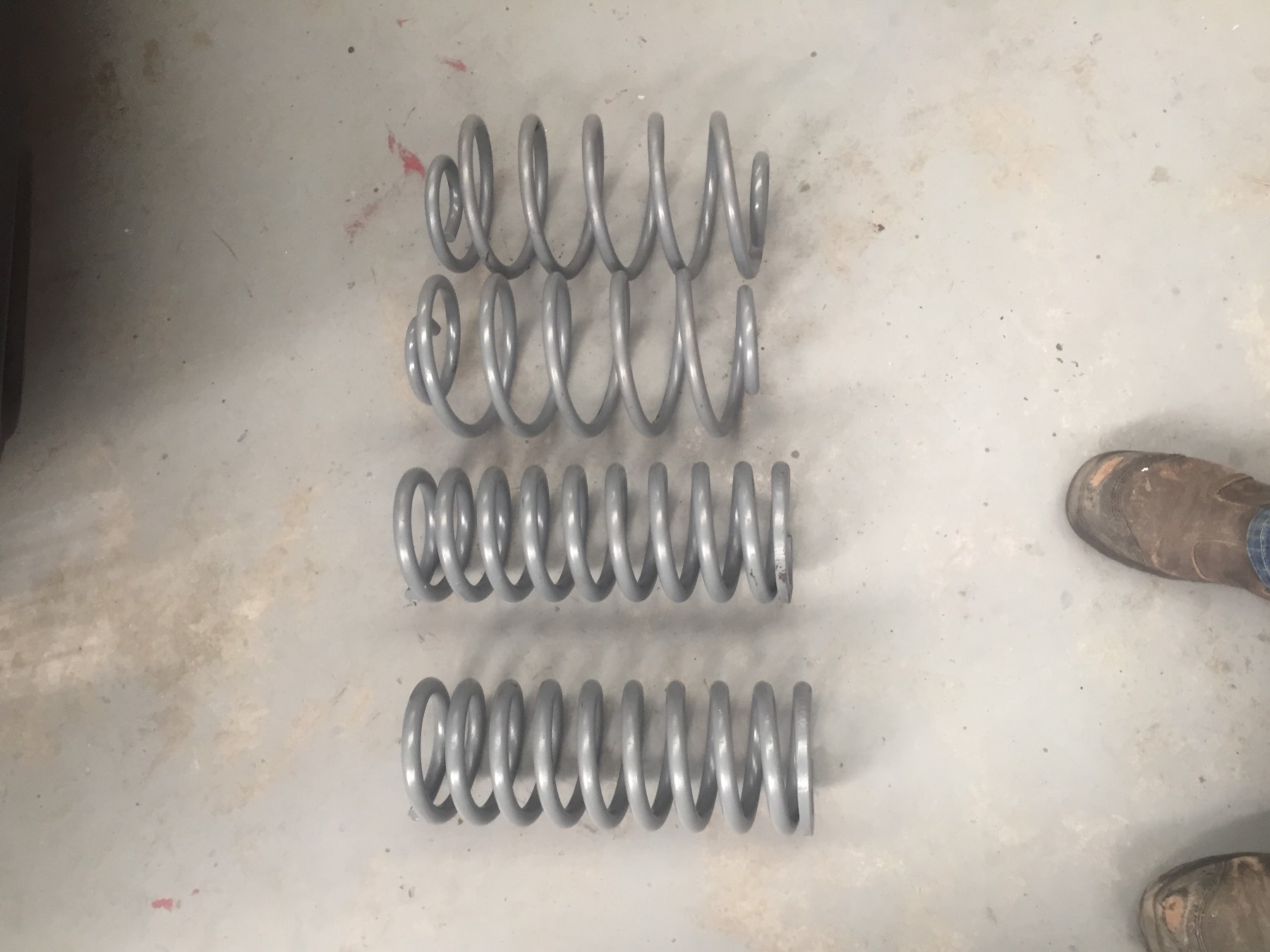

front springs have been reset 3 inches lower, rears are reset 2 inches lower, but these are just for set up and to see what my ride height is,then once i am happy with how she sits, i am going to have a new set made from heaver steel, these are way too light, i am after a firm ride not a floaty ship feel.😜

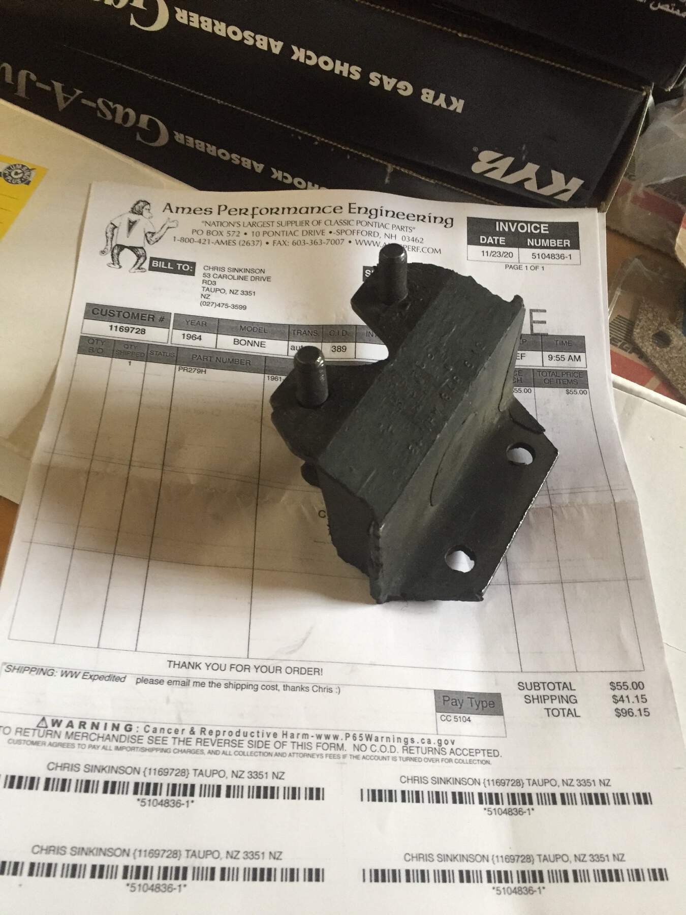

Trans mount arrived yesterday from Ames which was not bad Vermont to Taupo in 2 weeks πŸ‘

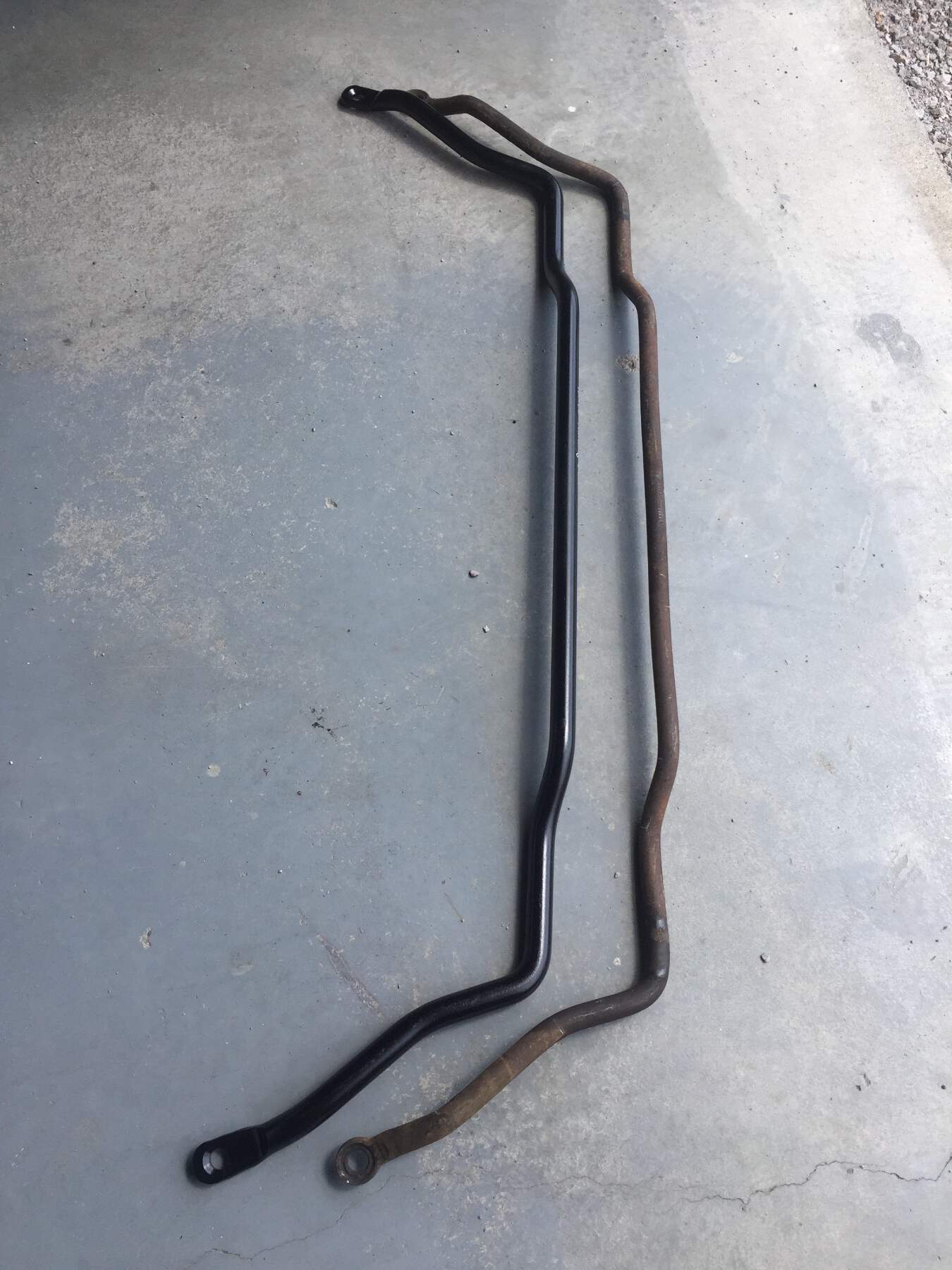

The new 25mm sway bar up beside the original 20 mm barΒ
while it won’t make the 64 into a race car , it will certainly improve corneringΒ
and I can retain the original saddles with Β new bushings drilled out to suit the bigger bar πŸ‘

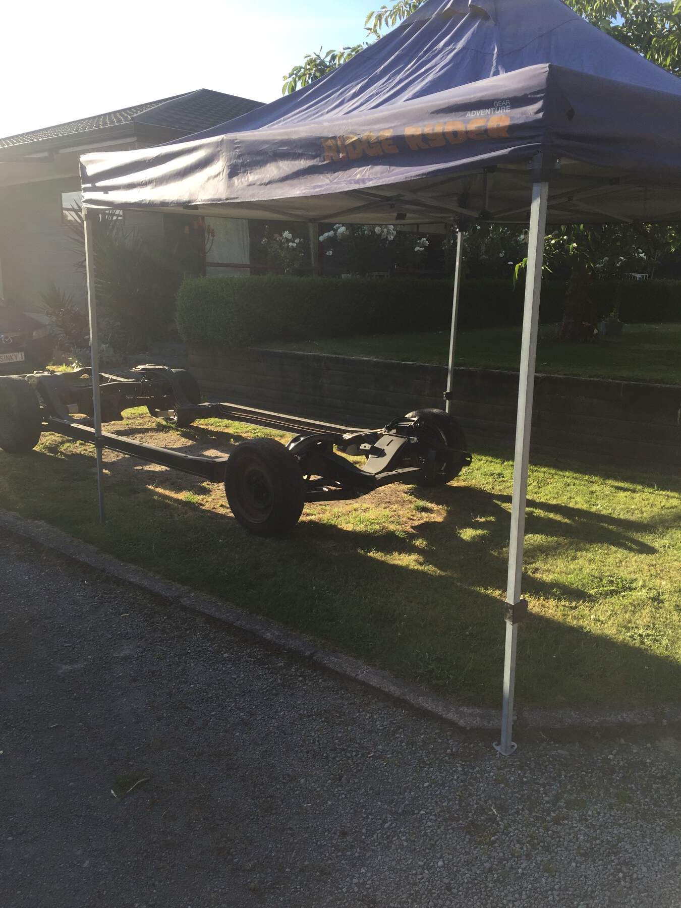

But it will have to wait.... today i am going to get my frame down on the front wheels:cheers::dancingpontiac:, its going to be another stinking hot day, and as i am sorting this part outside, i will stick the pop up so i dont get too burnt:unsure:

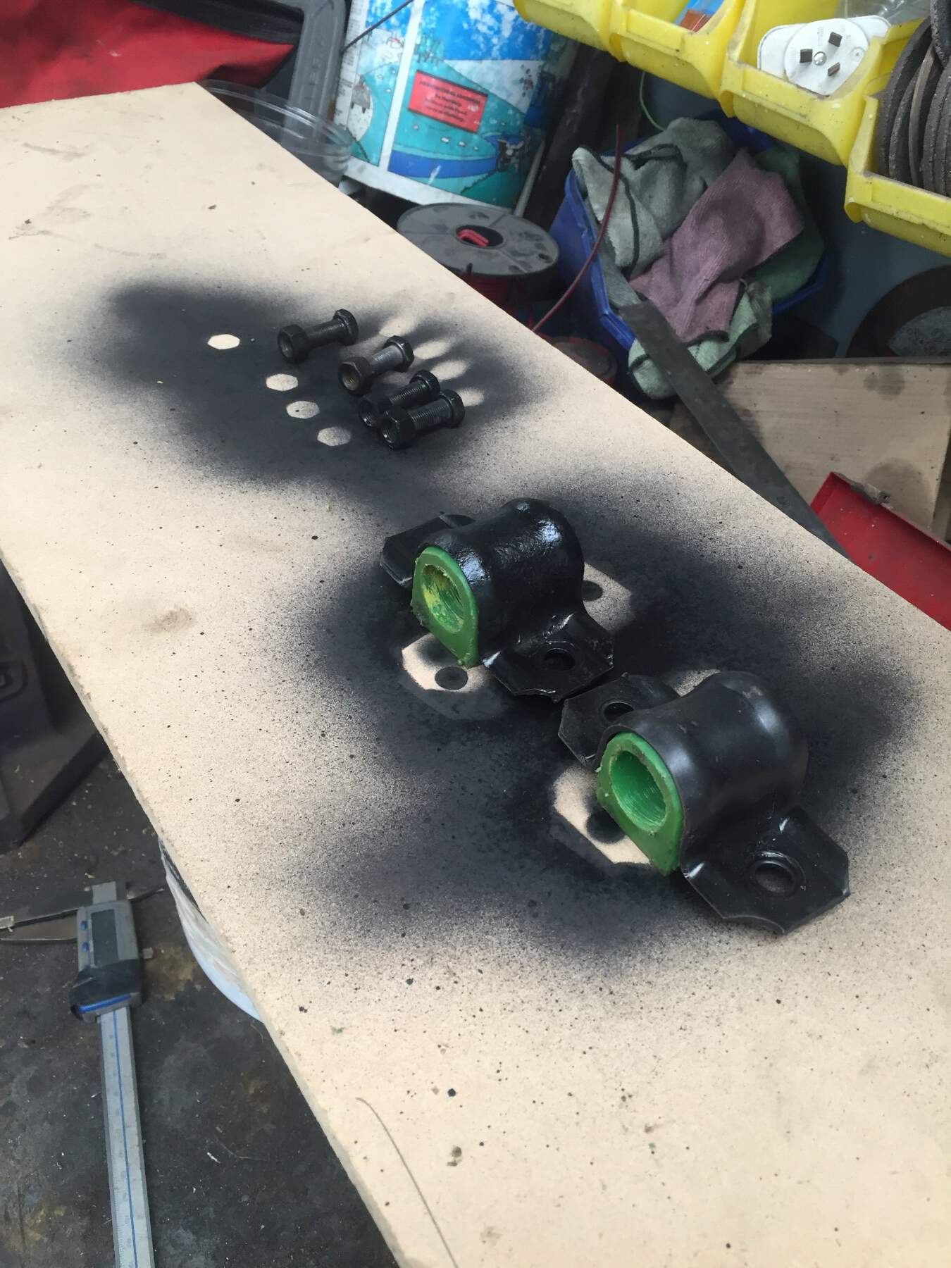

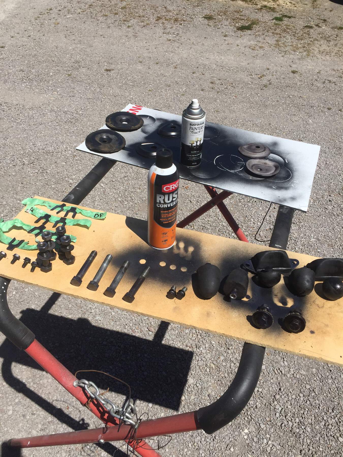

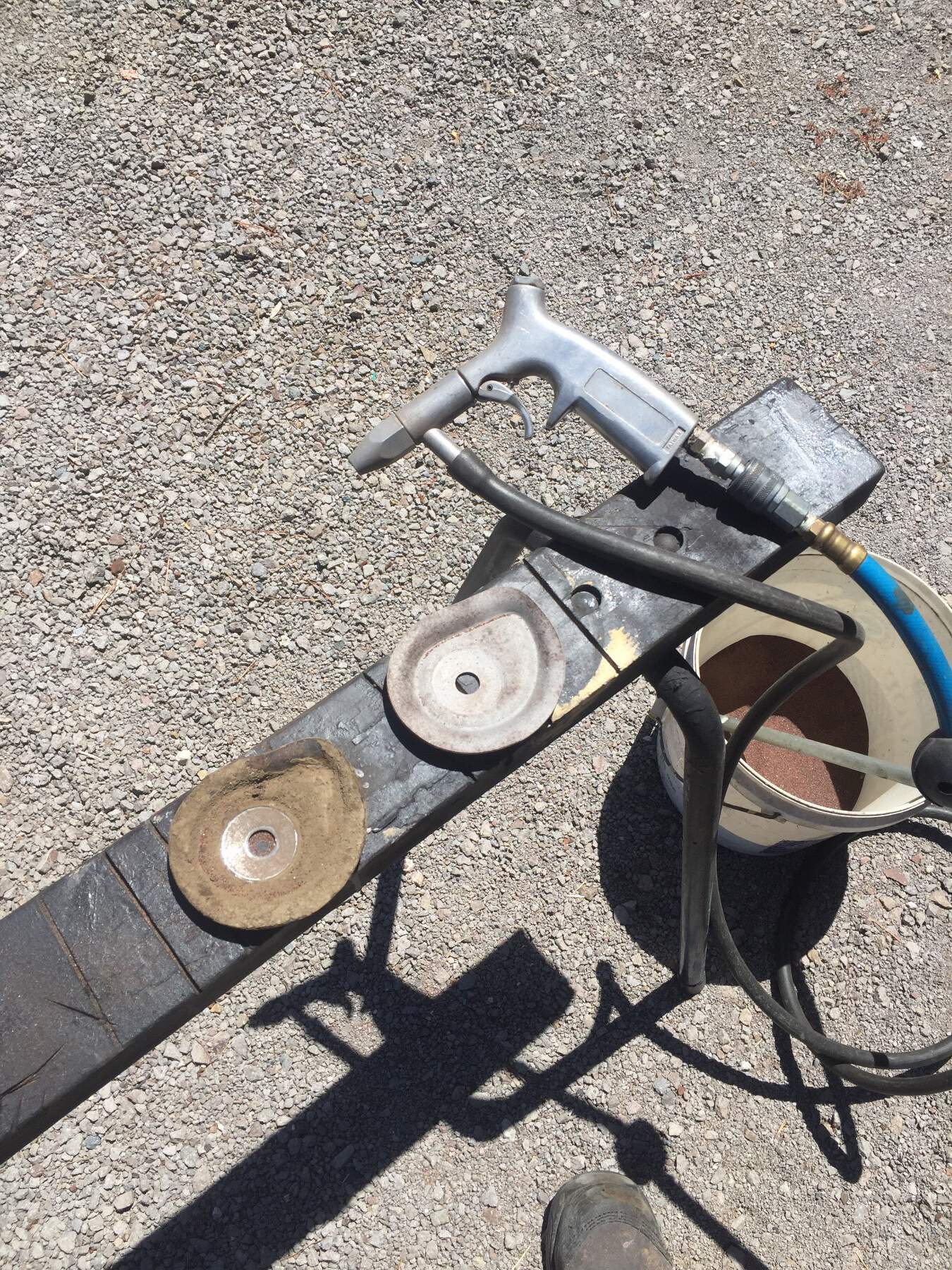

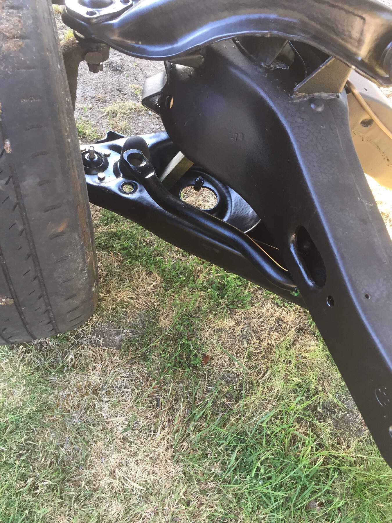

Wire buffed and sand blastedΒ all the bolts and partsΒ
some got JustA rust convertΒ prime while bigger parts got a coat of black paintΒ
Any bolts that looked wornΒ
I have replacedΒ
Bolted all the ball joints inΒ
Β
Another stinking hot dayΒ
So stuck up a pop up and got the girls chassis on four wheels 🍻🍻🍻🍻🍻
time for a beer I feelΒ :dancingpontiac:
The new inch sway bar looks to be fitting very nicely πŸ‘πŸ‘

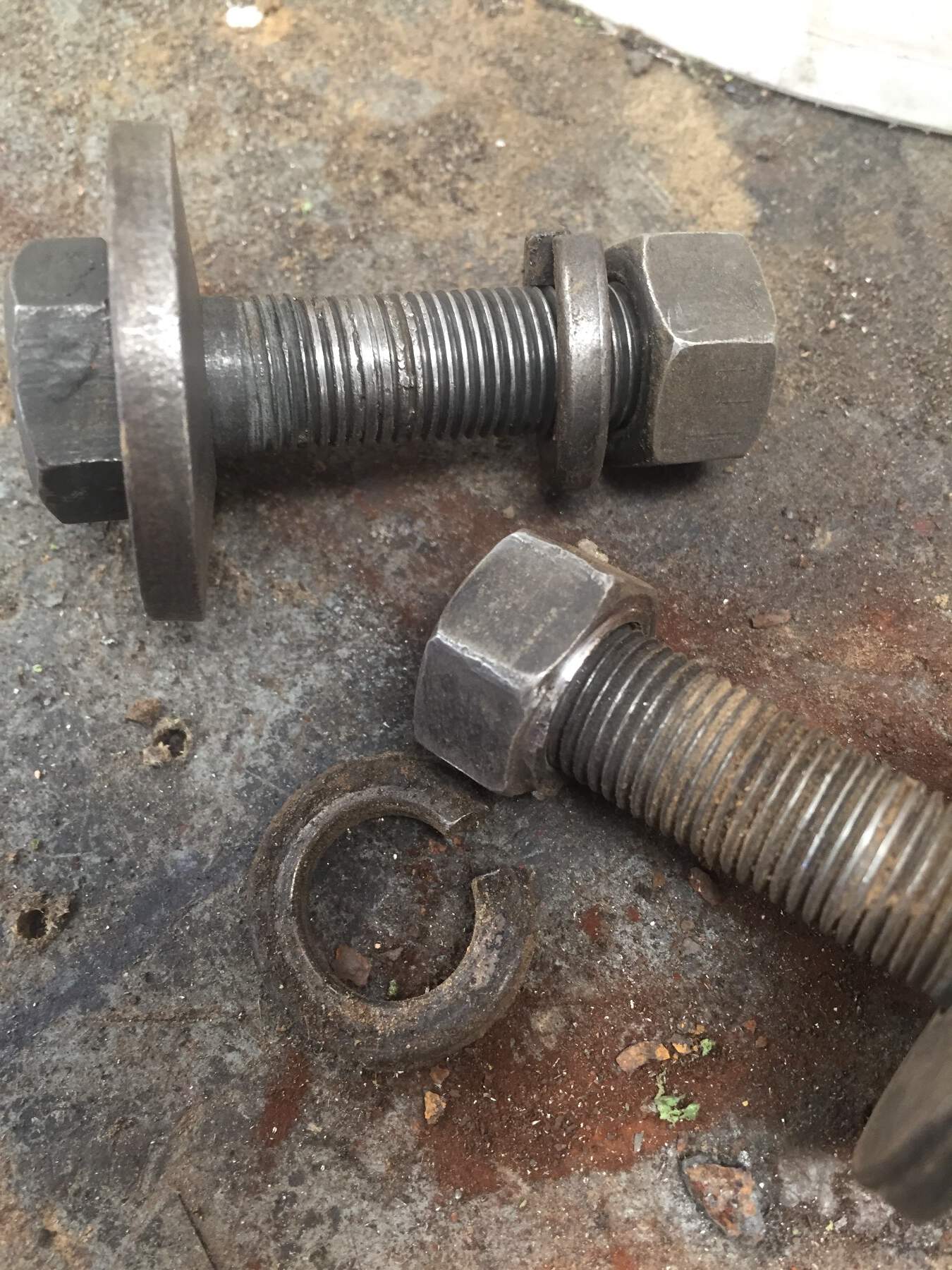

i have a issue and i am really hoping Last Indian will see this post and tell me if i am worrying for no reason !
yesterday i assembled the lower a arms onto the 64 frame, went to insert the bolts through the frame and bushings and they didnt fit !!! my bushings are 1/2 inch yet my frame rails they bolt through are 9/16.
now that means i need to get 1/2 bolts to clamp up these lower arms, but that now means i have a 1/16 play in each mount....
Β do i
AΒ  Β  bolt themΒ up tight and not worry
BΒ  Β  try and drill the bushings out to 9/16.... which i think will devulcanize themΒ
or C get a machine shop to make a 1/16 bush to fit in each frame rail bolt holes ???????Β Β :unsure:

If it were me, I think I would first try using either split lock washer or either an internal or external tooth lock washer to help keep the bolt in place. I would not expect the bolt to move around that much once you've torqued it down anyway, but I expect the added clamping force of the washer will further help keep it in place.

First of all how big is the outside diameter of the inner steel sleeve in the vulcanized rubber?
It’s a problem, but not to worry! You can fix it! You need one of two remedies! The simplest is two special washers for each side ofΒ the 1/2” bolt. So depending on how large the outer diameter is of the sleeve is will determine what those washers look like!
Aarms like other vulcanized bushing need the center steel sleeve clamped to the frame/bracket by the through bolt! This is what make the vulcanized bushing do it’s job!
Once you tell me what that O.D. Is I’ll determine what the washer should look like!

Justa me, but I would use the correct size flat washer for the bolt.Β  Then Justa tack weld the washer in place.Β  Too much pressure/stress to have it work loose Justa using lockwashers.Β  If you ever need to replace the bushings again, would be super easy to grind off the tack weld. Sounds like you got a wrong bushing.Β  What does your supplier say about it?Β  Again Justa me but i swear my a arm bushings took bigger bolts then 9/16 even.Β  1/2 sounds pretty wimpy.
