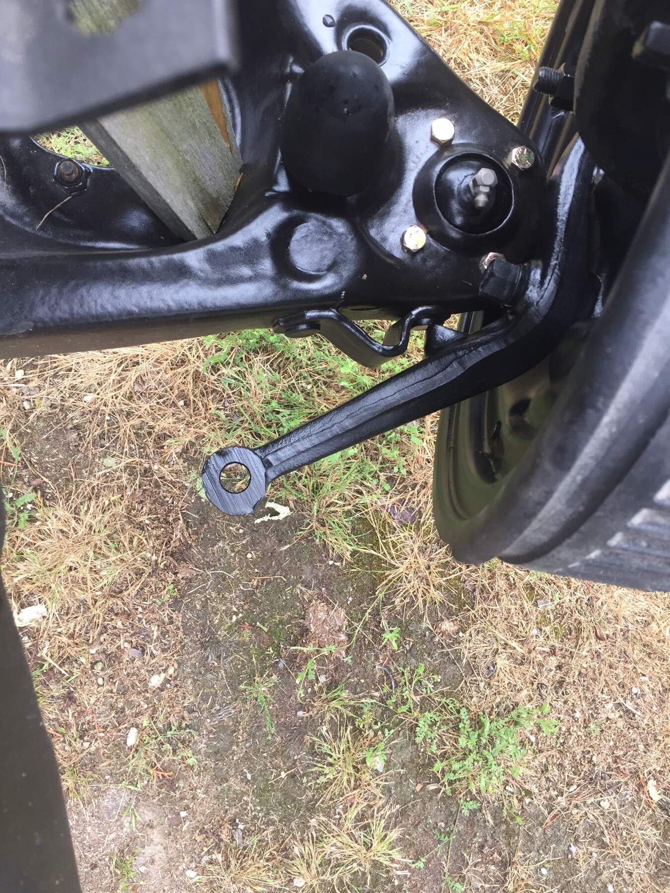

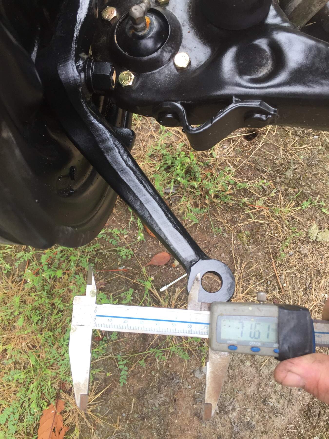

The freshly painted front stub axles and 8 lugger drums went on the new frame this morning ,,, looked great till I saw the  difference in the steering arms 😡😡😡😡
But that’s to be expected 🙄

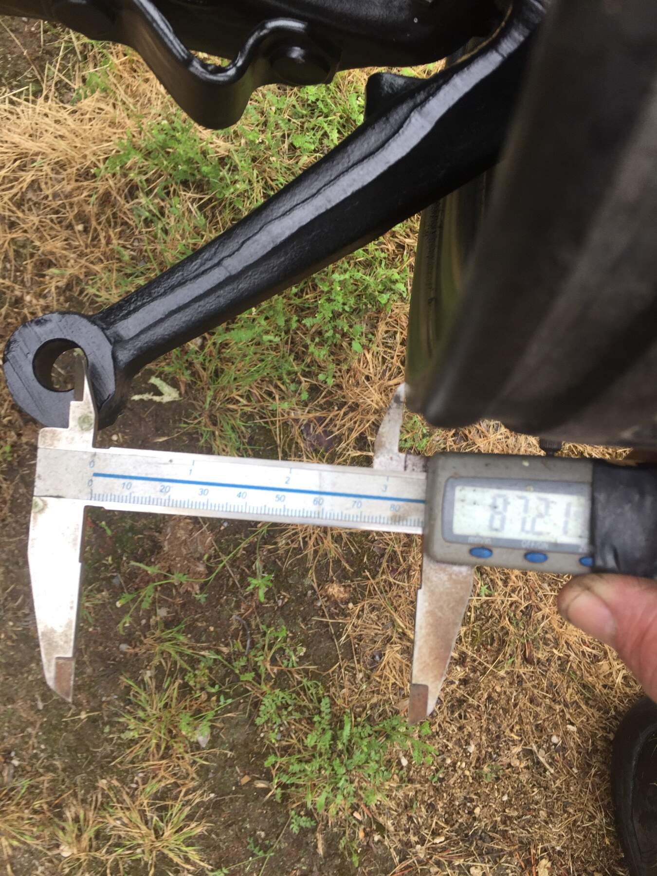

The passenger side arm is bent, and I will need to replace it !!! 🙄
you cant tell until you bolt it up and that’s where I saw the differance
anyone got a spare 63/64 wide body passenger side steering arm 🙃

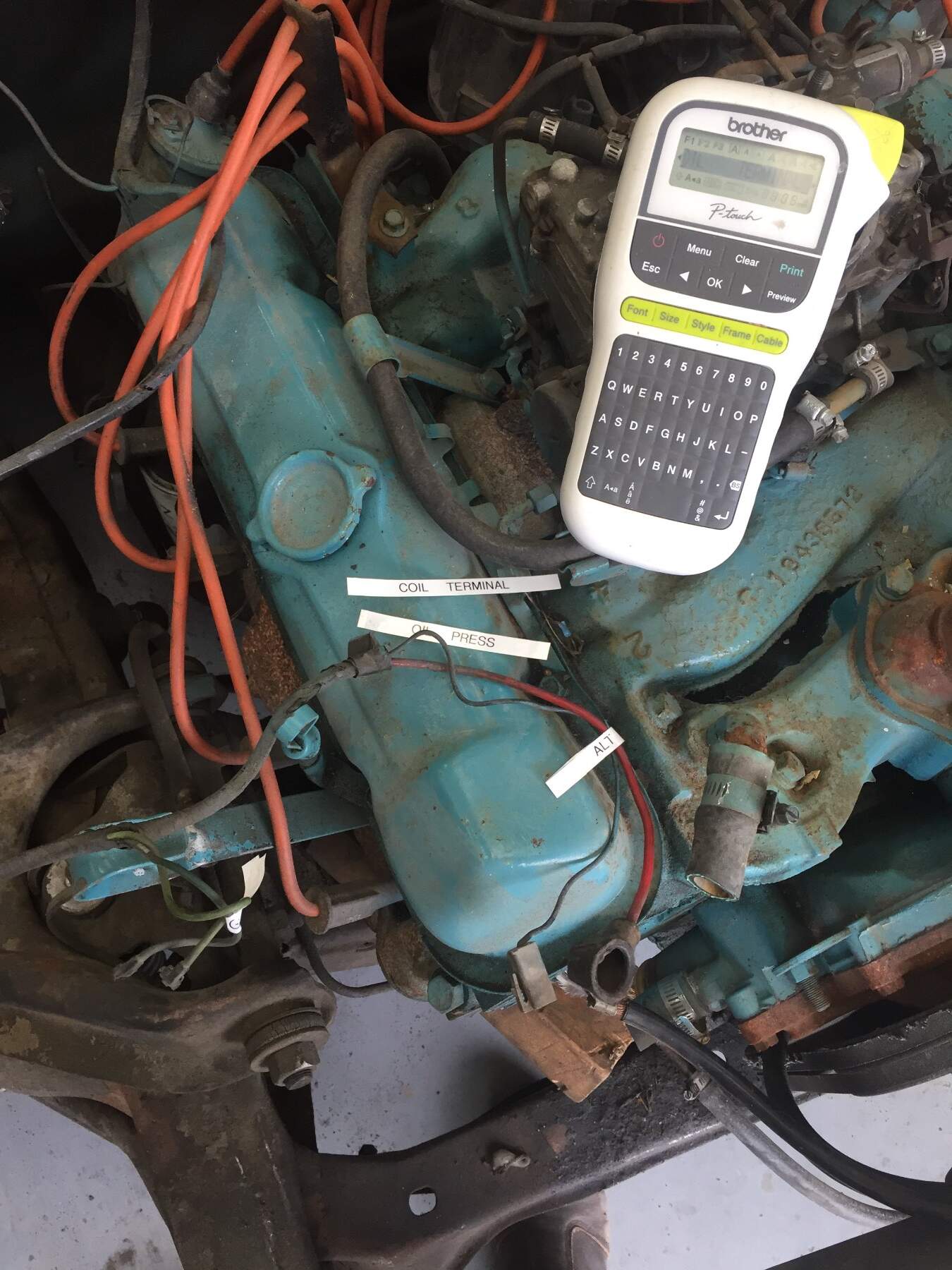

I bought a label machine for my last build and I had to steal it back off the boss so I could tag all the wires and hoses I disconnected today
she had been using it to label her fruit preserves 🙄

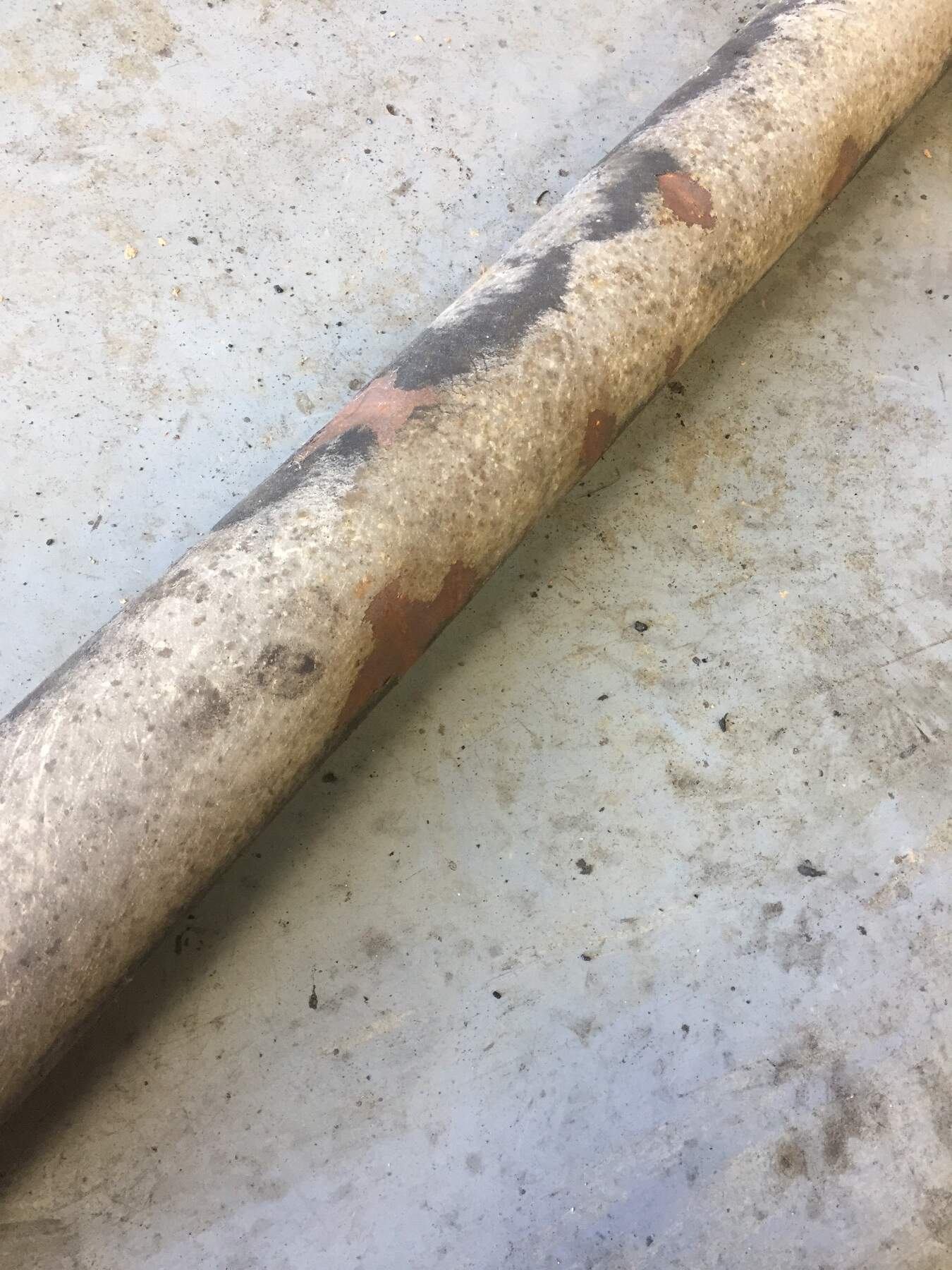

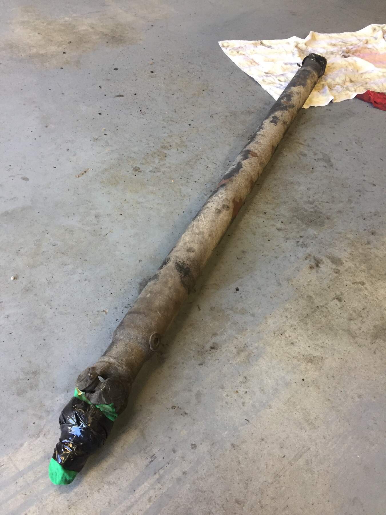

Removed the drive shaft and found it was bent! Looks like a fork lift has picked up the car at some stage and bent it

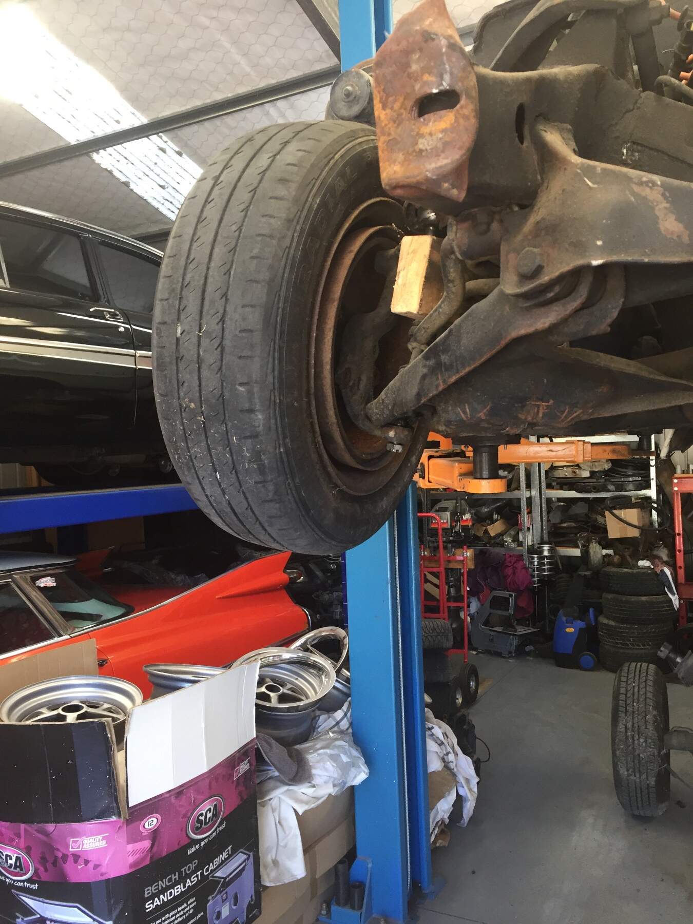

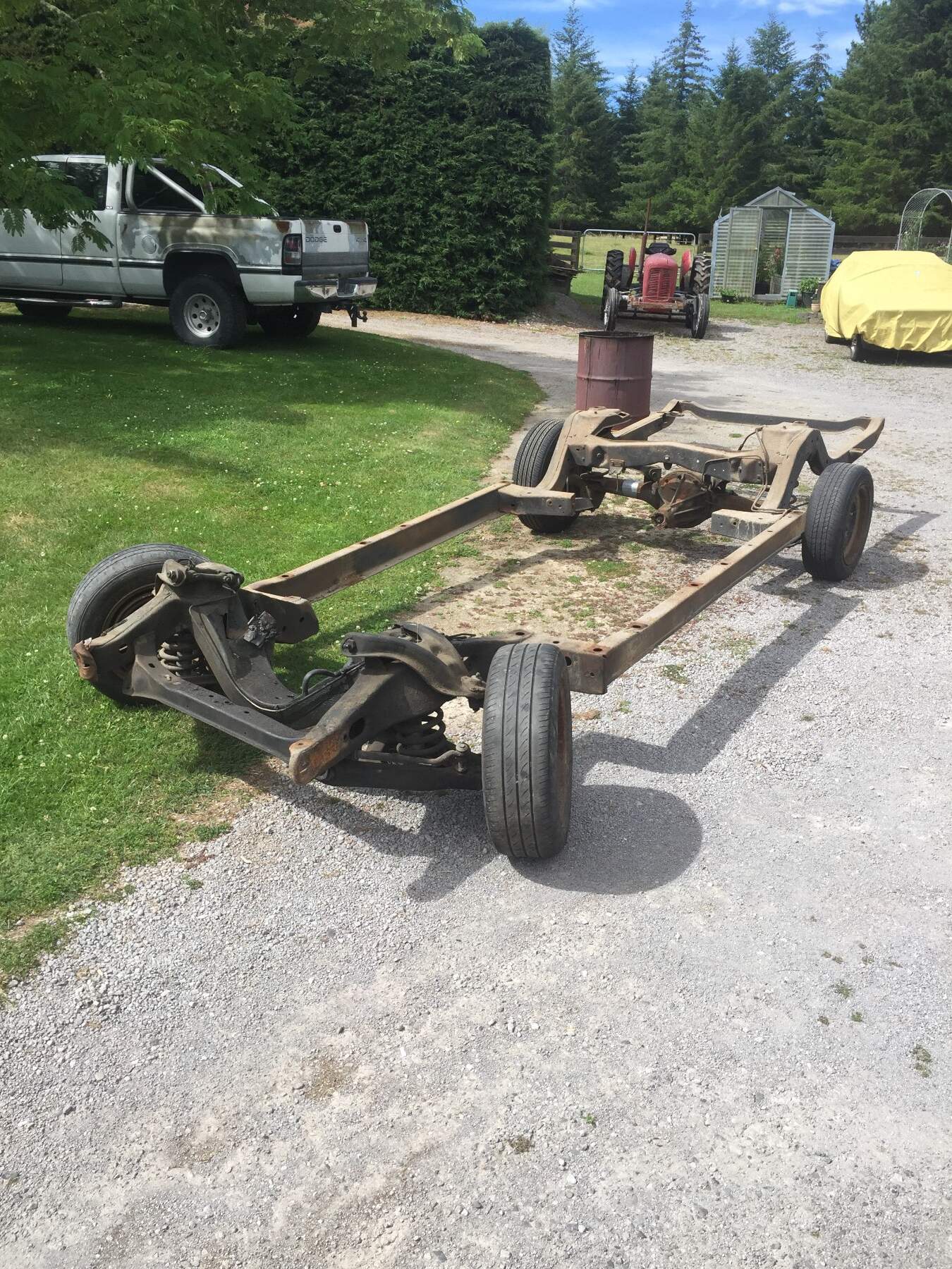

Fitted the standard drum and stub axles in the bent frame

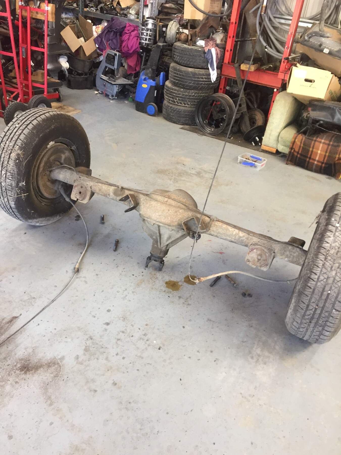

Pulled the good diff off
Cleaned it up and got it ready to hook up to the new chassis ,

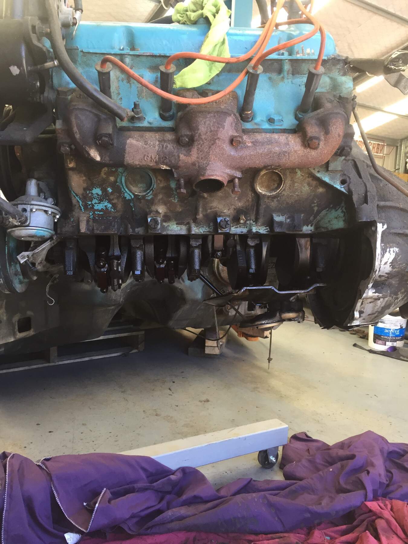

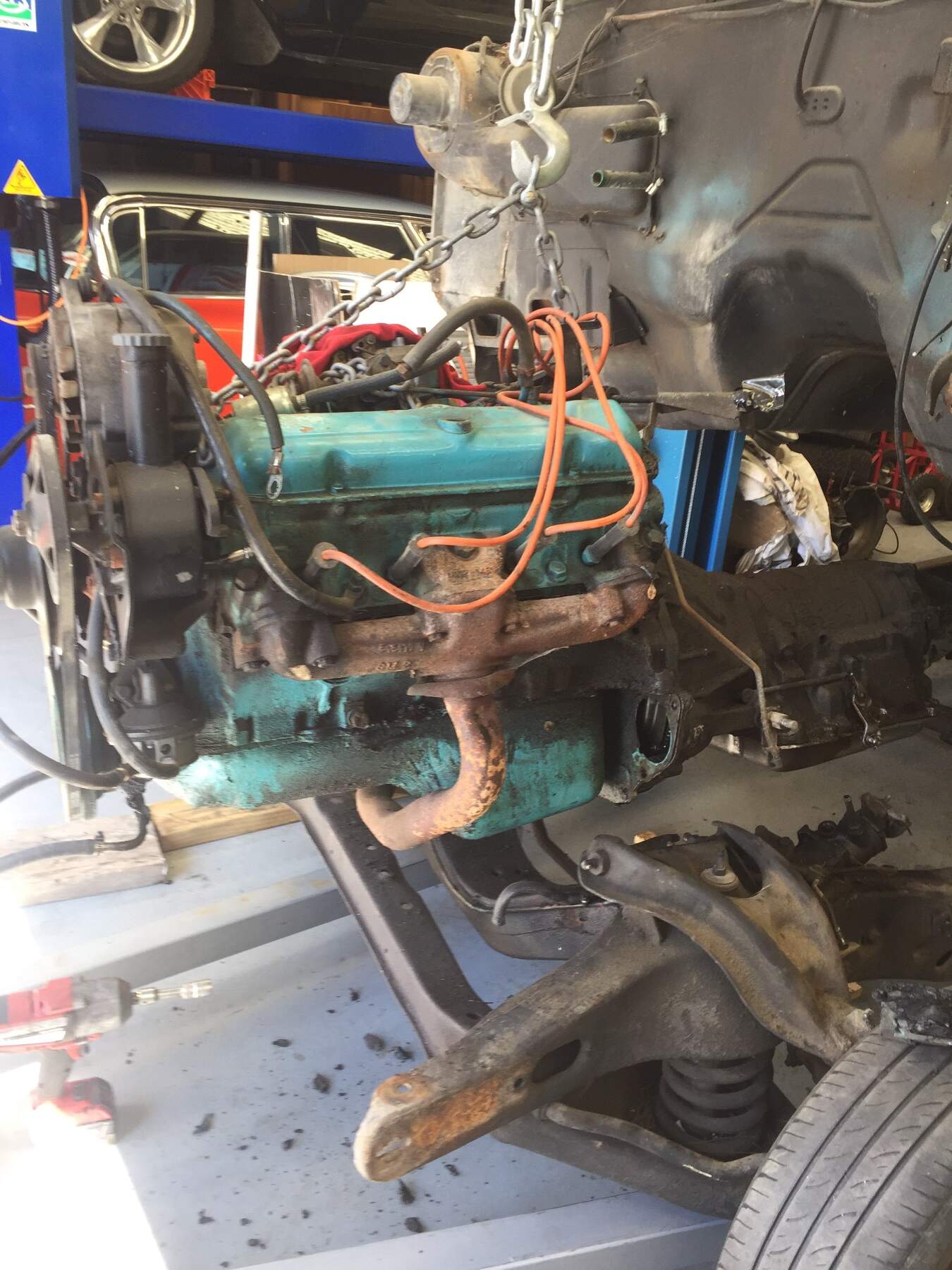

Pulled the engine and trans

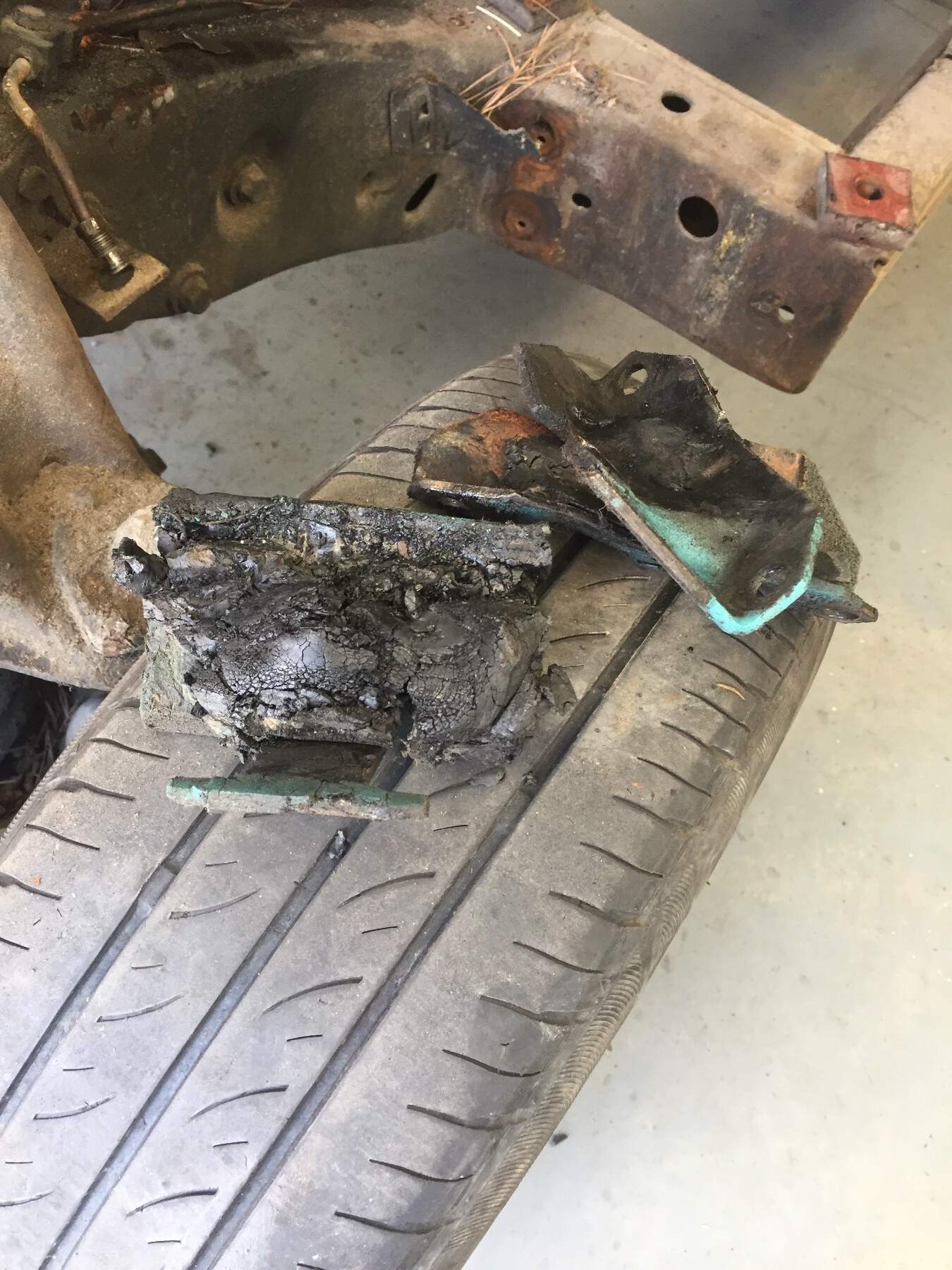

Engine and trans mounts where toast 🙄

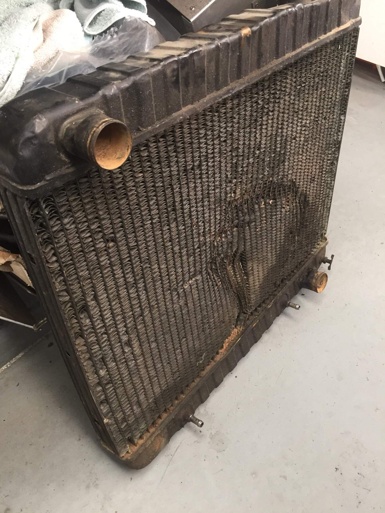

So I have a little list of parts to get ... radiator .....

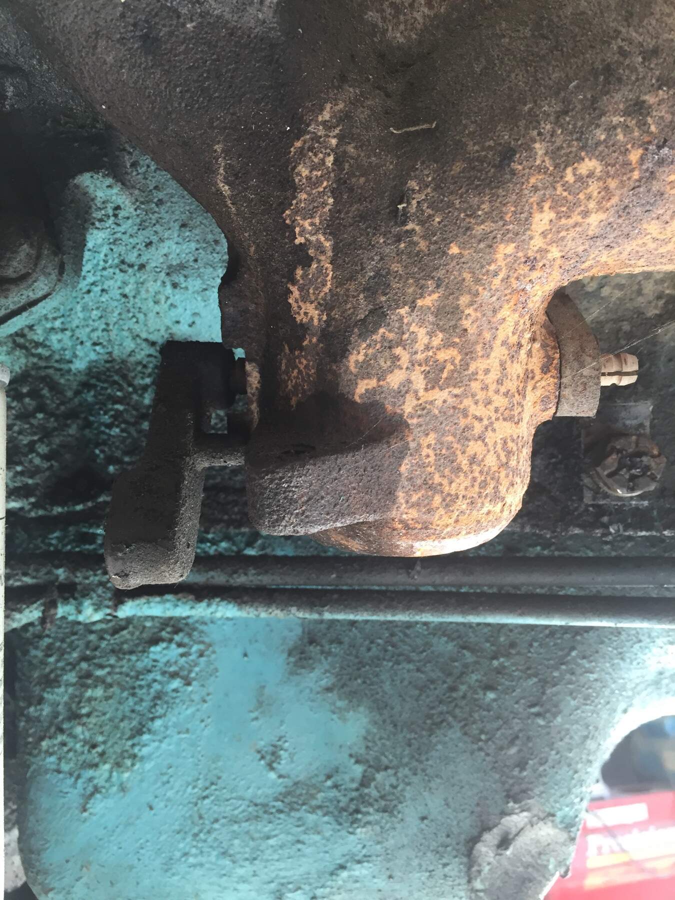

On the passenger side there is this exhaust choke,,, does anyone know why  a Pontiac needs a exhaust chock on one side ????

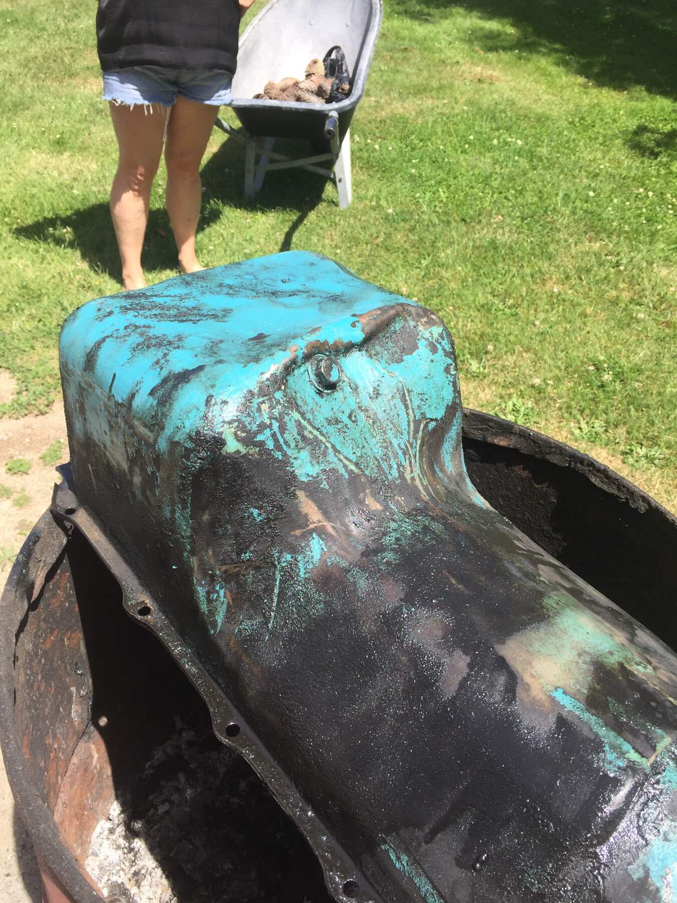

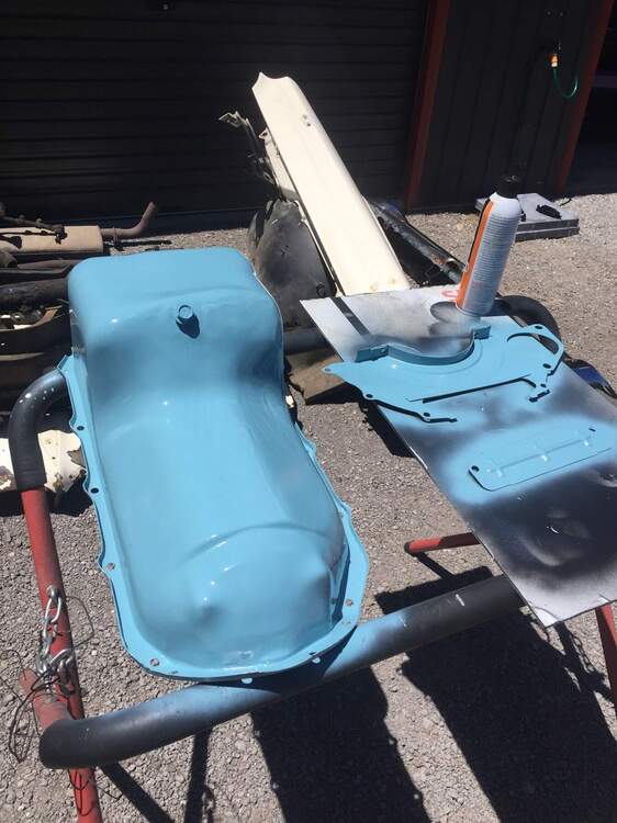

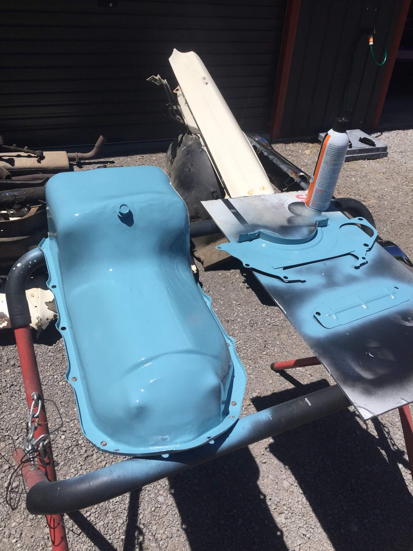

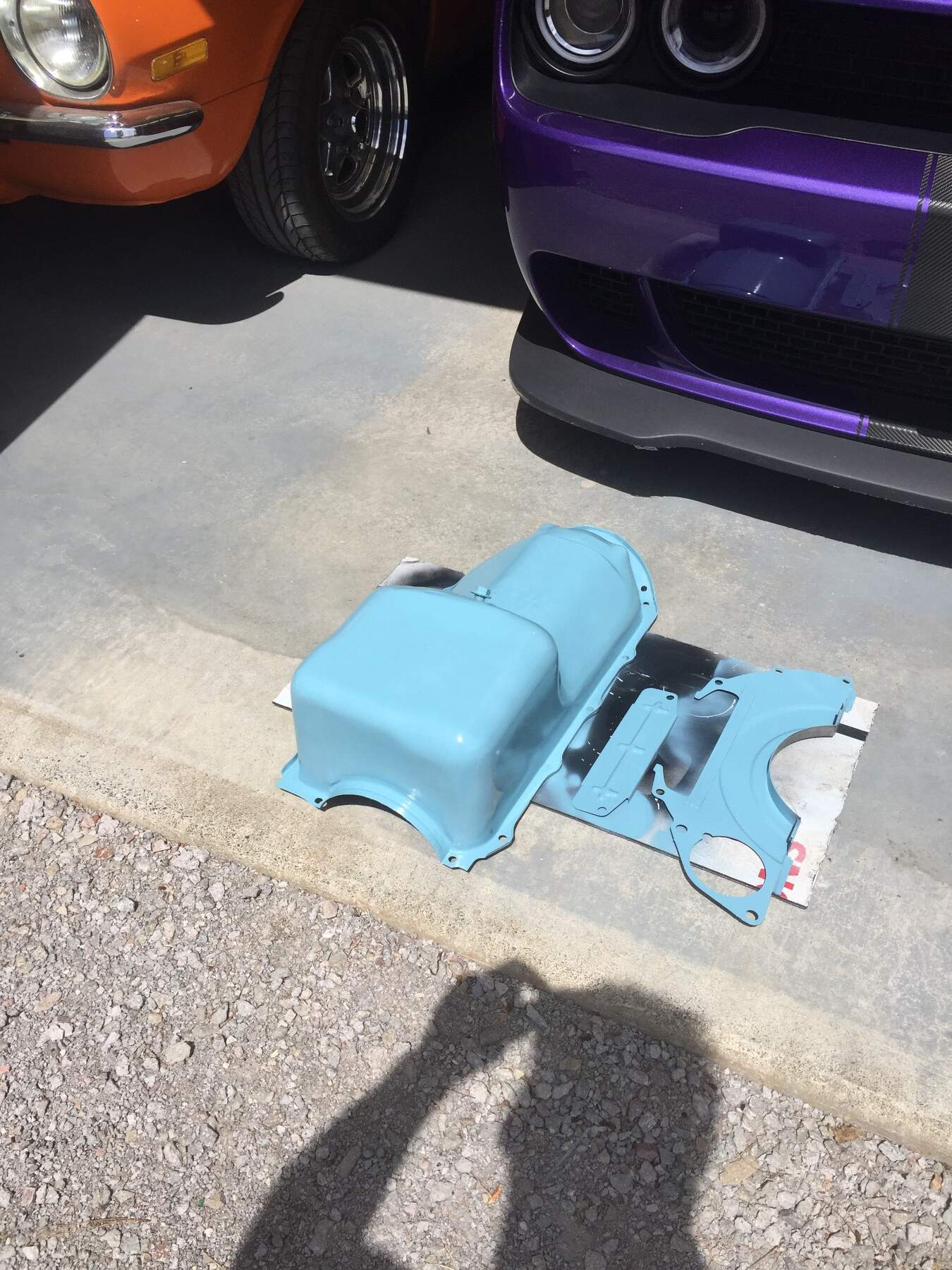

pull the damaged sump off the 389

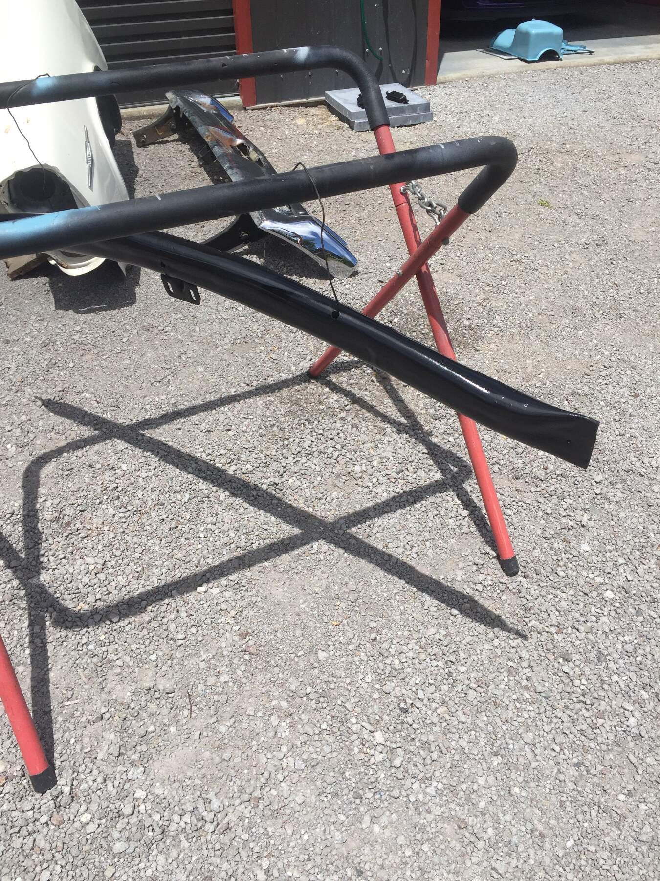

cleaned, preped straightened, and repainted
Then cleaned blasted trans mount and fluid lines , just more dirty work , mess every where that took longer to clean up  than prepping the parts :unsure:

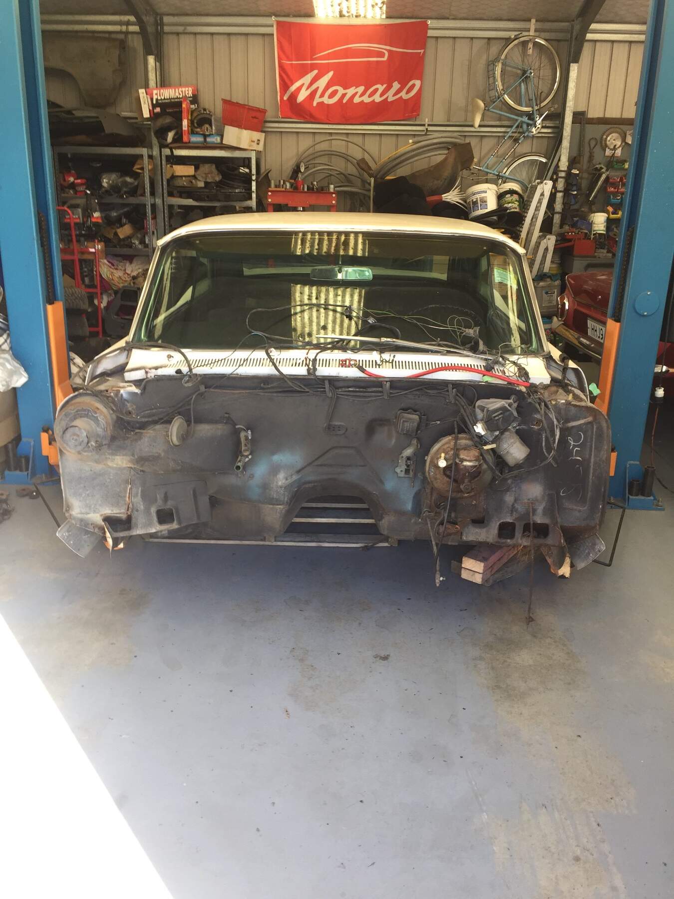

Old frame out of the garage and body down on the floor for the next job

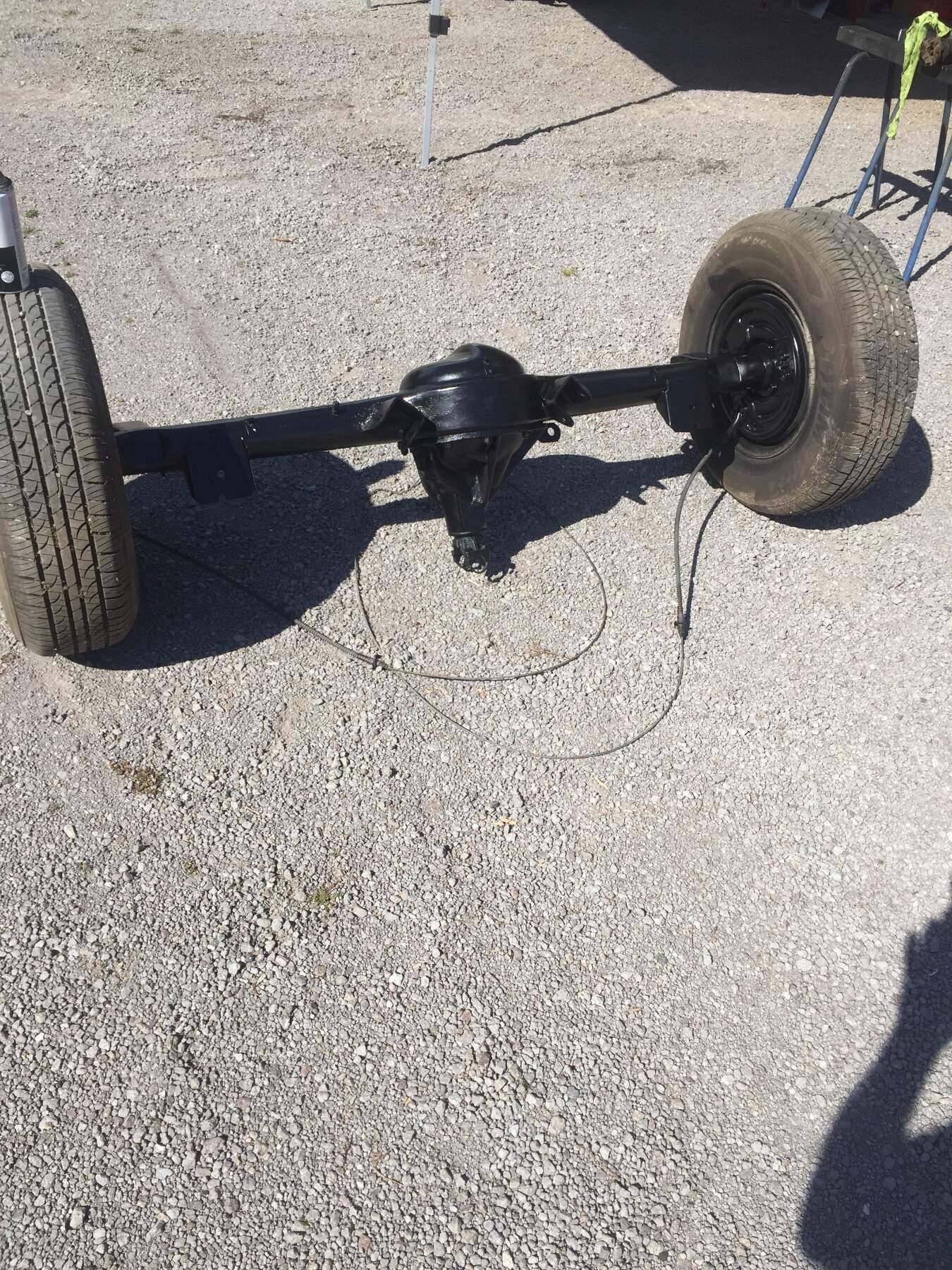

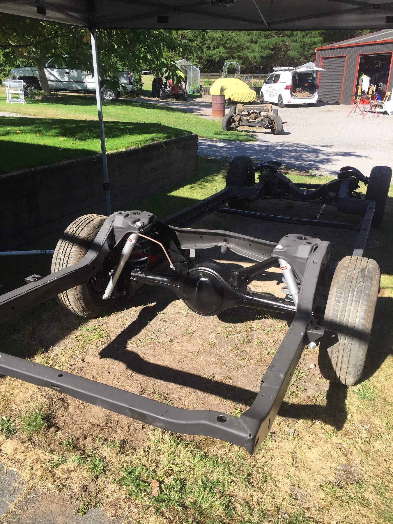

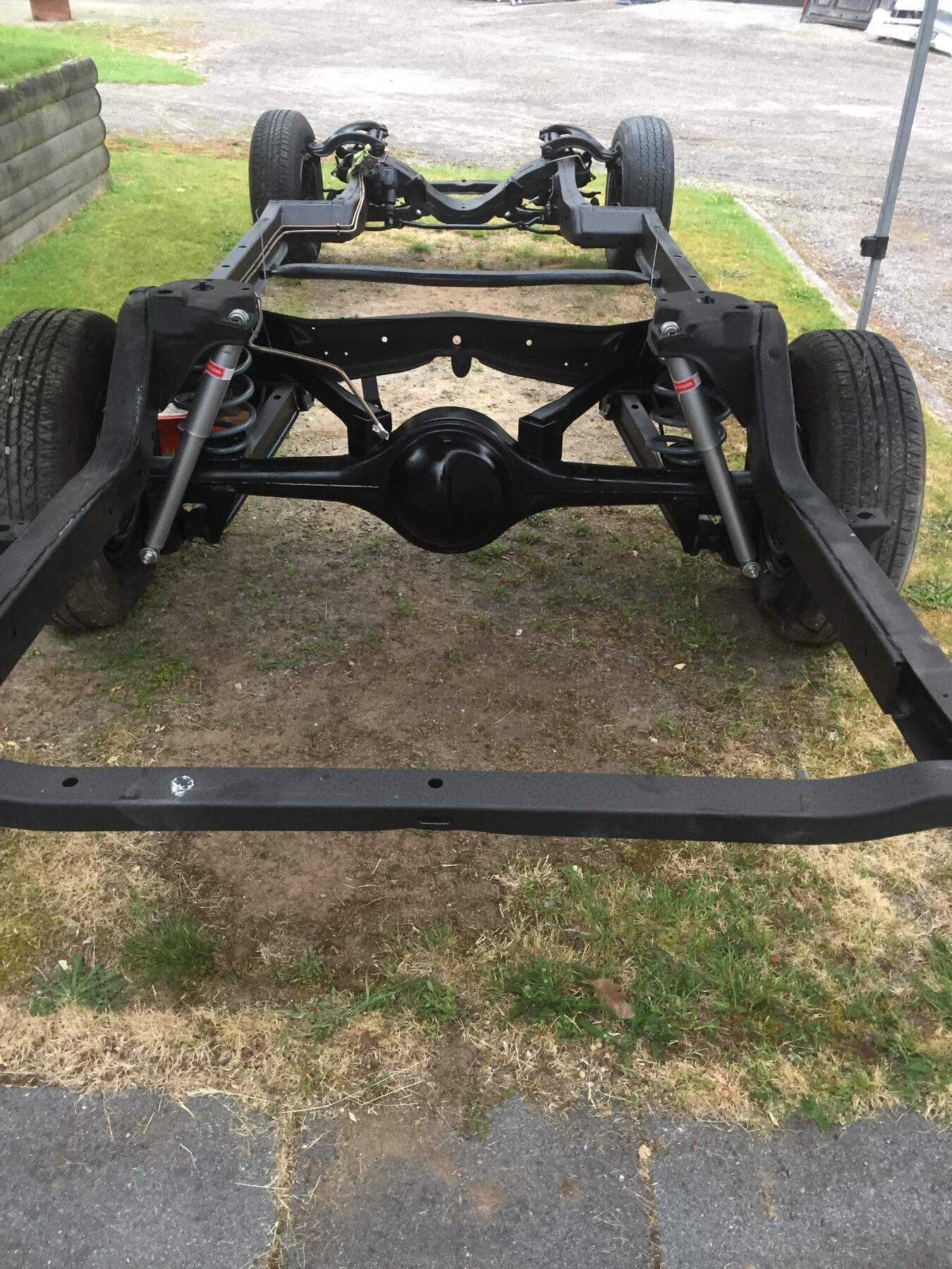

Freshly painted diff into the good frame and springs
Very impressed  with the kyb gas a just shocks
they came with new lower mounting pins and fit was perfect 👍Thanks Last Indian for the recommendation :cheers:

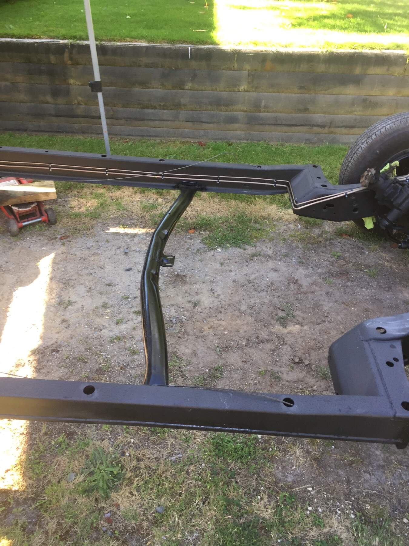

installed the steering parts and the new chassis is ready to go !!!!!

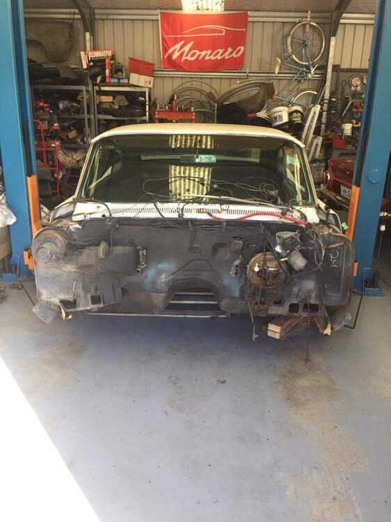

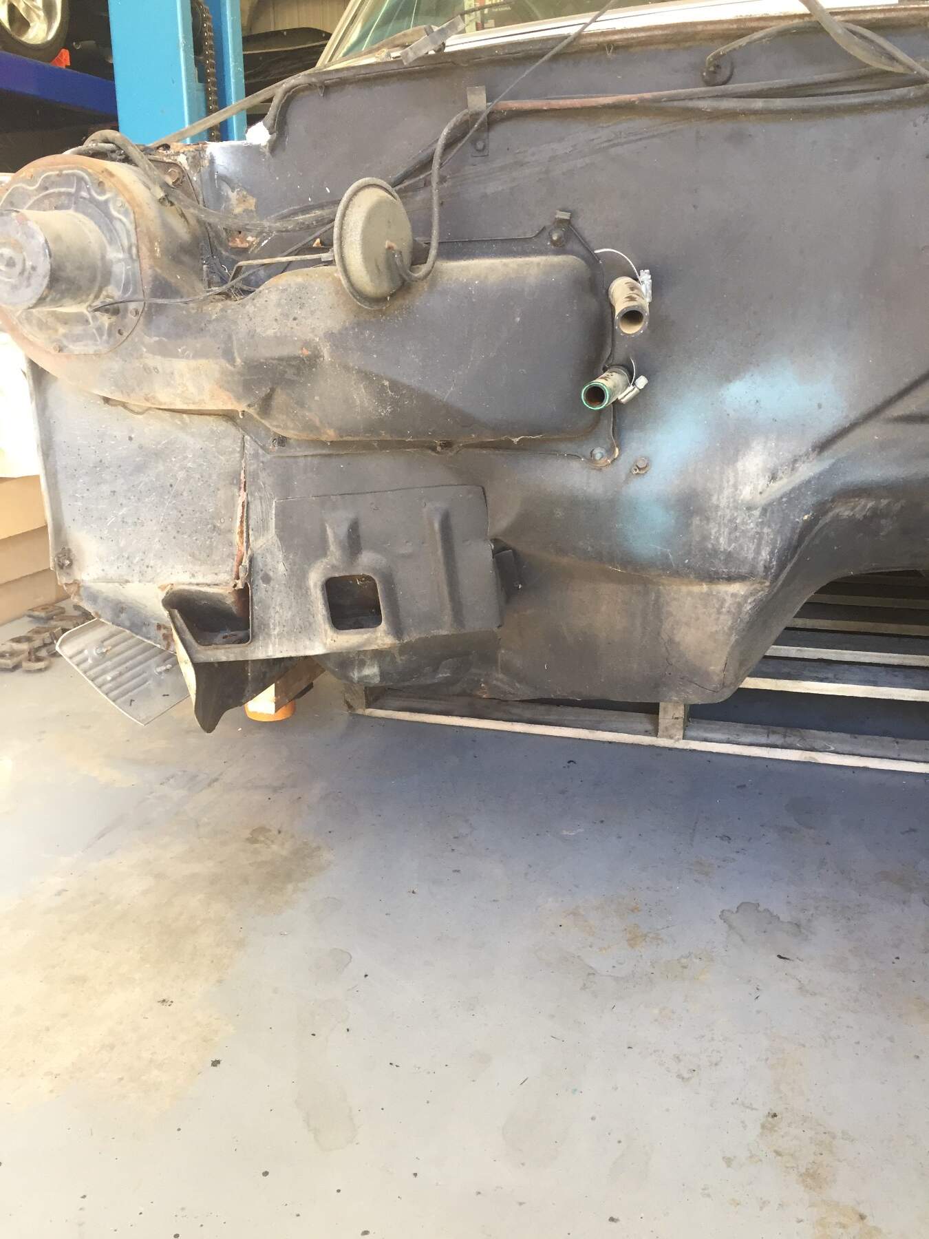

And this next picture is the mission for tomorrow.... you can see the big dent from where the chassis pushed the fire wall back and pushed the floor pan up.... shouldnt be too much of an issue and once done, i am ready to roll the pretty new frame under her.... weee heee:dancingpontiac:...

day 3 on the chassis replacement and i started by heading down town to get my rattle cans of paint, more sand blasting media and degreaser,
Now's the time to plastic gauge and check your bearings.  Best chance you will have to replace the oil pump, rear main.  How many miles were on the ticker when she was hit?
This is pretty much a summery of today’s work , it was a long day , messy as f-Ck
and felt like I got bugger all  done🙃
Yeah GM used the choke thing to help speed up engine heat up! Never liked it, never made any real cense! If it fails on the closed position that’s bad, but most of the time they just rust open! Then in time the cross shaft rusts through the shaft tends to fall out and the butterfly plate drops into the exhaust! If you’re lucky it sits parallel in the exhaust pipe, if not, it turns vertical and blocks off the whole exhaust. Long story short, get rid of it! Just drill & tap out the hole on both sides to the next closest size pipe thread and tap it! Get some Stainless Steel pipe plugs and seal them off. Just my two cents!
Thanks Last Indian, that explains why its there, it was frozen half open!!
both bolts to the flange had snapped off, and i am looking to buying the long branch headers from ram air restoration, i have emailed them as i couldnt get the order to work on line.
not going to go too far into it JustA, the car has only 86,000 miles on the clock and from everything i have seen, its looks to be true to that reading.
rear main doesn't appear to leak, had a look at the bearings and they look in good shape, bores look clean as from the botttom.
timing chain looks to be a little loose but i am not sure how loose they are supposed to be,
 i will check the clearance on the pick up, but wont change the pump at this stage, really not worried if i need to pull the motor in future, it may last for many more happy miles.... not that i will ever do too many miles, and if i did pull it out, i might just make it a way bit bigger😜

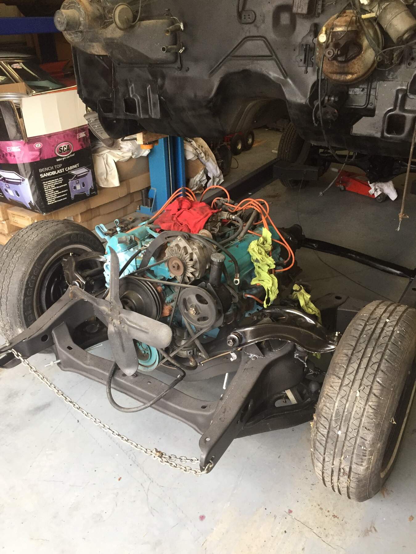

Engine into the new frame
with all new mounts 😀

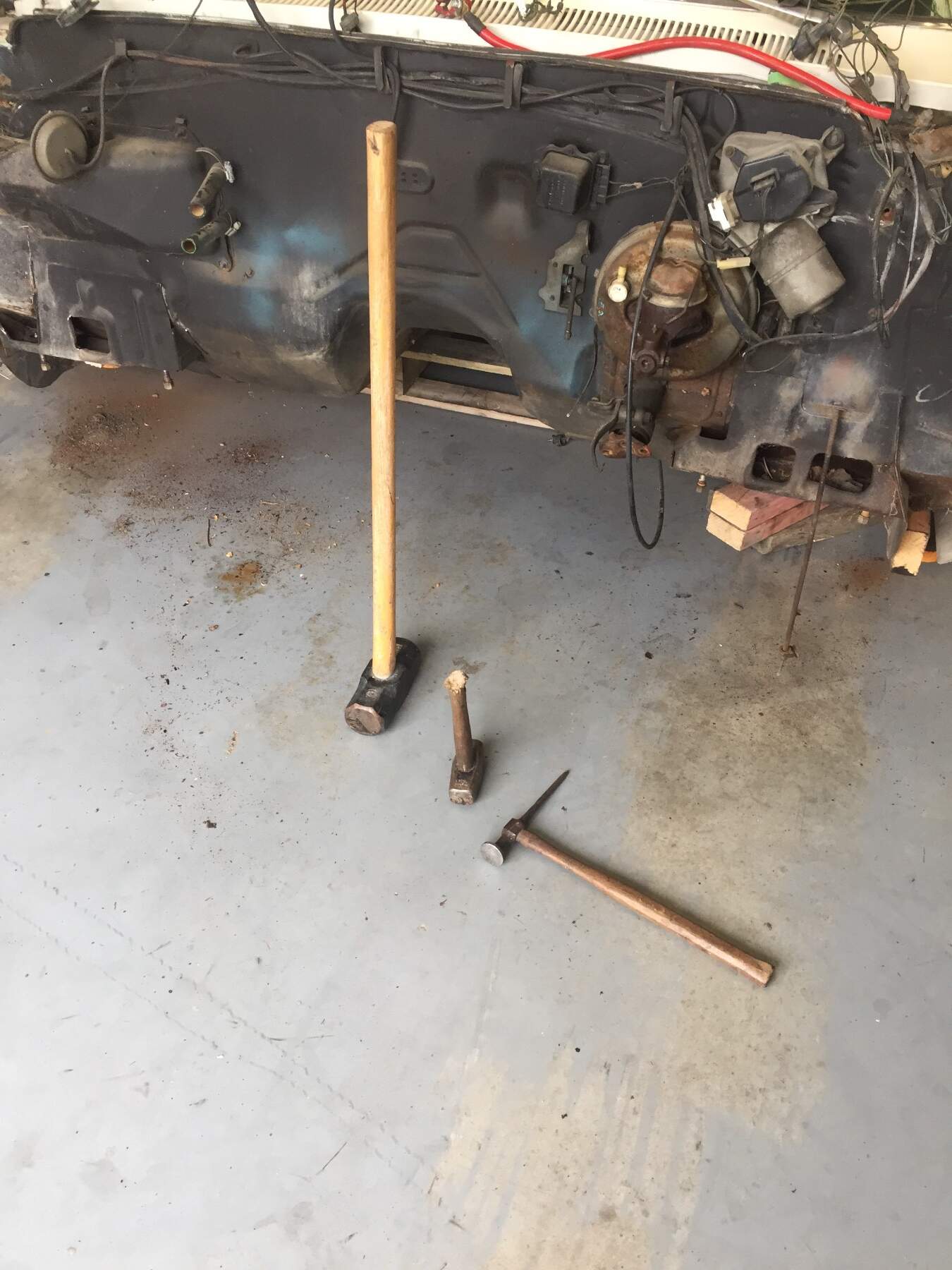

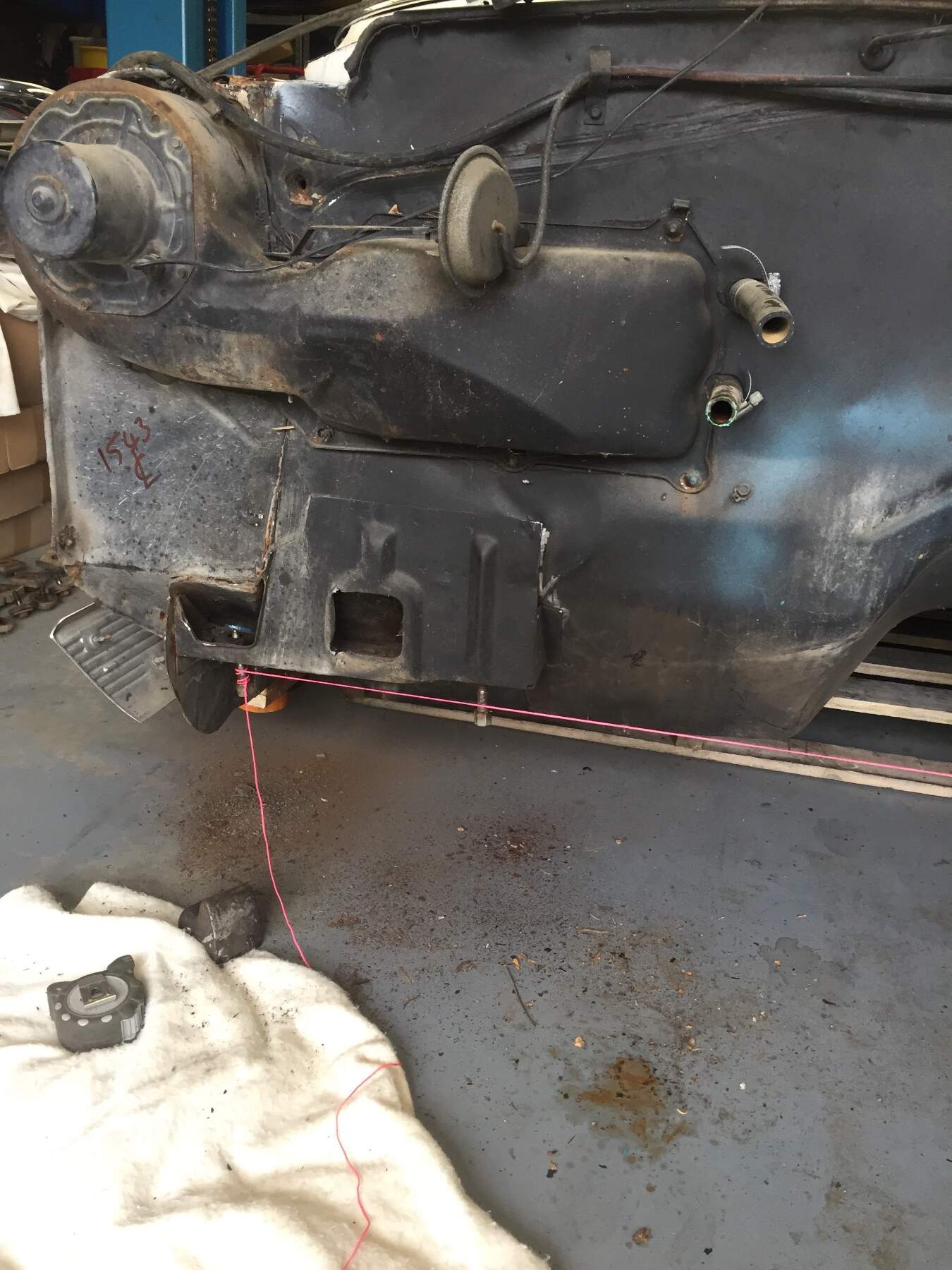

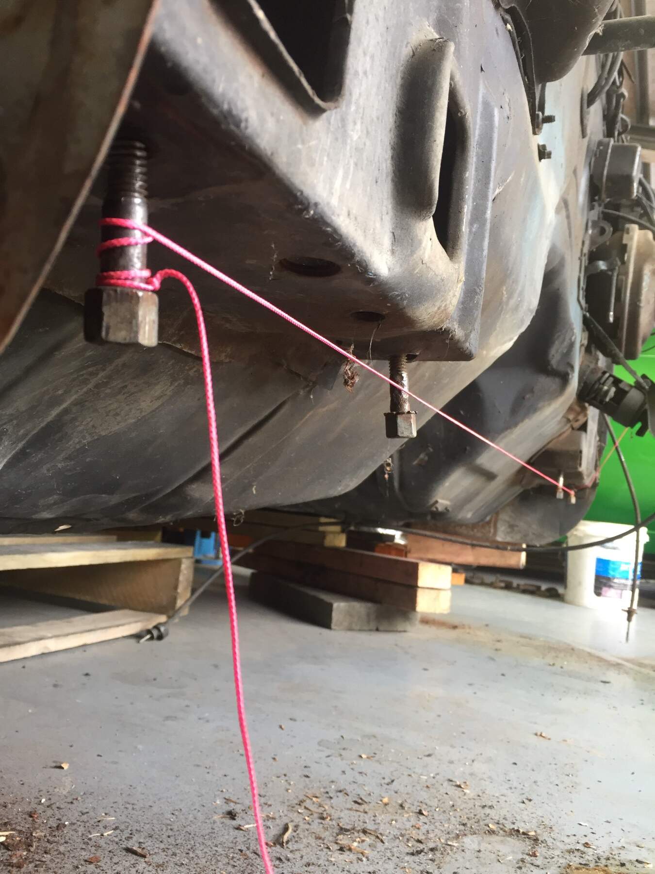

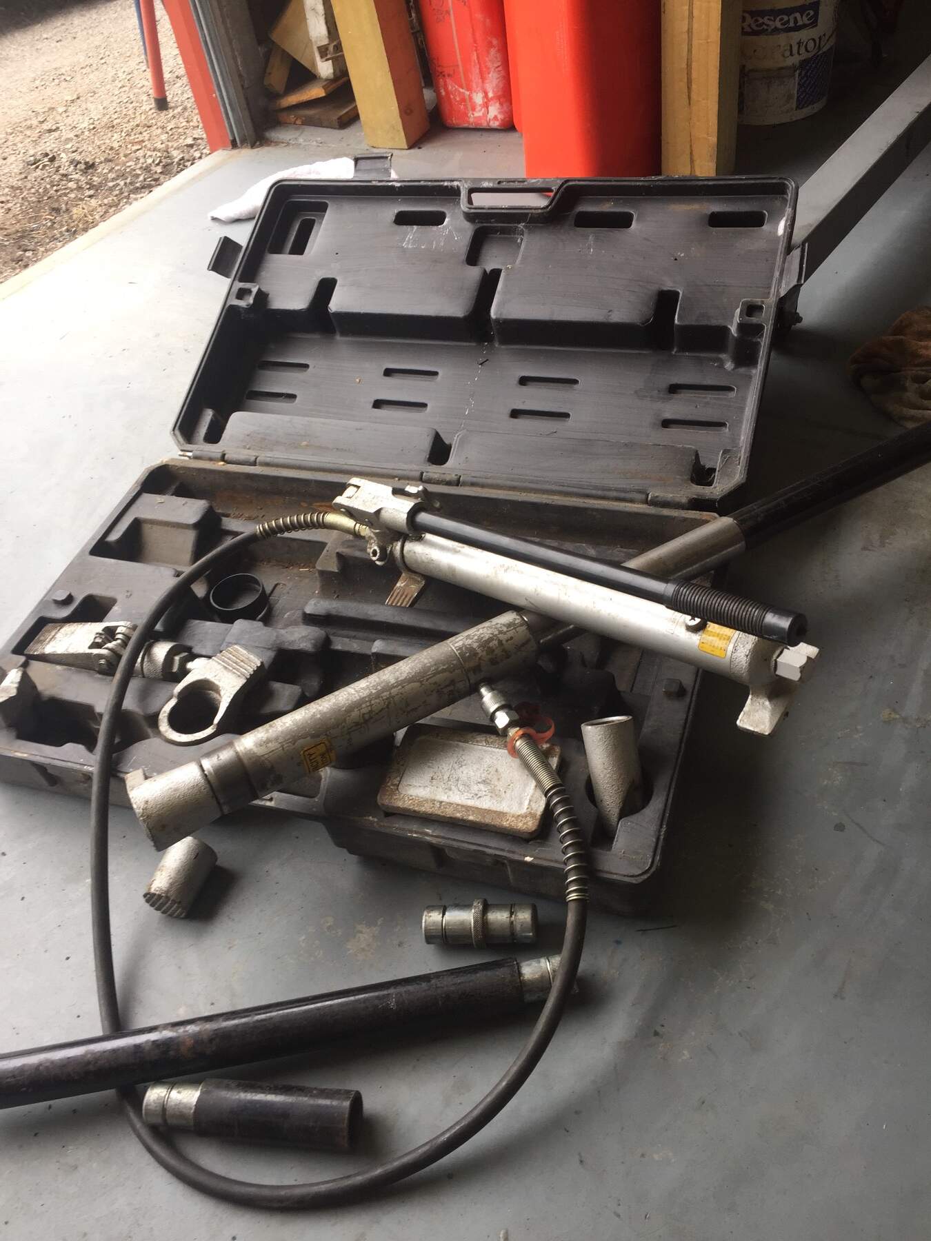

Sorted the big dent in the floor that you saw in the pictures from yesterday
Sounds like your mate owes you at least 2 beers :lol:. Looking good Kiwi. Looks like its coming together nicely.
way straighter
and the string line tells the storey 🍻
All thanks to my porta power
and 3 fbh.... (fu-king big hammers )
oh yeah! :dancingpontiac:
