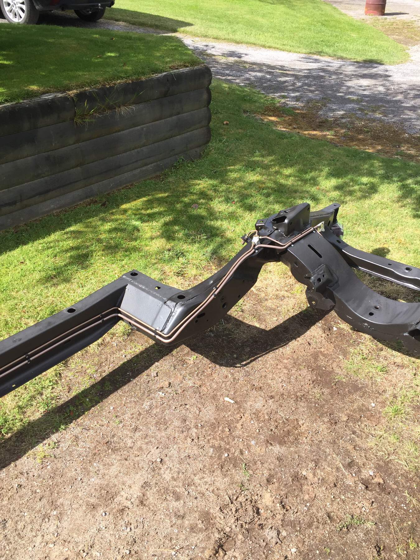

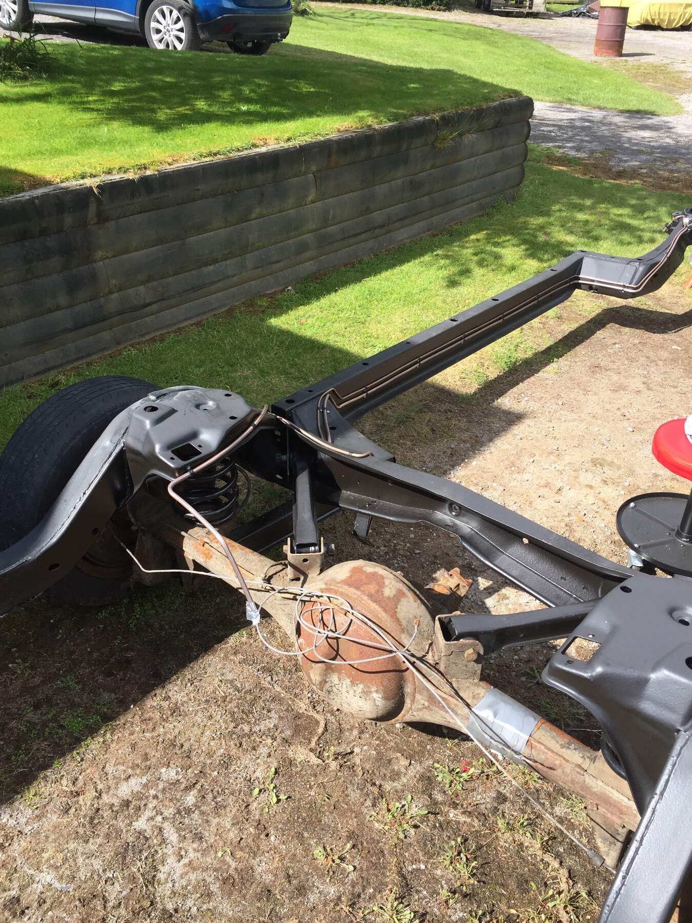

Brake lines completed
next will be a new 3/8 fuel line 👍

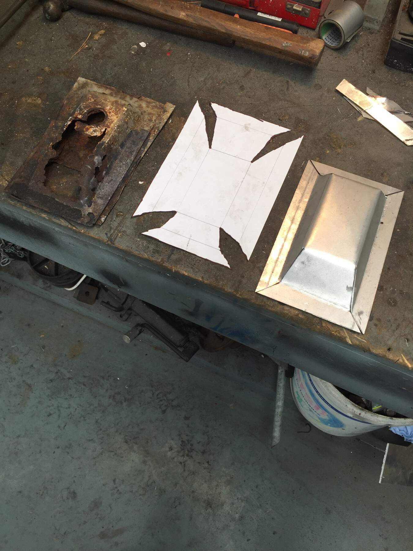

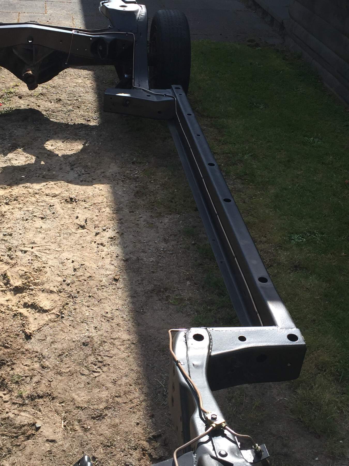

since I have been rained off this morning I got to making a pattern and folded up one of the two new boot floor pan supports that I need to weld in
at some stage,someone has replace the boot floor but missed putting the 2 supports between the chassis and the new floor just behind the rear wheels

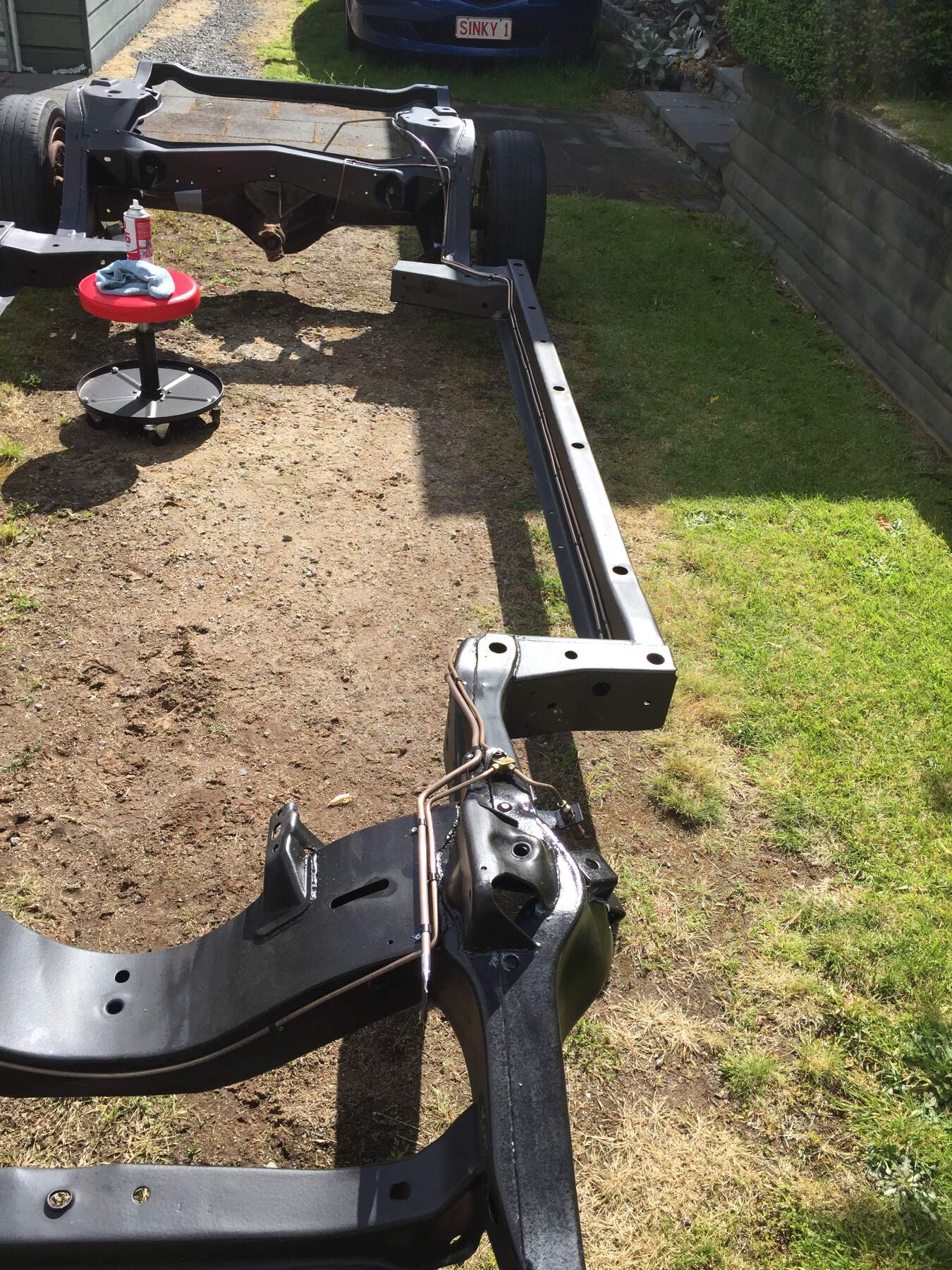

Suns out now so on went the fuel line
I just copied what’s on the bent frame
Nice work bro. Looks really clean.
So much easier with the body off.  Awesome job.

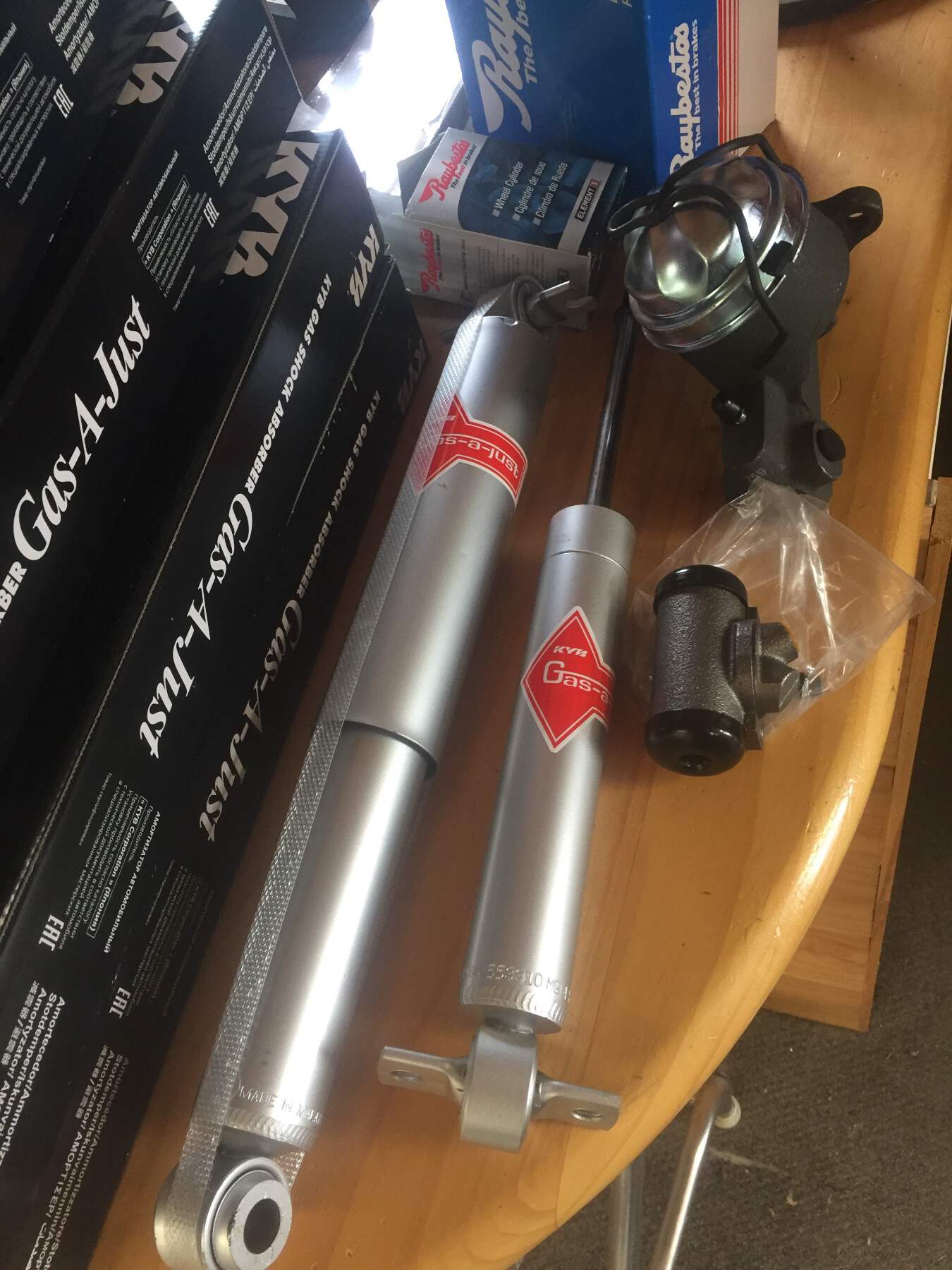

Ok, so like any naughty kid I justA had to check out my rock auto order:cheers:( dont tell the boss, guys)
master, 4 slaves and shocks for all four corners, but good  ones, and as Last indian recommended theses are the bees knees for good handling.... and watch this space, i think my modified springs and sway bar will help the 64 handle wayyyyy better. But hay she is never going to be a race car!:cheers:
