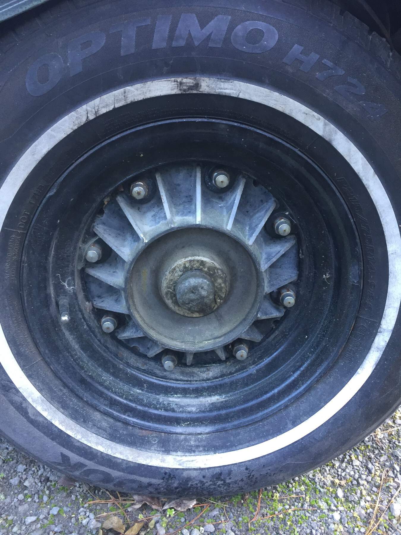

well as you can guess Frosty, they are really grubby and oxidised
 the black needs repainting then each of the blades that has a bright finish needs restoring.
i am guessing that factory would have had them in a lathe and cut/ polished that blade surface

Last Indian, i know your the king of aluminium, and you have seen, i have the factory "8 lug" rims on my 64
what are your thoughts on how to restore them ?
Well depends on what you want? If you want a factory OEM finish than they will need to go on a lathe! If you don’t care about being OEM correct than they don’t!
From what I remember, Frosty can set me straight one way or the other, the fins had a machined finish. So you can’t restore that correctly without remachining them! It would be a very light cut .010 to .015 thousandth, and I’m speaking just about machining the fin face, nothing more, but that requires a lathe and an indicator + a good machinist and a fair size lathe! But first you would glass bead them, not sand Blast! The first will clean then and strip the paint the latter will remove aluminum. The first will slightly brighten the second will tend to dull them.
If you don’t care about the OEM look, then glass bead the wheels. Than using a hand block sander, sand each fin up and down, not crossways, starting with 3M 280 wet and dry carborundum paper, then 400 grit, followed by 600, then 1200!
once that’s done the fins should have a nice Reflection when you look at the surface on an angle. The next two steps will bring out the mirror look! Using an SOS pad, blue soap steel wool pad and water, polish the fins up and down. Make sure the steel wool stays heavily soaped. That will give the fins a glossy mirror look. Finally finishing with my favorite metal polish, Happich simichrome polish! I have used a lot of hand rub metal polishes in my life and for me none come close to simichrome! If you don’t have access to SOS pads or the like you can use plain fine, not course, steel wool pads covered liberal with a liquid hand soap and water. Just don’t use as much water.
Than when you are all done you can paint the areas you want to paint!

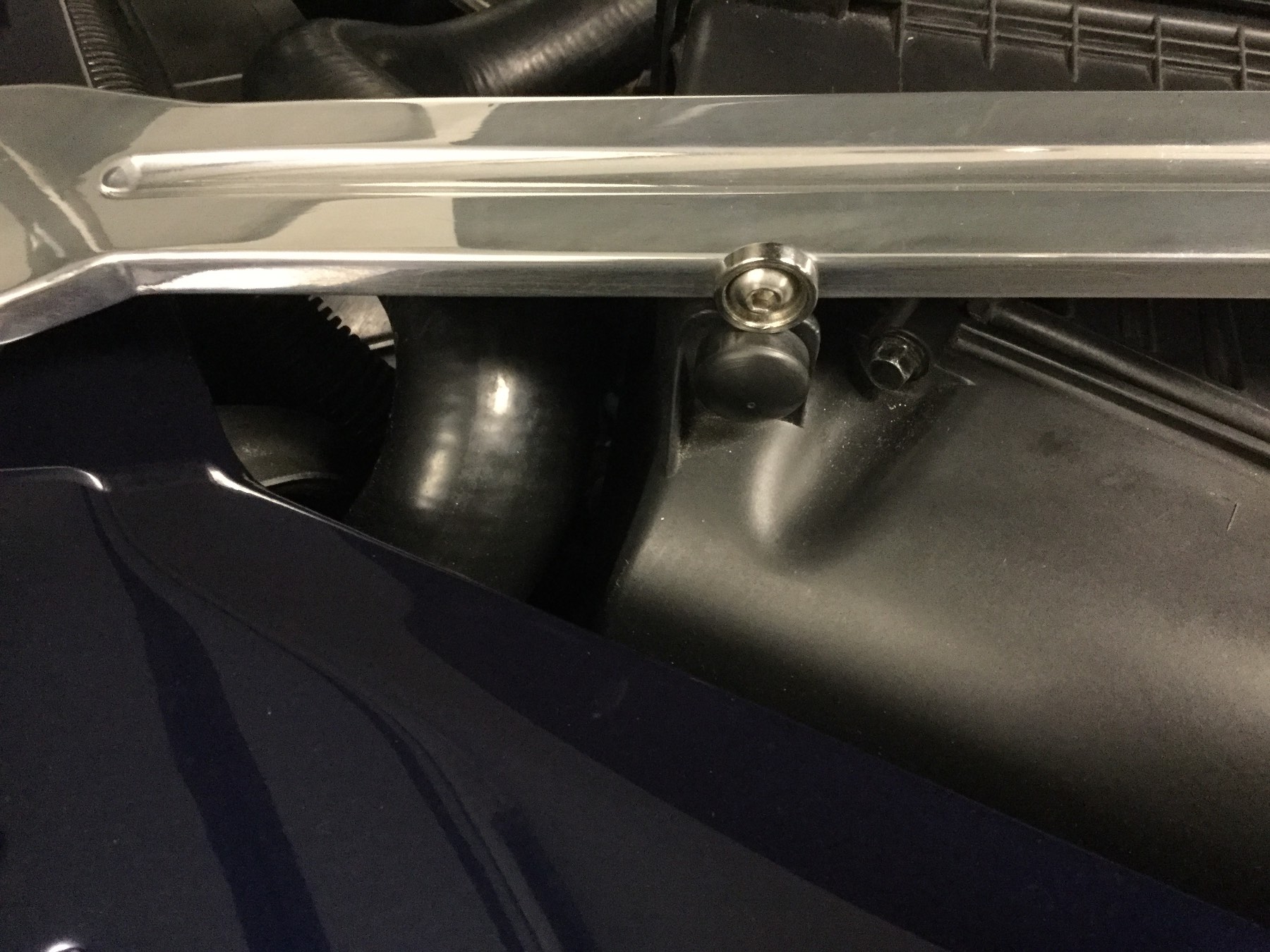

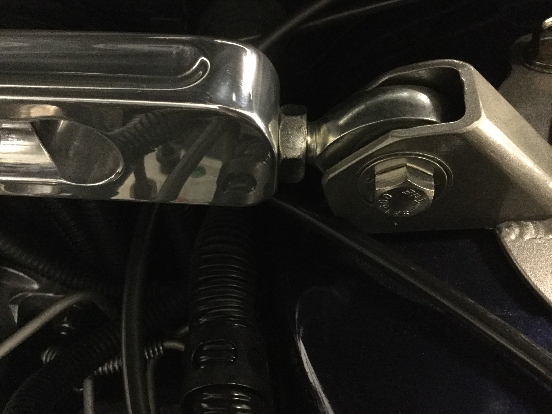

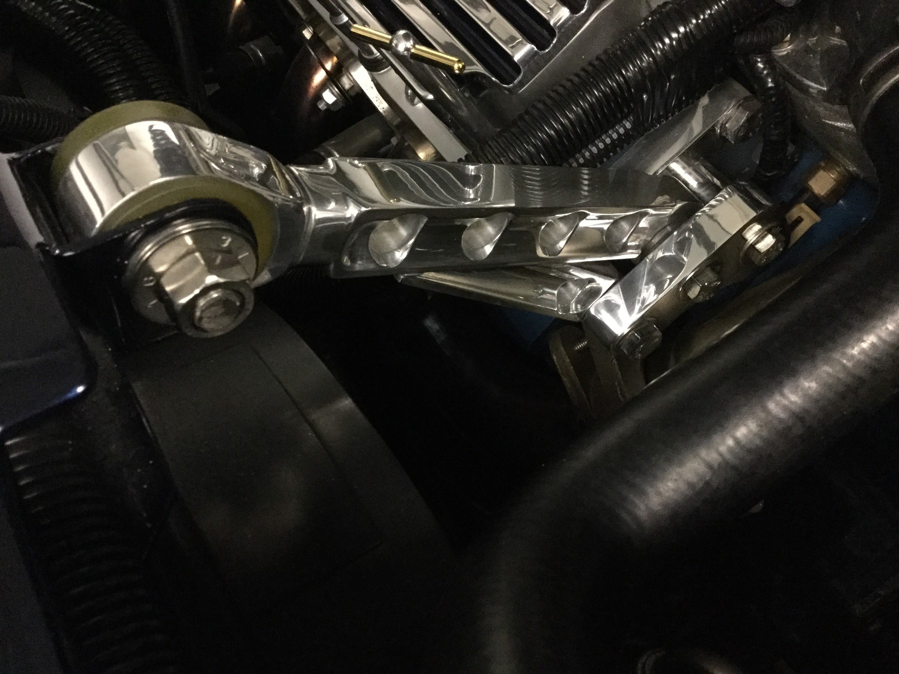

I have an indelible habit of looking at mechanical applications with a restructuring eye! So every car I’ve every owned and especially those I built, I always see things that I ask why? And then I have too change it. So I think you’ve seen some of that and I know it’s really hard to see it from just a picture! So I thought In some small manner you might like to see the level of detail that goes in to some of my stuff. Since you noticed the level of effort for the plenum cover to get air in to cool it from the hood!
The top motor mounts foe instance! These are so far removed for the original OEM product! Completely changed the mounting location. The factory version had the rotational arch of the motor wrong which really allows way to much movement, which cost a considerable lost in power to the ground and an inherent problem with bracket breakage. These mount allow almost no movement, but without engine vibration transmission to the car body!
The strut brace! Most of them don’t use heim joints and those that do are round! The purpose of a heim in that application is to allow some lateral movement while stopping in and out flex in hard cornering! Heim joints allow that, but round bars can buckle under excessive loads square or rectangular bars don’t!

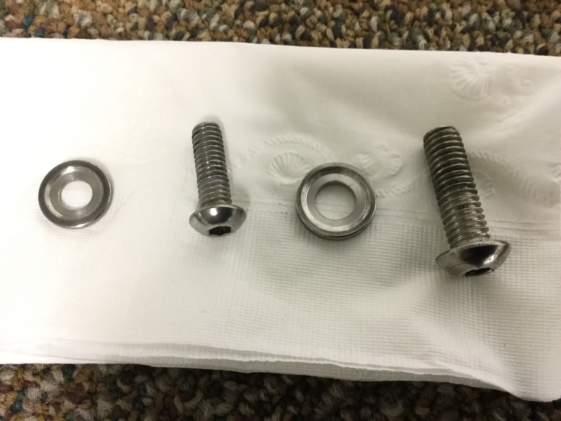

every single SS buttonhead bolt has a hand machined encapsulating washer made for its size.

I am very impressed mate, the detail is outstanding and very interesting what your saying about square rod stronger than round on strut braces:cheers:
What material have you used in the rod end, to body mount ?
The plate the attaches to the three strut bolts I assume you mean? That is 10ga. 316 stainless steel that is sandblasted and painted. I should also include that the bored holes in the aluminum strut brace actually make it more difficult to bend in deflection, plus it makes it lighter.
Ah sorry mate, i was looking at the engine mount and the soft material you have used to bush the mount to the body
Oh that stuff! That is 70 durometer polyurethane machined to fit the machined end of the Aluminum motor mount!

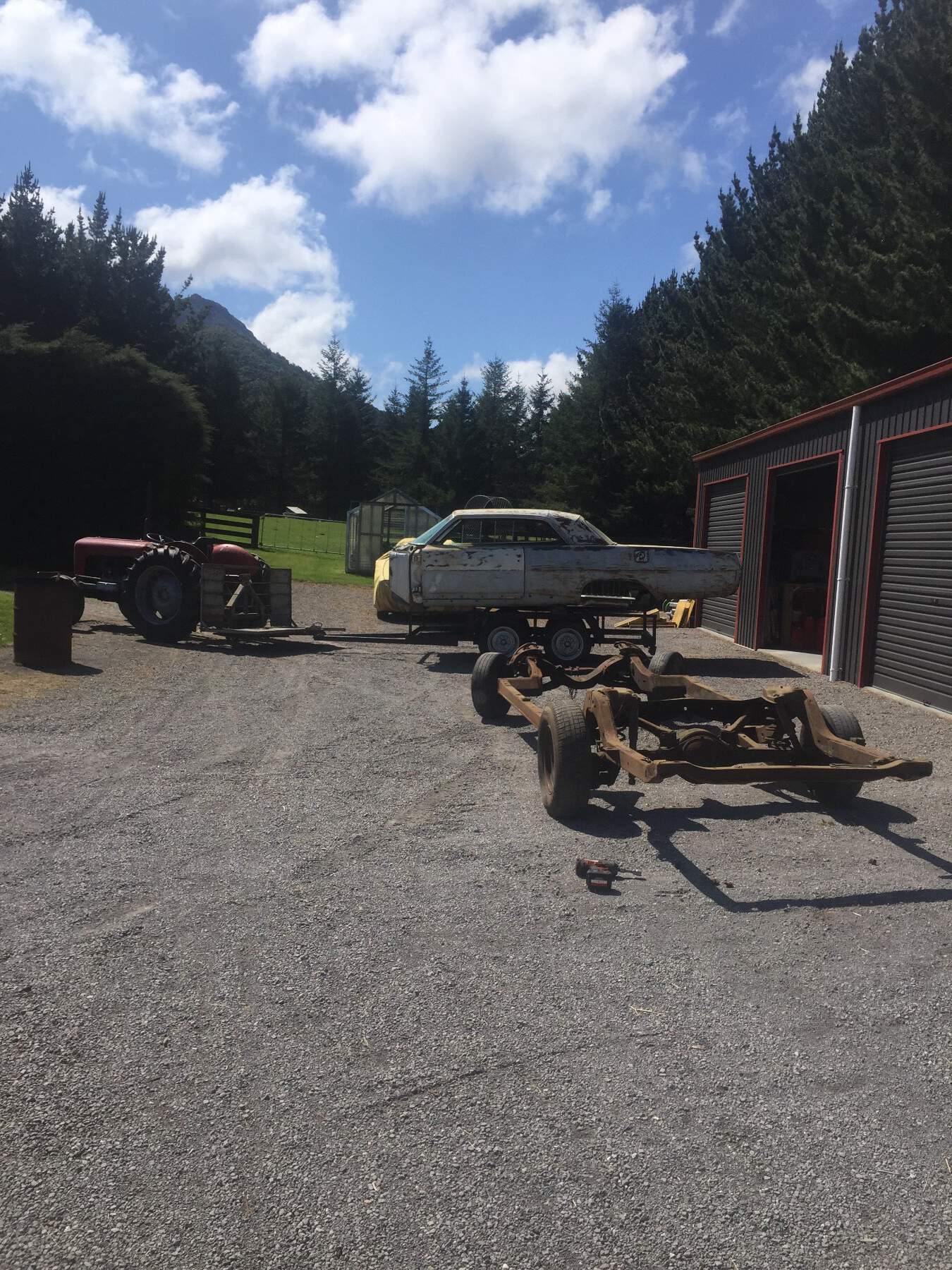

And i have come up with a plan on when i remove the shell from my donor chassis, i am looking to buy a cheap trailer and drop the spare shell onto that after lifting it off with my 2 post hoist.
 That way i can hook the tractor onto it and put it away somewhere safe for now... well thats the plan, i do have a trailer to go look at Monday that may suit the job, he is asking 600 notes for it but we will see🙄

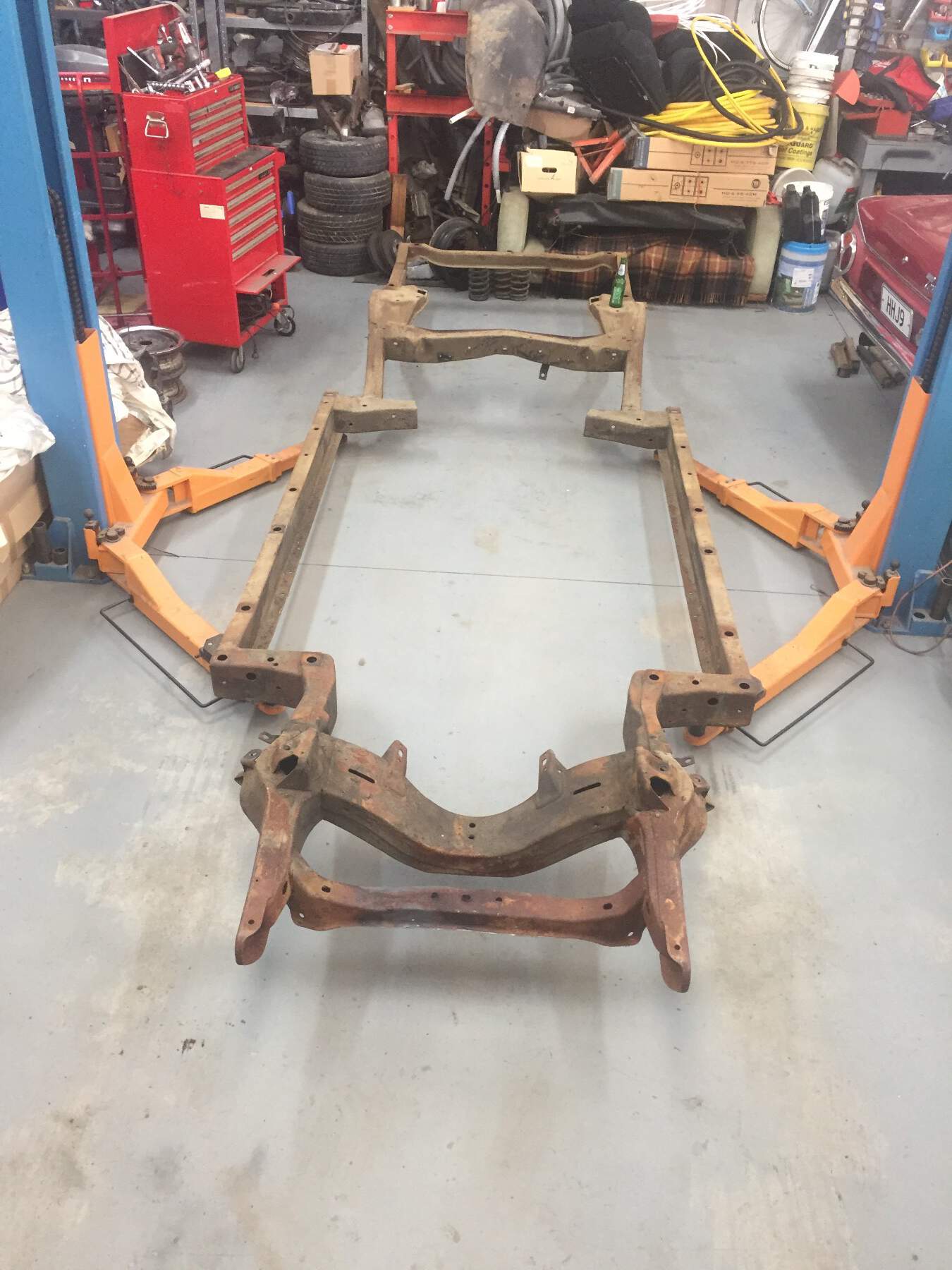

My plan is to pull chassis from under the doner 64............. watch the space!:cheers:
Justa6... get the cinder block ready , we will need 4 please mate, and 2 boxes of beer 😜
pictures to come.:cheers: but for now its beer o clock !!:cheers:... its friday and i have had a shit week of crawling, digging plunging and i am justa over the fact that for some crazy reason we are justa flat stick, and have been since we got out of lock down back in may :stars:
Good luck to you Kiwi. Justa don't be crashing anything on your head! We don't want the beer to go to waste! Priorities! :cheers:
Mmmmmm more naughty car pics! Cant wait! lol :dancingpontiac:

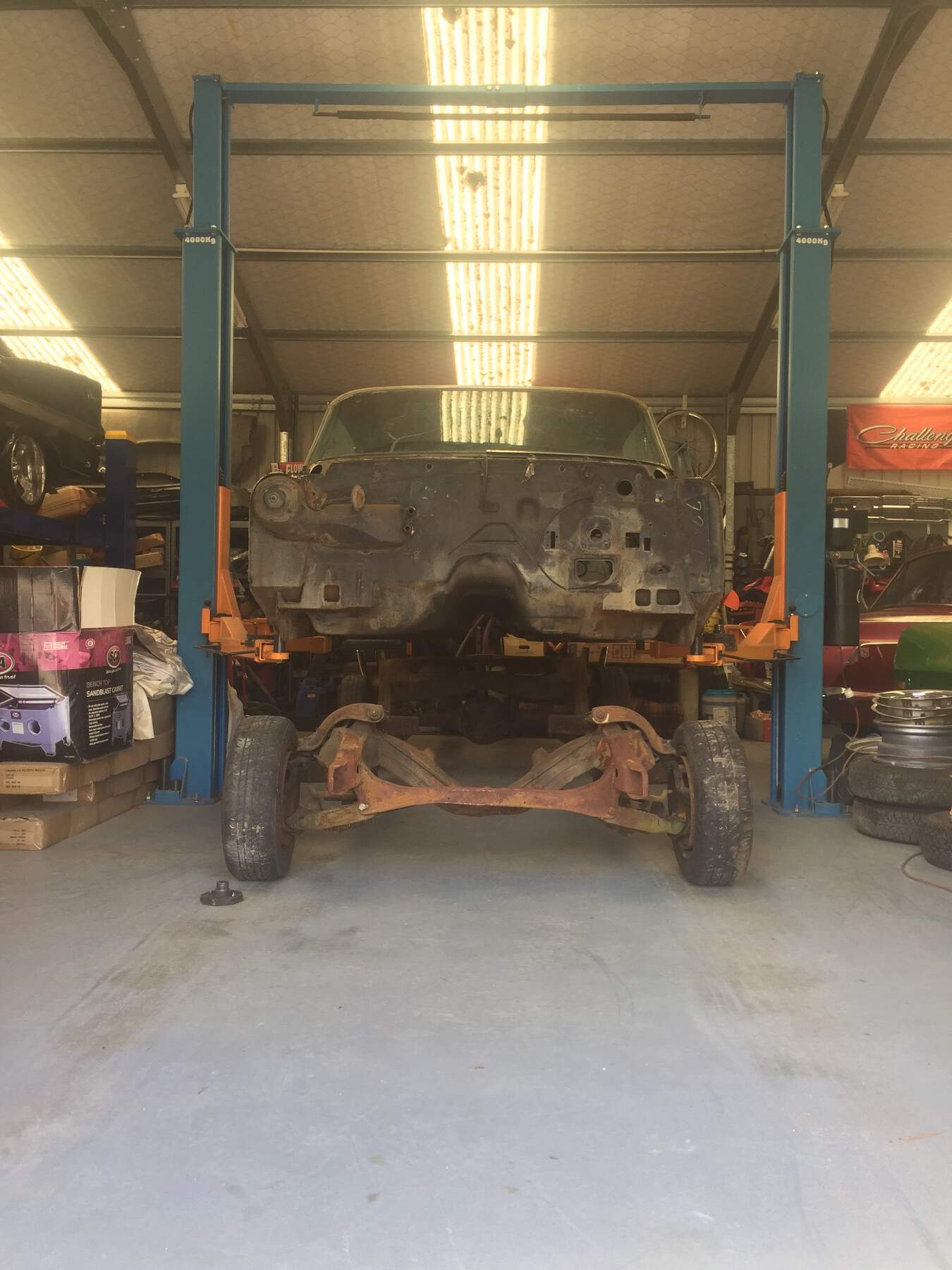

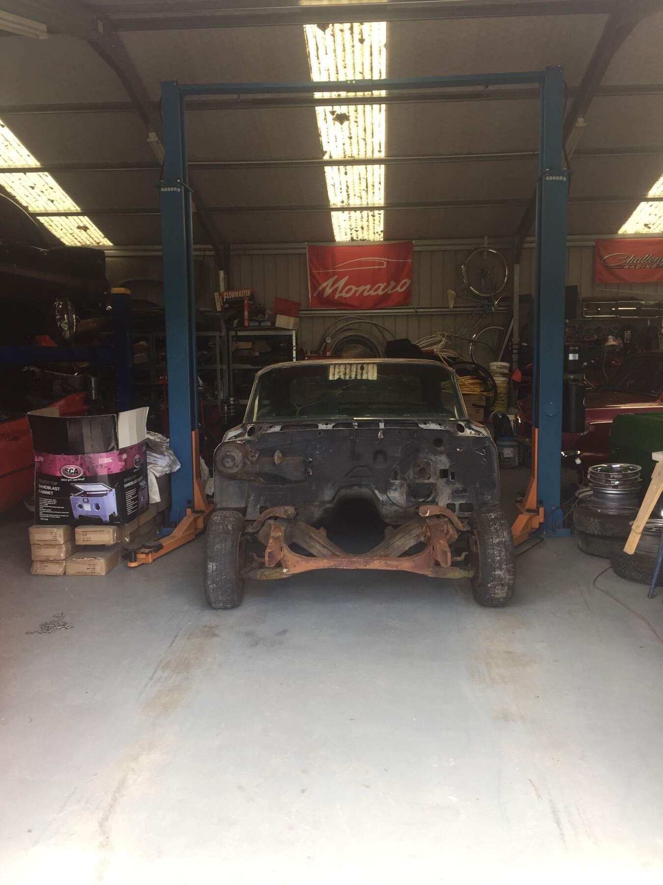

Ok lads on the count of 3
One
Two
three !!!
Thanks for the lift guys :dancingpontiac:
CHEAT......  No cinderblocks???? :willy_nilly:

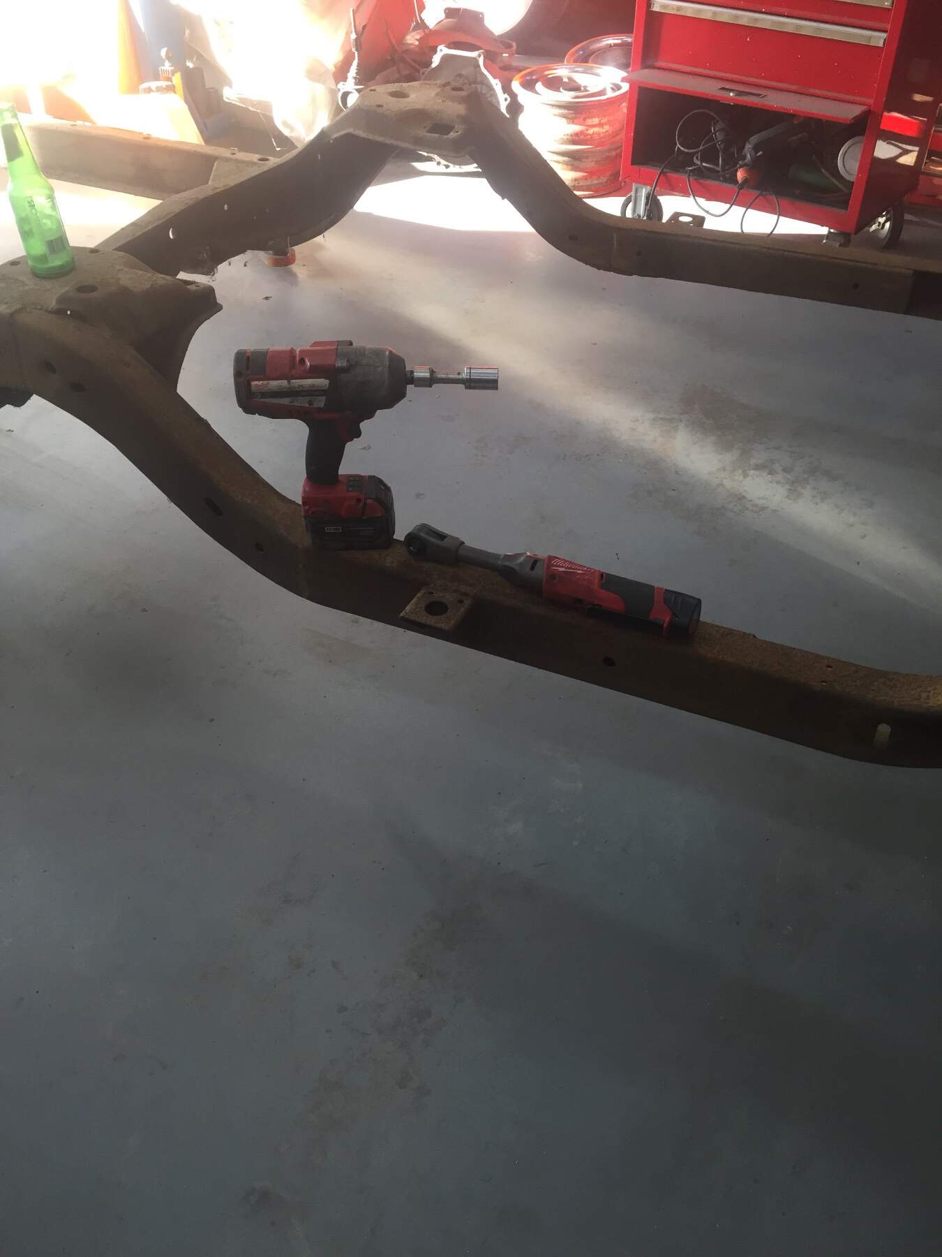

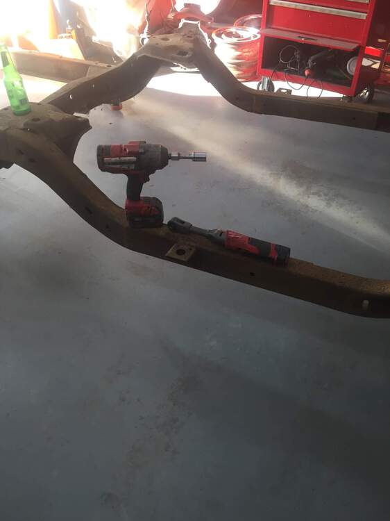

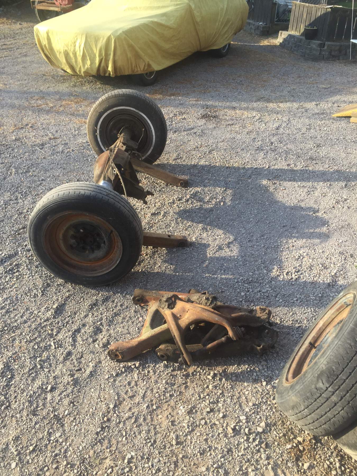

And with the help of some really cool tools that I have never used to strip a car before
i kneel to mr Milwaukee :bowdown:
these 2 have saved me many hours 👍🍻
Time for a beer and think about cutting the ball joints off the A arms tomorrow

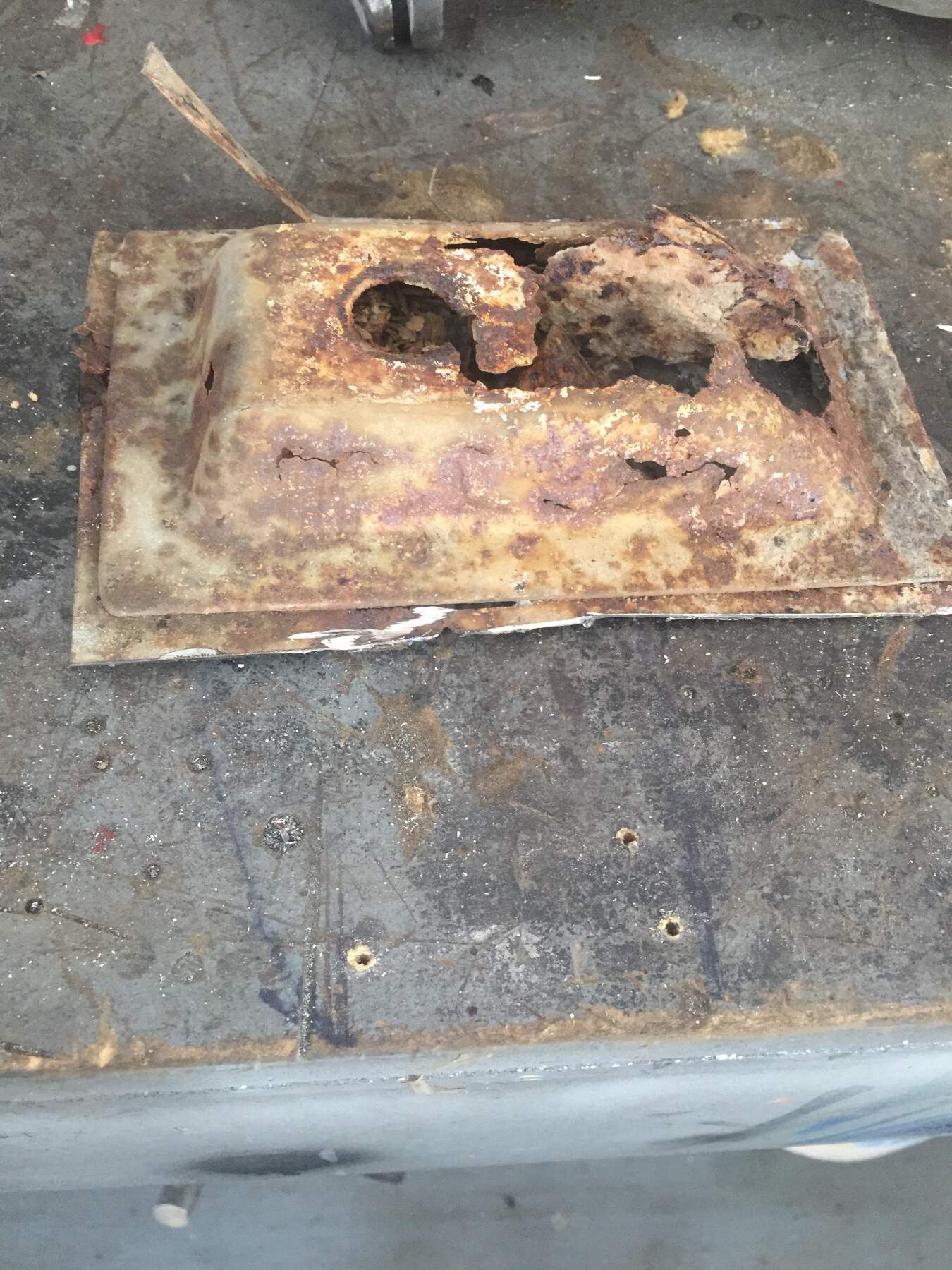

I cut this mount out of what was left of the doner 64 boot floor so I could copy it .
who ever replaced the floor in my girl didn’t replace these and so there is a mounting point that has no fixing😯
i will copy this x 2 and fit them to the underside of my girls boot floor

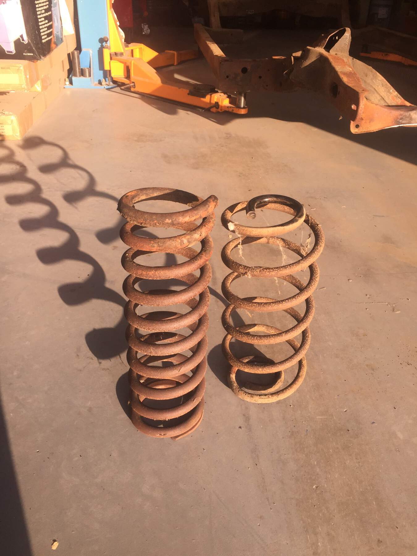

Check out these springs !
i will send them of to my spring guys and they can make me a new front and rear set
but 2 inches lower..... that’s my starting point
21st century stuff Justa 🍻
and I have done it your way myself before too!!!
you need a hoist mate 👍

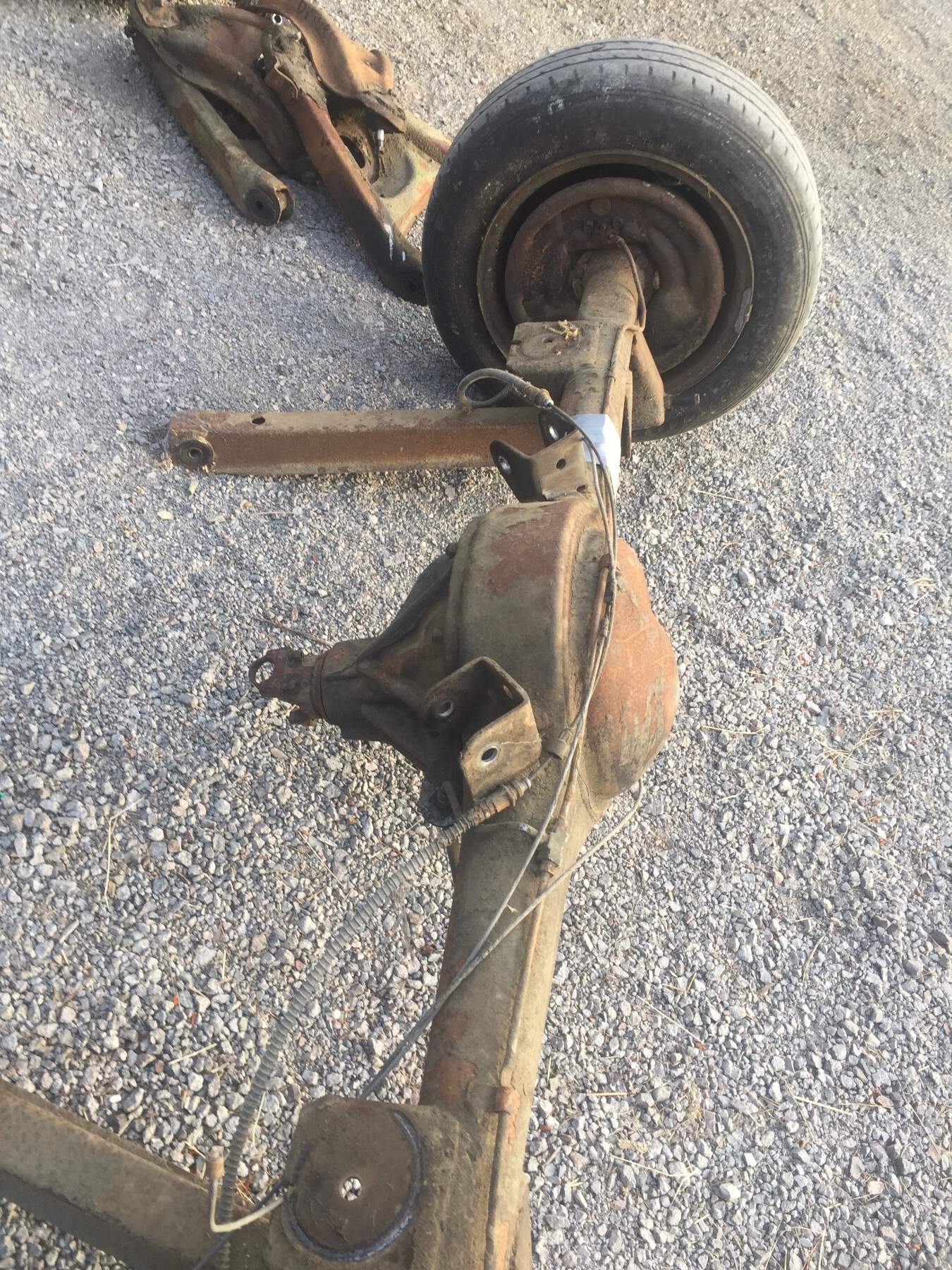

I would really like to know about the 64 diff 🙄
if this was a Chev it would have a tin back and be a 10 or 12 bolt
this diff is solid back and is wayyyy bigger than a 10 bolt
hopefully someone can enlighten me 😎😎
