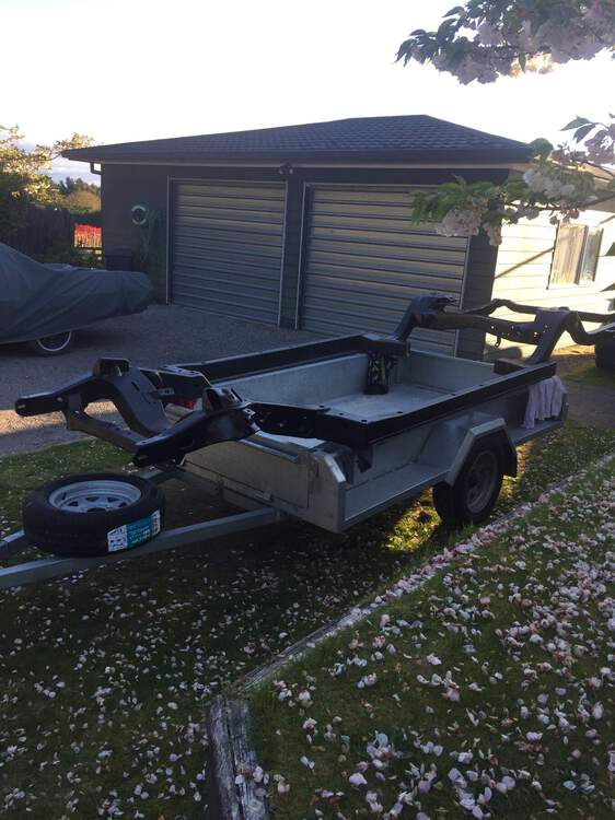

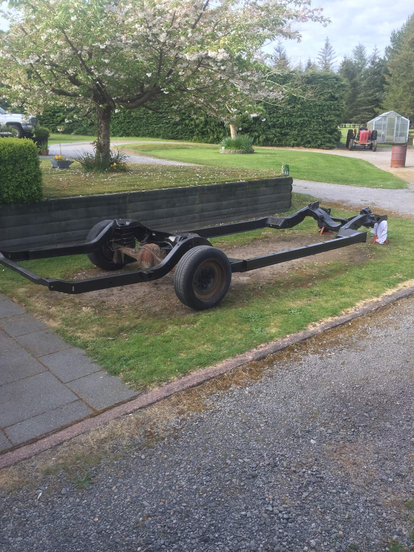

Ah and before you ask frosty, no, its not snowing here in new zealand!!, thats spring cherry blossom on the groundΒ πŸ˜€:cheers:Β
Second winter bud. Mine happens in June/July when the cottonwood starts flying. My whole yard practically turns white.

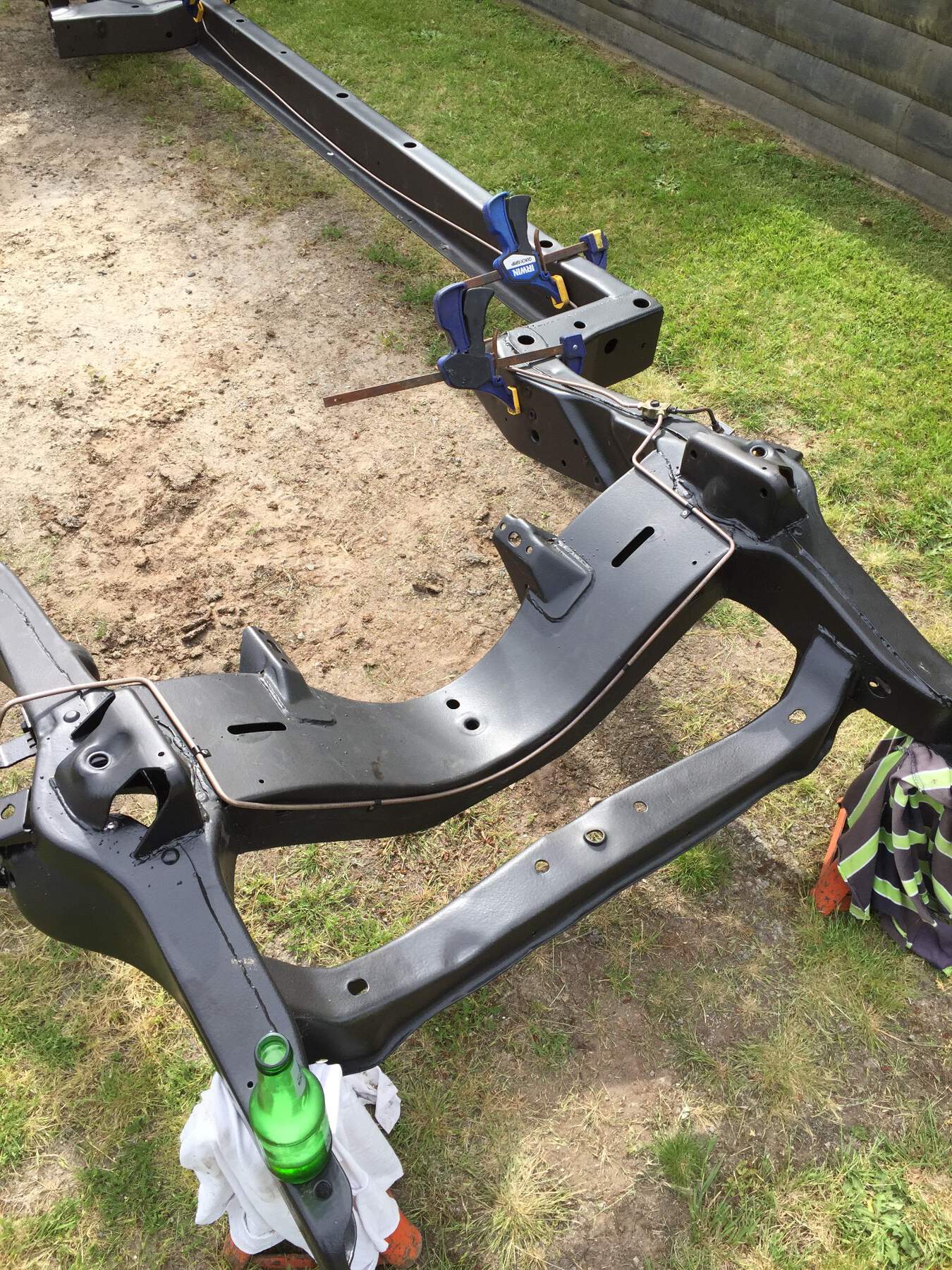

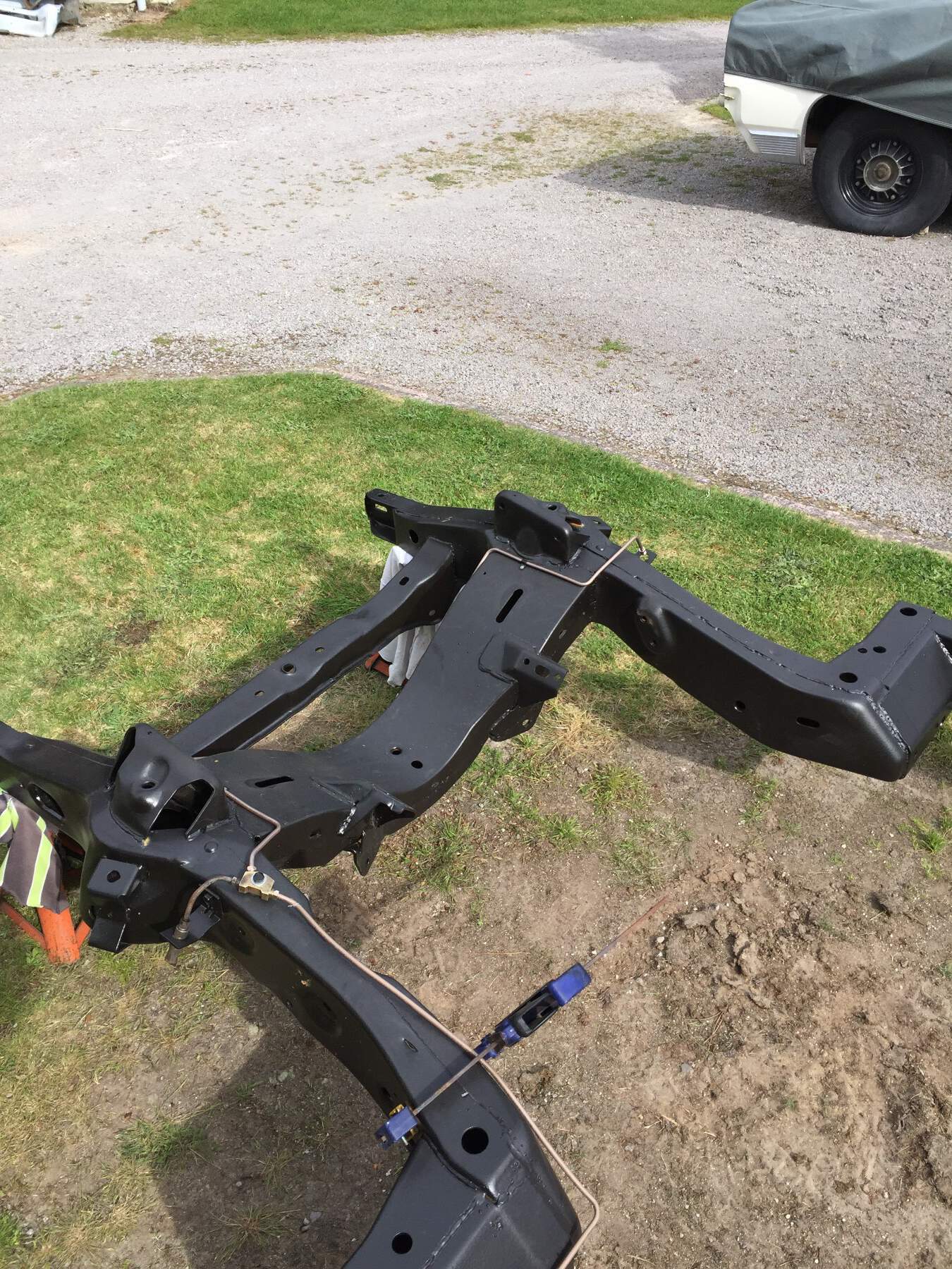

7 hours ago, Frosty said:

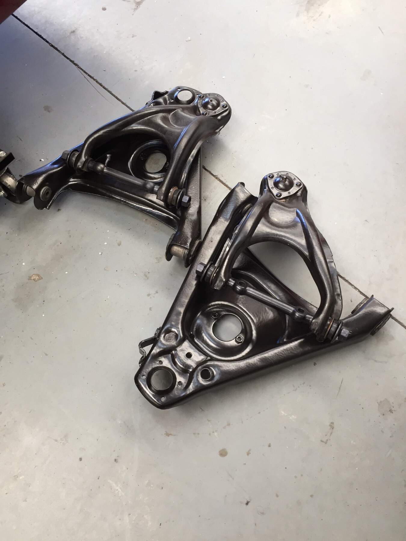

Cool chassis porn bud. I'm jealous. The finish on the control arms is first rate!

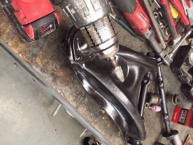

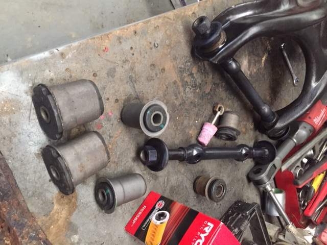

When i got the chassis and AΒ armsΒ sand blasted /Β epoxy coated they covered everything! including the holes where the bushes press into....
Β my fault, i should have told them to mask, barrier these off, i didn'tΒ πŸ™„Β
so i have had to sand/ dremilΒ off the coating on the inner sections of all 8Β bushings... NOTE TO ANYONE READING THIS IN THE FUTURE, HAVE THE BUSHING HOLES MASKED/BARRIERΒ OffπŸ‘

And the epoxy coating is really hard!!:unsure:, i am super impressed:dancingpontiac:

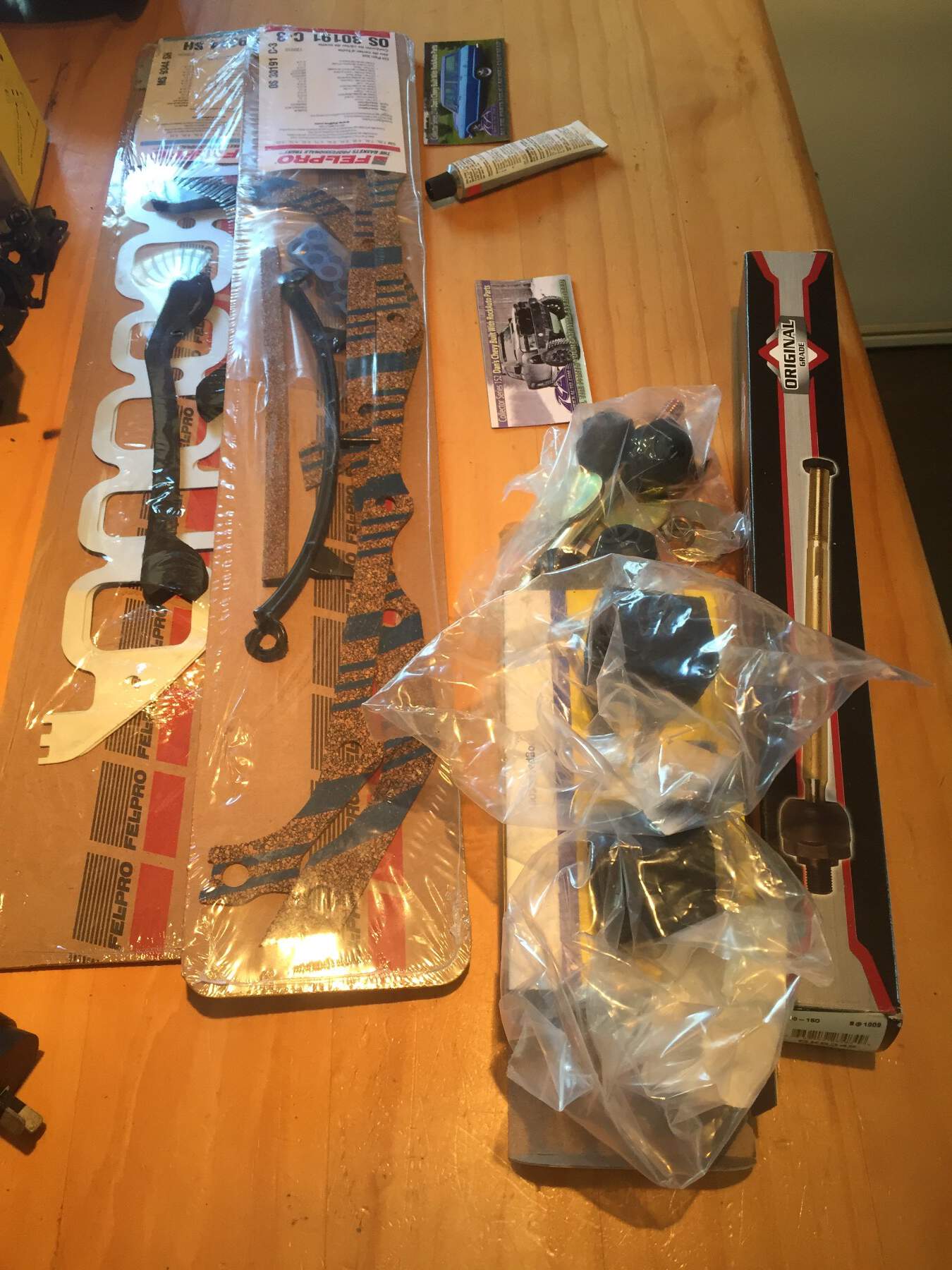

More early Xmas presents arrived from rock auto todayΒ
sway bar bushes. And connector bolts and bushingsΒ
a new intake gasket for my 313 poly in the 59Β
and sump gasket set for the 389Β
and what a bargain !!! $5.50 usd for each gasket set πŸ‘πŸ‘πŸ‘πŸ‘πŸ‘πŸ‘

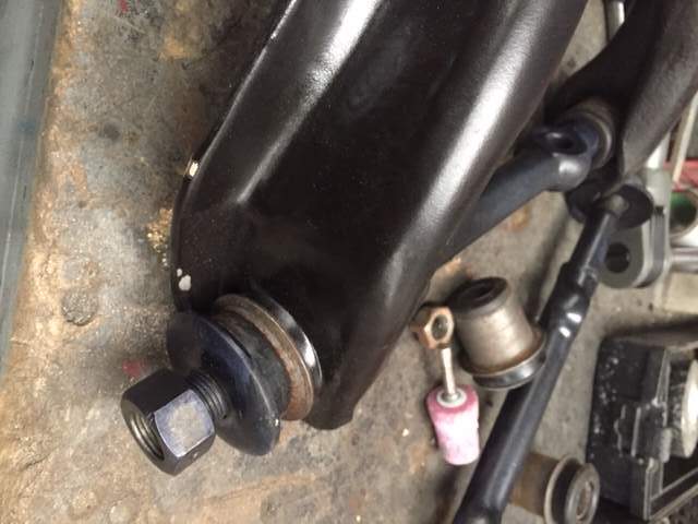

Got all the bushings pressed in todayΒ
And with all my a arm bushing jobs, i leave the nuts loose untill its all assembled and has sat for a little bit to get a true zero before buttoning them up!
 i learnt the hard way when i did the bushes on my first 56 chevy many moons ago!!! and tighten them up straight away then the springs settled and screwed the guts out of the bushes:rofl:😞🀨
Well that's a good little tip Kiwi!

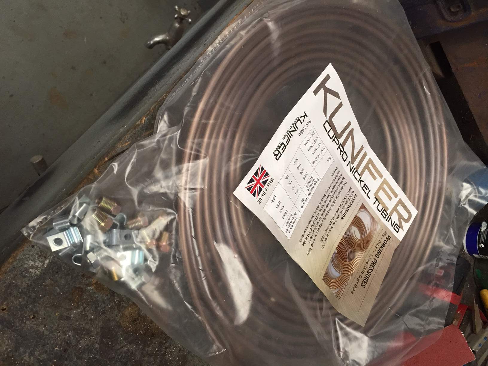

iΒ  have all the parts to plumb my chassis brakes,Β now all i need is some time to do itΒ :cheers:
Β fingers crossed SaturdayπŸ™„
Kiwi, great choice! Too bad they didn’t have this alloy of brake line material available back in the day!Β πŸ˜ͺ
Yes mateΒ
I have used this before and it’s really nice to work withπŸ‘
