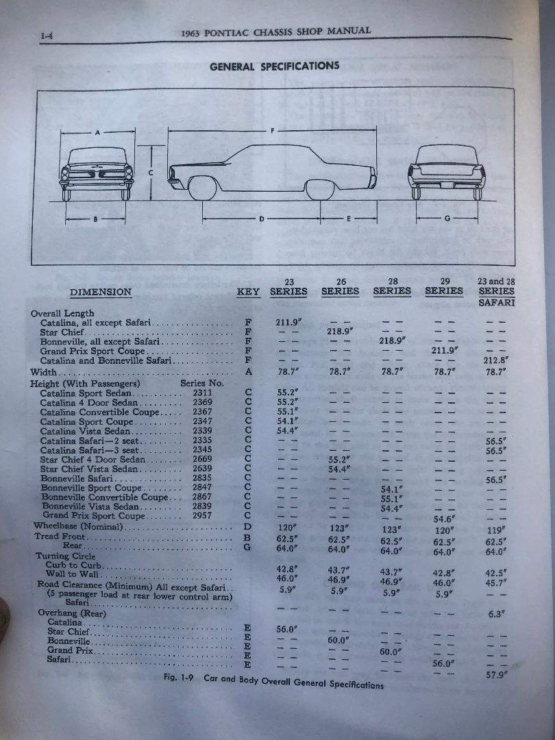

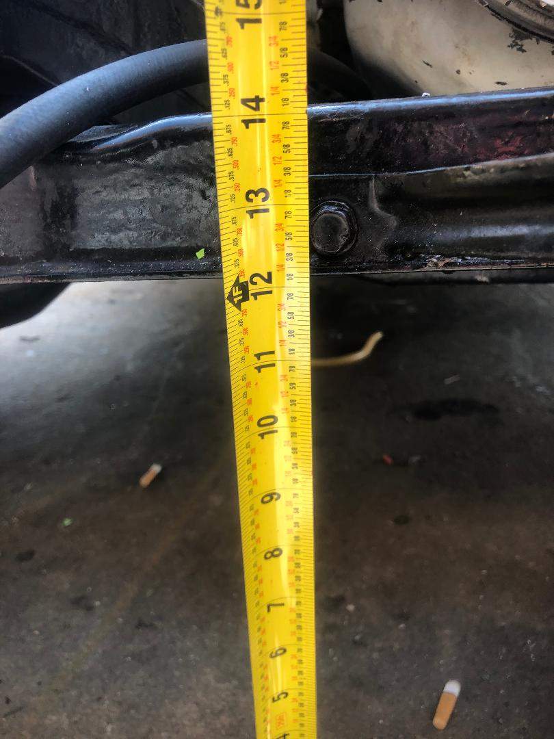

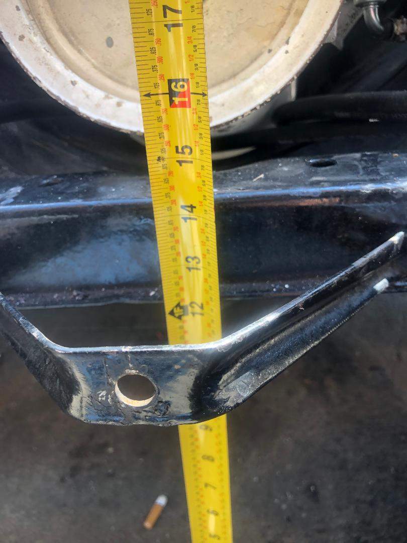

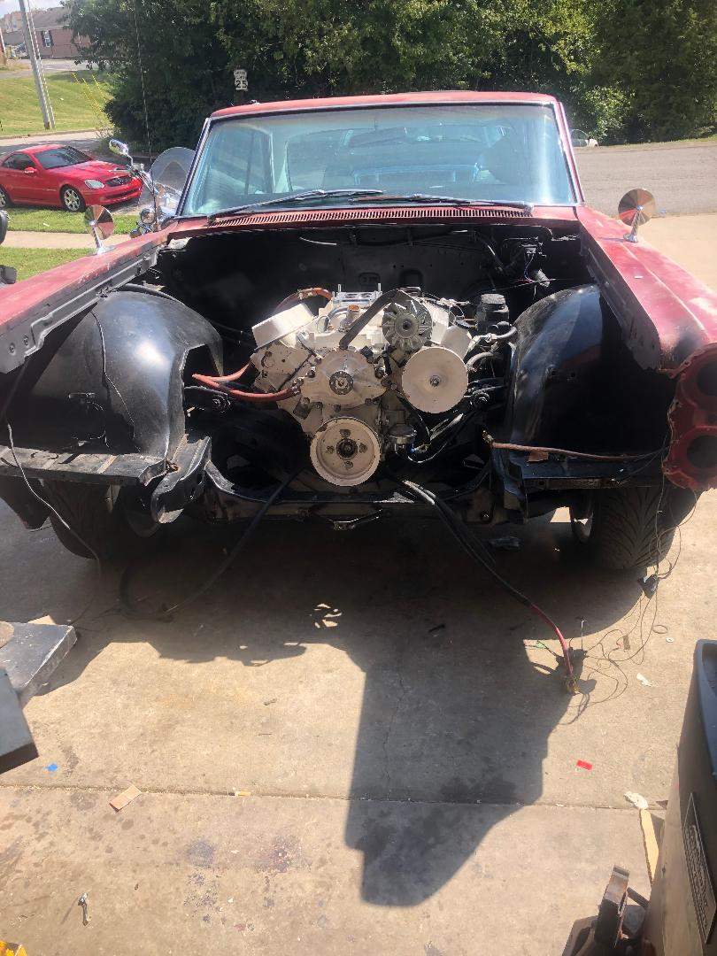

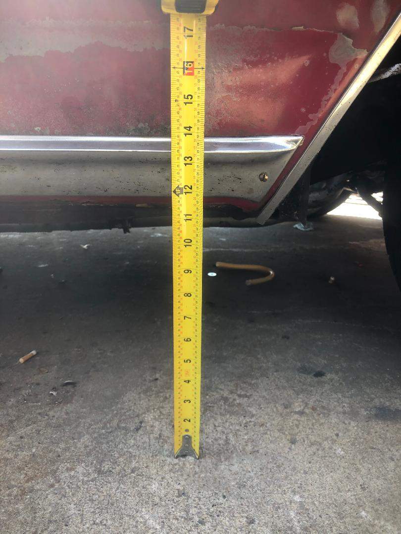

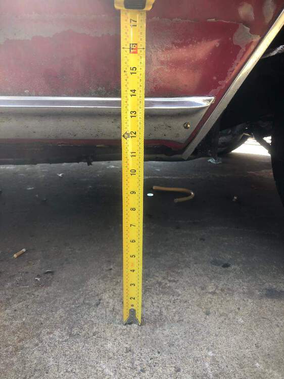

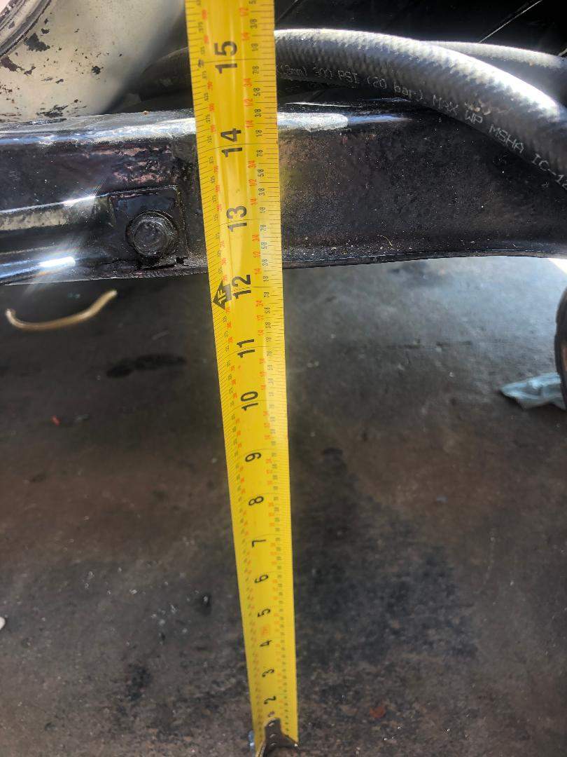

Hey bud, my cars still on the jack stands. Hoping to have her on the ground today or tomorrow and I'll measure frame to ground for ya.

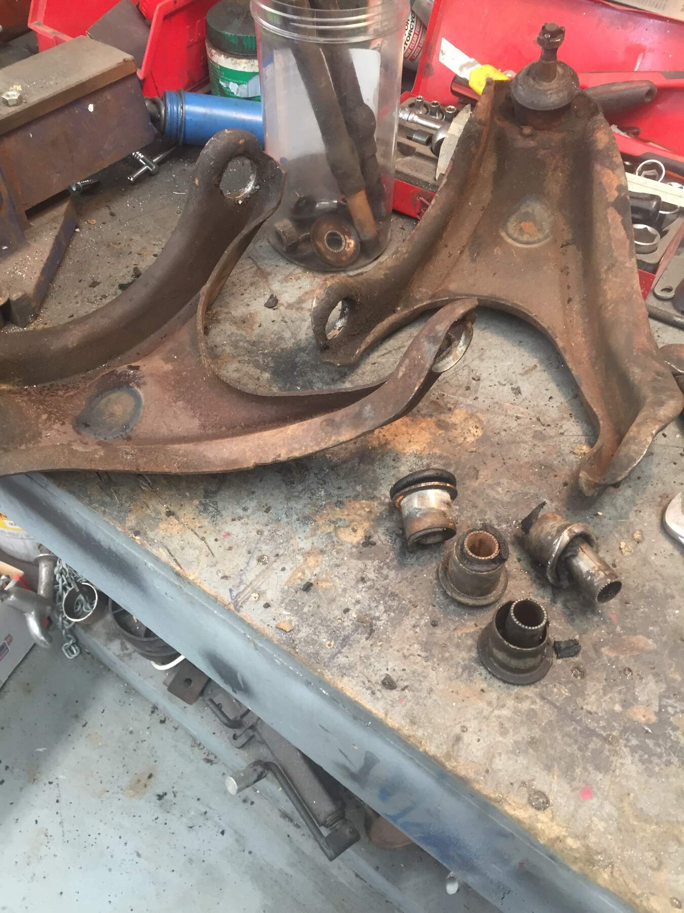

Got the ball joints off and pressed out the bushings ready for sand blastingΒ

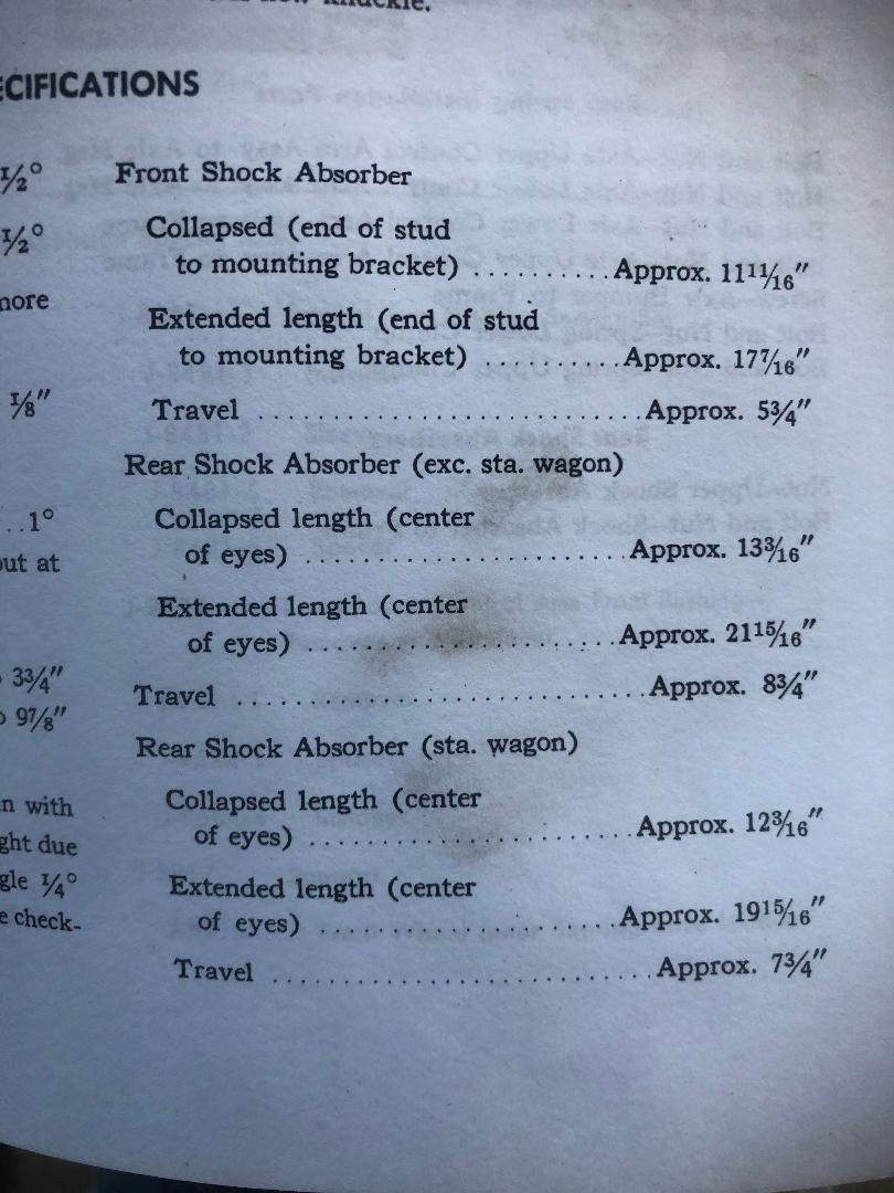

that would be cool wrongway, have you done anything with your stock springs??πŸ™„

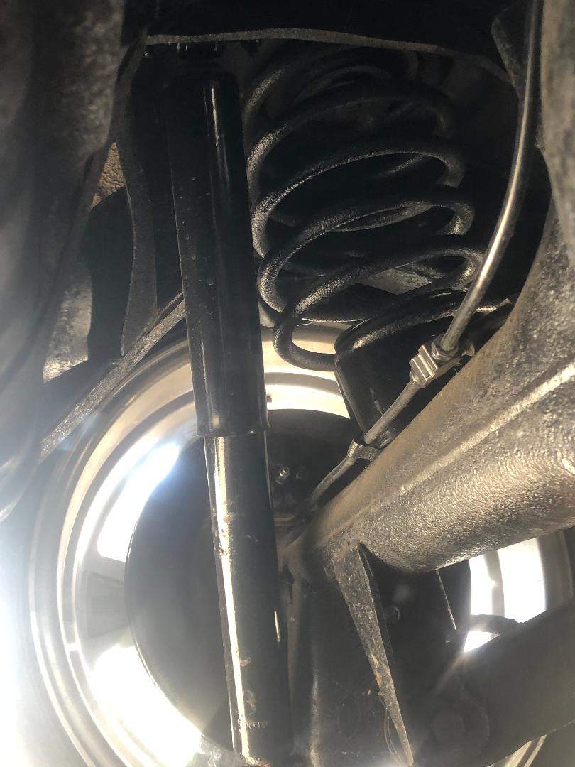

No bro, mine is pretty stock in the front and 3" higher in the rear. So I don't know if my numbers will help you much lol. But I did set it down today and get you some pics. Also the front parts are off so I'm a couple pounds lighter and sitting a little higherΒ then normal right now.Β I also found stock measurement's in my chassis manual from Pontiac but its for a 63' Bonneville. Hope it helps buddy. Let me know if I can do anything else.

cool thank you for the measurements Wrong wayΒ πŸ‘

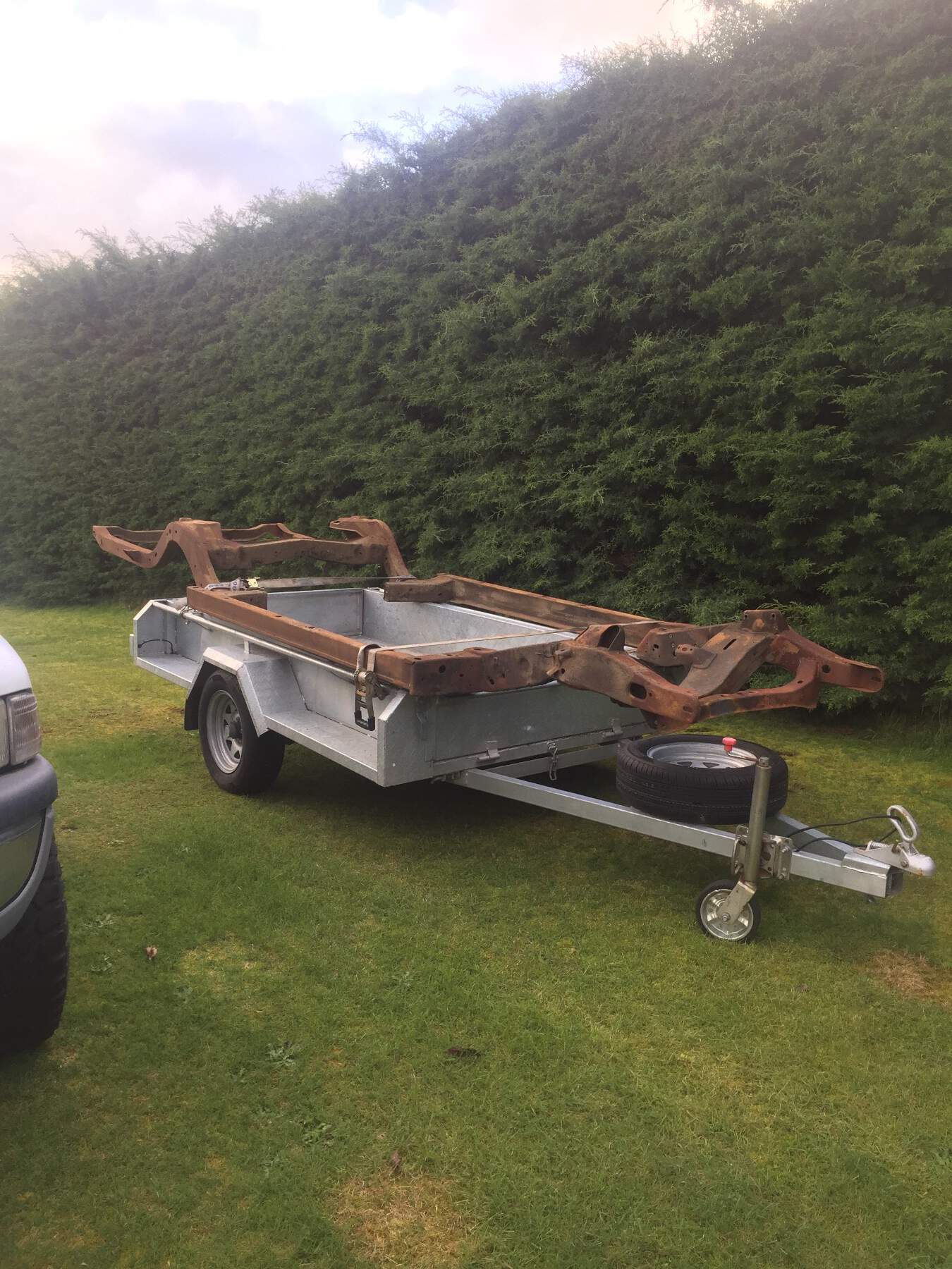

Am trying to get time to get my chassis to the sandblaster guy,justAΒ have not had timeΒ
Got the chassis to my sand blaster mate today !Β and he reconds i will have it back by end of next week!! $1200 to steam clean, then blast, prime and epoxy black paint, which i though was pretty fair:dancingpontiac:

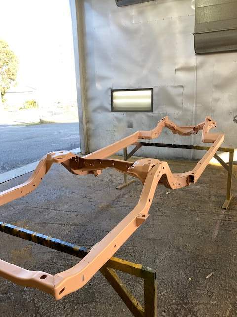

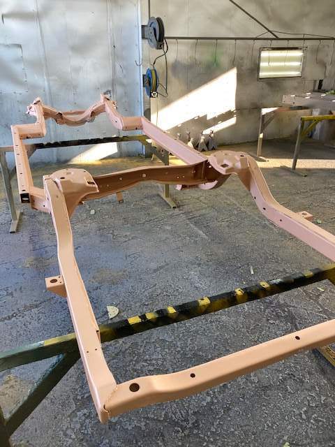

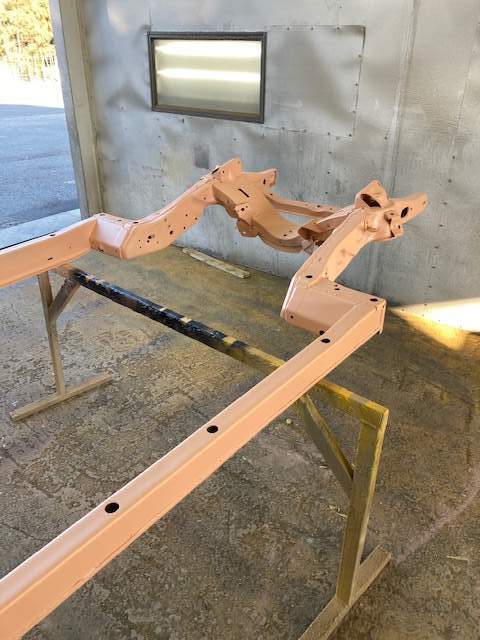

Dropped off the trailing arms off the diff to my sand blast man today, and saw my chassis, all clean, and primed!!!Β :dancingpontiac:
Β it looks mint as!:cheers:Β cant wait to see it in top coat... he is saying friday for pick up!

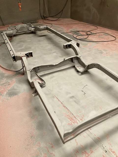

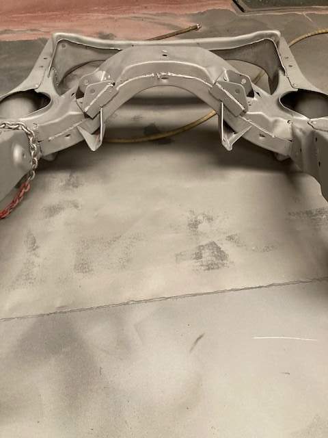

chassis at the blasters in nice clean bare metal

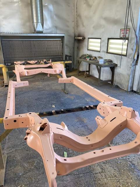

And then they primered it all

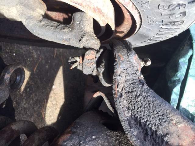

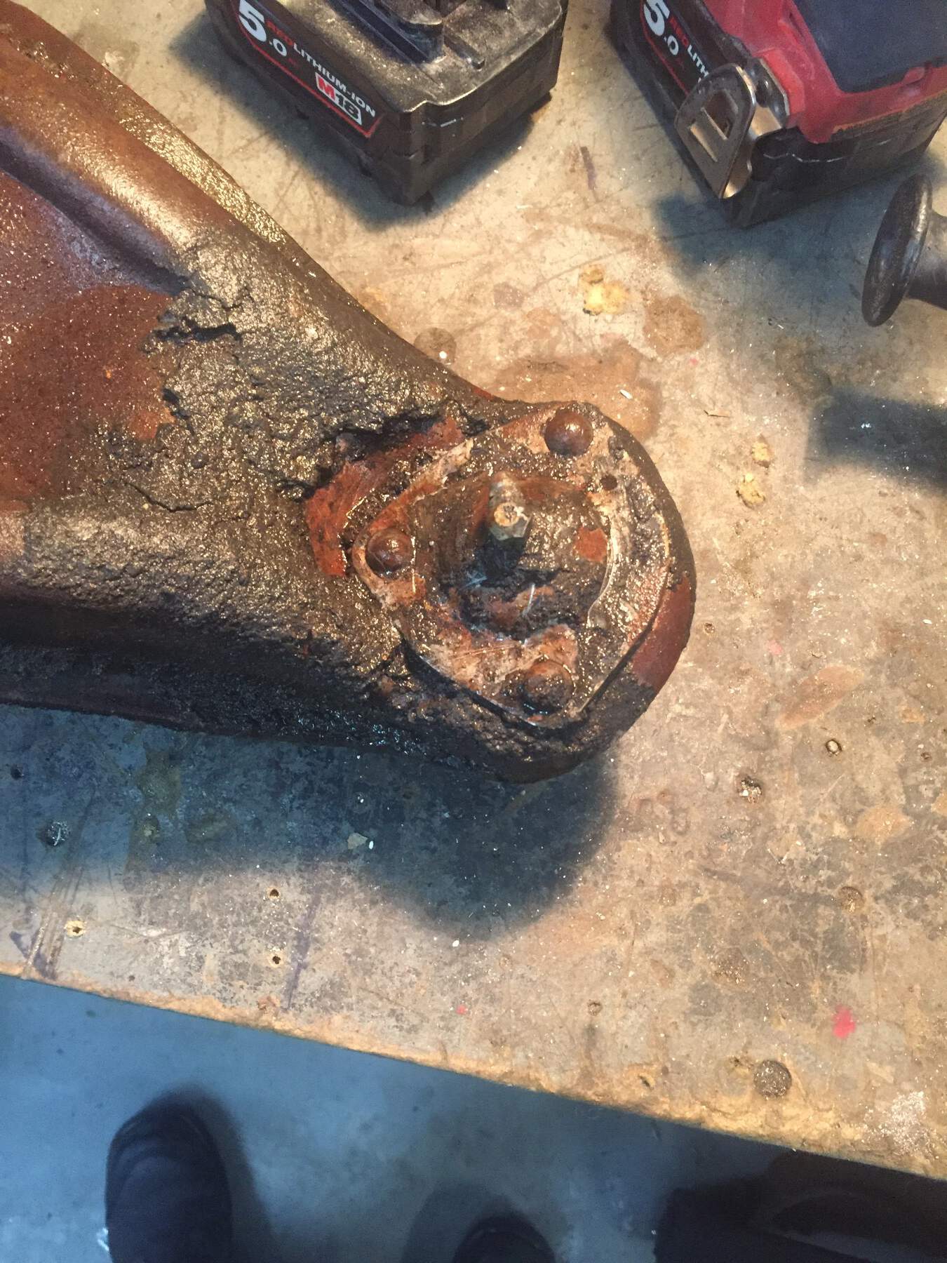

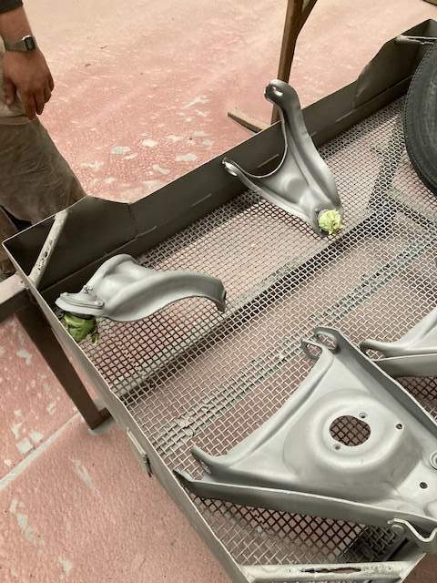

Remembering that some of these parts where very gummed up717660464_upperballjoints.JPG.3229fde569f0e91a7256725808dda921.JPG
And yes for anyone who spotted it, i have left the factory riveted upper ball joints in place, this car that i have robbed the chassis from had only 85000 miles on the clock, the ball joints are super tight and i just could not make myself cut them off just for the hell of "" quote"" "" rebuilding my chassis".
i am on a budget for this rebuild..... aka i answer to my finance minister (wife), and i wont waste money when some parts are in good condition and just need a clean up, i will replace the grease nipple after it comes back from the blasters just so i dont introduce any shit to the ball joint, which i am sure my wife will be over the moon about, how i am saving money !!:rofl:

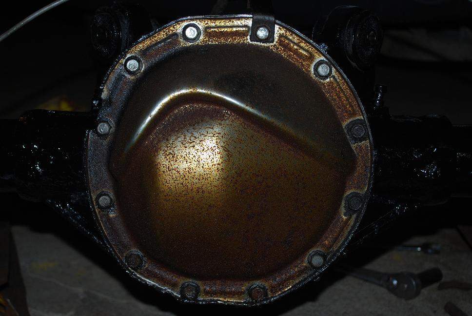

so whats your diff JustA ? 12 bolt???:cheers:
12 bolt N 4:11Β  Β  Β Have never seen another chrome cover like this one.Β  Cleaned N polished best it's gonna get, but still has some patina to it.Β  Β Was thinkin of painting it years ago when I painted the housing to swap over to the donor frame.Β  To me it looks like a big eyebrow.Β  So I bought the large set of MOON EYES stickers to make a smiley face...of sorts.Β  Never got around to it.

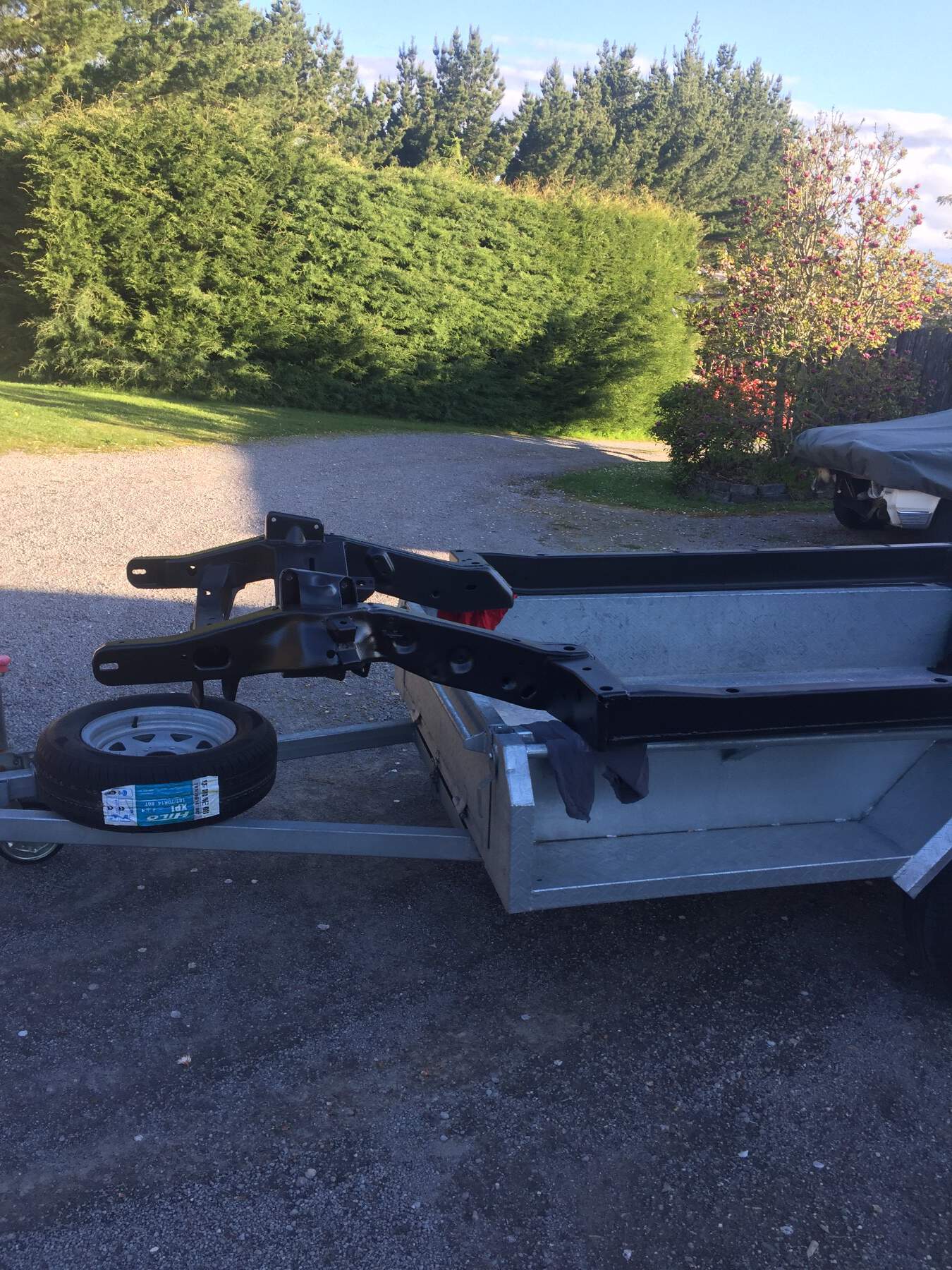

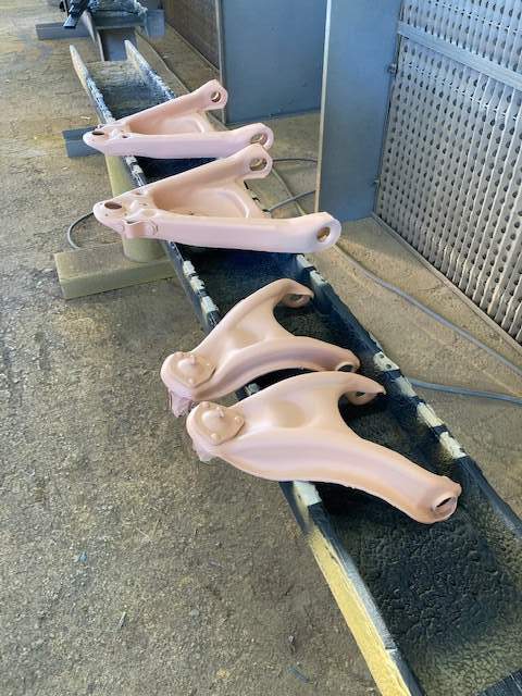

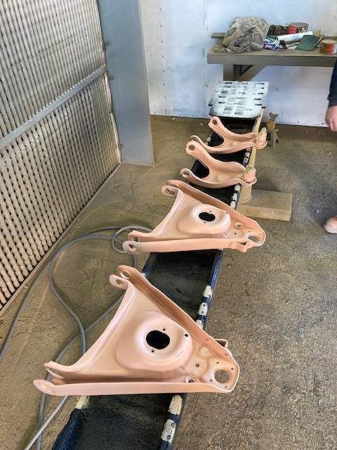

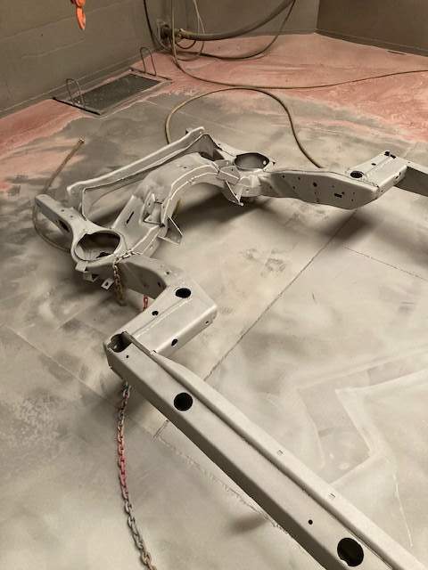

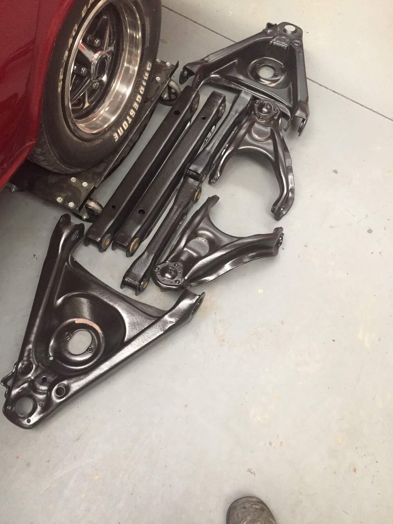

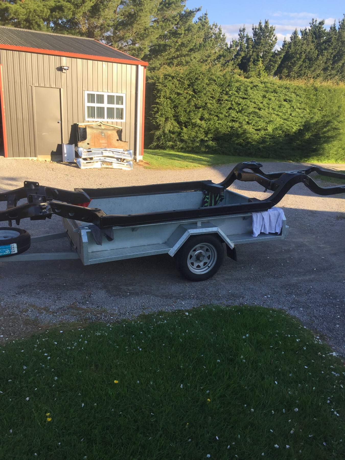

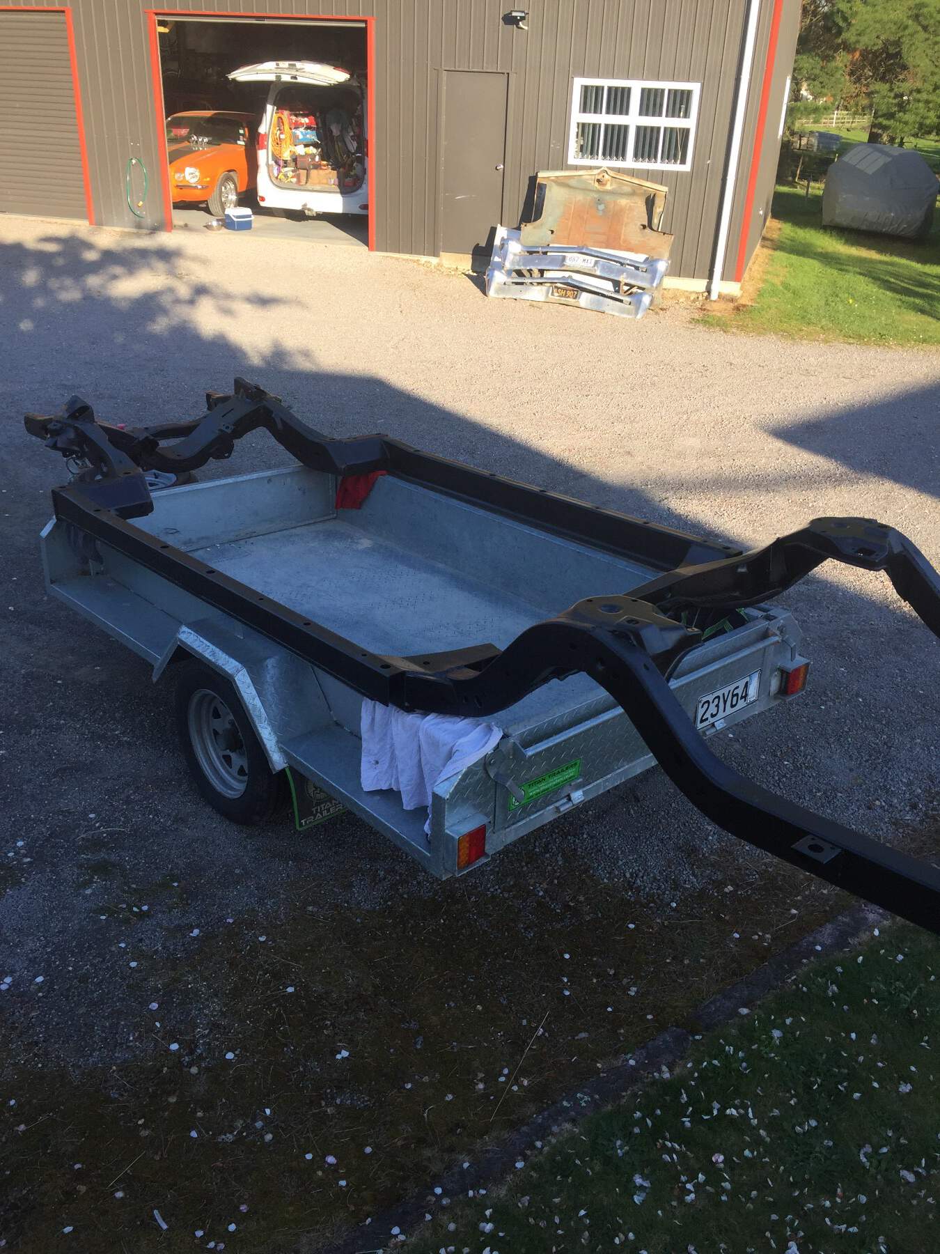

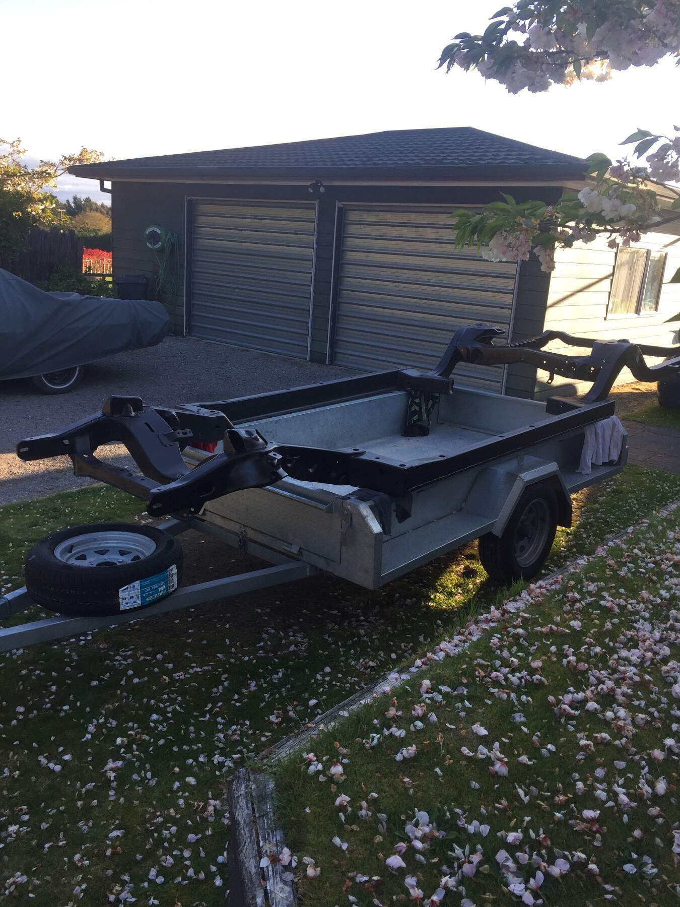

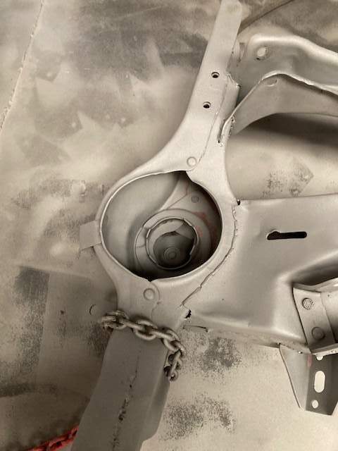

Hold on to your beers boys I have chassis porn to show you. And to quote the famous mike Myers .... sarrrr winggggπŸ™„πŸ’•

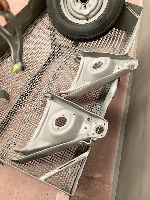

and all the control arms .... πŸ₯°πŸ₯°πŸ₯°πŸ₯°
I am super pleased with the finish on this chassis, it will last at least another 56 yearsΒ :cheers:
My sand blast mate, bare metaled, then epoxy primed, then 2 pack epoxy black top coated everything... 😁
i am, just for the hell of it, fisholene the inside of the railsΒ :dancingpontiac:
Ah and before you ask frosty, no, its not snowing here in new zealand!!, thats spring cherry blossom on the groundΒ πŸ˜€:cheers:Β
Cool chassis porn bud. I'm jealous. The finish on the control arms is first rate!

Glad to see it done bro! Looks awesome!Β
Nice bones....... Great work.Β  Happy it's back N gettin ready to ROLL.
