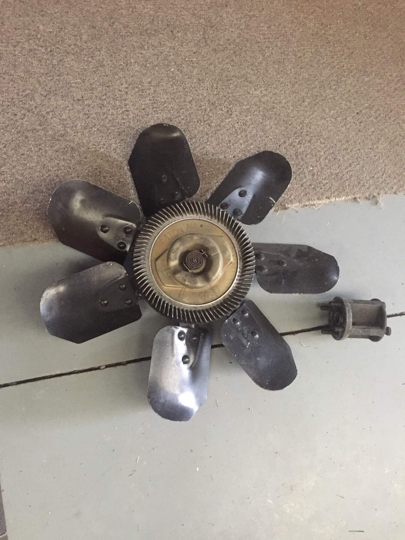

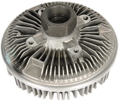

I am also thinking of deleting the factory fan, and fitting a thermostatically controlled electric one on the back side of the radiator.
My reasoning is that the factory fan is not thermostatic, so its pulling power straight from cold start, it has no real shroud to make it way more efficient.
It will increase hp justA by removing it.
Β What you guys think ???Β πŸ™„

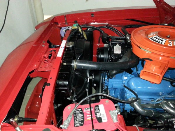

JustA my two cents worth! Electric fans are ok, but bigger HP, old skool motors which actually have a different design in both metallurgy and pattern flow of cooling jackets, can be tricky to keep cool with electrical fans and standard size radiators!Β
A three or four row radiator with a shroud and incorporating a good GM clutch fan does the best job at cooling in my experience. In myΒ β€œ69” Z, which had 600 HP in ran a 4 row with the custom aluminum shroud and a GM clutch fan! The motor really could make some heat! But with a 180 thermostat it never failed to stay at 185 to 190!

Pretty much exactly what I did with the GTO.Β  Water pump plate must be checked for cavitation as well.

Yup! For old skool motors it’s pretty hard to beat.Β
Kiwi! I did forget to mention that these units are designed to run a seven or nineΒ blade steel fan! TheyΒ have a pitch in the blades that at low RPM, when active real pull some amazing air flow! These clutch units are thermostatically controlled! Meaning that only when airΒ tempsΒ are high enough does the clutch engage! Otherwise the steelΒ blade fan just sits in neutral, I.E. disengaged!

Thanks Last indian and JustA. i appreciate your wisdomΒ

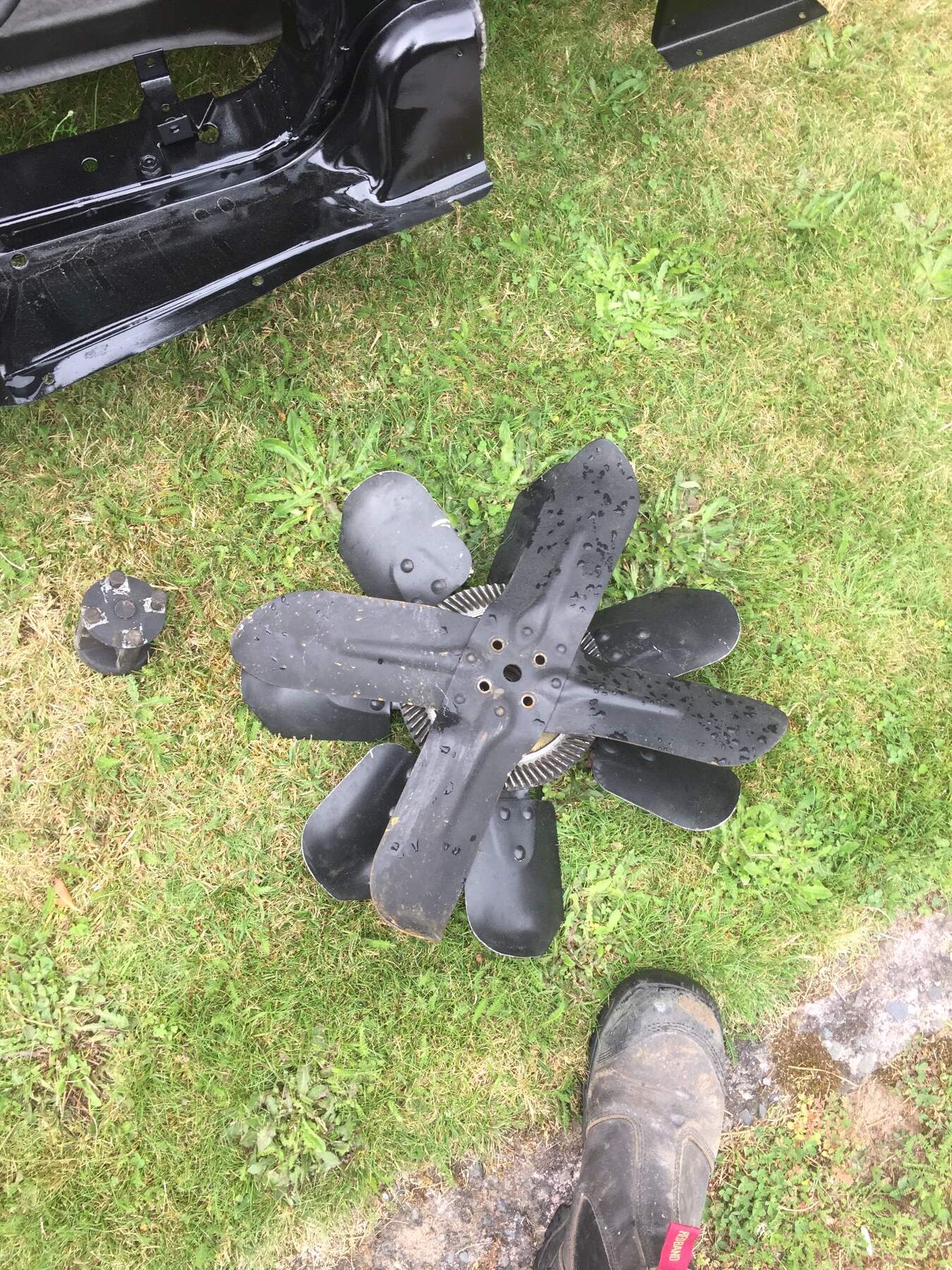

i justA happen to have the thermostatic fan off my camaro,Β :cheers:
i swapped it for a plastic unit way back in 2003 when i rebuilt the motor and my drag racer mates convinced me that it was pulling horse power and i was best do go with a plastic one if i was pull lots of revs..... well i never really did ( rev much) yet the plastic one with the shroud has never over heated and that car has done countless parades, slow congested cruises etc.
The thermostatic unit has the correct bolt pattern and when i am done baby sitting the grand kids this afternoon i will front it too the 64, i am certainly looking at building a shroud, my only issue is that the Pontiac radiator has no frame, it mounts in 3 rubber brackets, so i am looking at mountingΒ a shroud off the front radiator support member. I also need to check the clearances of the fan blades sizeπŸ™„

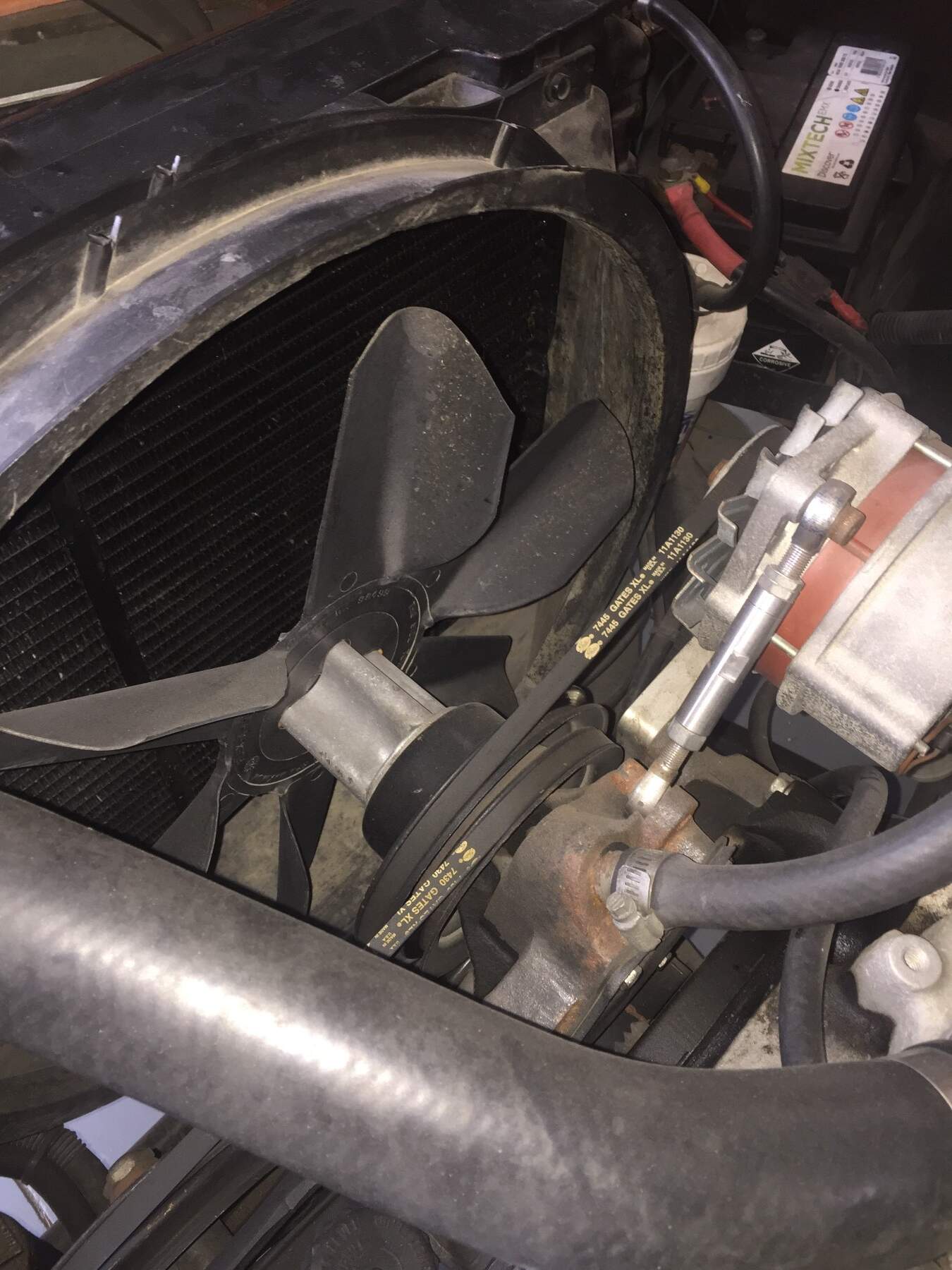

Thought it was JUSTA me N my Ol Skool ways.Β  Thankz for the backup LastIndian.Β  Obviously elect fans have come a long way, esp with FWD cars over the years and comes down to users choice for your pride N joy.Β Β

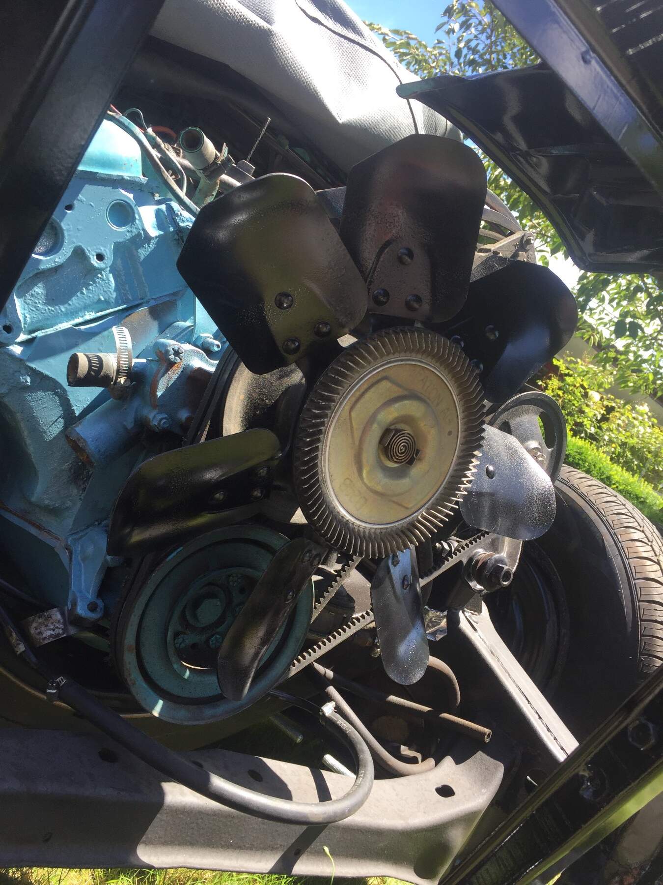

Fitted the thermostatic fan and its justa 3/4 inch smaller diameter than the stock one and looks to be a good spacing off where the radiator will sit.
Β
i will wait till the radiator is back to work out the shroud configuration... might even make it out of brushed stainless steel for a clean look:cheers:

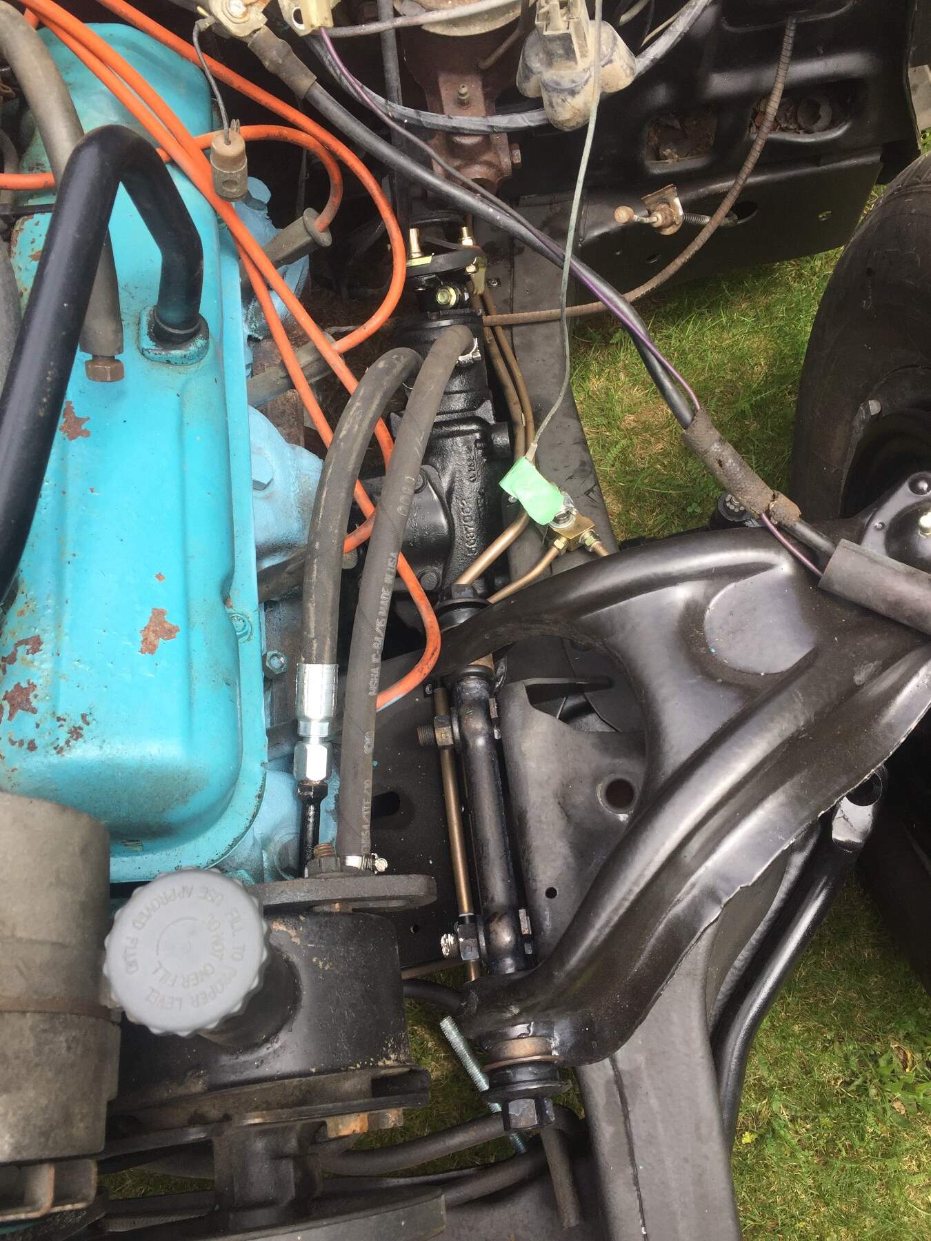

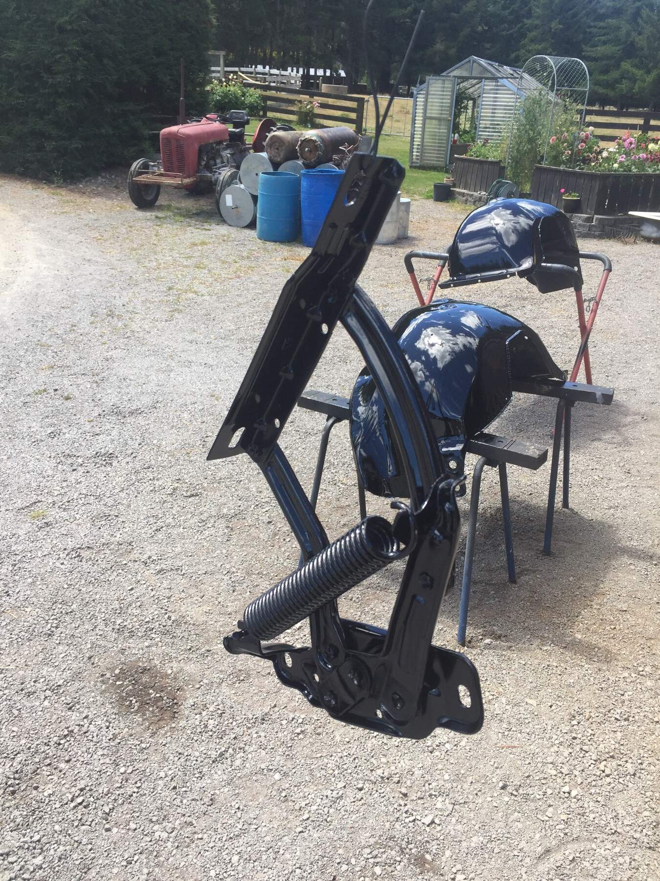

Also fitted the new power steer hoses i had made this week and prepped the third inner fender:)

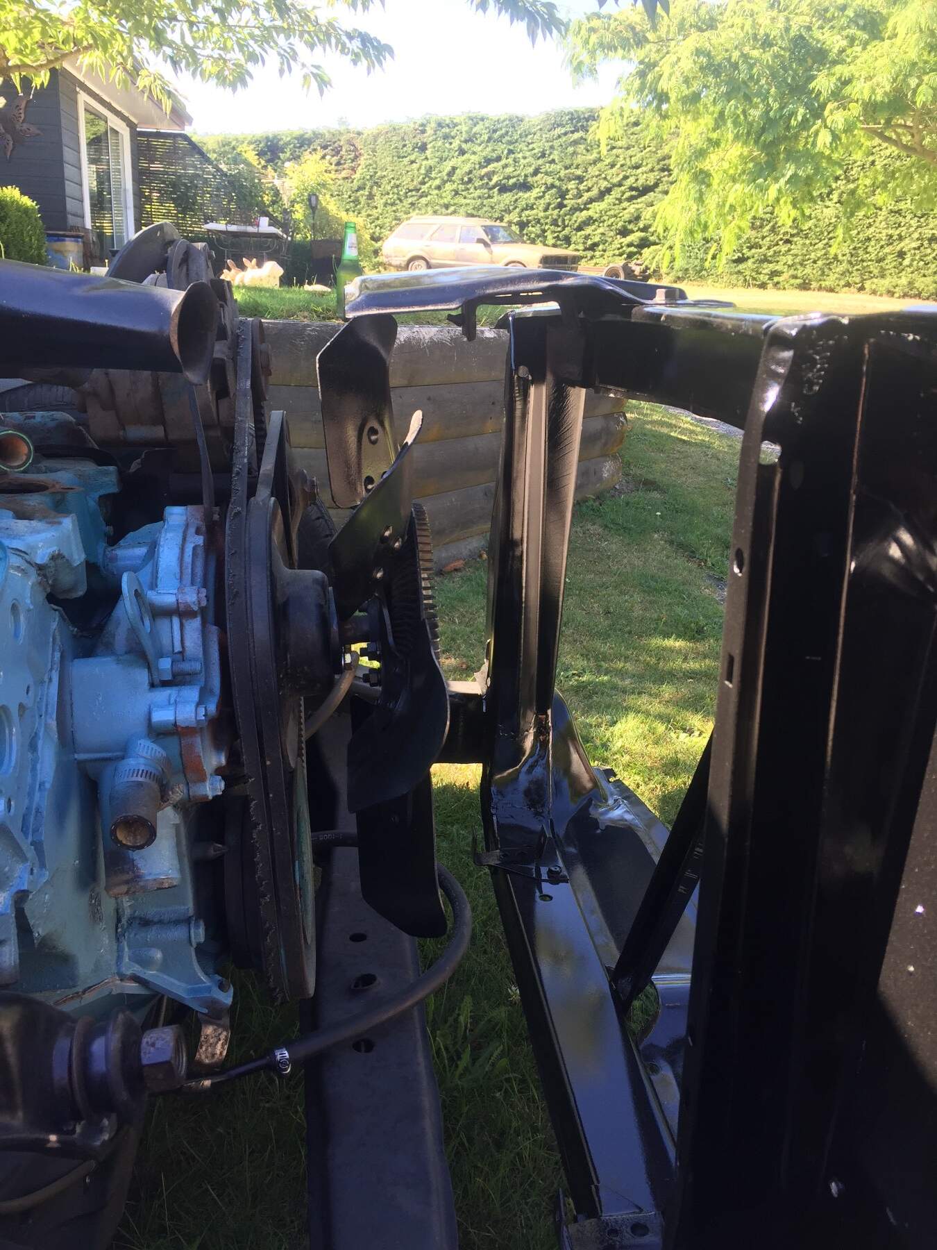

It might just be the angle of the picture, but just for reference, as this picture appears, this would not be a desirable setup! The fan needs to sit at least just inside the leading edge of the shroud or a little deeper! Also there should be only about a 1/2 inch clearance between the shroud circumference and the tips of the blades. This is what make a good draw of air through the radiator.
Yes good point mate !Β
This picture doesn’t really show much as far as location ,only that it’s back Β far enough to getΒ Β the radiator in πŸ‘
I need to wait till I get the radiator back and then I can mock up a full shroud template , the plate you can see above is justA the top support for the radiator and I guess it’s a bit of protection from the stock blade when your working on a running engineΒ

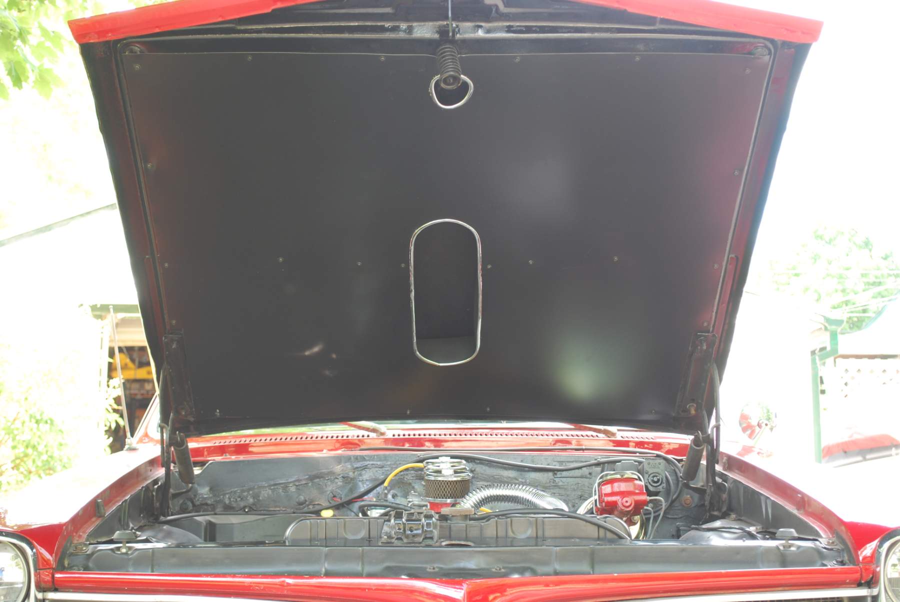

I have hunted around anΒ to looks as though 64 bonneville never had a factory full shroud unlike there sister chevs that certainly did along with the gto sΒ

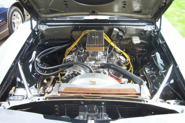

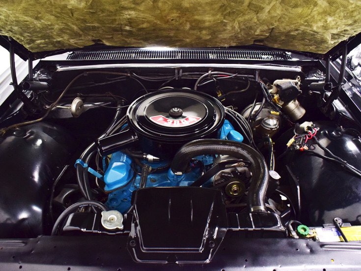

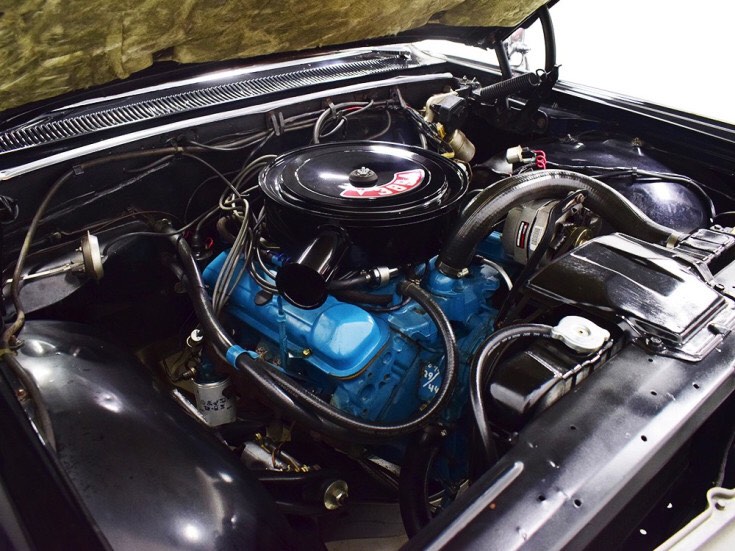

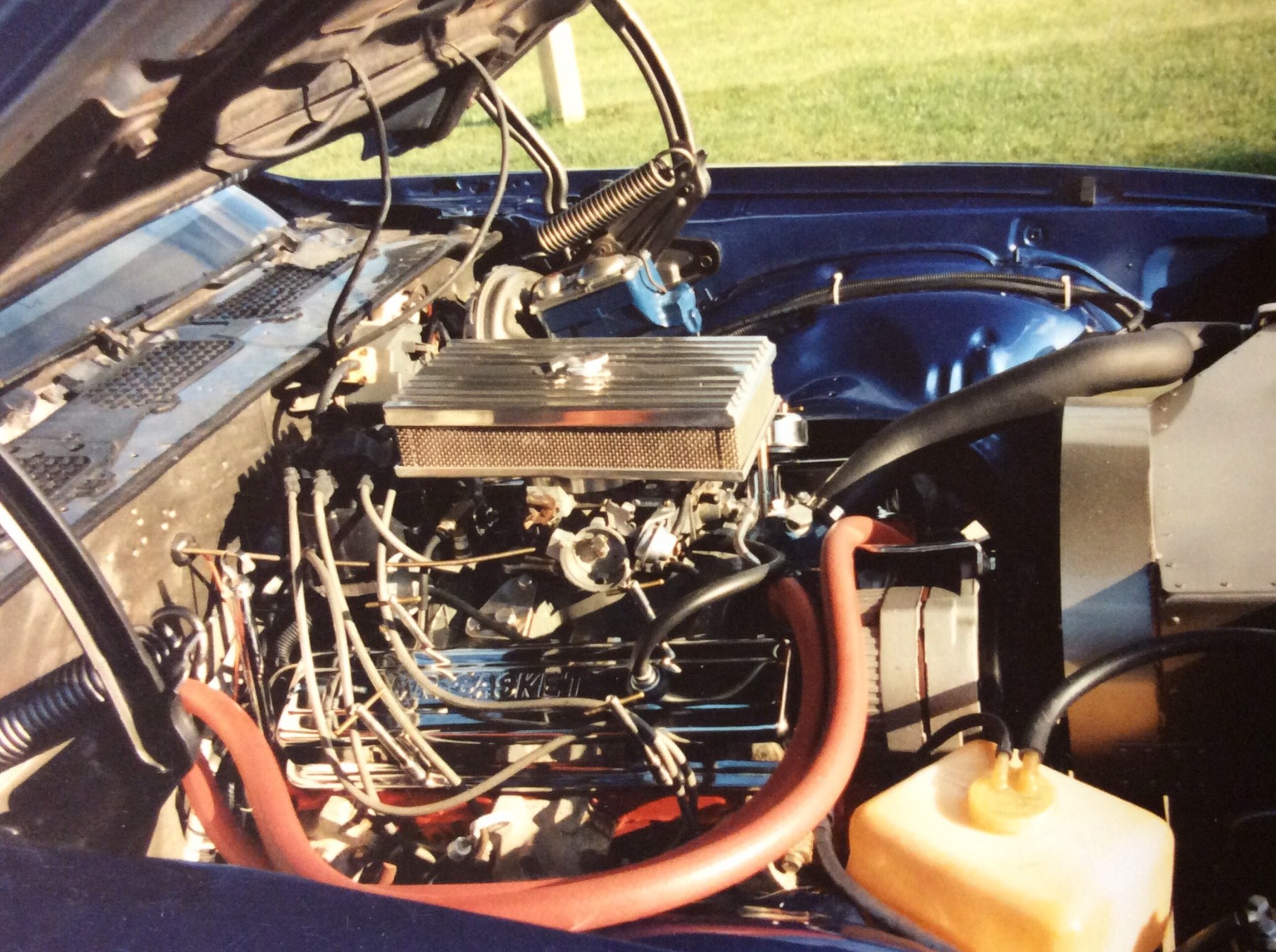

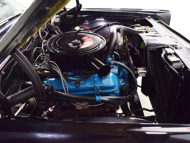

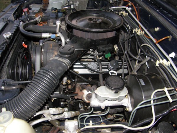

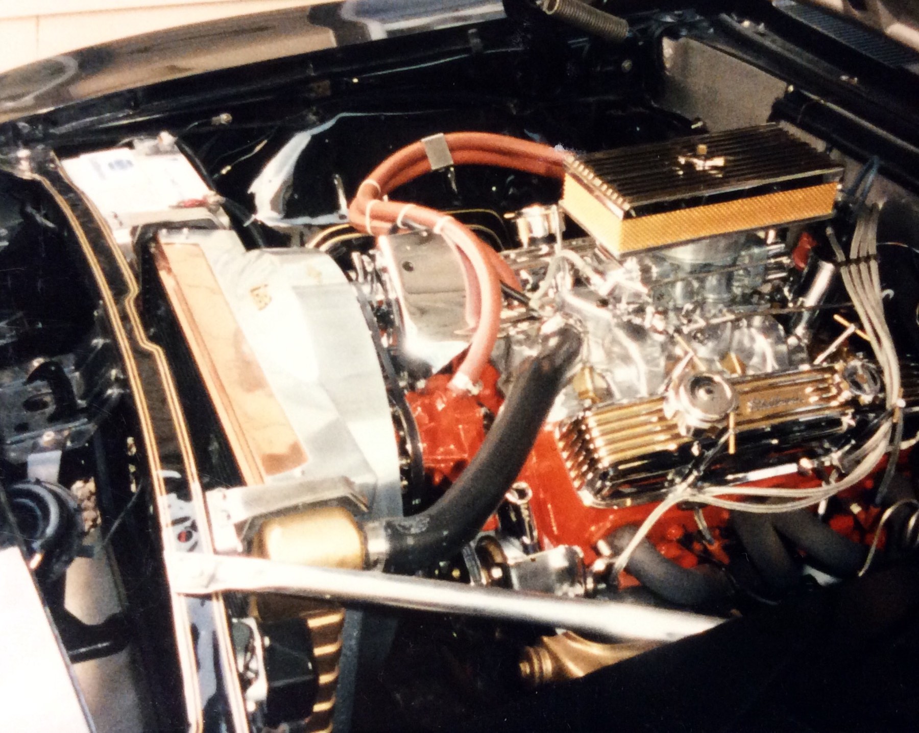

Kiwi there was a shroud for the Bonneville, see pics, but I think you could make a better one. If you look close at the pictures of my Z radiator you’ll notice that it’s made of aluminum! The part that the fan would enter is rolled the rest is a flat sheet of aluminum cut and bent appropriately and then the aluminum ring is tig into it. This whole assembly attaches to the radiator itself! Even the radiator retention brackets are custom made for holding the radiator in place. I did the same basic concept for my wife’s Z.

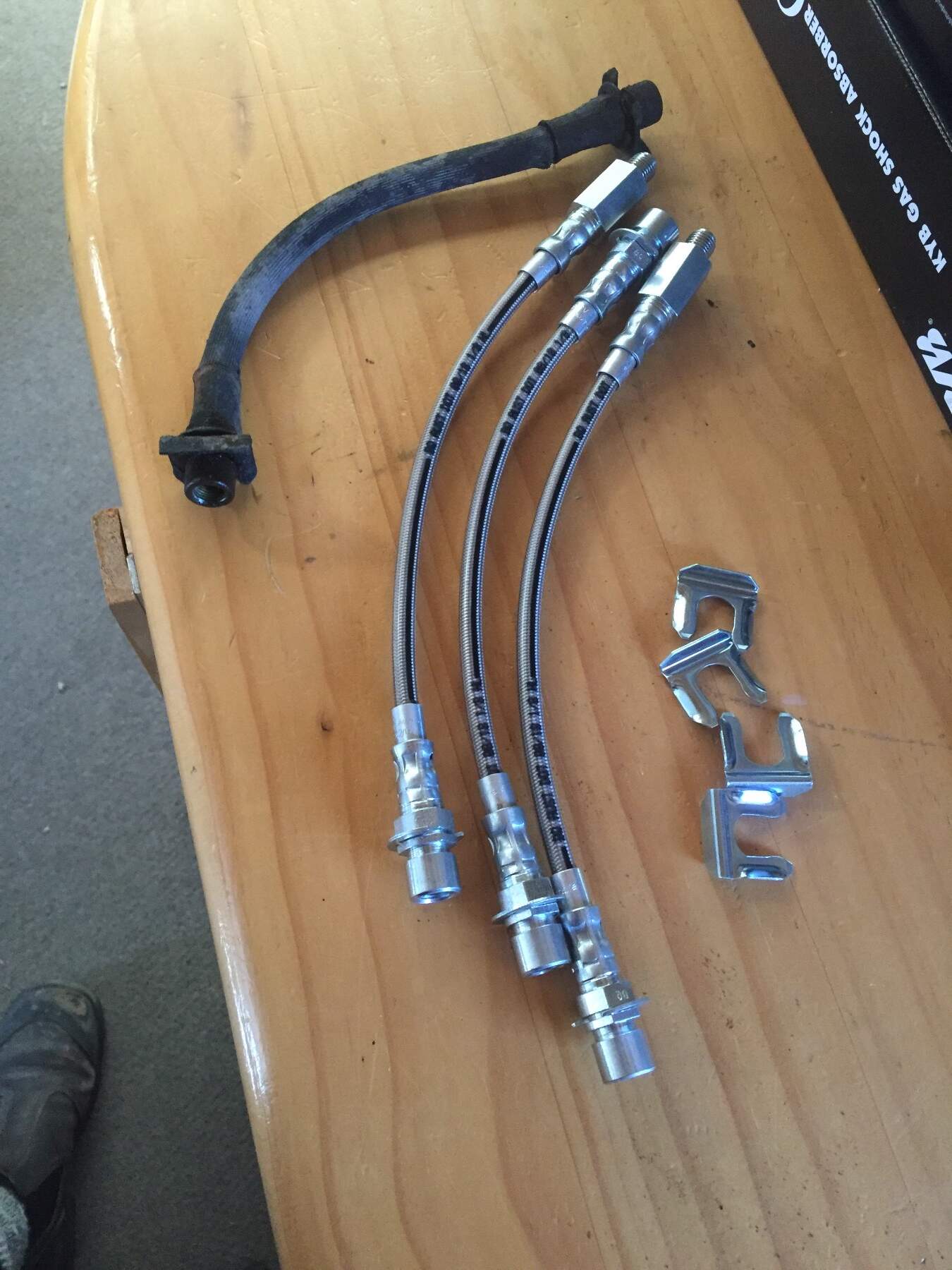

New Teflon brake hoses thanks to my brake shop mate, who is also making me a Teflon fuel line with a-n fittings from the pump up to theΒ  carterΒ :cheers:
these babys will not expand when those big brake drums get hot which will help with braking under heavy useΒ :dancingpontiac:
dont they looks sexyΒ :drool:Β compared to the scummy old one!!!:rofl:
Β
Great pictures of your 69 Last IndianπŸ‘Β thats what i will be doing with my shroud:cheers:

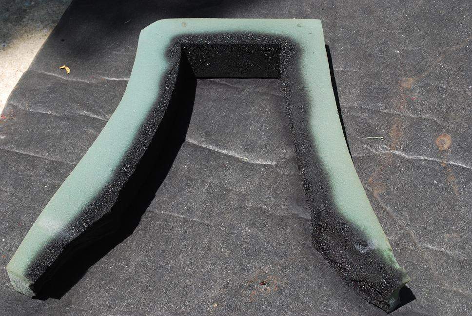

here is a better picture of the stock 64 shroud... which really is not a shroud at all... its more like a shr___
:rofl:Β with out the rest of a the ___oud haha. i really dont think it did diddly squatΒ :rofl:... watch this spaceπŸ‘
i think i can do much betterΒ πŸ™„
NowΒ  here is a interesting thing Last Indian... that air cleaner you posted has a really big intake! my one is way smaller and i looked at it and thought.... how the hell is a 4 barrel going to breath through a inch and a half intake snout????, your pic shows a nearly 2 inch snout !!
and even that seams too small???
There are all kinds of ways around that dilemma! If you what to keep it as a overall stock look, you add a little longer threaded screw to the carb and flip the top of the air cleaner upside down! Or you find and buy the same diameter air filter but a little taller add again a longer screw and raise the top up! You can also get a second top to your air cleaner and cut down the outside diameter which opens up a gap around the air filter! Or you can go aftermarket air cleaner that is opened all the way around! All of these maximize volumetric efficiency!
In each case you need to assure the the top cover seals to the air filter! So in the case of cutting the top cover outside diameter, you cut it back as far as you can while still leaving the sealing point of the air cleaner intact. Also always make sure you check the clearance between any changes you’ve made and the closing of the hood!!

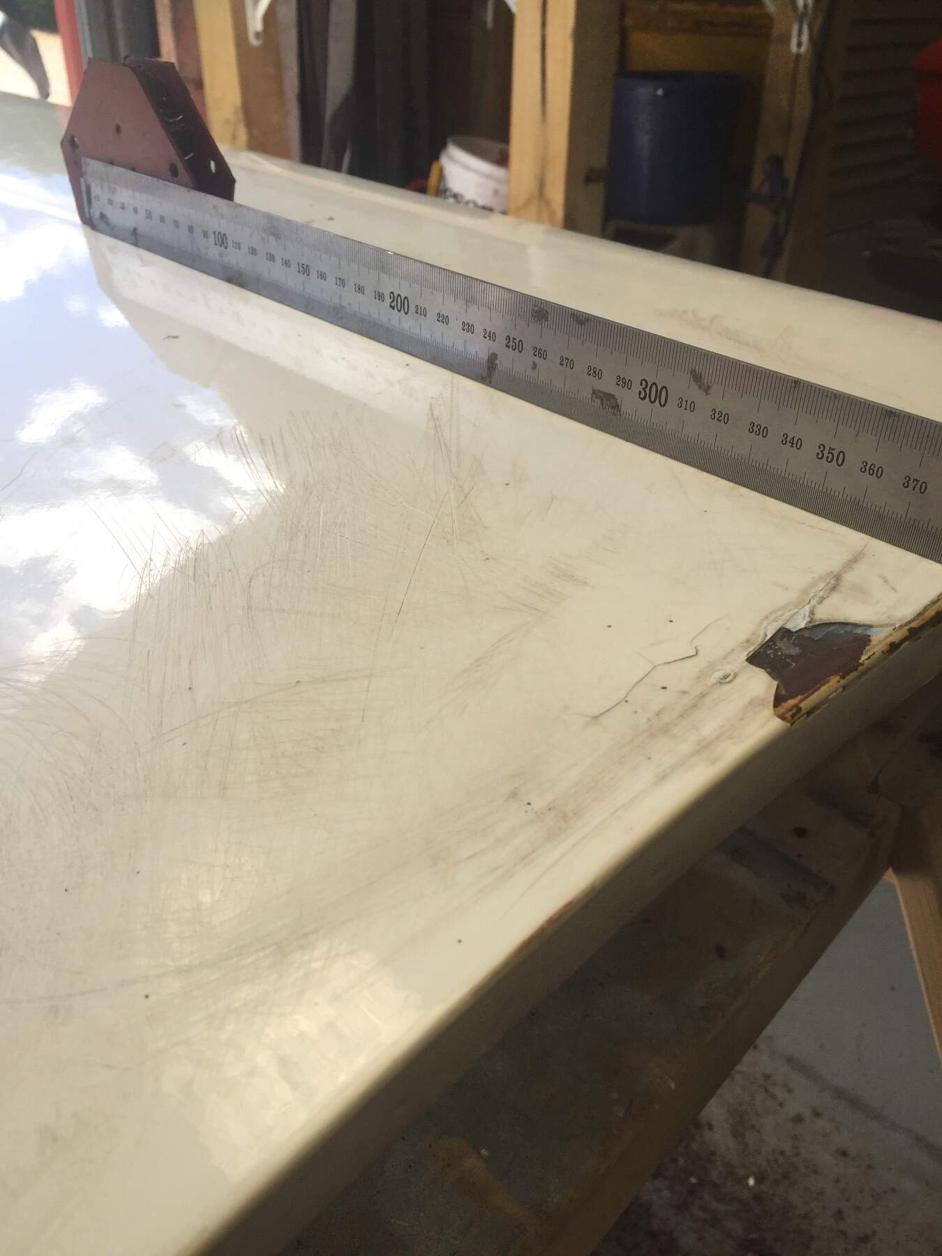

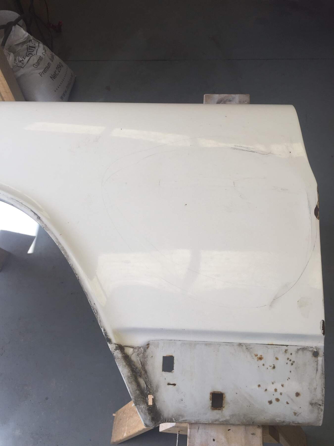

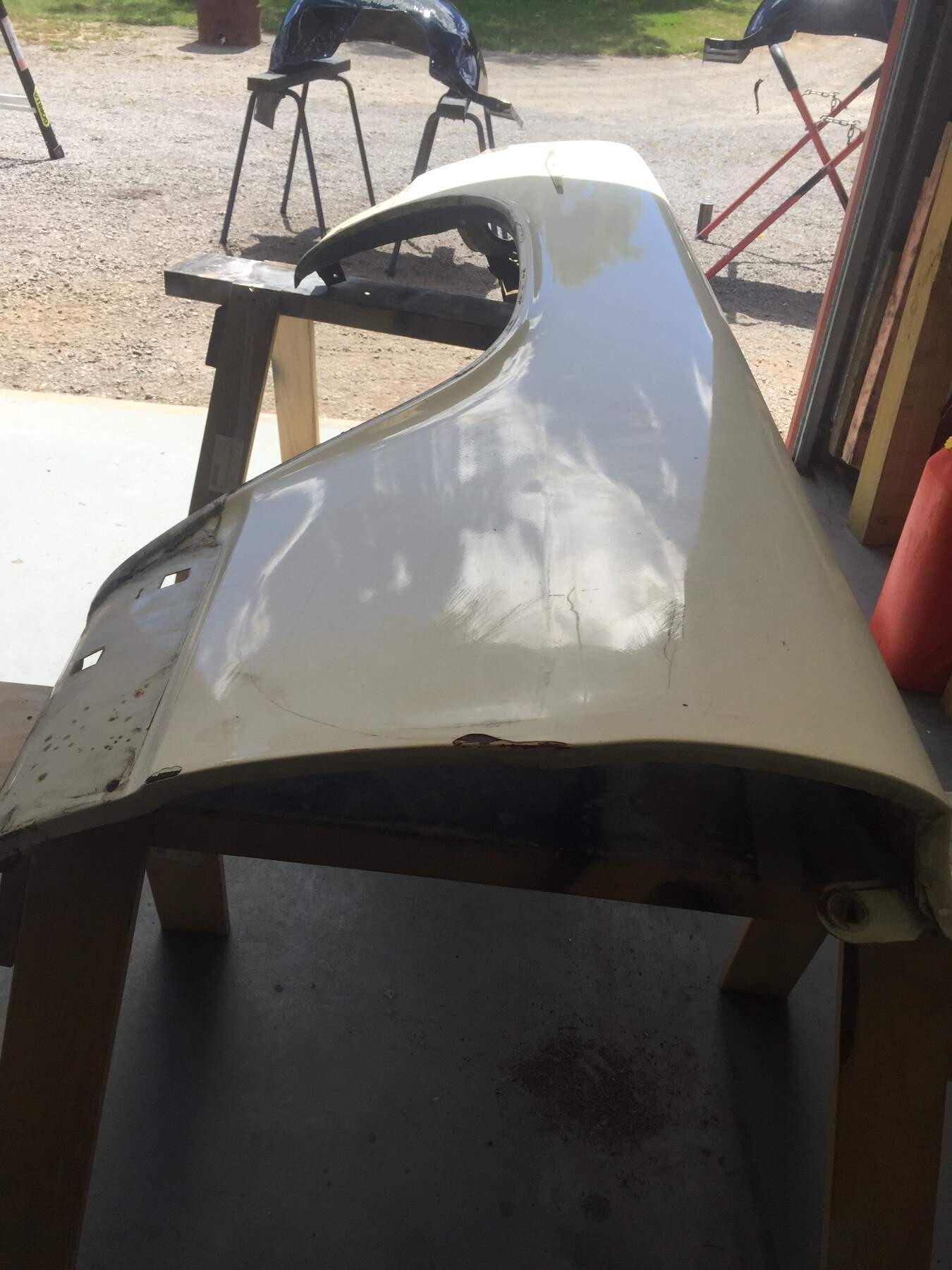

Got into the drivers side fender and here you can see the pencil marks around a nice big dent and with the straight edge you can see there is a good 3mm gap, few careful adjustments with a block of wood and a flat hammer and i had it down to just under 1 mm.made up a brew of bog and used a big trowel to apply it over the whole area so i had a nice skim coat to sand and loose the imperfections. i am going to leave it to fully set over night and block it tomorrow, then go over the rest of the fender. This one is in really good condition so i will check it over, sand and prime it. Right now we have mates coming for a bbq, and beers. so thats it for today. i did get the intake detailed but i will show that tomorrow once i have all the new hoses fittedΒ :cheers:cheers guysΒ :cheers:

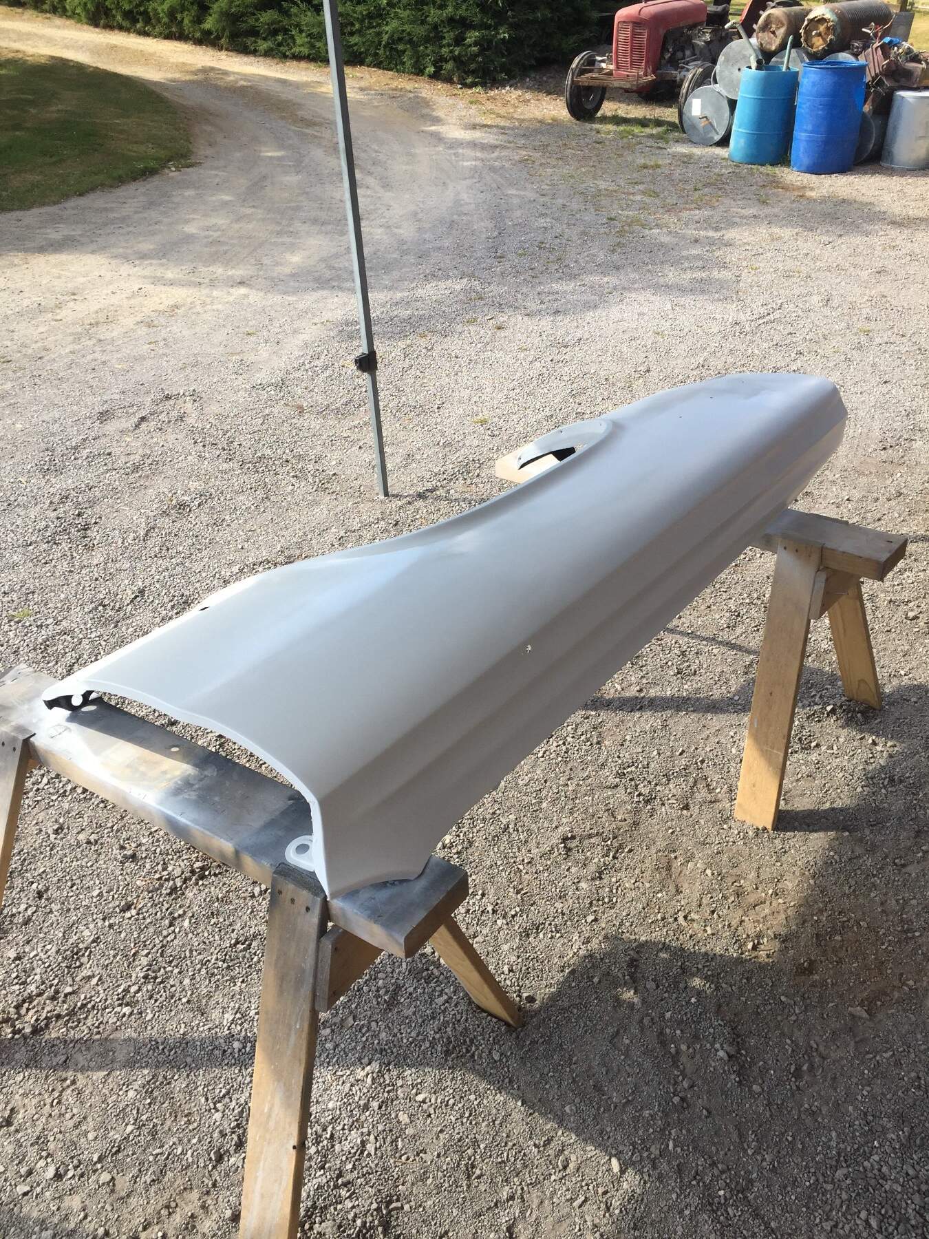

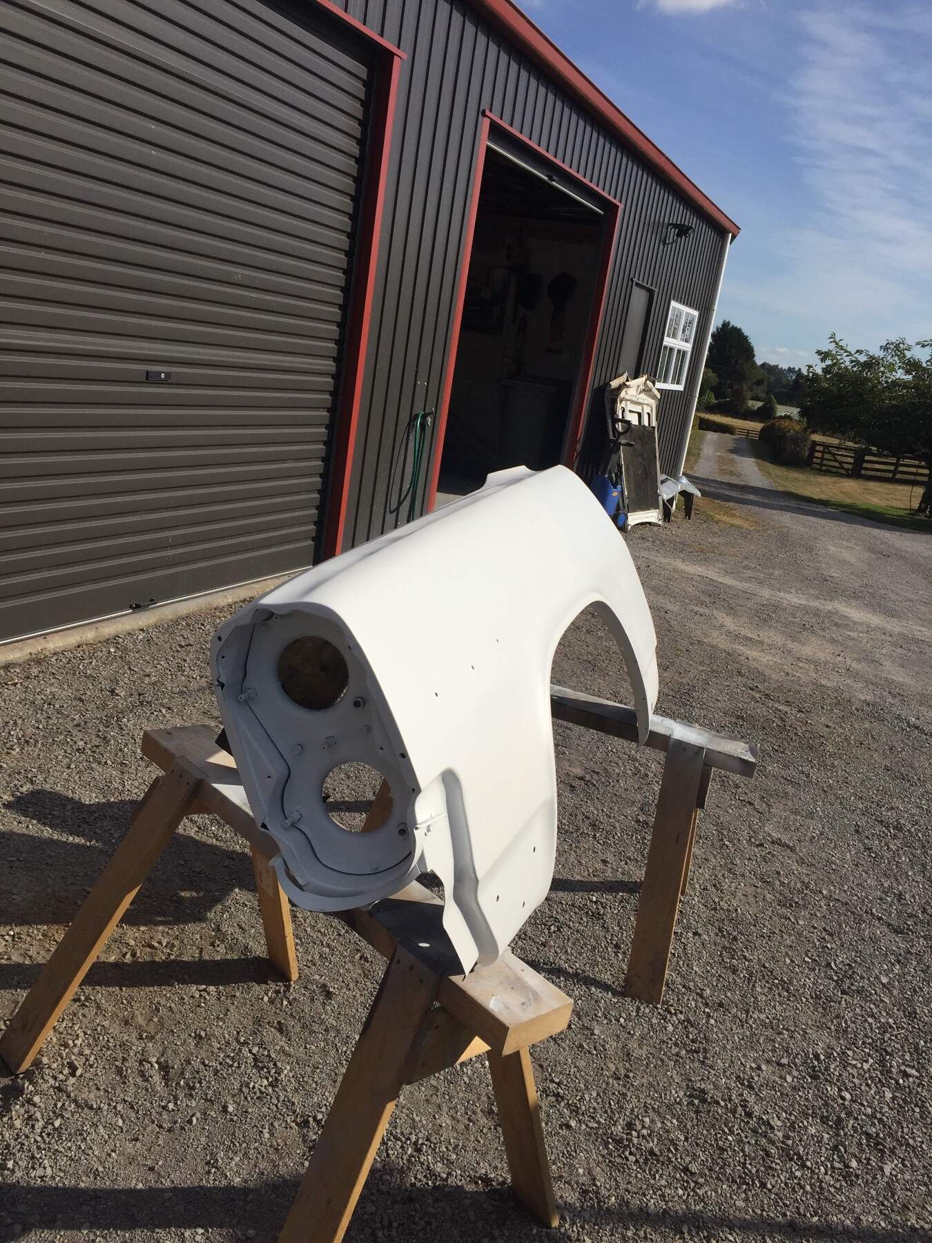

Got home early from the beach today being a long weekend for us,

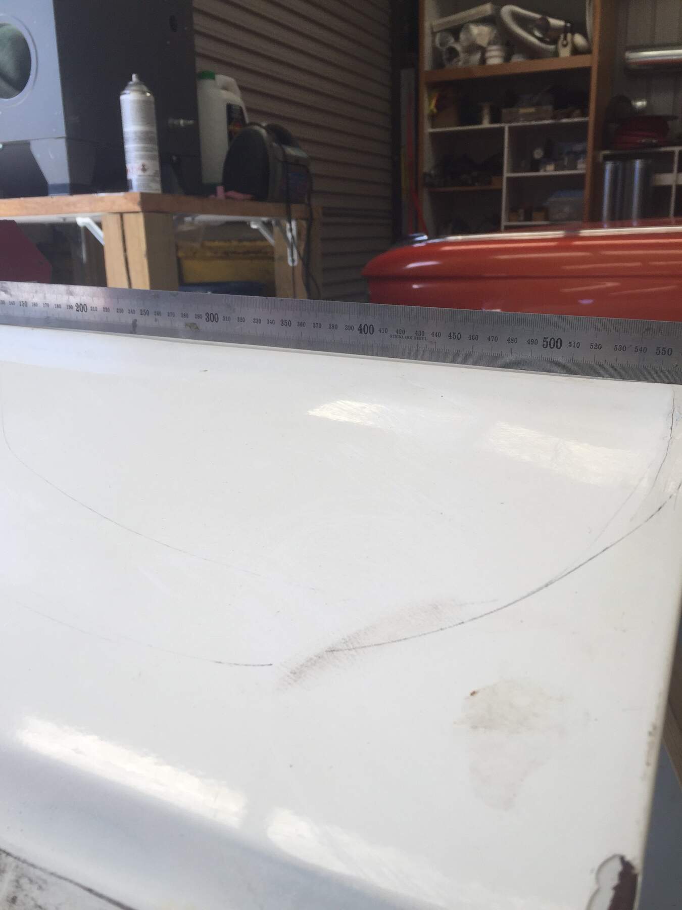

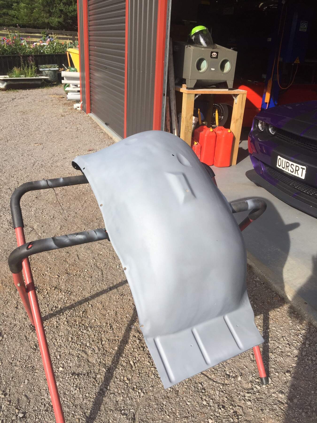

And got some time to prep surface and prime the drivers side fender, very happy with how straight it is, few nicks and scratch to deal with, but for now its bogged,Β Β sanded, leveled and primed in white and will go on the car that way.
Β The plan is to assemble everything, put the girl through vinning/nz road legal, then i will pull all the trim off and i already have the 2k paint system, supplied by my good painter mate who painted the hq ute( green car).prime her in light grey, go over the whole car and smooth all the imperfections, then second coat of 2 k primer, then she will go to my painter mate and be top coated in his spray booth...... thats the plan!!:cheers:
But right now it!!! ...... BEER O CLOCKΒ :cheers:Β Β

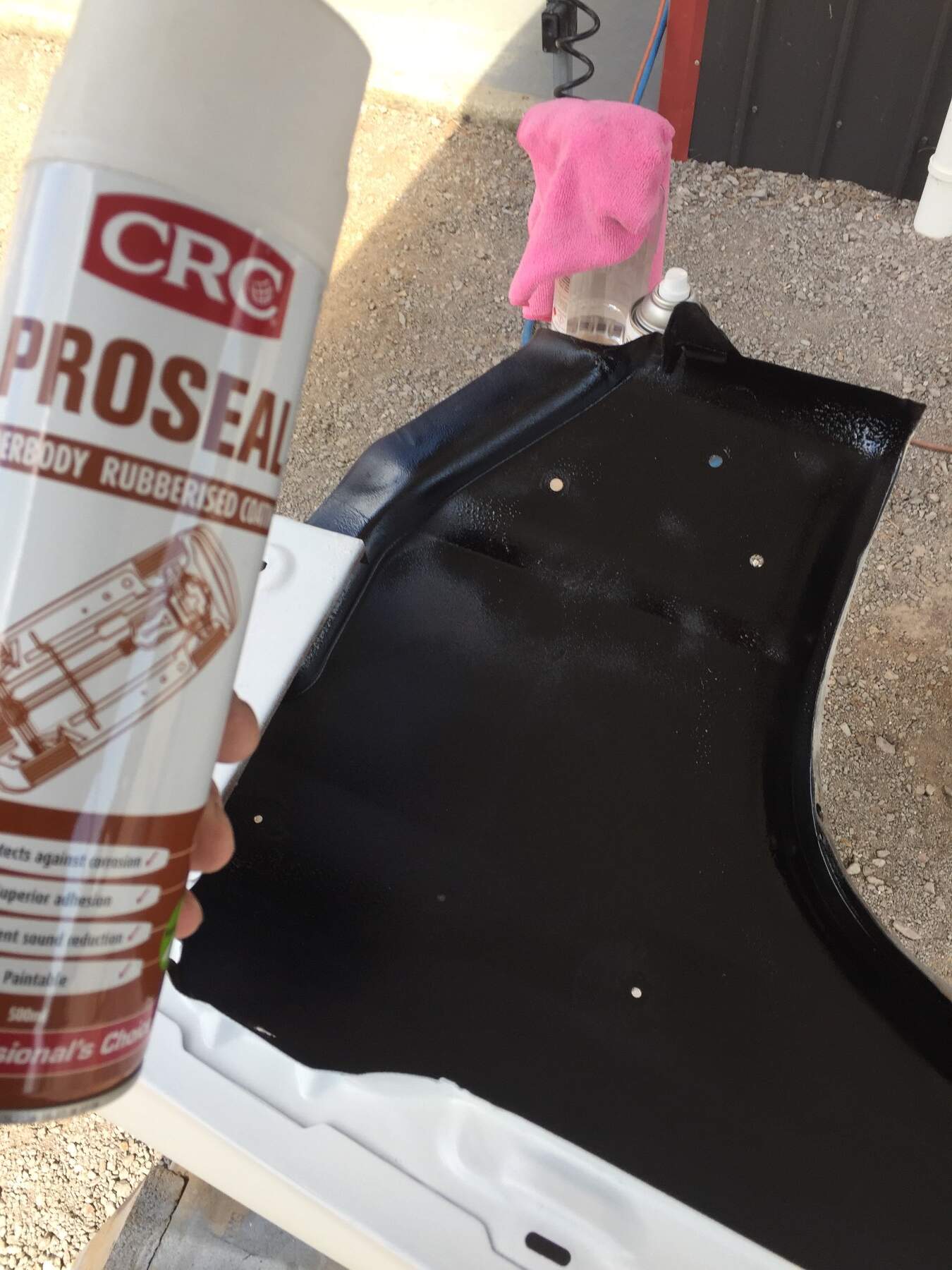

check out the pics, i did under seal the inner side with body sealer too, justA like i did the passenger side back in march last year, that fender is standing in my bar!:rofl:Β waiting its day to be fitted to the nice straight frame:cheers:Β its been my drinking buddy!
And for a whole year he has Β been sitting there and has not beenΒ  o-fendedΒ :rofl::dancingpontiac::rofl::dancingpontiac::rofl:
Now my bar mate has a friend, i hope my passengers side fenderΒ doesn't put up his guard and feel offendedΒ :rofl:Β

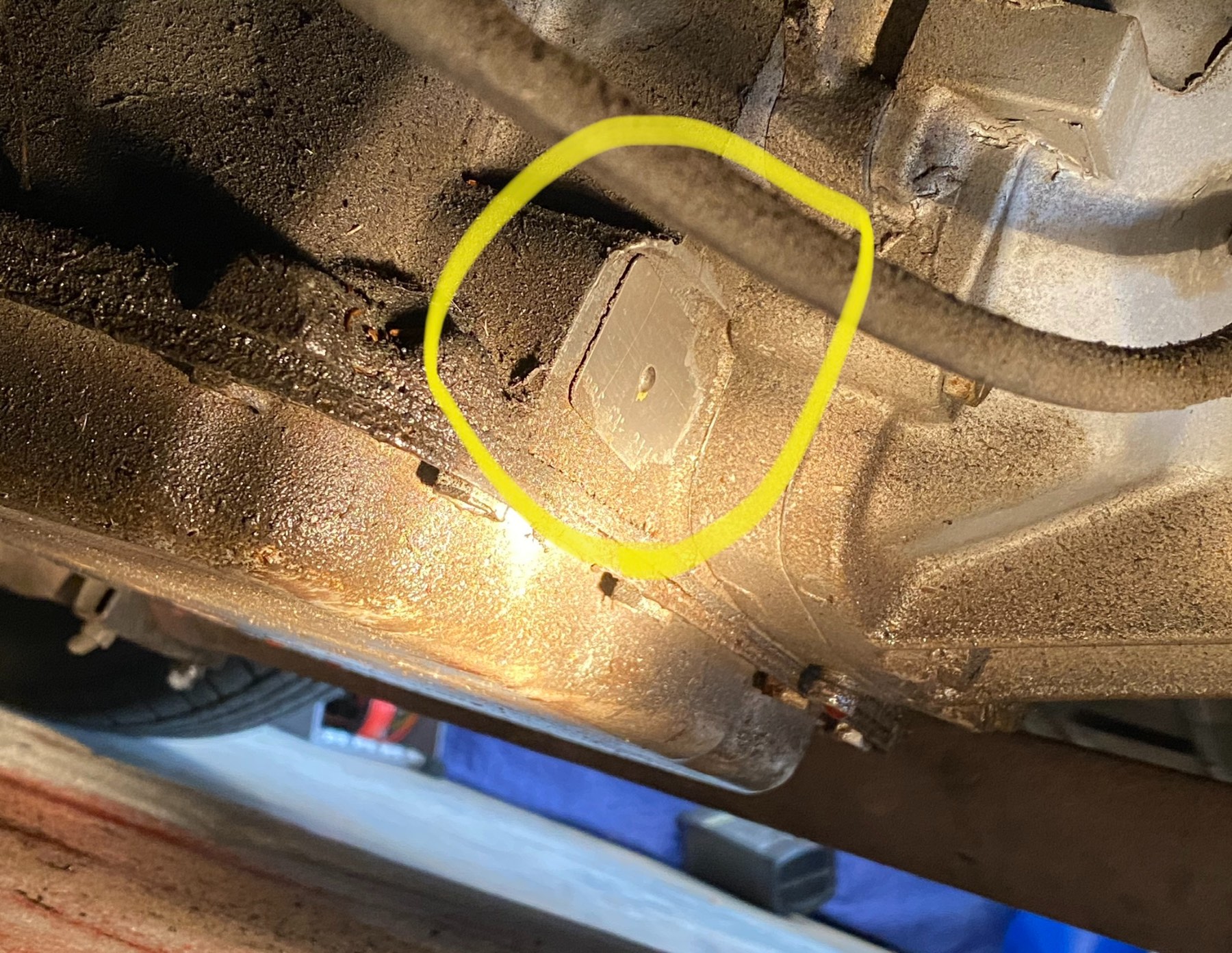

Β  Since this car is a keeper I’m ordering a new motor and transmission. The transmission is a JETAWAY. There is a tag on the back corner above the pan that should say pbs64 if yours is the same. I think I’m going stock on the motor vs fuel injection. What do you think?
