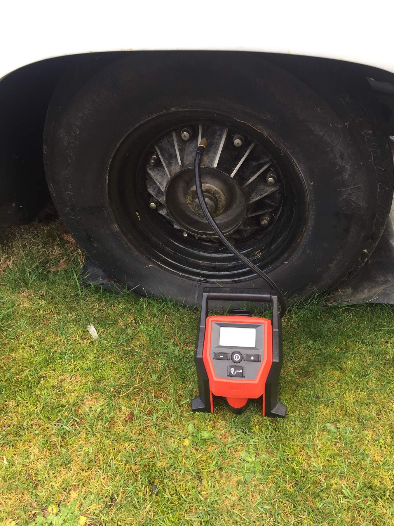

My latest Milwaukee tool
the m18 compressor 👍👍👍
I certainly recommended them

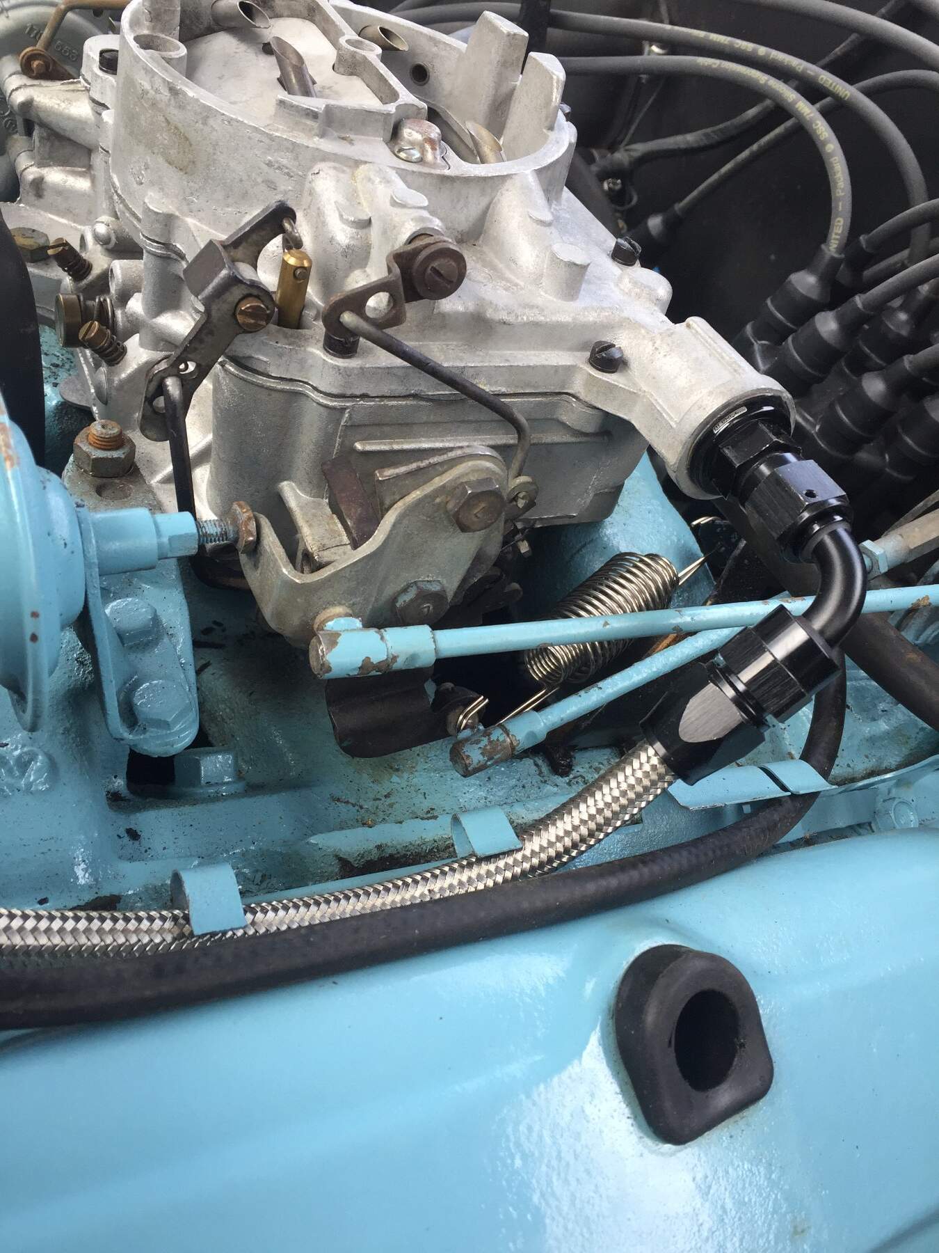

Finally got to fit the carter ... have lots to tell
but here’s a starter . I added a dual return spring for more safety ..

I like your fuel inlet set up. Any specs on the fitting that screws into the carb? Mine is (was) a crappy looking piece of 3/8 rubber hose.

Yes mate it’s a aeromotive brand Teflon fuel hose with a-n fittings and the one into the carter is the same as a holly fitting

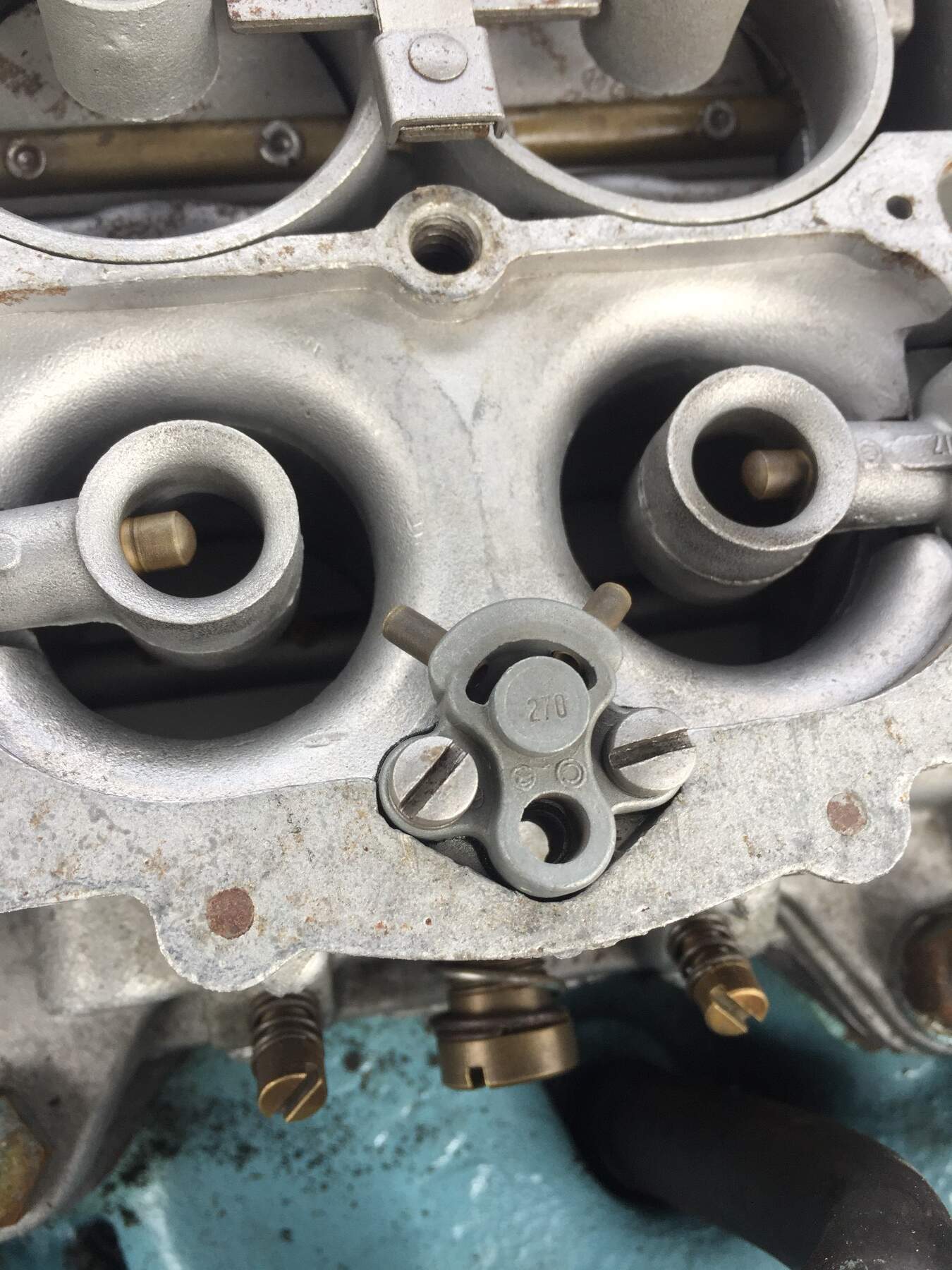

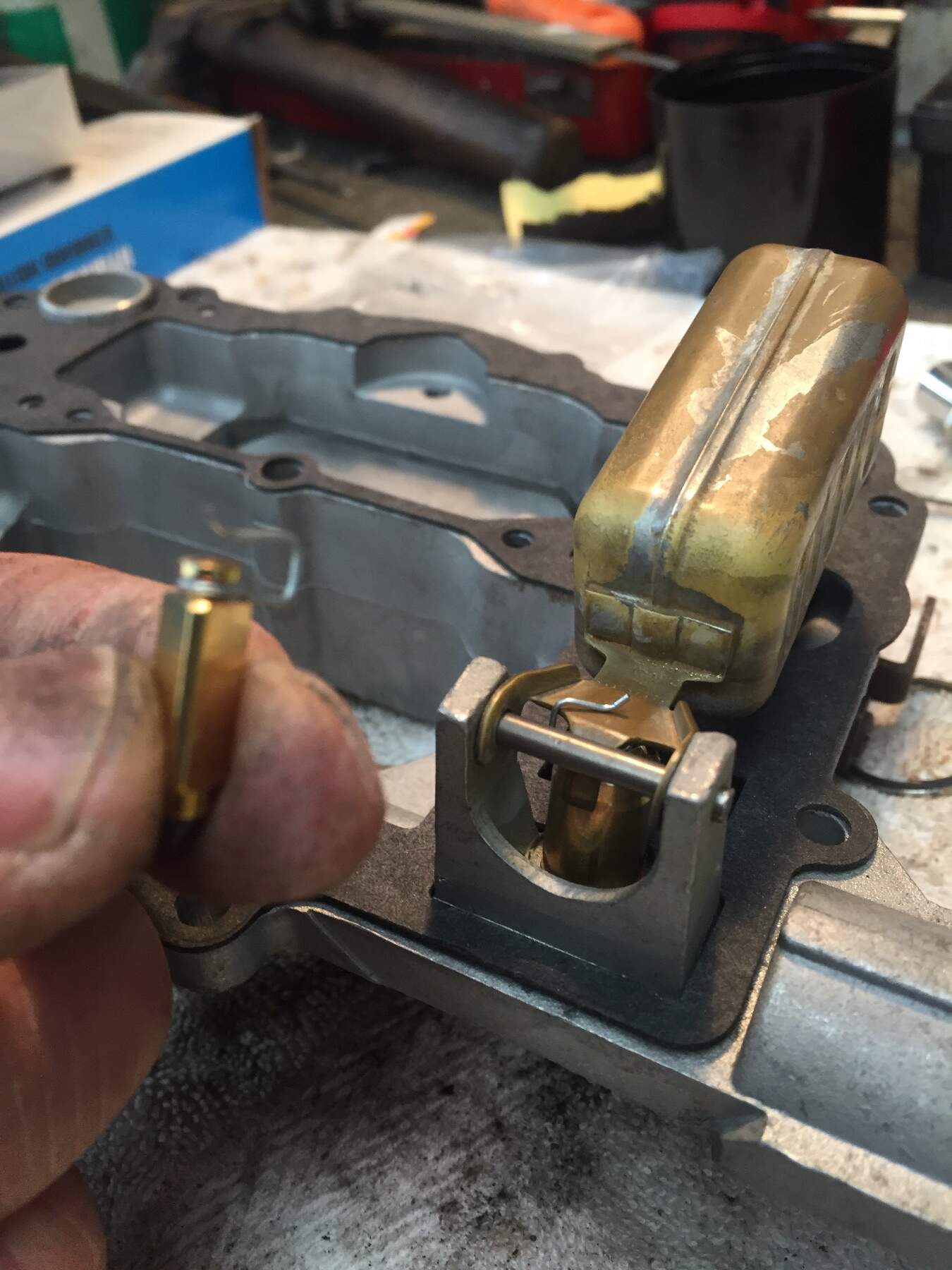

So I hooked the carter up and cranked the motor and no go... pulled the top off and found the inlet needles where not opening
then I checked the rebuild kit that I got from edelbrock and what was in the rock auto kit ,
here is the trap for young players ! The stock carter inlet needles don’t have a clip that pulls them open , but the new needles do !
I had used what edelbrock had supplied and no clips in that kit !!
so once I install the clips the float arm would pull the needle down off its seat !
watch for that little detail ... see pic
I also noted I was only getting a squirt of gas from the right side of the accelerator jet, so I pulled that off and found I had not cleaned it properly
With that all sorted she fired straight up and a quick tune of the idle jets and she is running better than ever 👍👍👍👍
onto the days mission !!

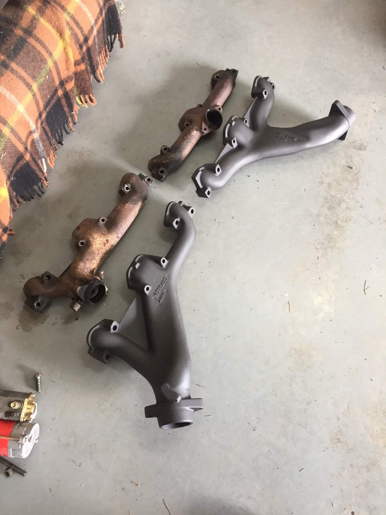

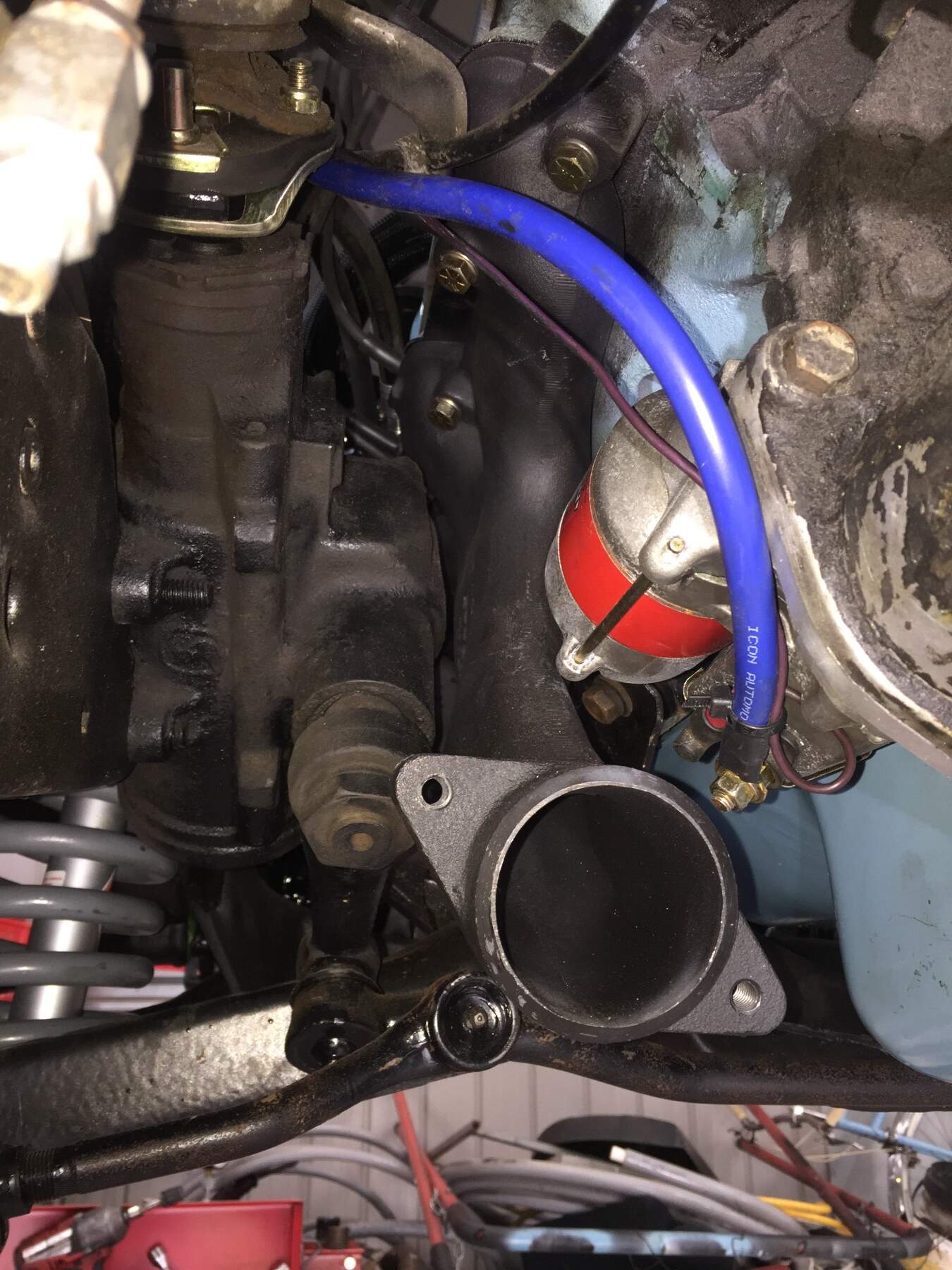

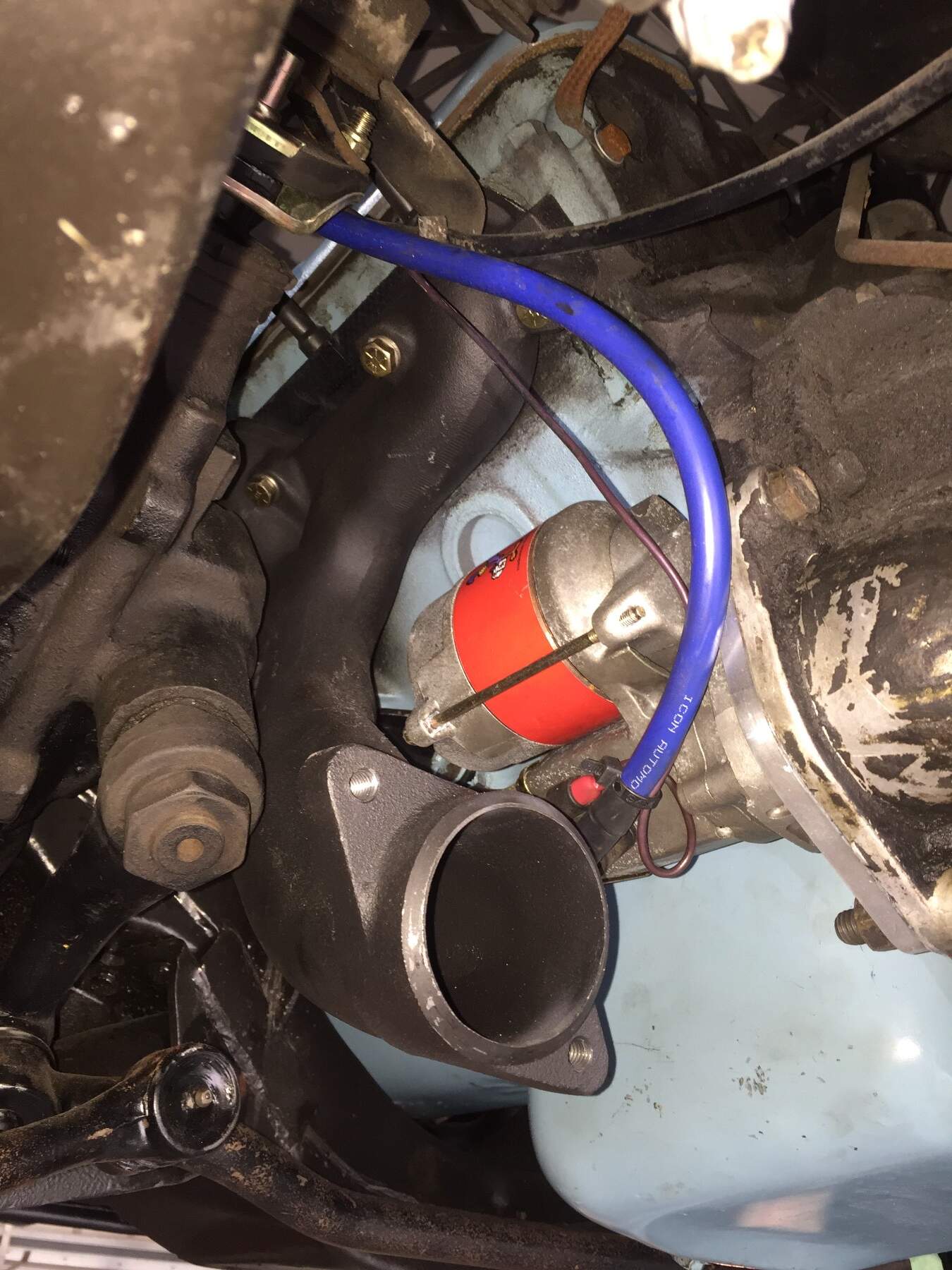

drove her into the hoist and out with the logs and in with the new super sexy long branch headers
A very nice clean fit too I might say

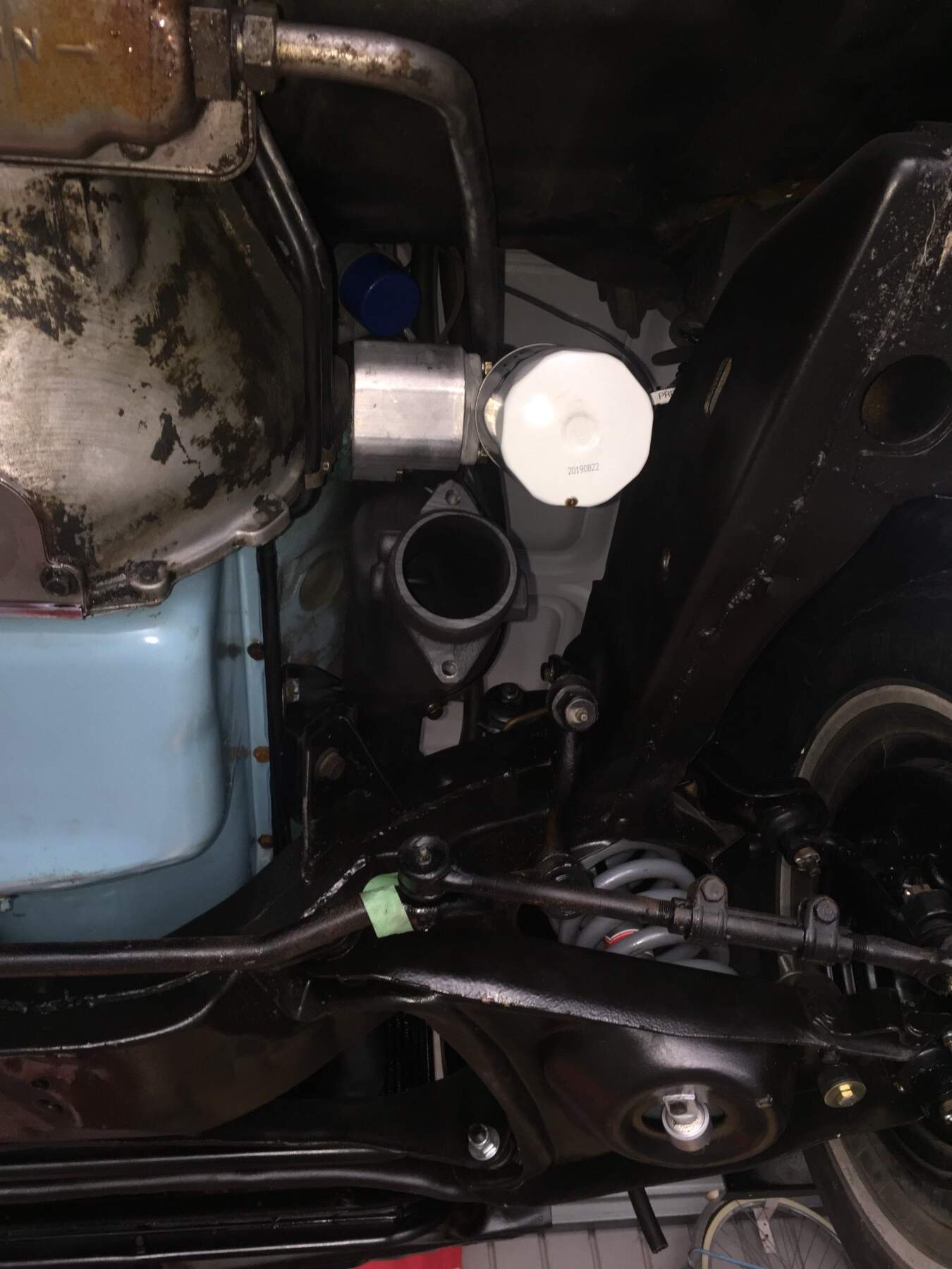

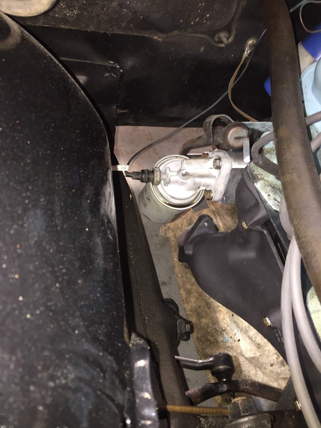

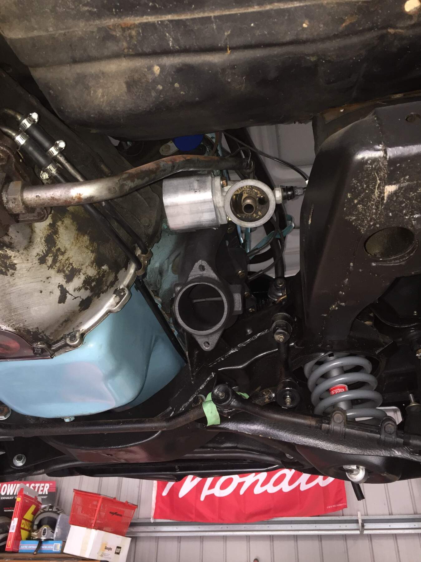

Fitzy some pics of the oil filter housing relocation
it moves the existing housing out, back and angles the filter
AWESOME....You have to be sooo anxious with all the great work done and how far you have come with this project. 😎
Very nice, can you imagine putting regular headers in, Pontiac with their exhaust port's oriented the way they are don't make it easy, like your oil filter relocation.
Nice work, Kiwi. I've never seen a needle valve be 'pulled' down before - only gravity assisted ones. Your headers look sweet. Man, that's a tight fit where they squeeze between the block and steering box.

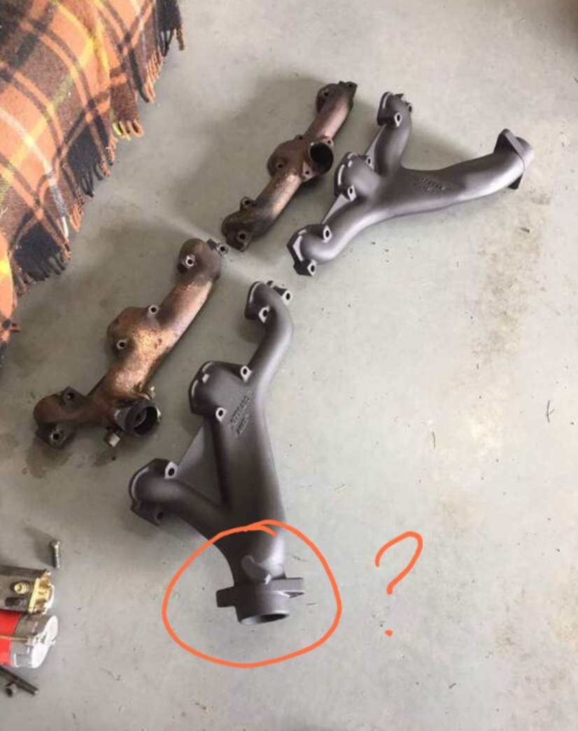

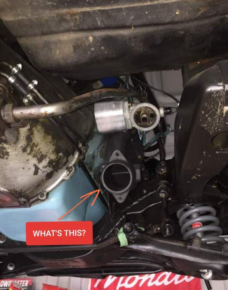

I have a question: is that some sort of valve sitting in the end of one of your headers-see pics.
yip! watch for that when you rebuild your afb Fitzy! ,,,,, without that little spring the bloody needle valve sticks in its seat and the fuel pressure doesnt push it open!
image.png.b2a01538d18afa1cbb563dcba10c965e.pngsorry mate its optical elusion ! there is no chock or valve like the dinosaur log manifolds
and i can tell you the 389 sounds way happier with the new headers too!!
what your looking at is the cast splitter between the runners, its not a valve or chock
yeah Andy with a 64 the steering box is right by the 2 middle exhaust ports ! so no way are any aftermarket tube headers ever going to fit.. but these cast iron repos work justA fine :rofl: , your lemans will have the steering box out the front, so no issues with headers

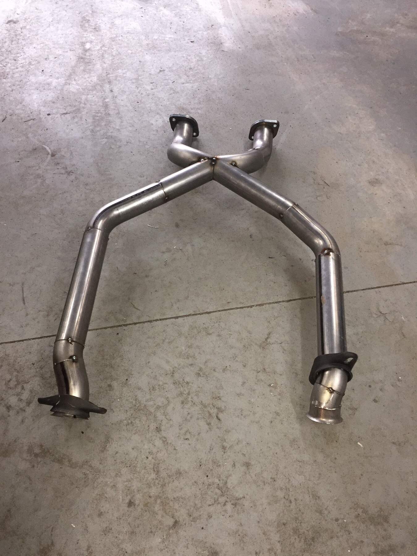

I spent all of today building the first section of exhaust
got it all tacked together and went to tig weld it up and my auto dark head shield shit it’s self , went and borrowed my mates one and then ran out of argon shield  gas !!! And it’s Sunday !! Nothings open 😡
basically time to knock off and go eat some nice food with friends and have a beer 🍻🍻
Oh ment to say
I am doing a x pipe system ... super tight to make it work but I think they work better than justA doing a h pipe
what you see here is the front section from the long branch headers and both sides have to step outwards to miss the trans shift linkage on the drivers side and the trans filler tube on the passengers side then wrap tight to the back of the trans pan ... x pipe then a sharp up and over the transmission support .
 and thats where i have made my firs flange joint :cheers:
