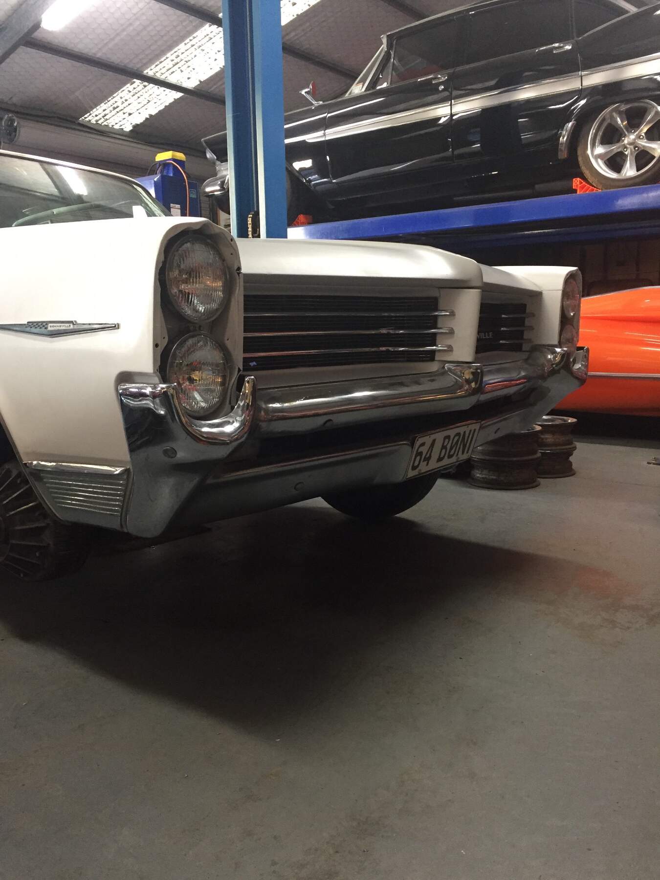

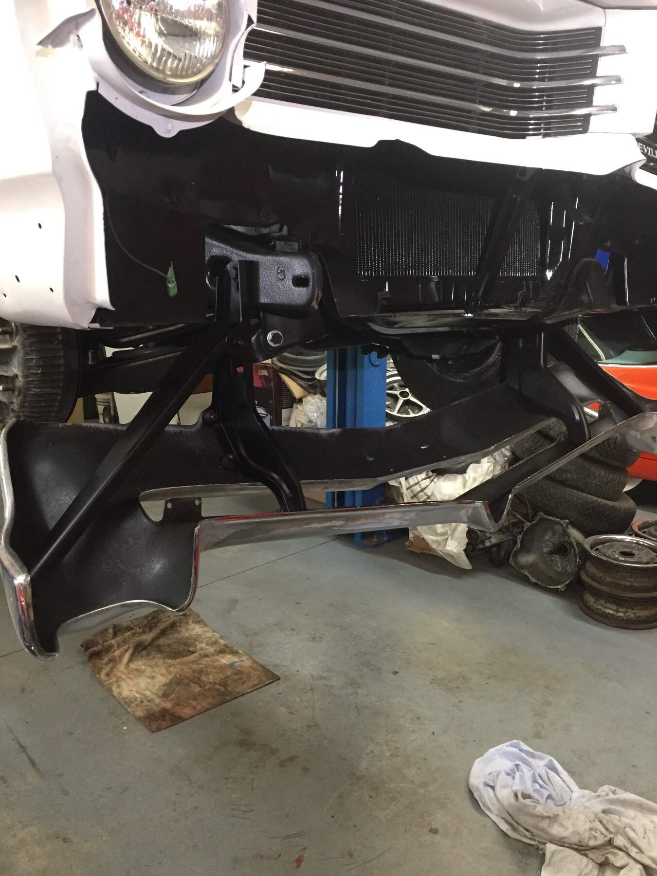

here is the first part ..... front bumper ....  6 hours on this one installation !!!
a 1964 pontiac bonneville front bumper weighs like 70 kgs... its not fun to fit by your self ... here is what i did.. i sweated grunted and curst to get the 2 rear bolts in and then i could hinge the whole bumper up......

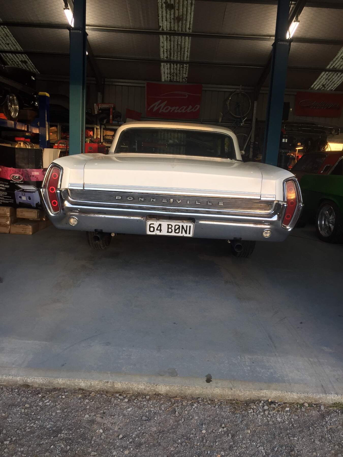

The 64 is really starting to look like a complete car again , I even fitted the new plates 👍👍
Dont look to hard,,, both my bumpers are in need of re choming .. but they are what i have and we make do with what we have !..
my frustration today was that the front bumper justA did not fit properly, i had that sucker on and off 10 times, had it in my press 3 times, moved the mounting irons 10 times and finally got it where it needed to be...a really pain in the butt job, that i didnt think would be that hard...
note to the next guy/gal fitting parts from different pontiacs'... they will NOT fit with out a whole bunch of..... love!!! haahaha  :rofl:
Another thing to note for anyone rebuilding their pride and joy is that i have the whole front clip still in primer stage.... why you ask! because all this parts on and off scratches shit !, the grill installation was a real pita, bumper the same, and when your doing fitment by your self.... well ....shit happens!..
by the time i have sorted all the adjustments and am happy everything fits like i want... THEN its time to pull it all apart and paint and refit.

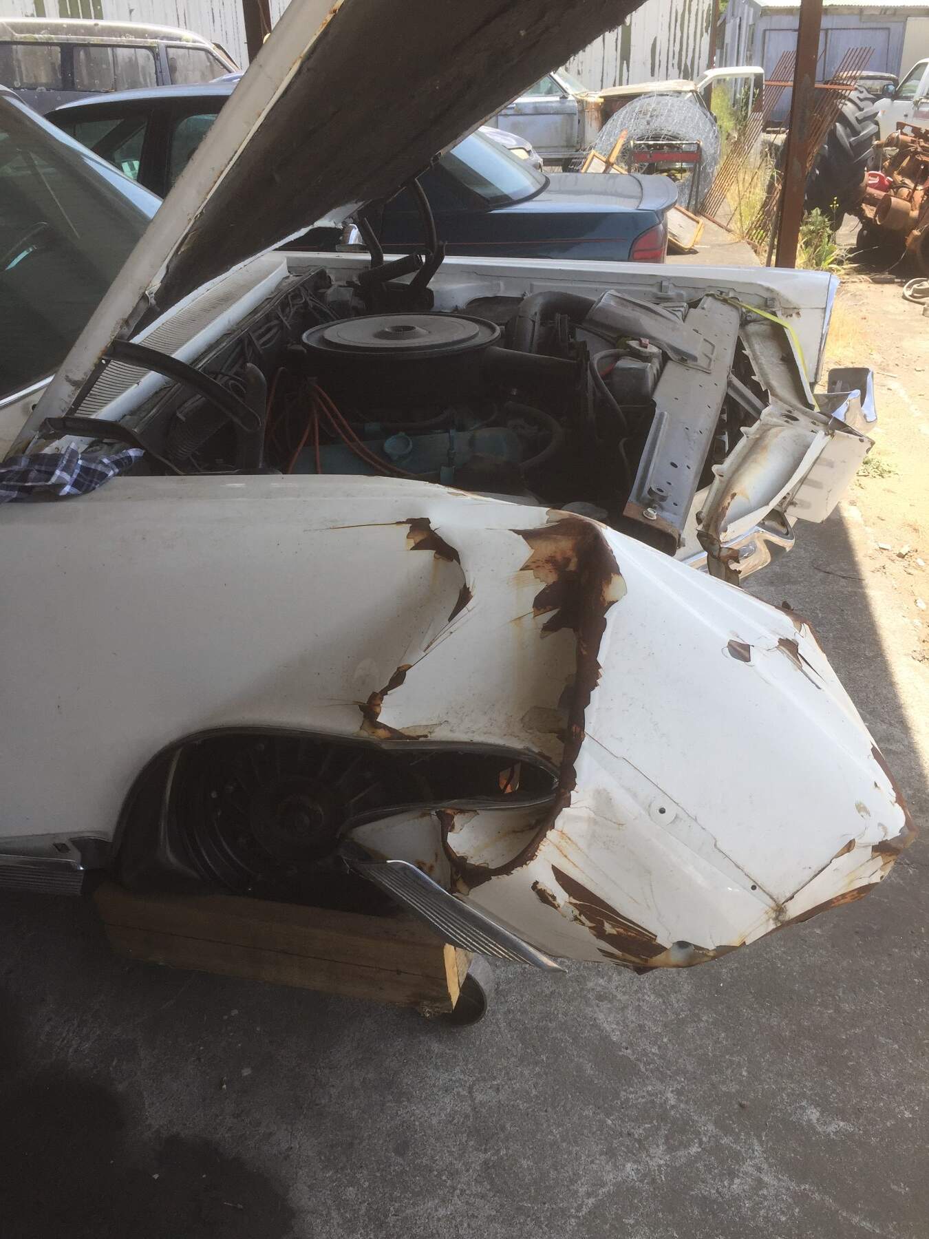

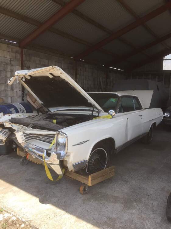

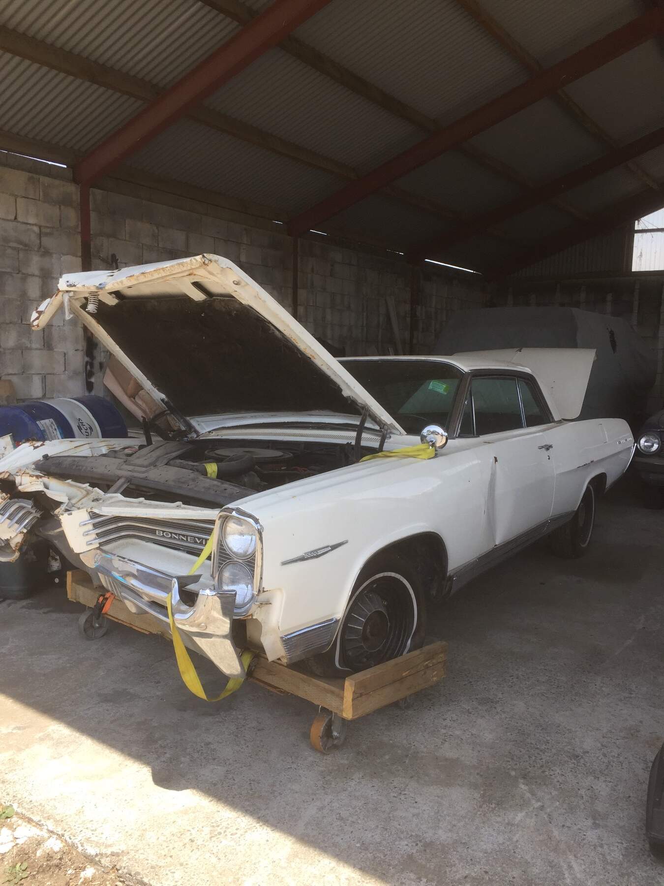

Nows a great time to show you all how she looked the day I went to look to buy her ..

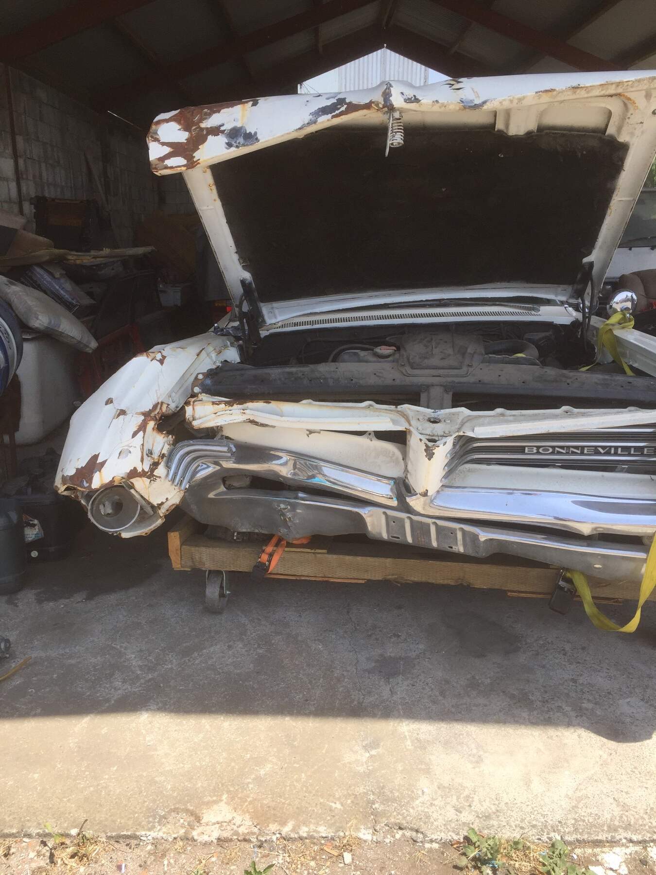

Kiwi, I had no idea your Bonnie was in such bad shape. Those photos tell the whole story. You've done a top job. Next time your Boss tells you you're uselsss, you can run back to FP and bask in the glow of our supportive comments. That'll show her.

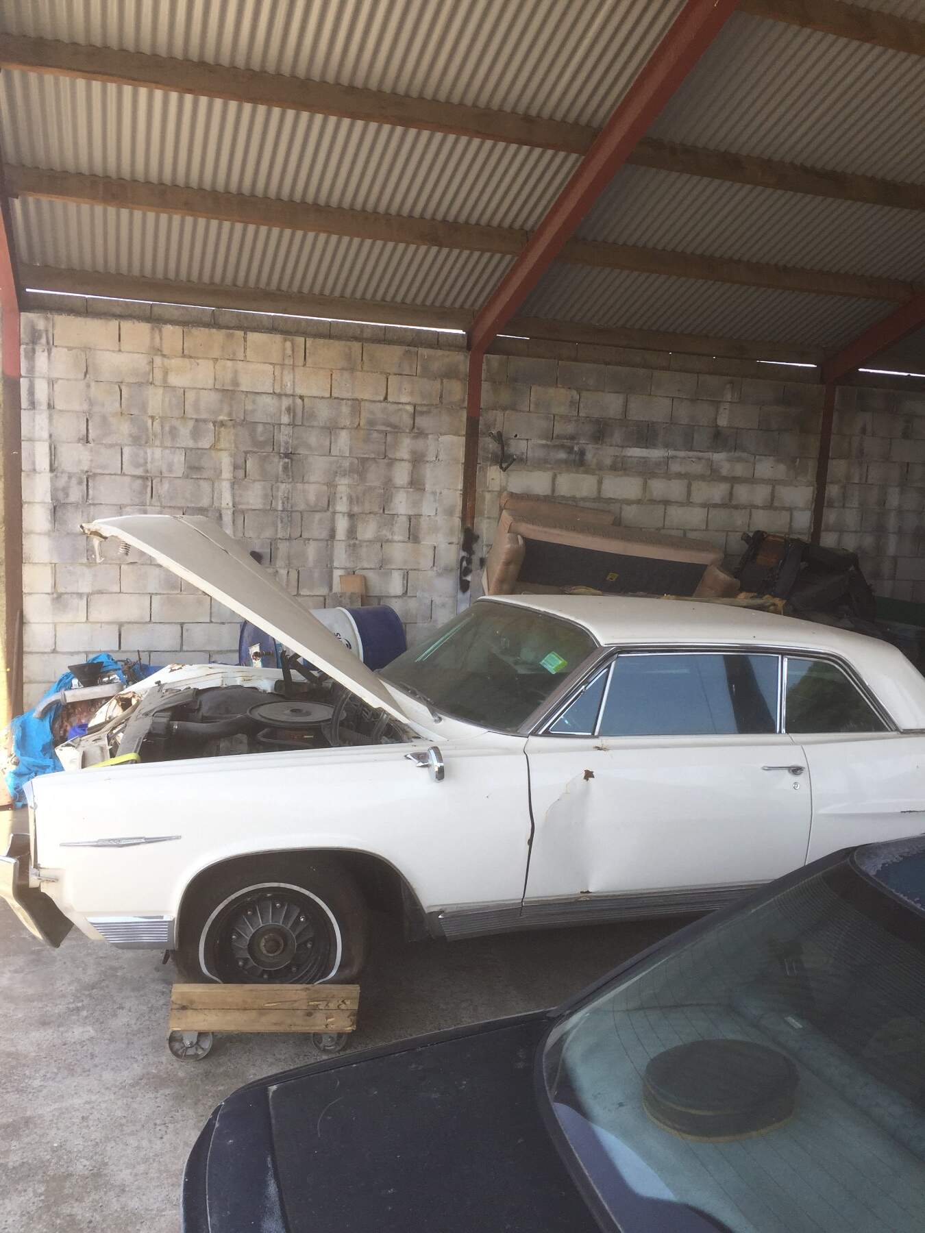

yes mate she was hit fair and square in the front passenger side chassis rail by something really hard! ( like a pole or armco)
when i went to first looked at her i could see that from the fire wall back was un touched and i thought to myself... i can fix this !!
 the luck was in finding another whole 64 bonneville chassis in new zealand that was straight, rust free and for sale !! luckily the guy i bought her off gave me a number of a guy... who has become a great friend now... who justA happend to have a whole parts car... long story short, that body is now under my trees short of its chassis :cheers:

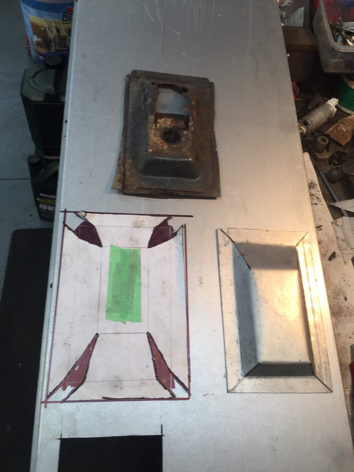

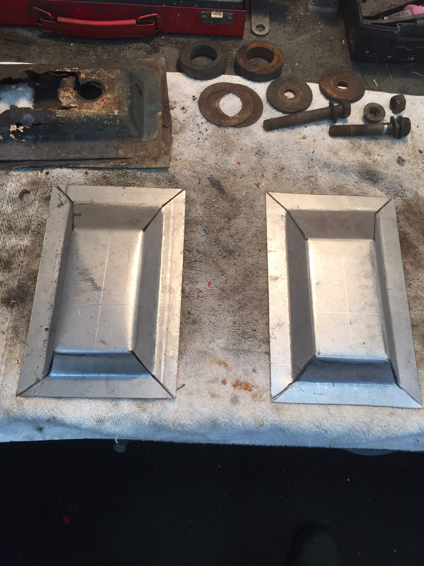

Months ago when it was a nasty weather day I had time to make a pattern for the missing sub body mounts justA behind the rear wheels holding up the trunk floor. At some time in the 64 life in California, it had a trunk floor replacement and they never replaced the sub brace mounts justA behind the wheel arch, which ment the the whole car was mounted at the bolt point at the top of the wheel arch and the next fixing point was right at the rear bumper mount!
This would be a big no no when i go to vin the car for nz .. so in goes my hand made version of what the factory made... top is a factory mount that i made a paper template from....below right is the one i made months ago.. and left is my template marked out on a bit of 1mm steel.

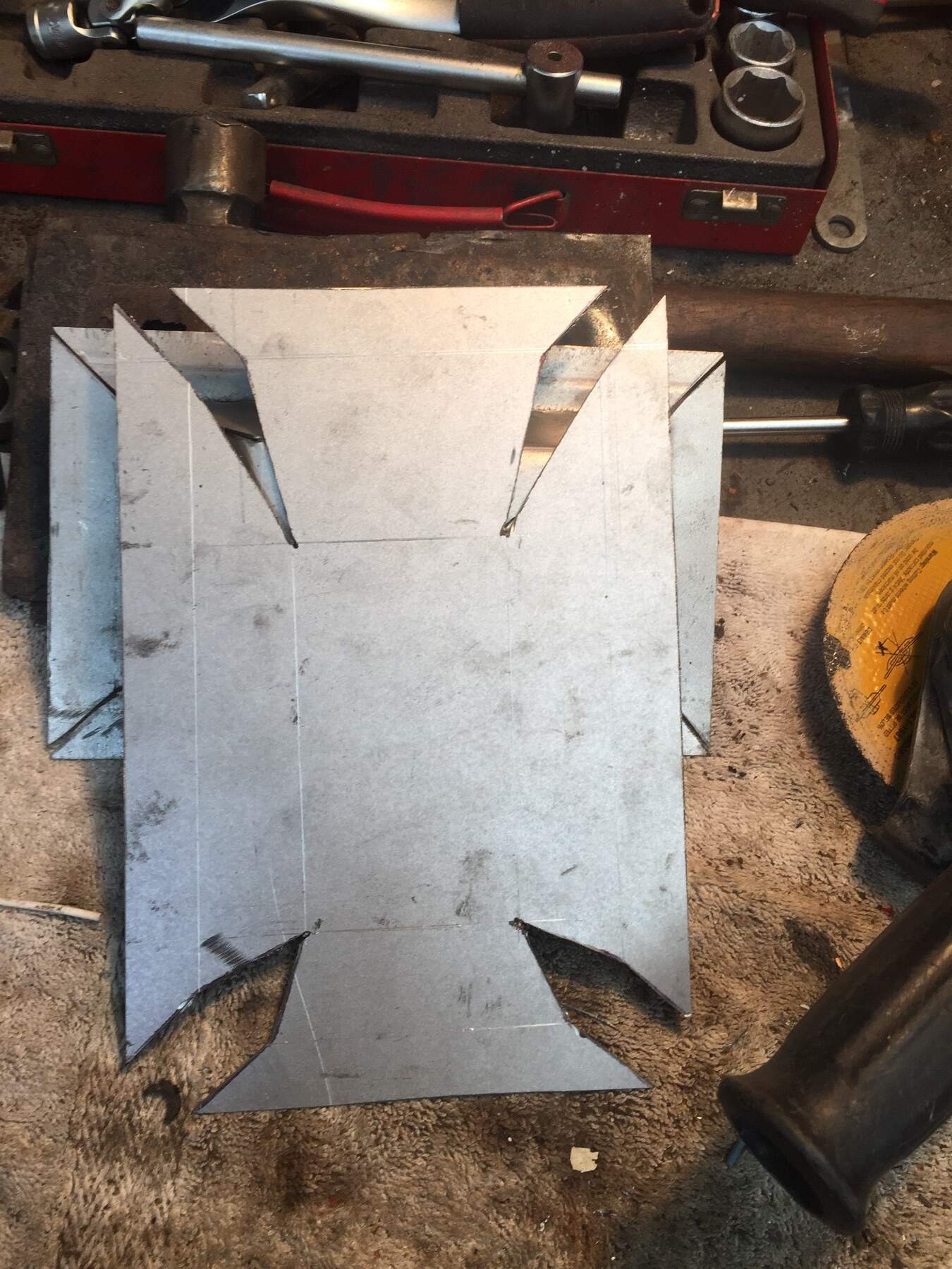

so I cut a second pattern out and folded up the subframe support
