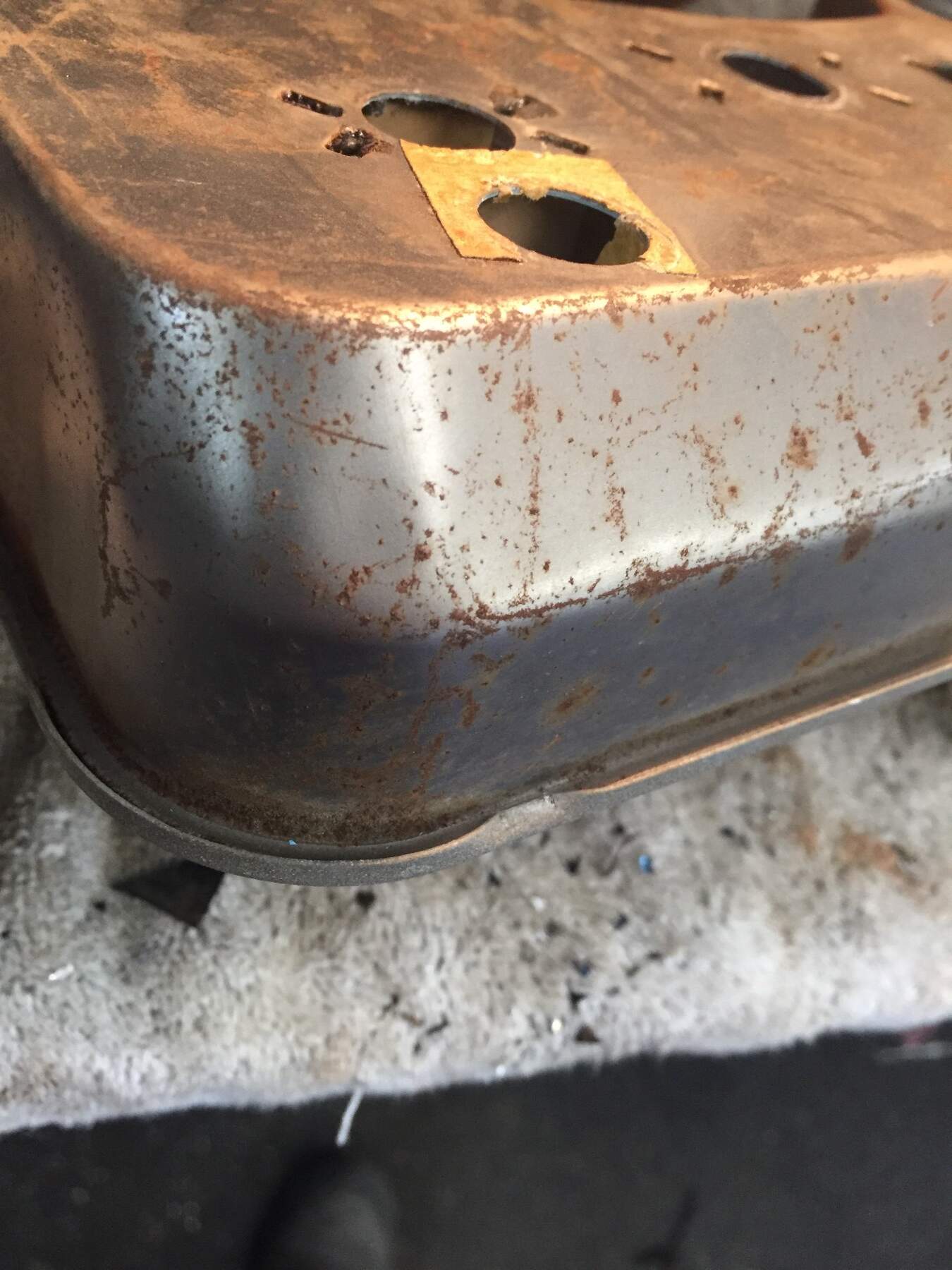

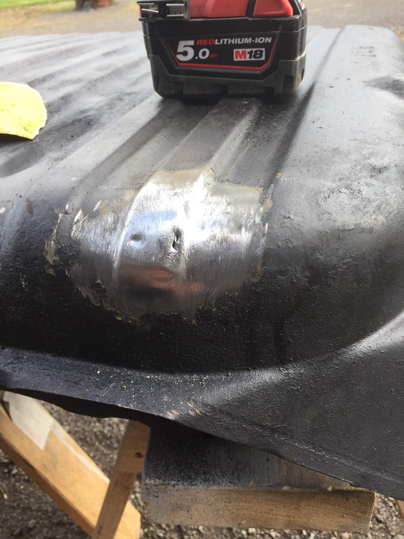

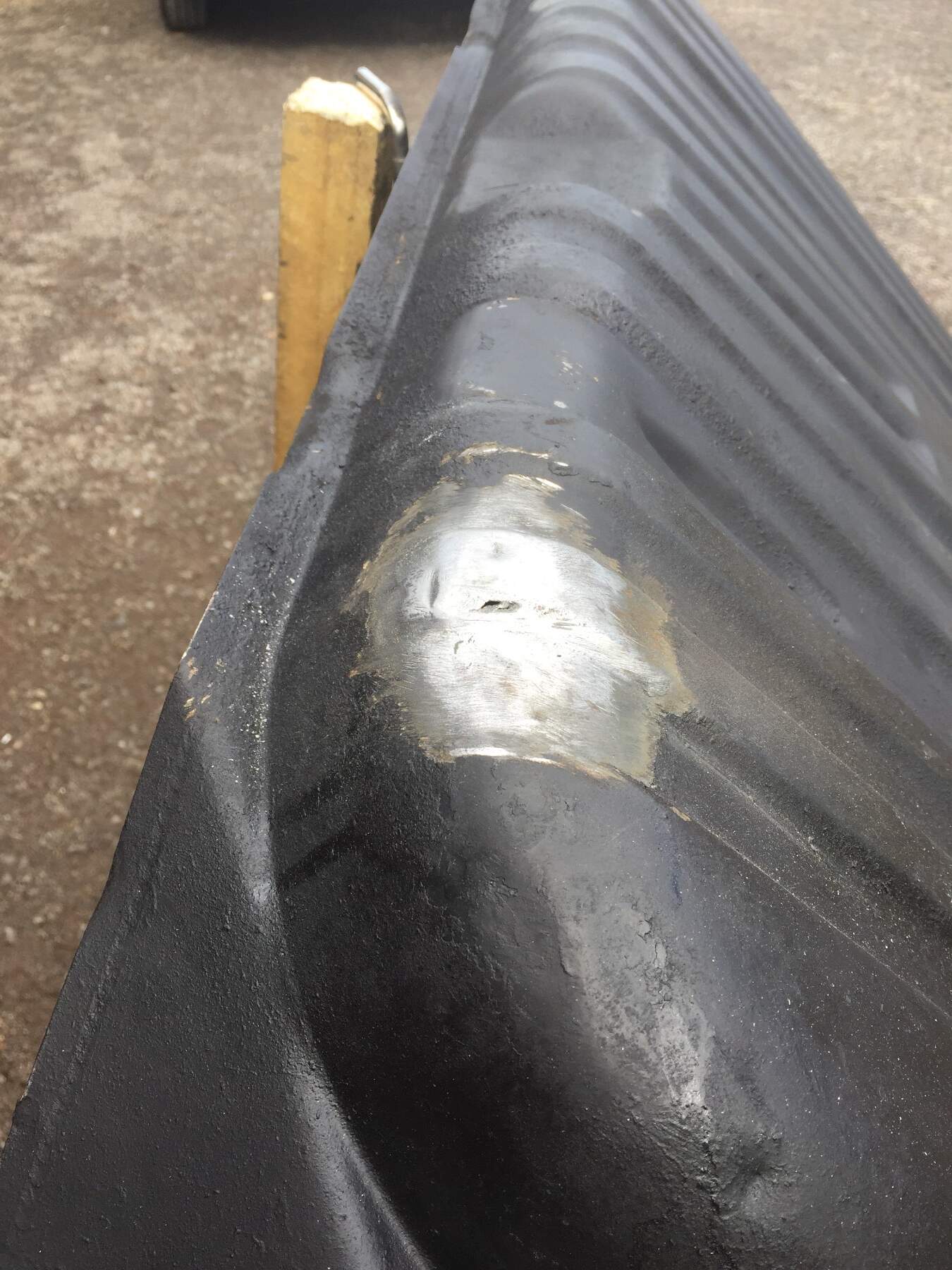

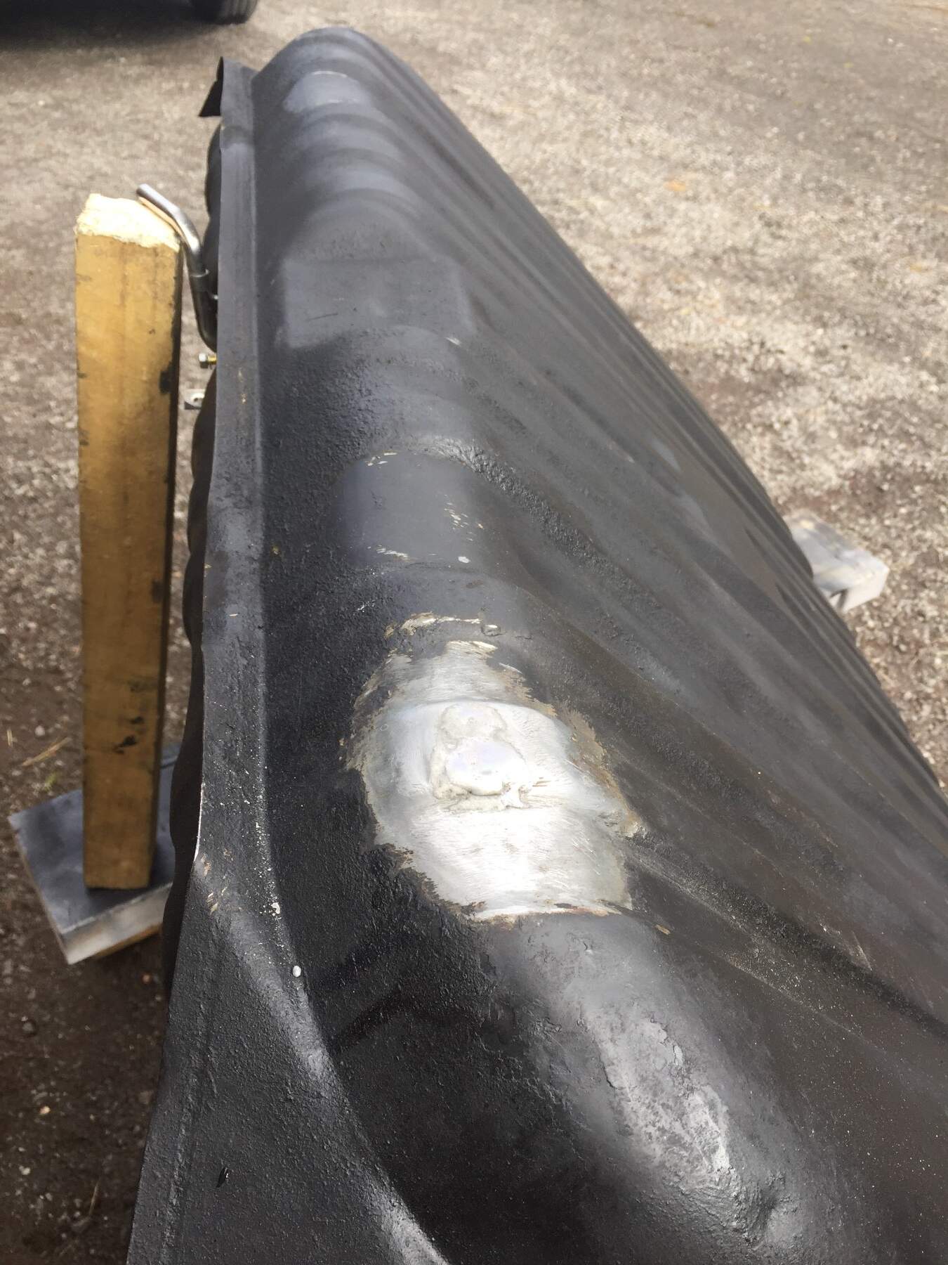

Looks to be a old puncher wound ย that some one had put some sort of bog over ,,

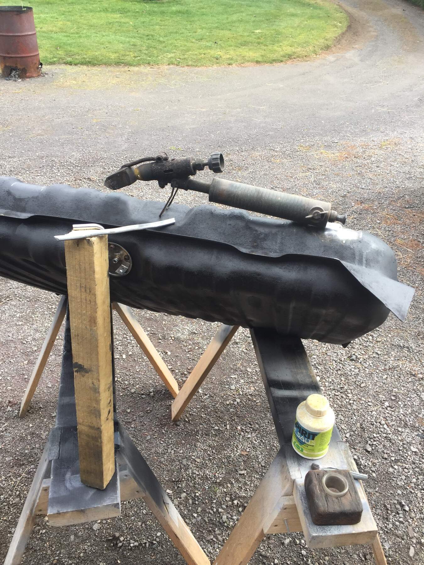

so out with the old Barthall solder iron that doesnโ€™t get to to see any work these days and I soldered it up !

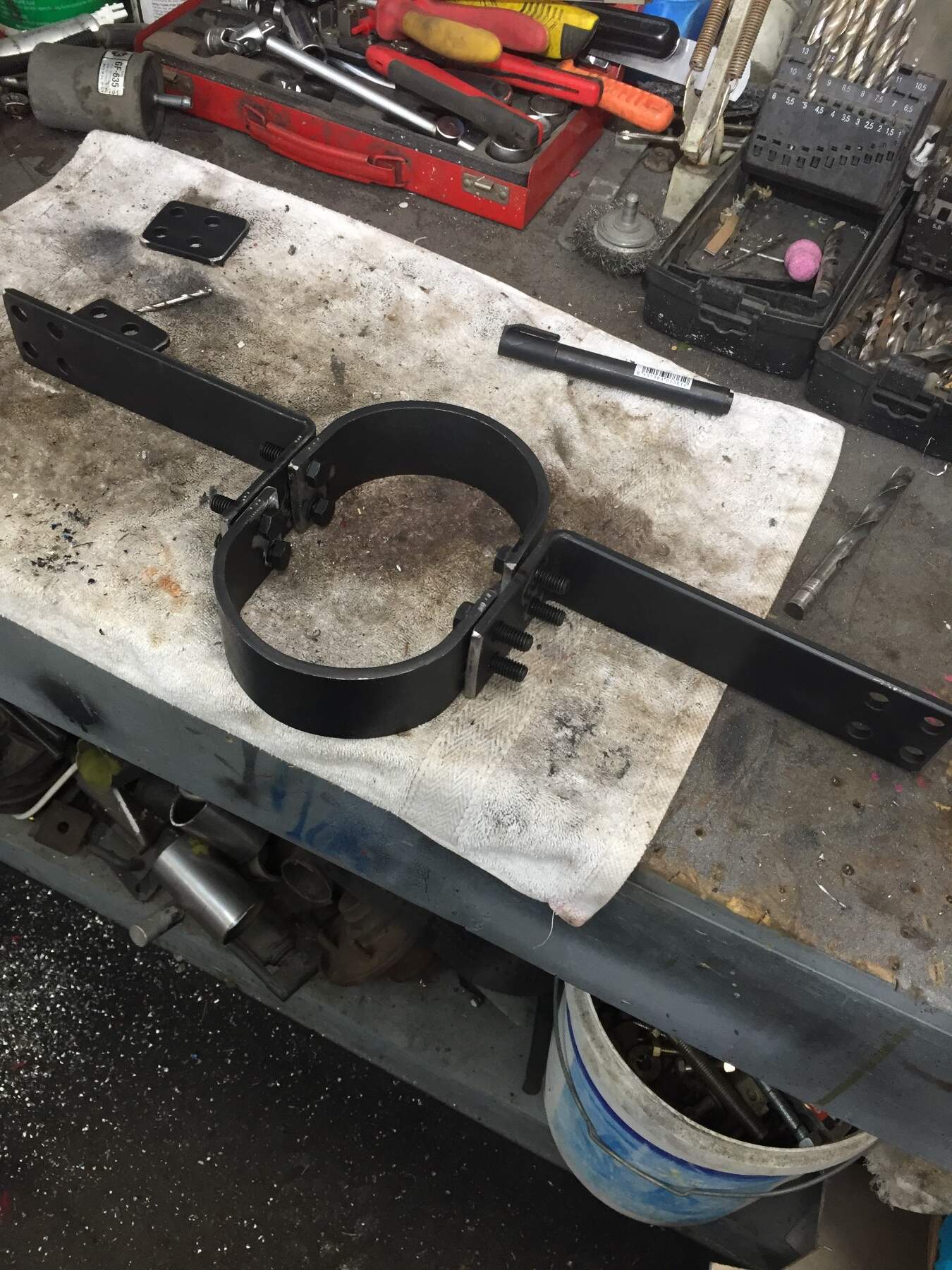

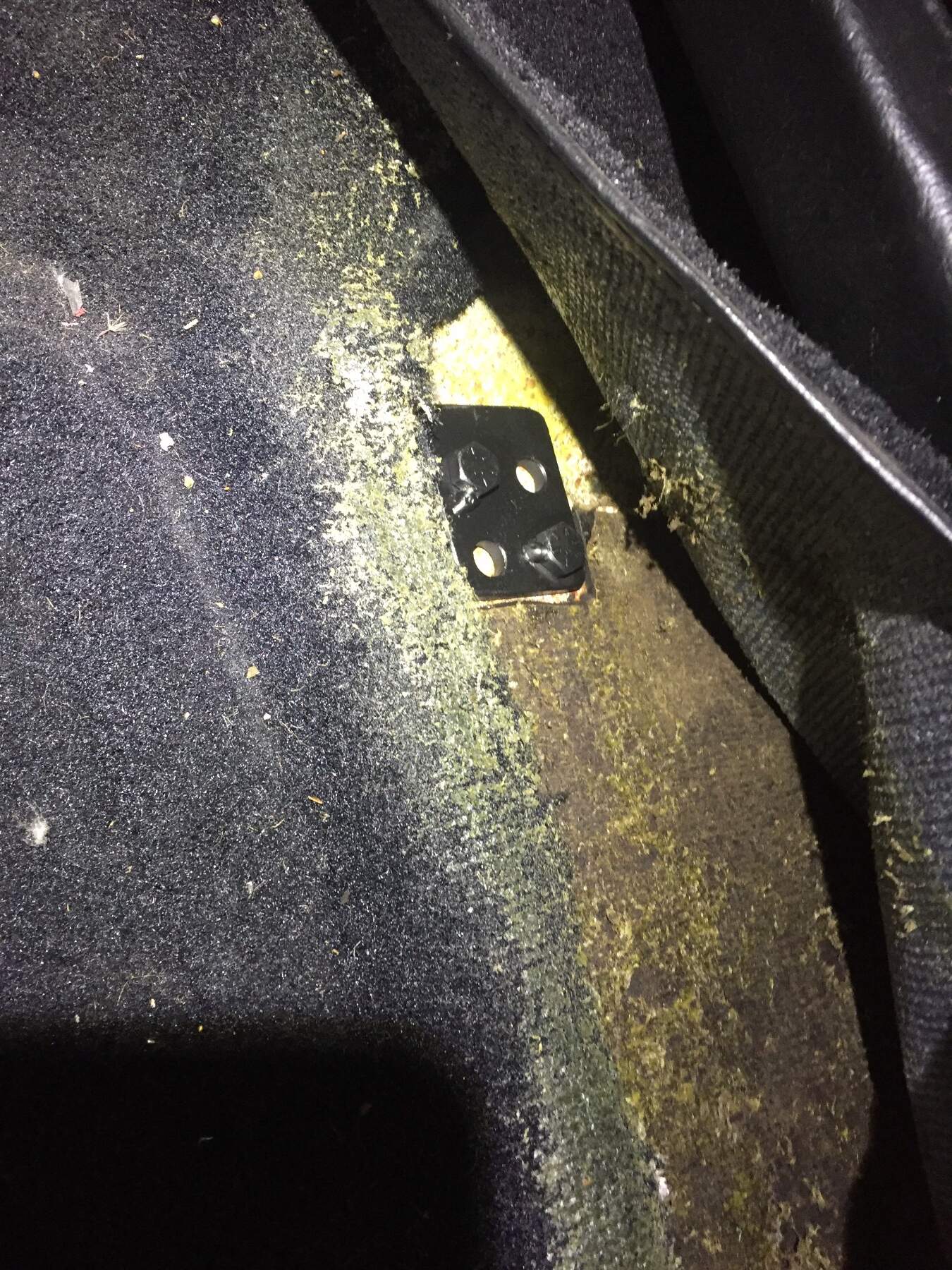

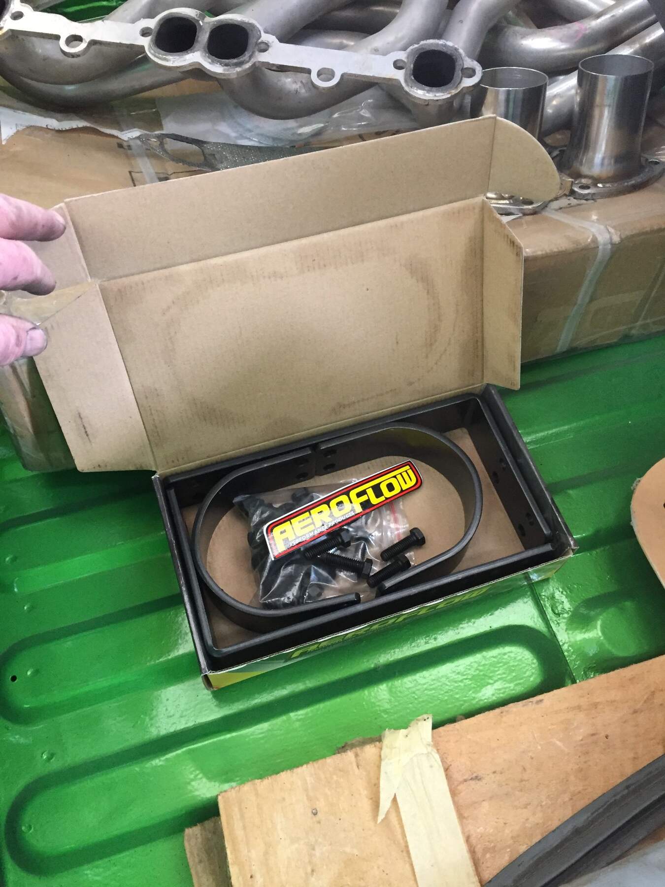

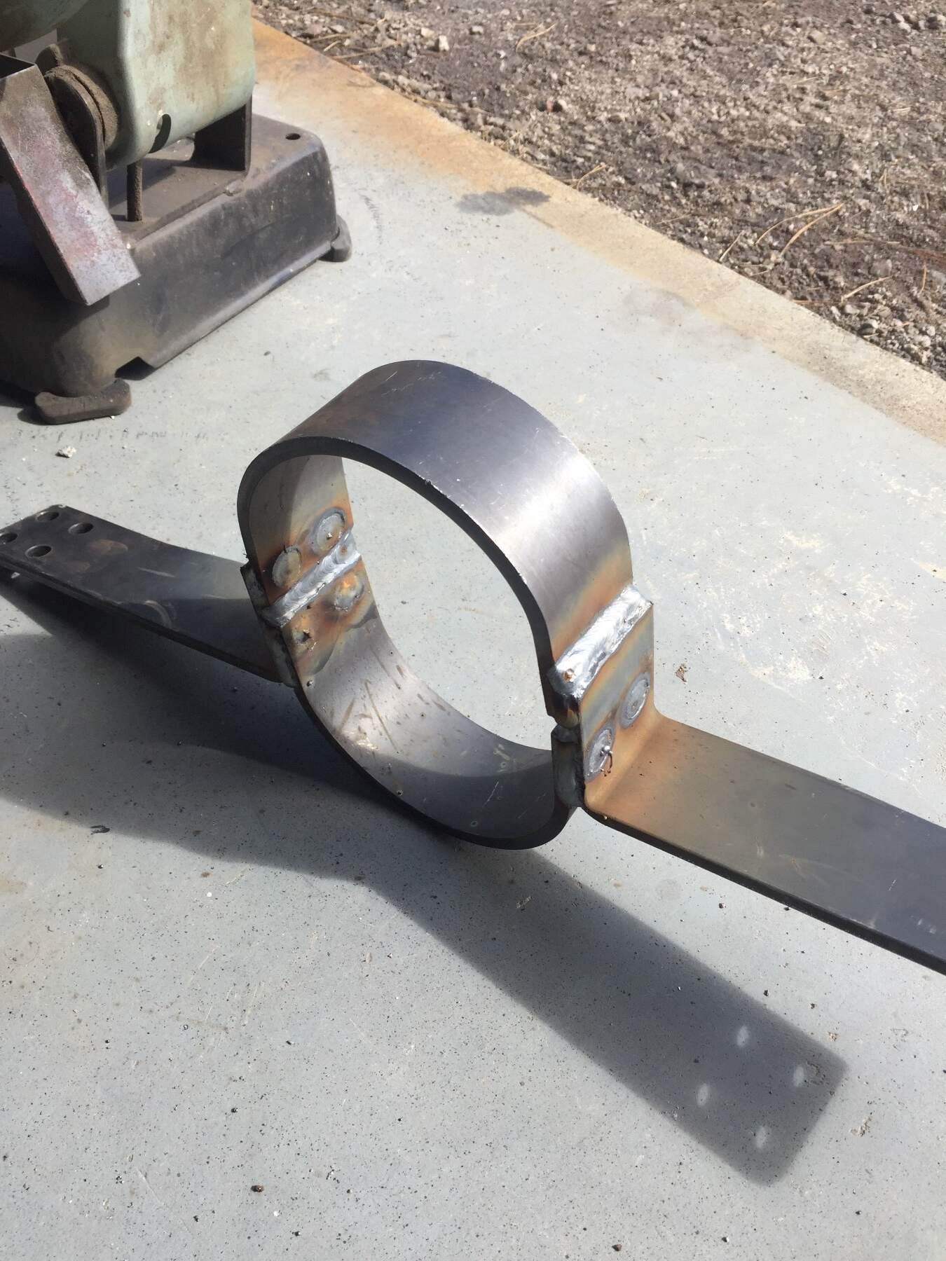

And then I could get on with what I wanted to achive today ... my drive shaft loop ..
ย this was a $52 kit with bolts and everything needed to make a nz legal drive shaft loop , and for the money it is cheap.... i didn like all the bolts so i welded the sucker and was wayy happier with the out comeย
ย

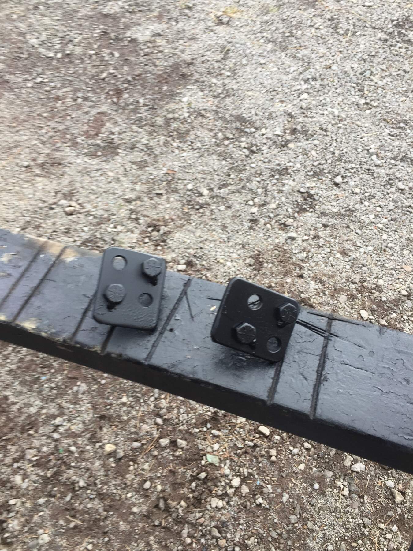

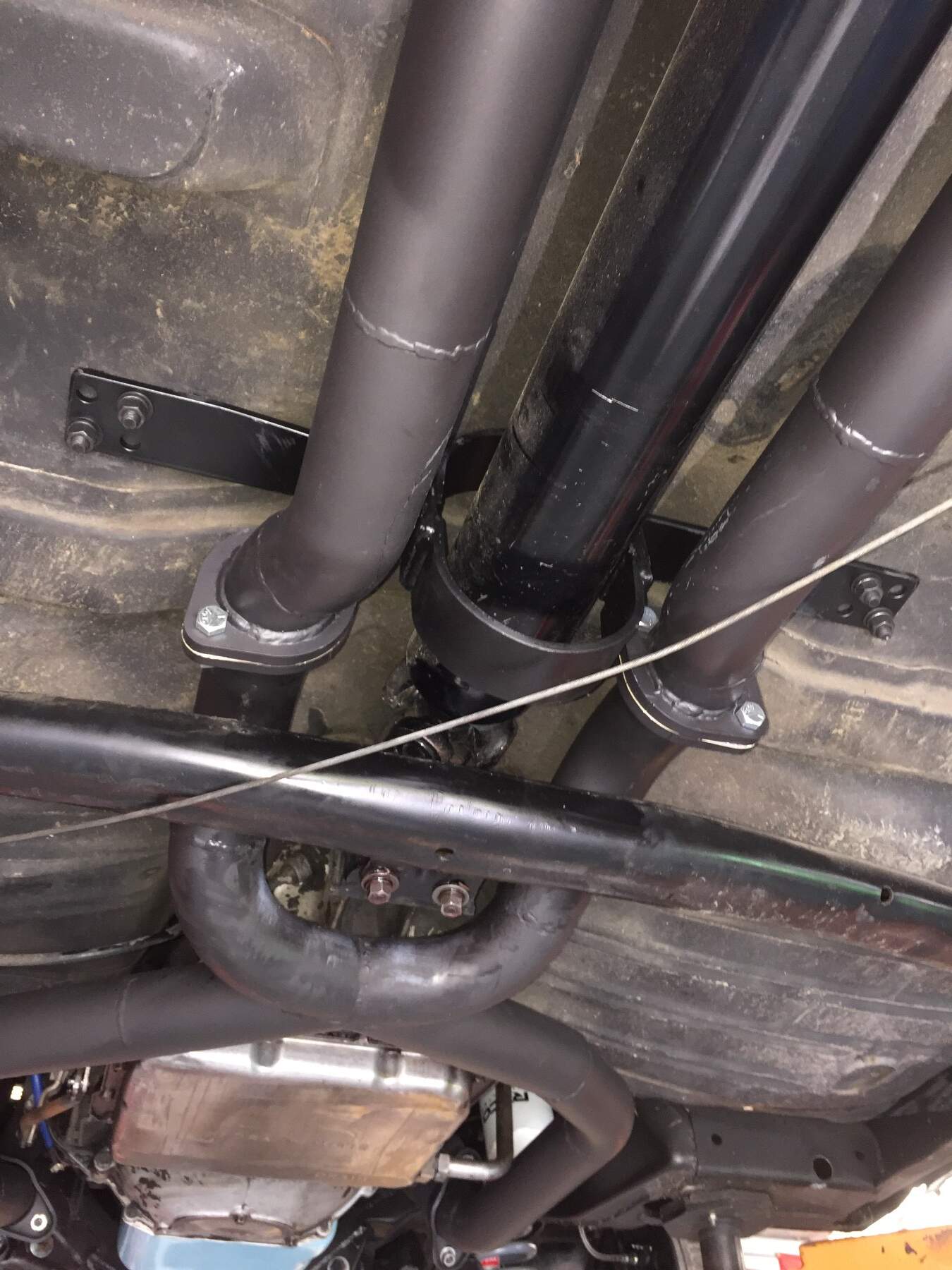

now with the rules i had to bolt this through the floor pan and achieve a 3000mm2 area plate on the top- side, bolted with 2 x 10mm bolts toย  be legal,, these plates have to have a 5mm radius on the corners and the whole plate has to be arised at 1 mm... i guess so it can not cut its way clean through the floor under the stress of a drive shaft trying to shit its self !!hahahaย :rofl:ย ย
sorry got my pictures around the wrongway,,, first 2 are of the plates through the floor pan, last pic is of the plate i made up, and tacked the bolts to them to drop through the floorย
ย
ย
Way happy with my safety loopย

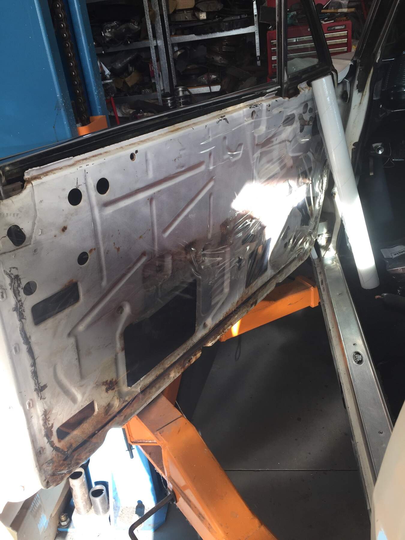

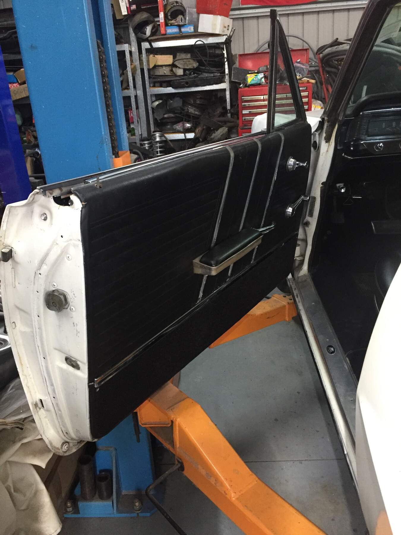

Last job of the day was to fit the freashly repaired drivers side door trimย
I painted the backing board to prevent it from rotting and I made a new door film from a roll of carpet protectorย
Another box ticked off ๐Ÿ‘๐Ÿ‘๐Ÿ‘๐Ÿ‘
Gutsy man right there.ย  Even if you drained the gas, there is fresh gas fumes.ย  ย WOW

Amazing all the rules and regulations they have in different place/ countries , I grew up with some of them but they also changed as the year's went by. How come all the factory cars that did not come with a loop was ok ๐Ÿ™„ Not that a loop is a bad thing.
We are truly spoiled here in CA just got back from the early morning donut shop meet and theย  stuff some people drive here and it's ok is amazing.
Nice loop installation and I like your exhaust.
Yes justA. Always mindful of gas fumesย
but I didnโ€™t have any flame near the tank at allย
justA hot solder bolt ๐Ÿ‘
All good glad it worked.

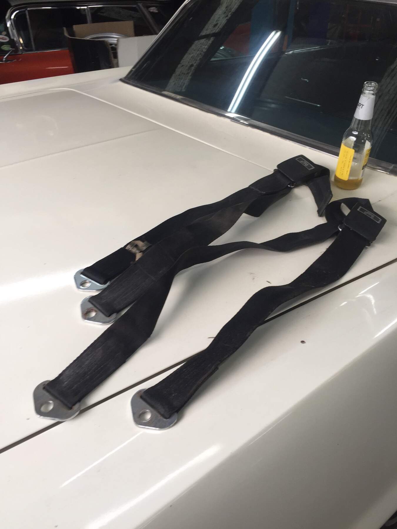

i pulled the seat belts ... they will need to be upgraded ย to be nz legal .... more on that latterย

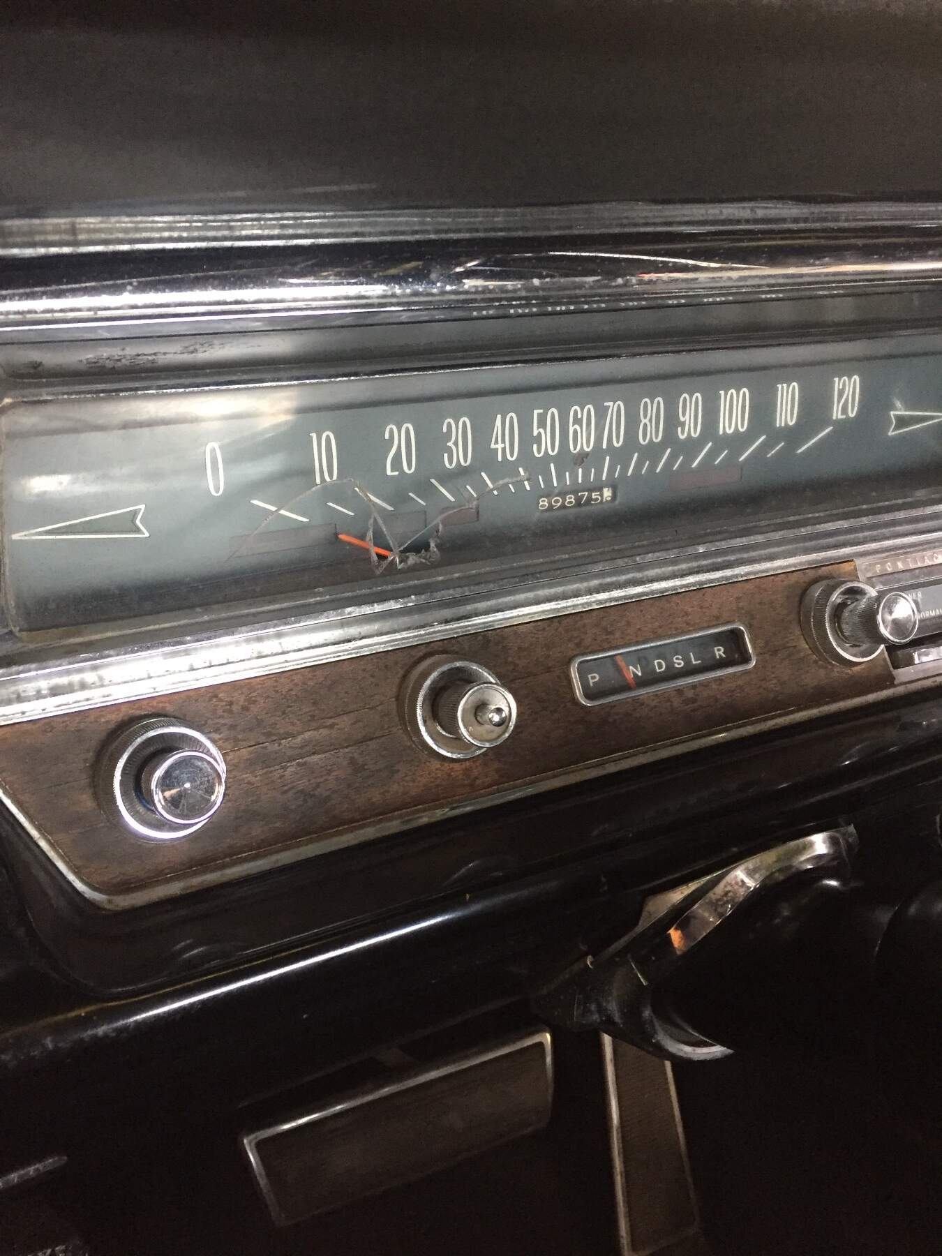

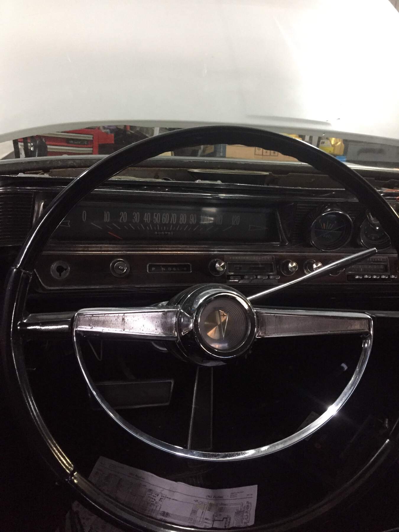

the poor bugger who was behind the wheel when my boni hit something really solid must have had their hand rammed into the speedo ...
here is the picture of the damageย

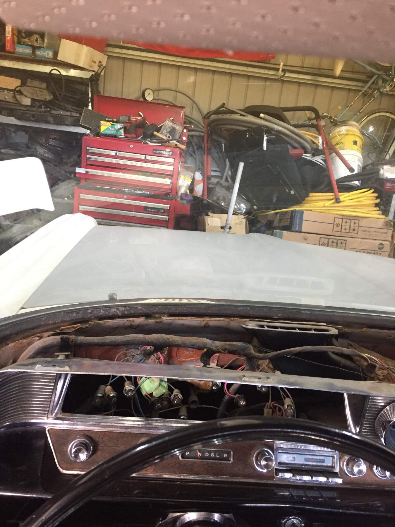

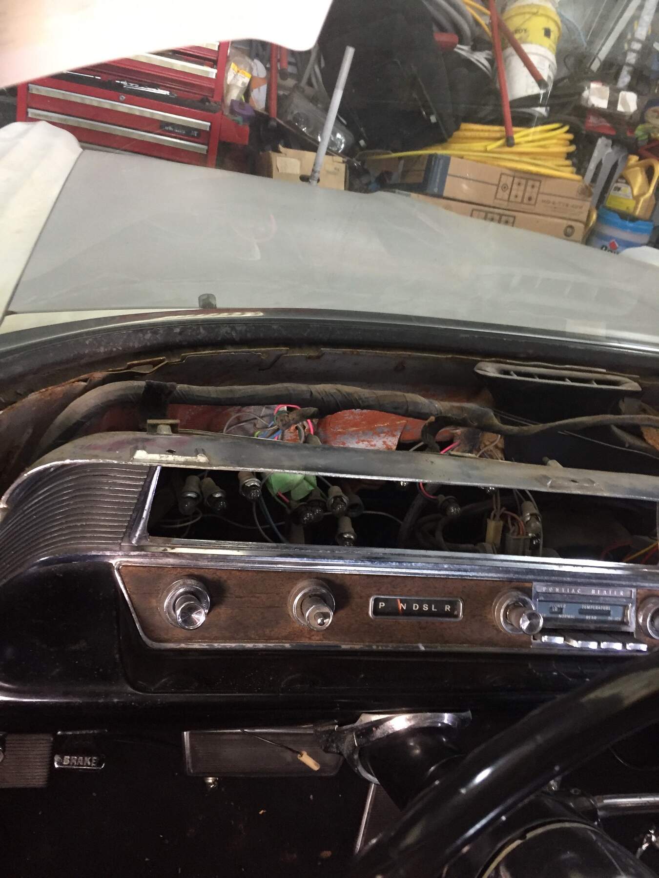

So I pulled the dash pad off ....ย
note to fitzy and wrongway ... my dash has a after market plastic cover on it !!
and I did have to glue one part up that had not stuck properlyย
Spent quiet a while going through all the bulbs and making sure they are all working while I had the dash pad offย
wayyy easier than trying to bend my old body under the dash ... but still had to do that too !! I know I will pay for that tomorrow !!! ๐Ÿ˜กย

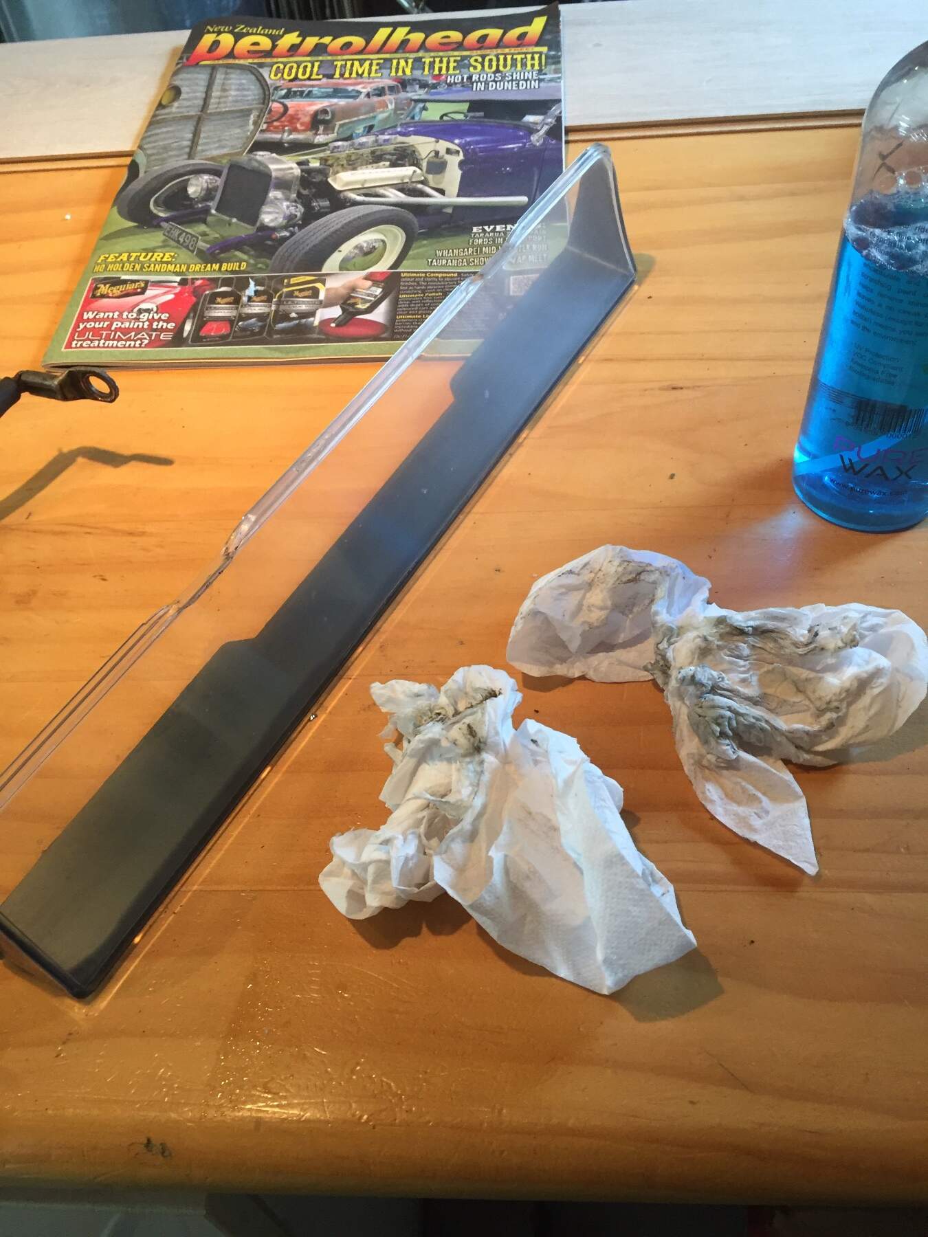

For anyone doing a swap of a lenses on a 64 speedo ... once the unit is out itโ€™s super simpleย
a light metal frame holds the lense in and 4 bent / crimps hold it togetherย
I pulled the lense and removed years of dirtย
and reassembled ๐Ÿ‘๐Ÿ˜€๐Ÿ‘

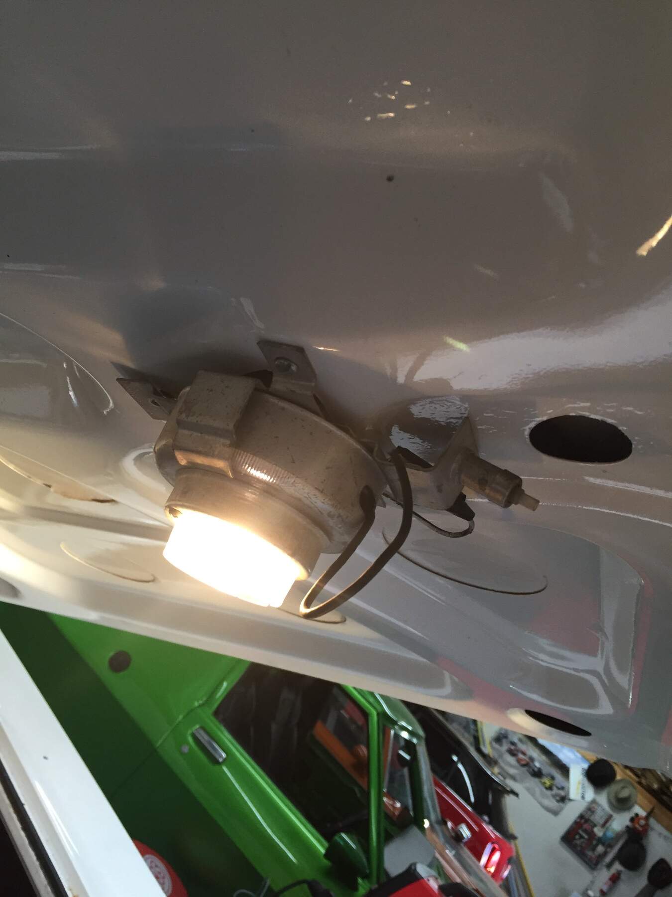

Does anyone know what switches the removable domeย light in the trunk ?
ย
I believe I read that it's a gravity switch.ย I have the same light but have never found any switch to activate it. I laughed when I learnt how to unclip it and unspooled the wire right around to the engine bay. How old fashioned and quaint. No LED pen lights back then, or mobile phones with a torch and no need now to peer under the hood to see why the car stopped, because modern cars don't break down like they used to.

my trunk light works great ... to great ! It doesnโ€™t turn off !! Hahaย
ย
Dang was gonna have fun with this one.ย  Fitzy is right.ย  Question really is does it shut off when ya close the trunk.
no it doesnt mate... i am going to pull it apart and see how it works !!

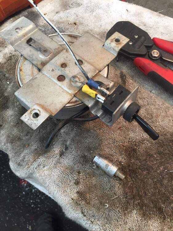

No real clue as to what switches it justA this small cylindrical thing that used to have wires going in to it at some stage of its lifeย
so for now itโ€™s getting a switch ย

That's a great idea - well done. You don't suppose that little cylinder was the switch? If not, I wonder what it's purpose is?
Not sure at all ... maybe Del reads this and can enlighten usย
as I am sure his rag top would have oneย

I had to use a bit of hose as a nut to hold the second hand switch in place !!!

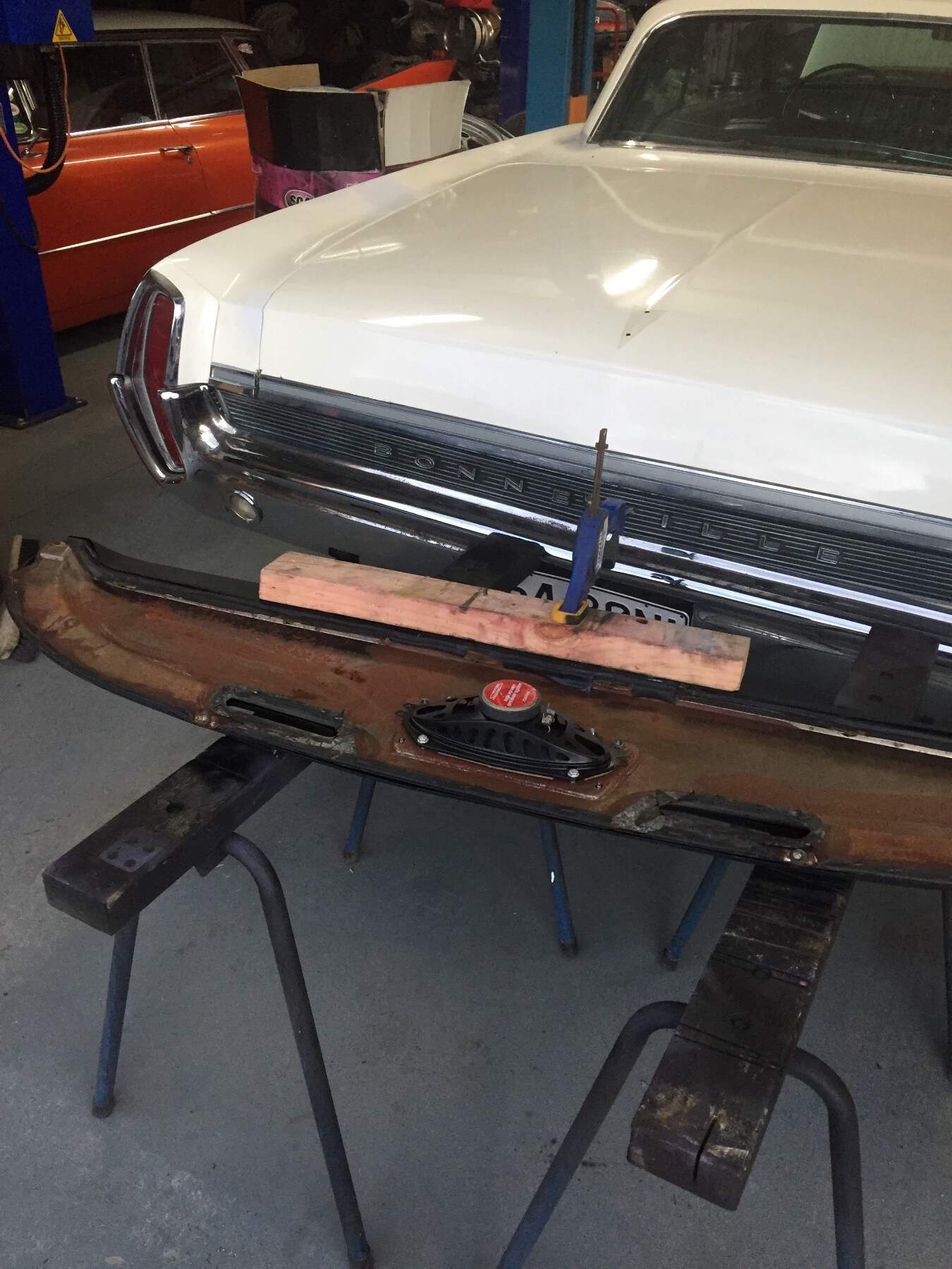

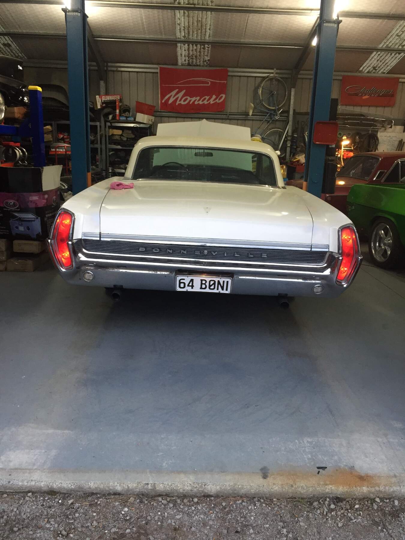

today was all about getting the head light/ tail light circuits sortedย
which after finding the faults in the wires from the switch, finding the tail light plugs that had been replaced and wired wrong... 2 of the 6ย had the wires crossed and tail lights with 21watts beaming away ! instead of the 5 watt they should have.
at the end of the day i had correctly working tail lights and number plate light!!!
Any keen eyed 64 owners out there would spot the 2 middle tail lights not working!! i justA ran out of bulbs !!! and they are on my list of parts to get once i am allowed to go to the parts shop !!! ...ย
