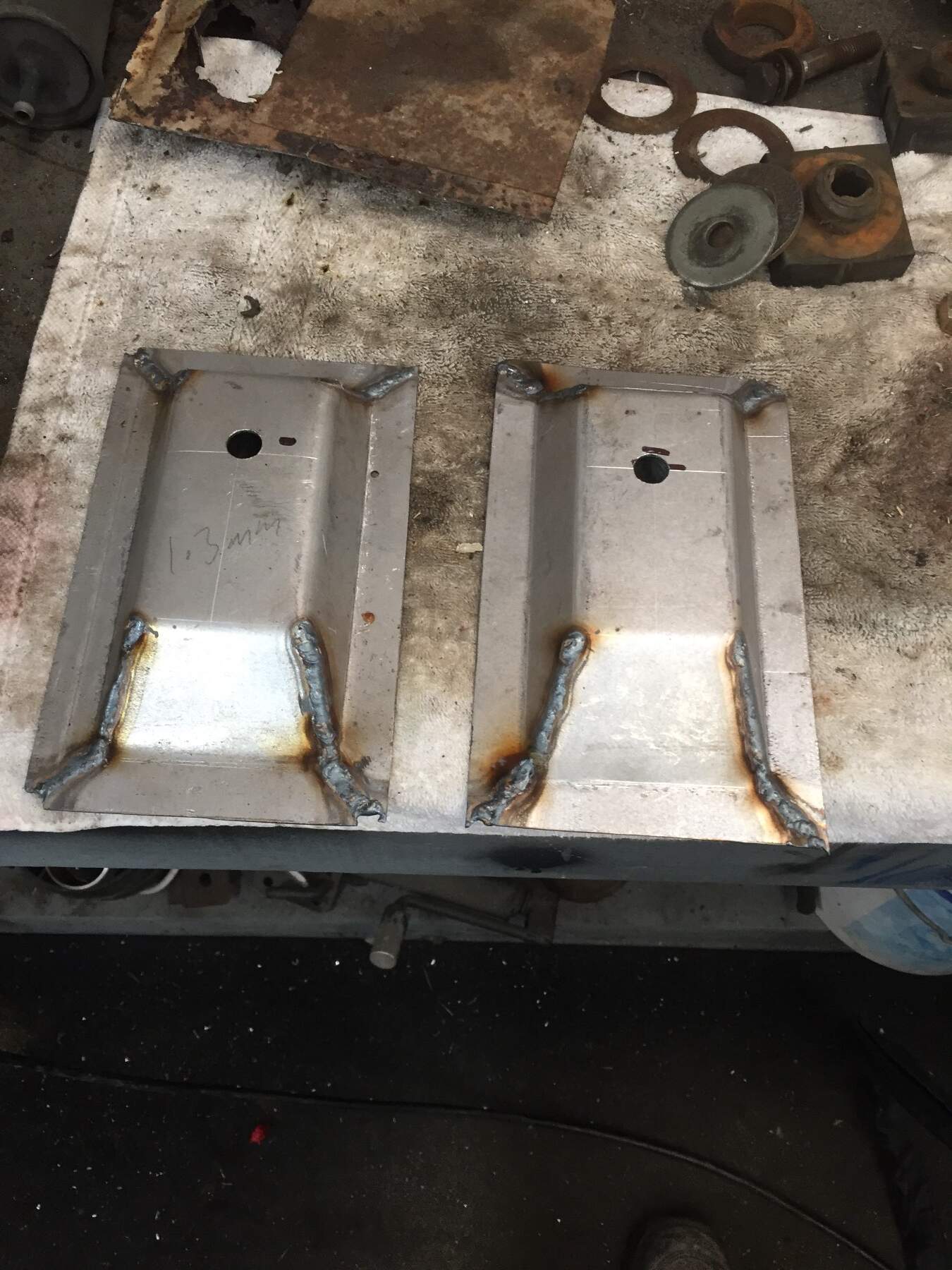

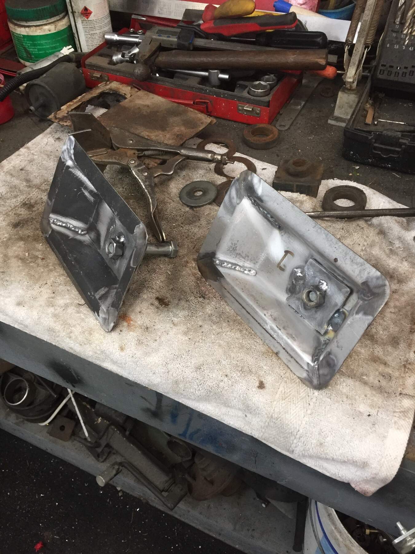

this was a great chance to practice my tig welding too
and welded some nuts onto some nice heavy flat square washers ... justA make em nice and strong

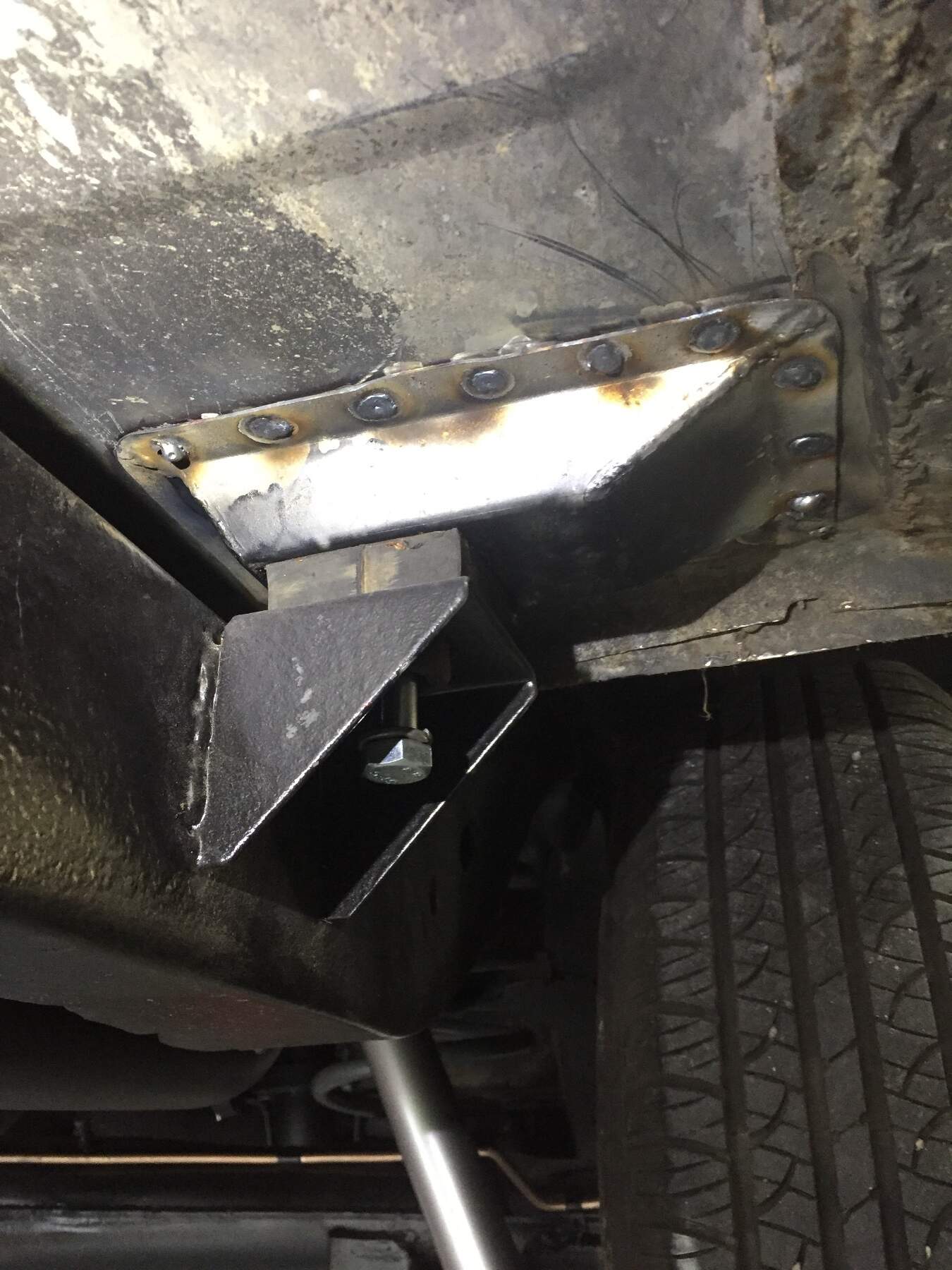

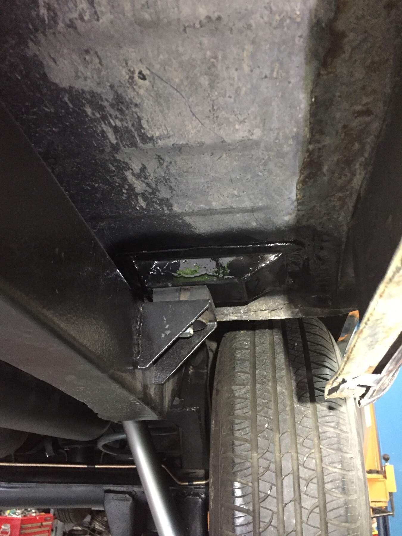

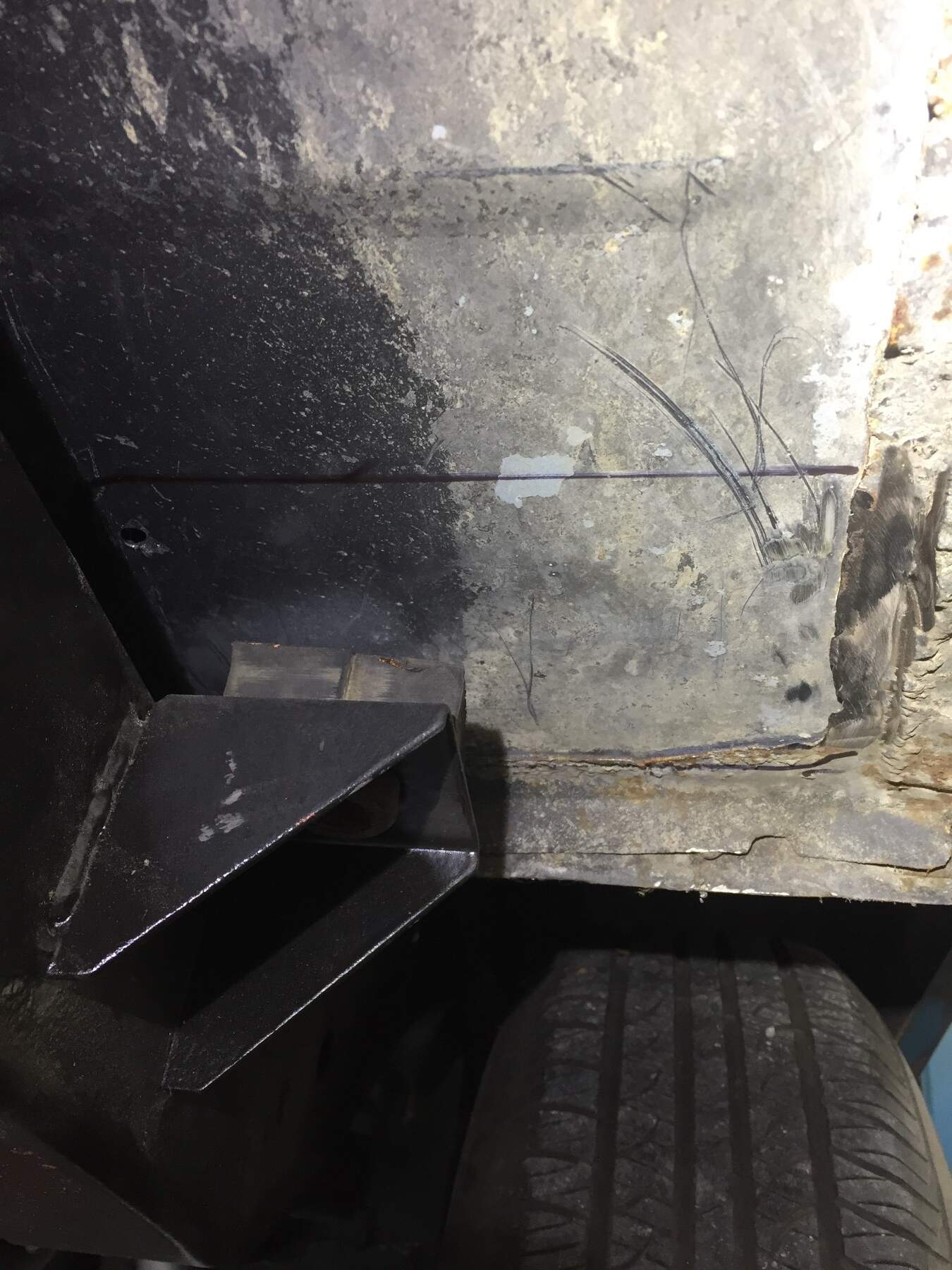

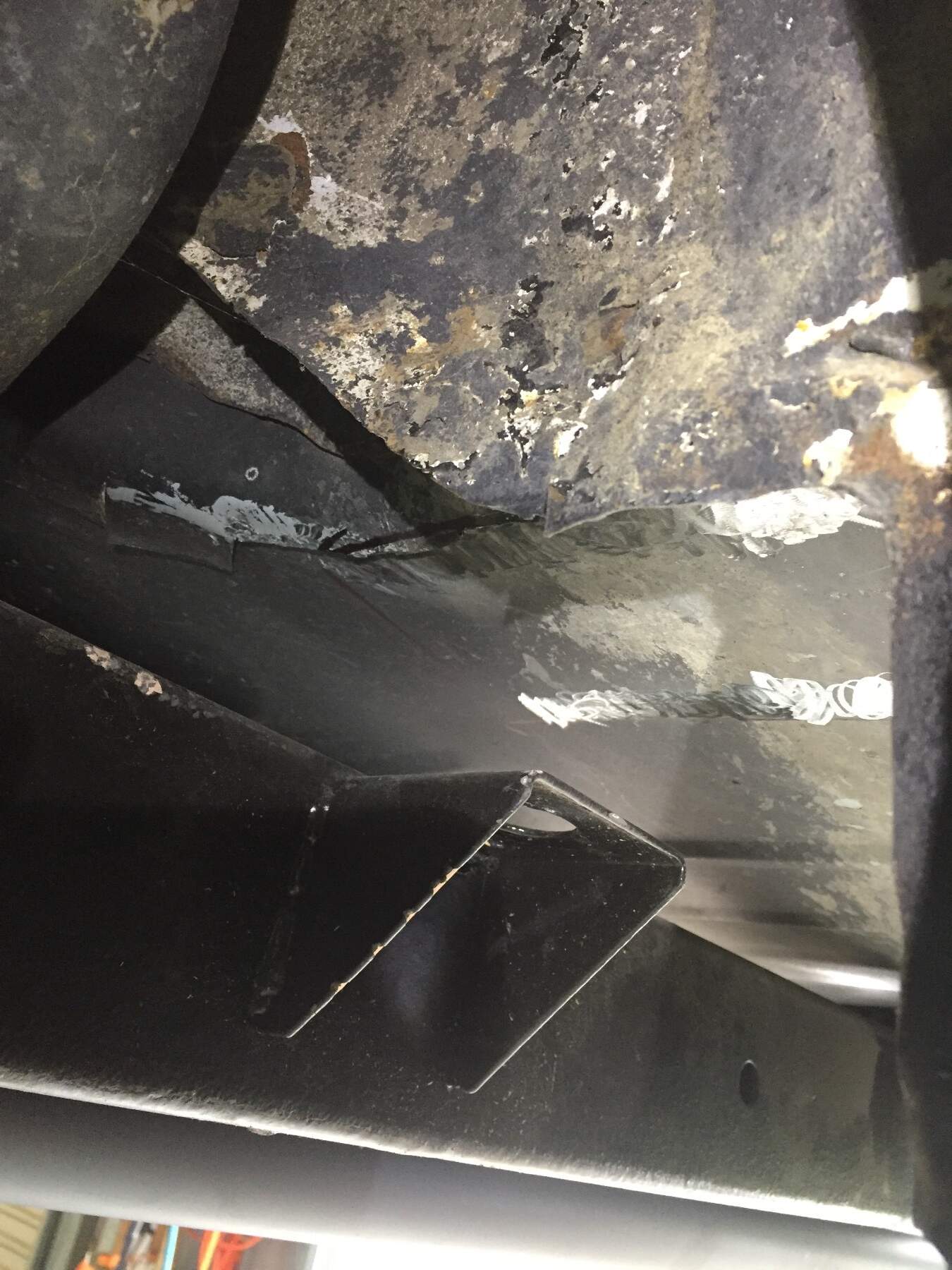

here you can see the chassis mounting points justA behind the rear wheels where the support is missing from when who ever replaced the trunk floor
missed putting them back in

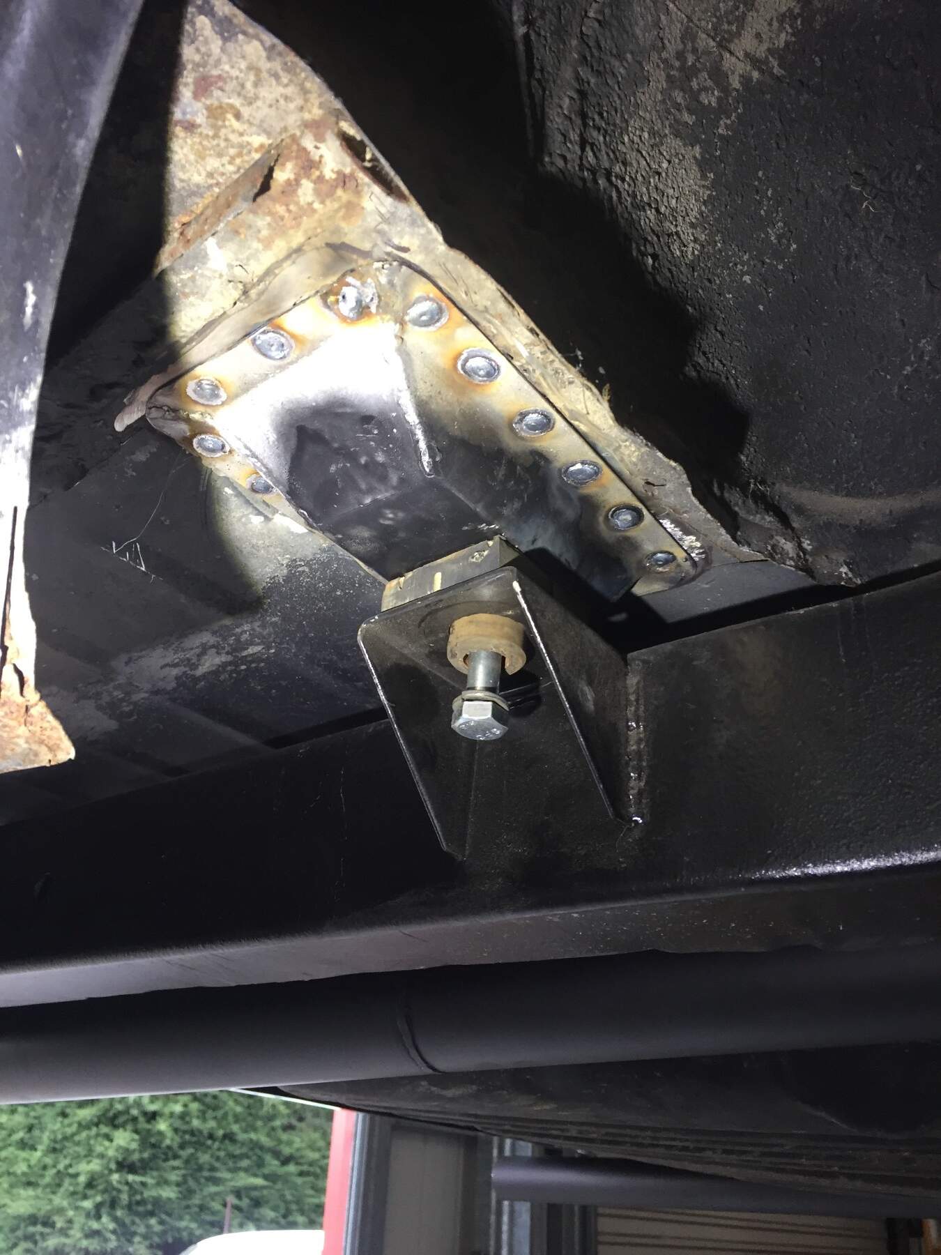

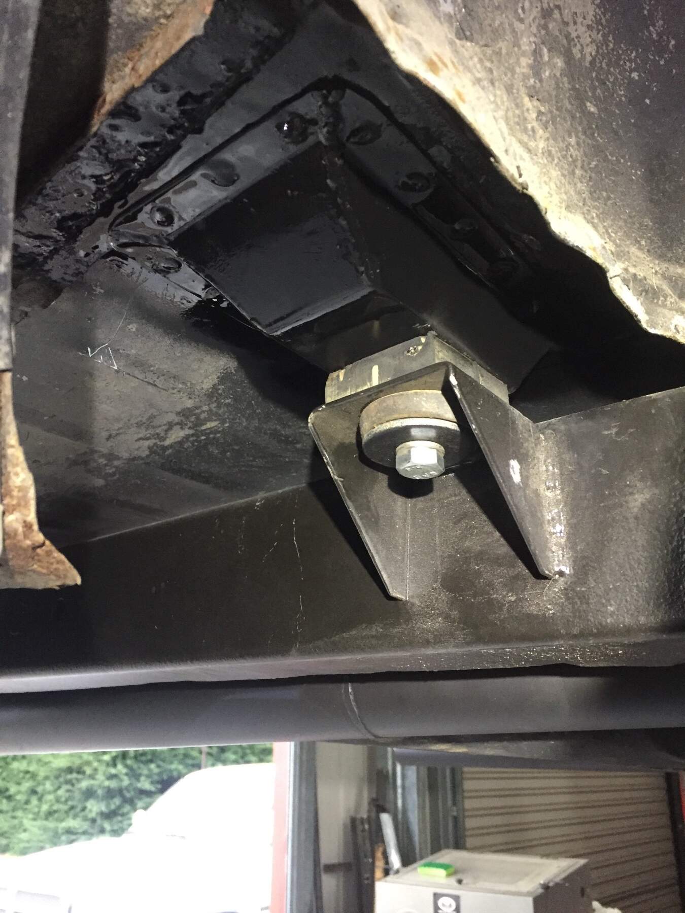

And here is the new mounts in position
I justA plug welded them into place and bolted up a factory bush arangement
so it all looks factory again

dont  look too close at my tig welding JustA.. i need more practice and learn how to set my current properly, and what to to do with my tungsten..... BUT ! its such a small concentrated flame and bugger all heat, its perfect for panel steel !!! 👍
 where as the mig is perfect for plug welds up side down in tight spots like the installation of those sub floor mounts👍
Looks factory to me😀. So you guys have annual car inspection? Something I grew up with back in the home land.

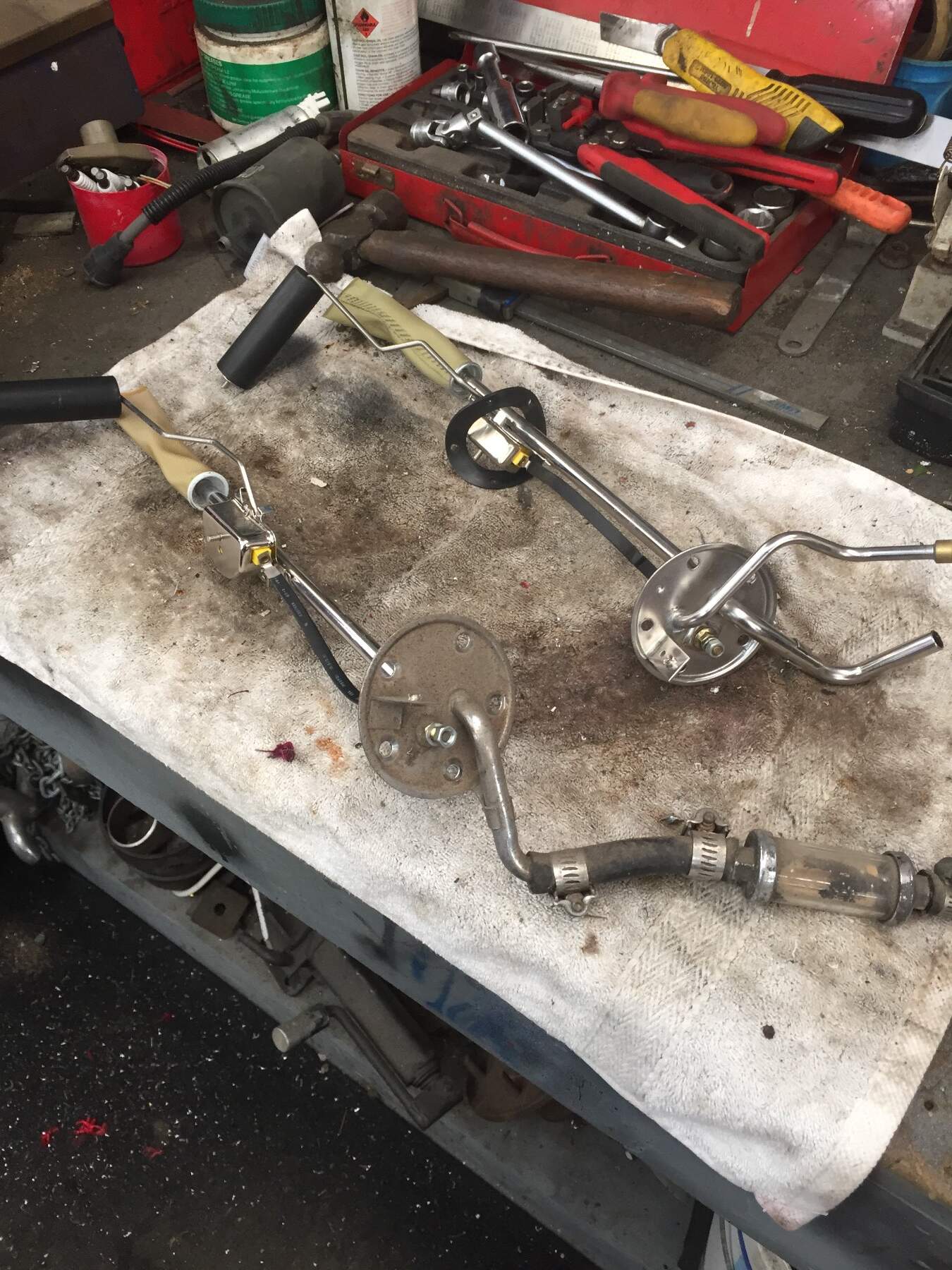

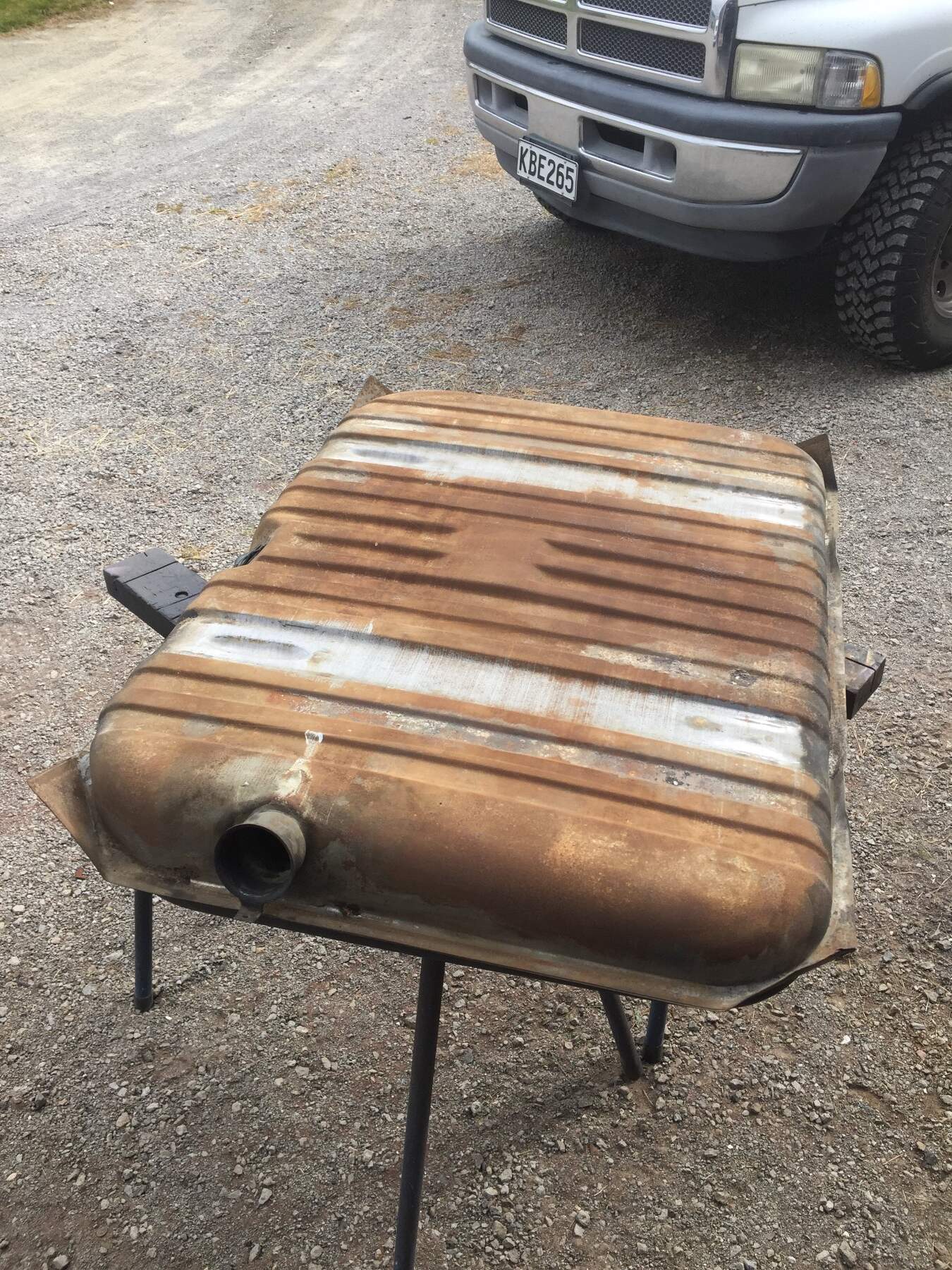

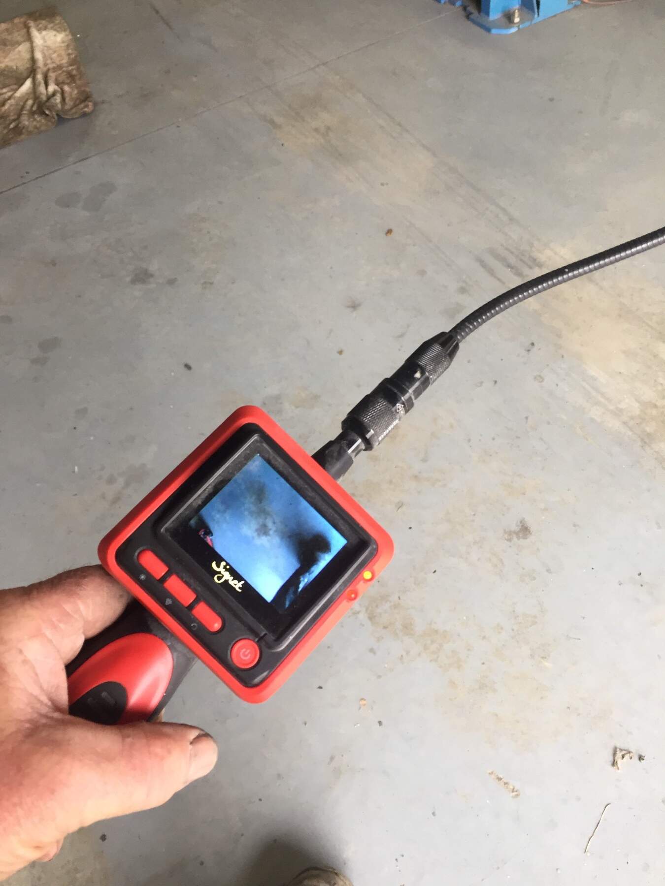

pulled the fuel sender on my gas tank thinking to install the new one i had bought....... that was a waste of time,,, the one in my tank look dam near brand new !!!

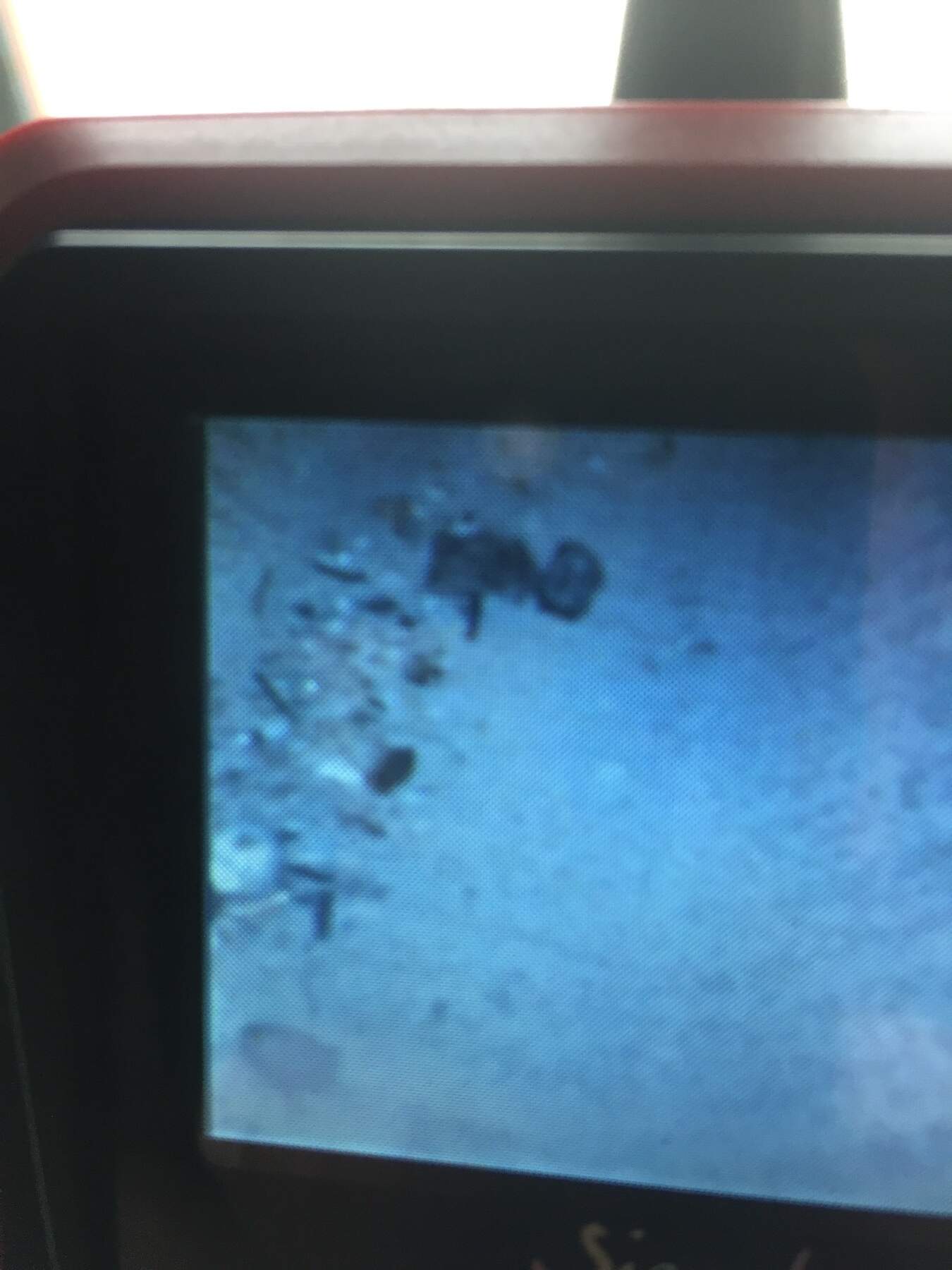

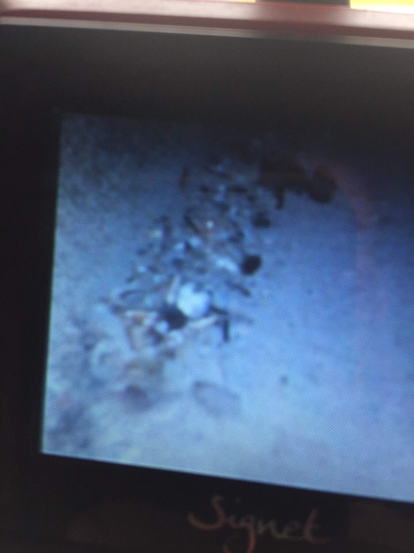

So I stuck the inspection camera in the tank to see how clean it was

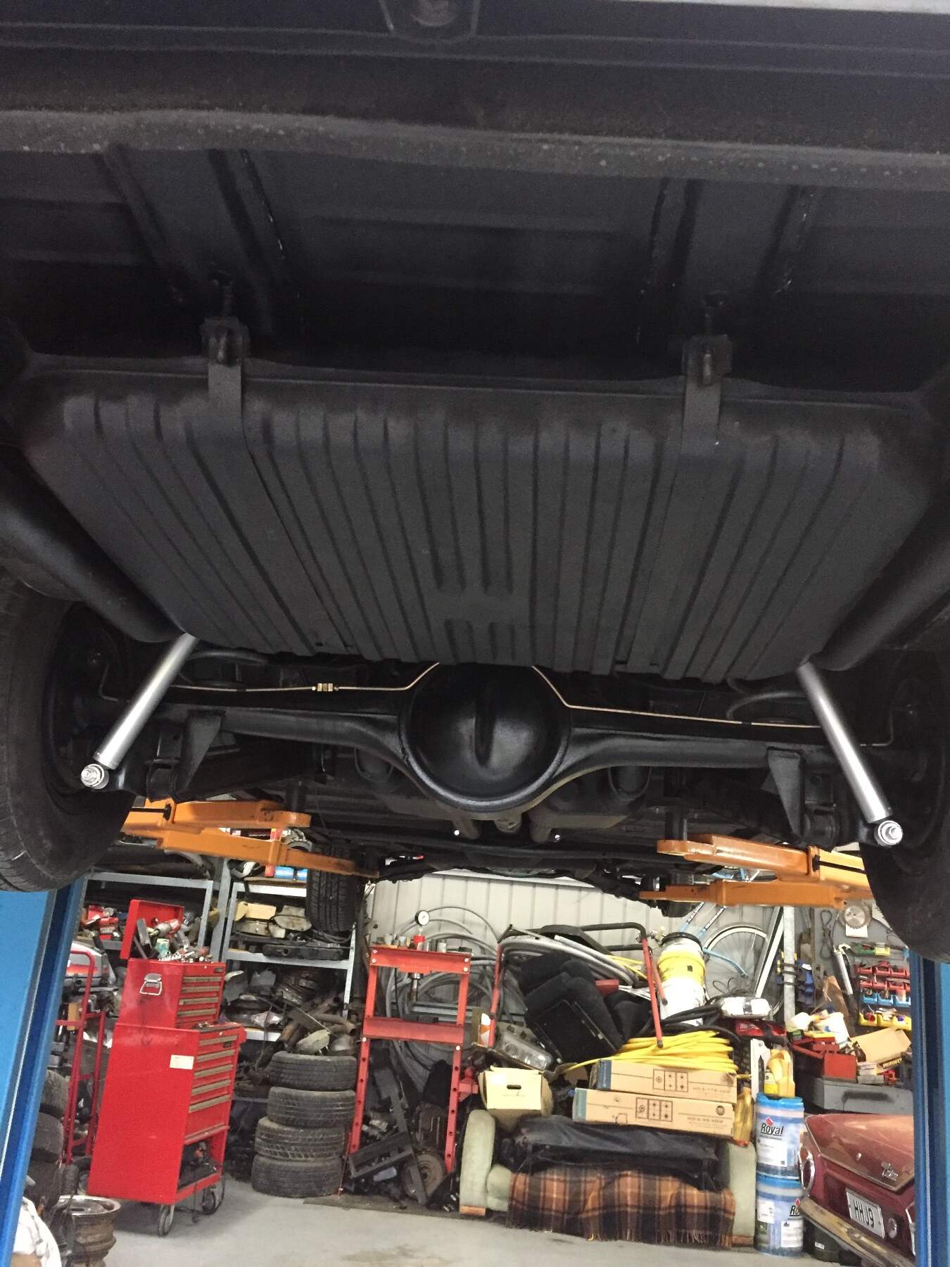

found there was a bit of odd looking crap... so i dropped the tank cleaned it out, gave it a paint job and bolted it back in

Wow - look at the crap in your tank. Looks like someone had a party in there. I did the same with mine, except had to fill a few pinholes with putty, wirebrushed it to shiny, and then rust sealed the entire thing. I rinsed the interior with the garden hose and then coated it with fuel tank sealer. My sender was in deplorable condition, so replaced that too, along with a nice new little piece of 3/8" hose to the metal fuel line. The only niggling issue is the vapour breather hose which inexplicably curls up behind the rear fascia between the taillights, as per factory. I still haven't figured out what to do about that because once the ambient temp gets above about 30°C (almost every day here) I can smell fuel. It needs to have a little filter or charcoal canister or something on the end. Any ideas?
my tank doesnt have that mate, i have a fuel cap with a small breather hole and thats it

The last thing I did yesterday was ,
I put the gas in the freashly painted tank,  finished up all the fuel lines
... I did think at the time ,,,, was that a good idea ,,,, and my brain said hell yeah let’s get a beer and go hang with the boss before she chops my nuts off for being in the shed for to long !!
this morning with all body parts still attached

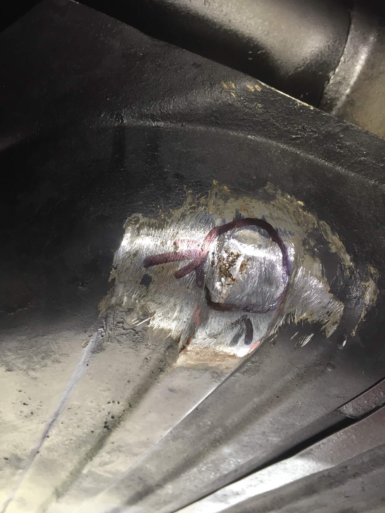

I go into the shed to smell gas !!!
Over under the 64 is a  leak !!
