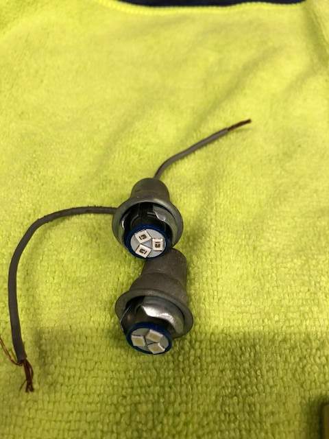

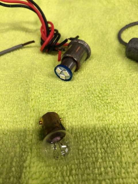

At least with Lucy I can get the bulbs in and out!!! They just don't work for some reason (not beyond calling it human error at this point).
Being that the 192’s are a flat blade type bulbs I’ve seen two things happen with them. One the looped wire that makes the connection on alternate sides of the bulb gets bent acts like a wedge. The other is they corrode and adhere to the brass connector!
So two things to try! First put a couple drops of lPS 1 of 2 down in the socket let it sit a few minutes! Now take some lacquer thinner and put several drops in the socket! Invert the socket to dump out the thinner. Wipe the bulb off with a little more thinner. Now take a set of small thin needle nose pliers, like you would use on circuit board components. The thin blades of the needle nose need to under the lower indent register of the 192 bulb and the socket top! Put a piece of thin neoprene or latex between the bulb and the pliers. Squeeze the pliers so the plier jaws/blades can act like a fulcrum between the bulb and the socket top.
I ordered the bulbs from Amazon and they plug into the original sockets without any problems, they also plug into the aftermarket gauges with no problem either. The original sockets worked in my dash, gas gauge, and clock and the rest in the aftermarket gauges. Also my RetroSound Stereo has over 3000 lighting colors so I was able to tune that in to match the LED's!

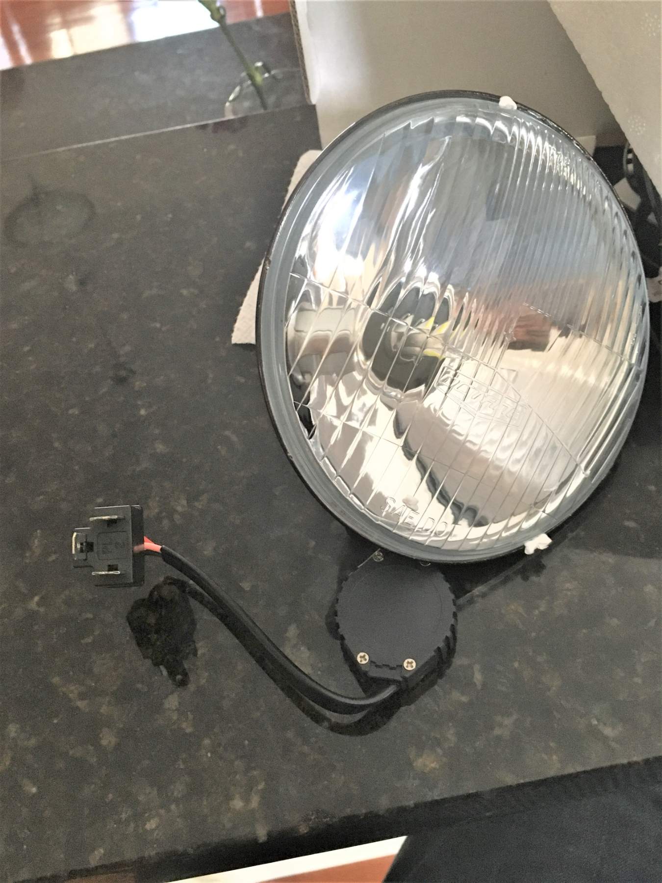

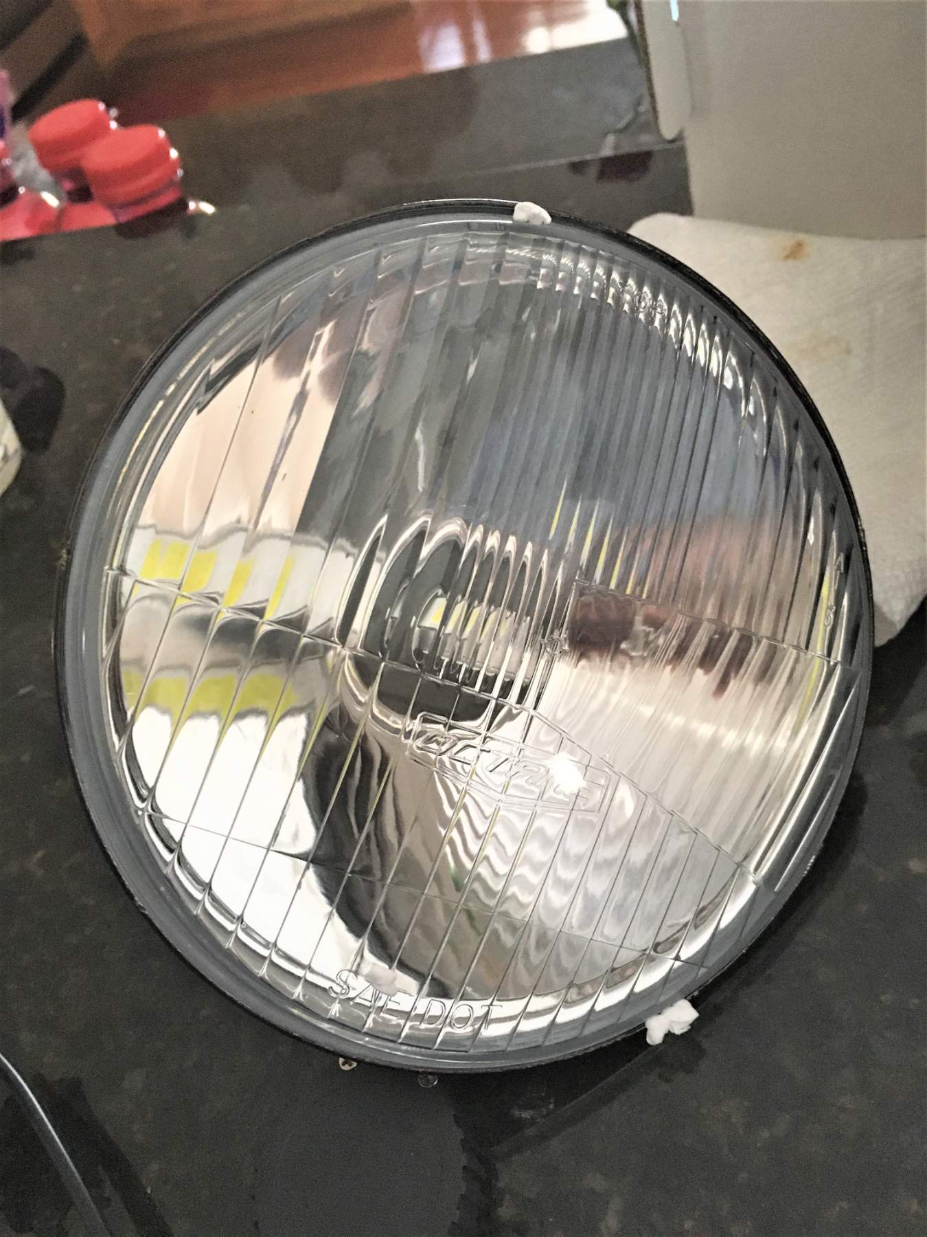

I just ordered a set of Hi and Low Beam LED 5 3/4" headlights for Lucy. I got them from Octane Lighting based on a recommendation from a fellow POCI member in Tucson AZ who installed them in his '68 GTO. He loves them.
I wanted a stock appearing (no halo ring) T3 replacement bulb with no sophisticated wiring. I think this suits the bill. The cost is $200 plus shipping and handling.
Here is the 5 3/4" LED crystal lens - sure looks like a T3

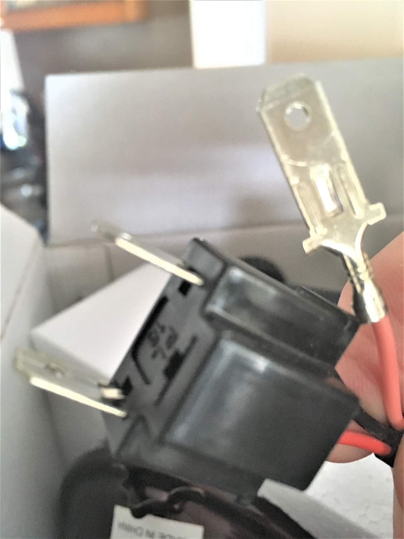

Here is is again with the electrical connection that plugs into the stock wiring harness - this is the low beam bulb/connector
Here is the back side of the bulb/connector of the low beam
1133112330_LowBeamwithPigtail-backside.thumb.jpg.eb11bb369e5519d49e675797dad4ed55.jpg
The high beam looks the same except for the wiring pigtail - here it is:

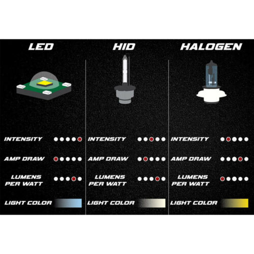

That looks great! I have a problem though, when I put on my high beams after a couple of minutes the circut breaker trips and out go the lights! I hit the dimmer switch and the lows come back on. The circut breaker is built into my aftermarket fuse panel next to the fuse for headlights. I've tried a higher amp breaker, but they still go out? Any thoughts? I'm running Halegon lights
wdl, i think its the other way around, your relay needs to be down sized, led lights pull stuff all current, you could even delete your relay, thats how lower current they pull.
on my 59 caddy i left the light rely in and its working, but, with led, ya justA dont need it, you really have no current pull. old school lights pull shit loads of current hence the relay and a big fat cable from the battery to feed them... led= a faction of current load= relay not required... well thats my thoughts... do we have a auto sparky that can enlight us... :rofl: get it en-LIGHT:rofl:
Kiwi is correct - this chart gives you an idea regarding amp draw vs. bulb type.
