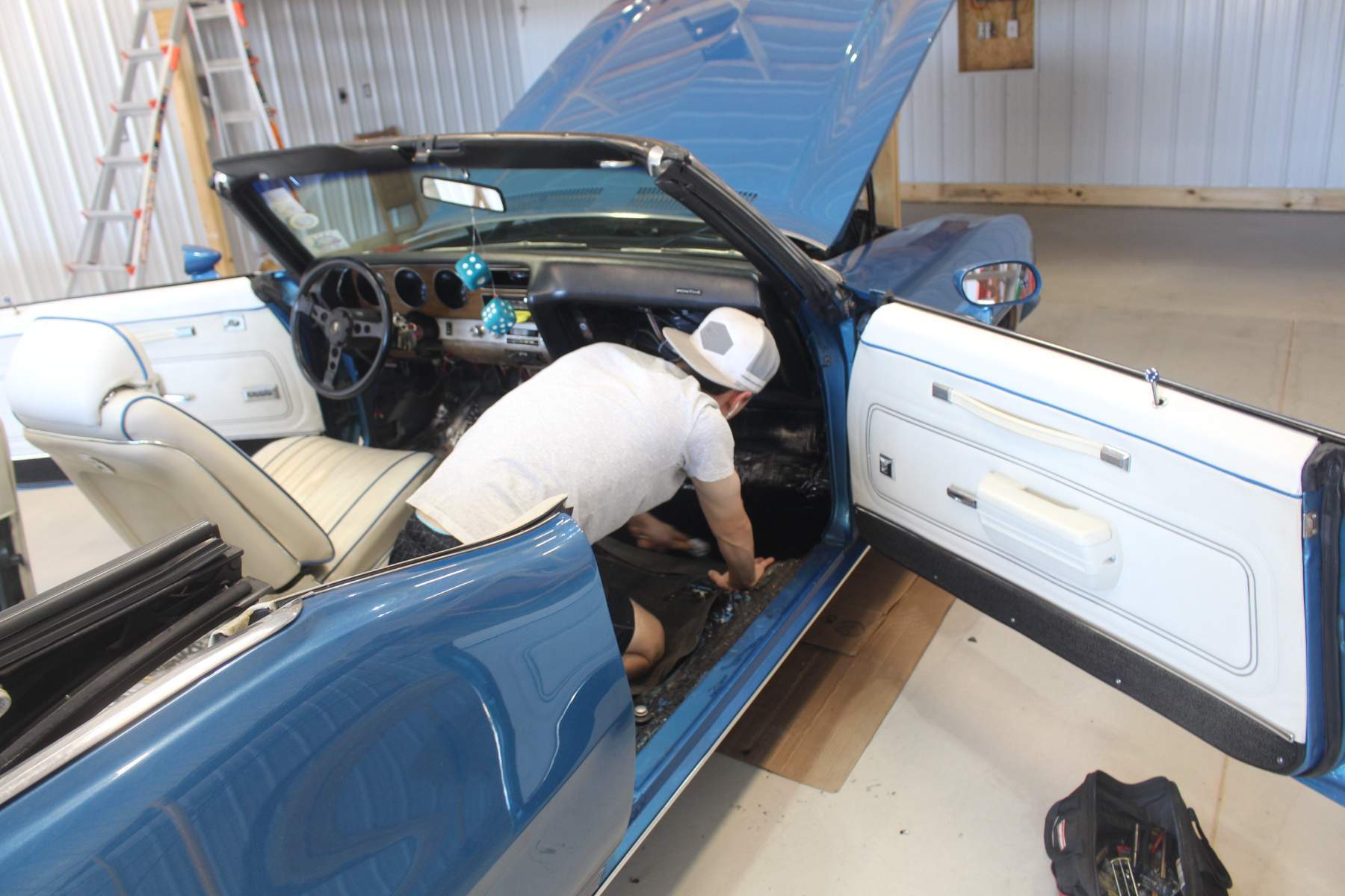

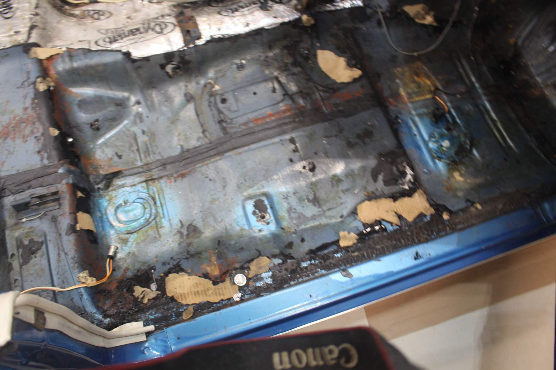

I made some progress on Lucy this weekend. Jacob and I took the car over to the garage mahal to work on it over the Labor Day weekend. We were able to:
1. Hook up the heater core to the engine.
2. Refill the coolant level
3. Throw in a bottle of Bars Leak (there is a small leak off the back of the engine). Grrr.....Bars Leak do your thing!
5. Install the passenger side sound deadener
6. Install the passenger side Hushmat (replaces the Dynamat I had to rip out 2 years ago)
7. Got the back half of the new carpet laid down but not fully trimmed out.
8. Reinstalled the front passenger door panels and trim. I installed new plastic arm rests but the plastic is not 100% correct. I spent a lot of time grinding the screw heads down because the plastic got narrower that the stock screws were. That was such a pain.
9. Discovered a small but annoying power steering leak. Double Grrrr....
We had to clear out of the garage in preparation for more work in the garage this week. We had to pack up everything and take it back to storage or the house.

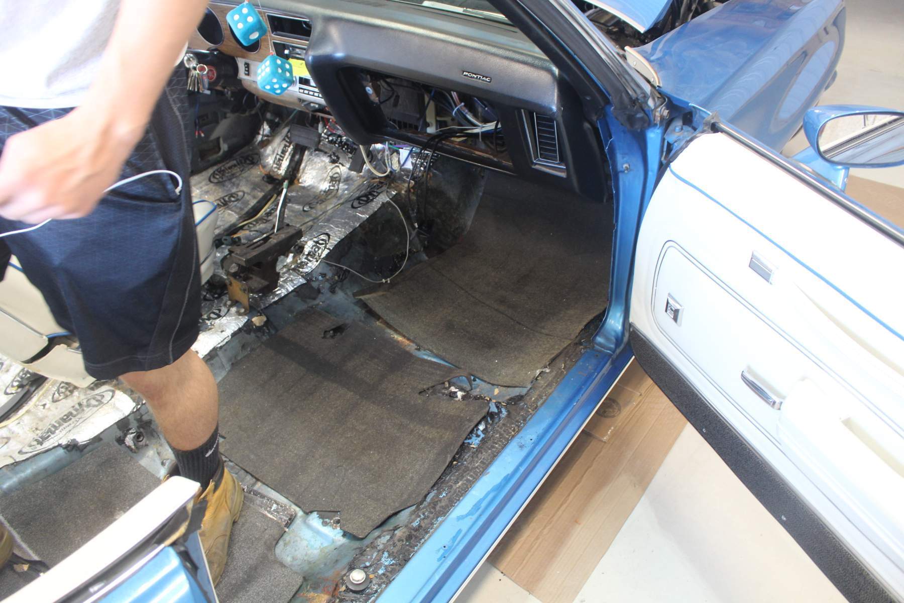

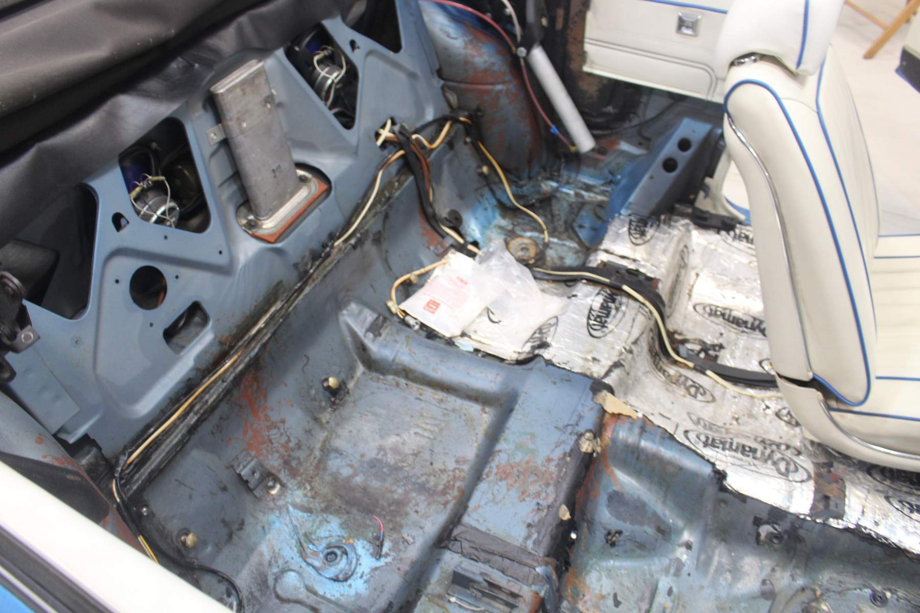

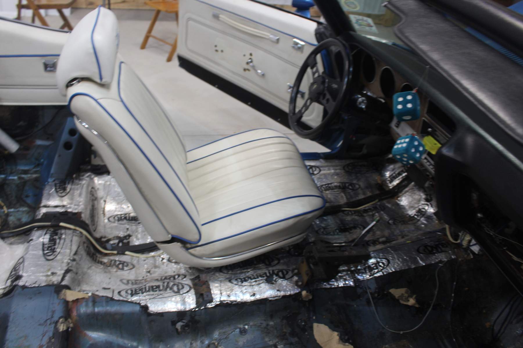

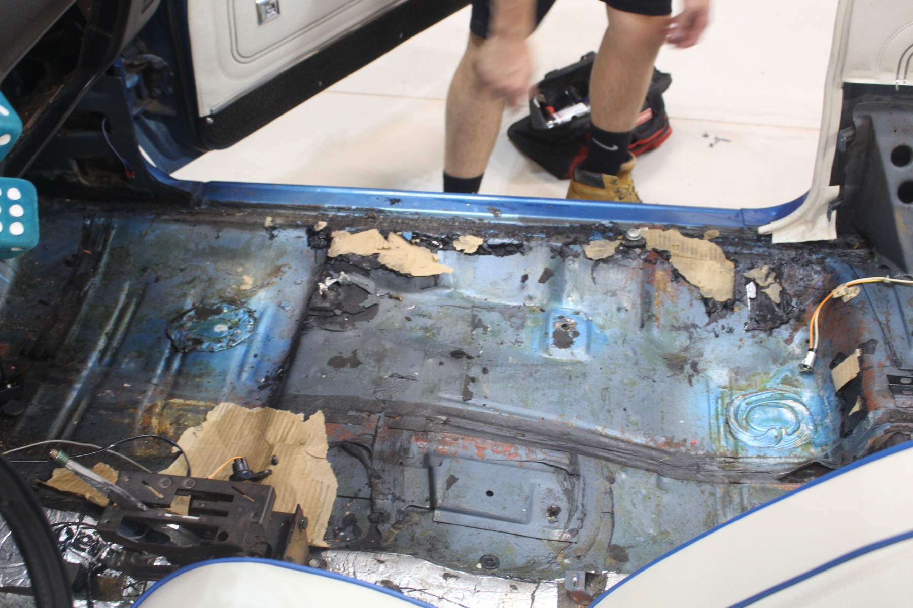

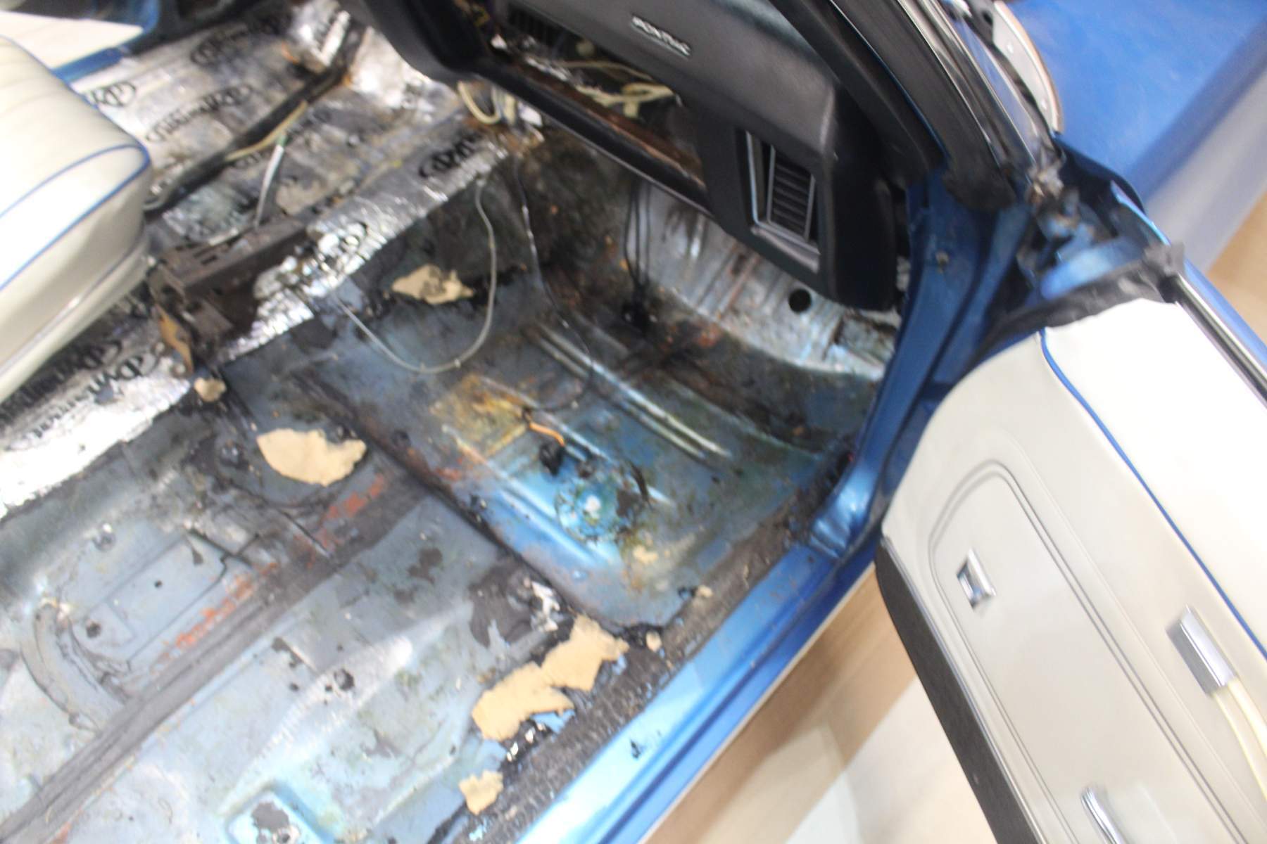

Starting point - barren floor boards on the passenger side were I had torn out the antifreeze soaked carpet, Dynamat and sound deadener 2 years ago. I had a large piece of cardboard over it to keep from getting old tar from getting on me.
IMG_9233.thumb.JPG.ec1aea73234ac9bb8395b46e2119d624.JPGIMG_9234.thumb.JPG.c328ab91691c4b563dfbc37e590a2f2f.JPG

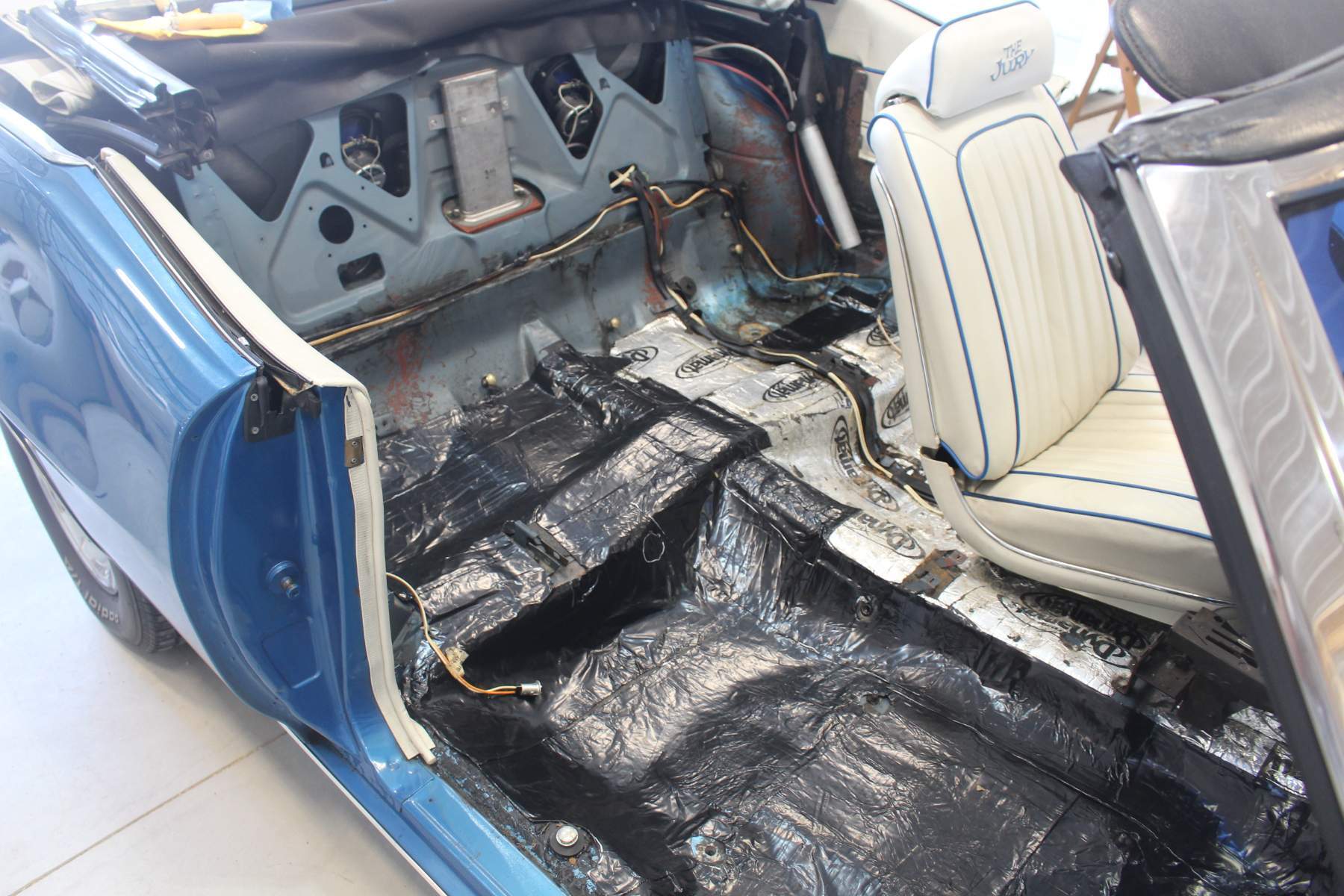

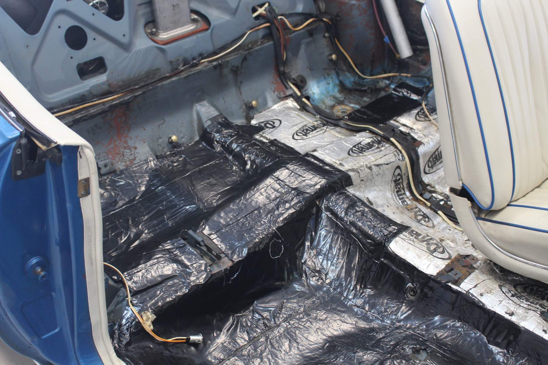

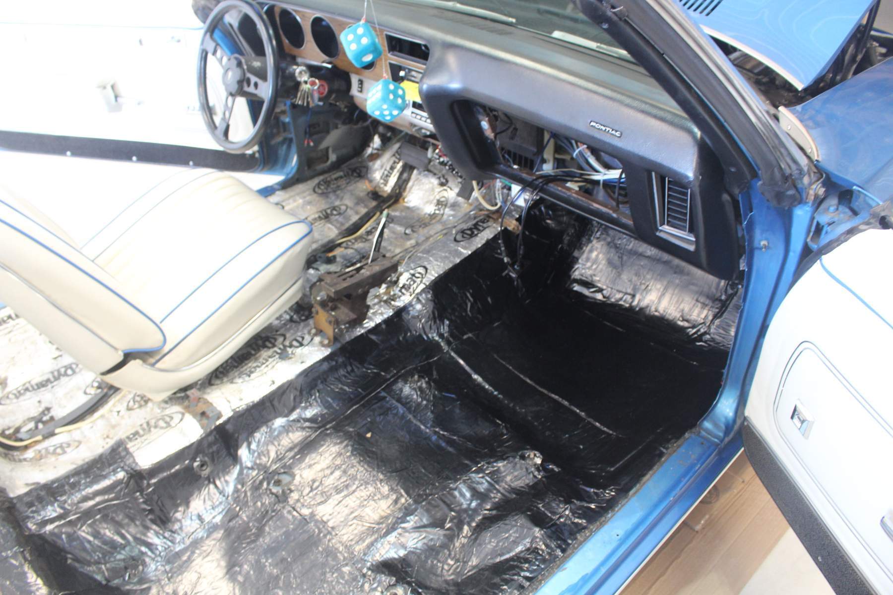

Sound deadener was next. It just lays there. Heat from the car will eventually cause the tar side to stick to the floor pan.
Hushmat was next - this stuff is black, not aluminized, like the Dynamat it replaces. I recall getting a lot of tiny cuts from the aluminized stuff. Not so with this stuff. Jacob did the hard work of putting this stuff down.
Also notice the completed passenger door!
IMG_9240.thumb.JPG.ce1a3974165dee842df3c1c9b4e1f000.JPGIMG_9241.thumb.JPG.ac7b93491202dc49f1c8db642ce4371d.JPGIMG_9242.thumb.JPG.3062099fb6af8b00820f0ac085d0b791.JPG

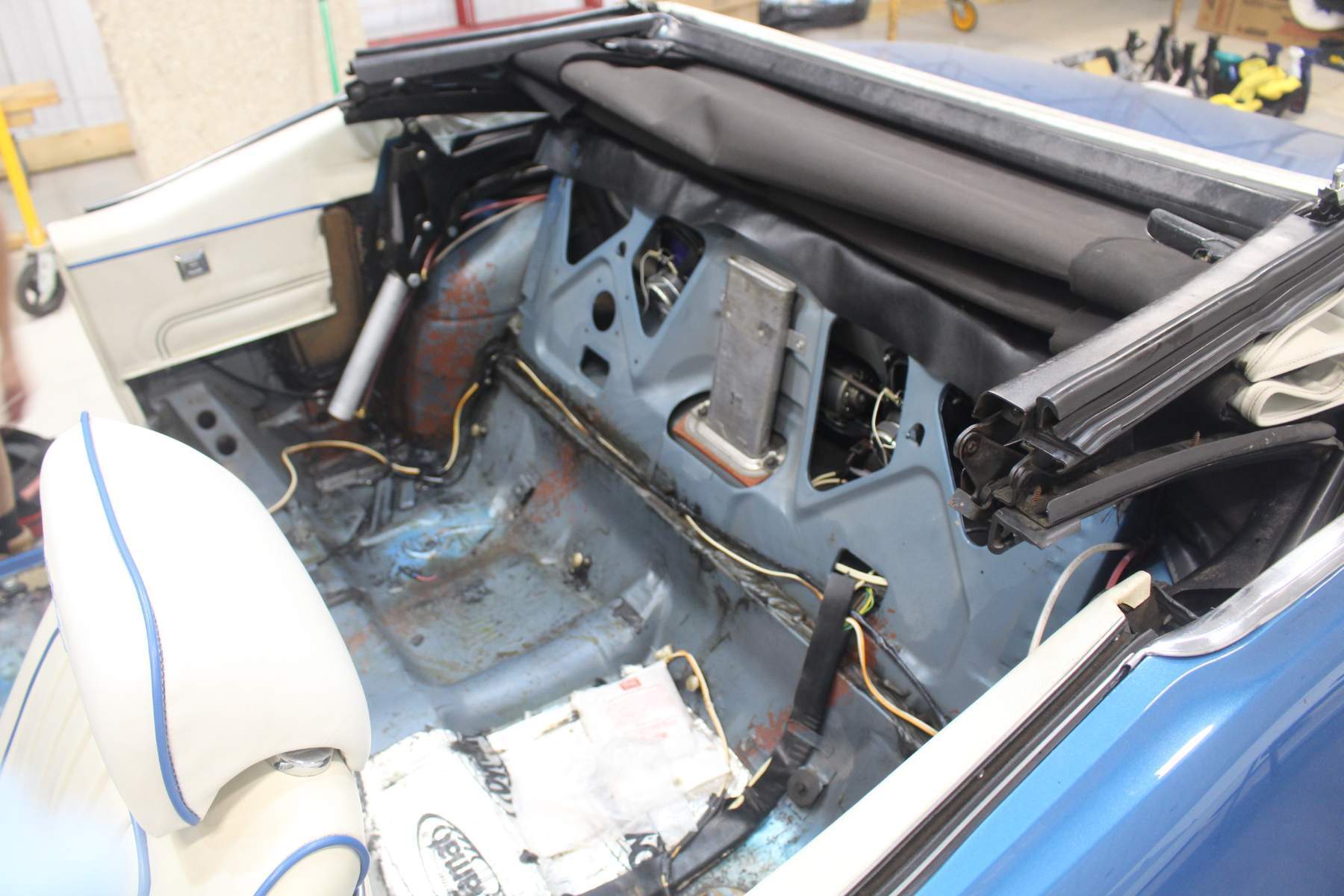

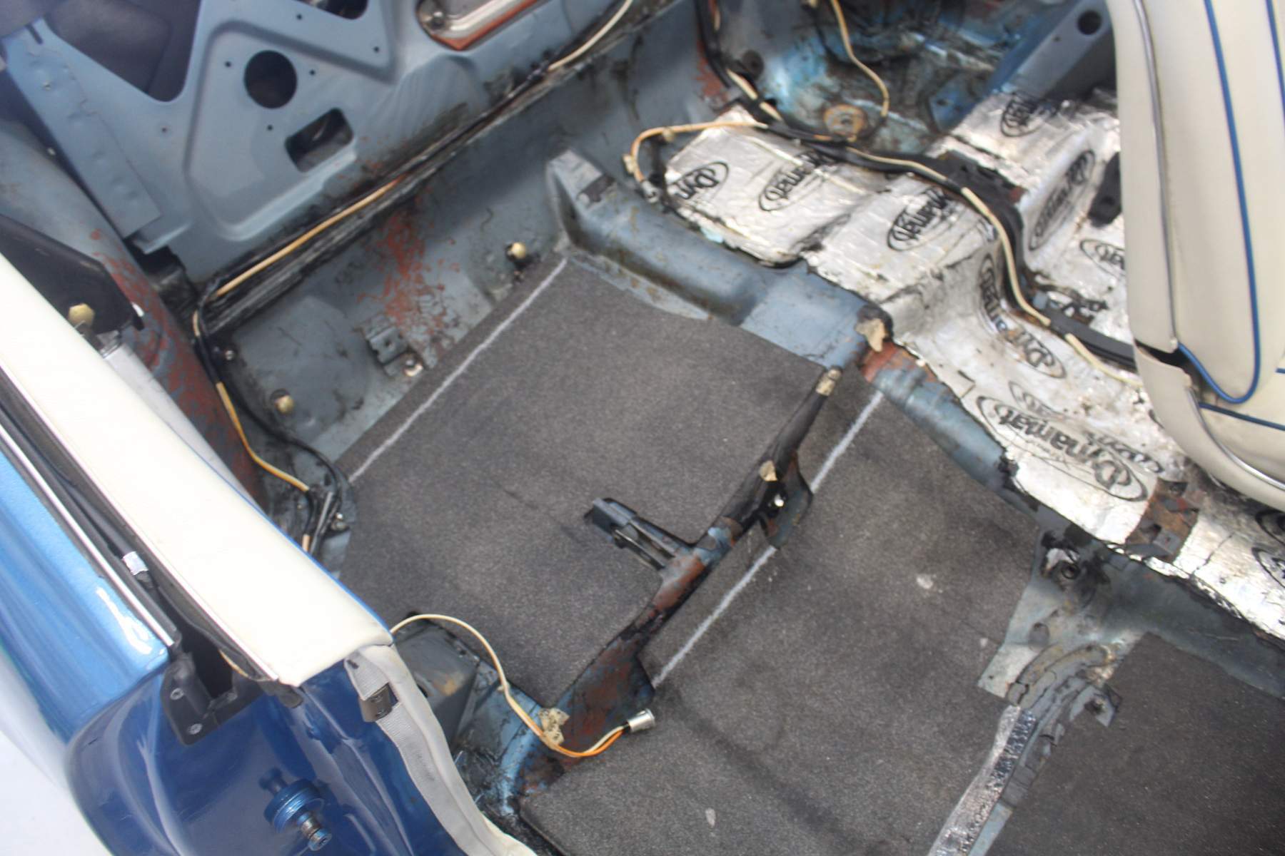

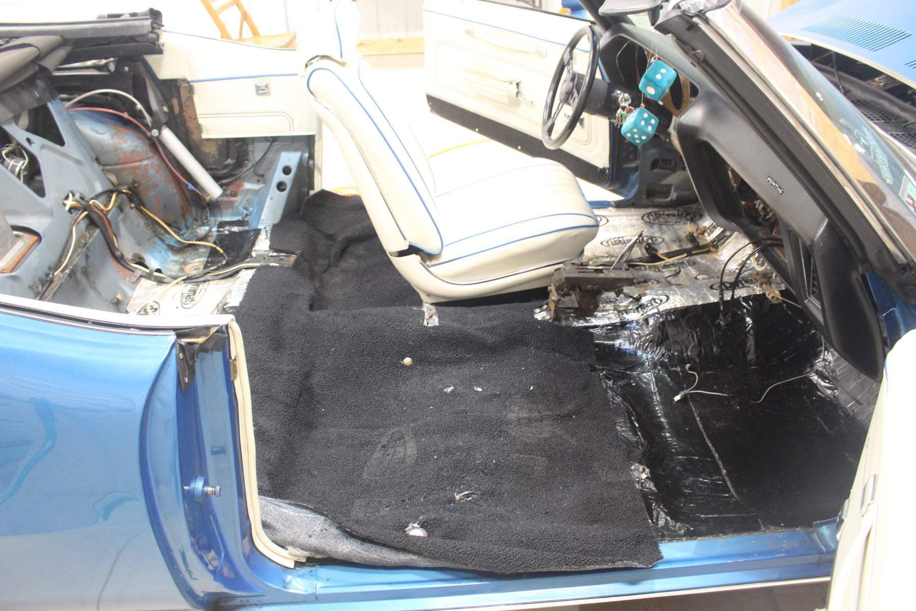

Finally we ran out of time while starting to lay out the new carpet. We started with the back portion first. We have it rough cut and glued down. We still have some wrinkles and final trimming to do.IMG_9245.thumb.JPG.33f85f8769a2b3ffe6f04d1db30cd186.JPGIMG_9244.thumb.JPG.621b0bd1a8fcf1e371dda50ec15bd80c.JPG

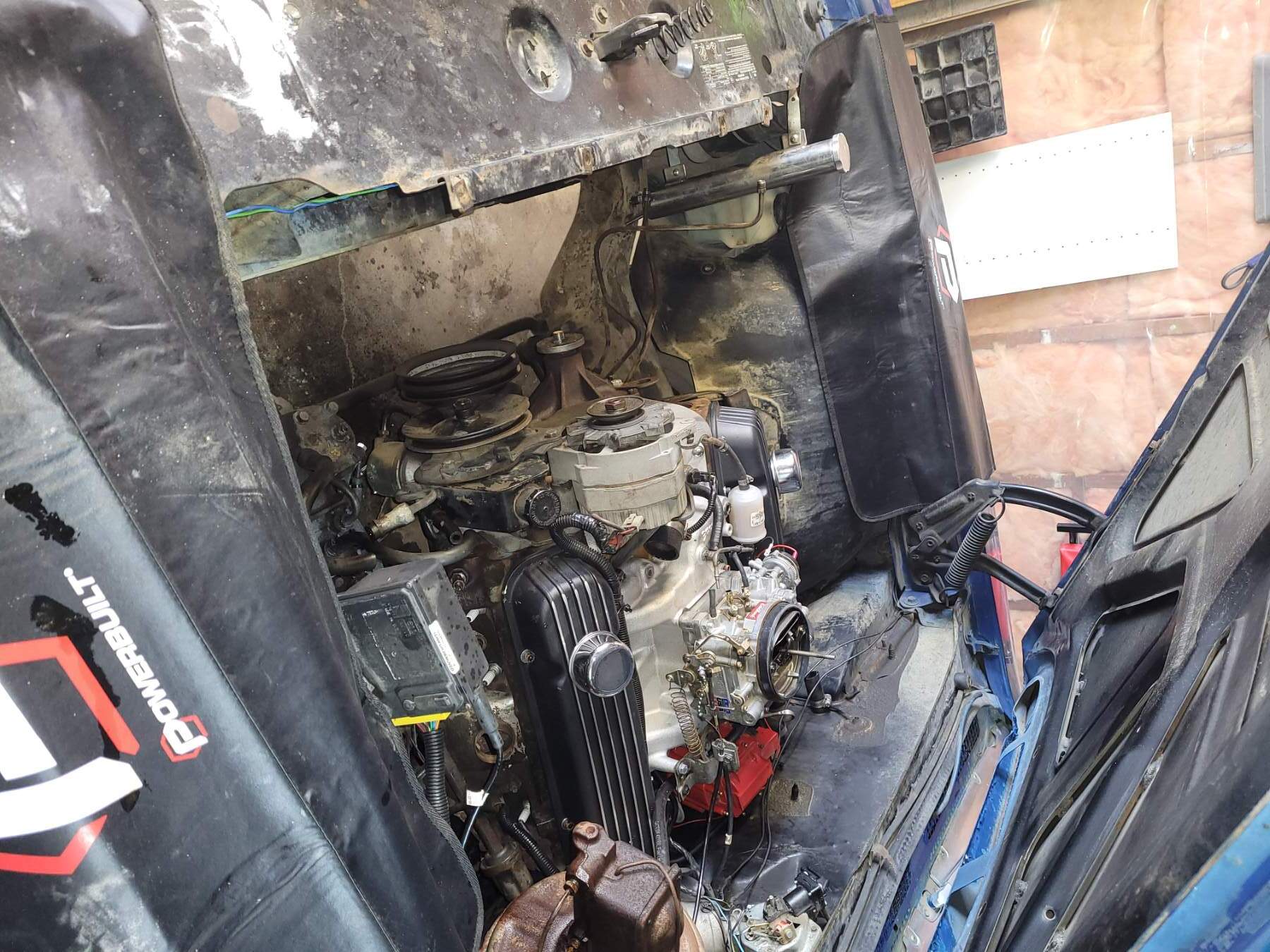

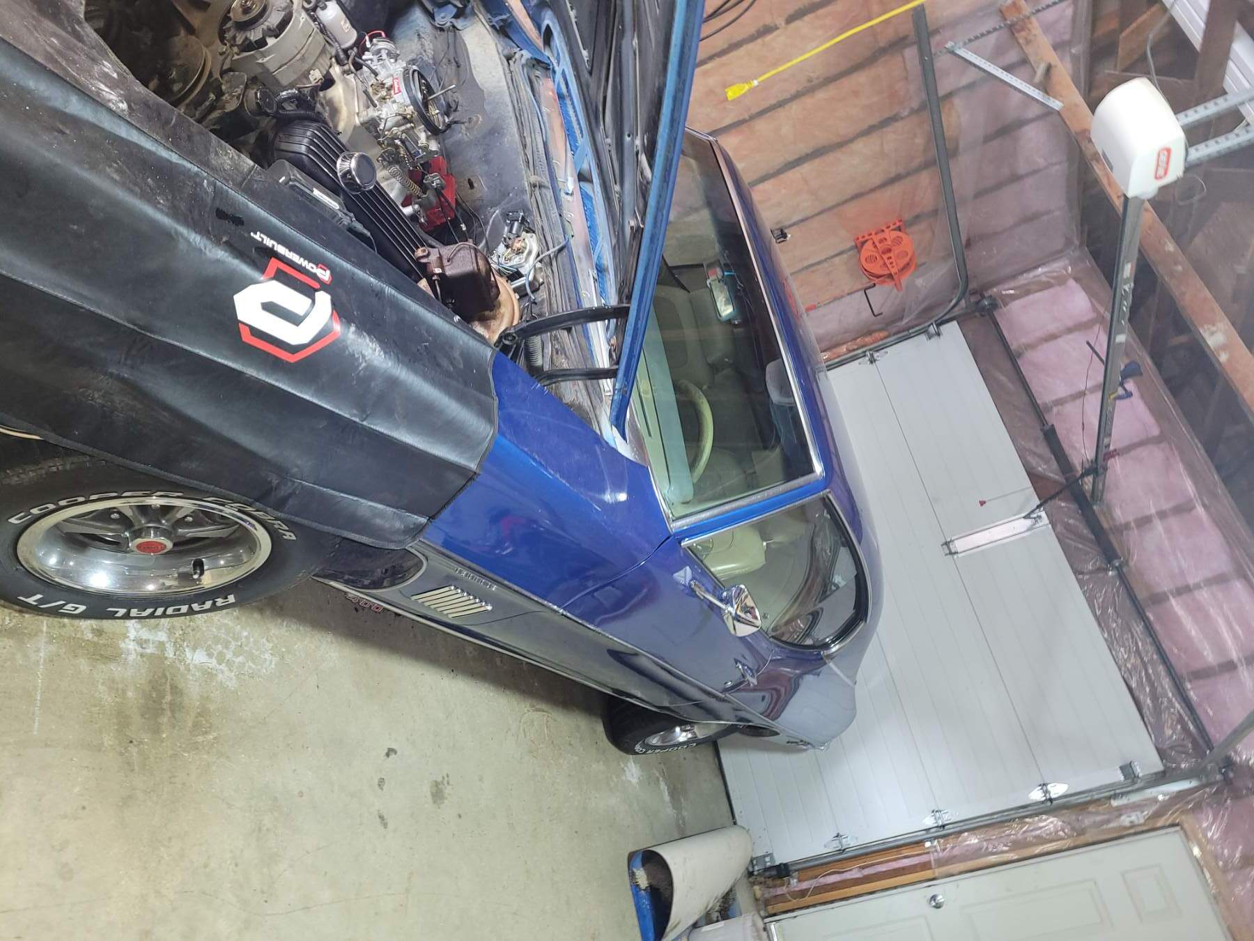

I've been preparing to pull my motor. Got everything dissconected. And just about to take the hood off a d doa few more things from the top. Plan is to pull it out tomorrow. .
Looks ready to get outta town. Good Luck!

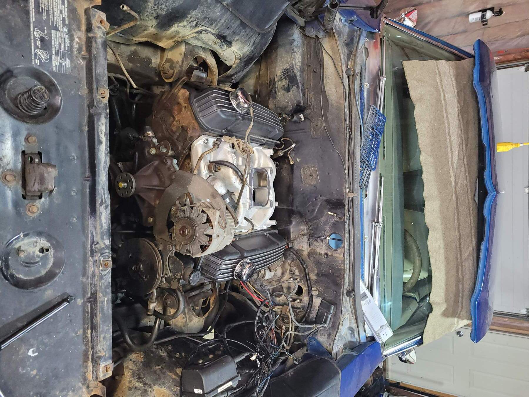

All ready to pull now. Only thing still co  enter is the wires to the starter  any tips? Was hoping I can disconnect them once it's in the air  if not I may have to cut them?
You should be able to disconnect the wires with an extension socket and perhaps a universal before pulling the motor. Should be three wires connected to the solenoid.
Easiest way...To Access the starter wires...Before lifting/Unbolting the engine...Drop the starter from Underneath...Support it so that it is not hanging on the wire harness...The wires will then  be easily accessible...Then use a 5/16..??...Socket or wrench to take the wires loose from the solenoid...Having the starter off the engine can actually be beneficial...Clearance wise when removing the Mill...Anyway..
Are you removing the the engine and transmission together as one unit..??
Edited by TWO LANE BLACK TOP
If you can't reach wires, Justa drop the starter.  Unhook wires.   It's usually easier to have it out while reinstalling the engine anyway.  More room to line up motor mounts N install your exhaust manifiolds.
Daaaaaa  should have read Two lanes before posting.  :slap:
