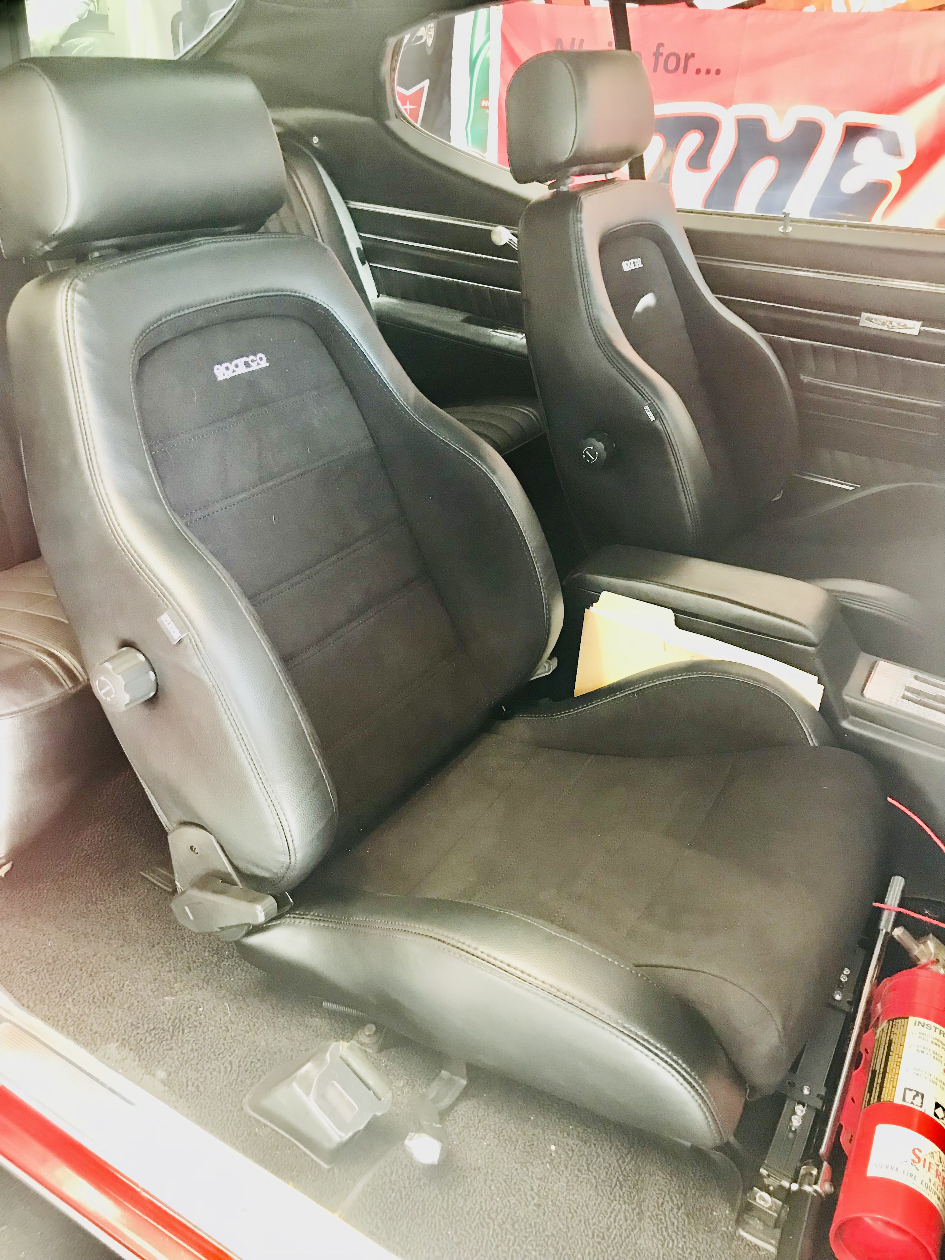

Well I decided to change the interior in my 64 Bonney! I'm going from bench seat to buckets! It started a year ago with a costly choice by me to give a new kid a chance to cover my buckets! and well he screwed one up and we parted company! Tried to work with him and explain do a good job and you'll have more work than you can handle! Lesson learned!! Was able to send back the one bucket that wasn't touched to Speedway Motors with No Hassel ! They were great and I highly recommend! So now I'm starting with Chrysler buckets that recline I drive the Hell out of this car and wanted some comfort and adjustability! I bought some "B" body bucket seat brackets off EBay out of Arizona and cleaned them up and don't you know the out side brackets bolted into the original Bench seat mounting holes !! Only had to drill for the inside tracks! I cut down the backs by 1 1/2" so that the top of seats would be even with the windows like the bench! I chose a 67-69 firebird center console and modified it to fit a GM Horseshoe shifter. I used carbon fiber material on my dash in place of the woodgrain (sorry but I don't like woodgrain in cars) I carried that onto my console with a carbon fiber wrap. I added a tach to the console and added blue led lights to match the dashboard and radio colors!                The seats are now at the Upholsterer's that I should have taken to in the first place. Here are some pics!
Wayne !!! That’s soooo impressive !!
I love the Camaro H shifter !
I have one in my 72 camaro ! And it certainly does look cool in the 64 !!! :cheers:
Ok, now that justa looks badass bro!

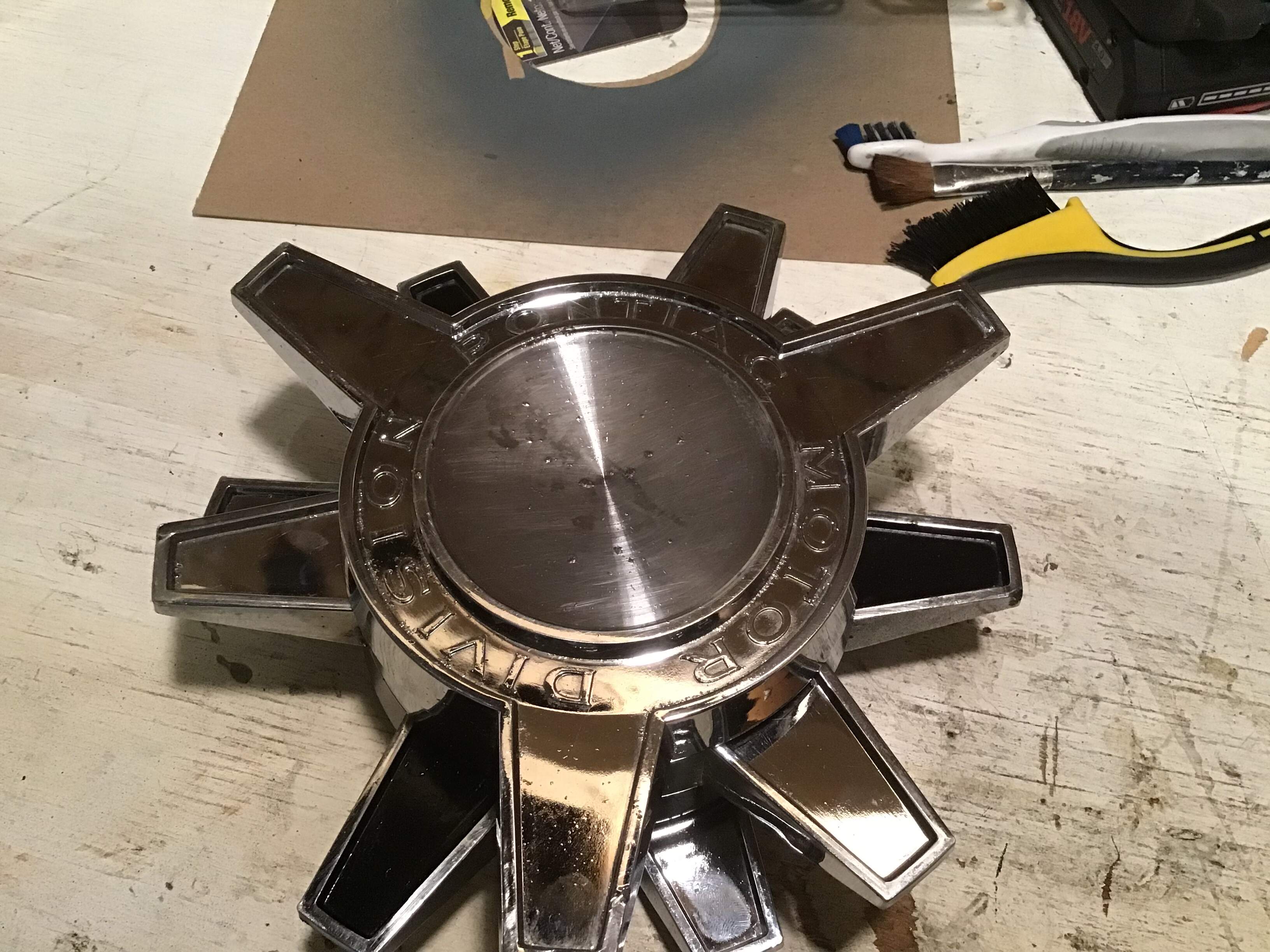

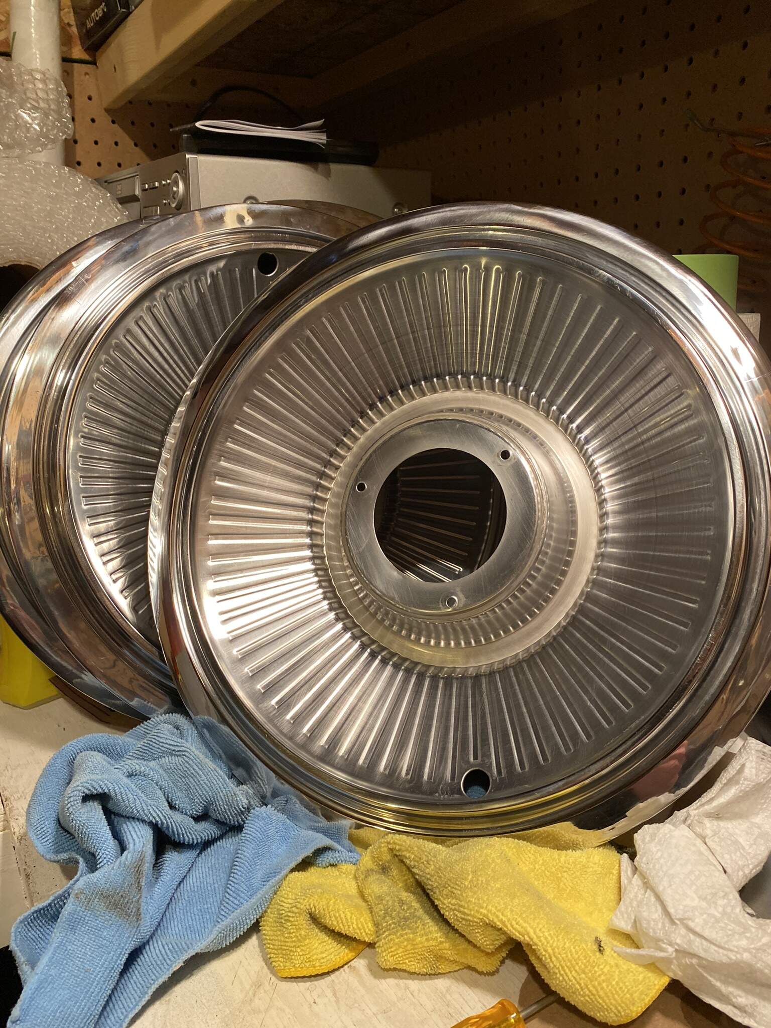

Great thread, I will probably make someone cringe. Time for a spinner hub cap refurbish. All of the black paint in the grooves was faded, peeling, chipped or completely missing. The center spinners themselves same thing with various stages of pitting.  Man I don’t even know if it have the perseverance to put black paint back in these grooves, the masking job alone would drive me off the wall. To make it all even more fun the grooves are tapered wider towards the outer lip. I’d love to know how Pontiac painted these back in the day probably a template of some sort,,,😬

Nice job of prepping.  Back in the day I would use pinstriping tape. (you could find it at any parts store) You can buy it in different sizes.  leaves a clean edge and you can bend it 90 degrees.  Will not leave adhesive or paper if left on too long like masking tape.
https://www.findtape.com/Sharpline-Prostripe-Pinstriping-Tape/p1727/?vid=15240&bc=C&msclkid=28970656d2d11efab7a7624c2c0a3ada&utm_source=bing&utm_medium=cpc&utm_campaign=(ROI) Smart Shopping - US&utm_term=4577198191682251&utm_content=Ad group
Use the cheap stuff, instead of wasting a bunch of $$.   Lettering will be the hard part.  I've cut down a razor blade on the grinder to leave a good finger grip and maybe an 1/8in of cutting blade.  Paint it and carefully scrape the paint off the letters. clearcoat to seal.
I seem to remember a red center, but I guess that could be an OPTION if you wanted.  Good luck, entertain us with pic's please.

Yeah I looked at some of those center caps before posting. Was thinking the same thing, they would finish that section up nice and would “deal” with the pitting.  The diameter of the spinner center is 80mm, 3.15 inch and the largest I could find was 2 15/16. Pretty close. Issue may be the center section of the spinners is concave and not flat across so can’t just stick them on there I figure. I’ll keep pondering my next move and post back. Thanks for the ideas people.
