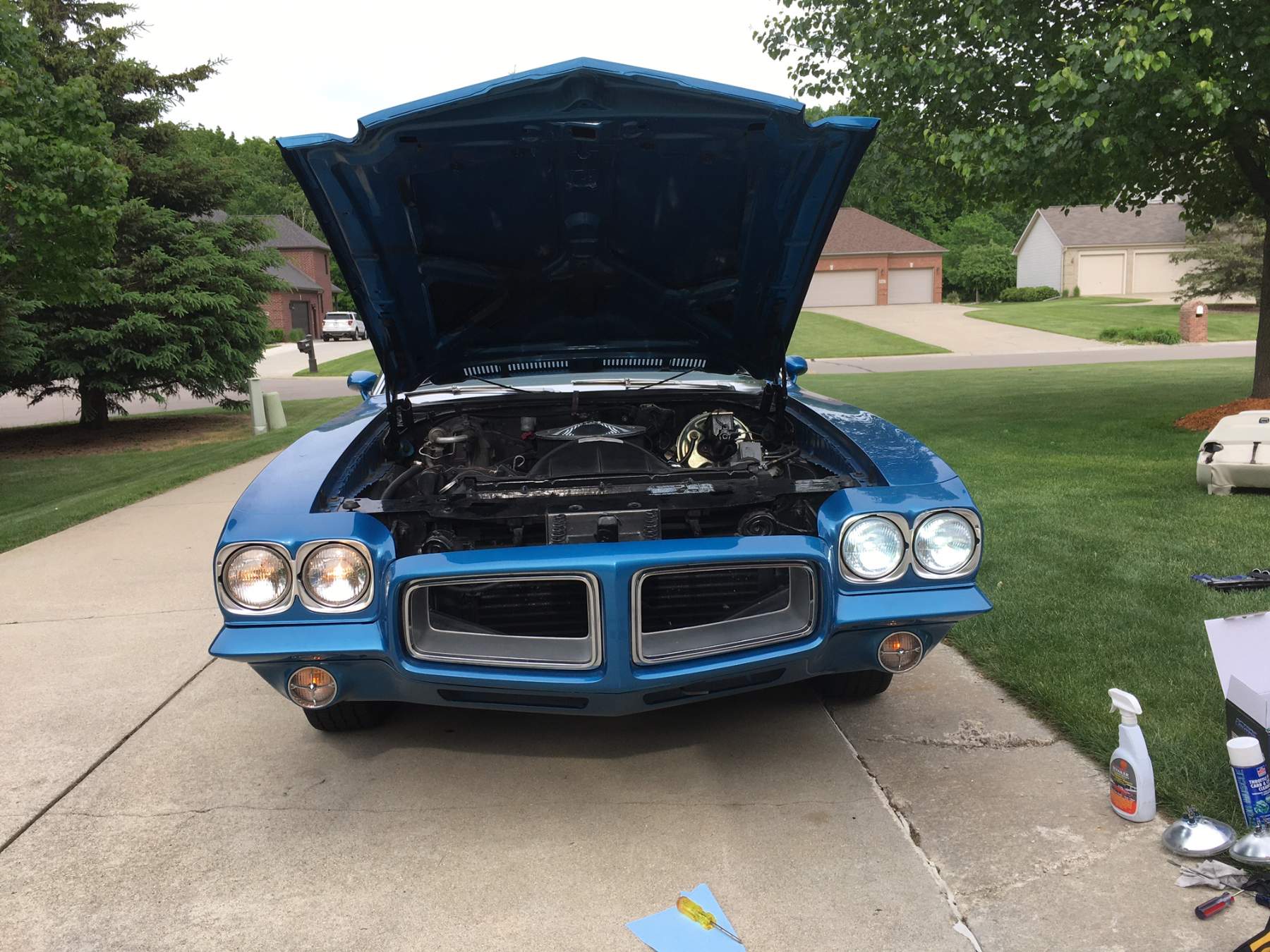

I finally got a chance to work on Lucy yesterday. I managed to fix the dash. The right turn blinker and high beam indicators weren't working. I was able to finagle the steering column wiring harness connectors off and on. Then I checked the bulbs and I ended up replacing one of the new LED bulbs in the cluster with another one once I did a bench test and it didn't light up. So now the dash is 100% working as it should, lights and all. I can now start the interior re-assembly. First I need to repaint the steering column. I scratched the crap out of it taking the dash in and out so many times.
I did a quick side job, I replaced my old 5 3/4" T3 bulbs with new halogen replacements from Octane Lighting. I ordered them directly thru their Amazon store last winter. It was a plug and play replacement. Two low beams and two hi-beams. I had never replaced the T3s in the 27 years I owned Lucy. So needless to say there was a tad bit of corrosion on the electrical connections from all those years. Low beams are 3 prong connections and hi-beams are 2-prong (although they can take a third prong if needed). You can tell the difference between T3s vs the Octane bulbs can't you? The set ran about $200 with shipping.

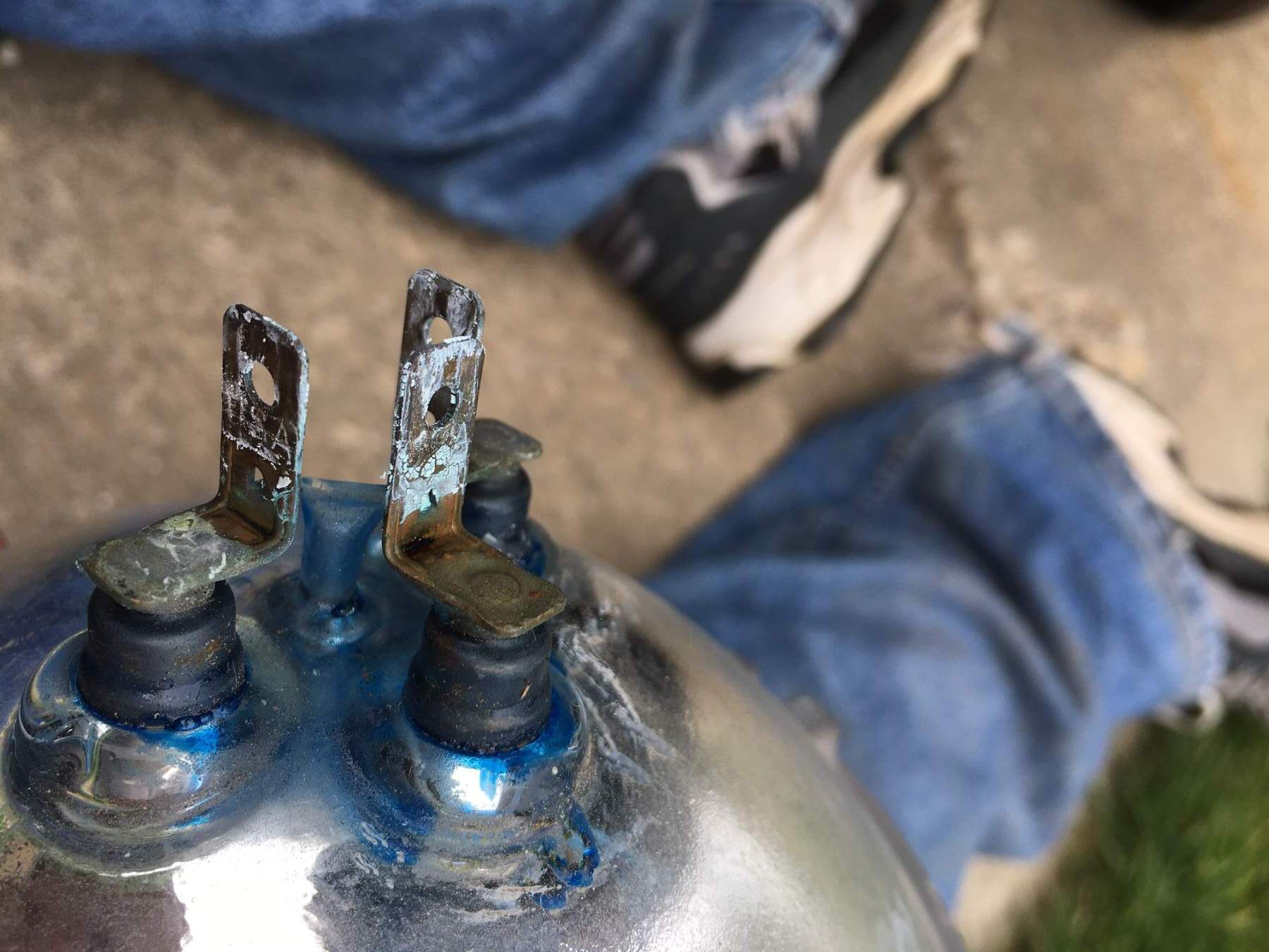

I've owned Lucy for 27 years now, until yesterday I never removed the headlights. Just a tad bit of corrosion build up, wouldn't you say?
Similar problem with the electrical connection. It cleaned up with a little elbow grease.

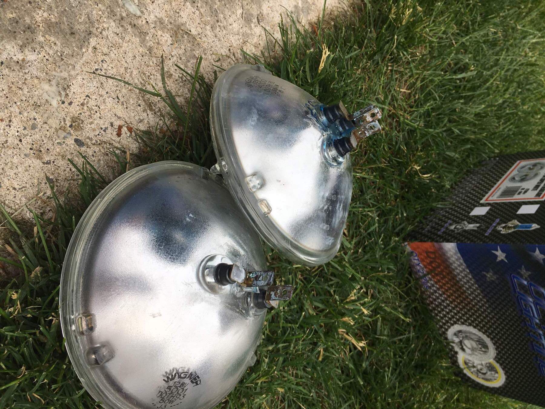

High and low beam together - original Guide T3s.

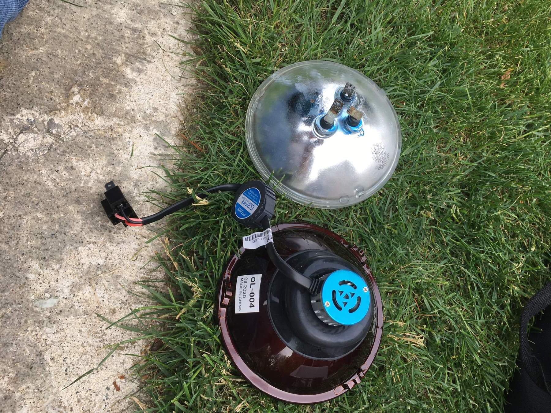

The low beam T3 next to the Octane Lighting replacement which is a halogen replacement. It is a plug and play replacement.
T3 low and hi beam on the left and the new halogens on the right? Notice how weak the T3s look. Here is a closer look.....
Here is the finished product.

For the record, I replaced the bulbs but they may still need to be adjusted or re-aimed. I won't know that until I drive it around in the dark for awhile. The halogens throw a lot more light than those old T3s could. So it stands to reason that the headlights might have to be re-aligned.
