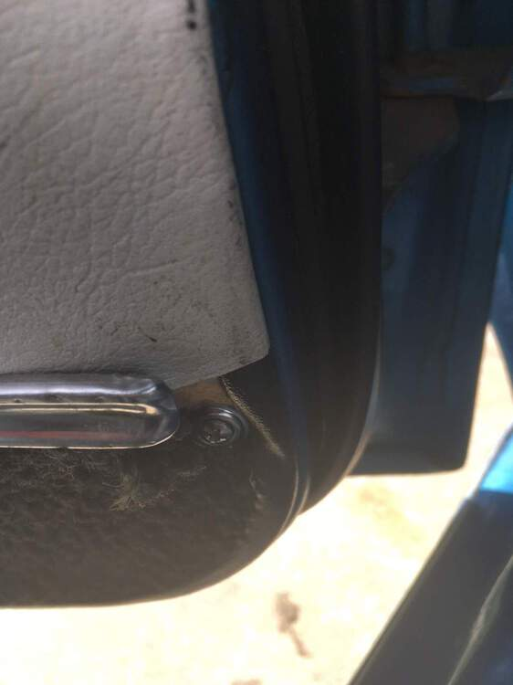

Kiwi, you asked me in an earlier post why I changed my circuit board on my cluster. Here's why.
Clearly after almost 50 years it's starting to delaminate. Nothing's built to last any more.
Here is also why I decided to order new door panels from Legendary.
Again age is taking it's toll, and probably my abuse....
It’s not you buddy! Very typical of those type of panels! Not that today’s are really any better! One of the problems are how they attach, which you can’t change! The only piece you can really effect are the attaching screws and the washer they typically use! Sometimes those either cut into the fabric or cup hard board the fabric is on.

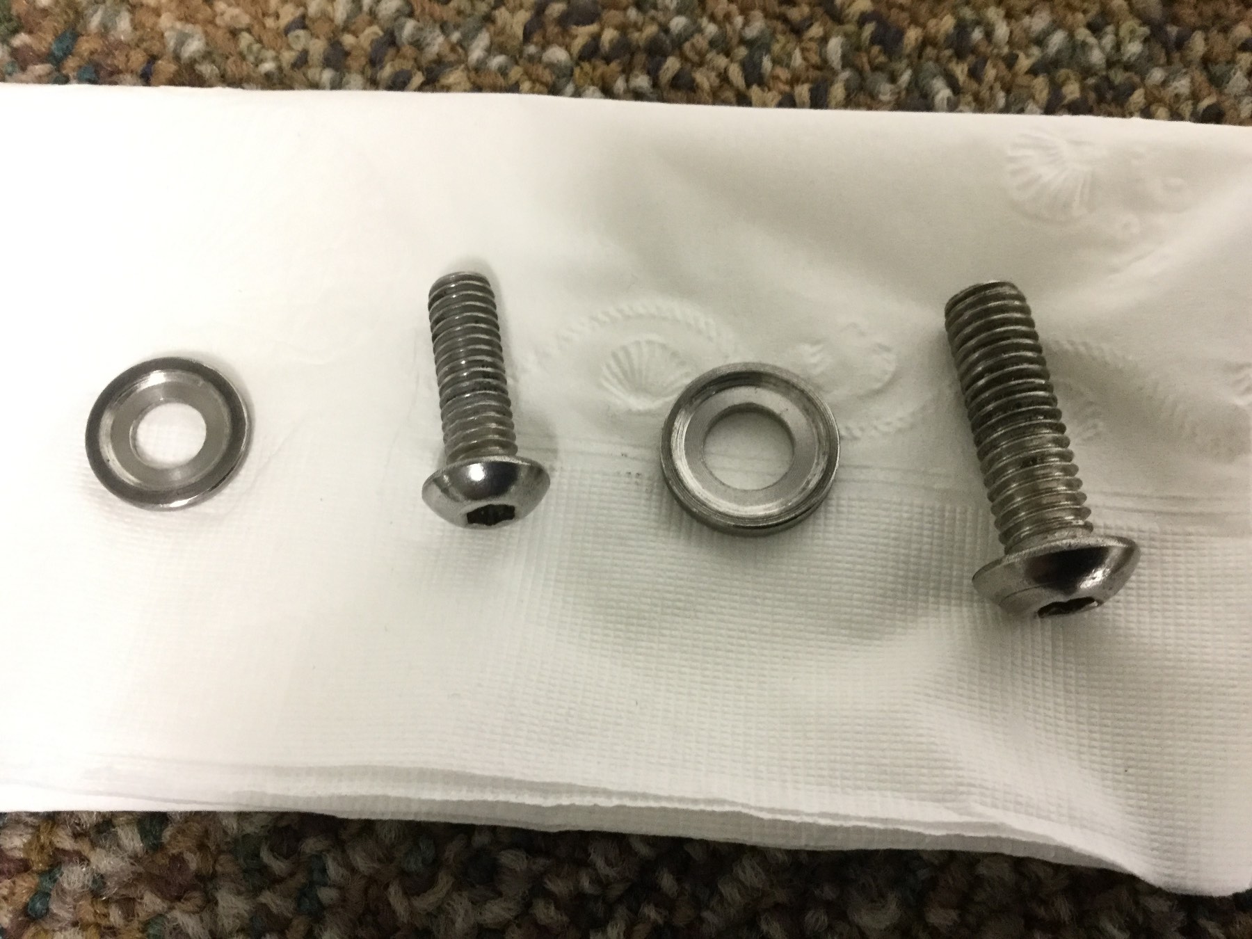

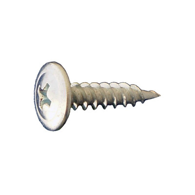

Frosty, you might consider panhead screws with a nice flat encapsulating washer that would tend to have more of a clamping action as opposed to dimpling action! If you do consider that the washers may not exist, if you give me the head measurements and how many I could make them and send them to you. JustA thought!
These are the type of washer
And this is the type of screw.

Ah pretty stink !!! that circuit board should last wayyy better than 50 years!!🙄Hahaha.
I like Last indian's idea of a better screw and a washer that loads the area better, what i would add is when you get your new panel, lift the upholstery off the board in the corner and and a whole corner section of thin metal to brace the whole corner and that washer will work way better :dancingpontiac:

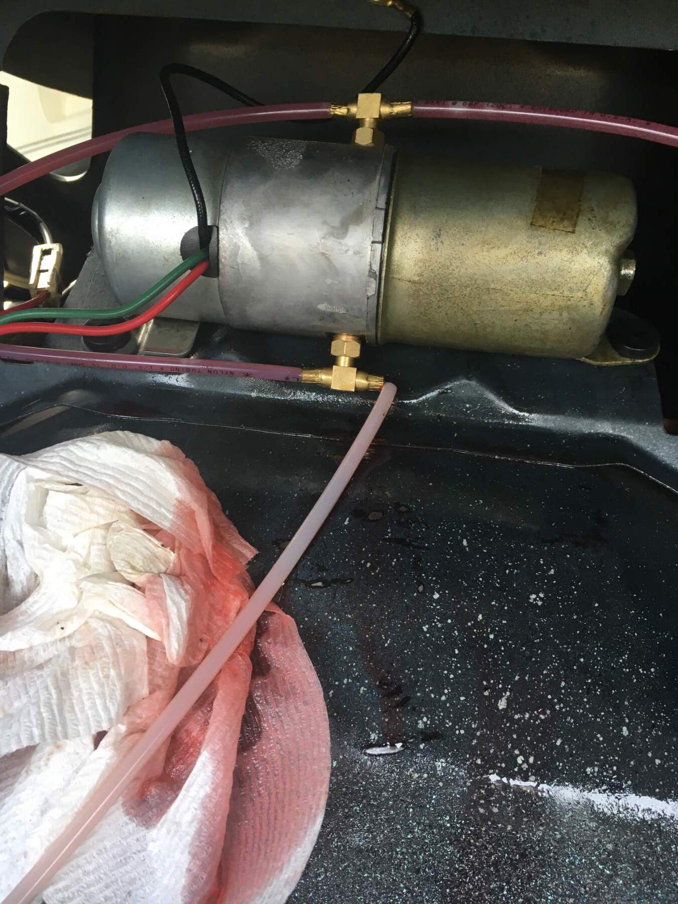

I had one other problem yesterday, I worked on the hydraulics of the convertible top. It's been a problem for the last couple of years. It's been leaking at the bottom of the passenger side ram. Well I checked all my tap and dies, and of course I don't have the right size/thread pitch. Still I tightened up the fitting as best I could. I crawled into the trunk and filled up the reservoir with transmission fluid. I lightly put the rubber stopper back in and hit the switch.....I heard the motor kick in. Good....I saw the ram arms start to move....good. Then I plop sound, followed by a bubbling noise....not good.
I looked around the passenger compartment nothing. I looked in the trunk....the stopper shot out of the pump and it's leaking fluid all over the trunk. This time the "new" hose failed at the fitting just below the pump.
Aggghhh....I feel like Charlie Brown and his kite sometimes. I replaced both lines and both rams almost two years ago when one of the original factory hoses gave up the ghost to begin with. I had to replace the rams because the threads on the host didn't match the original rams. Only the pump is original at this point. Grrr,,,,,
I had the good sense to purchase a spare set of hose awhile back, so I had it on hand. I tried getting the new hose to fit the passenger side ram and it wouldn't start. I had purchased a spare ram awhile ago too. It had some threaded caps on it. I took one of the caps off and tried it the passenger ram. That's when I realized the lower thread on the passenger ram was striped. I ended up replacing the passenger ram with the new one. New hose and new ram at this point.
I climbed back into the trunk and refilled the reservoir. I hit the power top switch and the rams went up and down! I reconnected the convertible top to the rams and tested it again. The top went up and down - yeah! No fluid leaks so far. I will test the top again this weekend just to make sure.
Justa thought 🙄

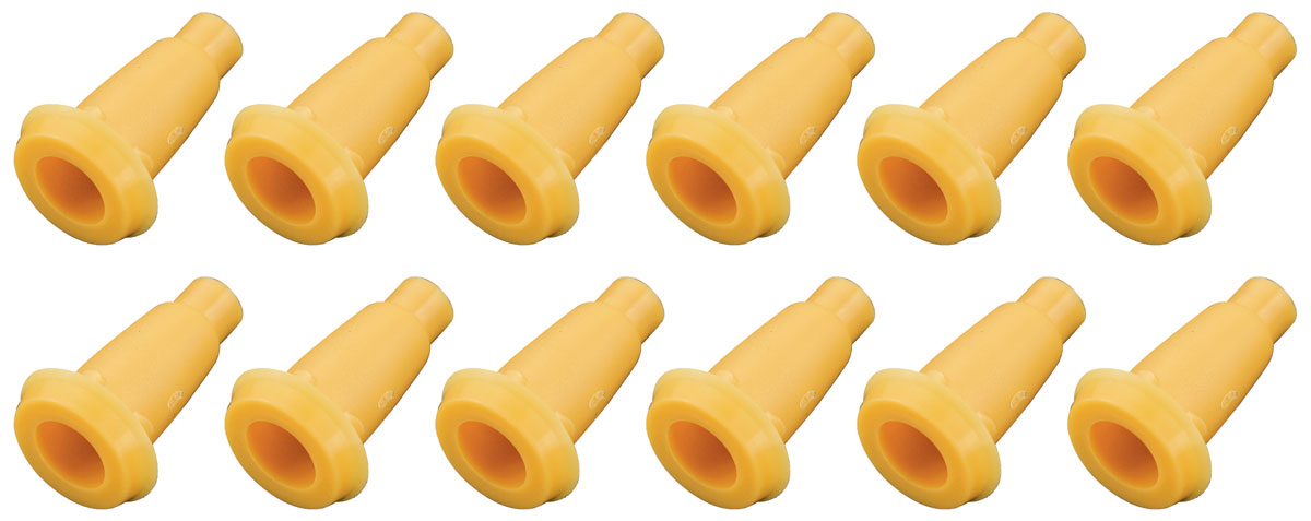

Kiwi, I've ordered a set of door panel mounting plugs from OPGI for Lucy to help reinforce the screws in the door. I do like your suggestion about reinforcing the corner though.

On 9/8/2020 at 9:34 PM, Frosty said:
Thanks Last Indian.

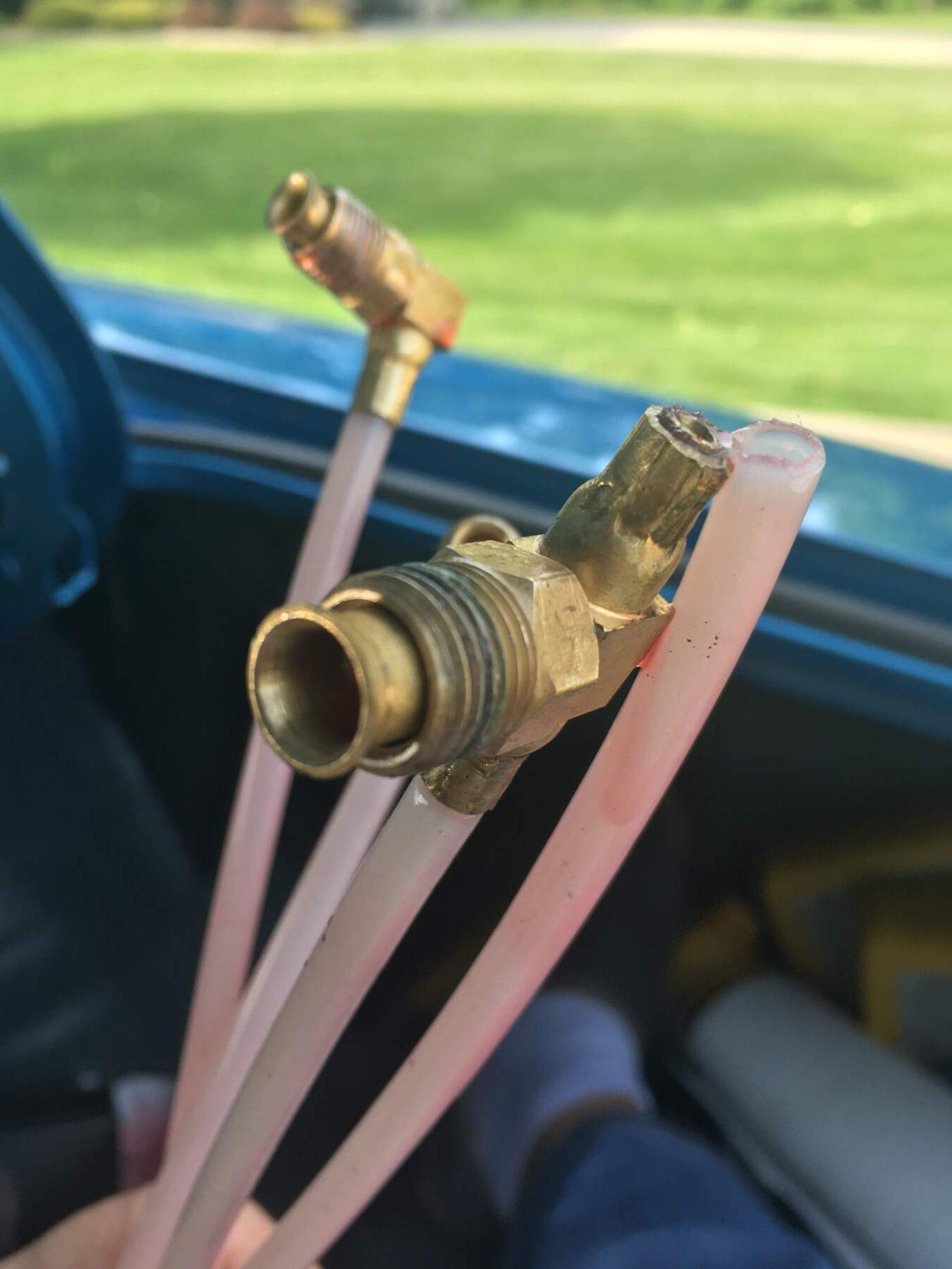

Frosty, while I know you’ve fix it and I hope that’s permanent, one thing to consider is changing the lines while you are still doing all your work on Lucy. Those type of crimped nylon line are inherently problematic! They usually do exactly that! It’s difficult to crimp them without causing stress points! Then any added stress I.E. swelling due to pressure line movement, or even aging due to fluid contact, etc. basically work fatigues them. If you have the room, & I think you might. Change the tees out for AN # 4 tee with a 1/4 npt female using a 1/4 tubing to 1/4 npt adaptor. You will also need an adaptor at the rams. This will allow you to run AN hose & fittings.
This is # 4 AN tee with a 1/4 npt on top
this is a 1/4 tubing to 1/4 pipe adaptor!
What size is the nylon line? It looks to be 1/4. I also presume that the fitting arrangement for the ram is tubing? I.E. cap and ferrule!
Do you have a Parker store near you anywhere?
Edited by Last Indian

The good news is the hydraulics on the top appears to be fixed. I topped off the reservoir again on Saturday, and tested it up and down a few times. It works. No apparent leaks. If it leaks again, then Last Indian, I will take up your suggestion and reach out my local Parker's, which is in Saginaw I beleive.
thats good mate :cheers:, but long term i am with Last Indian, replace all the hoses with new an fitting and new hose..... what did you tell me about fuel hoses, a few months ago :)
Teflon  hose is really good, you may consider that and crimped fittings🙄

The original convertible top lines are plastic nylon. The replacements from NPD are too. Since NPD is about 45 minutes away, that is what I purchased. I didn't expect one of the replacement lines to blow out the way it did. I'd prefer a custom made hose over this plastic stuff. Still the original host lasted 46 years too.

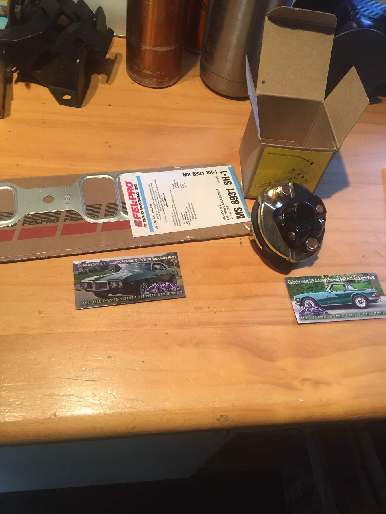

Got my Rock auto order today
and clearly I had a blonde moment 😫
i managed to order only 1 intake gasket for the 429 !
Here I was thinking I was ordering a intake set !!!
Correction ! i didnt have a Blonde moment!
i just went on their web site and it clearly shows 2 gaskets and states "set"
https://www.rockauto.com/en/parts/fel-pro,MS8931SH1,intake+manifold+gasket,5424
so i have emailed them about it... lets see what happens.
