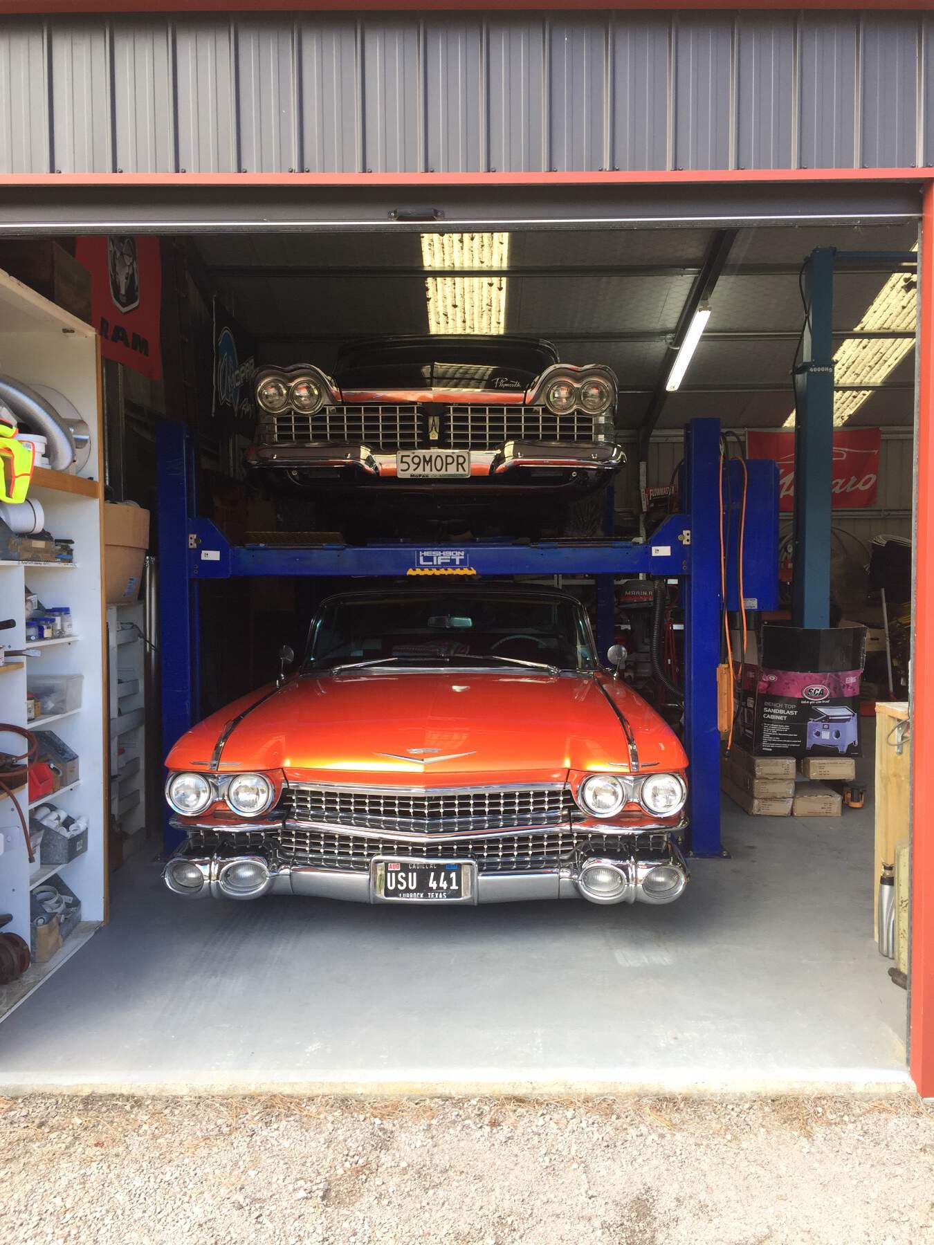

Finally got time to move the caddy to its new home and just on 3 inches clearance 🍻

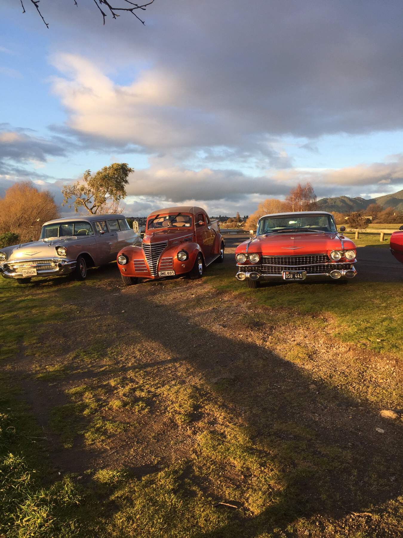

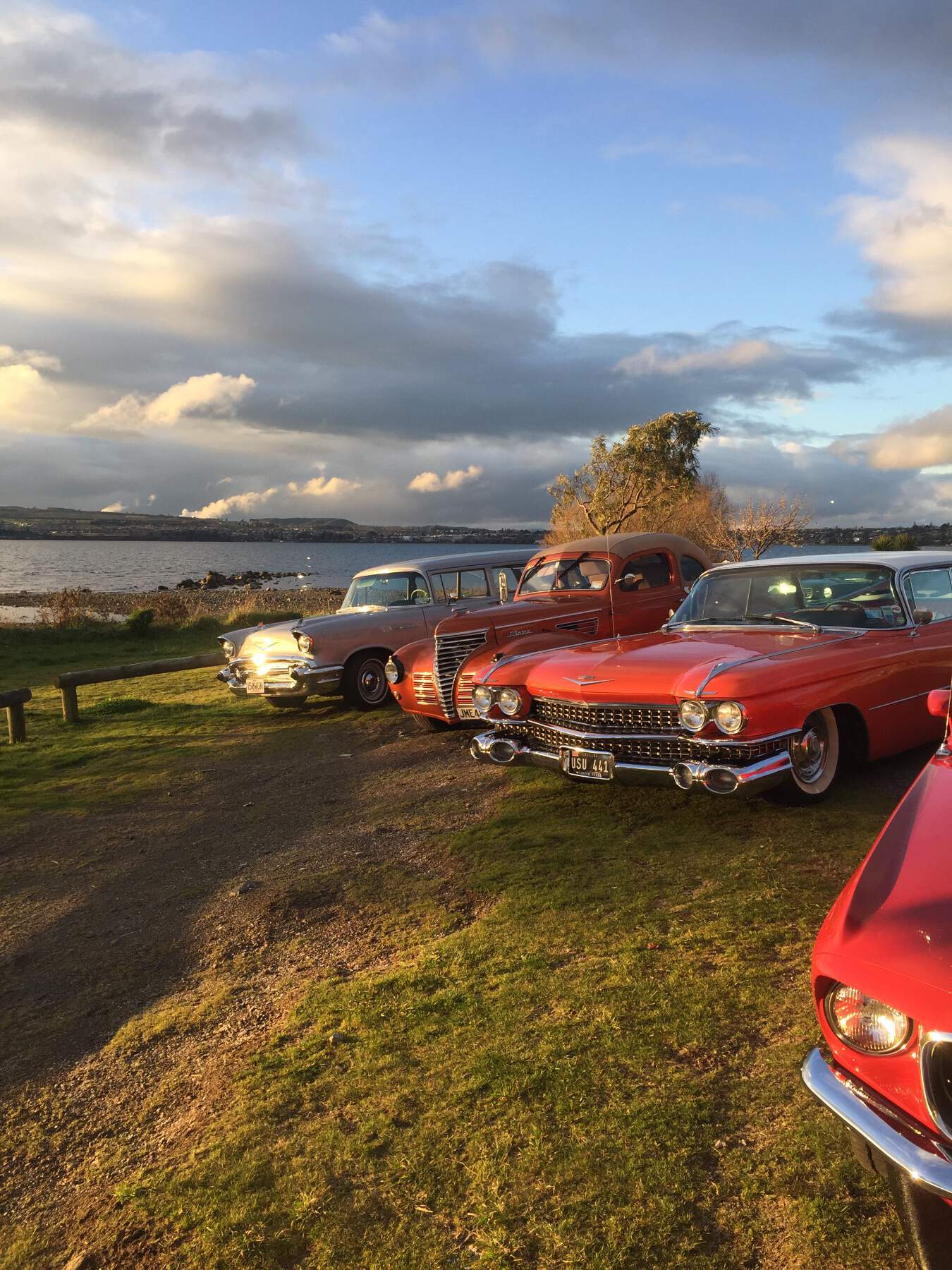

Last night we did a memorial cruise for a mate who past one year ago
was about 40 cars and we parked up at the lake
here is a couple of my mates toys

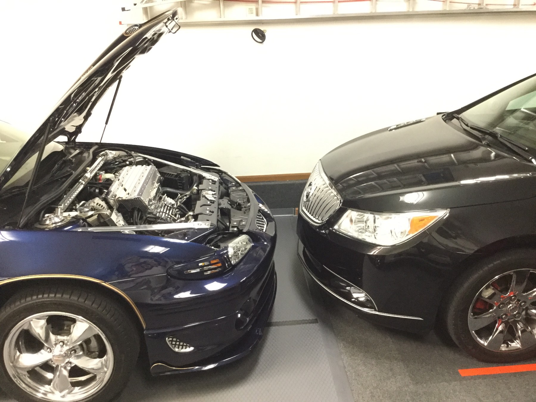

23 hours ago, JUSTA6 said:
Amazing as always..  So in one shot, there is a reflection of the Buick emblem.  Had to be an angle thing cause I don't see it out in plain sight.  You da man.:clapping:
Up it’s my black Buick LaCrosse! It’s backed in facing the Indian!

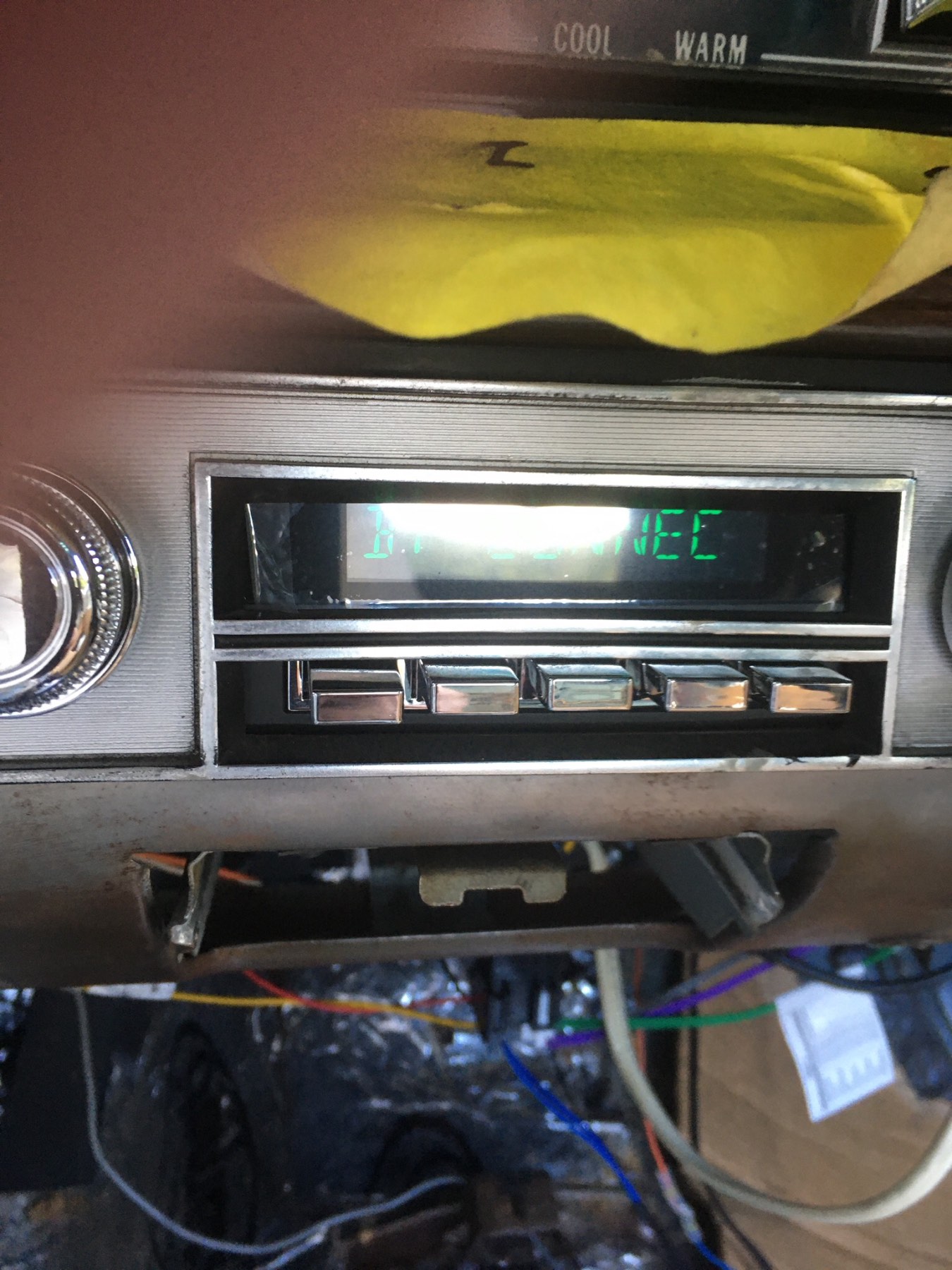

i finished connecting up the new RetroSound radio. Sounds good. The Bluetooth seems to work fine. The rear speakers work fine but I can’t test the front kick panel speakers just yet. They are tucked away with the rest of the interior pieces. So far, so good.
i wish I had taken a better picture. Sorry guys.....this photo is not up to my usual standards.
I spent a fair amount of time zip tying stuff up under the dash too. Hopefully I can start to,reassemble the dash and glove box soon.

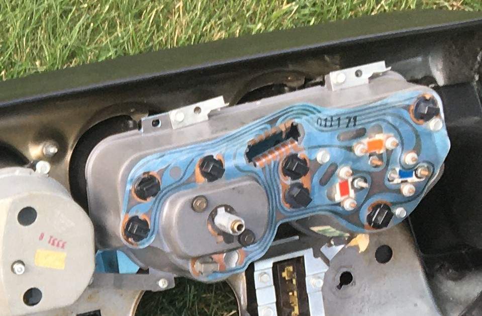

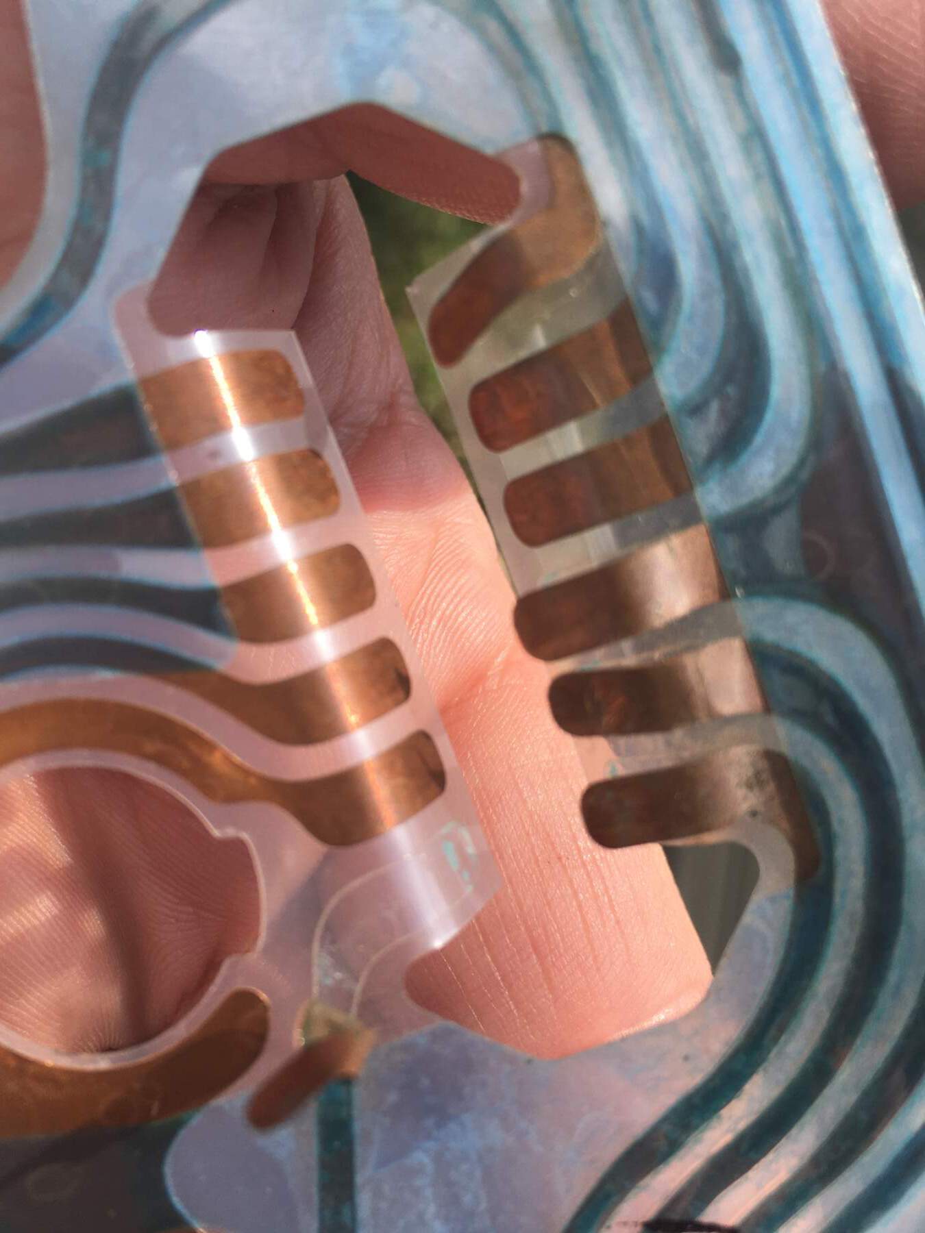

I was having issues when I turn on the headlights. Sometimes when I turn on the headlights, the dash lights would not come on for several minutes. Kinda scary on dark nights. Other times if I turn the knob to adjust the brightness of the dash lights, I could see it directly affect the gas and water temperature gage readings. This appeared to be a classic case of a bad or intermittent ground or short.
Then I took the dash out to replace the bulbs with LEDs and I noticed the circuit board where it plugs into the wiring harness and how it was starting to delaminate at the connection. I figured that might be contributing to my dash problems. So a new one was ordered.
Sorry Frosty, I’m a little slow on replying! One thing to consider with the issues you’re having are the LEDs! Depending on the type of LEDs you get and where they are going in the circuitry, they can cause issues because of polarity! Such as you need a different flasher module for LEDs! Side turn signal lights that flash opposite with the front or back turn signals won’t work period if you use 196 LEDs in the side marker lights. In some cases lights won’t dim properly, etc. FYI!
I've read that before Last Indian. THanks for the reminder though.
I've been on the look out for that. So far, I've only replaced the 194 bulbs in the dash and not anywhere else. The problem with the gages and headlight switch were pre-LEDS.

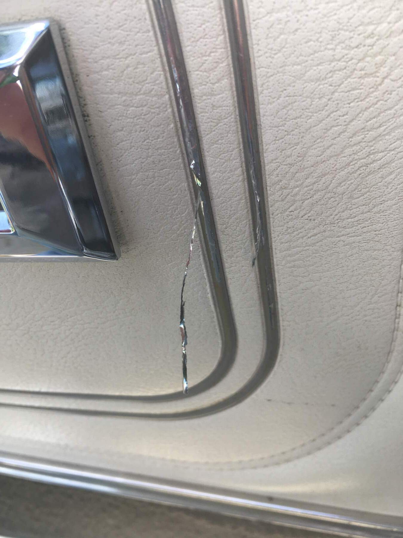

I took a hard look at my door panels, the driver door panel is showing it's age. The silver/chrome surround is separating, there is tear in the carpet towards the bottom. I decided to order replacement door panels from Legendary Auto Interiors in NY.

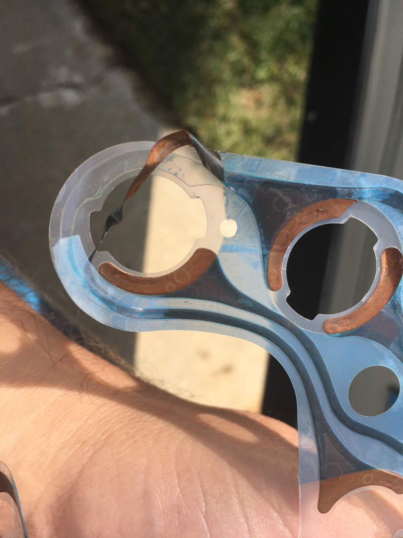

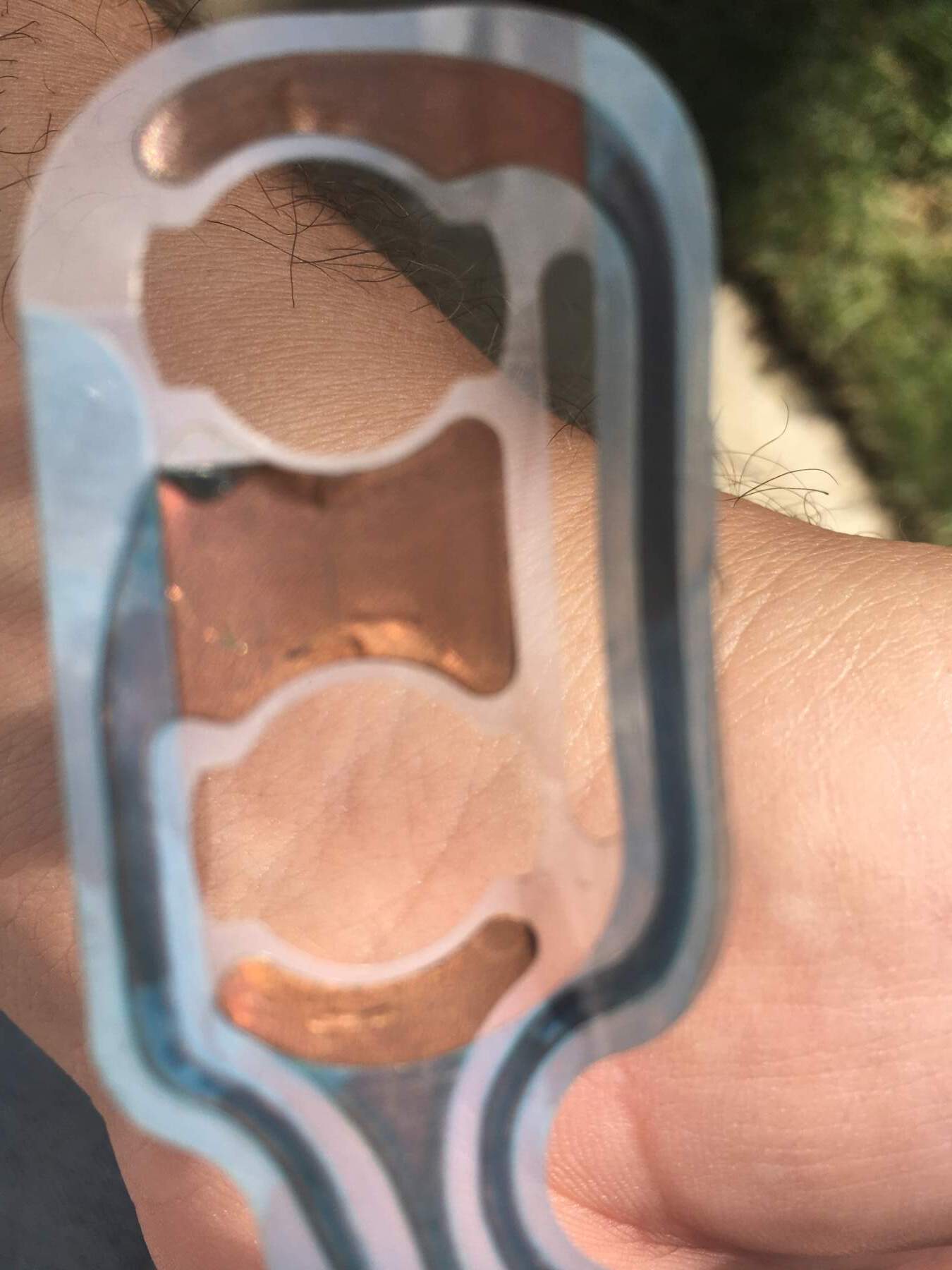

Kiwi, you asked me in an earlier post why I changed my circuit board on my cluster. Here's why.
Clearly after almost 50 years it's starting to delaminate. Nothing's built to last any more.

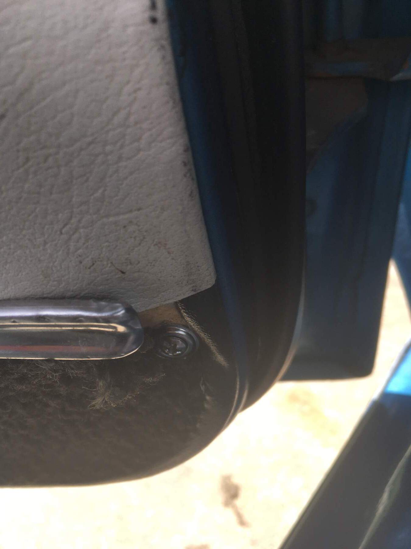

Here is also why I decided to order new door panels from Legendary.
Again age is taking it's toll, and probably my abuse....
