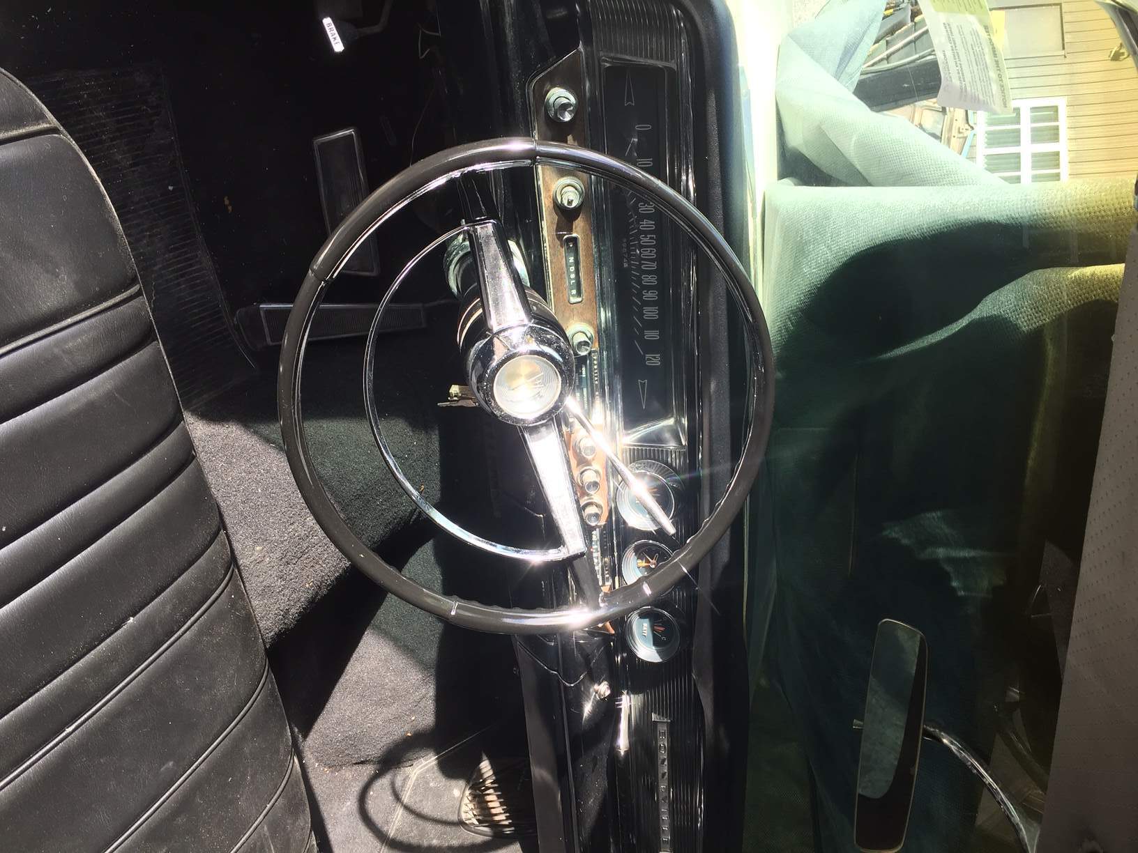

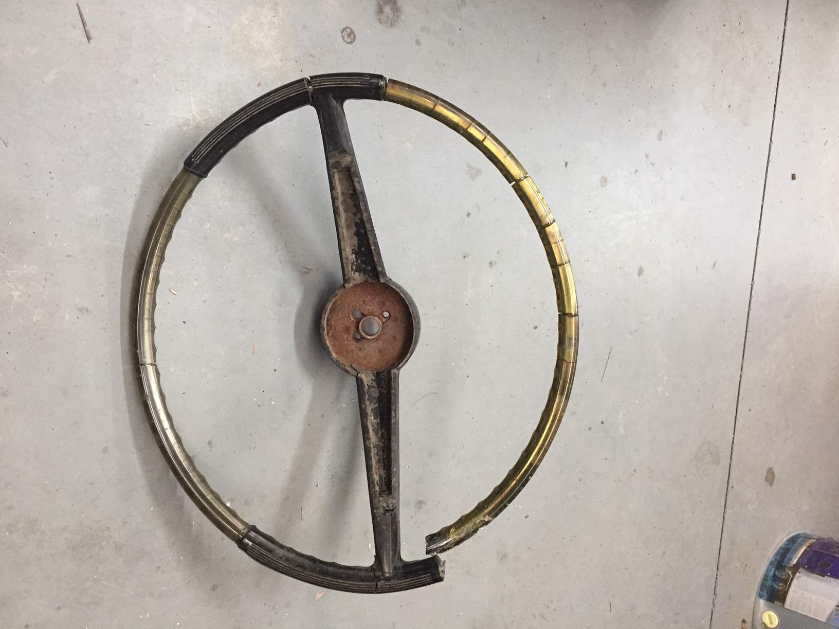

Well since I haven't replied to this topic, on topic lol. I'm working on my steering wheel today.
Oh i can relate to this job Wrongway !!! enjoy mate:stars:
you will be in for hours and hours of fine sanding !!

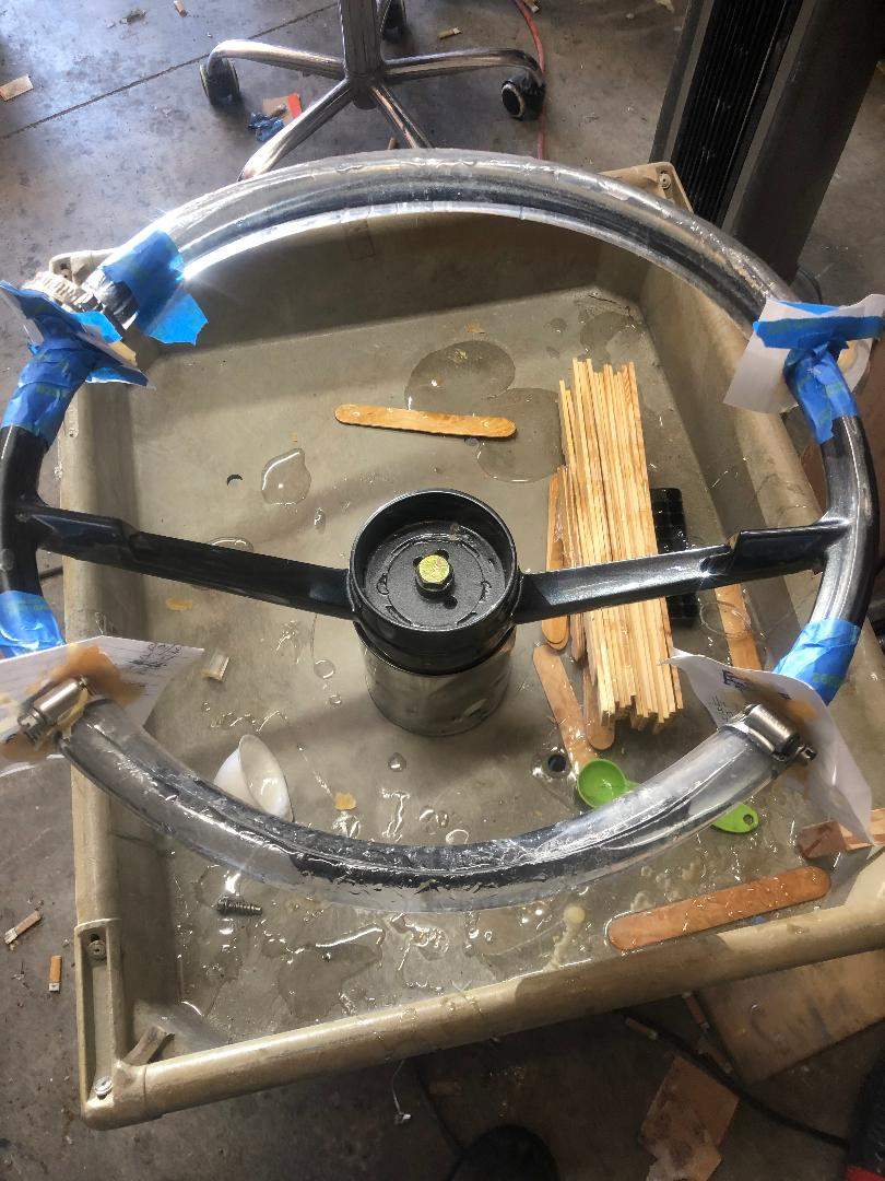

Wow, looks great bro. Did you.... I'll message you. lol
see page 4 of my 64 rebuild Wrong way, there some pics half way down the page on what i had to do to my wheel......btw
 i was inspired by Last Indian and what a magic work of art he made his steering wheel .....
you justA go maddddd with all the sanding :stars:

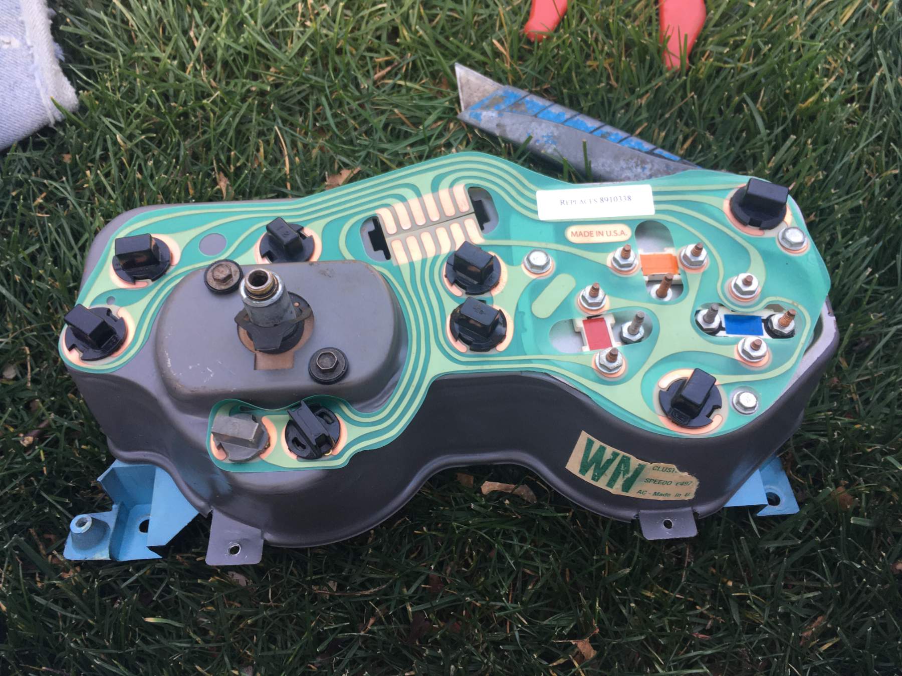

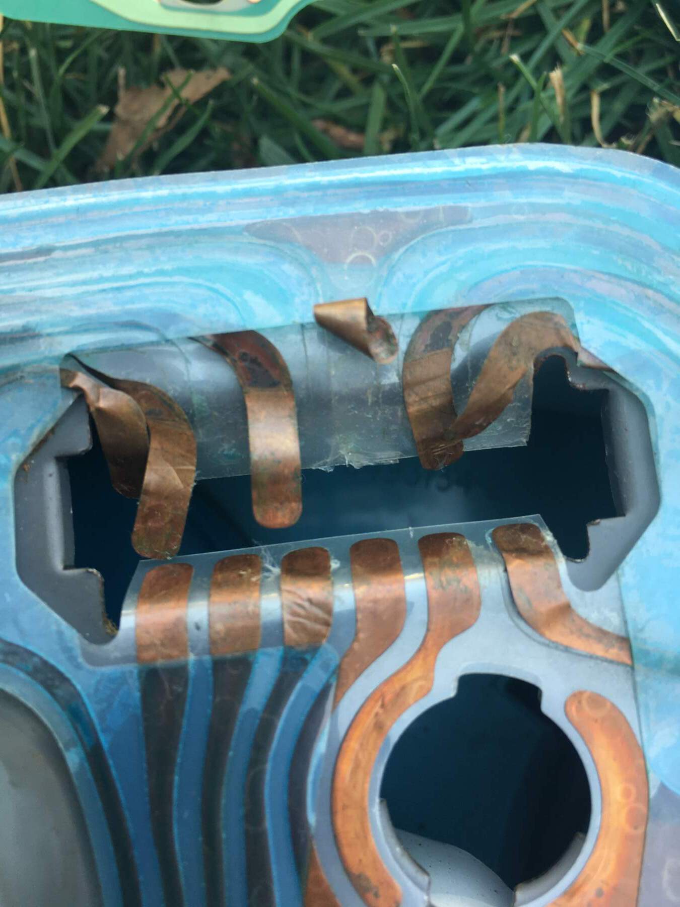

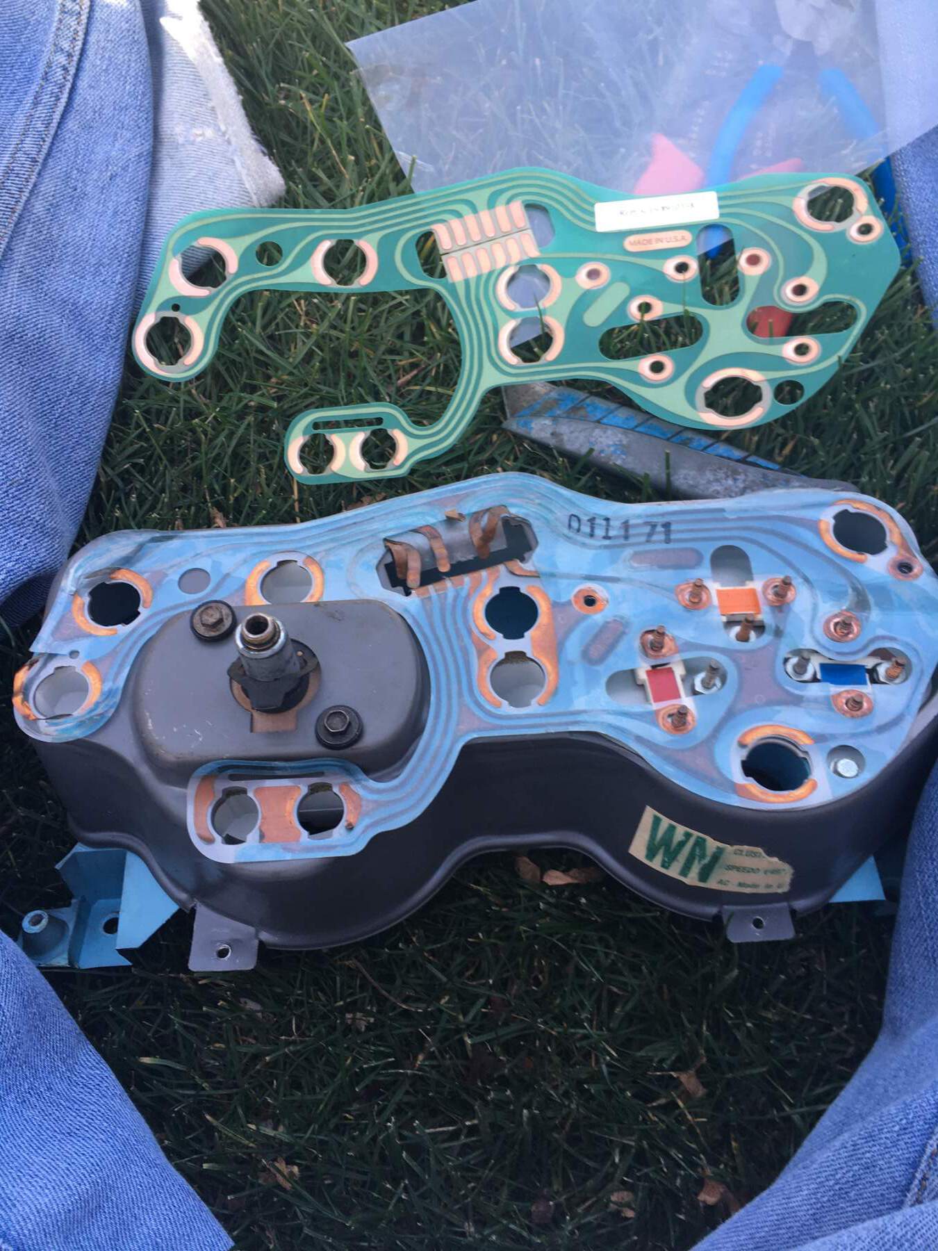

Okay - I'm going crazy with Lucy. I spent another two nice days under the damn dash. I got the new circuit board installed on the cluster. You can see the before and after pictures for yourself. The connector path was fubared.
My problem now is the speedometer gage lights and right turn signal won't come on. My rally gages now work. The tach works, the hi-beam and left turn signal all work. The lights for the tach work (they are separate from the cluster anyway). The gage lights for fuel gage/water temp/oil pressure works. Left turn signal and hi-beam works. I switched all the bulbs on the cluster to LED 194s.
I am frustrated as hell why I can't get the speedometer gage light(s) and right turn signal to work. I've checked the fuses - they are good. I checked the right side of the car - all the bulbs check out. When I hit the turn signal - the lights come on but don't blink. The turn signal light never comes on in the cluster either. I have also tried with and without an LED-compatible flasher. It doesn't seem to make a difference at this point.
I suspect I need to do a continuity check in the steering column next and check to see if something isn't loose or broken there. That might explain the turn signal but I am out of ideas on the gage light. You guys have any ideas?

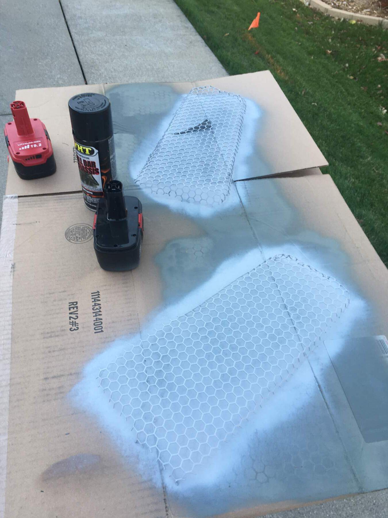

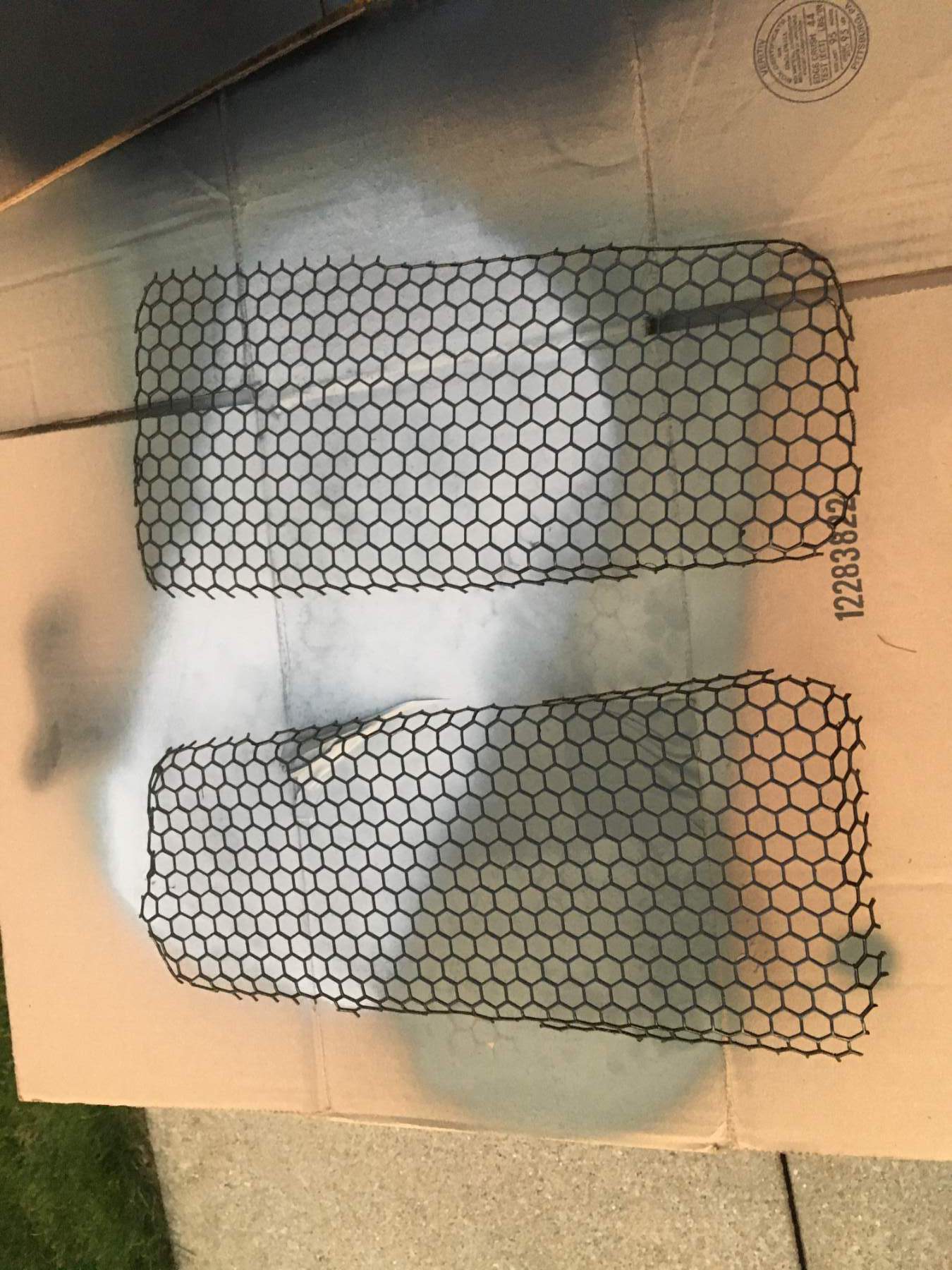

I also found some time to repaint my homemade honeycomb grilles. They had some spots of light surface rust, I hit those spots with sandpaper, applied some self-etching primer, some POR-15 primer next, and then two coats of roll bar/chassis black paint.
With luck I might have time tonight (while the weather is still warm) to re-do a set of pitted chrome '71 GTO grilles in black as well. I've always like the look of the '71 grilles over the '72. The '71 GTO had a chrome grille while the '71 Judge had the black grille. If I black out this set, I will have two sets of '71 grilles, one chrome (new) and one black (old), plus two sets of original '72 grilles (square egg crate) and my honeycomb grilles.

A couple things with the lights are possible. Have you turned the the 194 LEDs that don’t work around in the socket? Some LEDs are polarity sensitive. Also take a good look at the contact prongs of the sockets that interface with the Mylar circuit board! If those cooper prongs aren’t shiny it could be a connection issue. Lastly, and I’m sure you have, but double check the led bulbs to make sure they actually work, they wouldn’t be the first bulb that didn’t work straight out of the box!

Frosty, do you think you can leave the gage cluster out of the dash and use some wire with alligator clips to connect the plug-in harness to the gage cluster to try and troubleshoot the issue? I’ve done this before! It take several wire & alligators clip assemblies to do this, but it beats the in and out cycle.

Last Indian - I may have to pull the cluster one more time and test bulbs and circuit board one more time as well as perhaps test or continuity test what is coming thru the plug to the cluster and thru the steering column. With the nasty. cold weather setting in, this now maybe a spring job. I've done the alligator clip trick on other cars before. It's an old stand by, but it works!

Yes, Kiwi, I did replace the headlight switch, but I kept the original one as well. Interesting thing with these LEDS, they don't dim. They are either on or off period. So for the tach, fuel/water temp/oil pressure the bulbs are on. So that tells me power is getting to the cluster, I think Last Indian may have a point about the bulbs or contacts on the speedometer. I just have to figure out what it is.
yes thats your clue mate... it has to be on the circuit board or the led itself😋

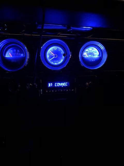

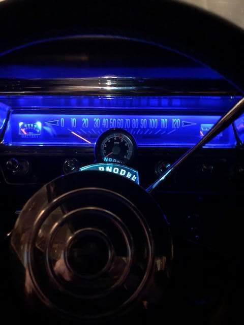

I used LED's in everything on my dash except for turn and hi-beam! all gauges, clock, and glovebox!
they look very cool,
but also bright, can you dim them ?
Not as bright as they look, but working on dimming and don't do alot of night driving unless I have too! Thanks

Those look awesome wdl182!!!
From what we have been learning, this is not plug N play???  Your dash looks great.  What did you have to add to make em work?   Many older car peeps have problems esp with tail lights, turnsigs, wouldn't expect much of a problem to replace the peanut bulbs as we used to call em on the line.
