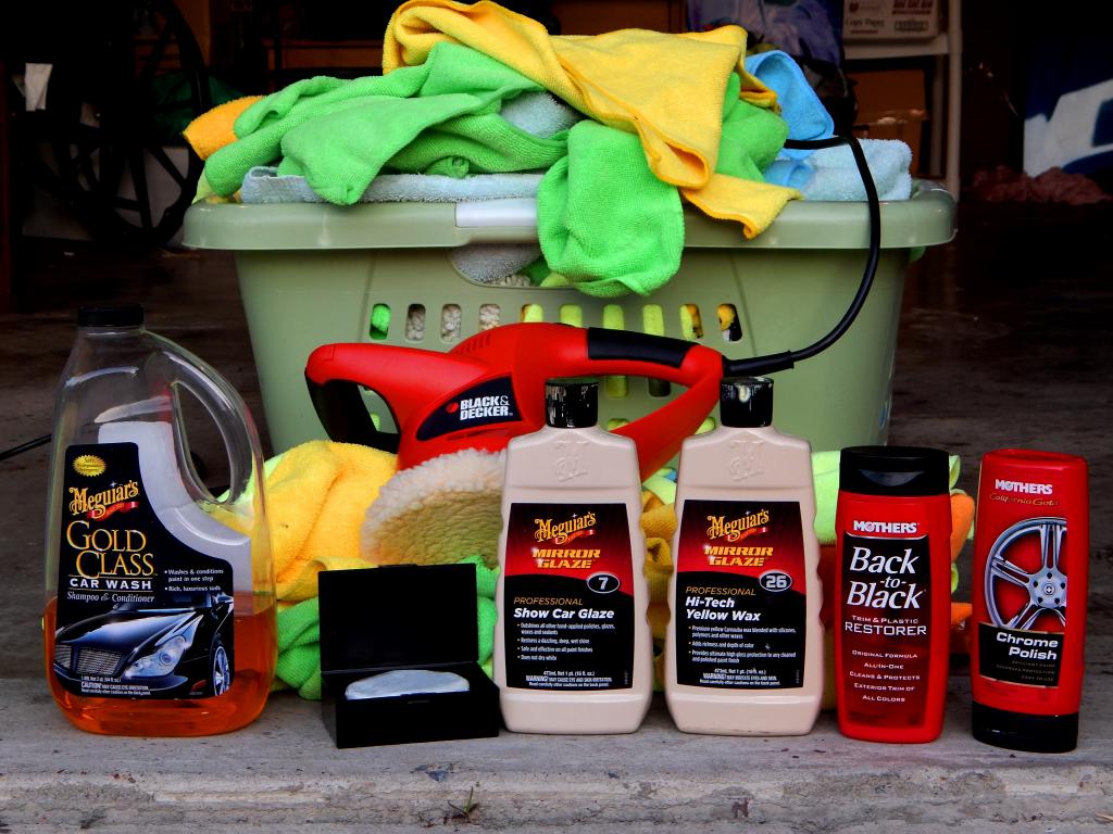

I had today off, so I spent all day getting Black Betty ready for a show tomorrow.
I used this stuff...
... and got these results...
