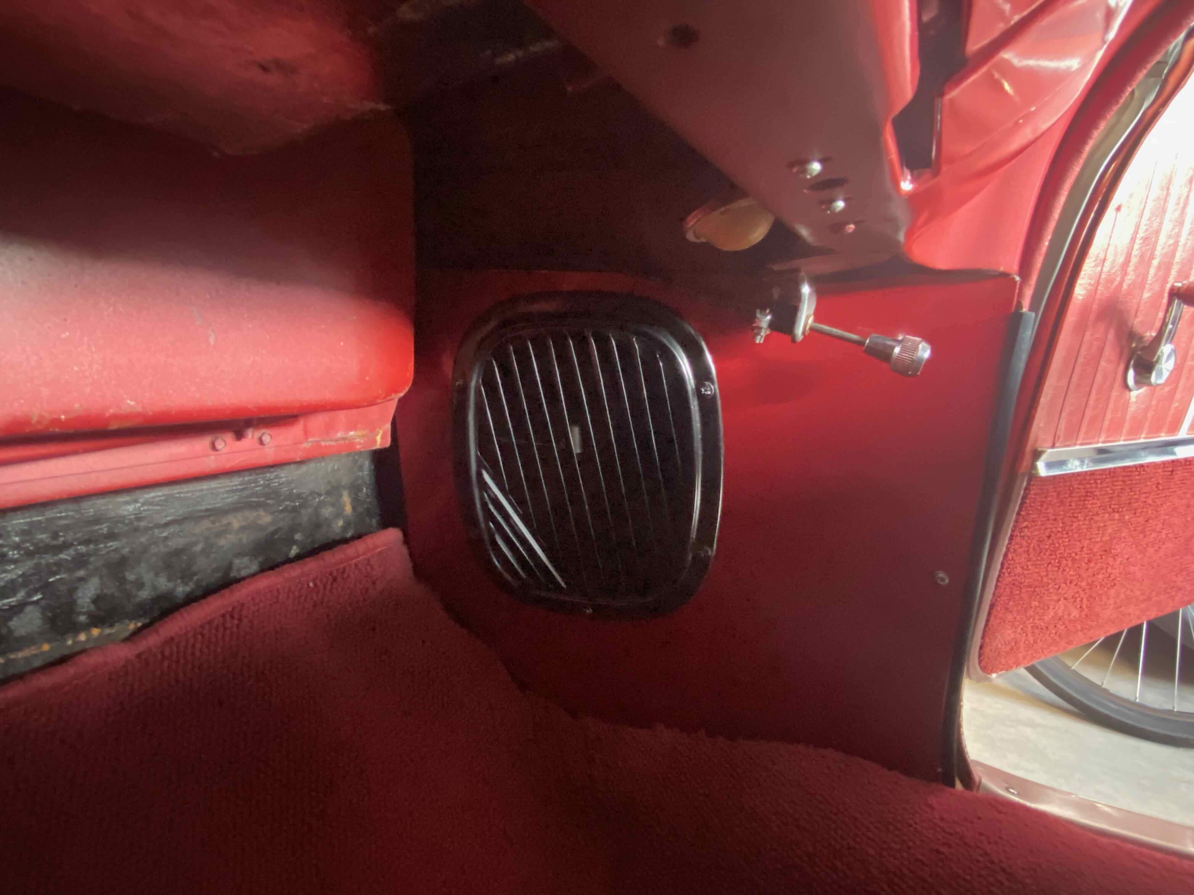

Another small job that will make things much more comfy for my gorgeous passenger...

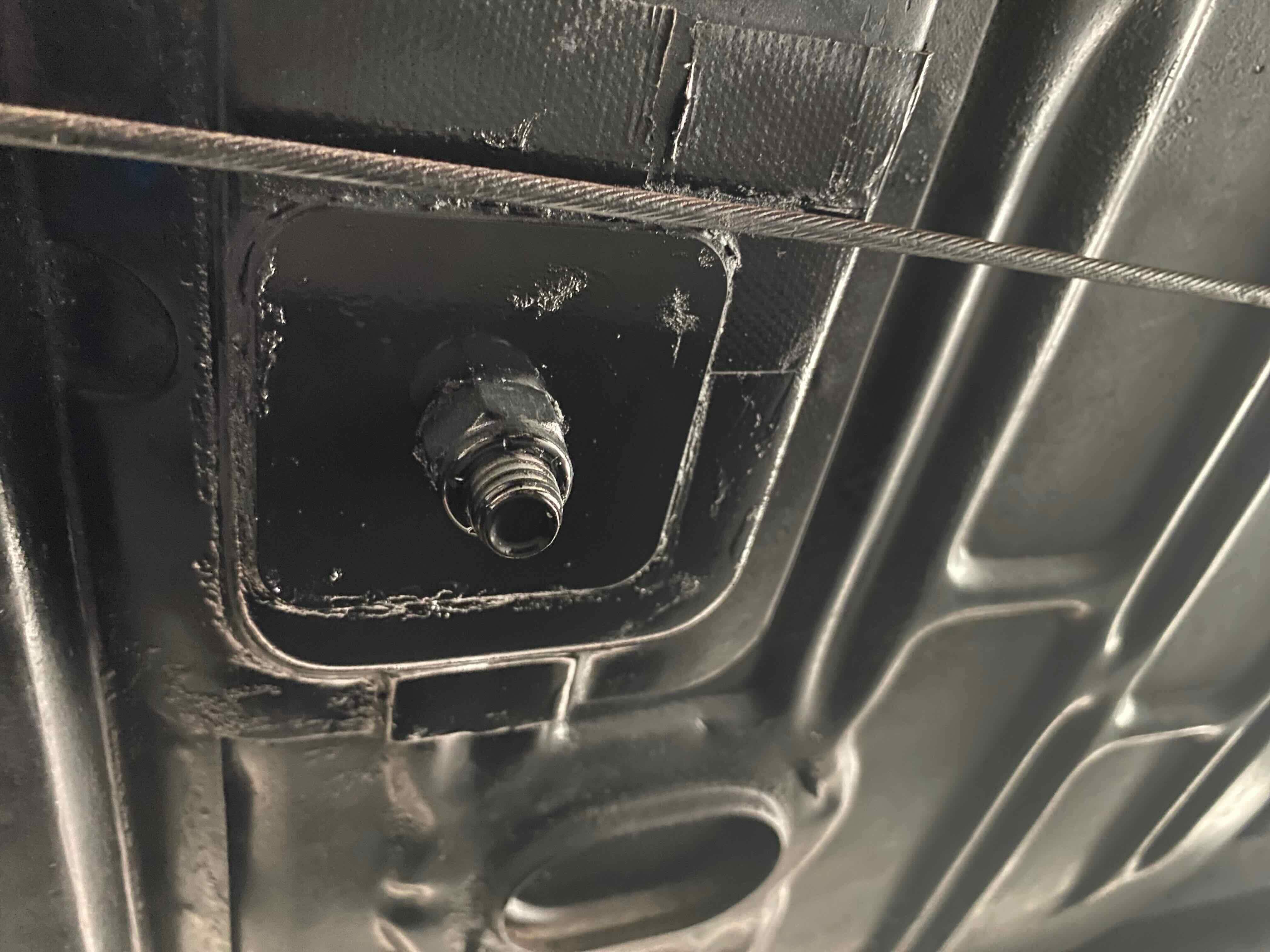

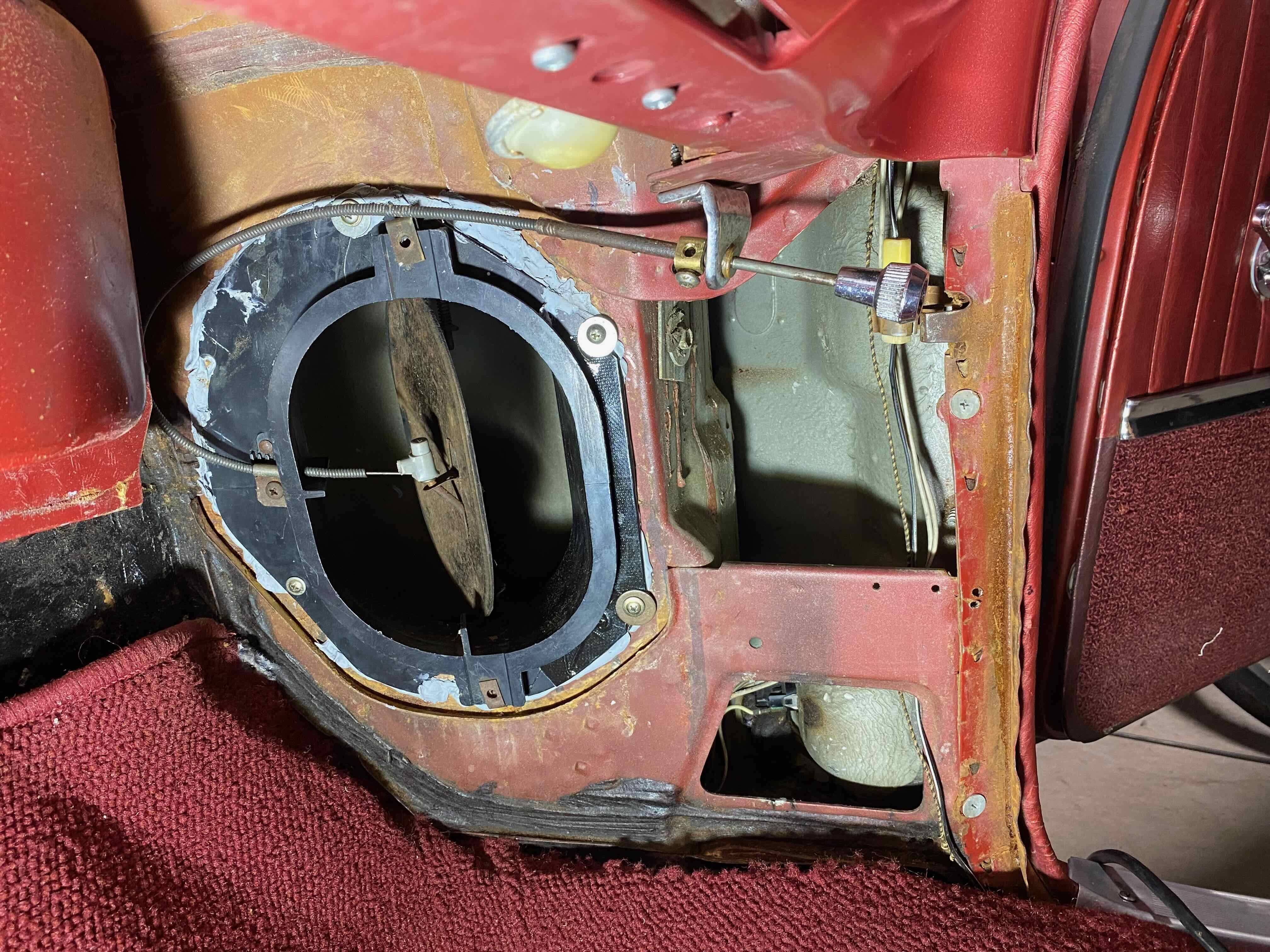

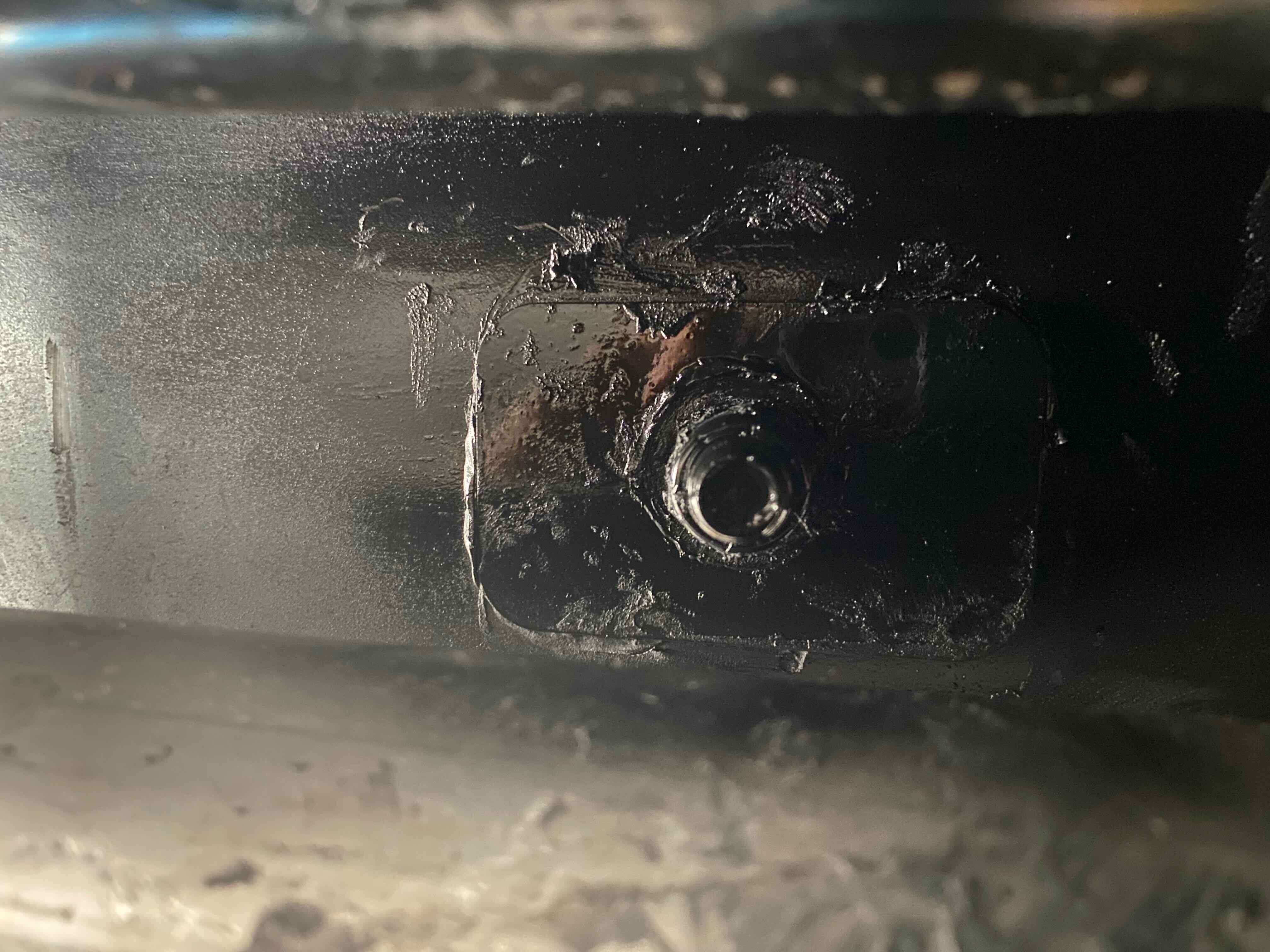

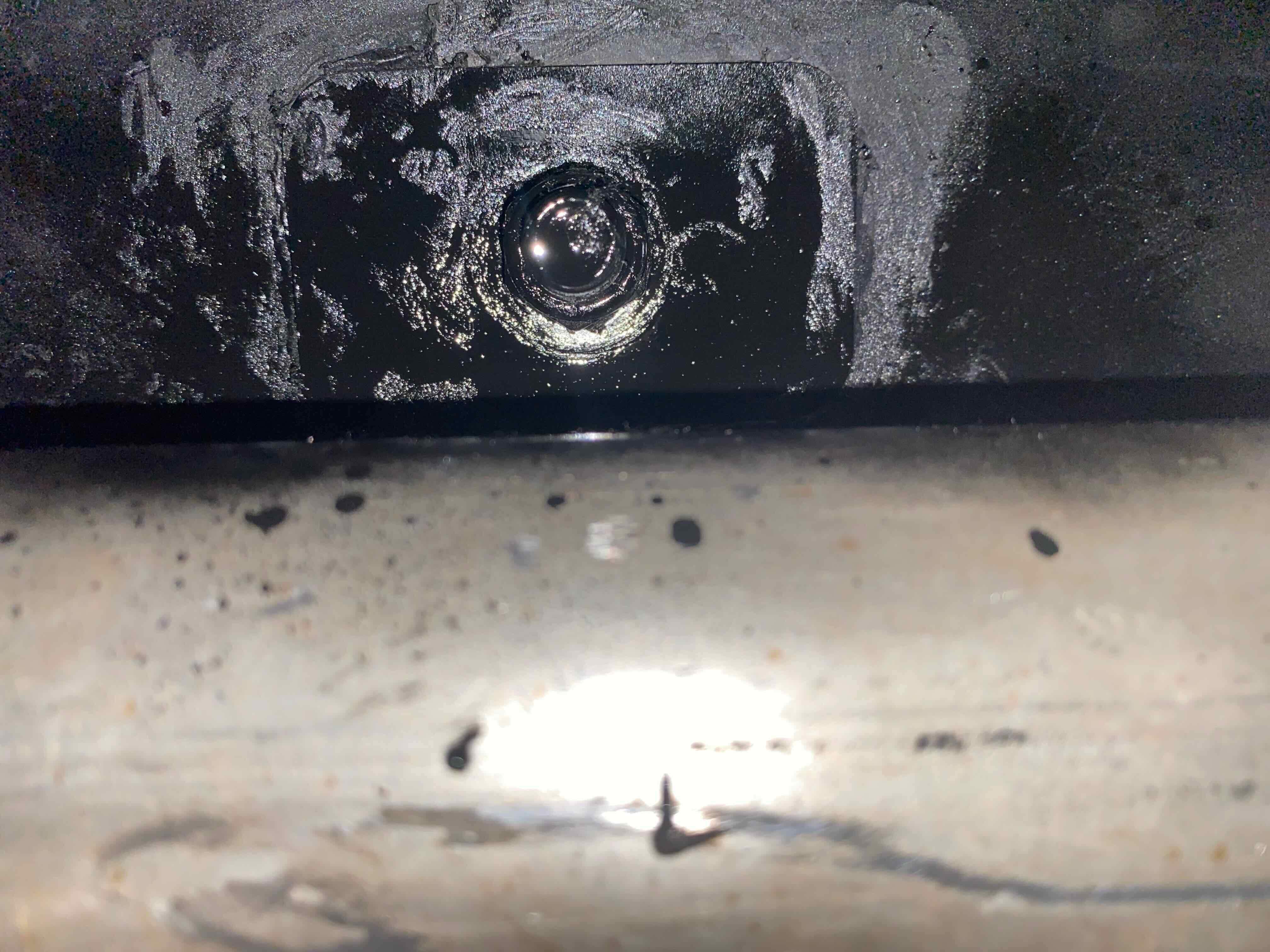

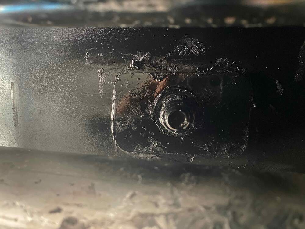

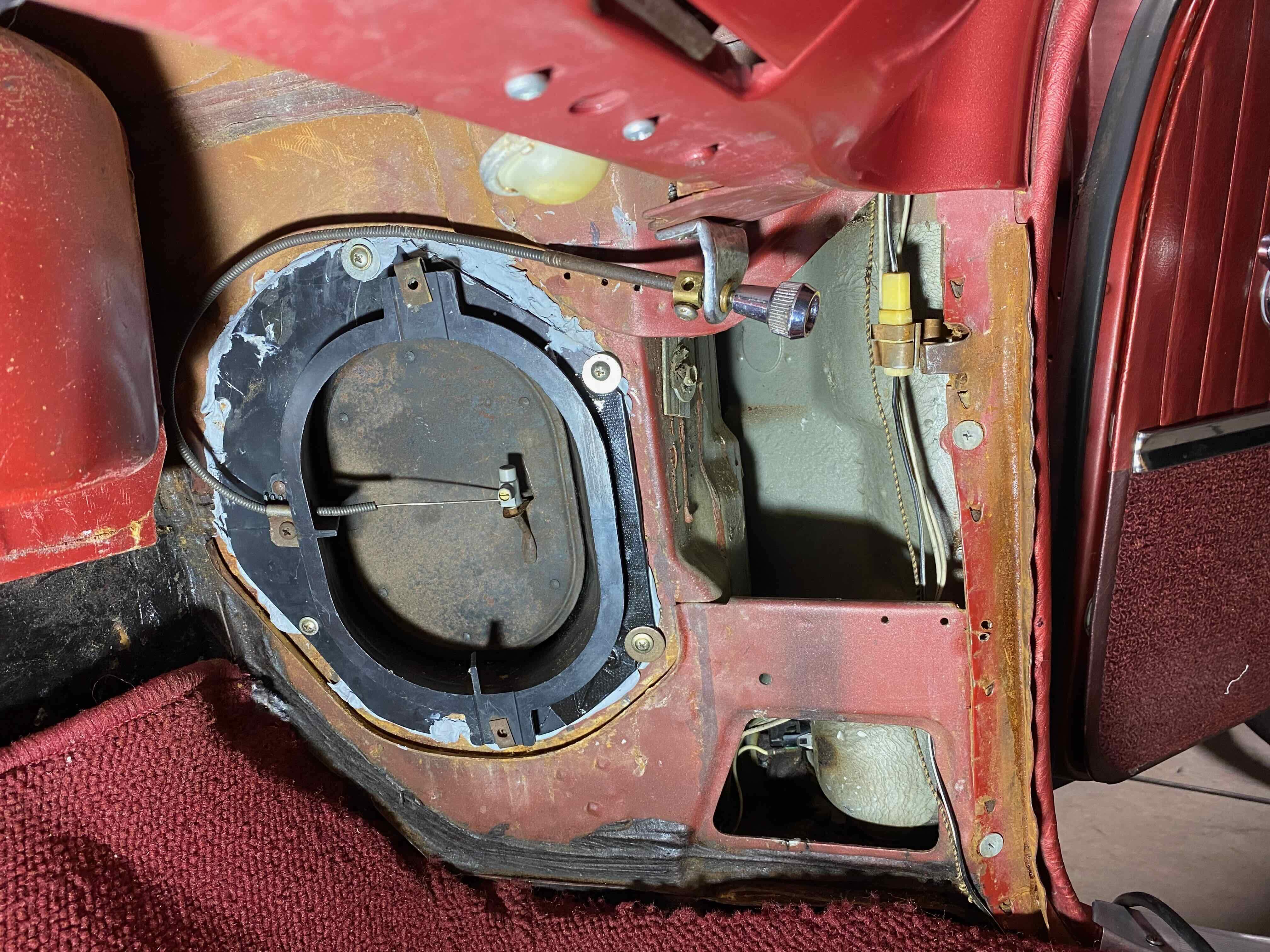

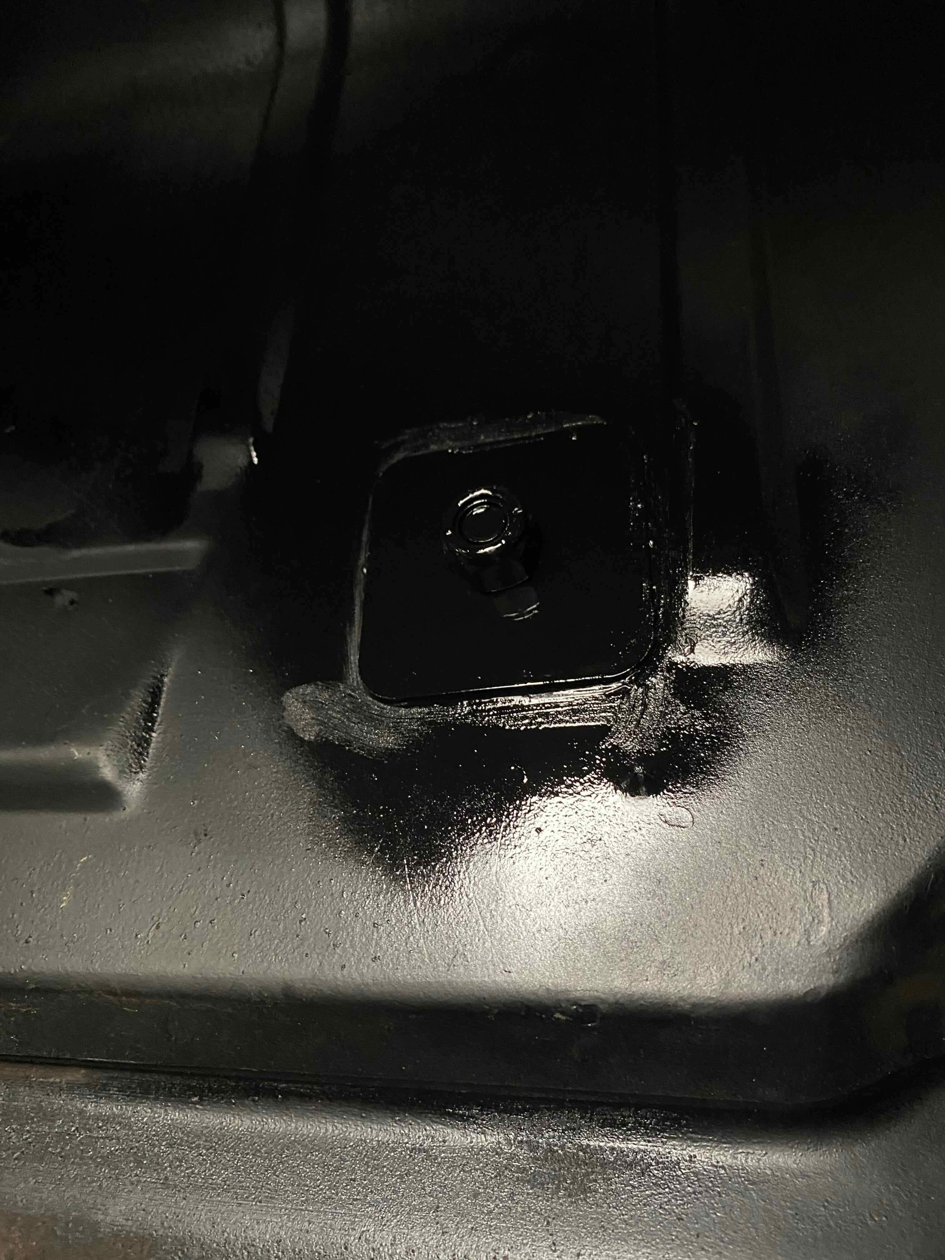

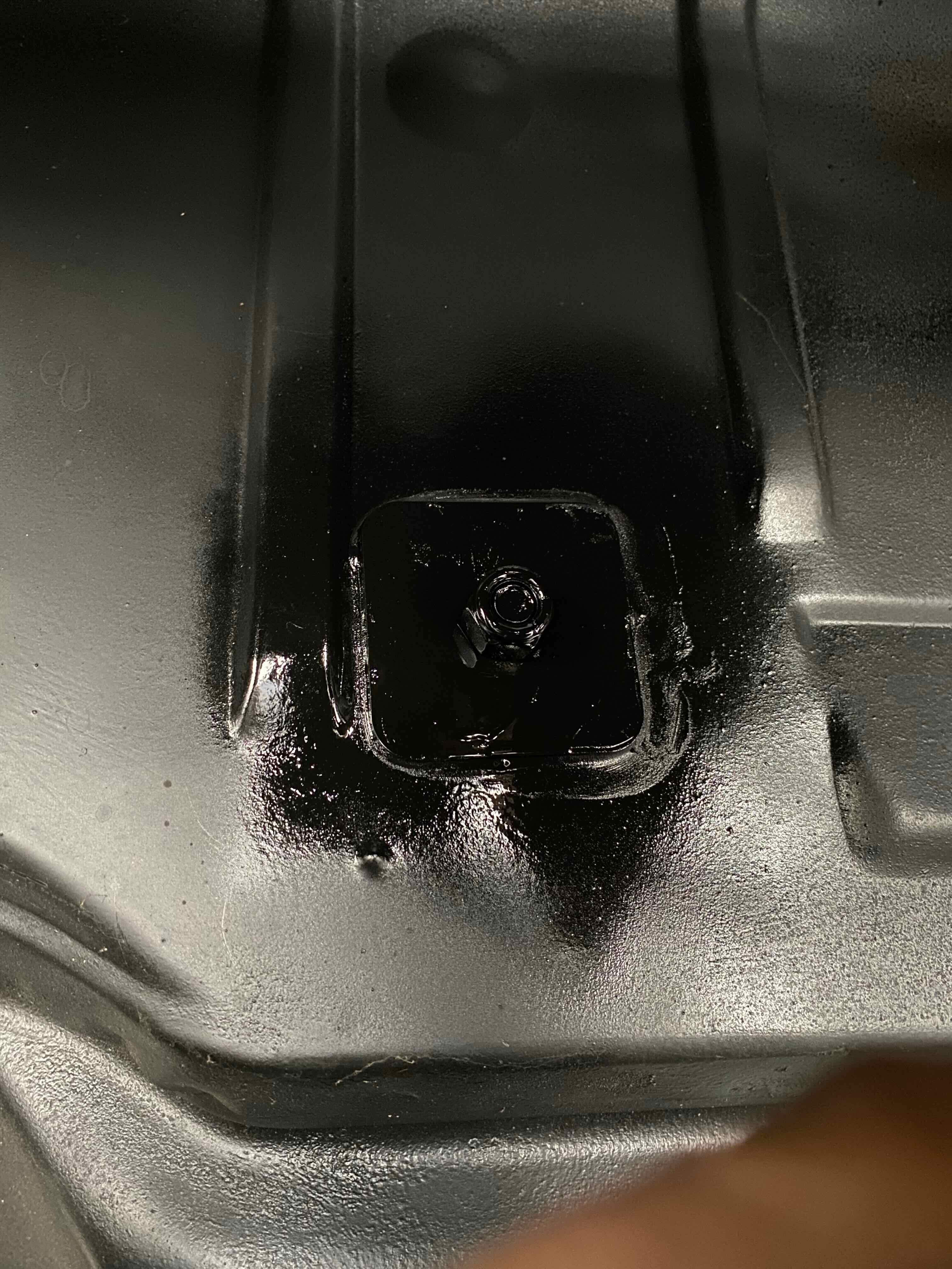

Finally tracked down a passenger side footwell vent for mine. My car was originally supplied with a/c, but at some point in its history a previous owner decided that removal was a better option than repair. All good, however they didn't bother to close up all the holes, so our first winter was a little chilly with ice-cold air blasting into the footwell via the completely open and unrestricted vent ducting. And to make matters worse, when I closed MY vent to reduce the cold air it effectively doubled the flow into the passenger footwell. A few early trips to car meets were completed with my wife wrapped up in a blanket 😆
Anyhow...after a 5 hour round trip to pick up the vent & cable, I spent another few hours cleaning, repairing and freeing up them up. It took a bit of mucking around making it fit because the one I got came from a '64 Impala so the cable length was different. Installed it, got my mate to cut a hole in the kick panel he'd made me to block off that great hole, and Bam 👊 - mission complete.
See photos...

Nice job on the kickpad N vent.  Is your entire heater core missing?  No heater or defroster?
Edited by JUSTA6
No mate, all that is intact.
It was just the wide open vent that was the issue. All good now😀

Oh, nice job on the fresh air vent. Mine work great - heaps of air, not like a modern car.
Yes mate,

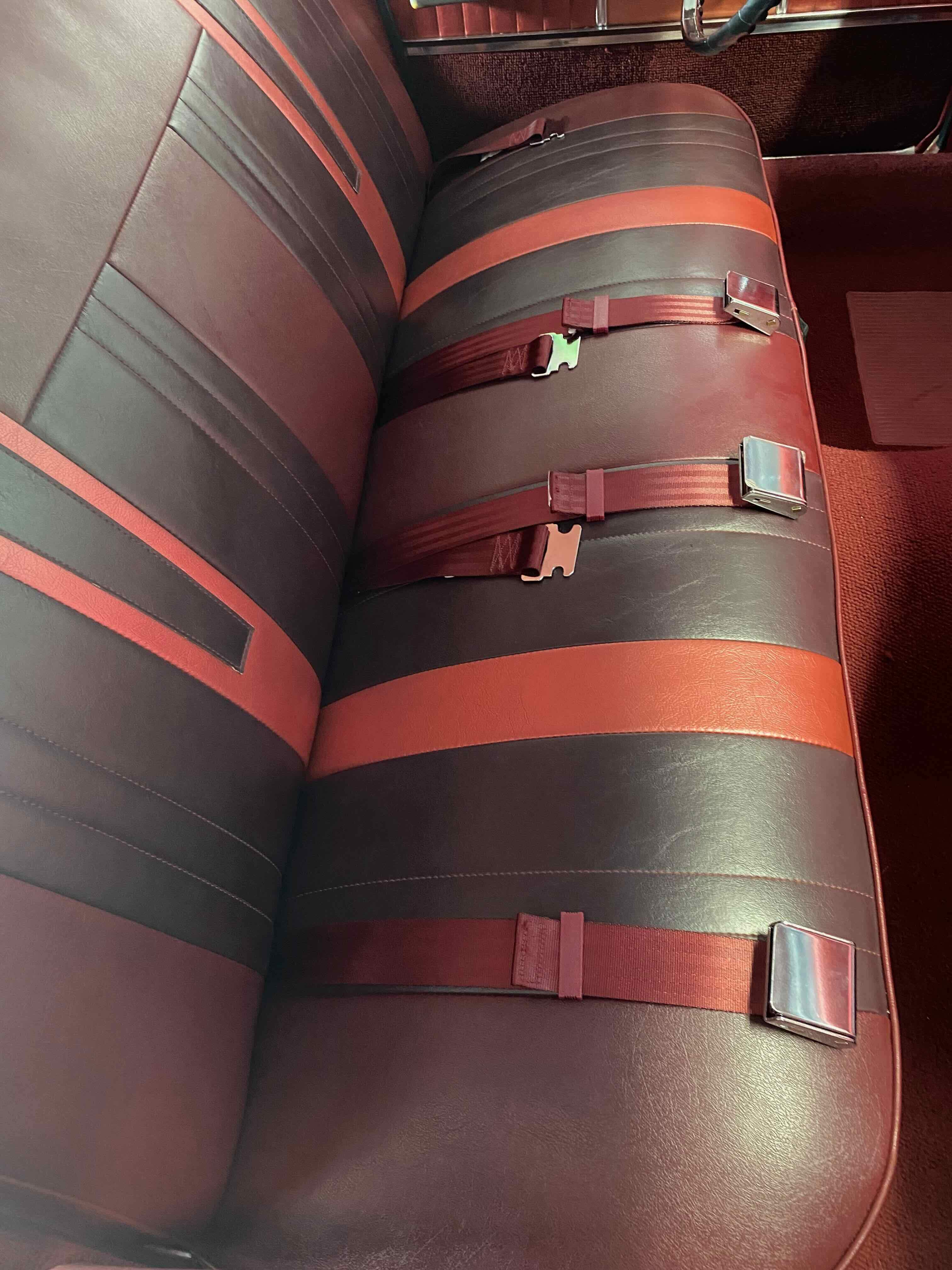

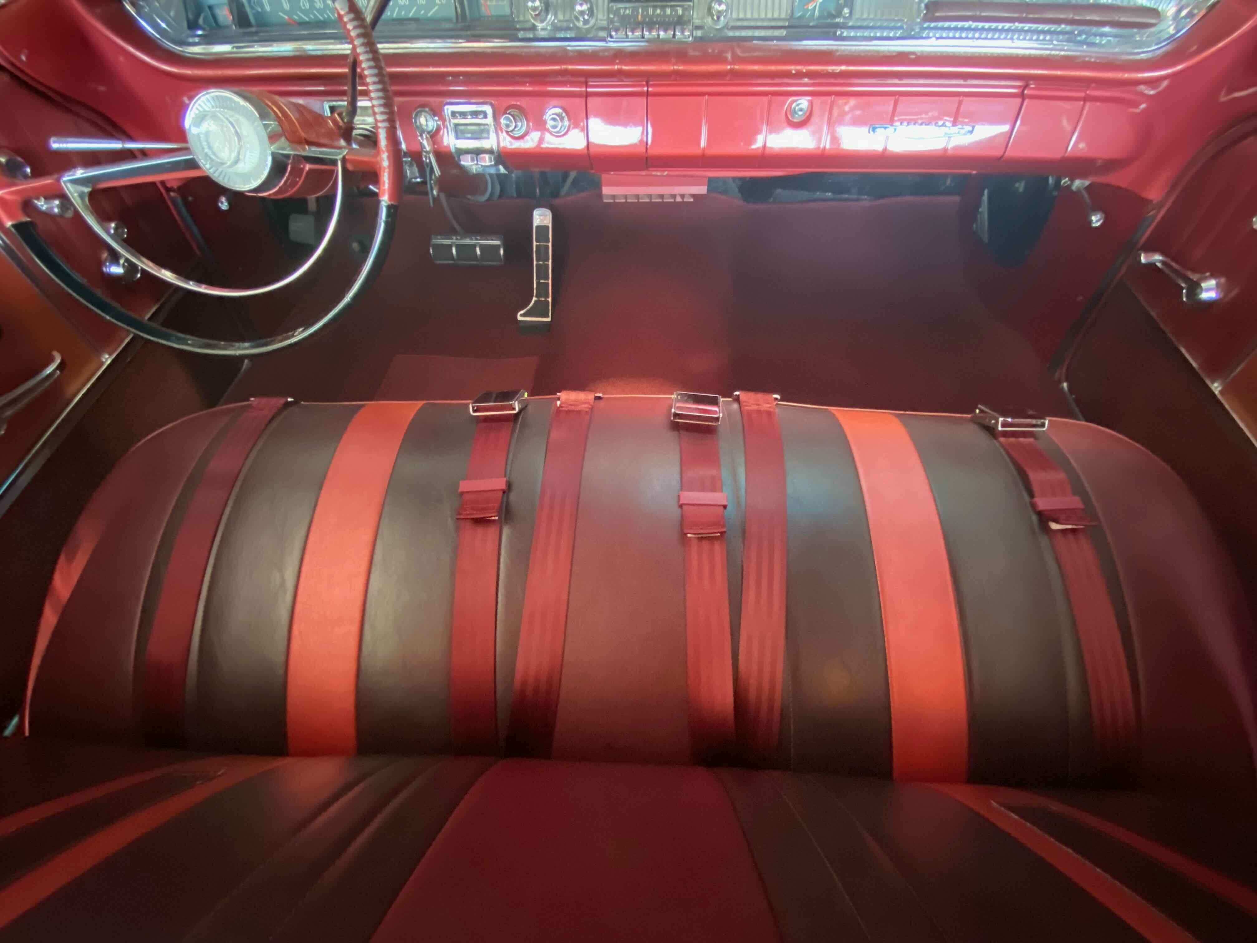

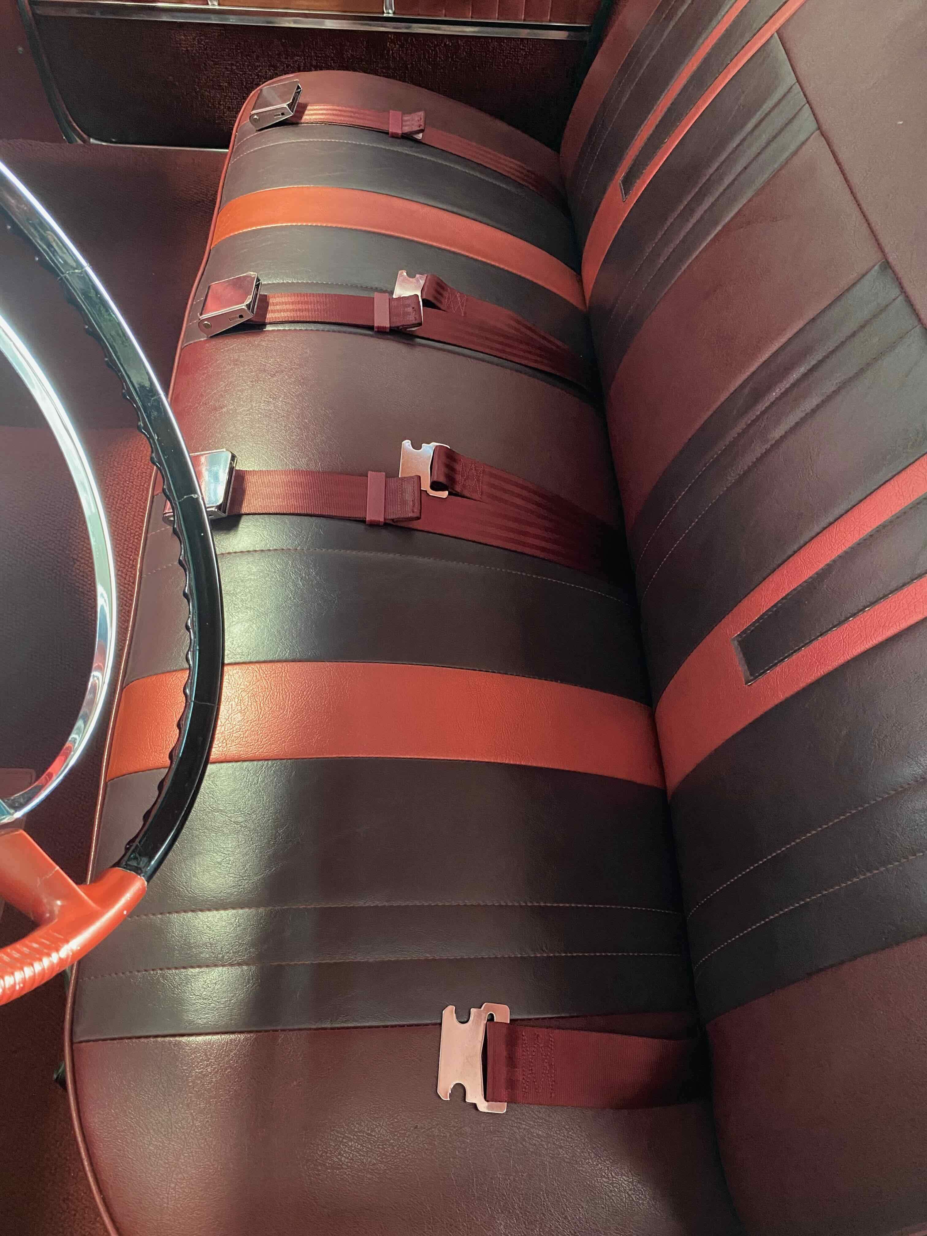

Now for something completely different...

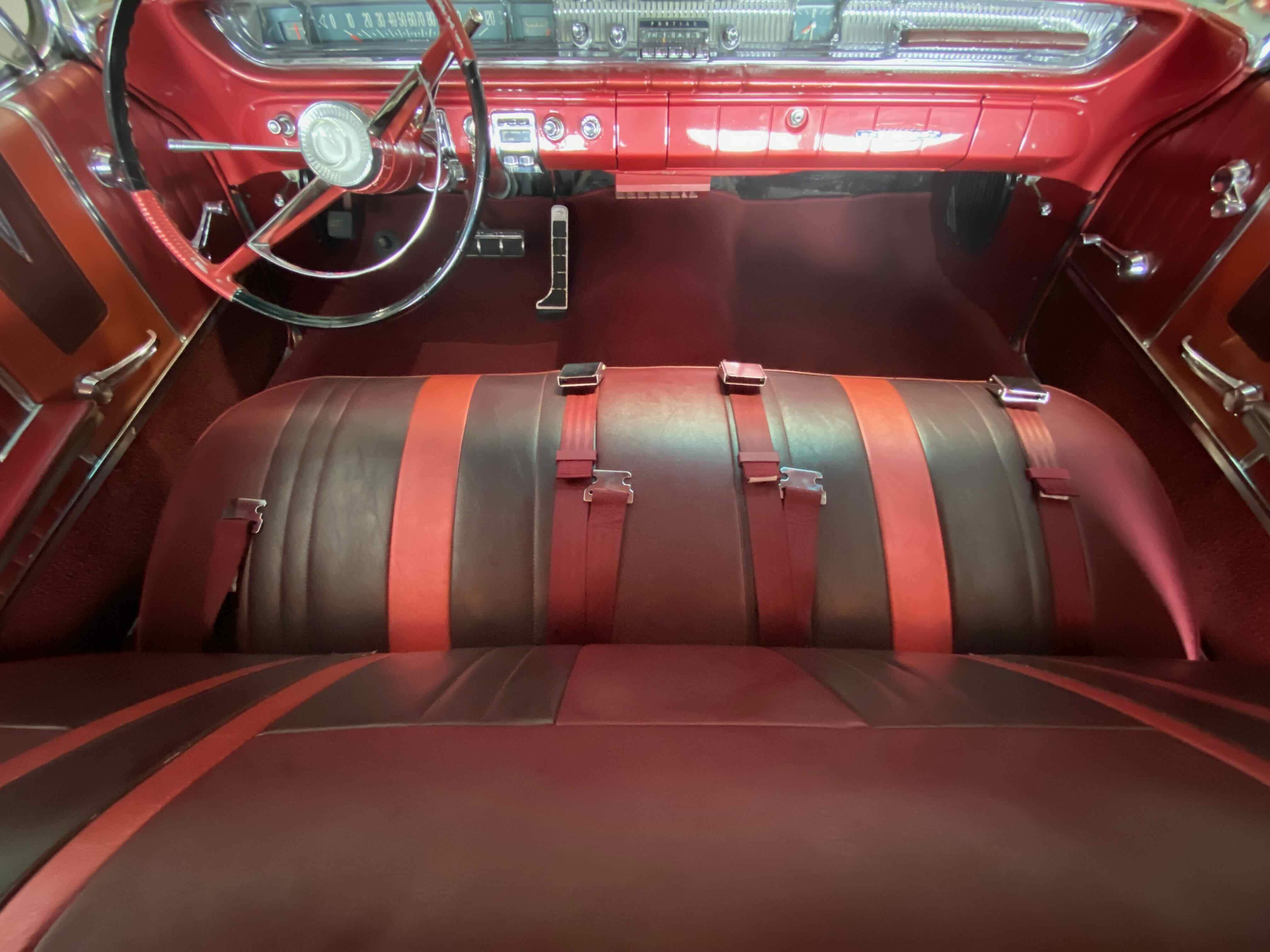

A while back I was chasing recommendations for seatbelt suppliers. I was tossing up whether I should buy Australian Complied belts, but in the end I didn't bother as I didn't want belts mucking up my beautiful pillar-free Ponti. And if I was only going to fit 2 point belts, it was a wasted argument because even though the belts themselves would be compliant, fitting them into the outboard seats of my car was NOT🤷‍♂️
Ergo, I went 2 point belts with Aircraft style stainless buckles, that actually look like they came with the car. (Mind you, I'd have rather not had any in it at all, but my gorgeous passenger insisted 😆)
Ended up finding what I needed at Morris Classic Concepts in the US. Sarah (Morris) was very helpful, pricing was really good, and manufacturing and delivery happened in a very reasonable time frame. She assured me that whilst the belts obviously wouldn't comply with our ADR's (we have to have black plastic buckles with red release buttons), they did meet all necessary US Compliance Regulations, and that they had sold thousands of sets with no issues.
The finish and quality is excellent, and she spent a bit time with me going back and forth getting the colour match right.

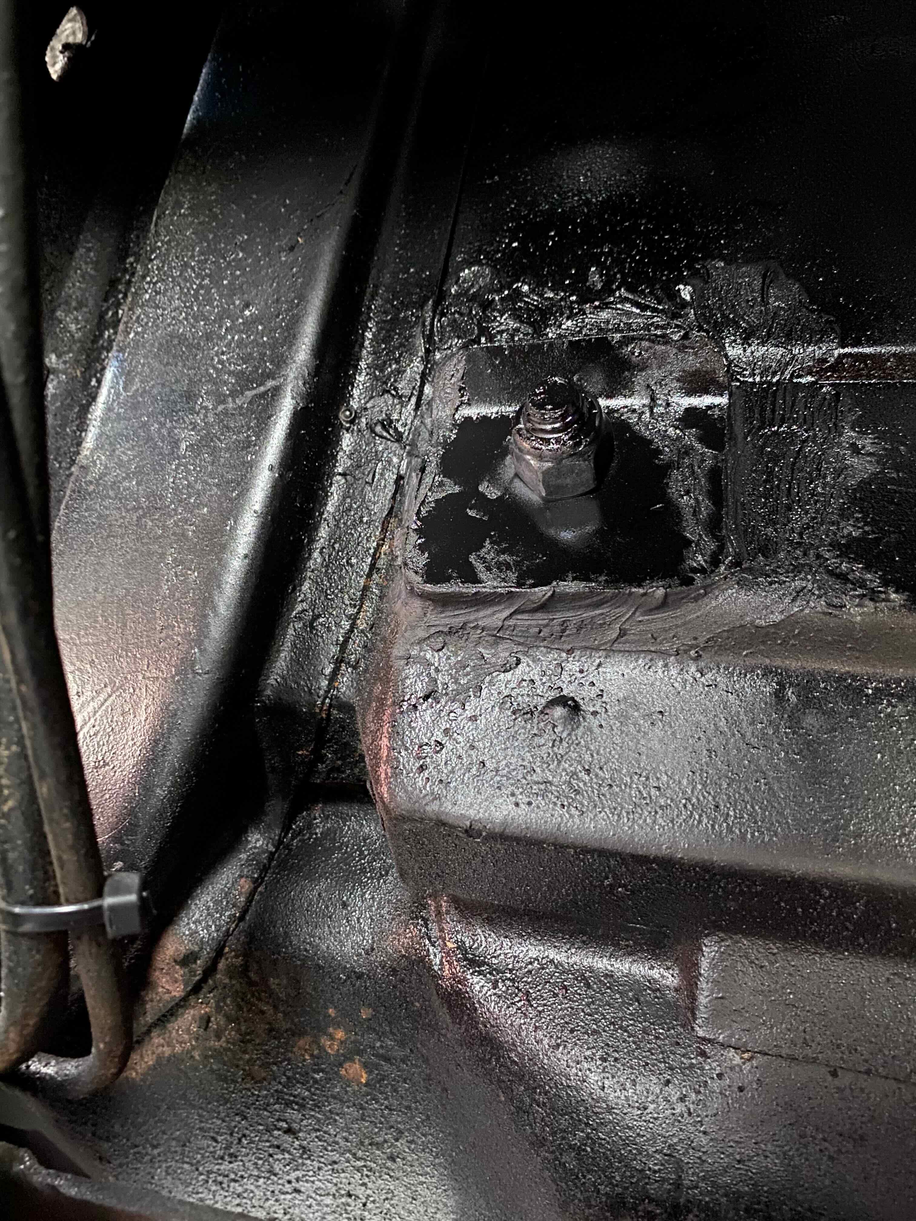

I've spent the last 2 days (had to carry the job over into Day 2, as the swear jar filled up pretty quickly 🤬) installing the front belts. Just about broke all of my fingers at the knuckles trying to "guide" the things through the seat frame, but in the end it all looks good. Installation was completed to Australian Standard as far as prescribed angles, distances and anchor points.
Once I get over the trauma I'll complete the job and install the rears, at which time I'll post those results also😊
Looks Great !!👏

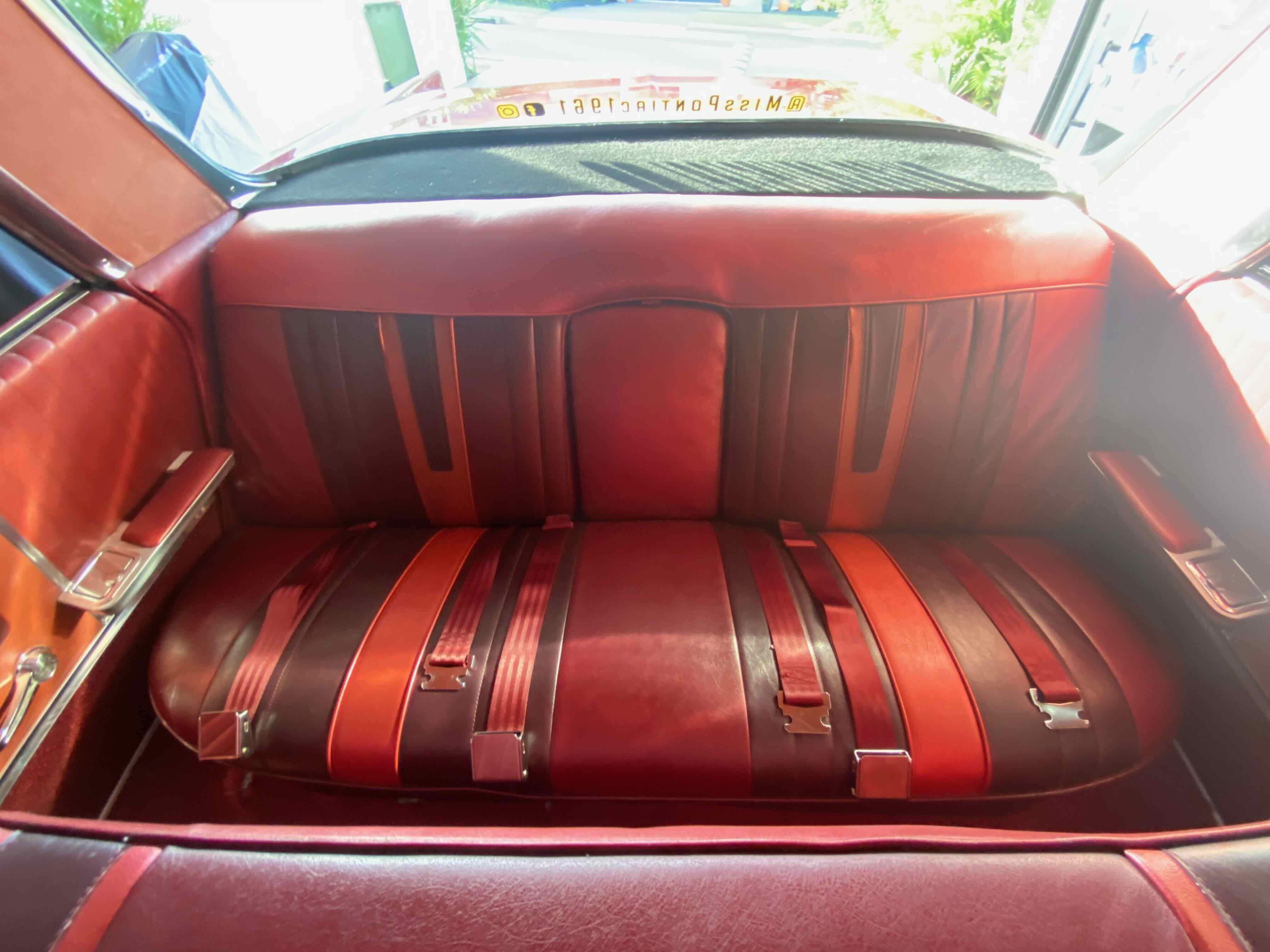

Well, well - all done!
The rears were a lot easier, although I had some issues with the length (happens sometimes, I'm told🤷‍♂️).
I'd been advised I would need 60" for the front and 74" for the rear, but this turned out to be incorrect.
After checking around Australia to find someone who could shorten the 74"'s up for me, my wife had an epiphany...why not mix the sets around, see how they work? So, a bit of time and sweat later I had the fronts with 60" buckles and 74" tails, and the rears with 74" buckles and 60" tails. And, that works! Perfectly. All belt buckles sit between the body centreline and the right hip, depending upon occupant size (we're both pretty compact so for us they sit to the right hip. More "normal people (fat bastards, I say😆) they sit more centred. Photos attached.
She's not only good looking, but clever too 🥰

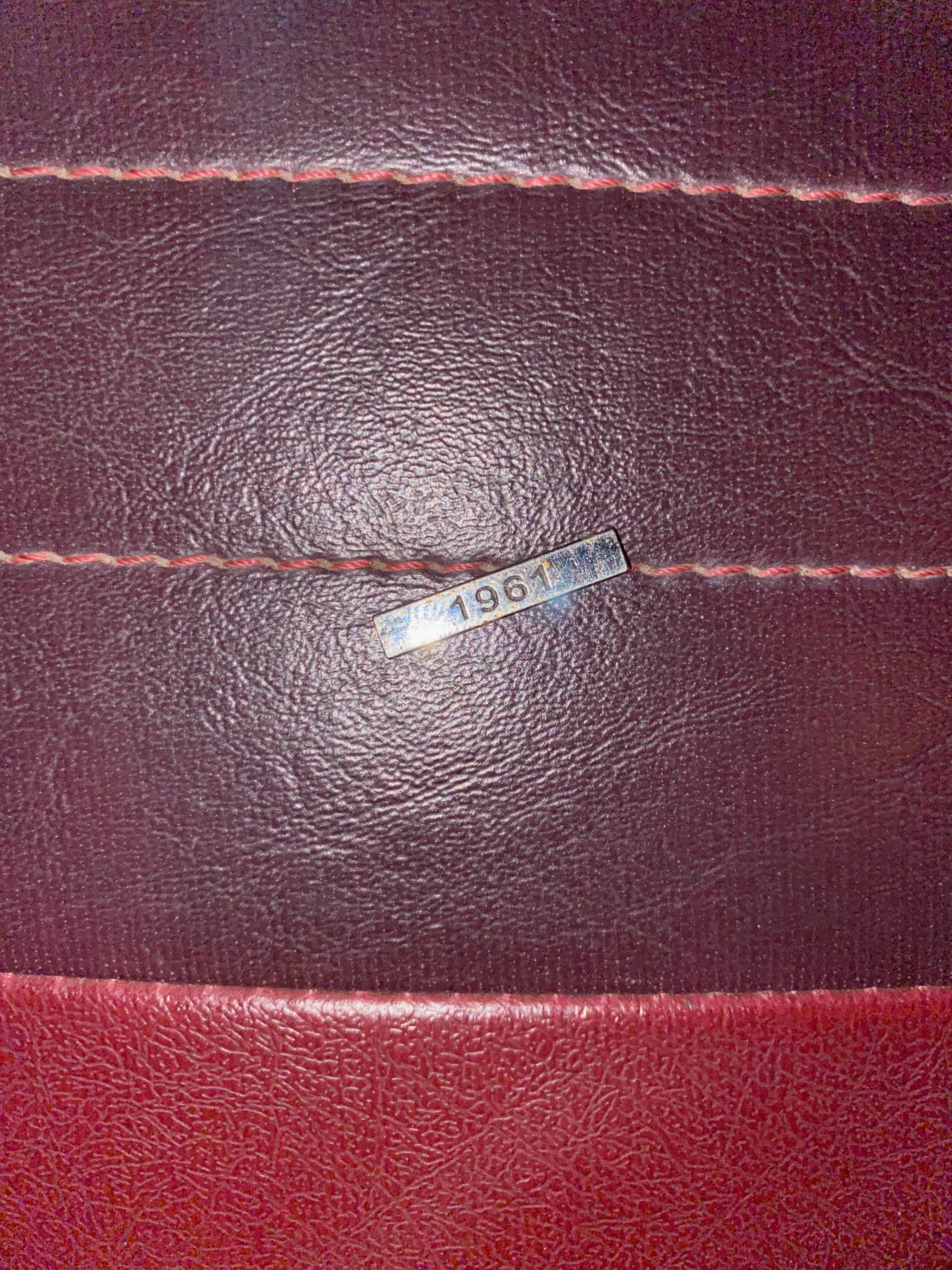

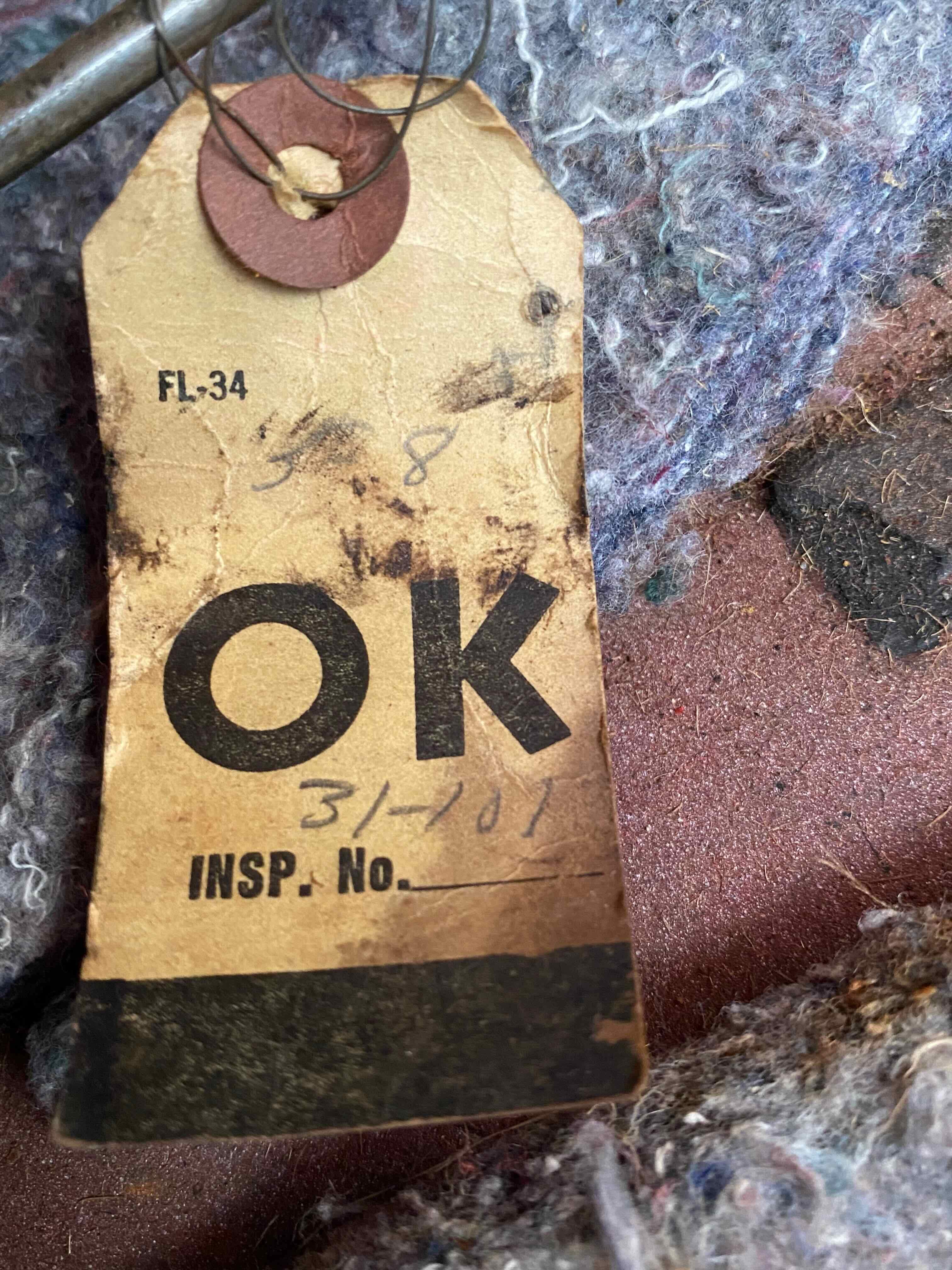

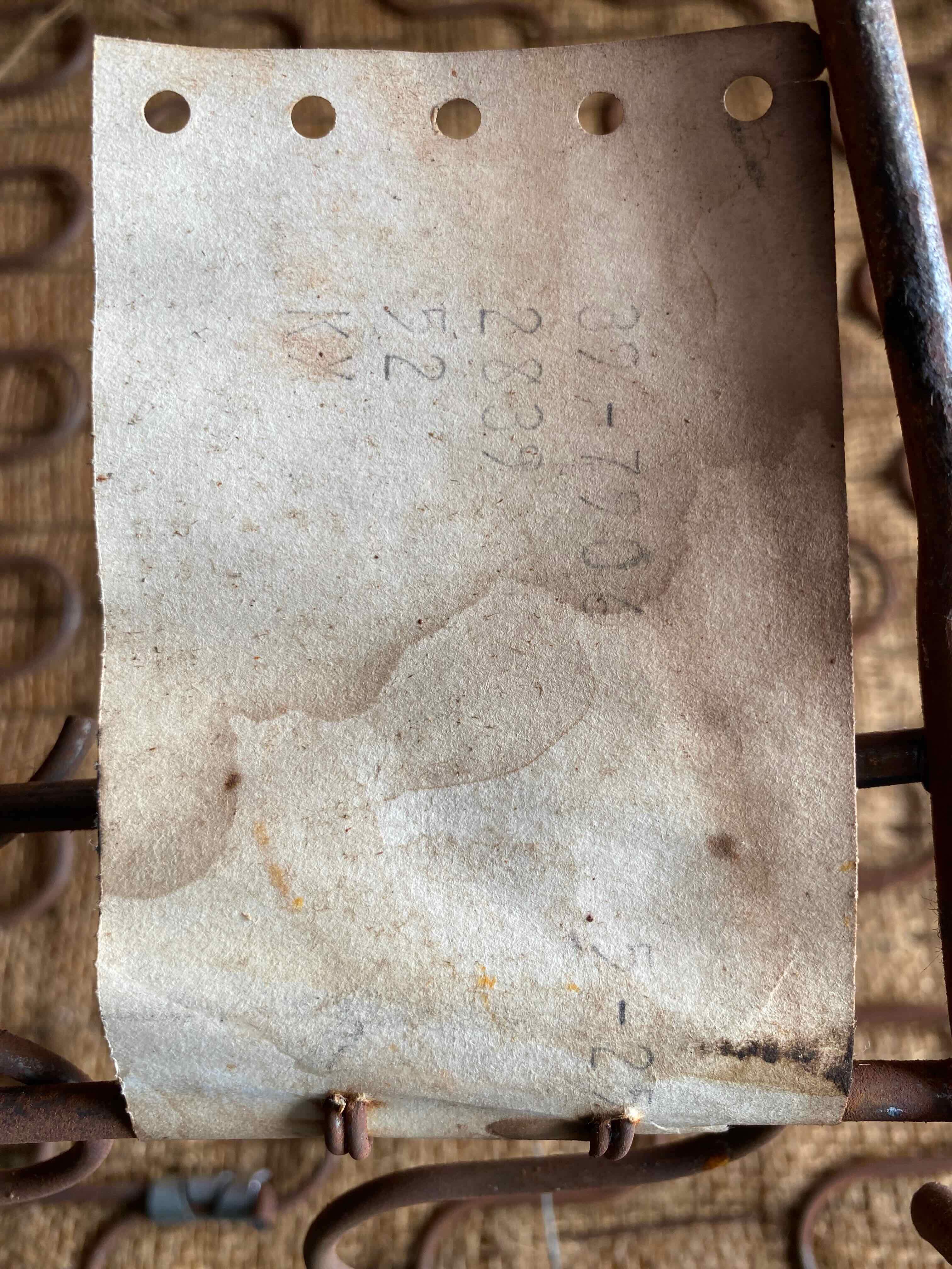

Oh, I found these OEM tags under the seat too, while I was working away. Cool, hey?

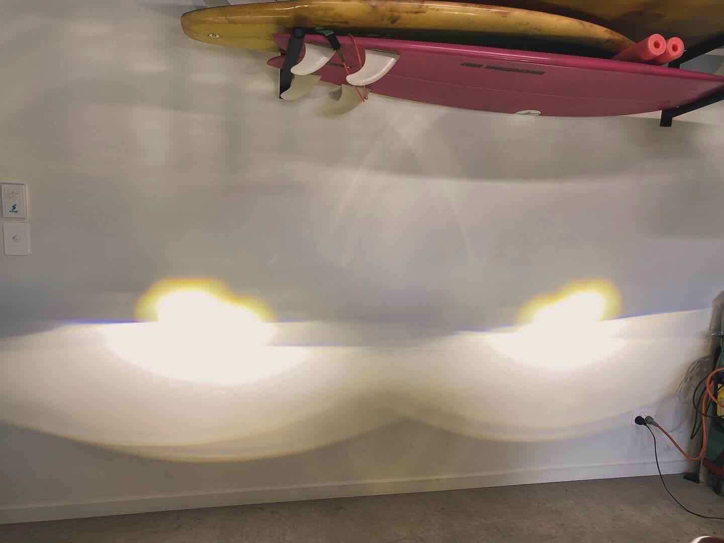

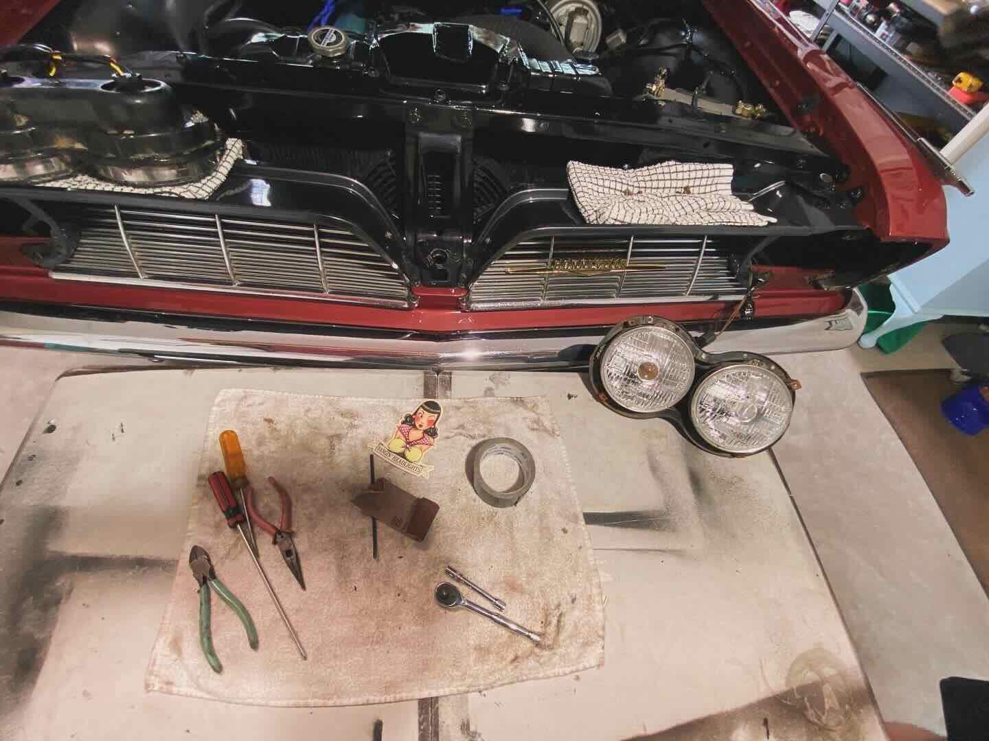

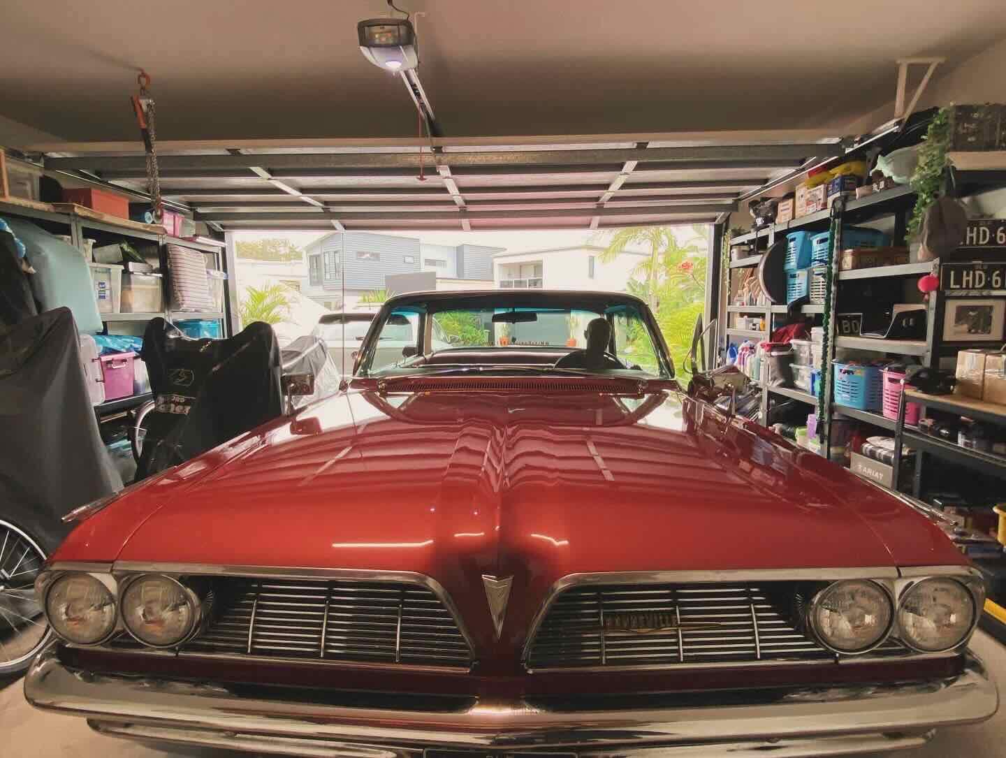

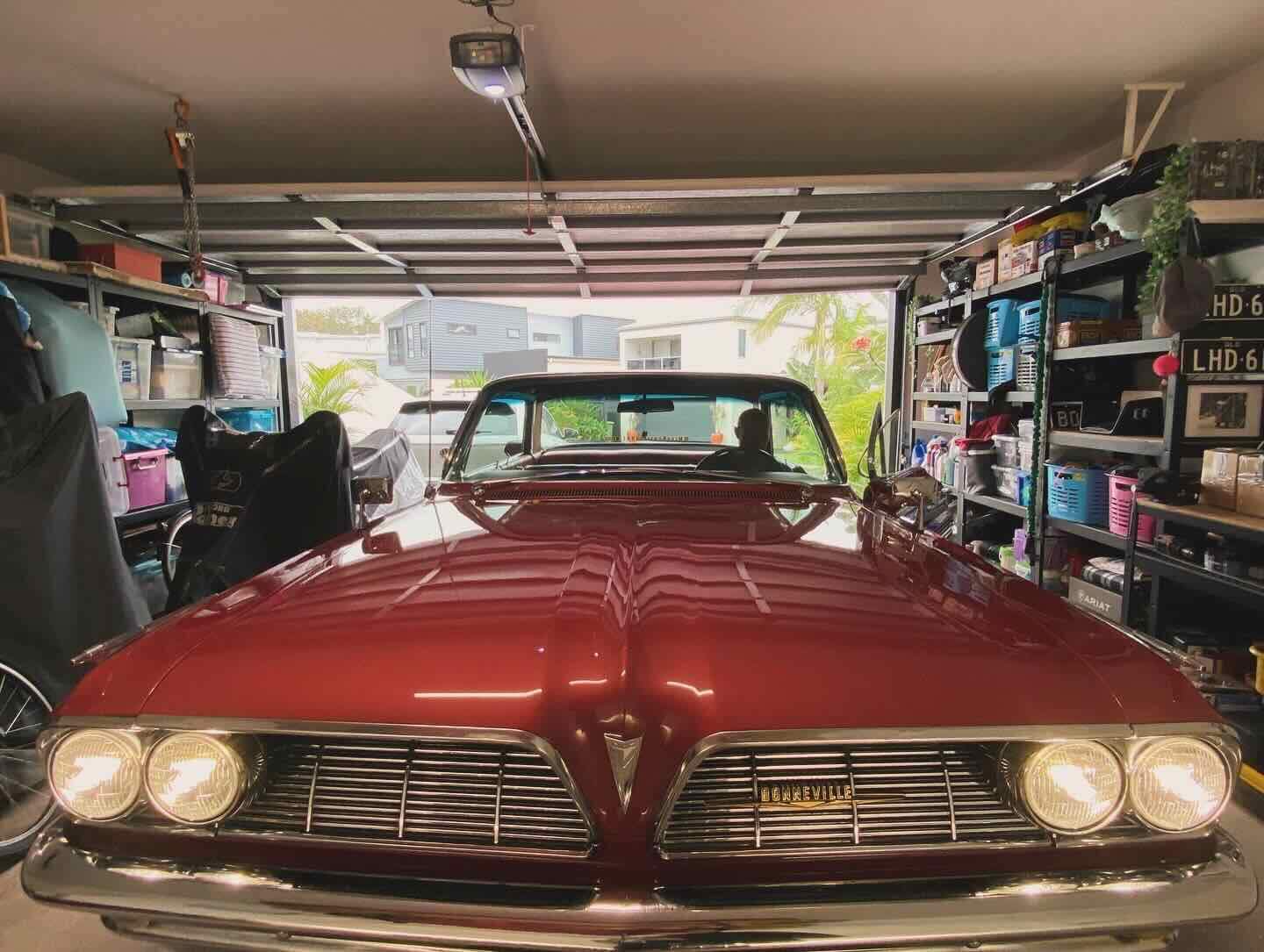

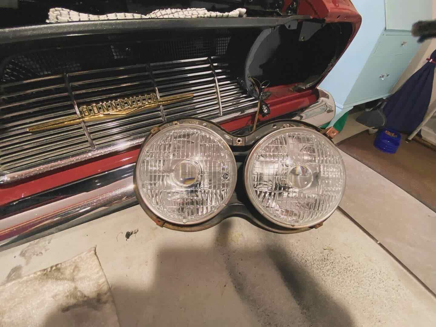

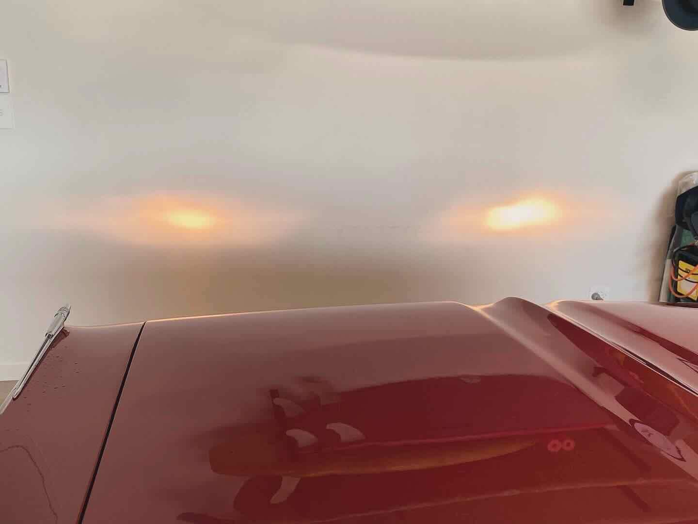

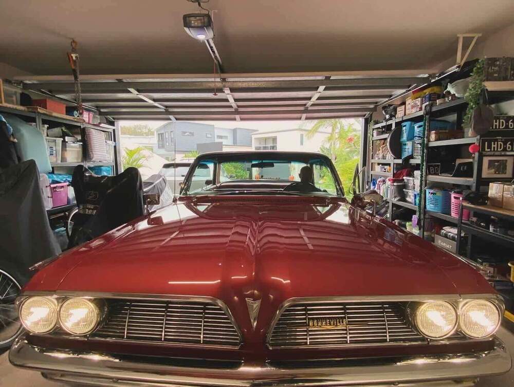

As some of you may remember I had some Bangin' Headlights on pre-order?
I think I mentioned earlier, they're led but at 4300k emit a warm white light that emulates the original sealed beams.

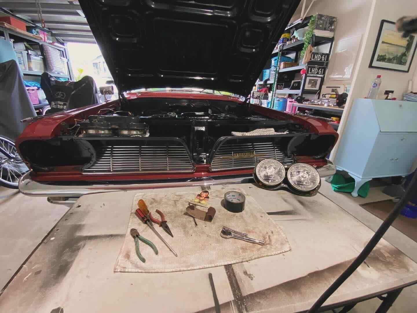

They arrived, so what else to do but install them?
First up, they are a quality product. Australian made (company based in WA), glass lenses, Aus-complied, an EXACT replacement fit for the OEM halogens. Took all of an hour to fit, including improvements to one of the earths, and terminating the high beam plug and leads that are now redundant.

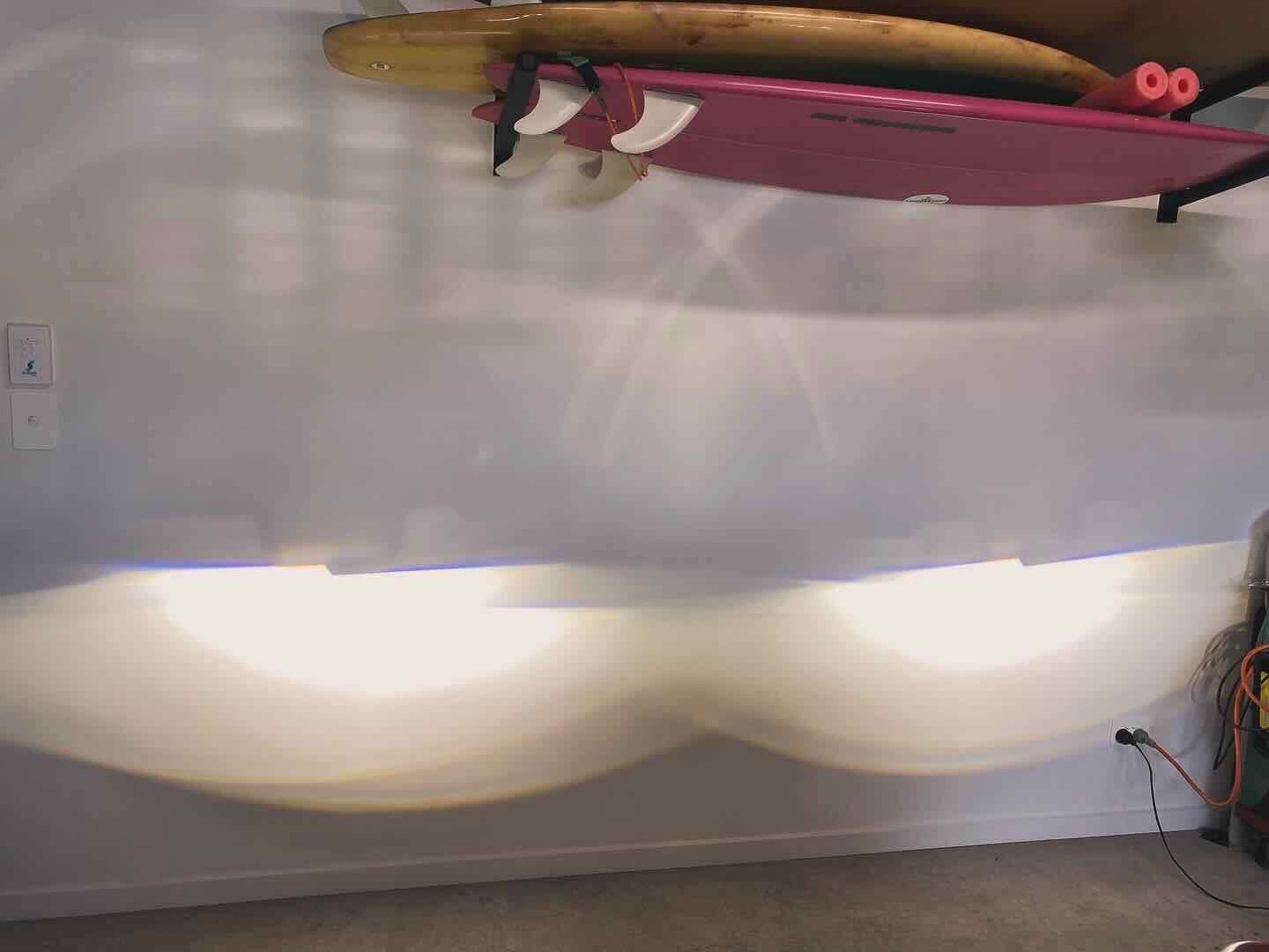

I fitted them with the supplied H4 Splitters, which allow you to run all 4 lights on both low and high beam. As you'll see from the photos that's not needed for lighting power itself, but sure looks cool 😎
Did a short night run to test them - clearly I need to adjust them somewhat, as the CAA have already been in touch stating that I'm making it difficult for pilots on their landing approach 🤷‍♂️ National Parks also reckon I'm mucking up the bats sleeping patterns too
 The difference is absolutely outstanding, I'm sure you'll agree. And at around AUD$150 per light ($560 the set, splitters being optional), IMO they are excellent value. Rated for 8,000 hours, the globes are also replaceable.

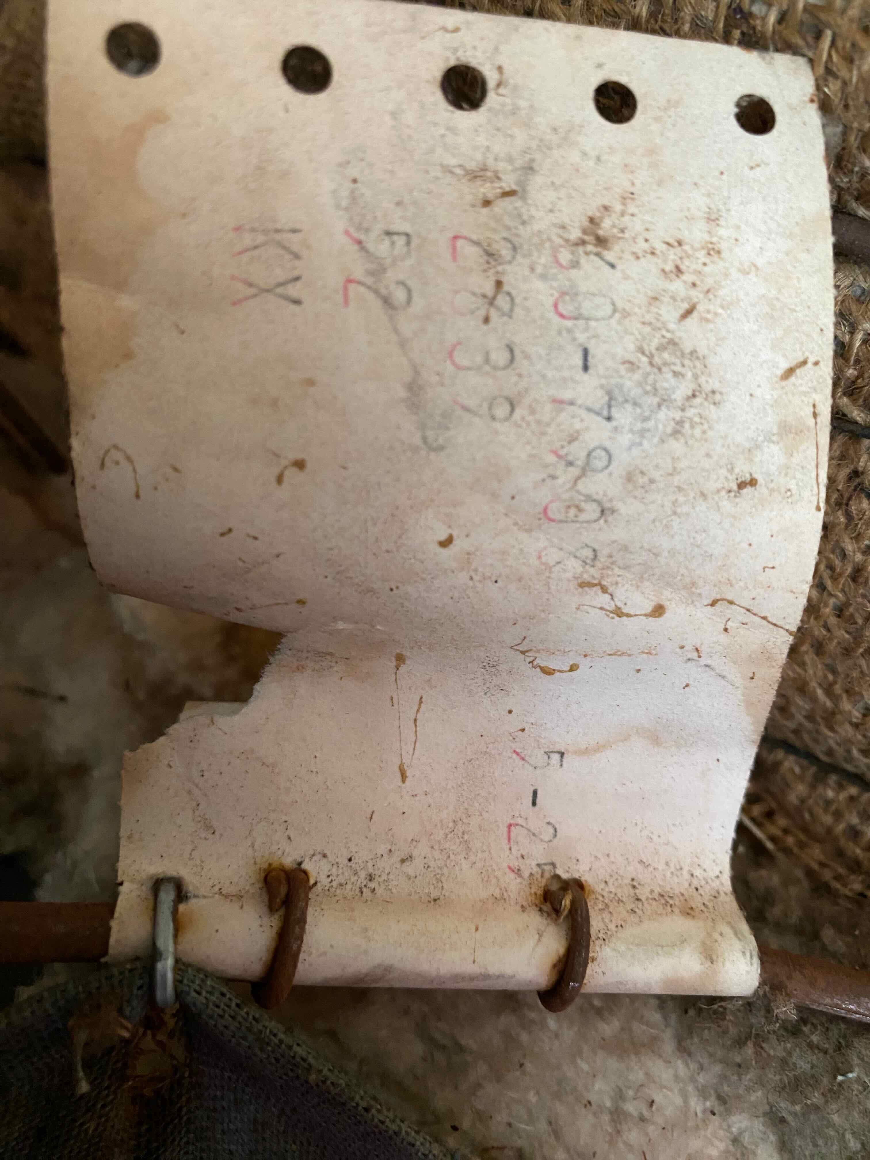

I also found an original tag stuffed inside my rear seat. It listed a number of option codes, so it was obviously something to do with that car's particular build. Frosty was good enough to decode it for me and when I checked the car's option codes on it's ID plate, they concurred. This was back when humans built cars and they had to write things down. In contrast, I think a new VW Golf rolls out the door every 36 seconds or something.
