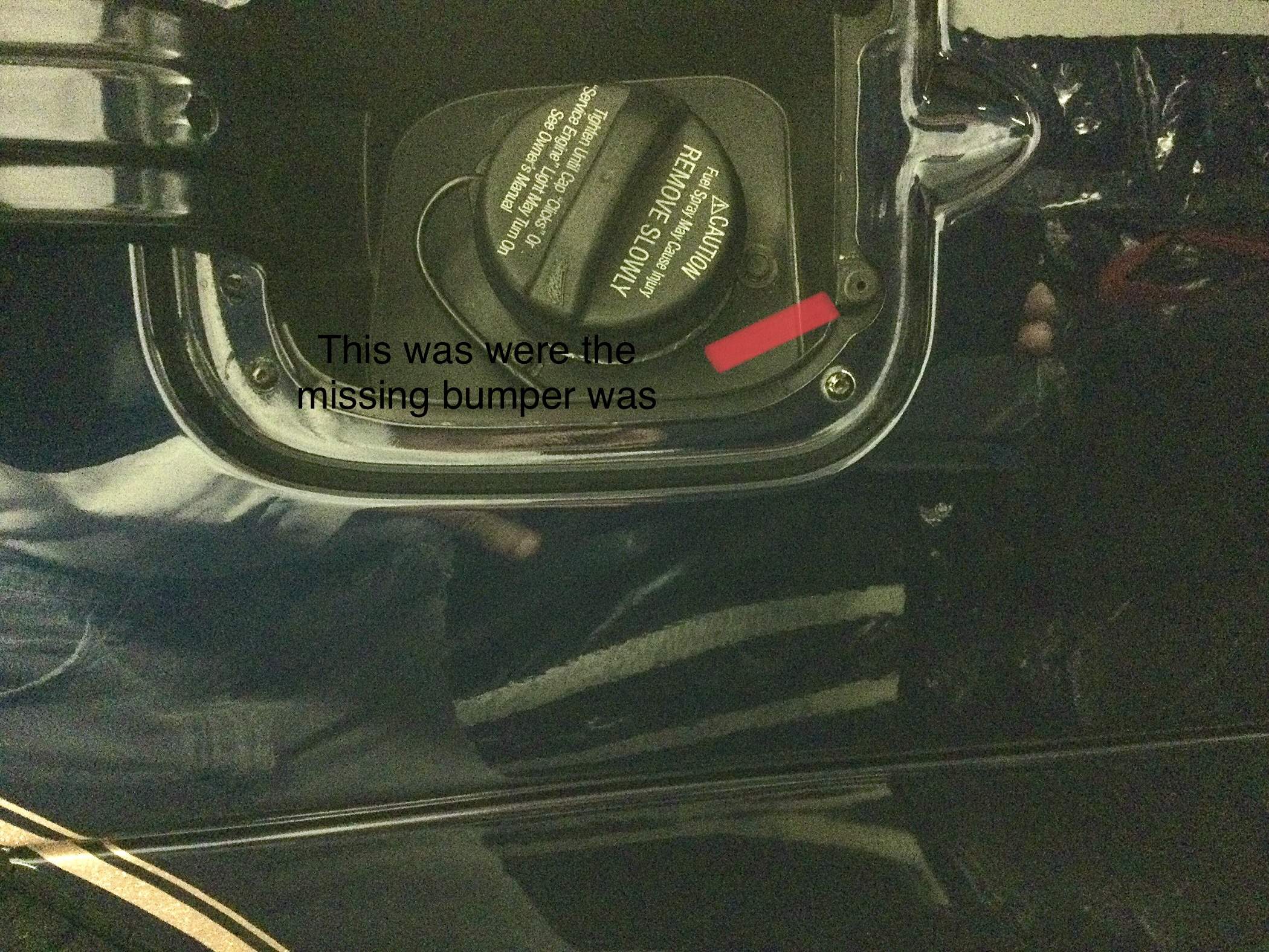

Well get to join this club today too! The two years the Indian has been making this noise on hard right turns. Several years ago I found a 20 mm rear sway bar. Its configuration is actually for an Impala, so it doesn’t have all the bends the Grand Prix bar has. This presented finite placement to avoid contact in certain areas. This made me believe the was due to that, but last year I was sure the clearance was good but the noise got worse. This year when I bought the new solid 25mm bar I thought it might fix the problem.
Now anyone who has followed the Indian build should understand this a stout car with a suspension that will compete with some of the good sports cars. It’s not a harsh suspension, but it takes some serious speed on a hard 90 degree corner to make it lean. And this new 25mm bar just made it better, but now the noise has gone to a new level. Now this noise has always sounded pretty much like car exhaust rumble, but I had inspected over & over again & could never find anything!
Well today I found the problem! Would you believe a rubber bumper on the gas tank door!! There are two of them one top one bottom. Because the bottom one is missing, the door being on the left hand side of the car. On hard right corners the lateral G force is so great it causes the door to vibrate drastically at the bottom missing bumper! Unreal!
Have no idea how ya figured out that one.  But it is always good to practice safe sex and always check your rubbers. :naughty:
Even a squirrel finds a nut once in a while! I been looking for this noise for two years! JustA stupid dumb luck! I knew the basic area it sounded like it was coming from. There was nothing else left except to tear my back door panel off & see if it was coming from inside the door. So I open up the gas door, as I’ve done before. Stand there looking at it look a moron. But this time I let the door go on it’s own instead of closing it softly by holding it. When I did that I saw it vibrate a little. So I opened it back up & started looking, that’s when I saw the missing bumper. Fortunately I had a spare so I put it in. Took it out, no noise! :bowdown:Thank the lord!
Some way, some how, it’s these small victories that seem the most satisfying!
