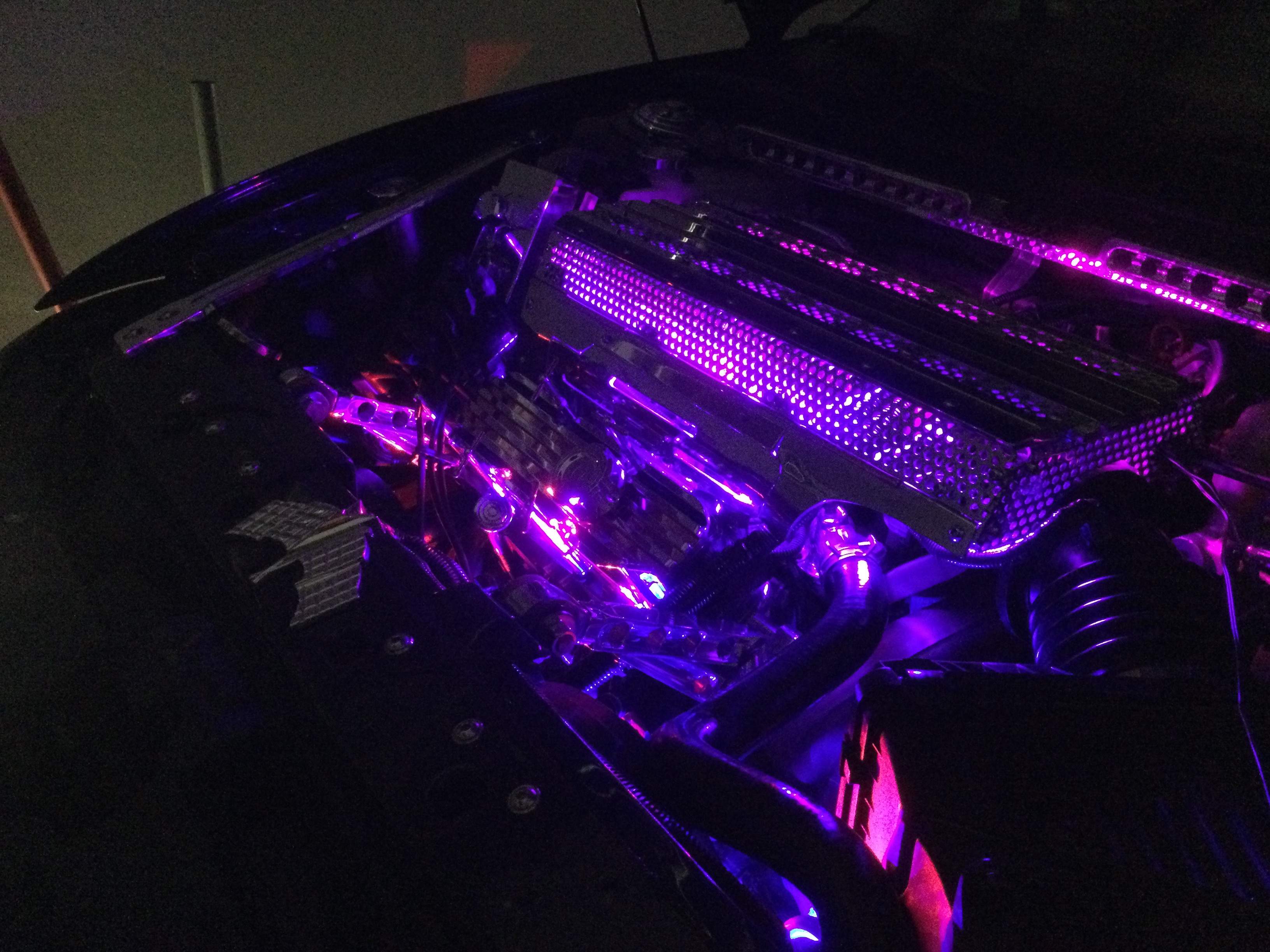

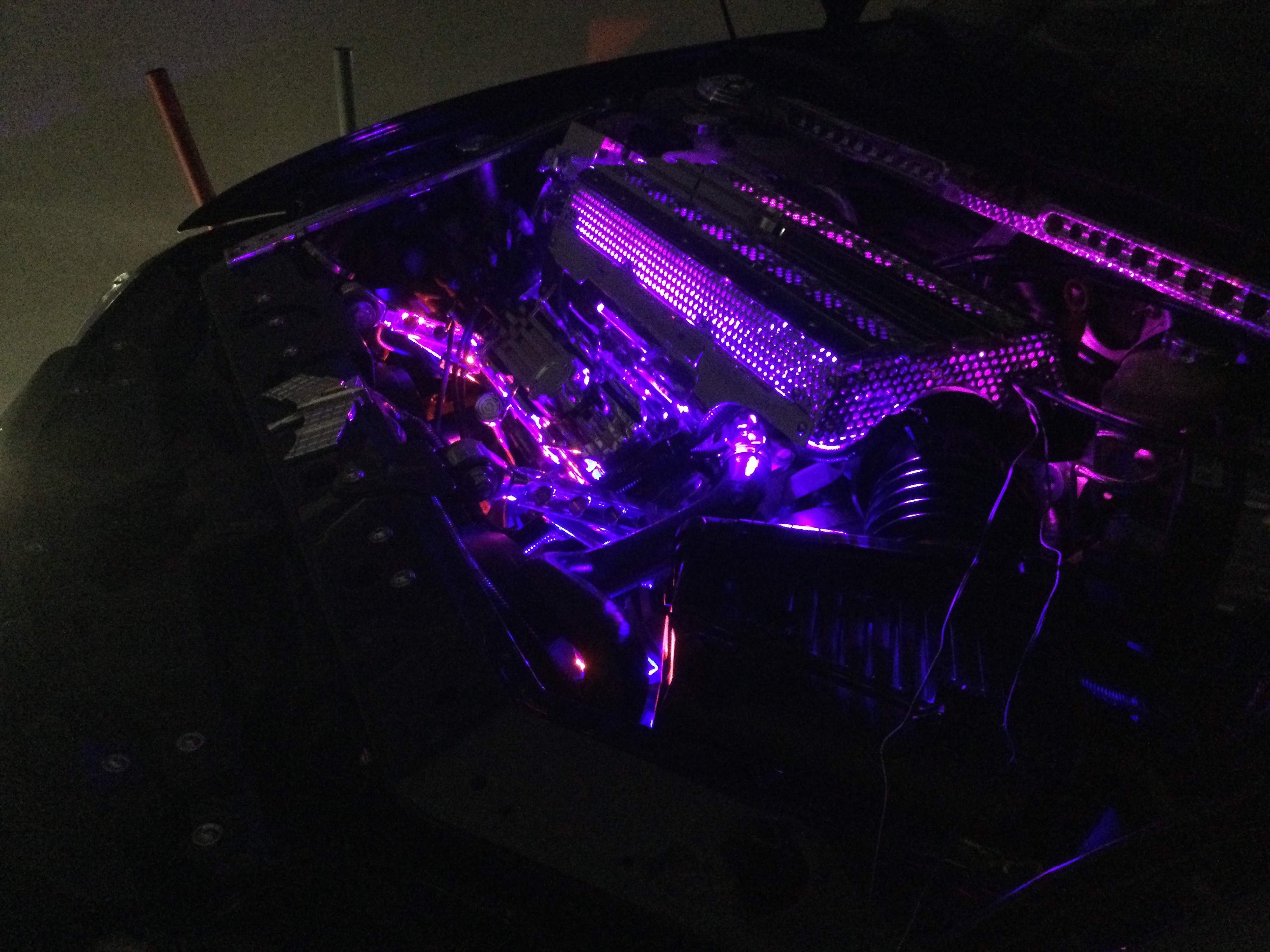

JustA playin around! Thought I’d see what night lighting the engine bay might look like.
If the rats at my place even LOOK at my expensive new MSD spark plug wires, they will die.
Pretty sure the JAP crowd, teenagers & pimps should love it 😅
