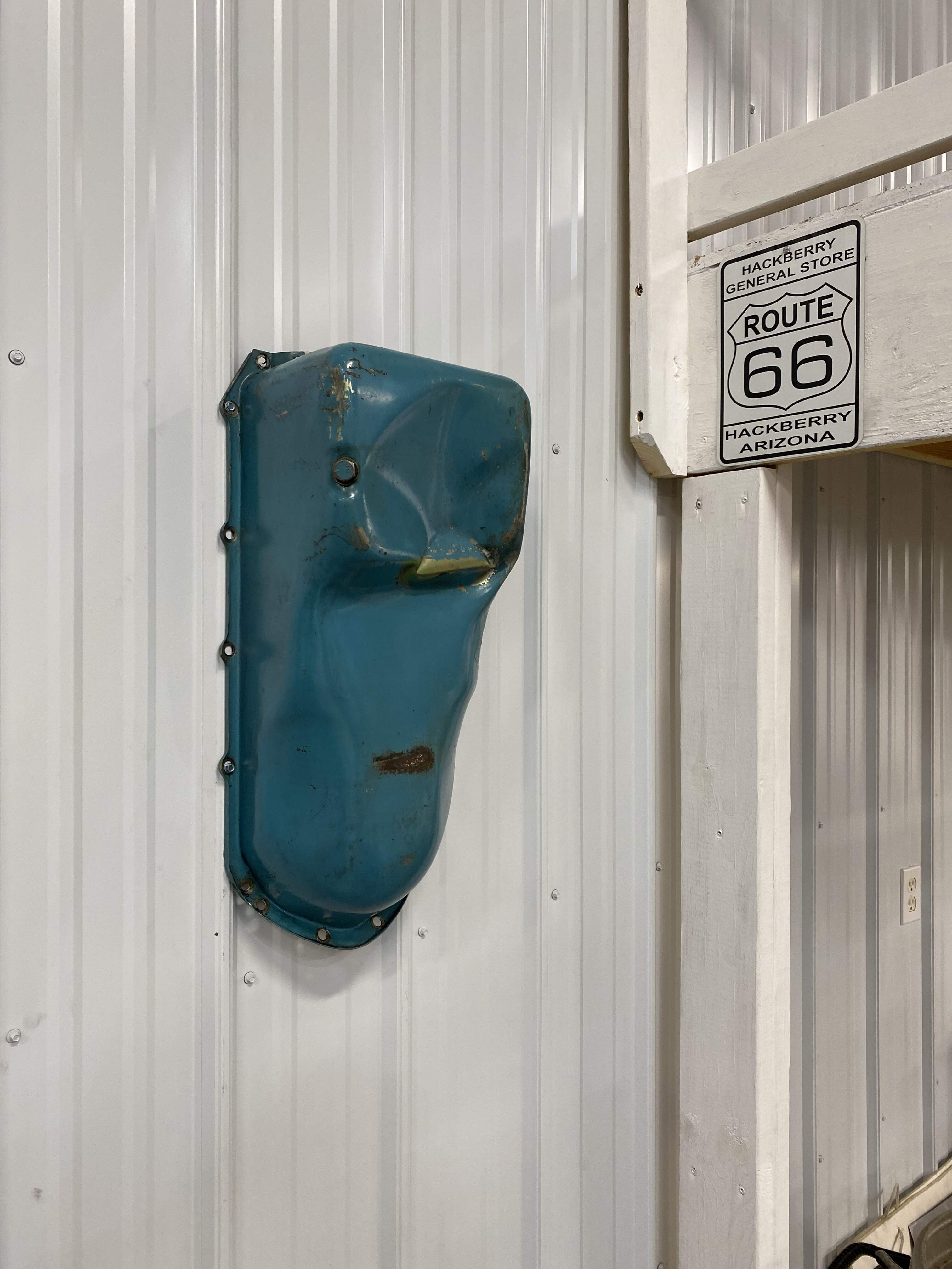

I mounted Lucy’s old oil pan onto the wall of a shame today. I scraped the old gasket off and wiped it down with brake creamer. IMG_0452.thumb.jpeg.4768157815bf35596737c0e291b7fcc7.jpeg

Awwwww nice wall art :cheers:
Now that I think about it, that is the third oil pan since I’ve had in Lucy. The first pan died in 2004 when  two windows, on either side of the crank, opened up. #8 connecting rod split into three pieces! Scored up the bore too. Oil pan #2 is now on the wall. #3 is under Lucy.
Third times the charm snowman. :D

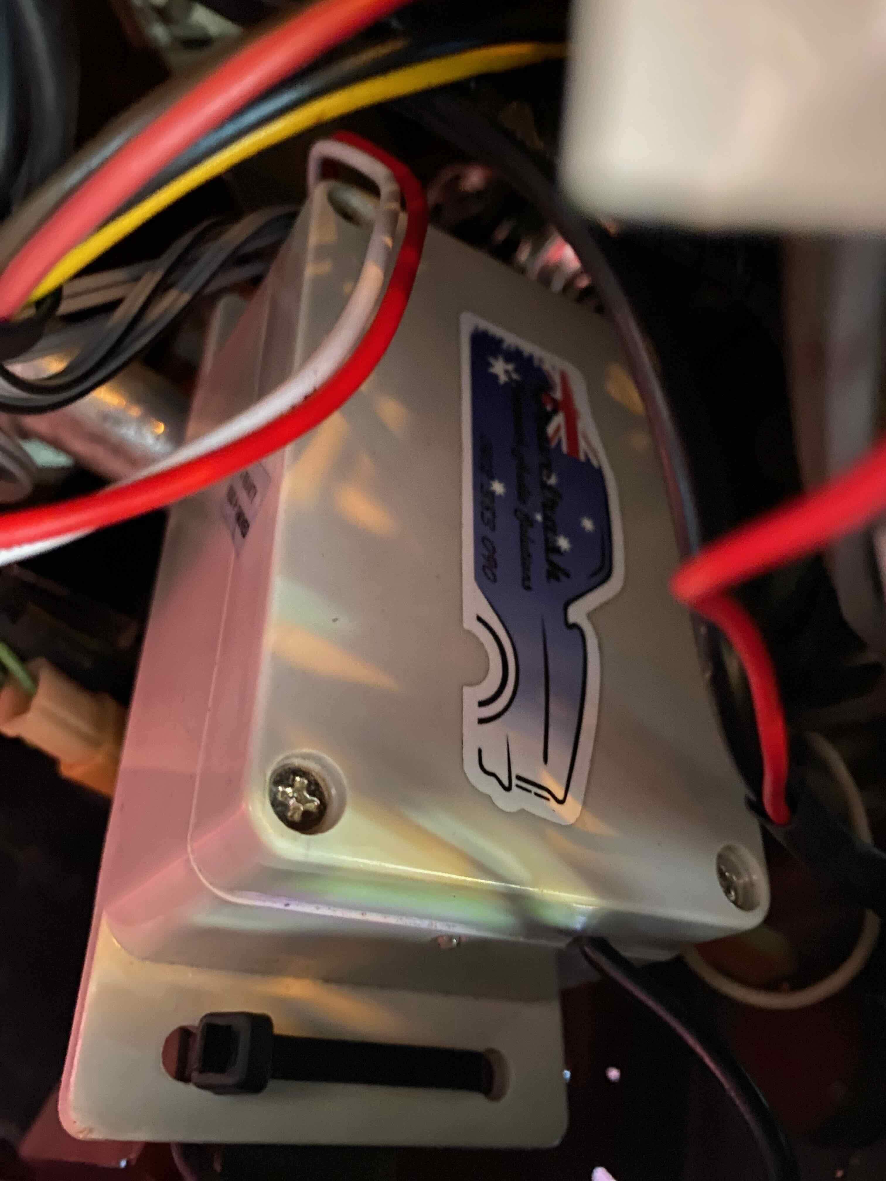

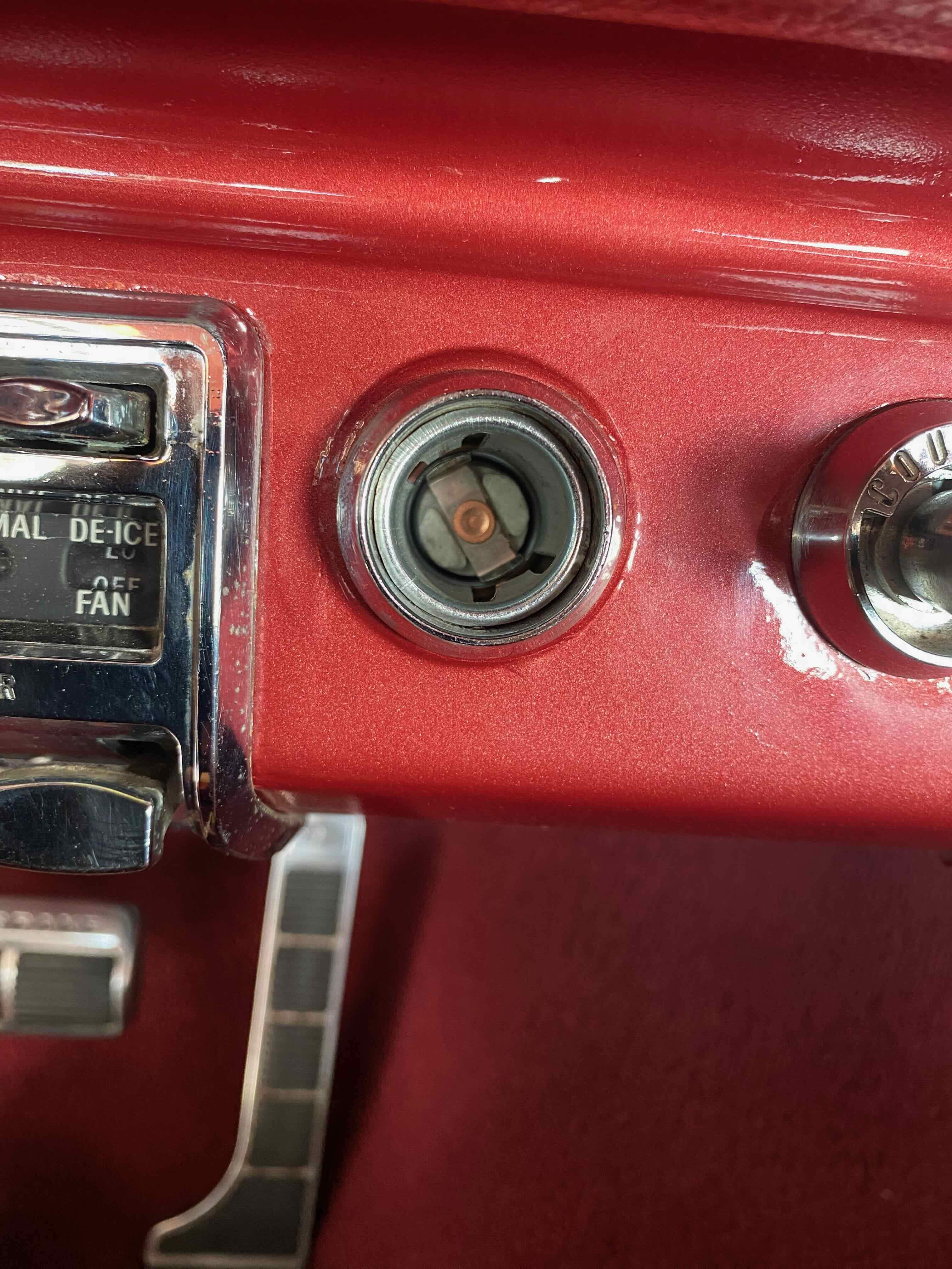

The Bluetooth gear has arrived, and the work has begun.
Pretty easy fitting the switch into my original cigarette lighter (just had to grind the edge of the new switch so it seated fully in the chrome surround), and the module was easy too.
The speaker pod was another story...the holes in the mounting plate weren't correctly spaced, so I had to elongate them. Problem was, the outer rivets that held the speakers to the plate were in the way. No prob's I thought, I'll just mount straight through the speaker brackets as well and all will be sweet.
No such luck - the thin metal tabs broke away, which meant the unit was solid in the dash, but the outside edges of the speakers weren't fixed at all🤦‍♂️
After hours of drilling, filing, and Circus-like contortionism up under the dash all I've achieved is the removal of lots of skin from my head, shoulders and hands, with the now useless speaker pod sitting back on the bench where it started out🤬
Anyhoo, the system itself works well so I'm on the lookout for a reasonable quality 10"x4" speaker to fit and all will be good.

Ok, so the new 10"x4" speaker from I ordered from Retrosound arrived today 👏
Pulled the glovebox liner back out, crawled back up under the dash, and (other than some minor "relieving" of the mounting holes) fitted the new speaker, wired it up.
Boom - the system works. Push in cigarette lighter, which activates the switch, hear a "pairing" beep, start playing music.
Perfect! Looks completely original and unmolested, some reasonable sounds coming out of the centre dash speaker, happy days.
See evidence below👇
